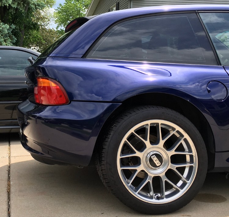

            Since BMW used red locktite on the strut bolts from factory and these are definitely original struts, lots of pb blaster and a torch were needed to remove the lower strut bolts. I eventually got it all done and went for a cruise. Feels good!
            Sun didn't help the pics. Rear seems like a good height especially for just guessing on the adjuster position. Front can maybe come down just a tad still. All in all, I am very happy with it.
            Still have to install the interior back together, but again, waiting for the paint/dye to show up.
              #44
              great improvement! never knew about the rogue engineering reverse mounts, neat idea. how do you keep the top bracket from pushing up into the cabin when trying to thread the nut on from the bottom?
                  That is a good question honestly. I had a bit of trouble with that and had to press it back down from inside the car, lol. I can only assume that once all the sound deadening and trim is back installed that it helps hold the plate down? 🤷‍♂️ Only time will tell I guess.
