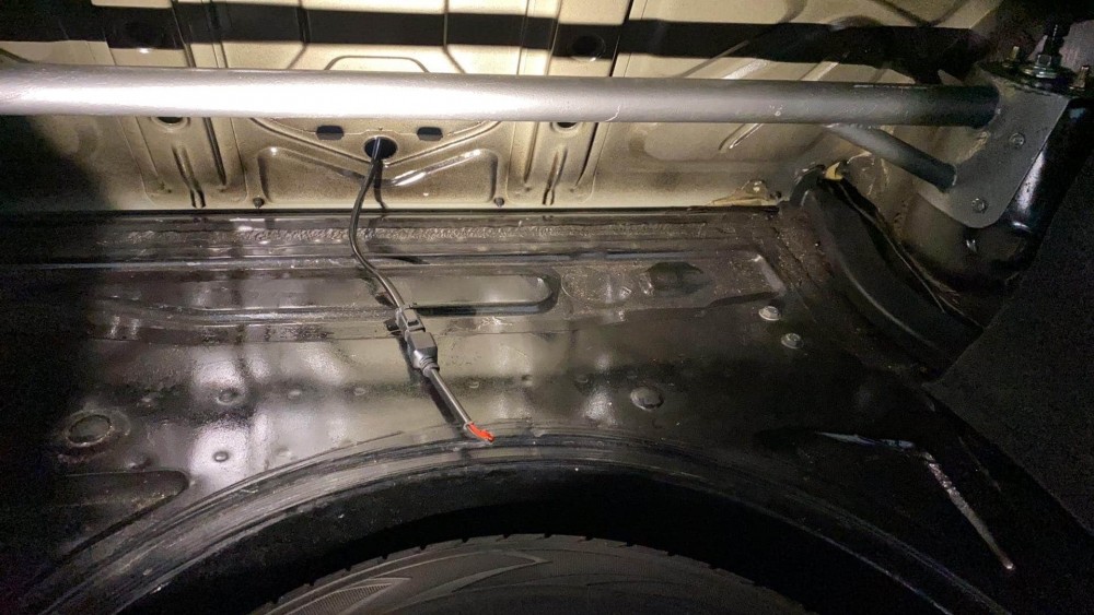

                              Harness showed up today so I figured I’d get it tossed in before the rest of the coolshirt crap shows up.
                              ordered a harness from superbrightleds, they had a bunch of offerings for pre-built stuff with weatherpack connectors/relays for like $17.
                              connected it under the firewall cover, snagged power from the distro block, grounded to strut tower.
                              the switch they provide is a gross rocker style switch for a 248” brolightbar.
                              I ended up repurposing the AC button to turn the pump on. Figured it kind of made sense because “ac.” I couldn’t figure out illumination on the switch so I said screw it and just use it to trigger the relay. The switch stays in the down position anyways, so it’ll be obvious when the pump is running.
                              power to the trunk runs under the console/carpet/rear seat and comes out under the ski pass. Just long enough to make it to the coolers location. 57D6DBAB-5808-4BC4-9CFE-7A85DED54418.jpeg
                              waiting on a few things to show up, the tube insulators will probably be the last thing to make it here and they’re kind of holding up the show at this point.
                              goal is to make this as hidden as possible, going to try and hide the tubes under the seats
