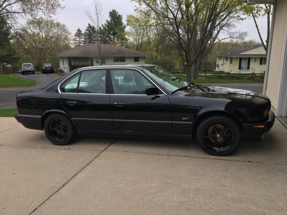

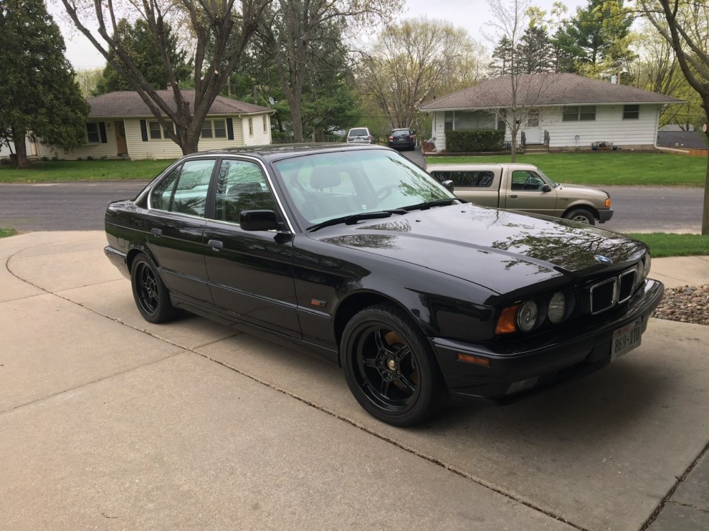

                            I haven’t been very good about updates, but a few things have happened since the last post, thought I might as well update for record keeping purposes.
                            Finally took care of the rear license plate mounting situation, the P.O. had it attached using two mismatched self-tapping screws, one of which had been overtightened and stripped the plastic grommet out. Ordered four new grommets and screws from FCP, and voila, no more annoying rattle when closing the trunk. It’s the little things.
                            I also got the m-systems bolted up and took some pictures, even with old tires the increase in handling sharpness and overall grip was miles better than before. Unfortunately, the car also developed a tendency to tramline that I wasn’t really expecting. Tightening the steering column nut helped some, but I think some adjustment of the steering box or replacement of some parts may be necessary to get rid of the problem, or at least reduce it. Input from other e34 owners would be greatly appreciated on this one.
                            The lower profile tires also exacerbated a noise that I believe to be caused by the sway bar links, those will be replaced as soon as the parts show up.
                            Also want to give a shoutout to @Jdesign for his help dismounting the tires and ensuring the wheels are true, they’re now ready for refinishing and I’m happy to report they’re as straight as an arrow. I’m finishing up a prototype design for a 3D printed center cap as I type this, and will share results after I test it.

                                    Tires on backwards by chance? Hard to tell for sure from the picture but that could have an effect on tramlining too
                                      #87
                                      give up now? lol I replaced basically every component in the e34 steering (besides the steering box, itself) and it still wasnt perfect. always chased my tail on that.
                                      tramlining, specifically, is caused by something loose, i.e. worn ball joint or bushing. the wheel is allowed to move out of alignment from the rut in the road, even with the steering wheel held in place. anything in the front suspension with a joint is in question.
                                      also, nice eye! sounds like a great fishing trip.
                                        #88
                                        Backwards tire could cause noise or potentially improper or accelerated wear but couldn't cause a wander like he's describing.
                                        I'd suggest taking the tires to someone with a road force balancer and have them straight track the tires. This will diagnose a tire issue if it exists and they'll be able to tell you which position to mount them in to avoid and minimize pull or wandering.  If that comes back good then @straight6pwr is most likely correct that it's a loose suspension part.  Strut, balljoint, tie rod, etc. You pick and it can cause this concern.
