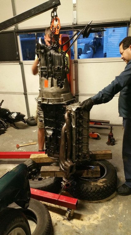

That same evening I got right to it and after about an 1 hr of fiddling around I had the trans back off and almost immediately saw my issue.
The guide tube had been rubbing on the clutch disc which had caused it to mushroom up. This only meant only one thing, I had the clutch installed backwards. That was confusing for me though cause I recalled following exactly as the instructions had said from fx racing which said to have the hub/protrusion face the trans. After digging around on the intranet I found that I wasn't the only one who had run into this issue and people had started the engine causing the tube and disc to build up so much heat between each other that they ended up friction welding themselves together making it quite the challenge to pull the trans back off. It came down to the fact that the instructions were actually incorrect from fx racing and that the hub on the clutch disc has to be facing the flywheel. Frustrated but thankful it wasn't something worse I got the disk flipped around and the pressure plate re-installed. I do want to point out that I installed the clutch disc the same way when I had the stage 2 kit. However for some reason with the g260 the guide tube never meshed with the disc so I guess if you're running the 260 on a 24 valve you shouldn't technically have any issues running the disc that way.
I did go ahead and order a new guide tube from the dealership which should be showing up tomorrow sometime and I should be able to get the trans back on the motor this weekend.

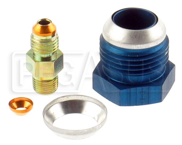

Nice progress. fyi no teflon tape should be used for -an fittings, only on tapered pipe threads.
+1
there are much better alternatives to fix pesky an leaks
Did you replace the detent stuff on the zf when you had it out? Or were they not bad yet
I miss wrote on the post. the threads on the 45 degree elbow going into the flange fitting was not a -10 an, just regular threads (not sure on size or pitch though, probably like m14 I think). The plan was to use some blue Teflon which I guess was oil resistant but happy I just welded instead.
