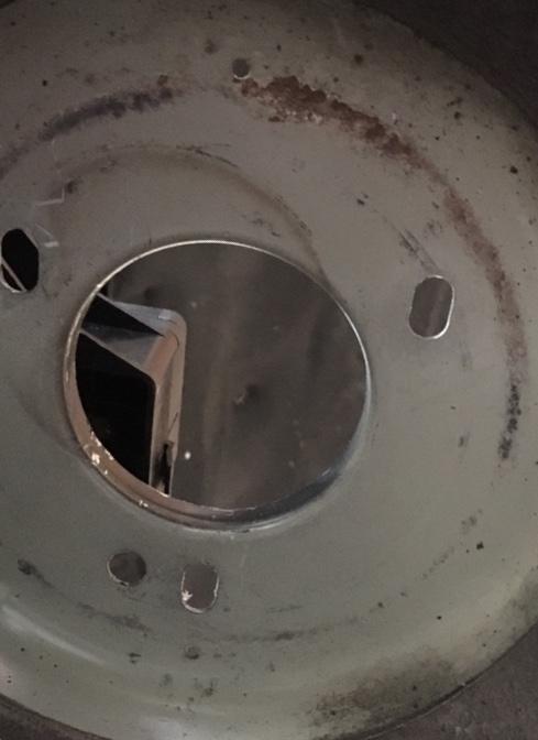

                                    While the wheels were removed, they were cleaned thoroughly on the inside and the tires were rotated.
                                    9B75053E-9C58-4F4C-BE7D-B0EDF64E822E.thumb.jpeg.0f97e52badd089749325070a5b735ac0.jpeg17EE964D-CDA9-4254-ABD1-6800585E9F94.thumb.jpeg.3c3d175ed3fcb6bb39f47fc10e30cac2.jpeg
