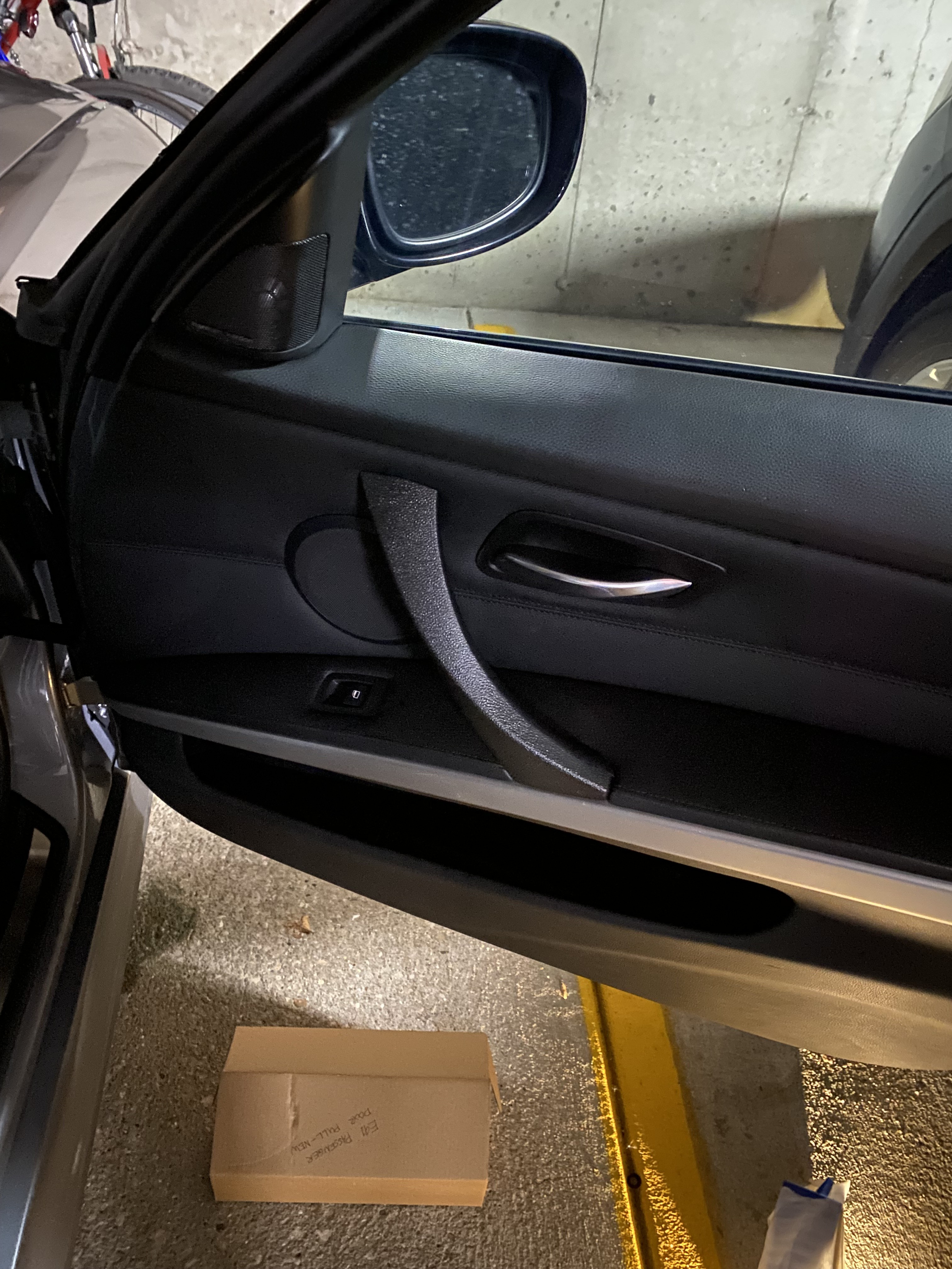

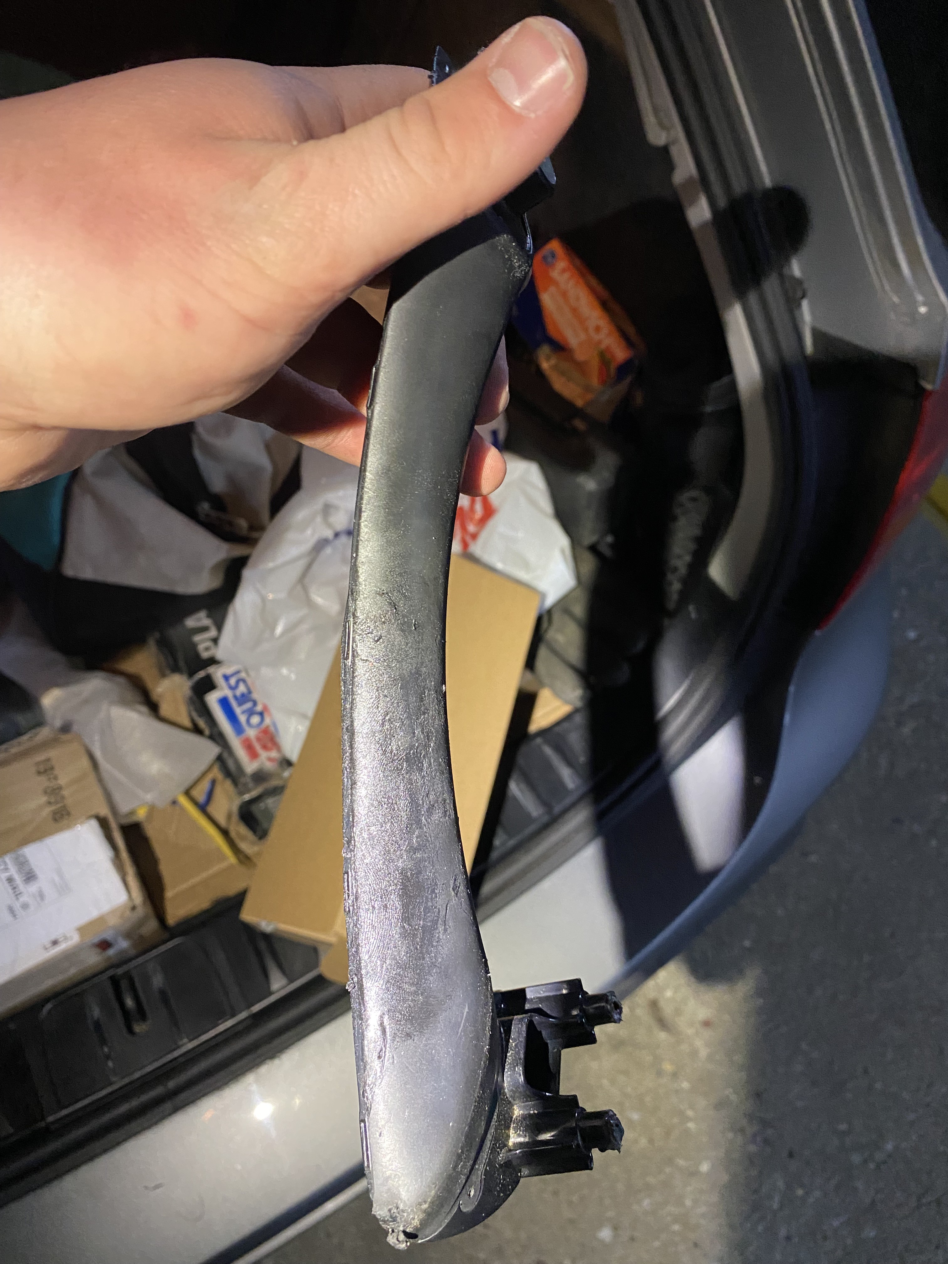

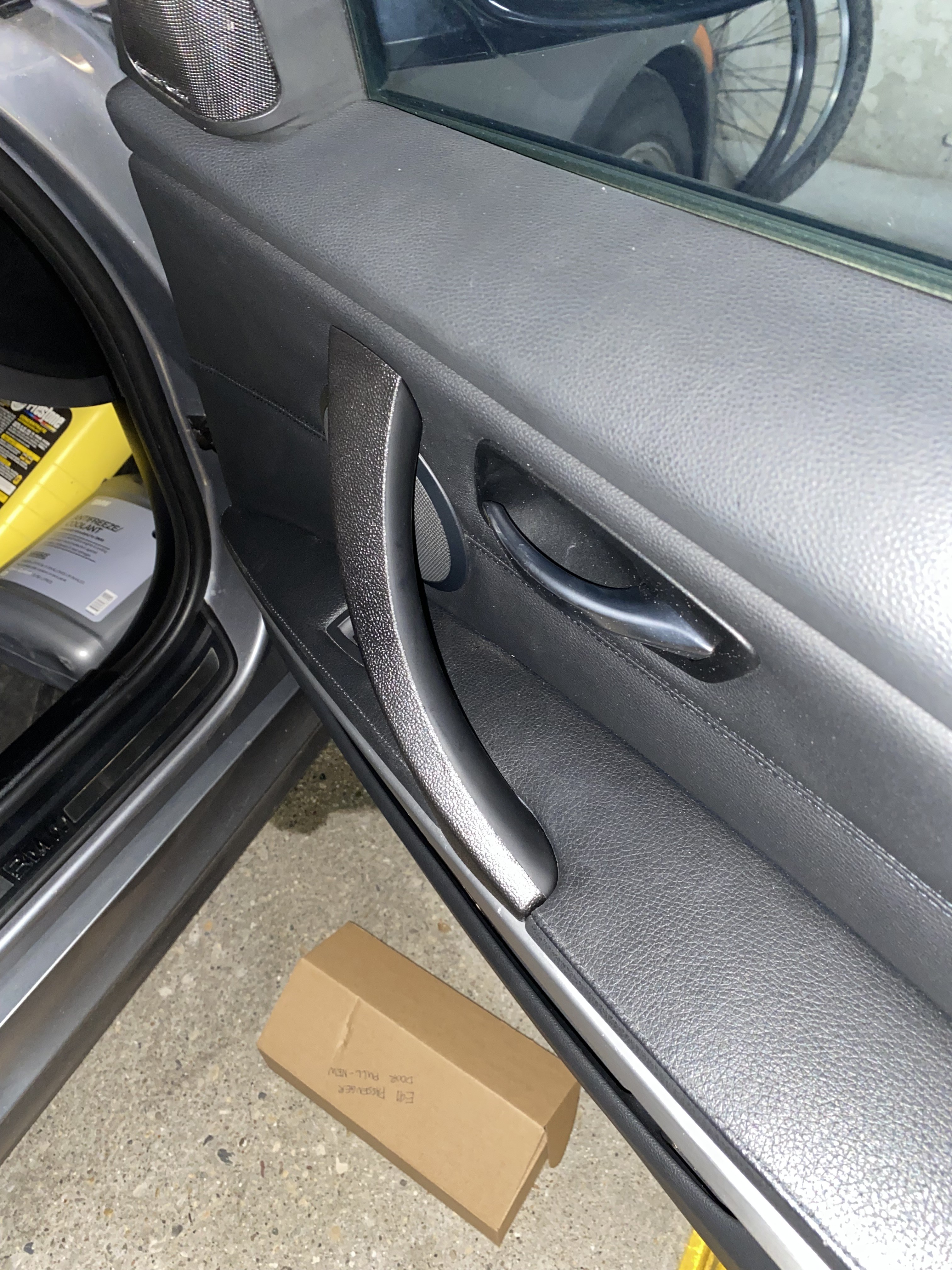

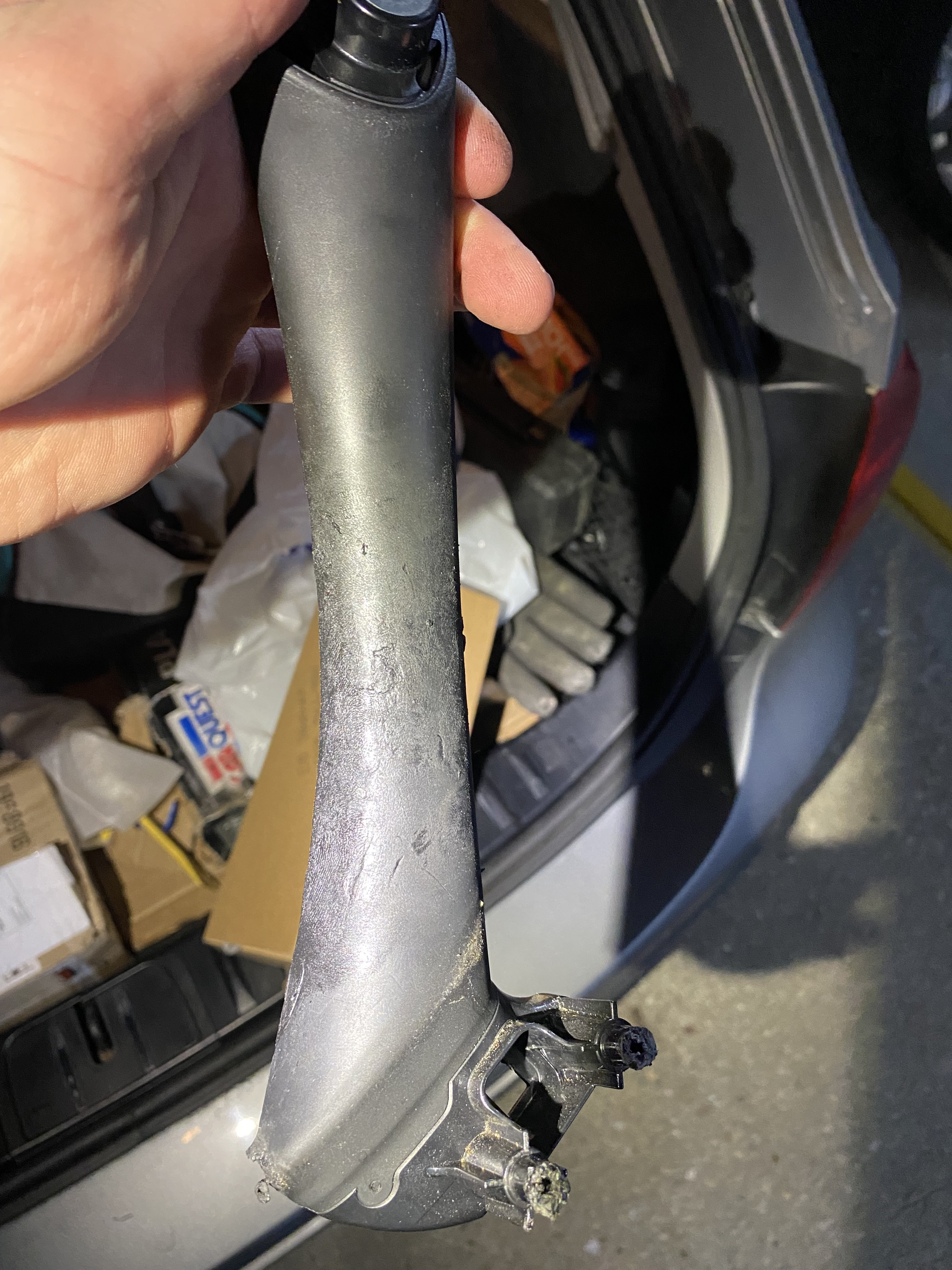

        Replaced the passenger side door pull - it was all nasty like most of them are and left sticky black stuff on your hand when you pulled it. Not ideal.
        I bought the Amazon special version, as much as I want the OEM look I couldn’t bring myself to spend $100ish on a new door pull that’d break down in the exact same way in a few years. The black plastic definitely looks cheaper on the outer cover, so maybe I’ll get an OEM replacement for that, but the inner feels fine and it all mounted solidly. This version uses screws instead of the heat-staked originals.

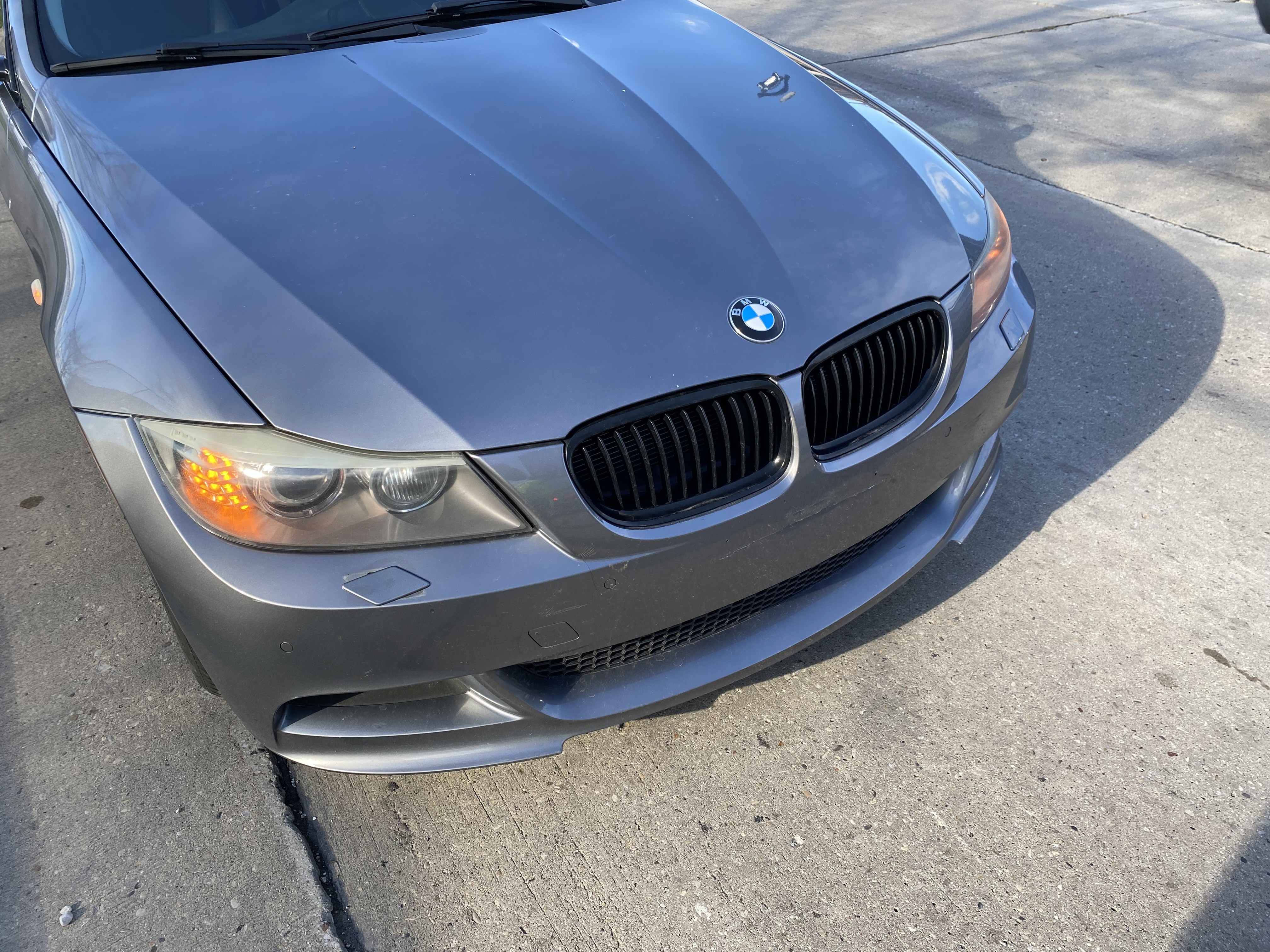

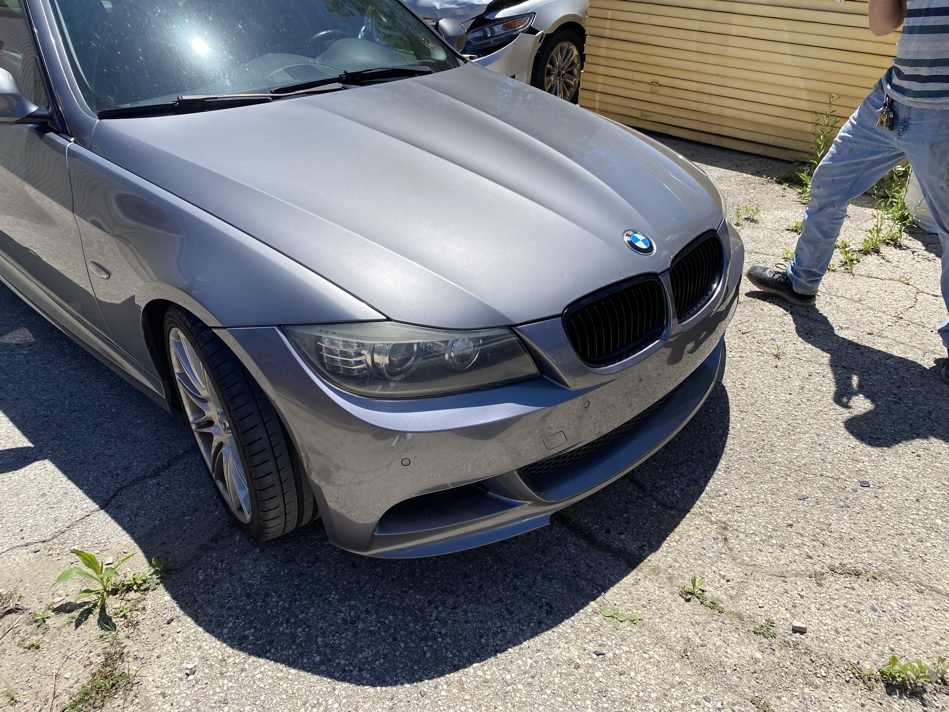

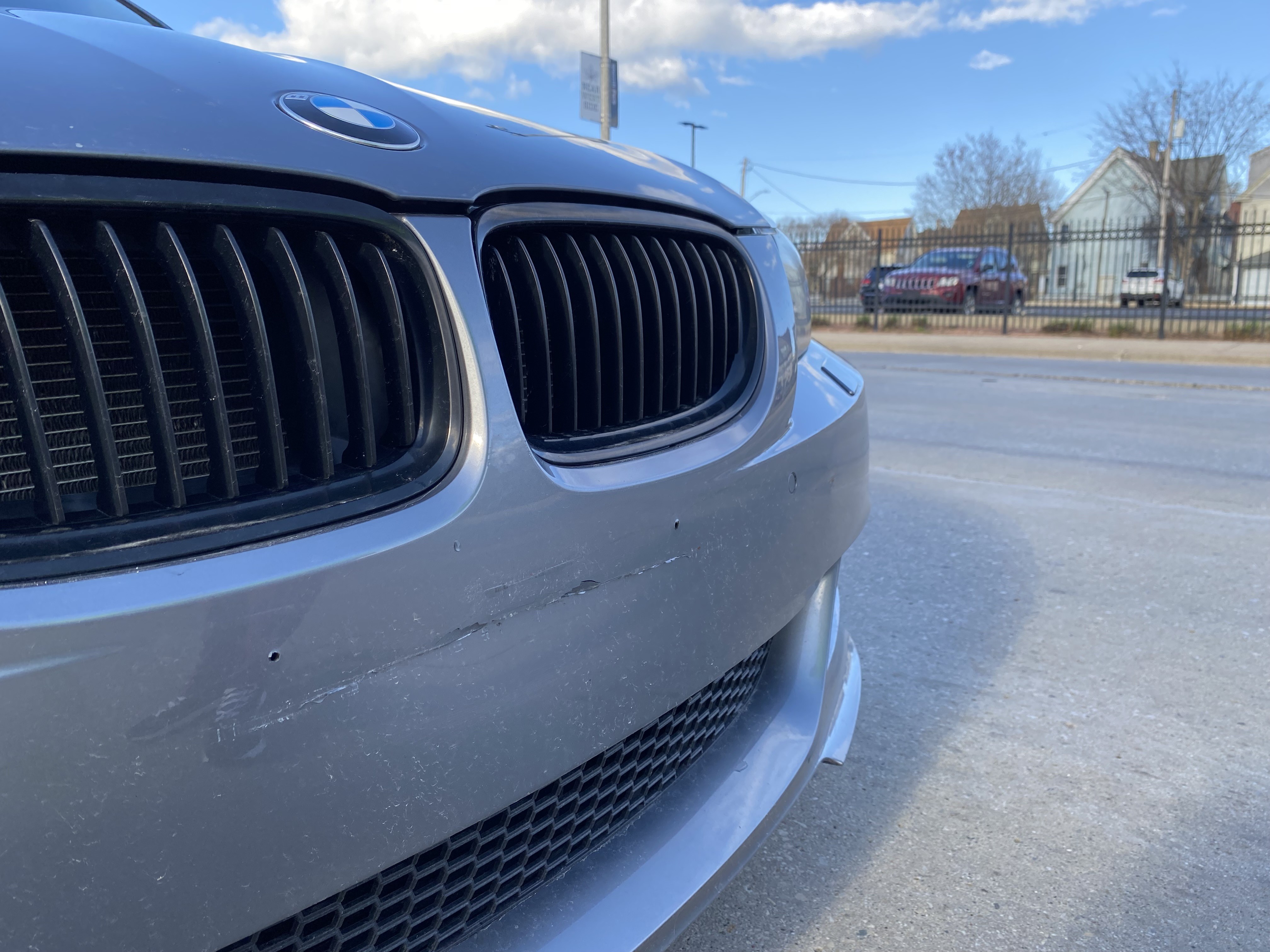

            Oh - last update: had a semi back up into this car in traffic in April, and I was extremely disappointed. The hit wasn’t too hard but it put a large crack in the front bumper, which is NLA and basically unobtanium (genuine performance aero bumper, and would’ve made the car have an incomplete kit)
            Through Reddit and a bit (read: a stupid amount) of luck, I found one on German EBay of all places, bought it, had it shipped here (in only bubble wrap 🙃) and finally painted and installed a week or two ago. I managed to snag a euro model bumper too without headlight washers, so I got to delete the ugly covers and the ugly side markers all in one fell swoop.
