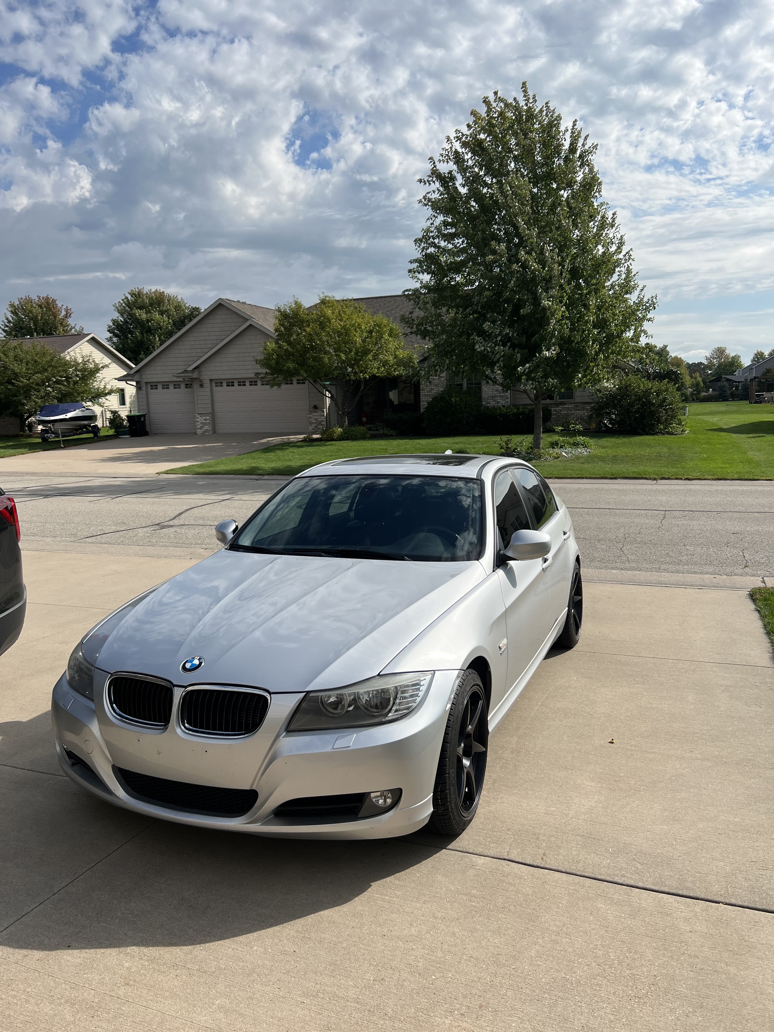

    2 weeks before the truck sold, I made a trip down to Chicago to pick up my brothers 2011 328xi. The car was having starting issues and he was unsure what to do with the vehicle. We figured it would be best if we brought it back to the Appleton area for further diagnosis and repair. Car made the 3 hour straight drive back to Wisconsin with out a hitch. It was around this time that I was looking for other vehicle options. I wanted to reduce my payment significantly or not have one at all, so I was looking at E46's, E70 X5's and E90s. My brother decided he wanted to find something newer so would be selling the E90. So I bought it.

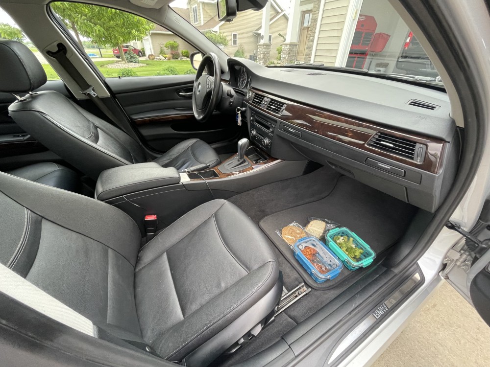

    2011 328xi Titanium Silver, Black Dakota leather, and Burlwood with 99,863 miles. No iDrive.
    Car was running lean on both banks. After some research found it likely to be the valve cover with the built in CCV. VCG was leaking anyway so it was time for it to come off regardless. I also had the OFHG replaced along with the power steering fluid reservoir to address any immediate concern areas. Next will be cabin and intake filter, along with wiper blades.
    The car is in very good condition minus a few minor things. Was a 1 owner vehicle up to 72k miles when my family bought it. Has always been garaged kept.
    Silver wasn't my first choice, but the color has really grown on me. I also can't say enough about how much I am enjoying the E90 platform.

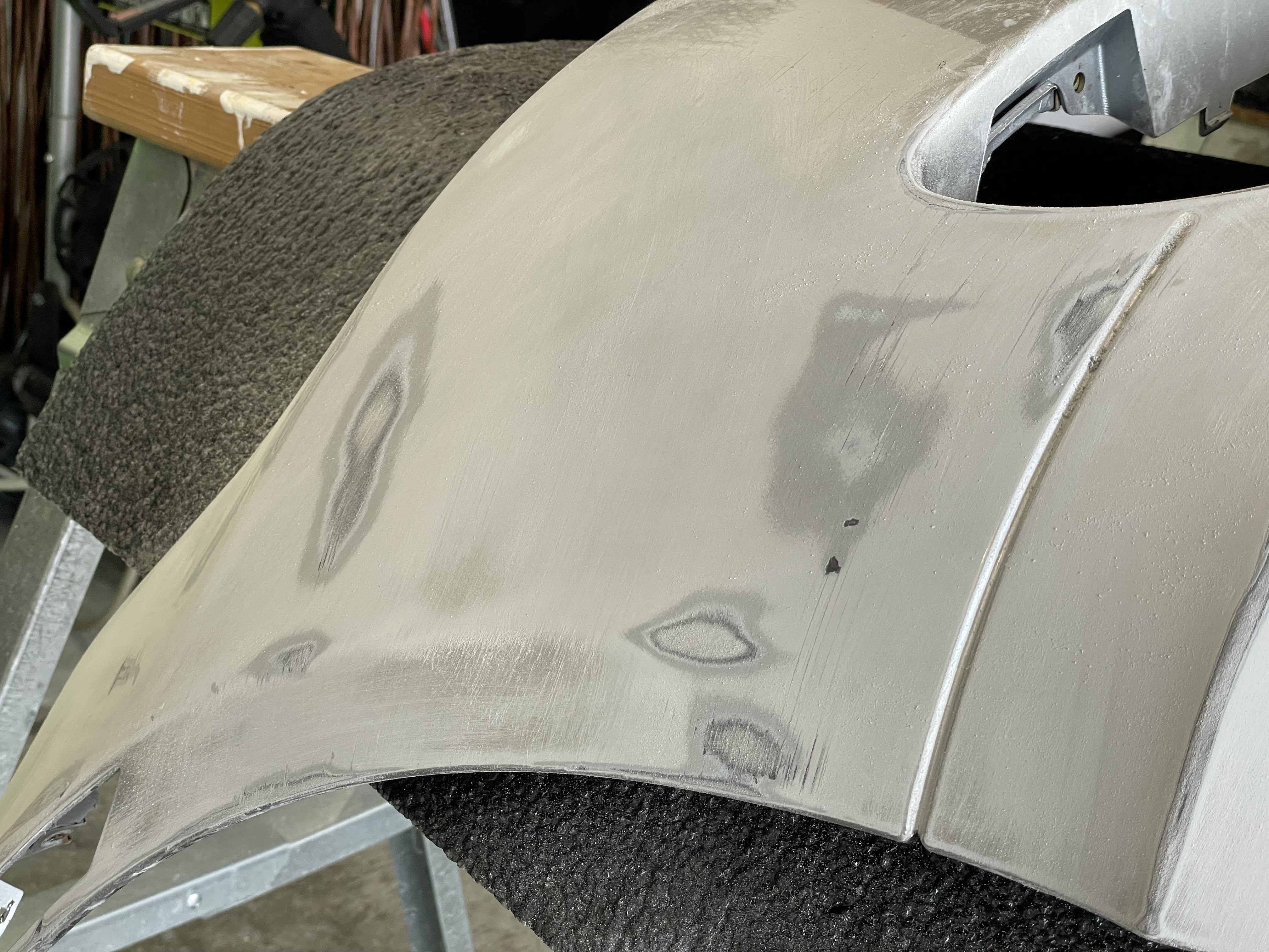

    My brother hit a construction barrel. I am going to do my best to get this looking presentable, but I plan to replace the bumper next year with an M Tech/M Sport one.
    (Ignore my dinner)
    If it's not going to be the weekend car, it has to look good and be enjoyable to be in. I have a fair number of things on the way to address both of those. But will remain largely stock( I say that now).

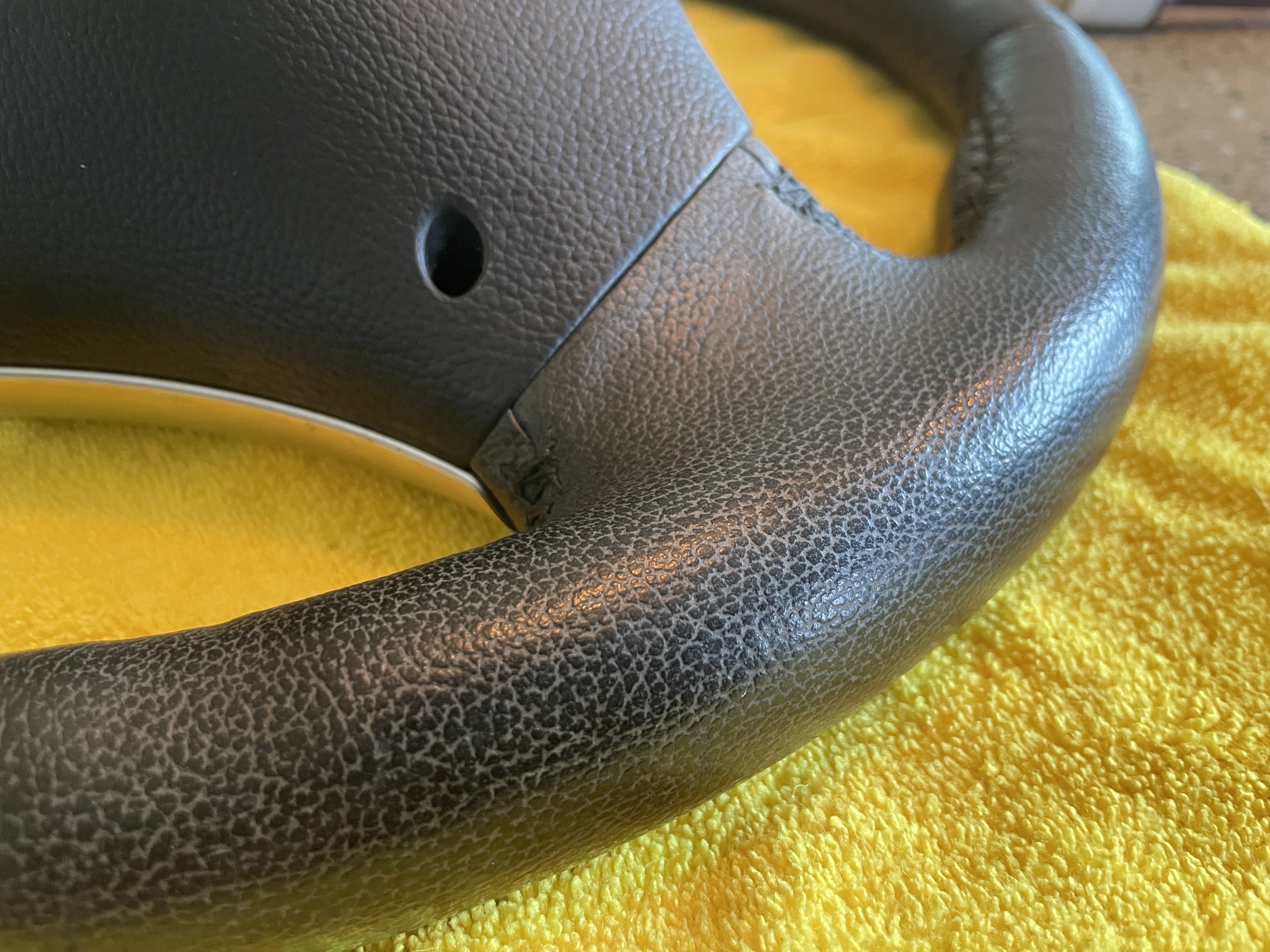

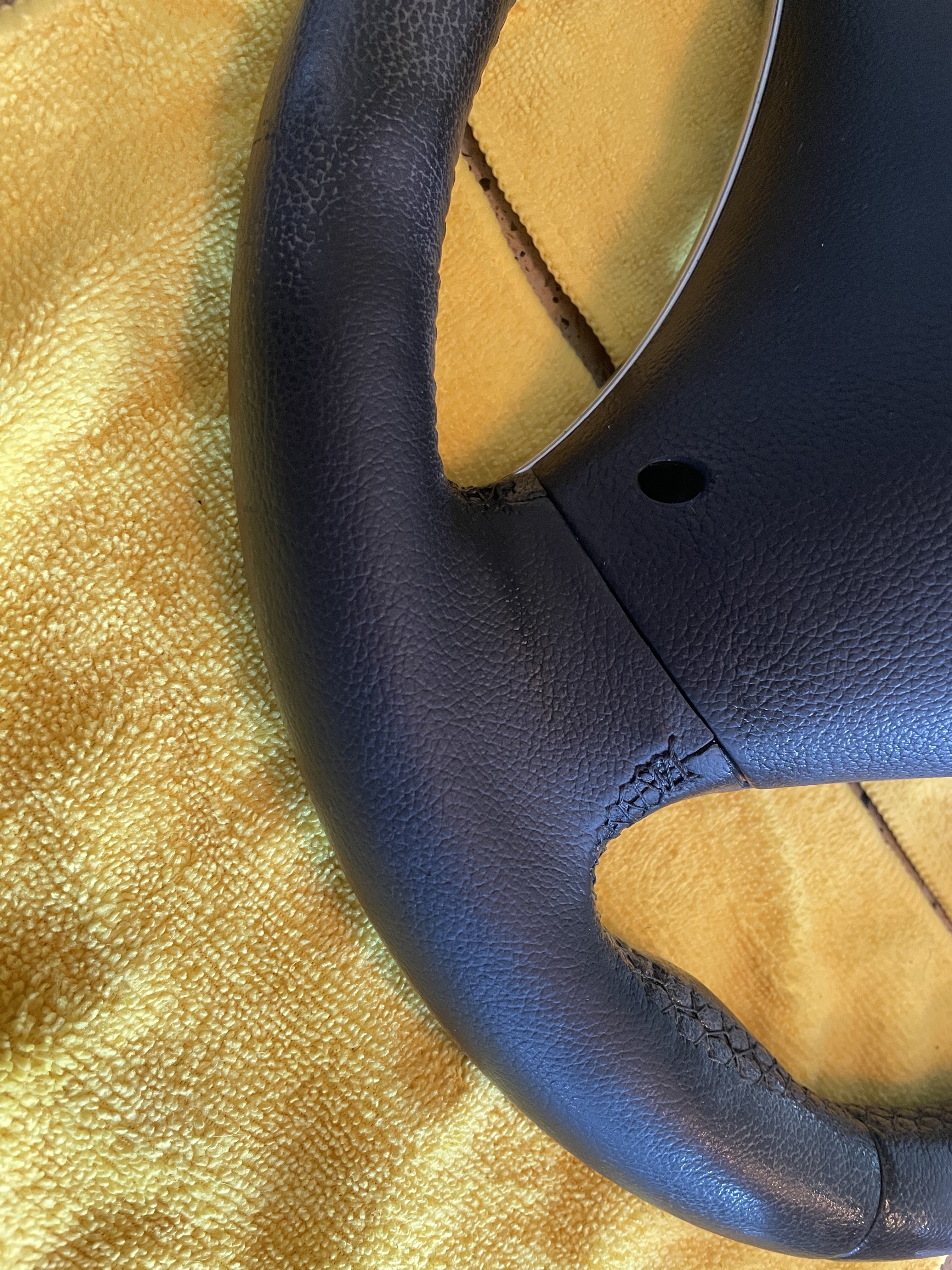

    To start, the steering wheel. The stock one is fine, but we can do better.
    Purchased this heated Sport wheel that I have some plans for. But first to clean it. I used Griot's leather 3 in 1 and leather conditioner in conjunction with a Colourlock leather brush, short hair detail brush, and a tooth brush.
    You can see how much dirt is caked into the grain.
    This was after one pass with the first brush.
    This was after the whole wheel. Clean your steering wheels.
    Grain clean, nice semi gloss matte finish.
    More updates to follow.

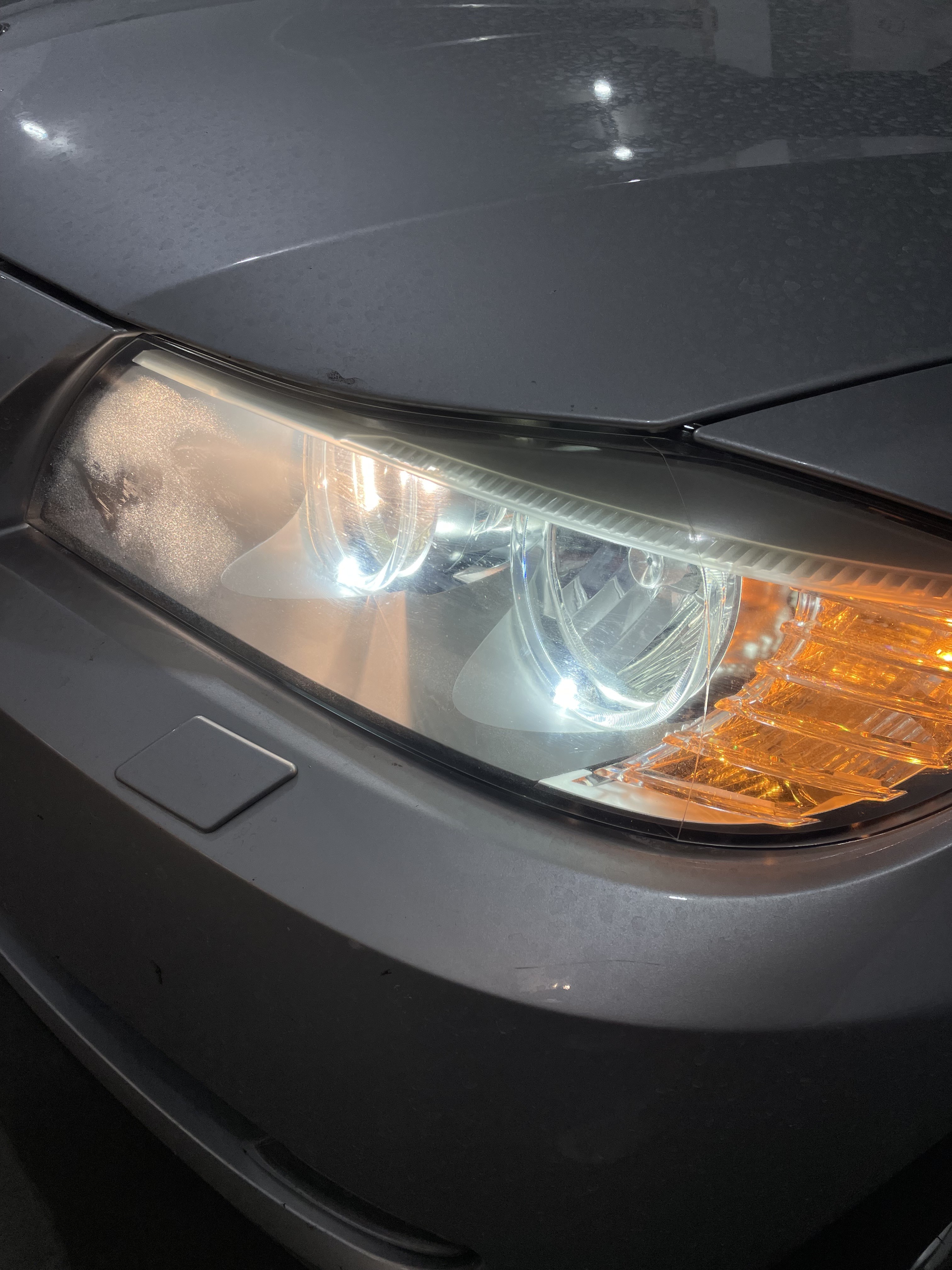

        Nice! N52 e9x's are probably one of the best 'modern' BMW daily drivers (though I'm a bit biased). I had no idea the euro xenon's had no leveling units, I'd love to get rid of those since they're nothing but trouble.
          This thread is where I found that. Having OE xenons on my E46, upgrading the lights in my F30 and F150, I really do not like halogens. I know you can buy brighter, better halogen bulbs, but they last significantly less amount of time and the cut off is not great.
          Need to do more research.

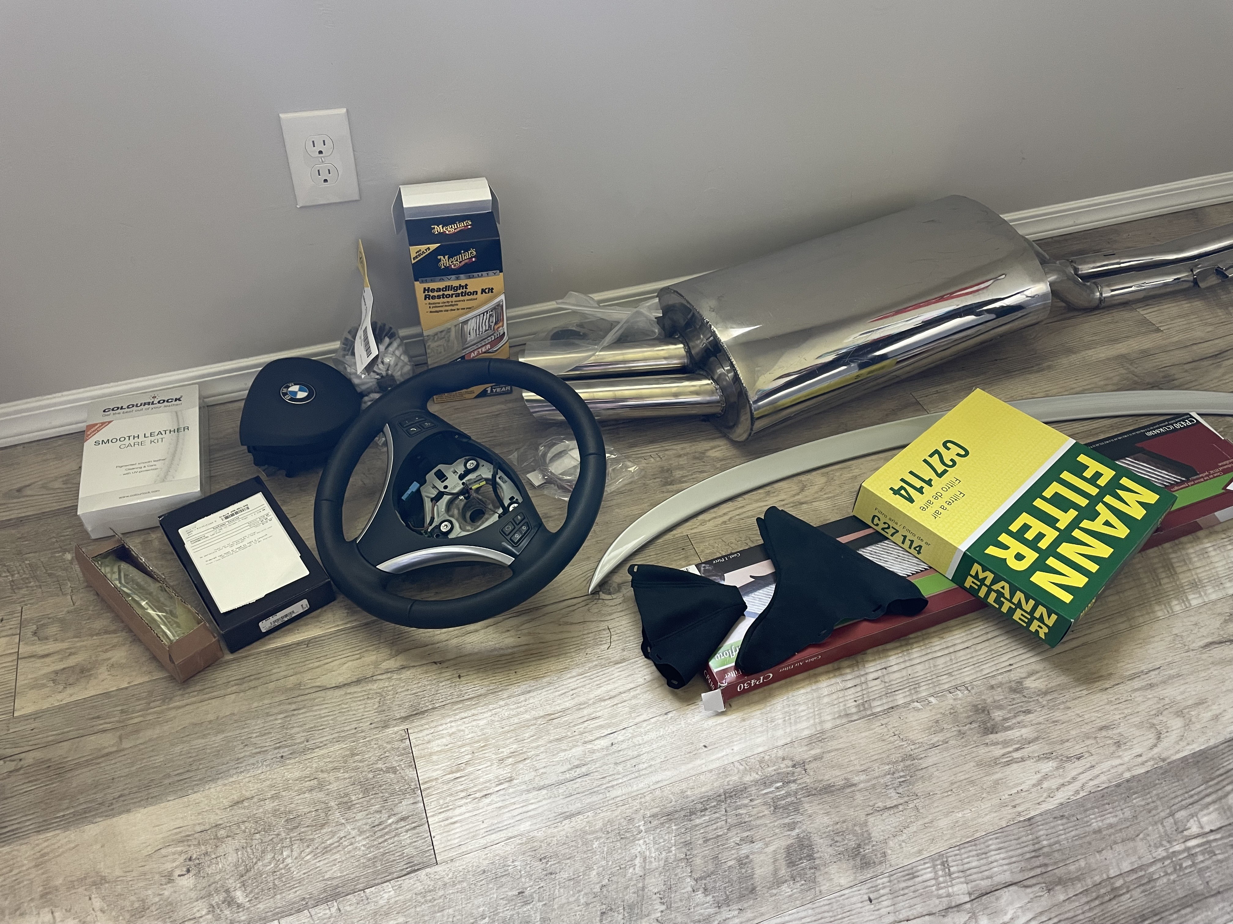

            Parts and things starting to pile up.

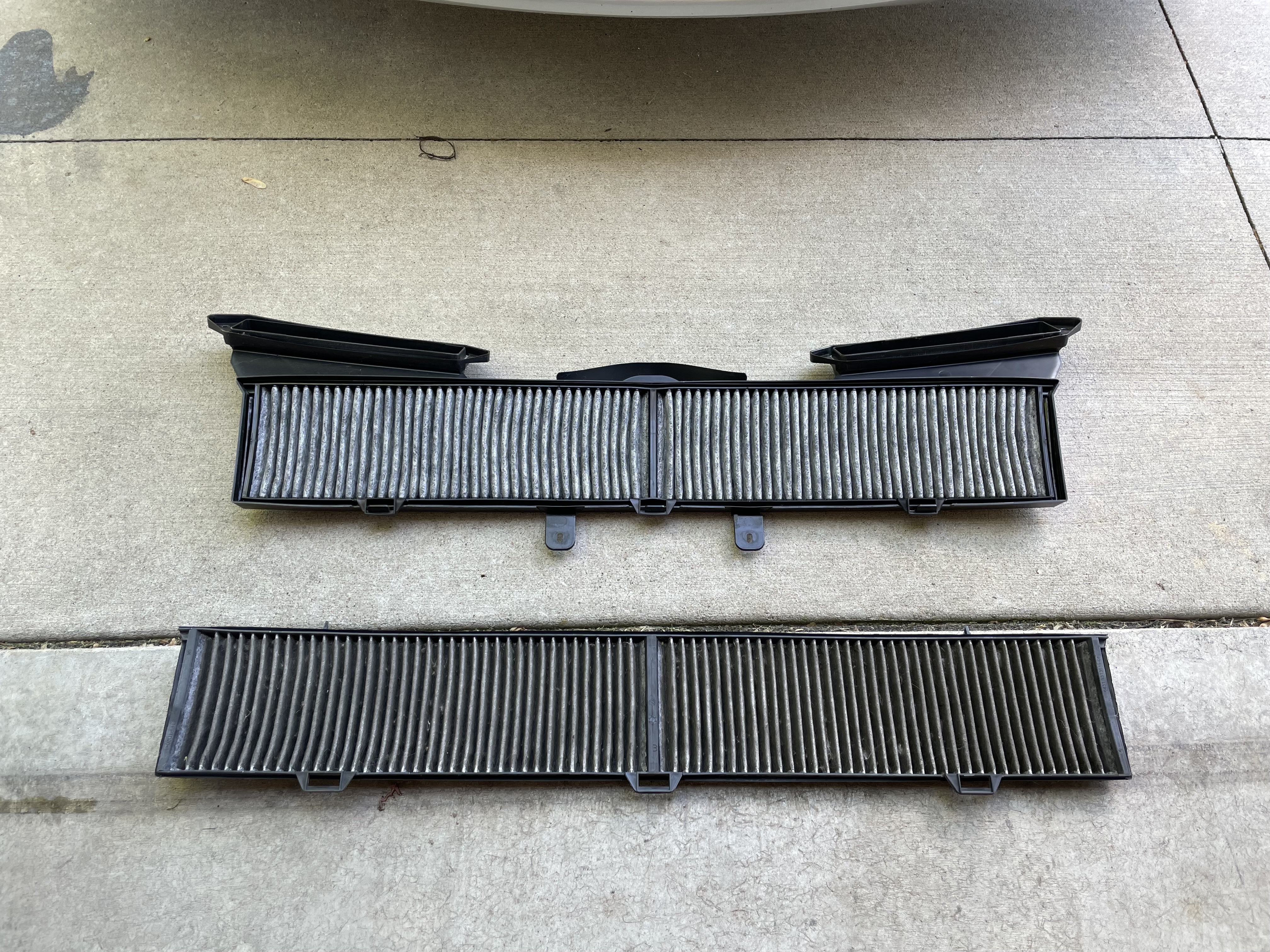

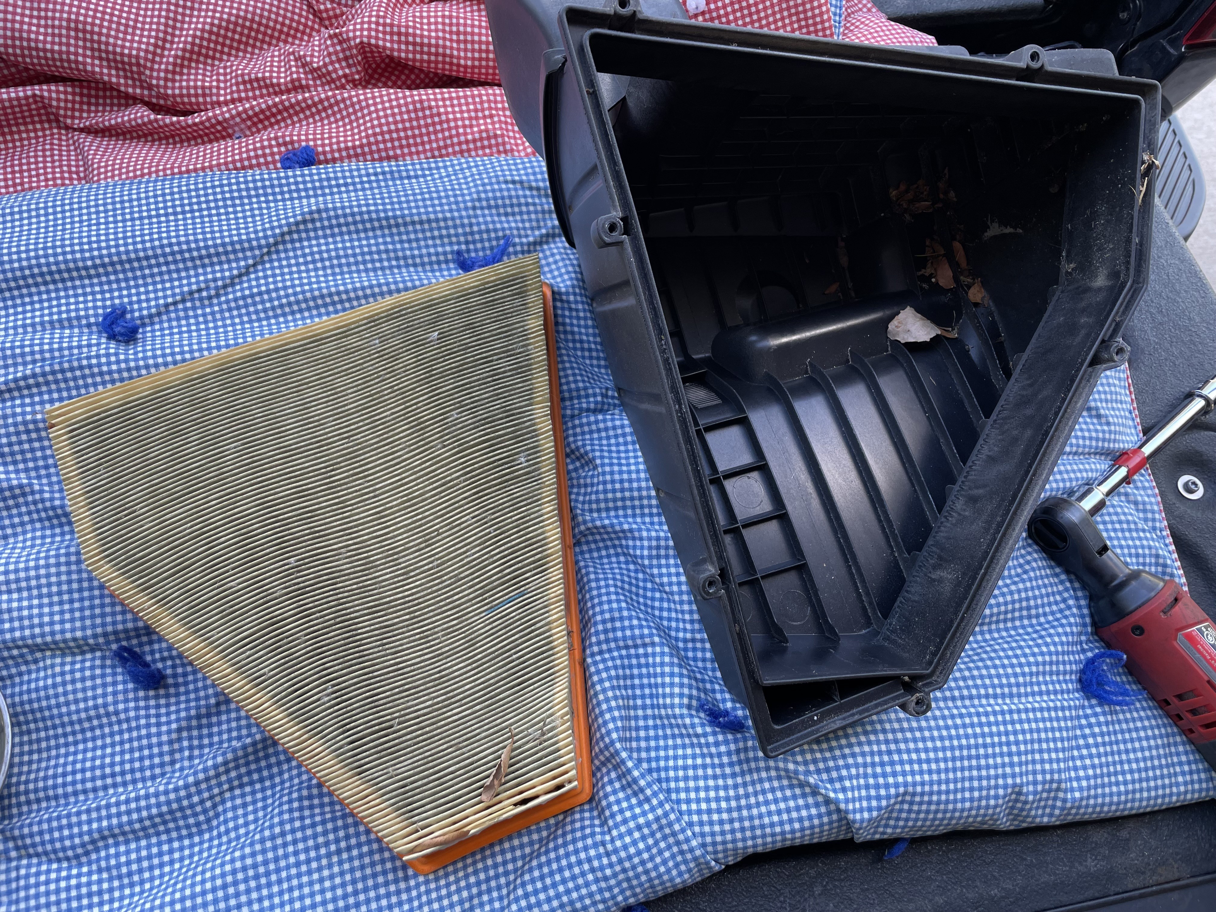

            Some basic maintenance items that clearly needed to be attended to. Cabin air filter and air filter, done at 99,873.
            Old filter.
            New filter in housing.

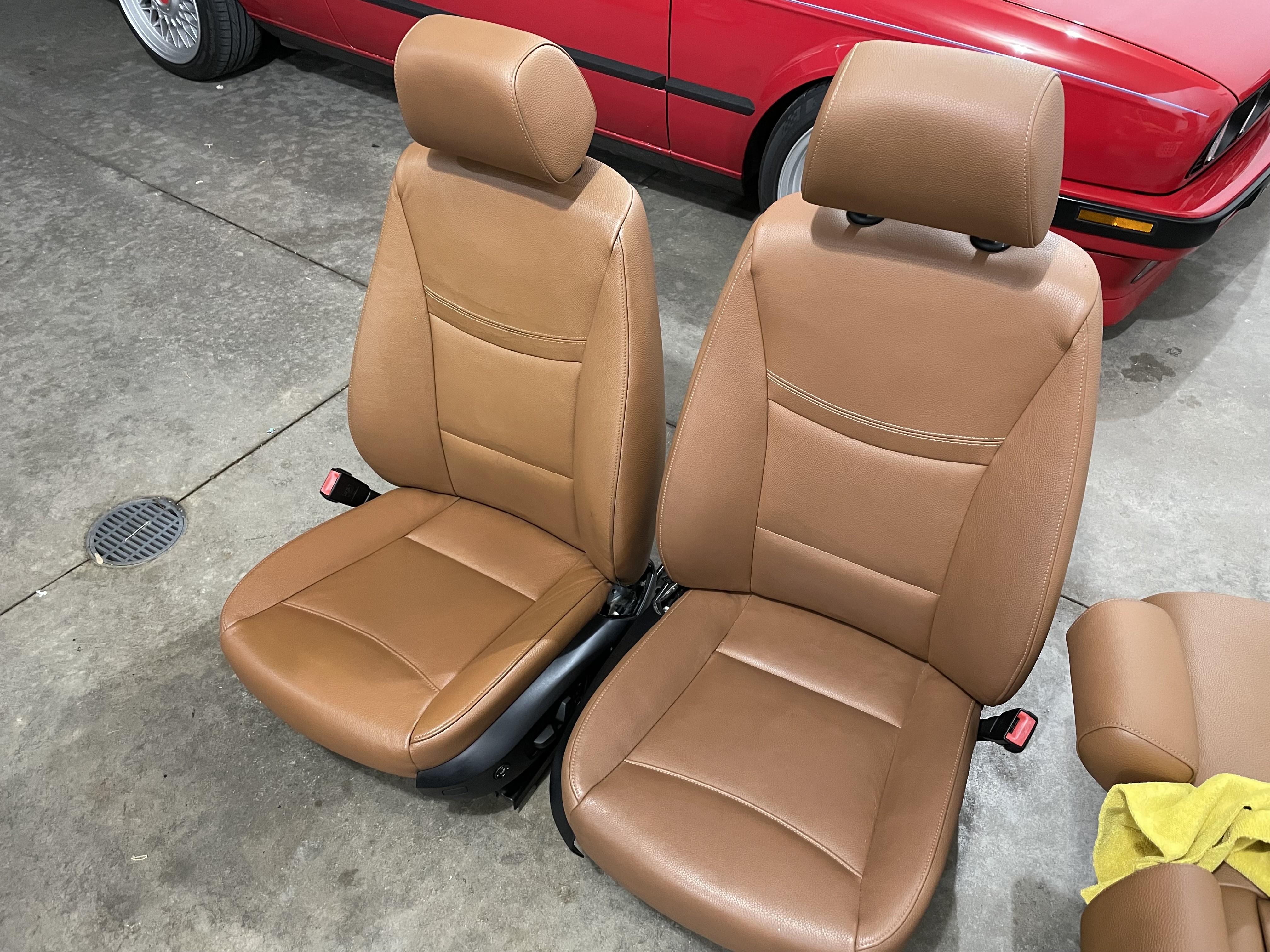

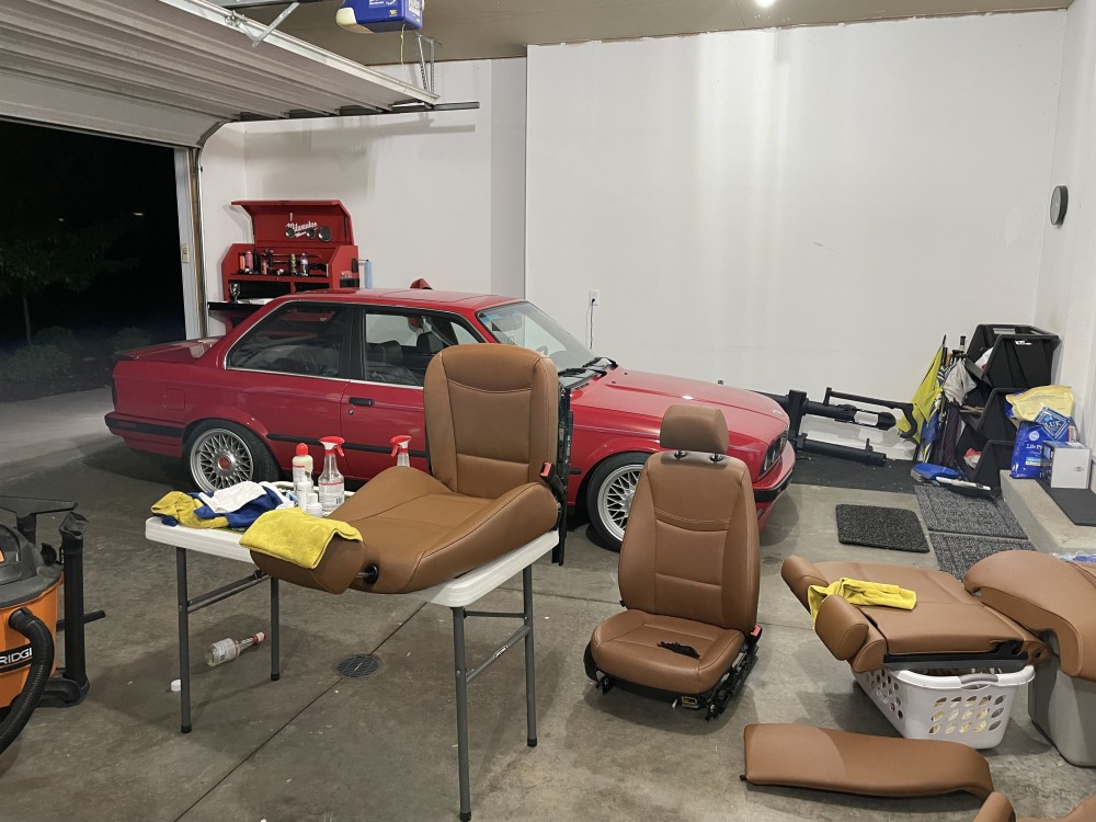

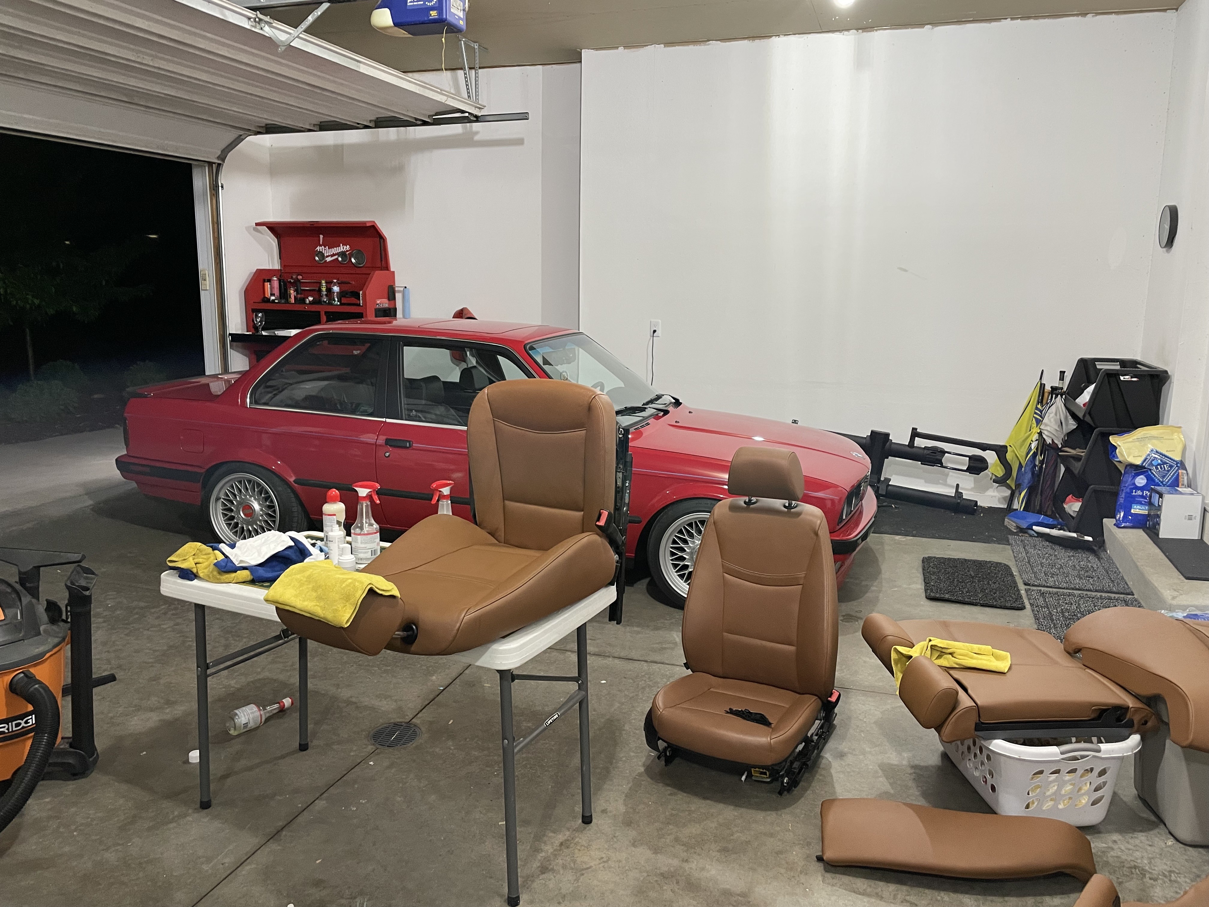

            I picked up a full saddle brown interior for dirt cheap. Not sport seats unfortunately, but I actually like the comfort seats in the car currently. Can always try to find some in the future. Came out of a 2011 335i. It's in pretty great condition minus a few small imperfections.
            I had originally bought this Colourlock leather cleaner kit to do my current interior, but ended up using on this.
            IMG3141 2.jpeg\
            Brush is not included but is required if you have dirty leather.

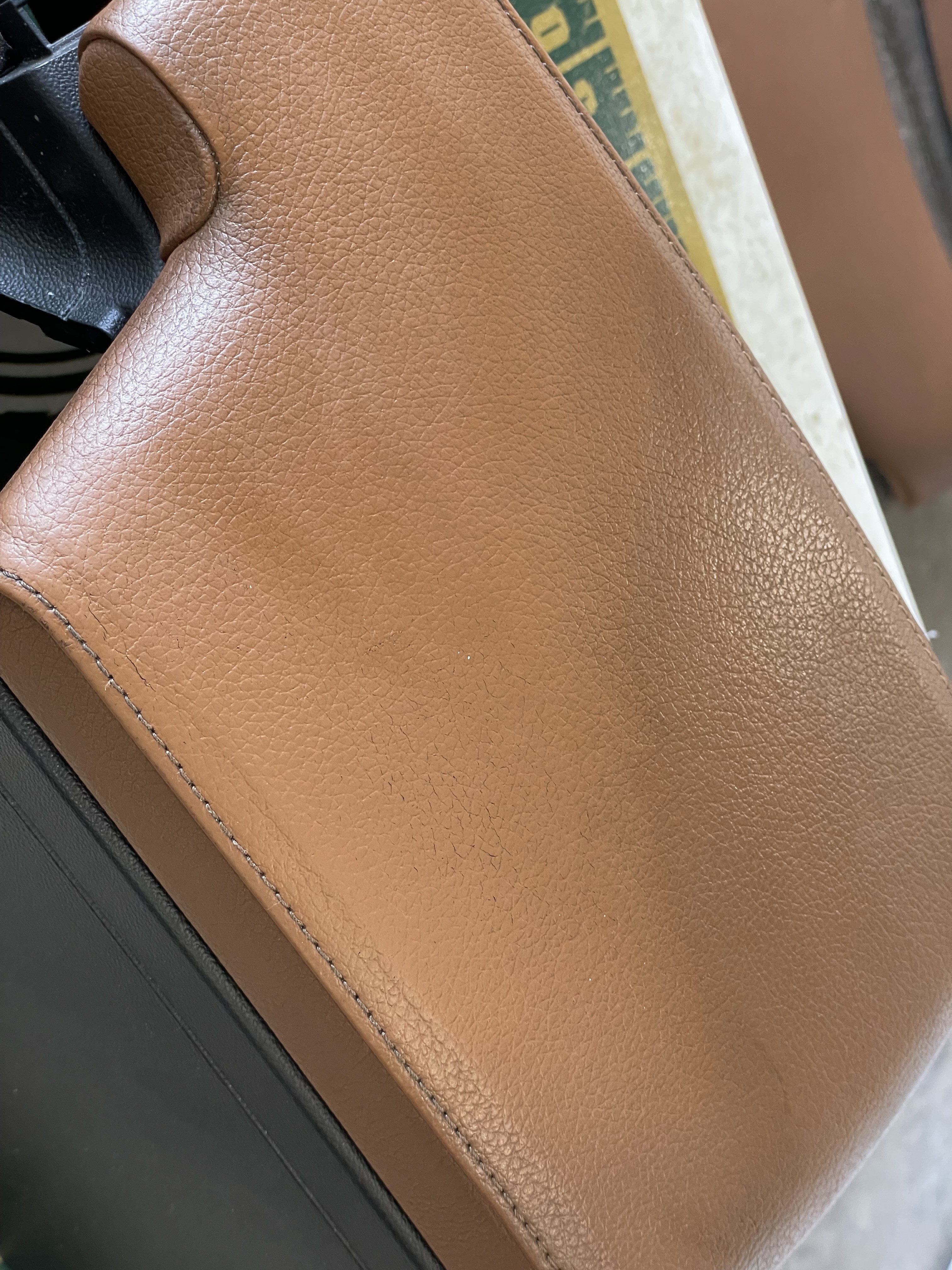

            High traffic areas looked like this. Brown, but clearly in need of some attention.

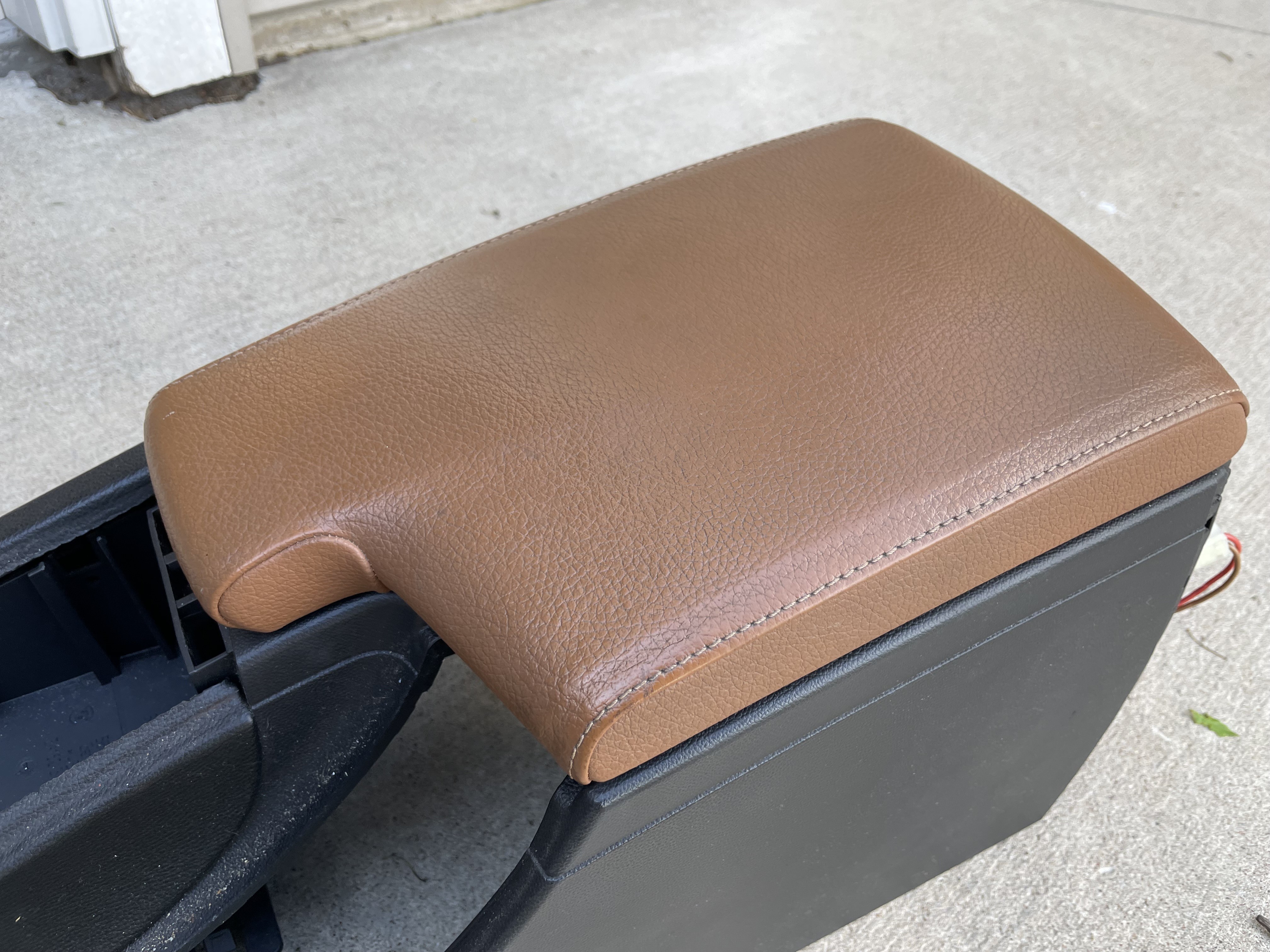

            I don't plan on using the center arm rest for the time being because you have to replace the entire center console, so I used it as a test piece.
            This was just couple back and forths with the brush and the leather cleaner.
            Then got to work on doing the whole thing.
            Bottom is clean, top is untouched. Definitely needed it.
            Here is a side by side of the cleaned driver seat, and the uncleaned passenger.
            Driver left, passenger right.
            I'm assuming the passenger seat got less use as it wasn't as dirty, but still, different shades of brown.
            I will have to do some further cleaning once the seats are back in the car and I can recline the seats all the way back.
            The top of the driver seat came back pretty decently, but doesn't have as rich of brown color as the bottom half. I'm guessing due to some sun fading.
            Now that it's clean, I plan to do a full rejuvenation of the leather using Leatherique. Some spots are pretty dried out, liked the rear headrest on the side facing the rear windshield. But it really could use it everywhere. I also need to get some liquid leather and some color matched dye from Colourlock. Some high traffic areas like drivers door card arm rest and some spots on the driver seat has the leather kind of worn away.
            All in all, for how much I paid, it should be a fun project and I'm excited to see how it works in the car.
            Not going in the car yet as I have a few other things that go with this to really set the interior off that I am waiting to receive still.

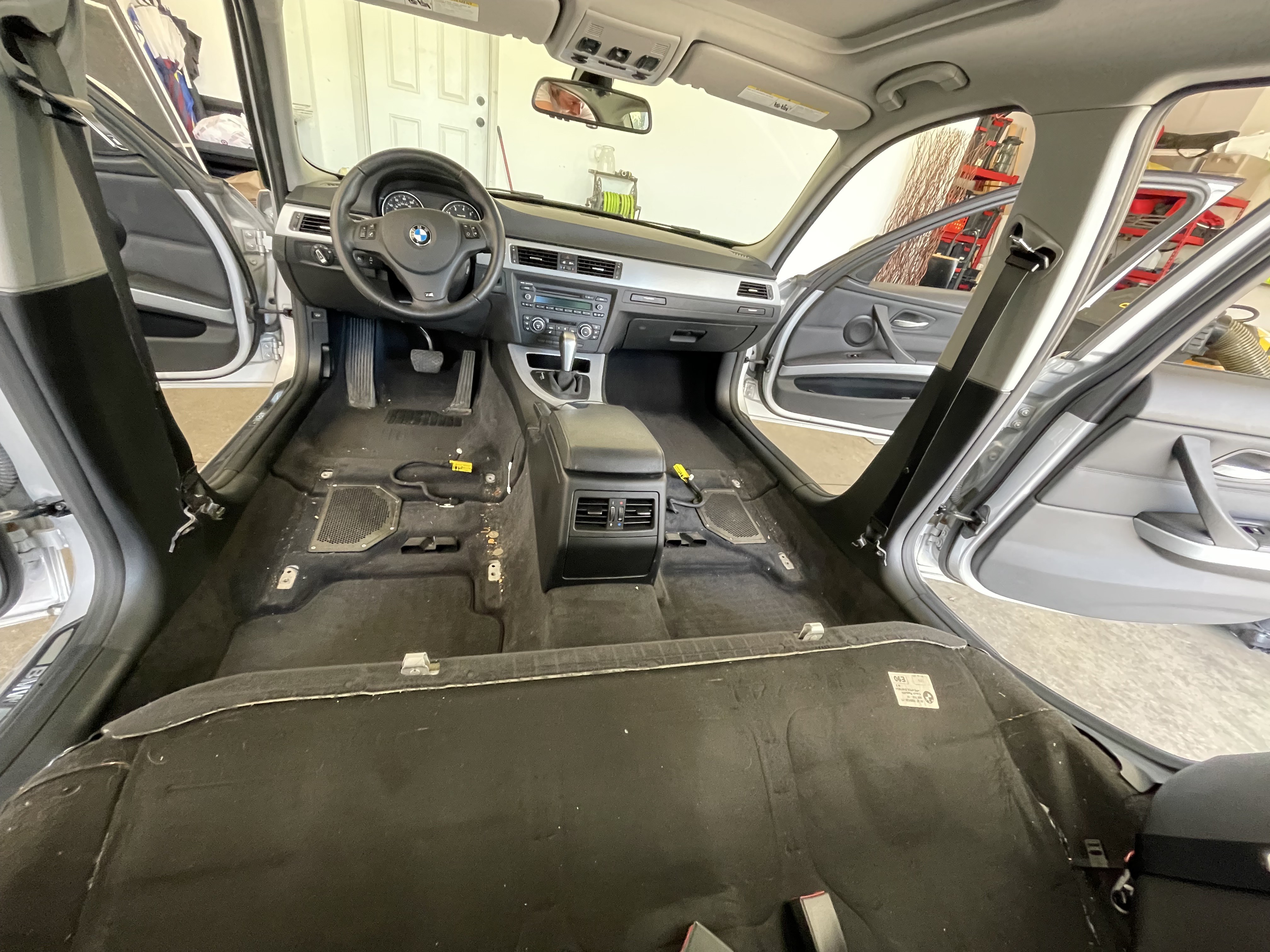

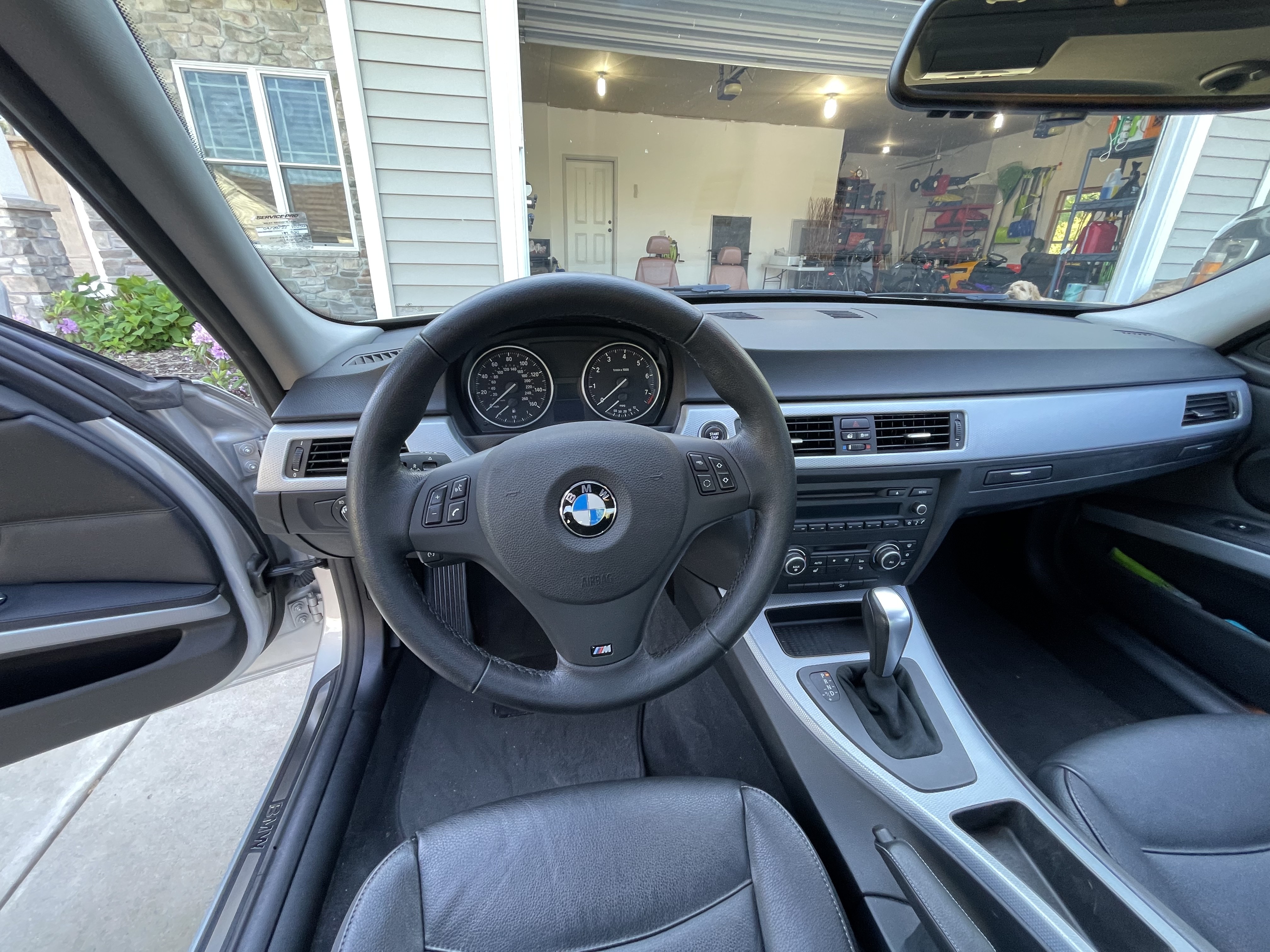

                    The saddle brown interior idea was short lived. Did my interior mods as seen below and decided it wasn’t even worth giving a go. Love the way the interior looks now and don’t want to mess with it. If you want the interior, will give you a good price on it.

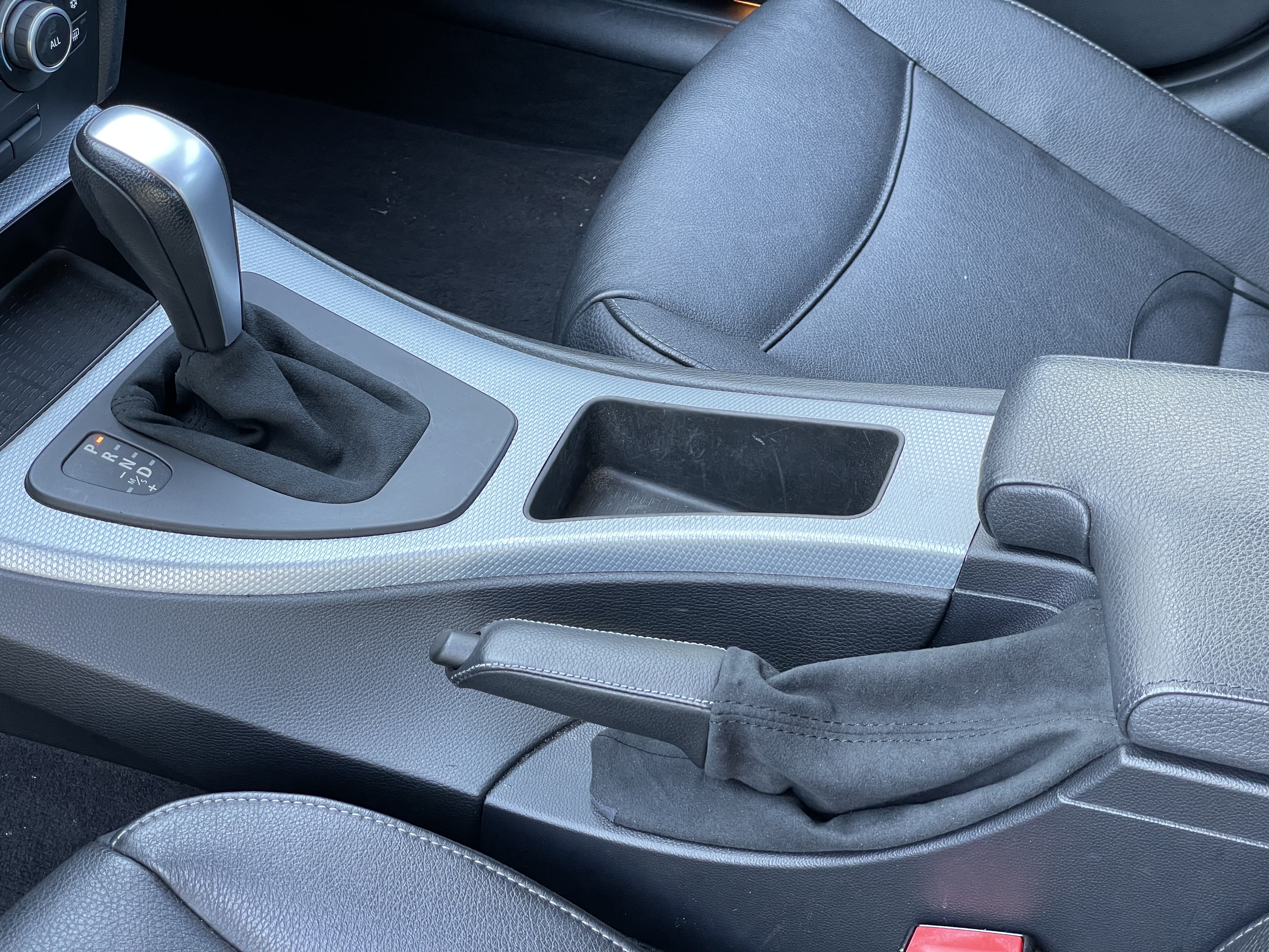

                    Interior mods:

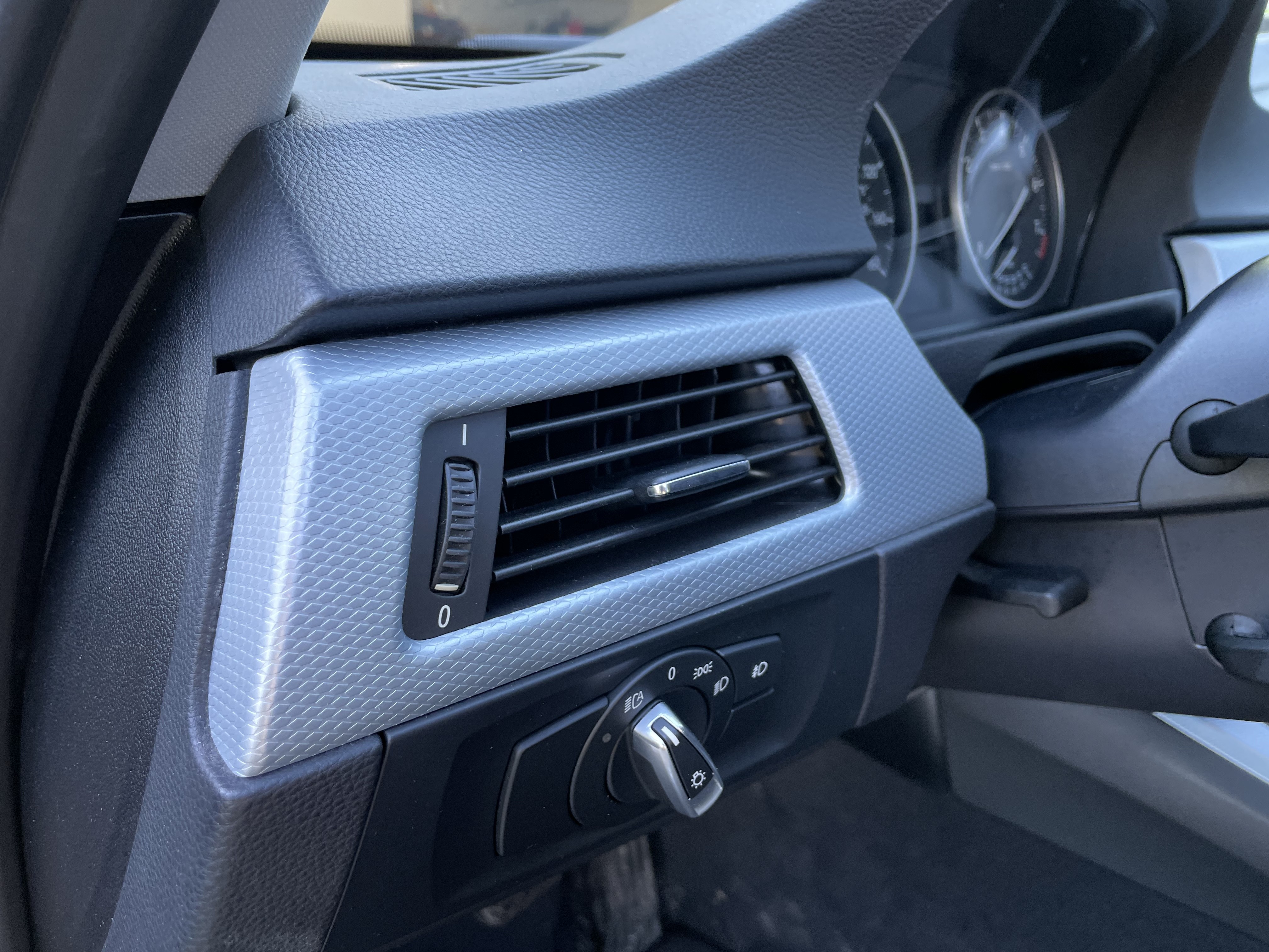

                    Glacier Silver interior trim. Similar to the cube trim of the E46, this has a raised texture to it. I love the way it looks in the car.

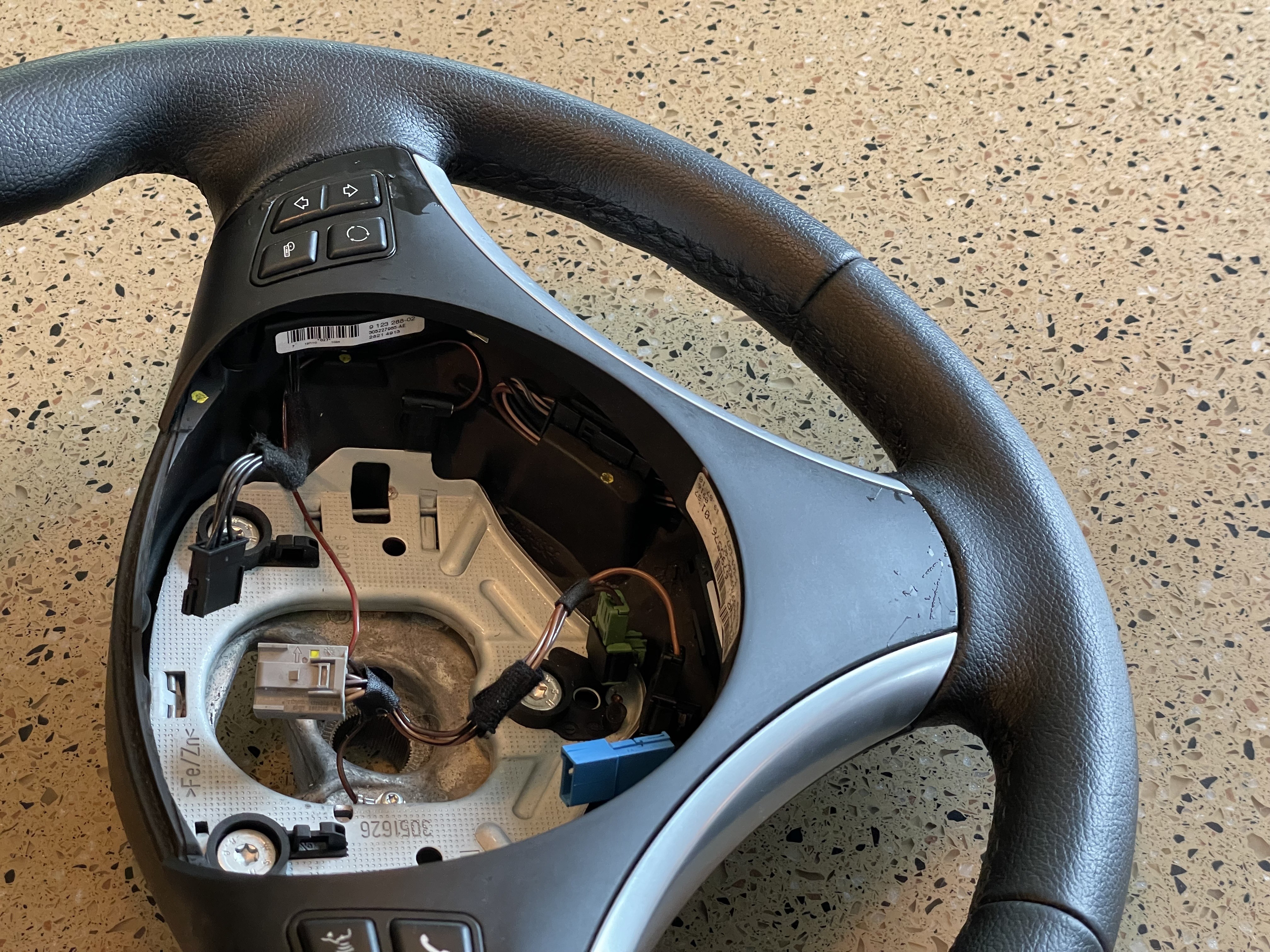

                    Sport steering wheel with M sport trim. This was the cherry on top to really transform the interior with the trim. What a difference this makes and looks amazing.
                    Alcantara ebrake and shift boot with a better conditioned shift surround. Just to freshen it up and some different texture than the dried out leather boots.
                    I love this interior. I think black sport seats would really set it off.

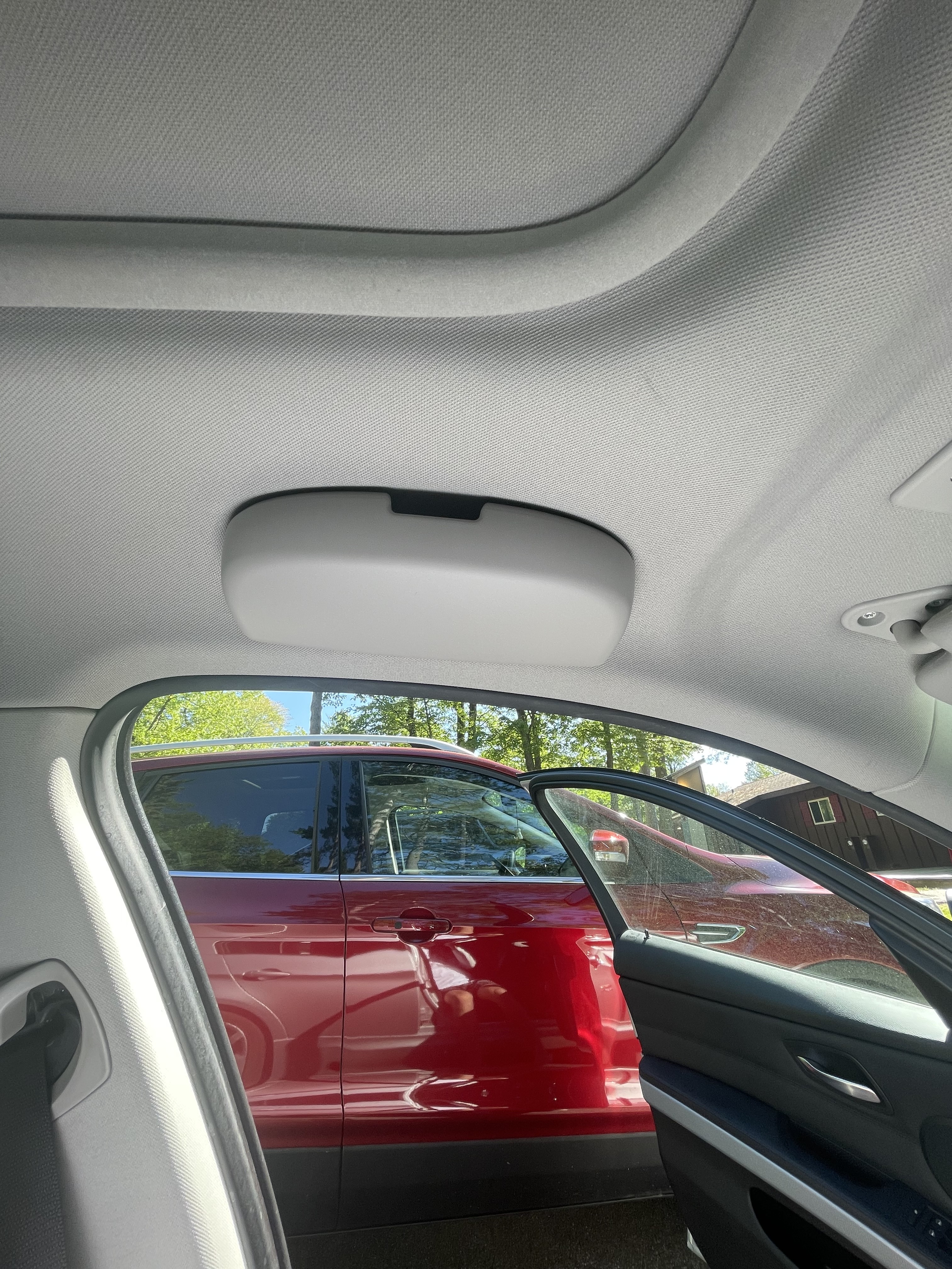

                            Did a the sunglasses holder mod before I headed up.

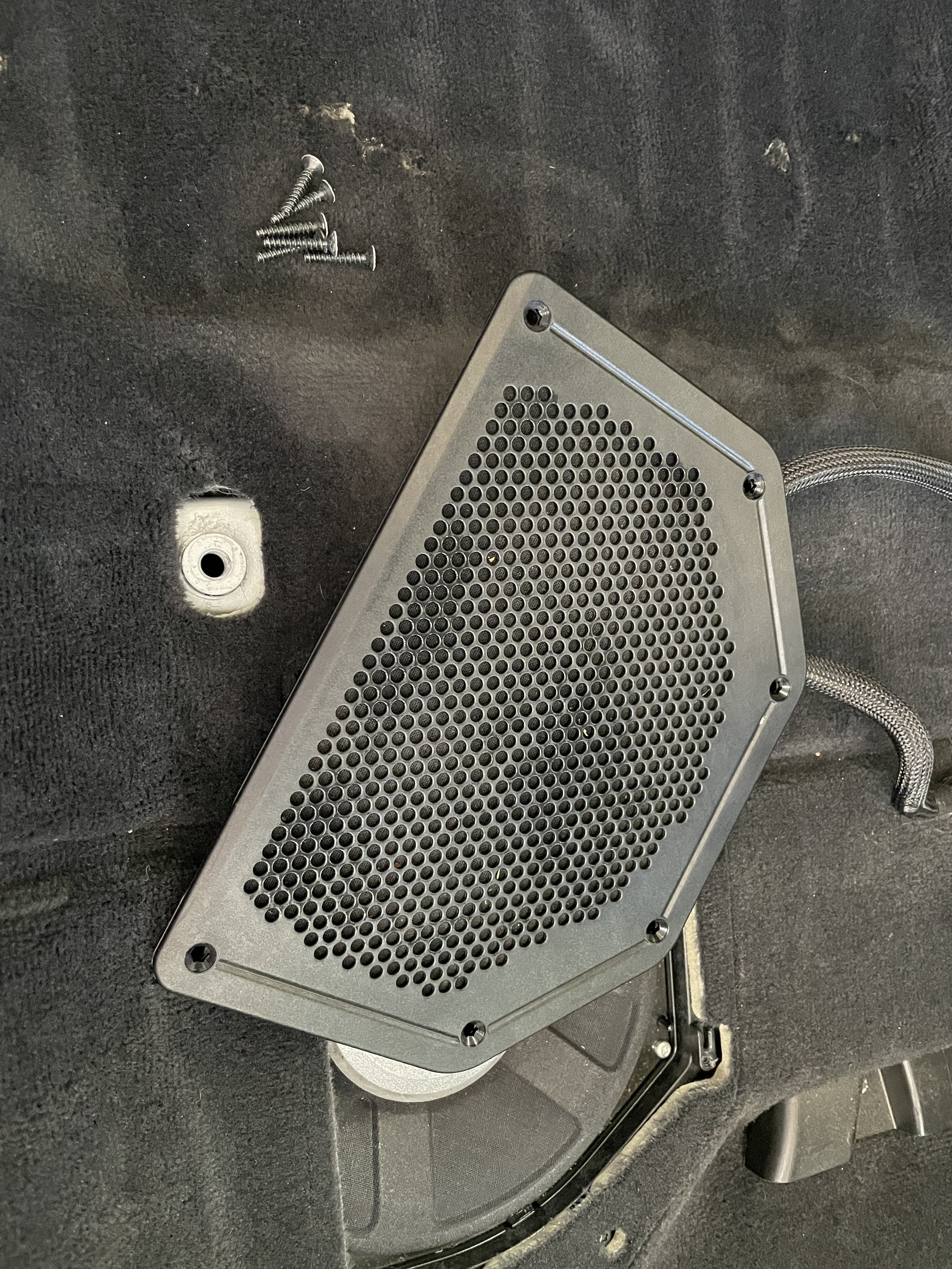

                            My cup holder was making some rattling noise(cup holder E90 problems? never). Turns out there is a guide pin on the back of cup holder assembly that goes into a socket behind the dashboard. I’ve seen that it can rattle because this pin is smaller that the receiving socket, turns out my pin is just broken off.
                            I might try the one that is sold on Amazon for the $30 bucks or however much they are.

                                  DId you buy the OEM sunglasses holder or one of the cheap aftermarket ones? I had the OEM one but a little tab broke in it after a few years and haven't decided if I should spend the money for OEM again or just try a cheap one. Definitely one of the best usability upgrades I did to my car (before I broke it).
                                    I bought one of the cheap aftermarket ones on Amazon. Matches the existing trim great and has a nice felt inside.
