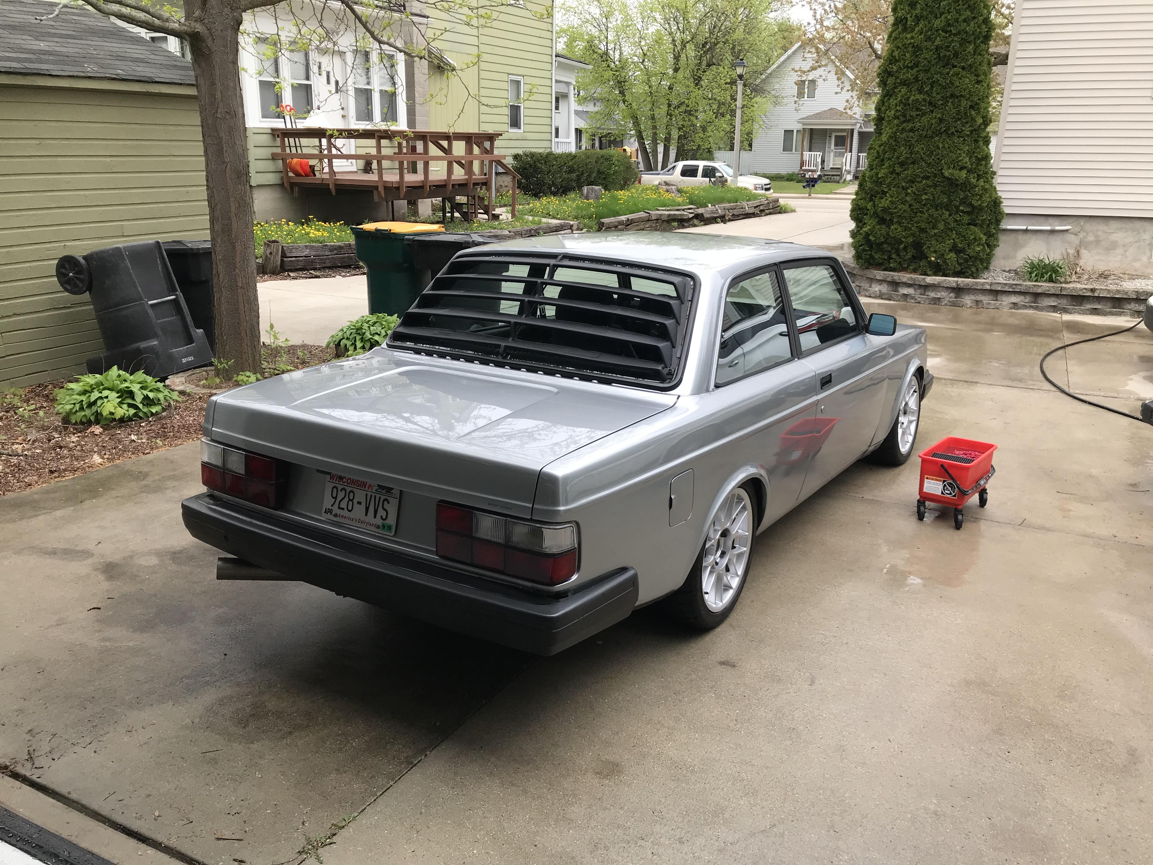

                    Just for the record, I did end up showing up to the e30 picnic in this... for about 10 minutes at 2:15. No photo evidence aside from washing it in my driveway that morning.
                      #250
                      Certified
                        #251
                        I hearby stand as a witness to this testament
