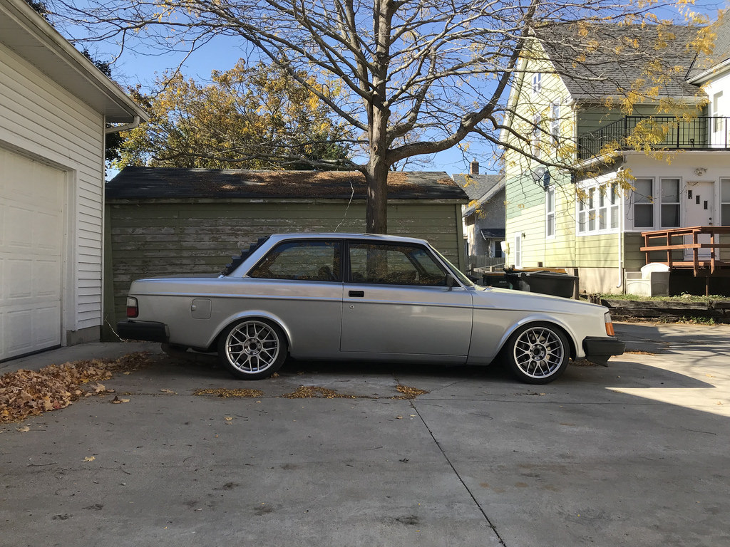

        bigger wheels means it's time to drop it down a bit more.
        Tom - I have a few BMWs, an overworked Volvo 242, and now a YouTube channel called Drive, Revive, Tinker
          #85
          Looking good Tom. A little lower will help it a lot. I've got that fender roller if you need to use it.

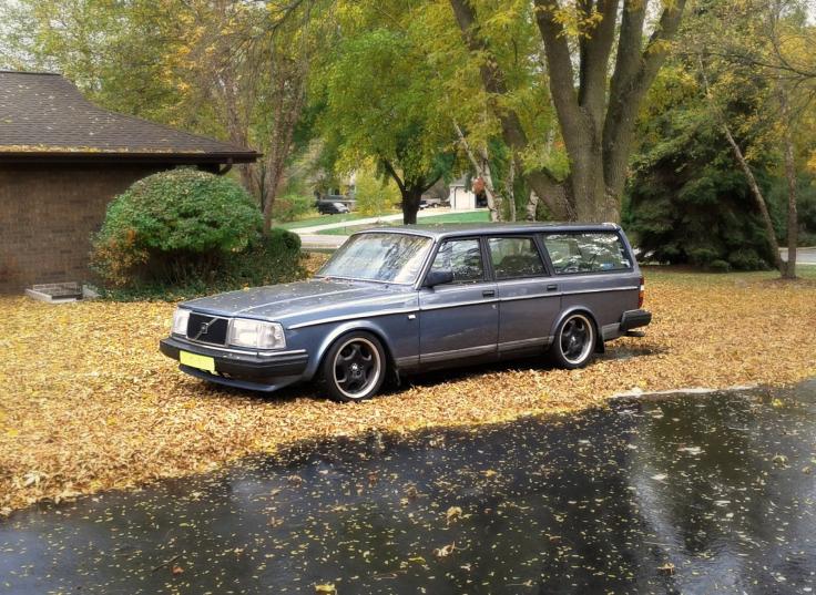

              well, the blue wagon is going away
              ...and being replaced by this:
                Wagon was cool, but I'm really digging that coupe!

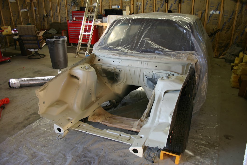

                                    Finally wrapped up the prep and sprayed the engine bay with Spray Max 2K epoxy primer. For an aerosol can, this stuff is pretty great.

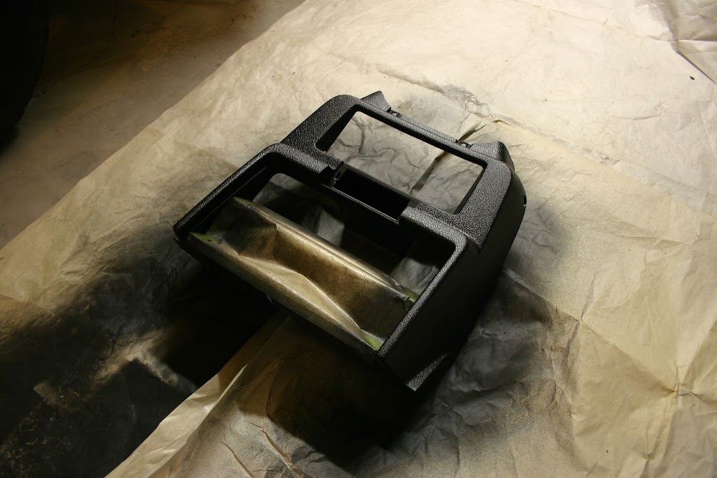

                                    I'll be using some of the blue interior trim from the wagon for this car, so I tried out Duplicolor interior paint. Seems to be pretty good.

                                      The engine bay is finally done, save for a little wax.

                                      Dash stuff. I repaired the dash cover; just need to refinish it now.

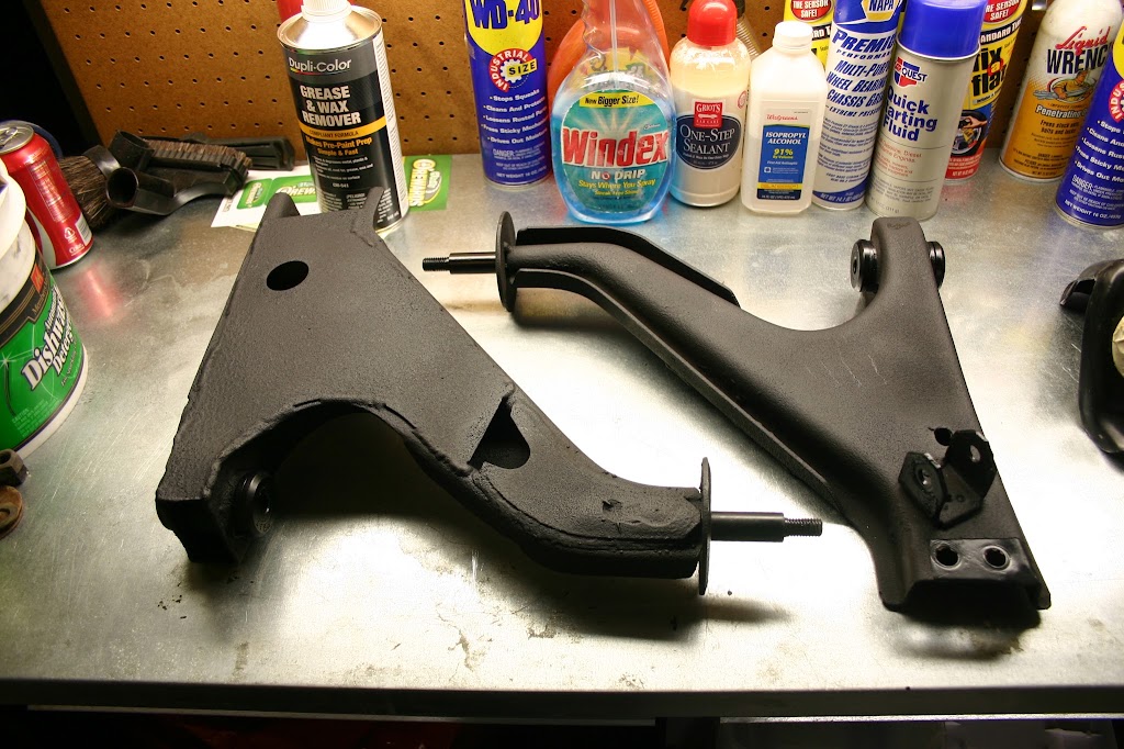

                                          Front control arms boxed, painted and undercoated.

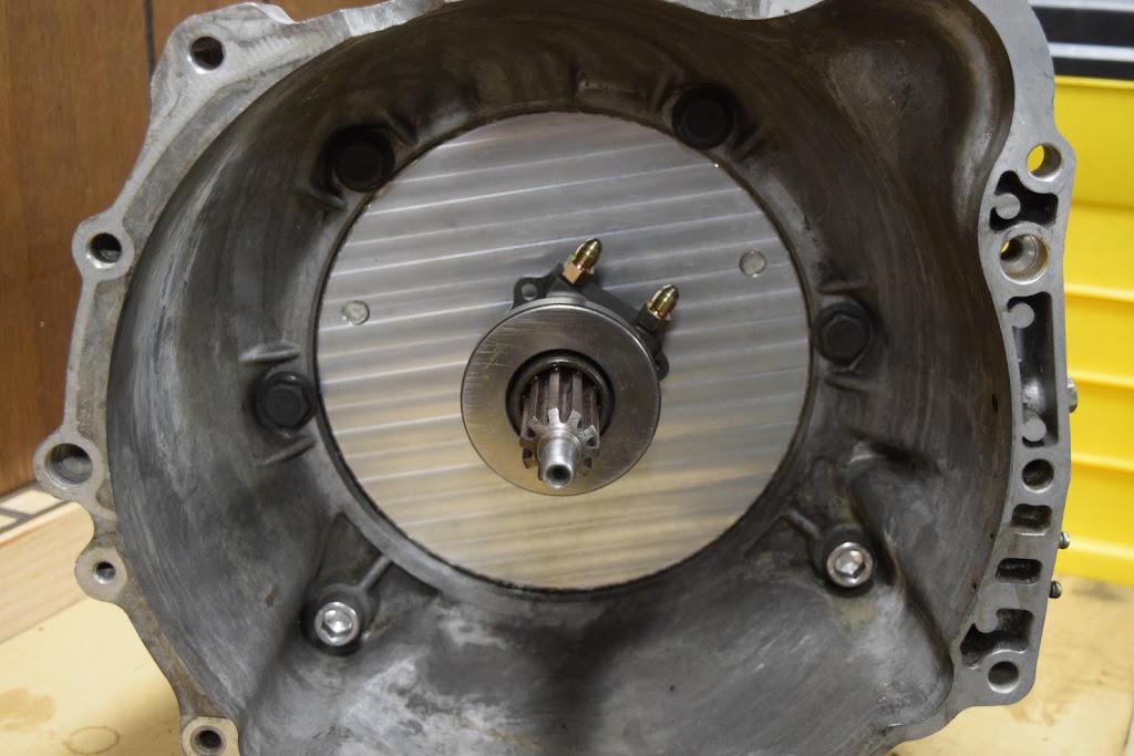

                                          Getrag 265 swap parts: Bellhousing adapter plate, centering ring, shifter cage and linkage to fit 240 shifter location, driveshaft support bearing relocation bracket.

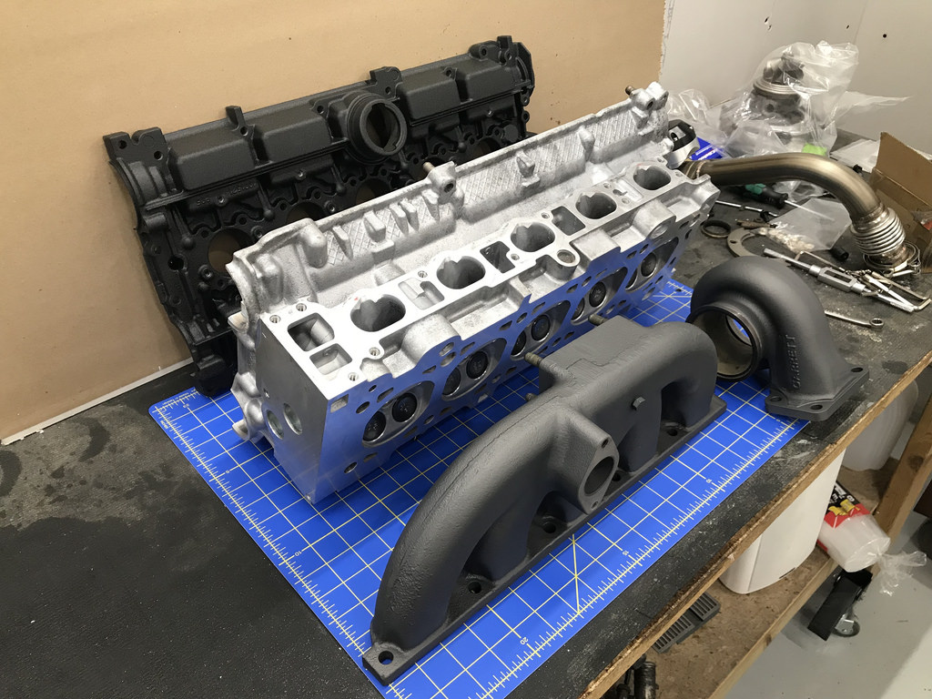

                                          Getting more things together. Meticulously prepped the exhaust manifold and turbine housing, then painted them with 'Stove-Brite' (Old man trick for good HIGH heat paint. Volvo guys use this on turbine housings and say it holds up remarkably well. One guy has been using it for 30 years...)
                                          Phenolic intake manifold spacers to help abate some amount of heat transfer when I'm asking for all that the little baby TD04HL-16T turbo is worth.
