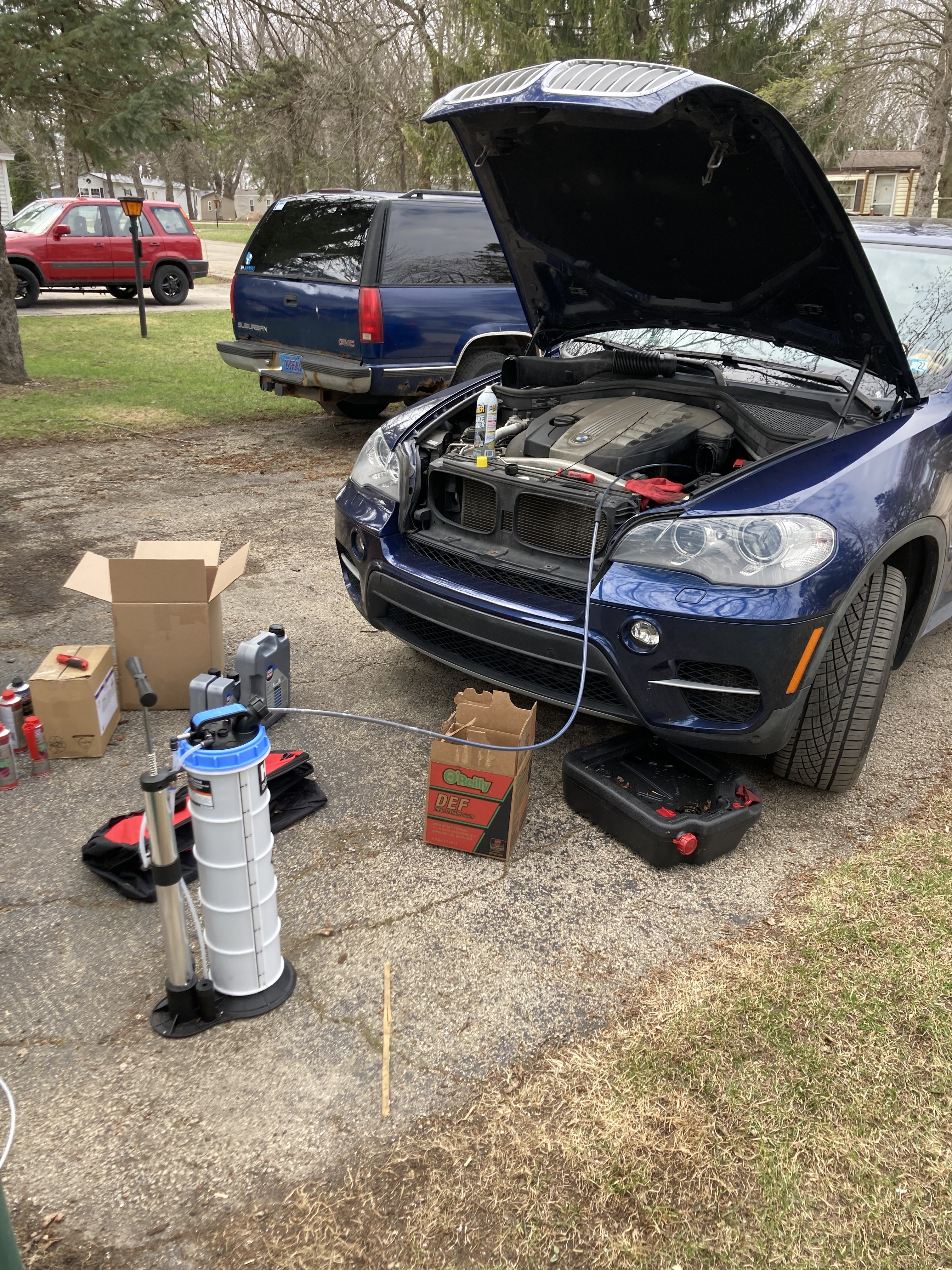

      I have to use one of those extractors to change the oil on my boat and I hate it. LOL
      In other news, I still want a diesel X5.
      Thread jack, but if you want the pro strat for boat oil changes, the next time you do it buy or make a drain hose kit. My parents inboard came with this setup from the factory and it’s slick as shit, and so easy. Just snake the tube out of the boat drain plug, put a drain pan underneath, and pop the cap off. Easiest oil change I’ve ever done.
      Example of a kit: https://www.wholesalemarine.com/sierra-18-7891-oil-drain-kit.html?gclid=EAIaIQobChMI_9PmkLjb9wIVBezjBx3cYQ45EAQYAiABEgKgXfD_BwE
        #27
        I have one of those. My big gripe is that it takes a good 20-25mins to suck all the oil out and you have to continuously pump it to keep it pressurized even if there are no air leaks.

          Personally I've always used Power Service in the burb and semi's because they have winter and summer versions. Additives work though, I've seen .5-1mpg decreases when I don't add it in, which is huge something that gets 7.5mpg on average lol. Anytime you're doing fuel filters too just use diesel additive instead of straight fuel, it'll prime the system much quicker.
          I don't plan on regularly towing with this so gonna stick to the 50k fluid changes. Did you do the Solenoids? Guessing I should order those too given the higher miles and assuming original lifetime fluid. I have the full service kit already from FCP and was gonna buy this aluminum bridge seal somebody on the FB group recommended. https://www.ebay.com/itm/273799403855
          Yeah it is annoying but I've spilt enough oil in the driveways and shop floors that this is still preferred. Don't you have an air compressor at the shop? Upgrading to a full pneumatic when I have shop air again is my plan.
            Yeah that makes way more sense. I didn't even think of that 😂

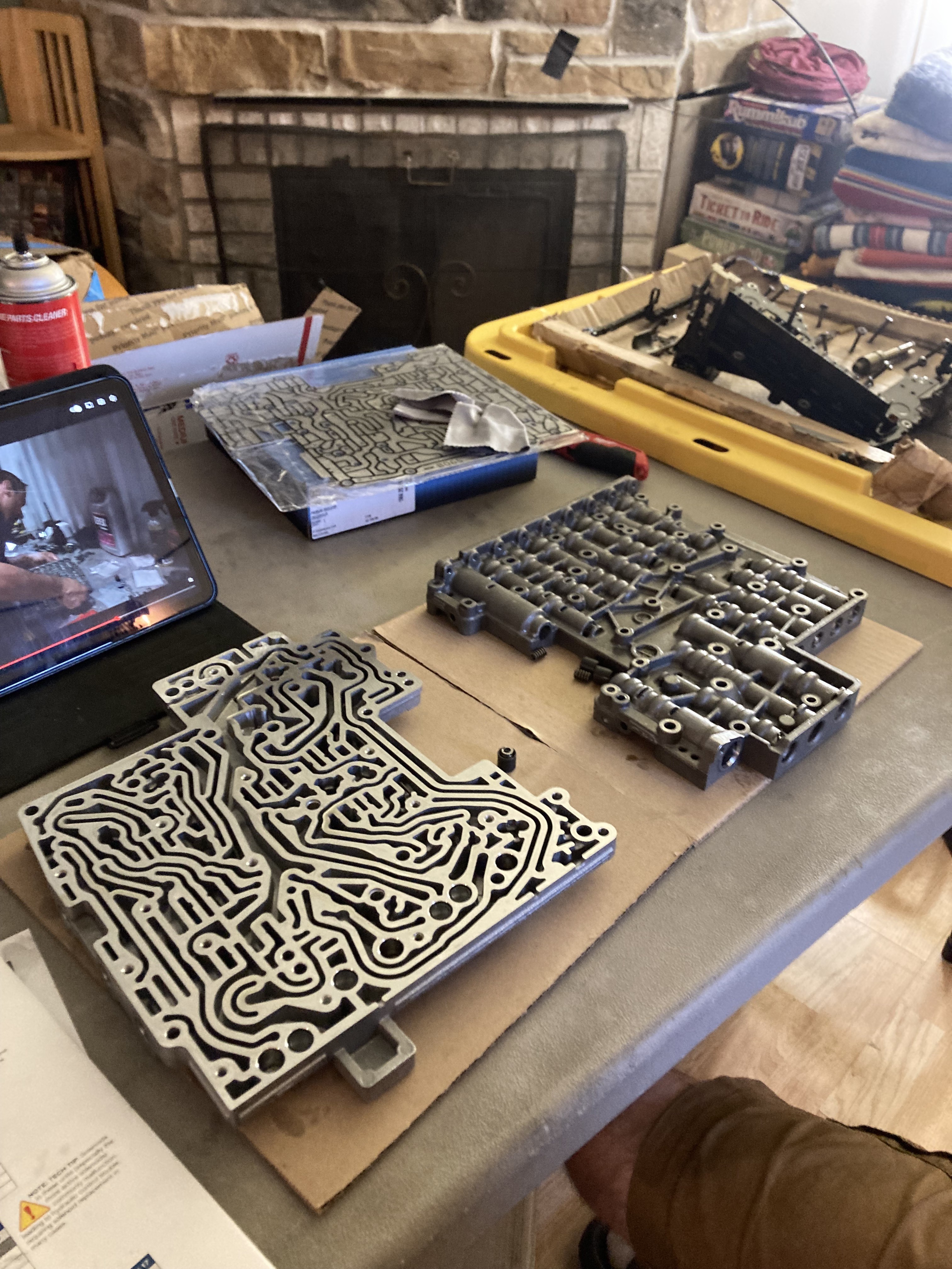

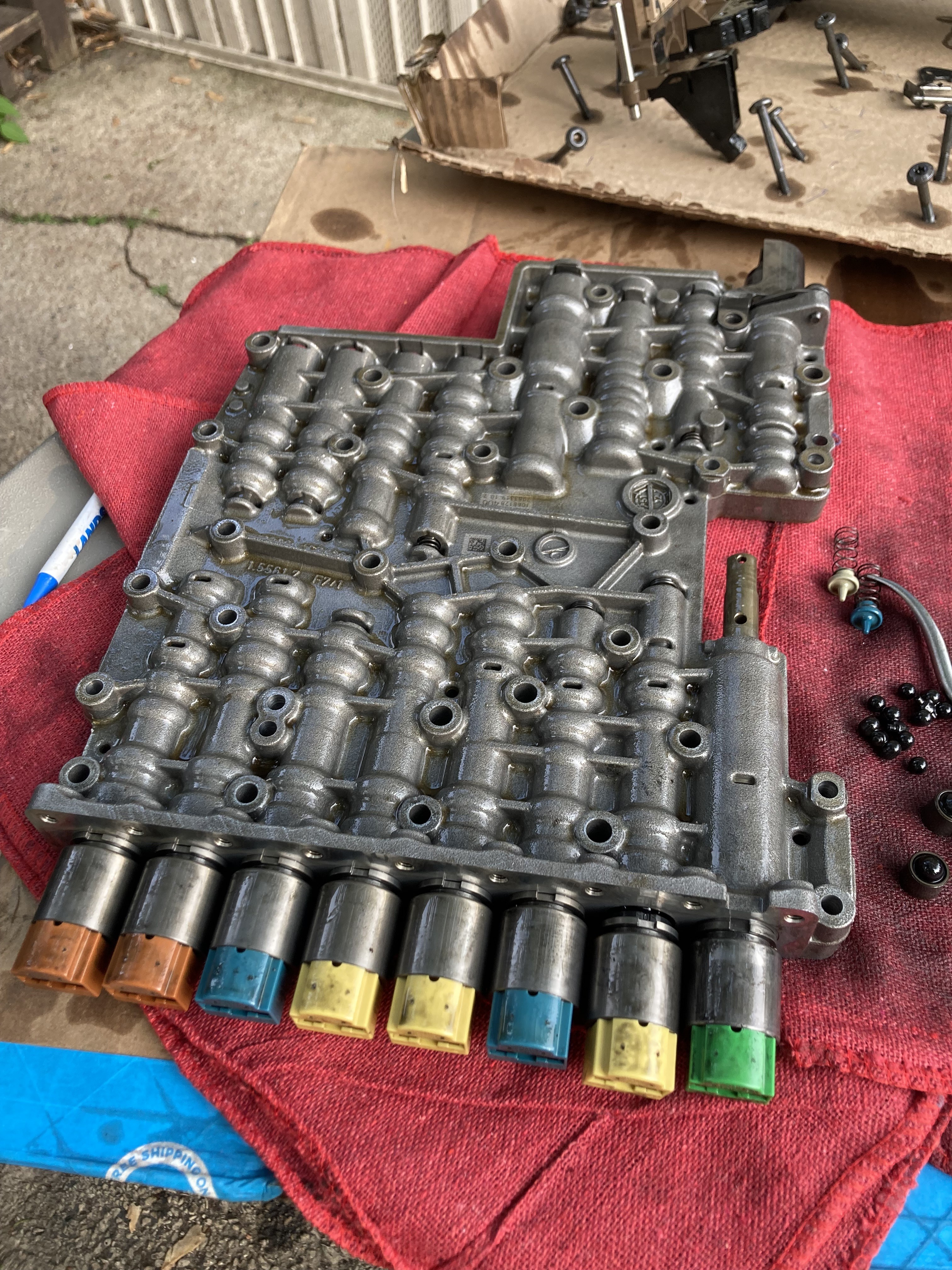

                      Crawled under the X5 for the first time to get the the main parts list off the transmission. Also installed the K&N VF3019 cabin air filters.
                      Below is a cross reference for the Tune My Euro E70 100k restoration/maintenance list to FCP OE or OEM parts for better prices/warranty. Certainly needed at 150k now and many are while you're in there with the intake manifold off and added power from the tune.
                      • FCP EURO
                        • M57 Sleeve kit for 6HP transmission
                          • 31.4mm Automatic Transmission Valve Body Sealing Sleeve ZFS-0734317371
                          • 40.7mm Automatic Transmission Valve Body Sealing Sleeve - ZF 24107520715
                          • 25.9mm Mechatronic Sealing Sleeve ZFS-0734317370 x2
                          • Mechatronics Sealing Sleeve ZFS-0501216272
                          • Automatic Transmission Adapter Plug ZFS-0501215718
                        • GA6HP26Z Automatic Transmission Service Kit - 24117571227KT3
                        • Mechatronic Solenoid Kit (6HP21 6HP28) - ZF 1068298047
                          • My parts list 1068-050-045 is not listed on FCP's product page but these pages have more complete references.

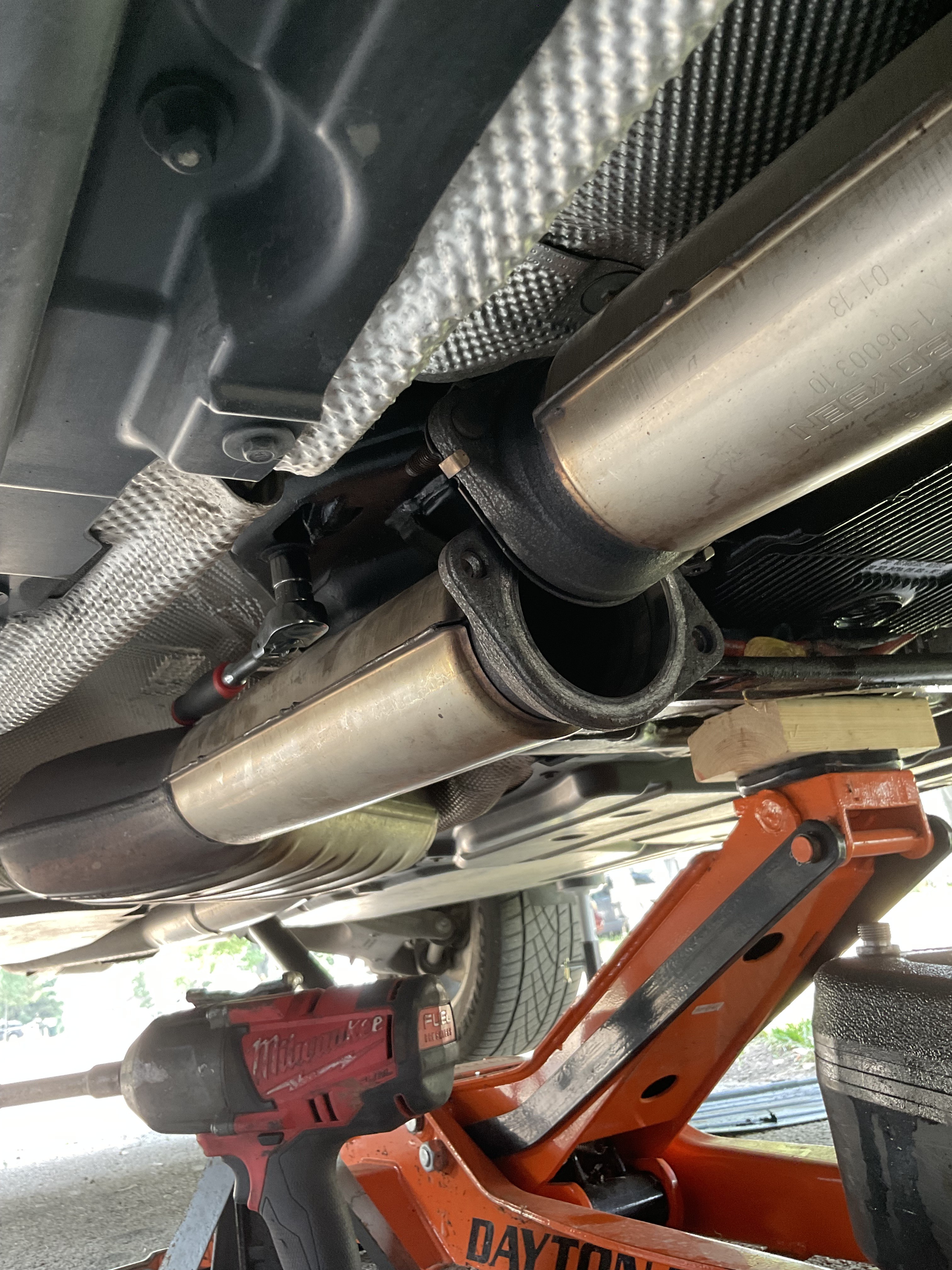

                              I did the delete on mine recently and am very pleased with how it turned out.
                              I would like to note that I would rather do rod bearings on the M3 again before doing another X5d delete... It was a lot of patience and odd body positioning.
                              I went with the VSRF down / midpipe and the fit-up was pretty decent. I saw you had the buzzken one in there which is over twice the cost.
                                #39

                                Did you get the cat? What else did you need for install? I'd assume I'd just need these EGR block off's additionally. Forgot the VRSF has a resonator as well which I'd like, are you happy with the sound?
                                https://www.tunemyeuro.com/bmw-x5-e70-low-pressure-egr-block-off-plate/
                                https://www.tunemyeuro.com/bmw-e70-x5-lp-egr-coolant-block-off-kit/
                                  #40
                                  I did not get the cat, but doing it again I may. It's not bad but I like cruising with the windows open and spend time crawling around so I feel the smell may become a tad much. I may end up trying to get a catted one.
                                  Sound is pleasant, lots of turbo noise and a tiny bit of engine with the windows open. With windows closed I can't tell a difference from stock which is nice.
                                  I did the EGR racepipe at the same time (Bimmertune) and that came with the coolant blockoffs for that, and picked up the plate you linked above from a different source.
                                  The turbo noises and power gains are very fun.

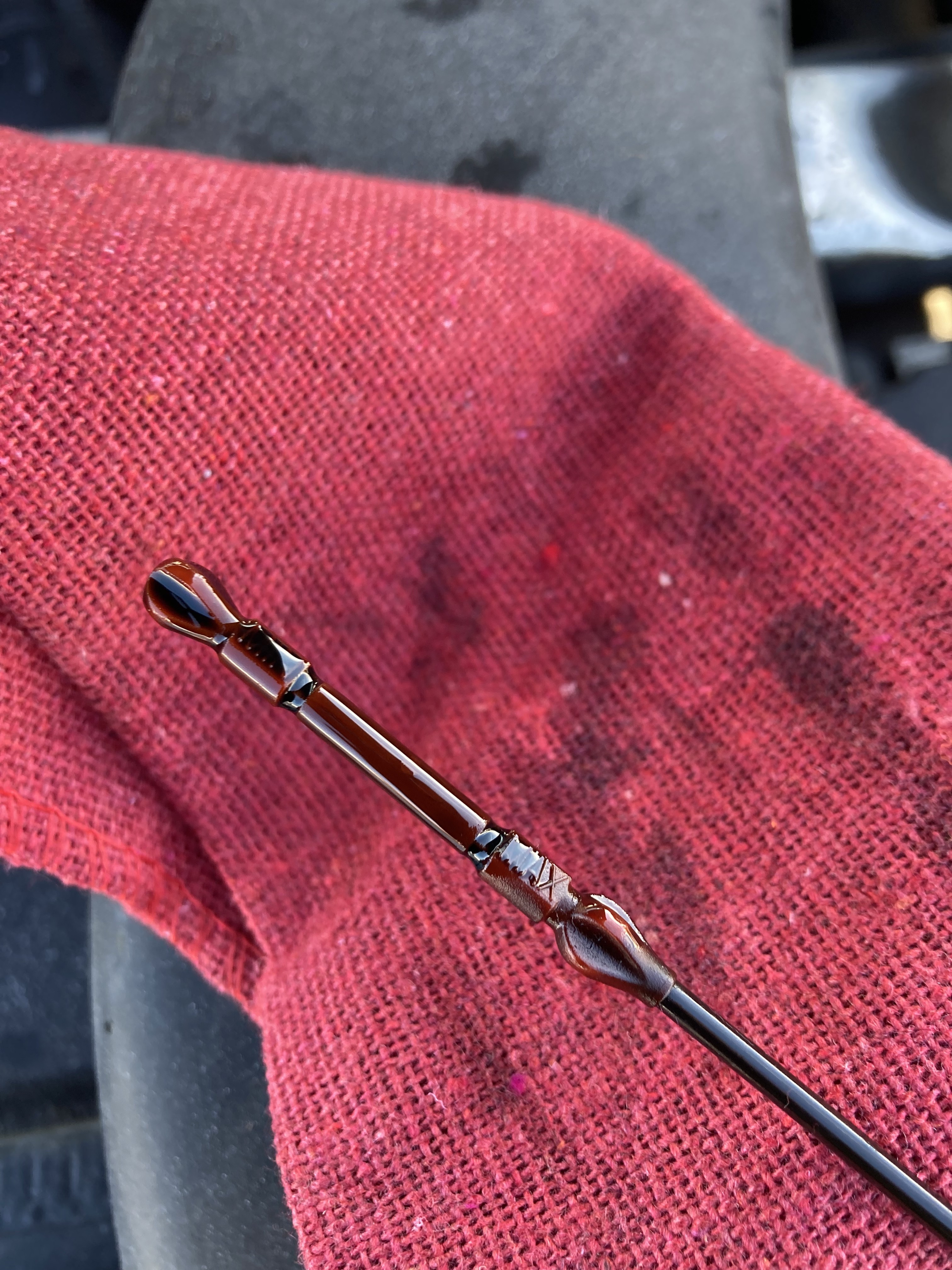

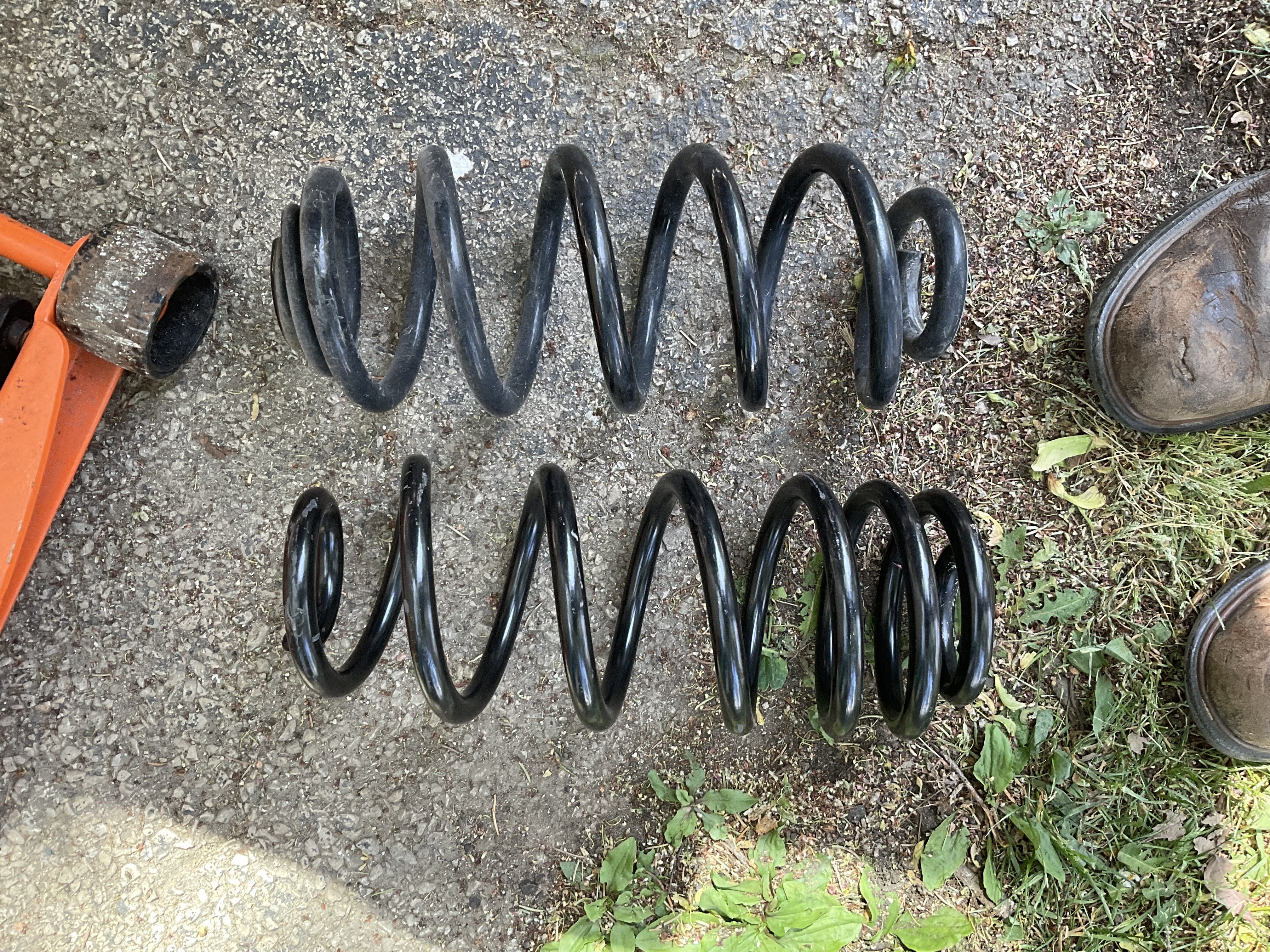

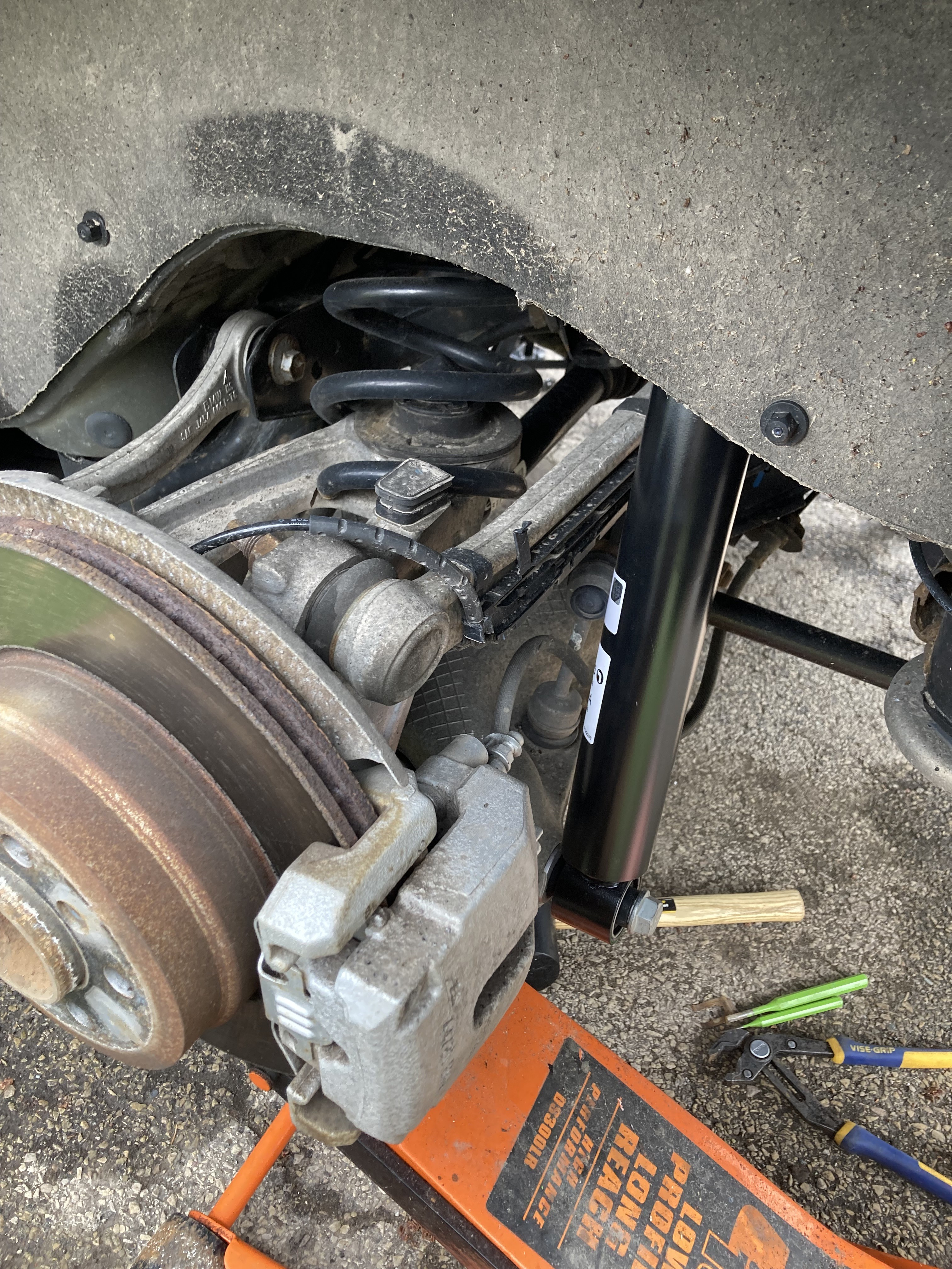

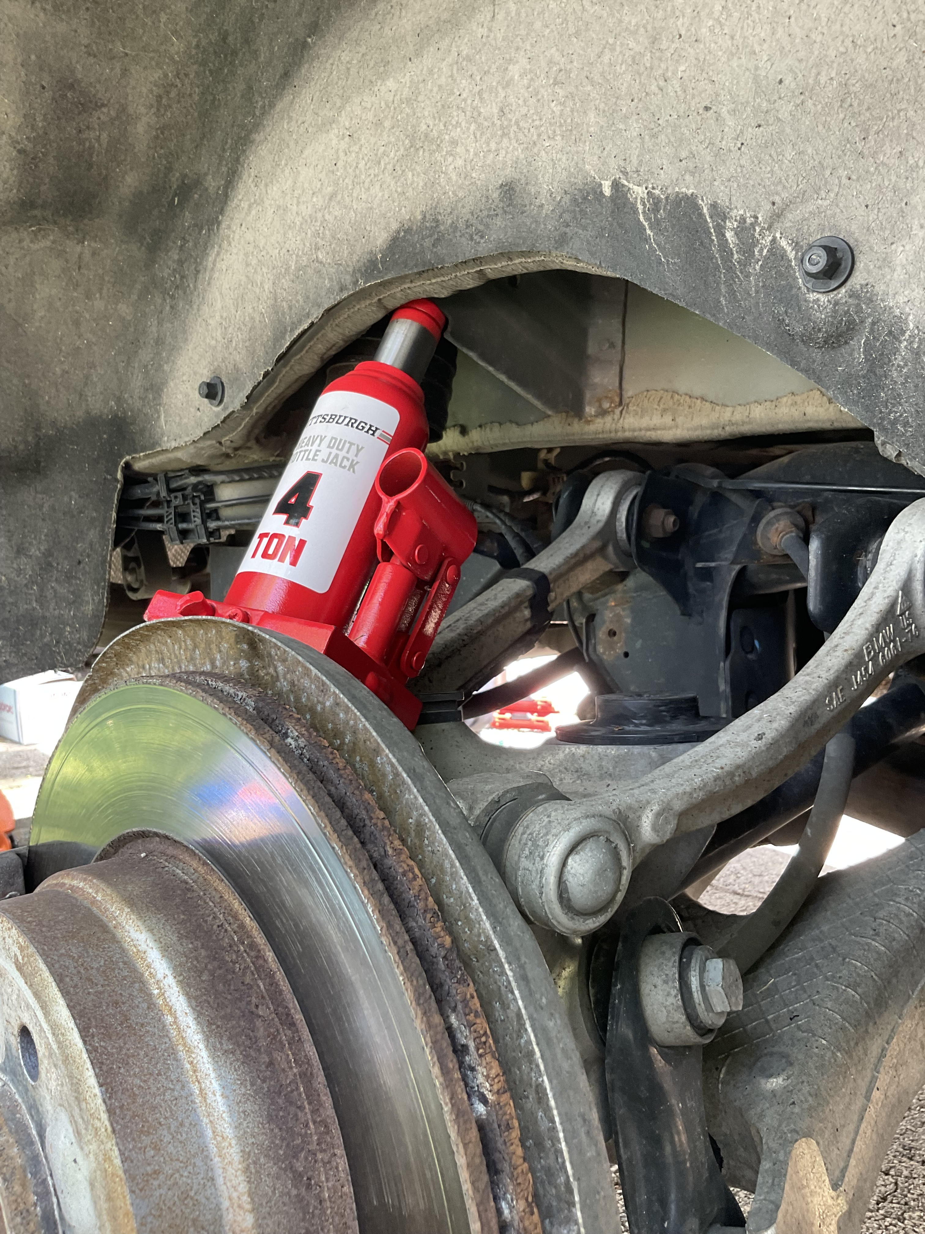

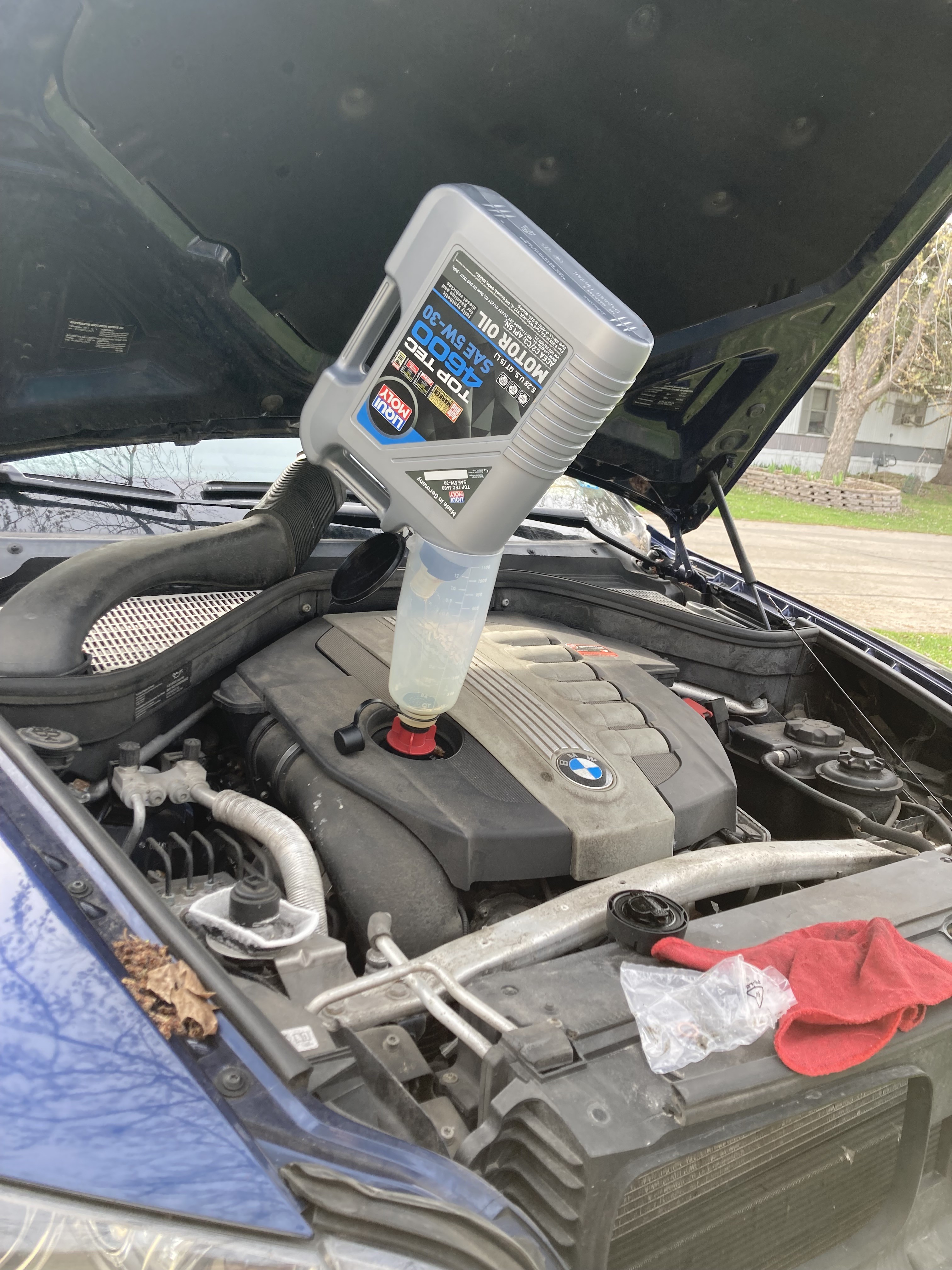

                                        157045 Miles Checked a few things off the punch list. Changed the oil with the handy screw in oil funnel kit when it was on sale. Also installed a mishimoto magnetic drain plug. https://www.harborfreight.com/master-oil-funnel-filling-kit-56892.html

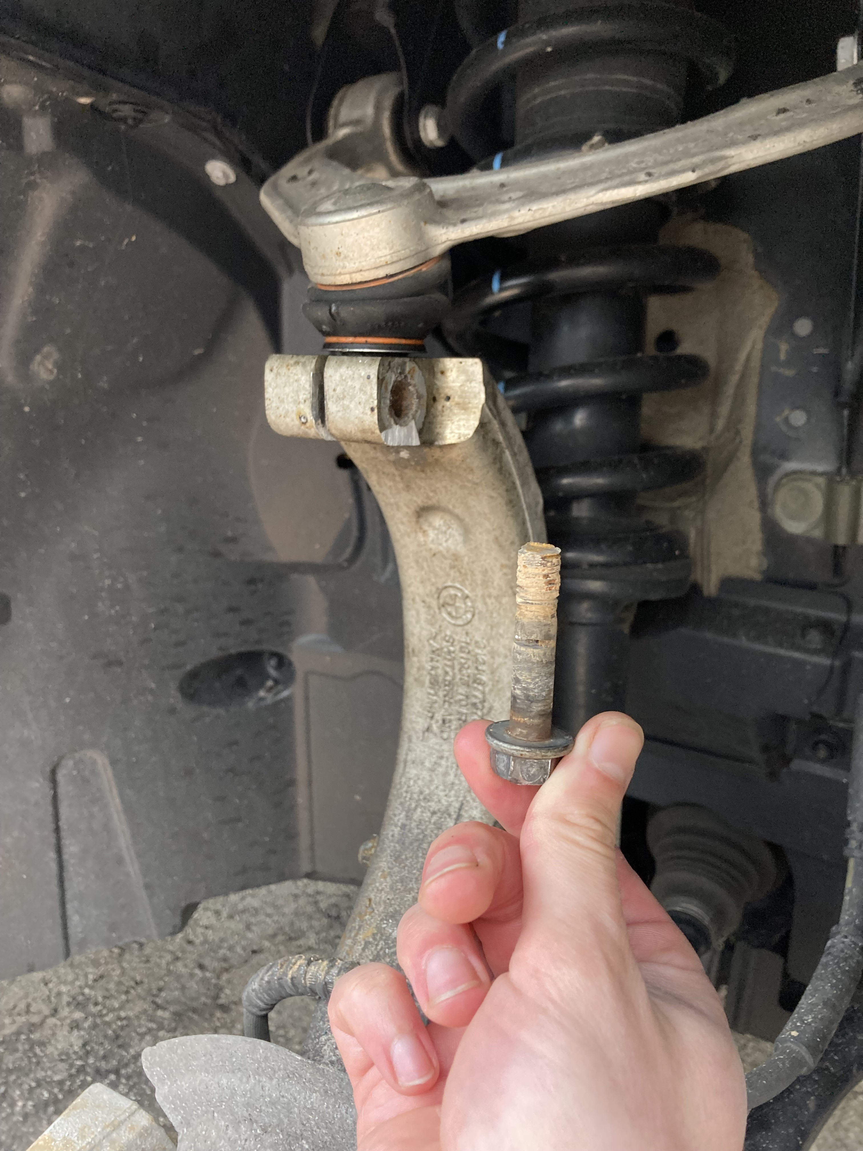

                                        Attempted to start the front shocks, ball joint bolt had different plans. Very seized and had to cut/punch out. Replaced with a 10.9 bolt and haven't gone back to that project yet.
                                        Discovered during the rear shocks replacement that the drivers rear spring had broke and wrapped itself around under the mount. Didn't notice any noise or handling issues so this was quite the surprise but apparently a common issue by 150k.
                                        OEM spring compressor is short but extremely expensive. Not enough room to use standard ones so just ended up using a small bottle jack and got plenty of room to pull them out. Make sure the brake line is removed from the shock mount location.
                                        Replaced both sides with LESJÖFORS 4208476 from Rock Auto as they were $20 cheaper each than FCP and didn't care about warranty. Top is the unbroken stock, LESJÖFOR below. Little thicker than the OEM. Replaced rear upper and lower spring pads as well.

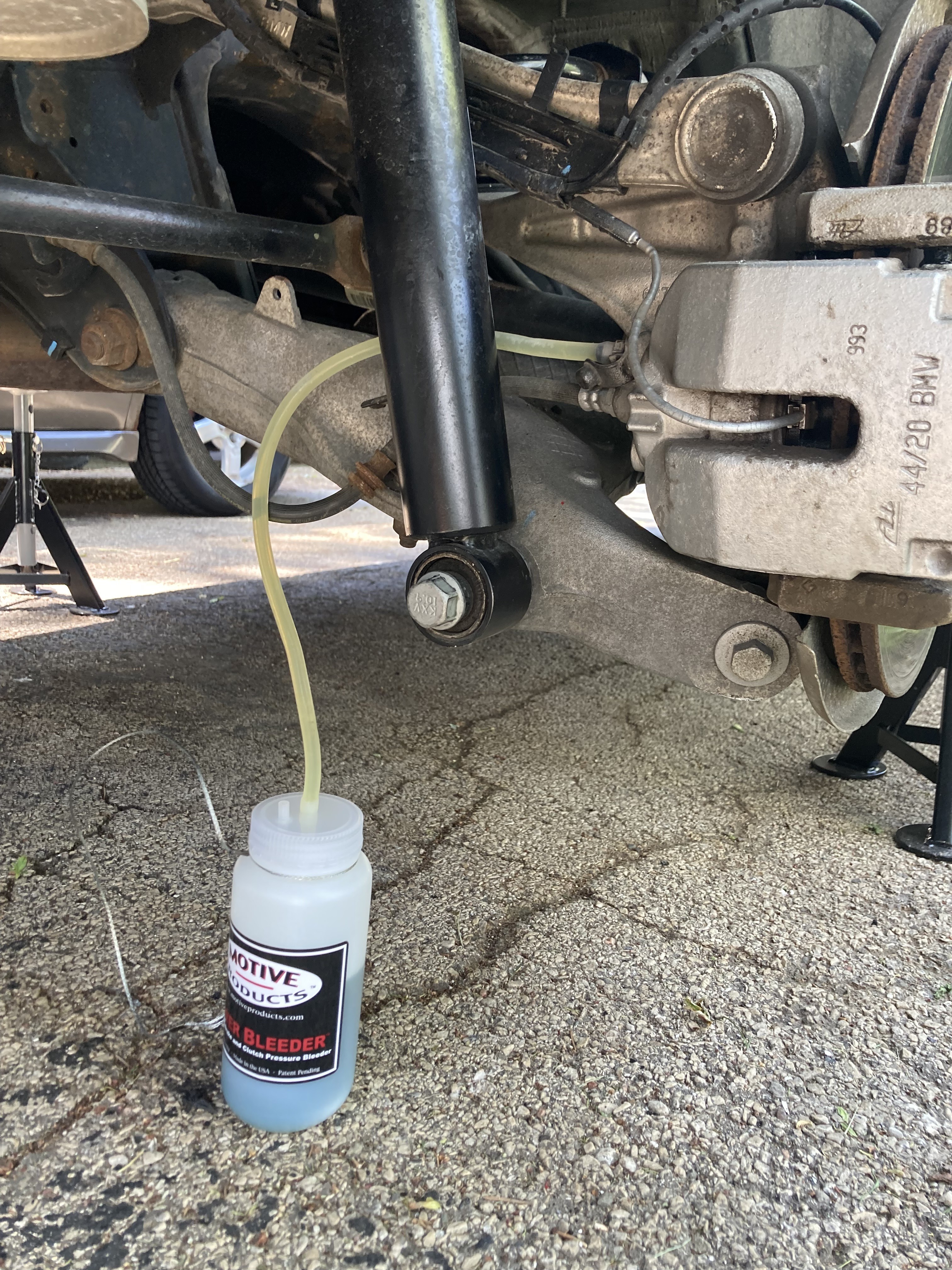

                                        Finally pony up'd the $25 for the Motive bleeder bottles and was happy to toss away my gheto gatorade setup. The seal on my Motive 1100 power bleeder cap had swollen as well, FCP and Amazon don't offer the replacement. I ended up trimming a 3/8 x 2 1/4 with 1/8 center rubber washer from Menards down to 1 3/4 diameter tracing a hole saw bit. Brakes bleed with Pentosin DOT4-LV
                                        Got all the other parts on hand, just need to purchase the tune yet and then I can dig into the major refresh items.
                                          #44
                                          How has the power bleeder been to use? Been considering grabbing one.
