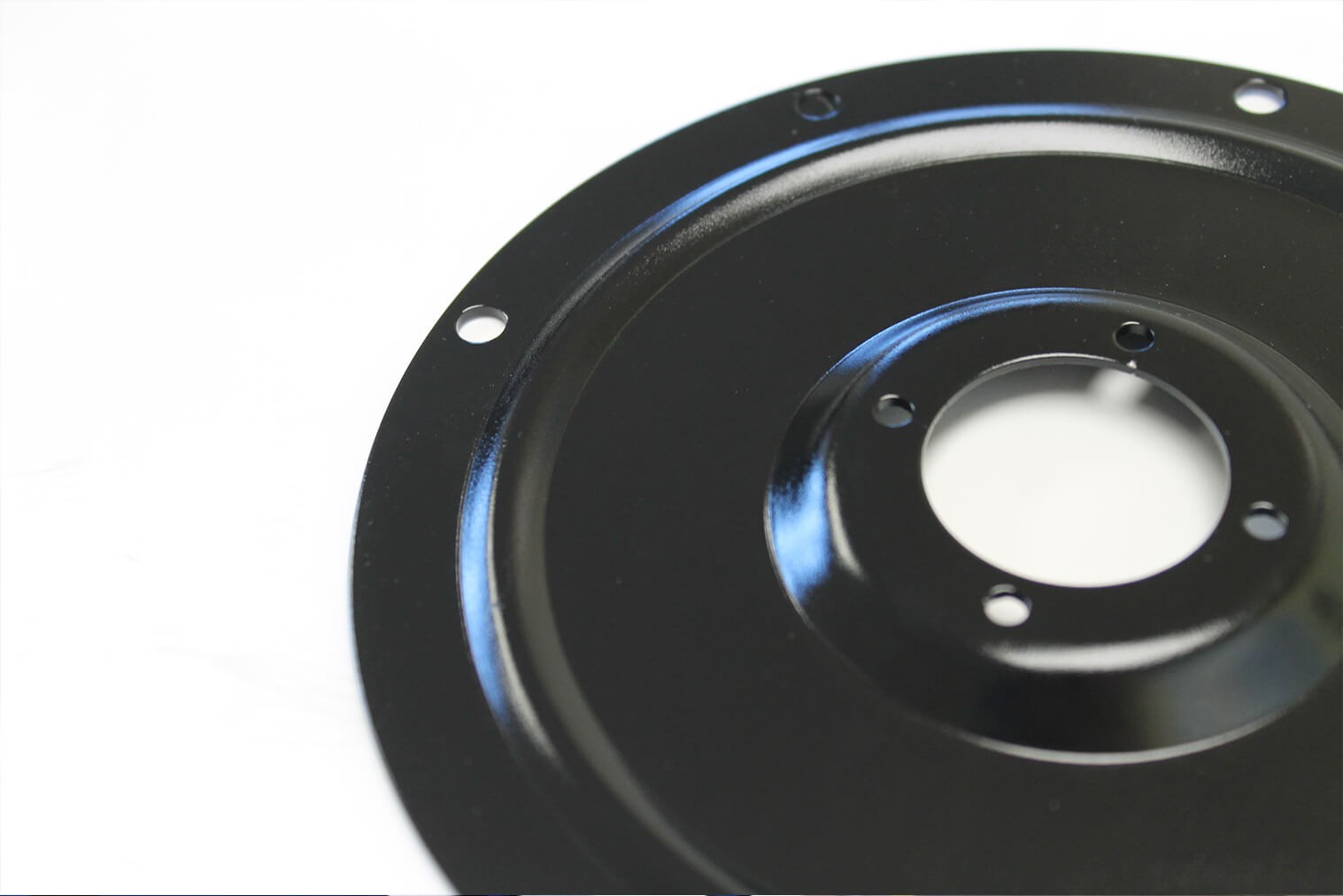

      I would recommend E-coat.
      PPG E-Coat Powercron 6000CX is a semi-gloss black electrostatic liquid coating. Think powdercoating, but liquid instead of powder. The benefit of e-coat over powdercoat is it is very good for tight tolerance/holes/features where you dont want coating buildup/uneven thickness. Its a commonly used automotive coating.
      The downside is it is less UV stable than powder.
      Try Swiss-tek or Hartford Finishing
