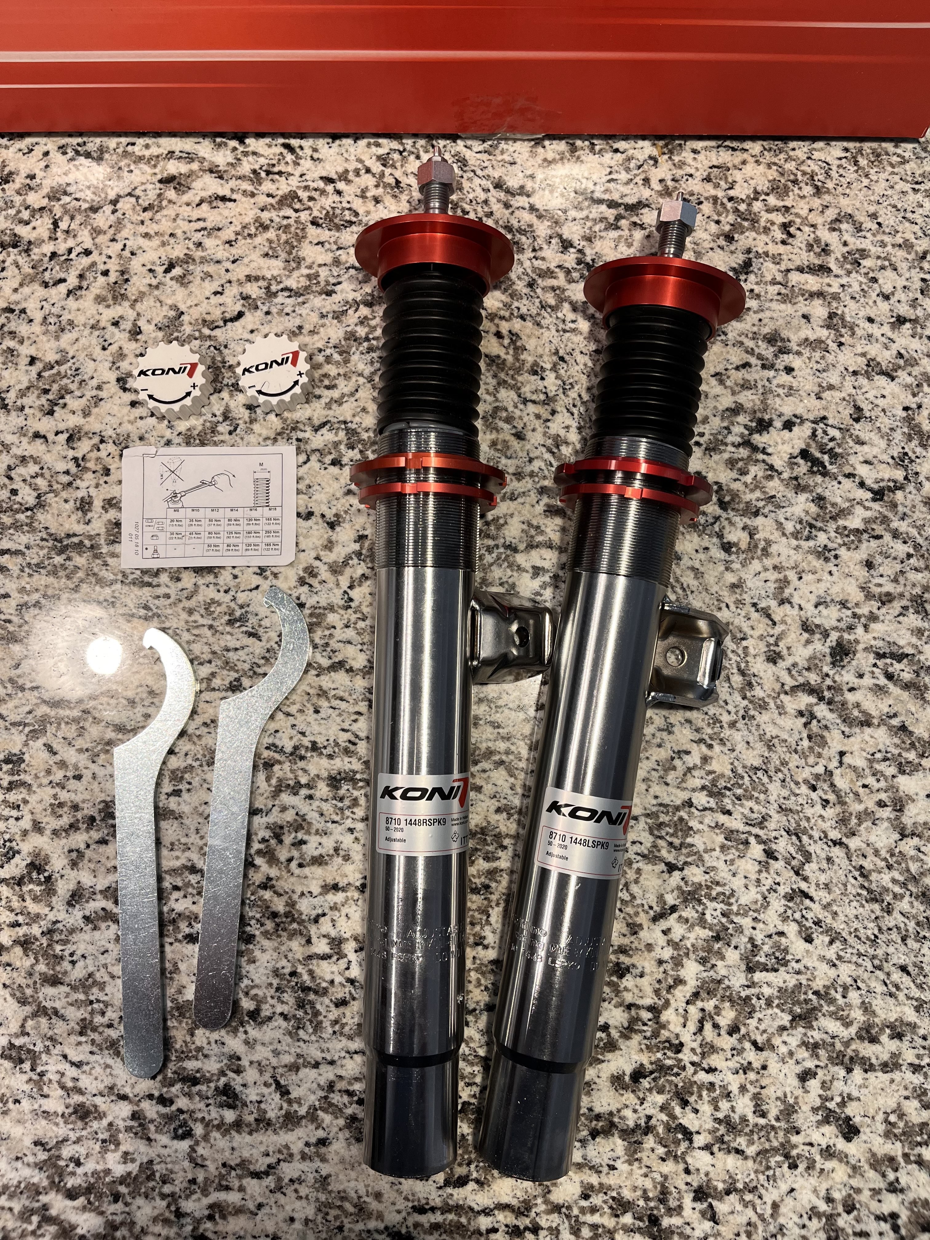

                              I ended up buying some TC Kline coilovers from a forum member on nam3forum. They were advertised as a 3000 mile set and they looked pretty solid in the sellers photos. Upon getting them I realized he might have forgotten a 0 or two on the mileage. The two fronts are blown and the rears have a pretty old build date. This set is nearly $3200 new, so I hoped I could save a few bucks buying used. NOPE no chance. Bought two new front replacements that are on their way from TCK. Going to rock the rears until they wear out, might have another season or two in them.
                              On the bright side, I did get Ground Control camber plates included. They were a bit dirty and beat up, so I did my best to clean and re-grease the bearings. Think they'll work just fine.

                                Will the replacement shocks need to be revalved for the spring rates? Or are they an off the shelf setup
                                • pynaclP
                                  pynaclP
                                  pynacl
                                  #76
                                  Yeah they are custom valved to the springs. I did give the spring rates to TCK when ordering, so hopefully the replacements are an exact match. Honestly not sure how to confirm or deny that though

                                    #77
                                    Got the new shocks from TCK already! Time to swap the GC camber plates on and get these installed. Still not sure if the factory end links will fit. If not, maybe that'll be an excuse to replace them and upgrade front sway bar too.
                                      #78
                                      pynacl said:
                                      Got the new shocks from TCK already! Time to swap the GC camber plates on and get these installed. Still not sure if the factory end links will fit. If not, maybe that'll be an excuse to replace them and upgrade front sway bars too.
                                      I'd suggest going with a shortened or adjustable sway bar link.  The stock ones are made for the stock height.  You're going to change the pre-load on the sway bar and could impact your handling if you stick with the stock sway bar links and lowered height.
                                        #79
                                        https://groundcontrolstore.com/collections/e46-m3-sway-bars/products/bmw-front-sway-bar-end-link-adjustable-pair
                                          #80
                                          Just know that heim joint sway links can be noisy. So if that doesn't bother you, go for it! I have them on my Z3 Coupe and will be switching them out for some adjustable ball joint style sway links to quiet things down. Just an FYI
