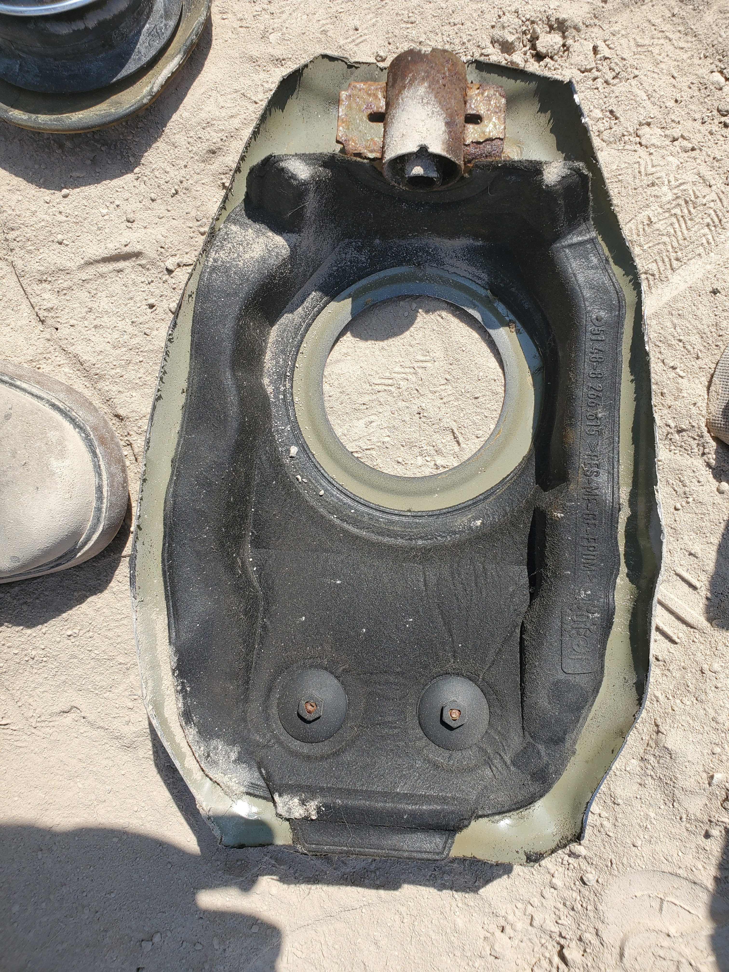

    #68

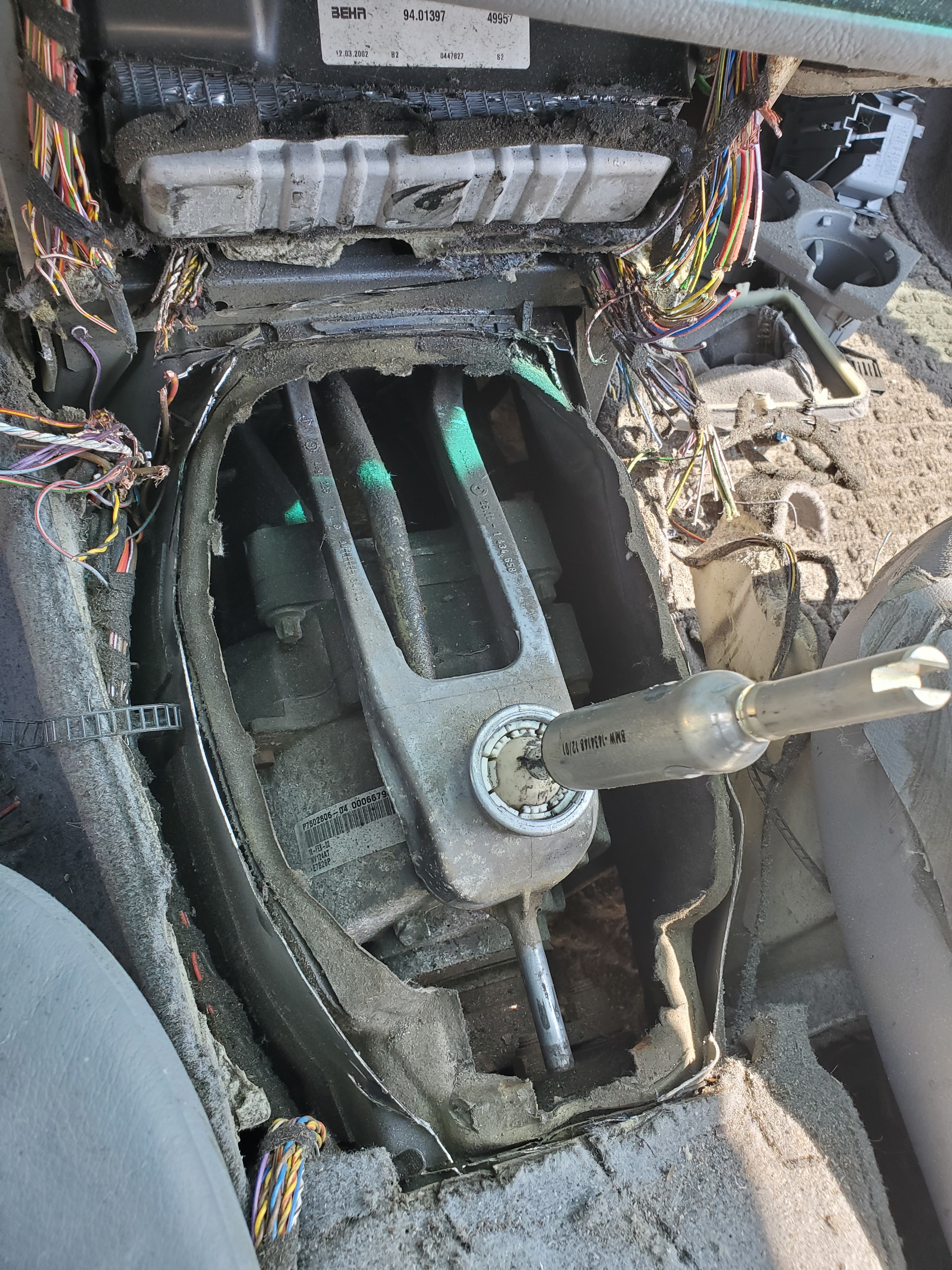

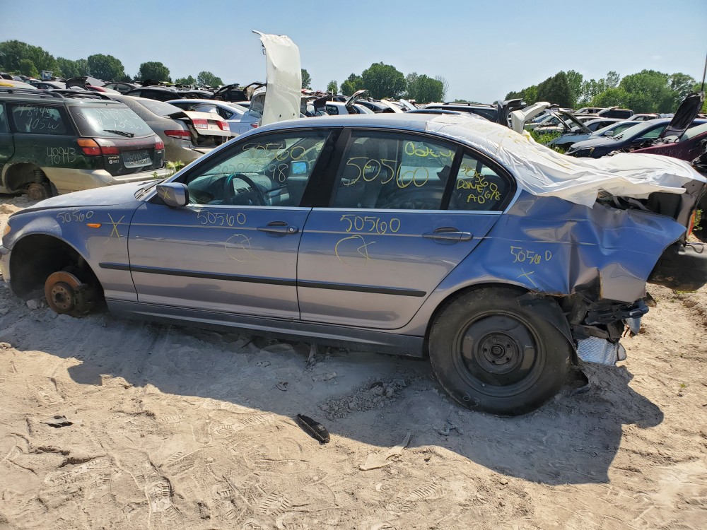

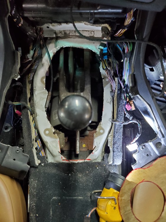

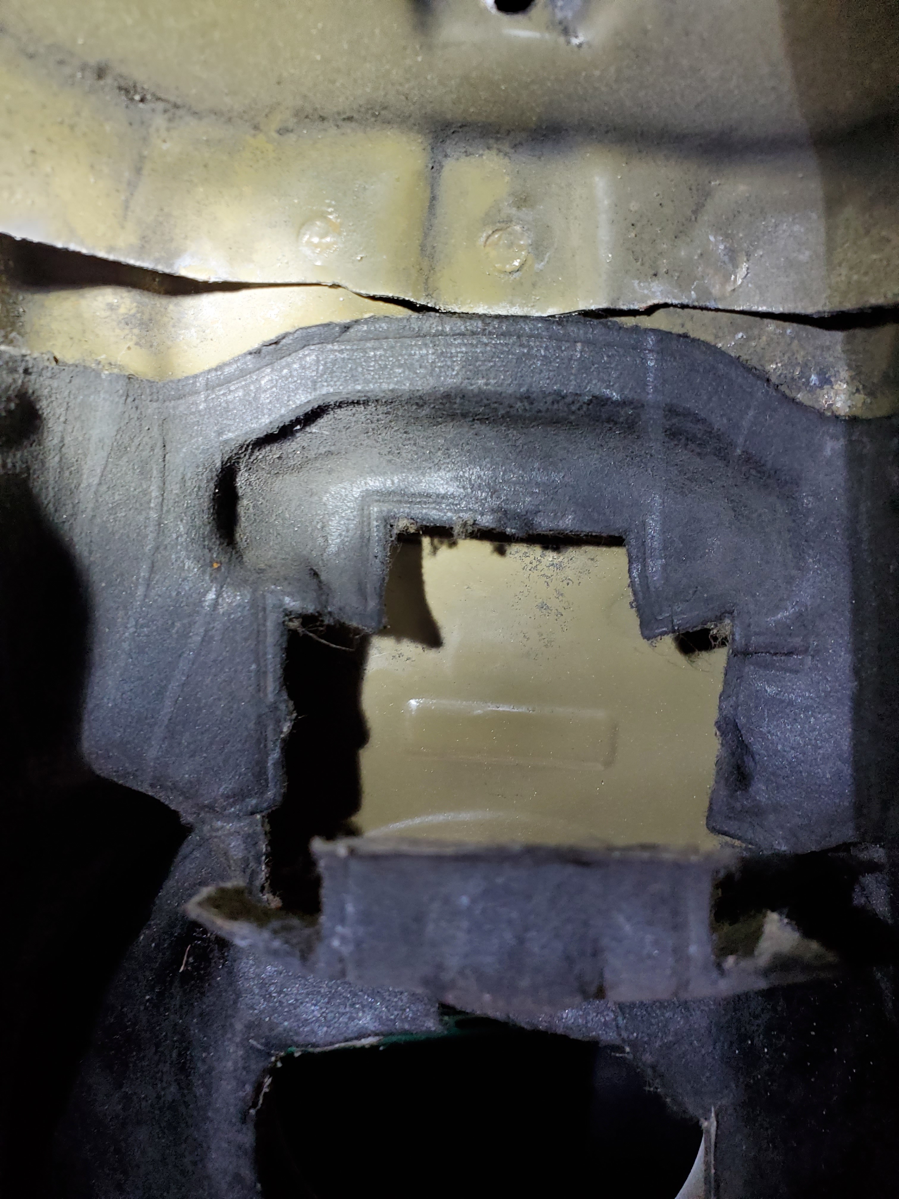

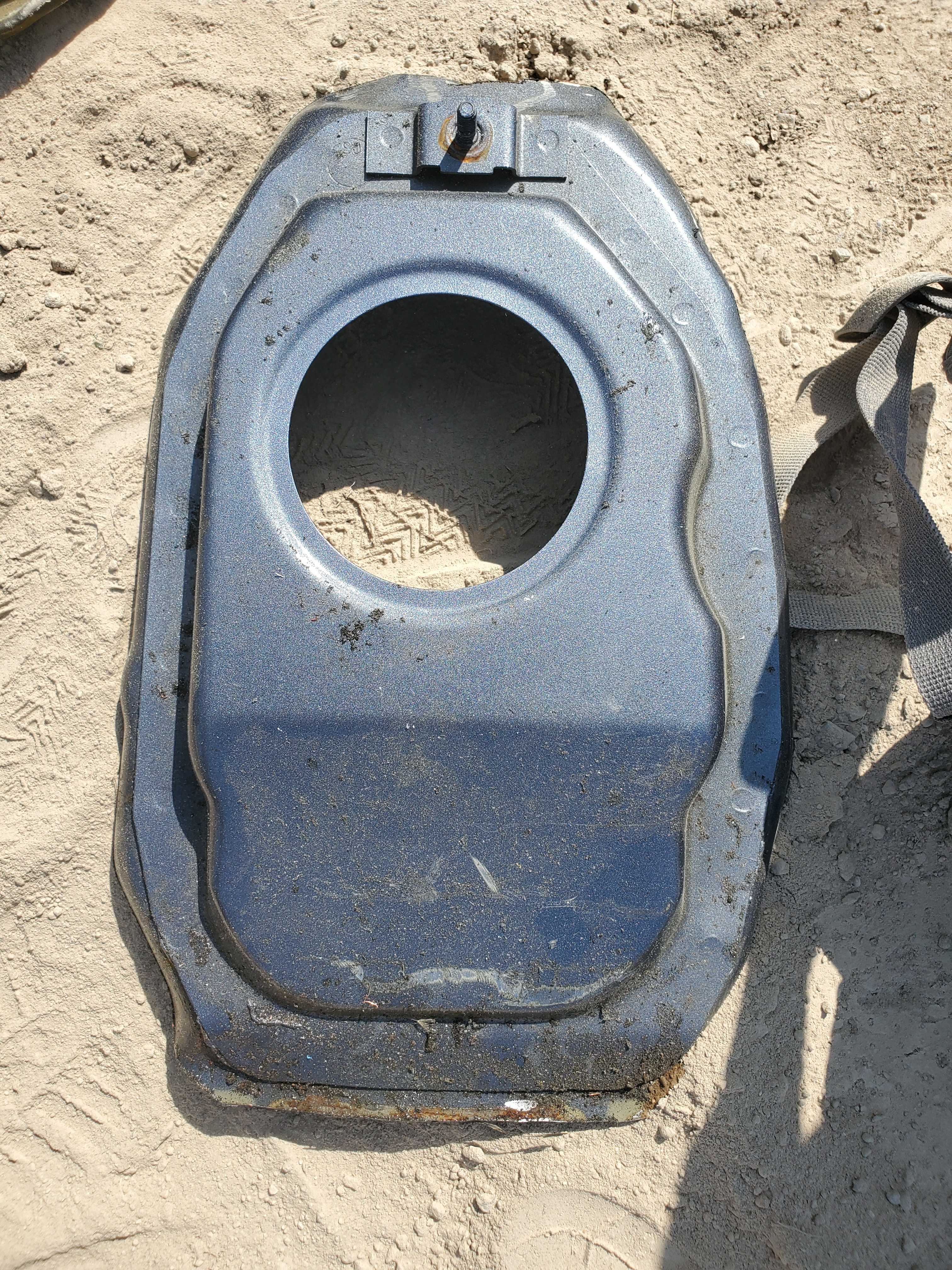

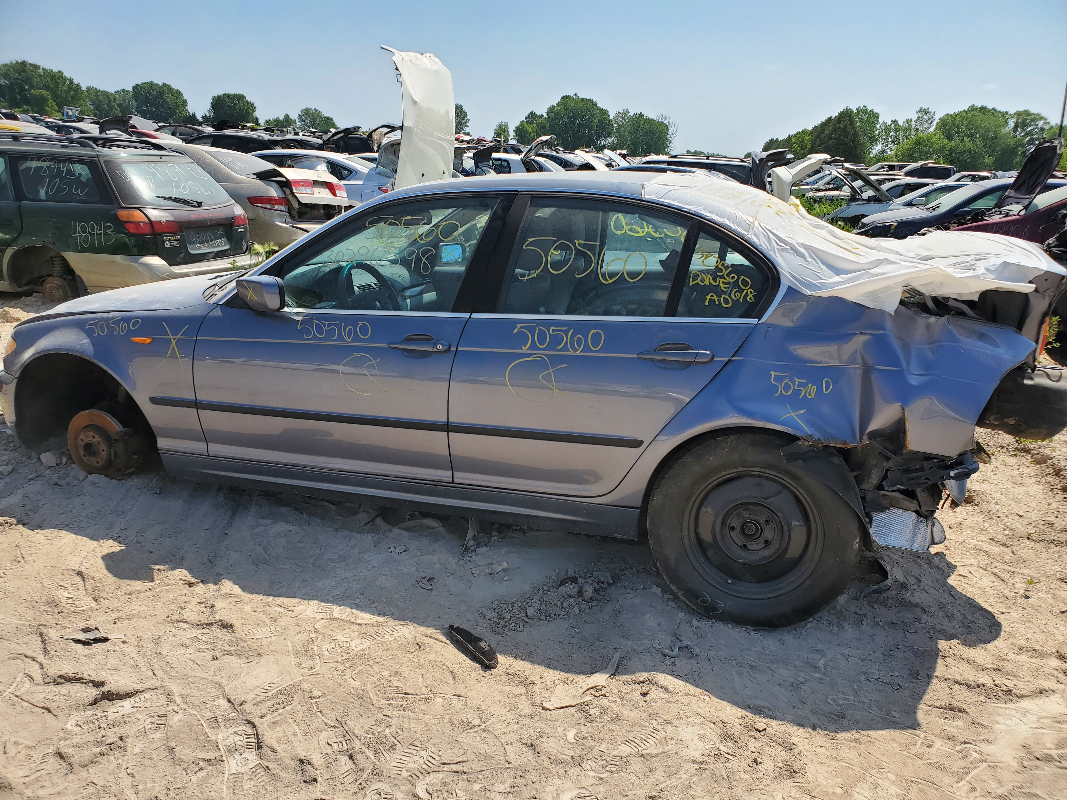

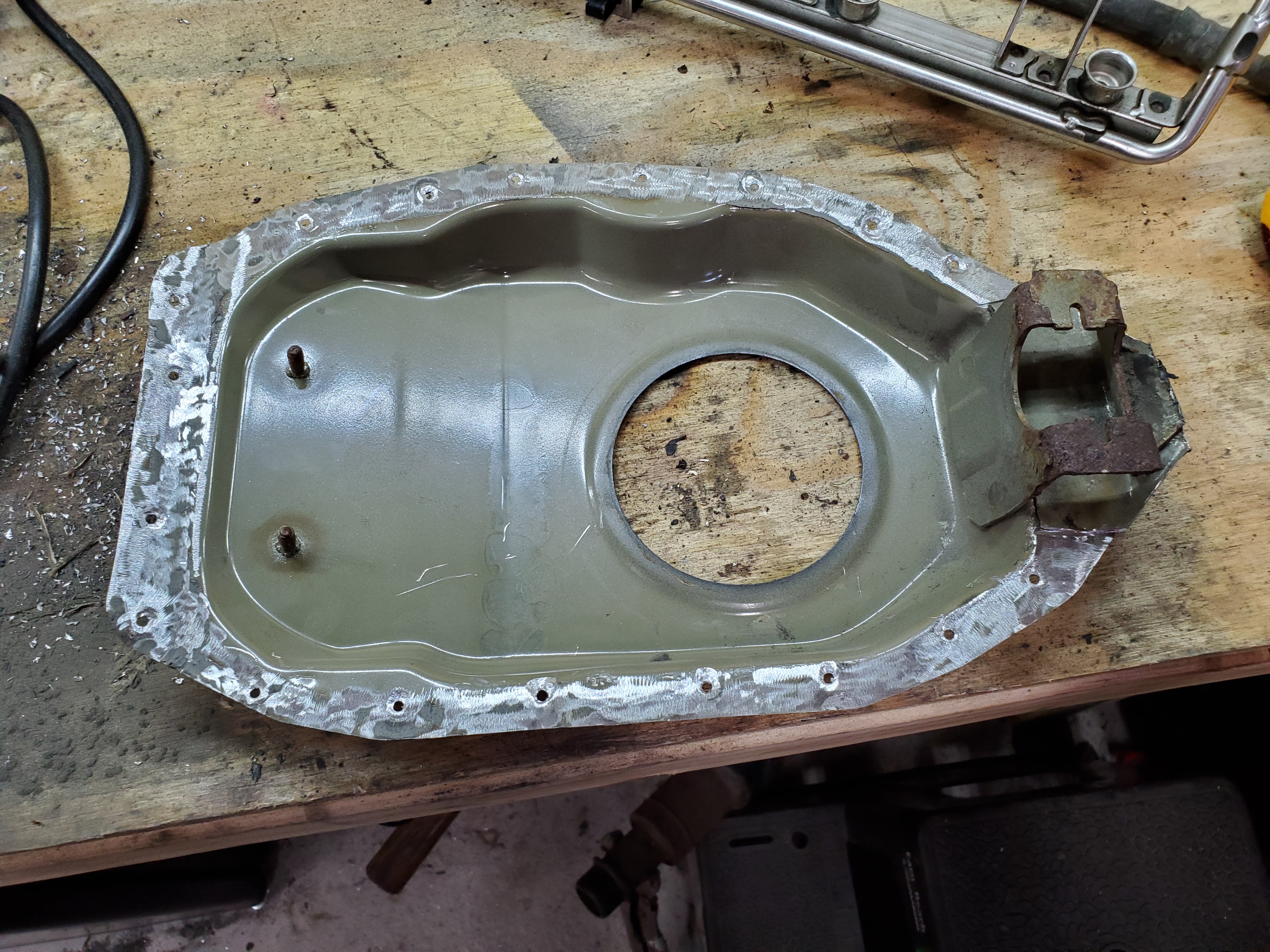

    Prepping for surgery. Cut out the raised trans tunnel section for shifter from a 330xi at wallys u-pull in Oshkosh this morning.
      #69
      Interesting. So did all the xi's have the raised tunnel then?
        #70
        This is my assumption based on everything I've read, seen and experienced through this process...
        All preface lift e46 xit's, regardless of auto or manual, had the raised tunnel since bmw based all chassis' off of being manual even if they became auto's on the assembly line.
        Then, for some unknown reason, the facelift xit's that were manual got the raised tunnel and auto's got the flat tunnel due to shifter assembly.
        Again this is just my speculation with what I've seen and experienced.

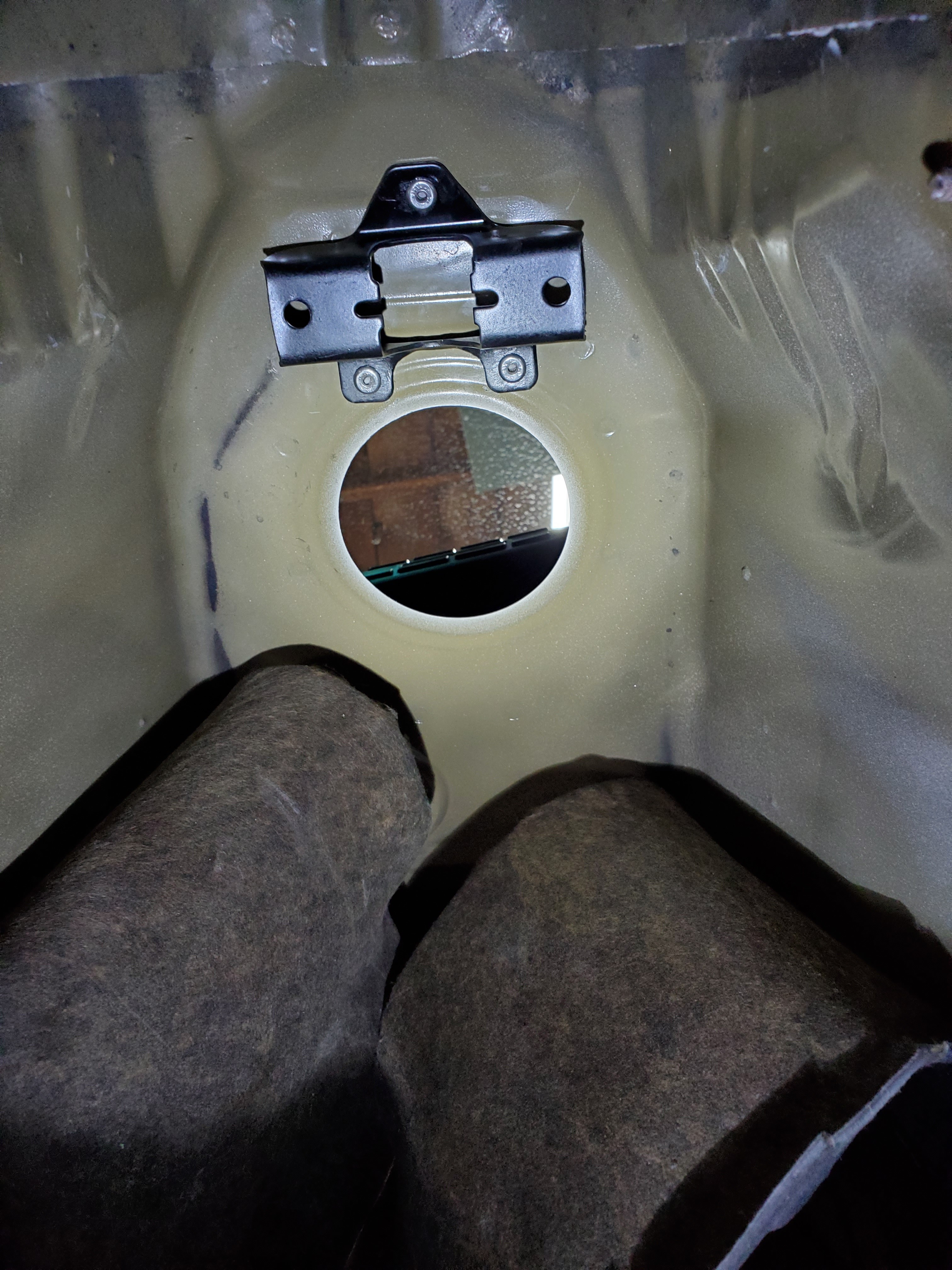

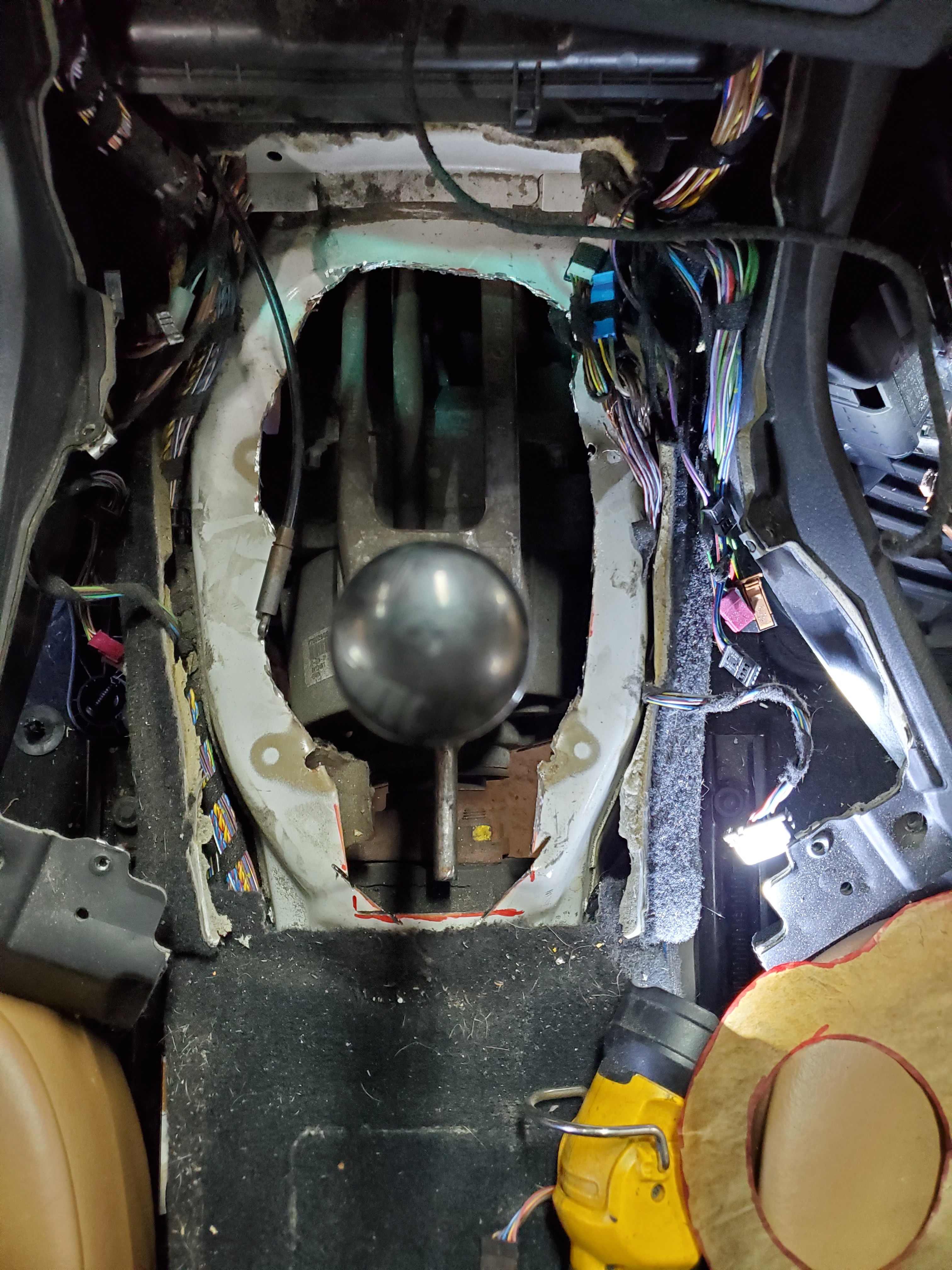

          #71

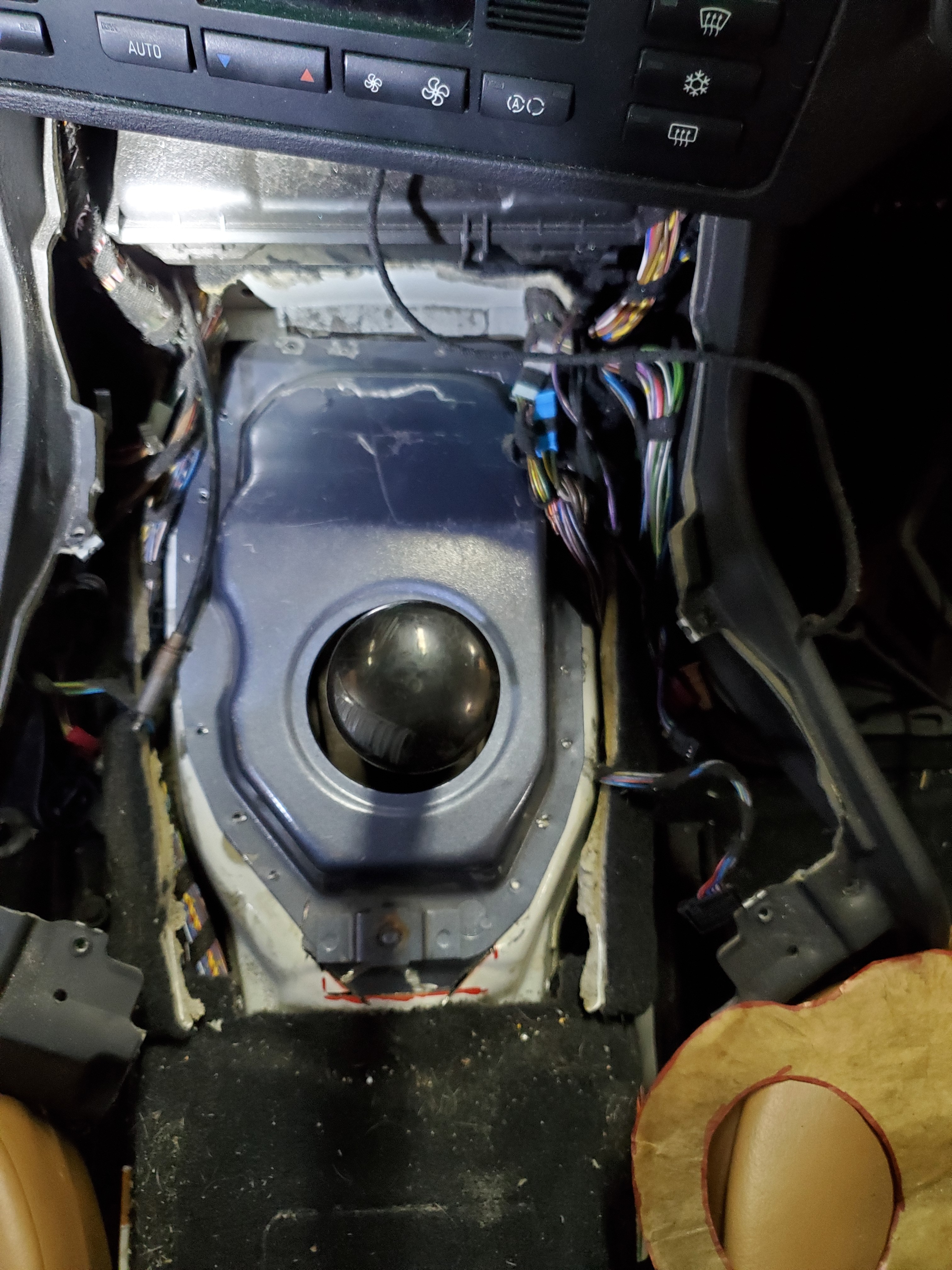

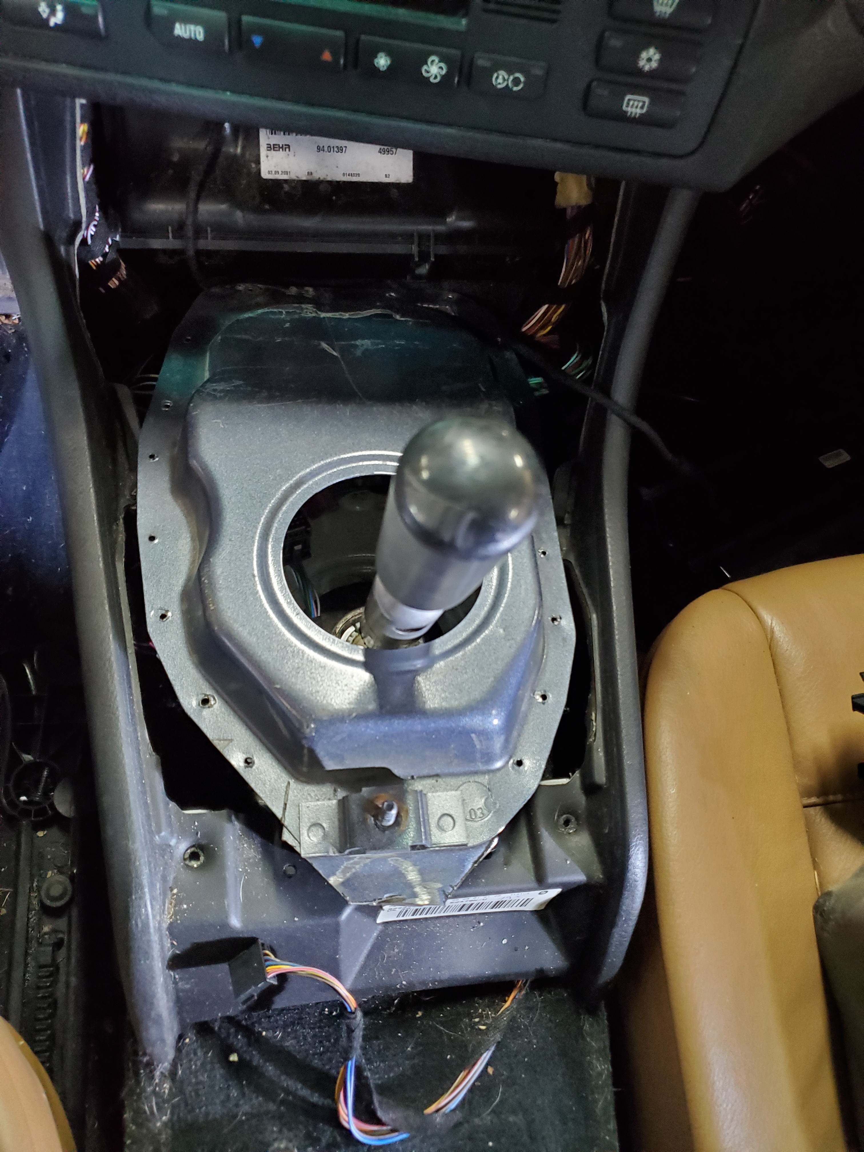

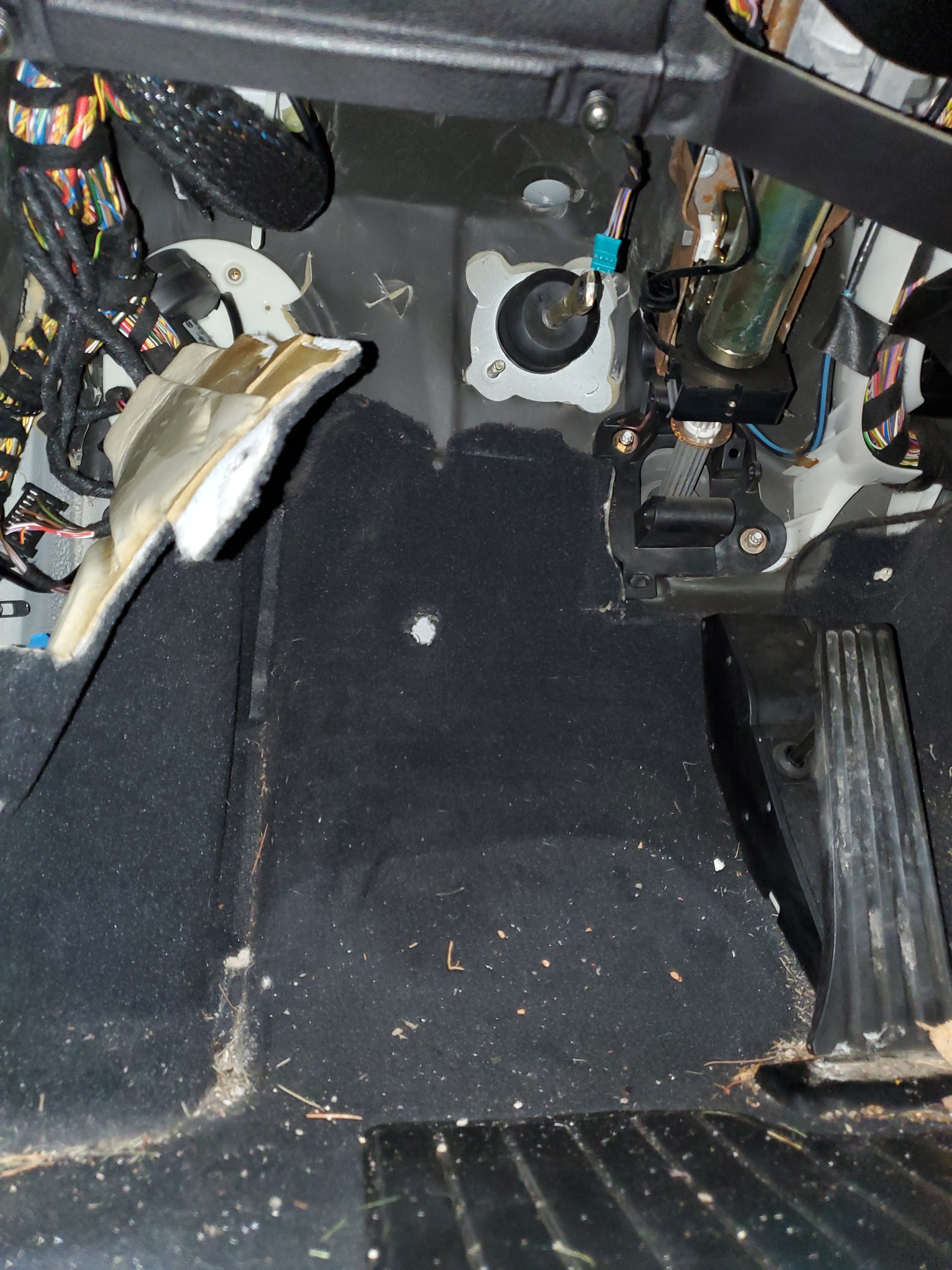

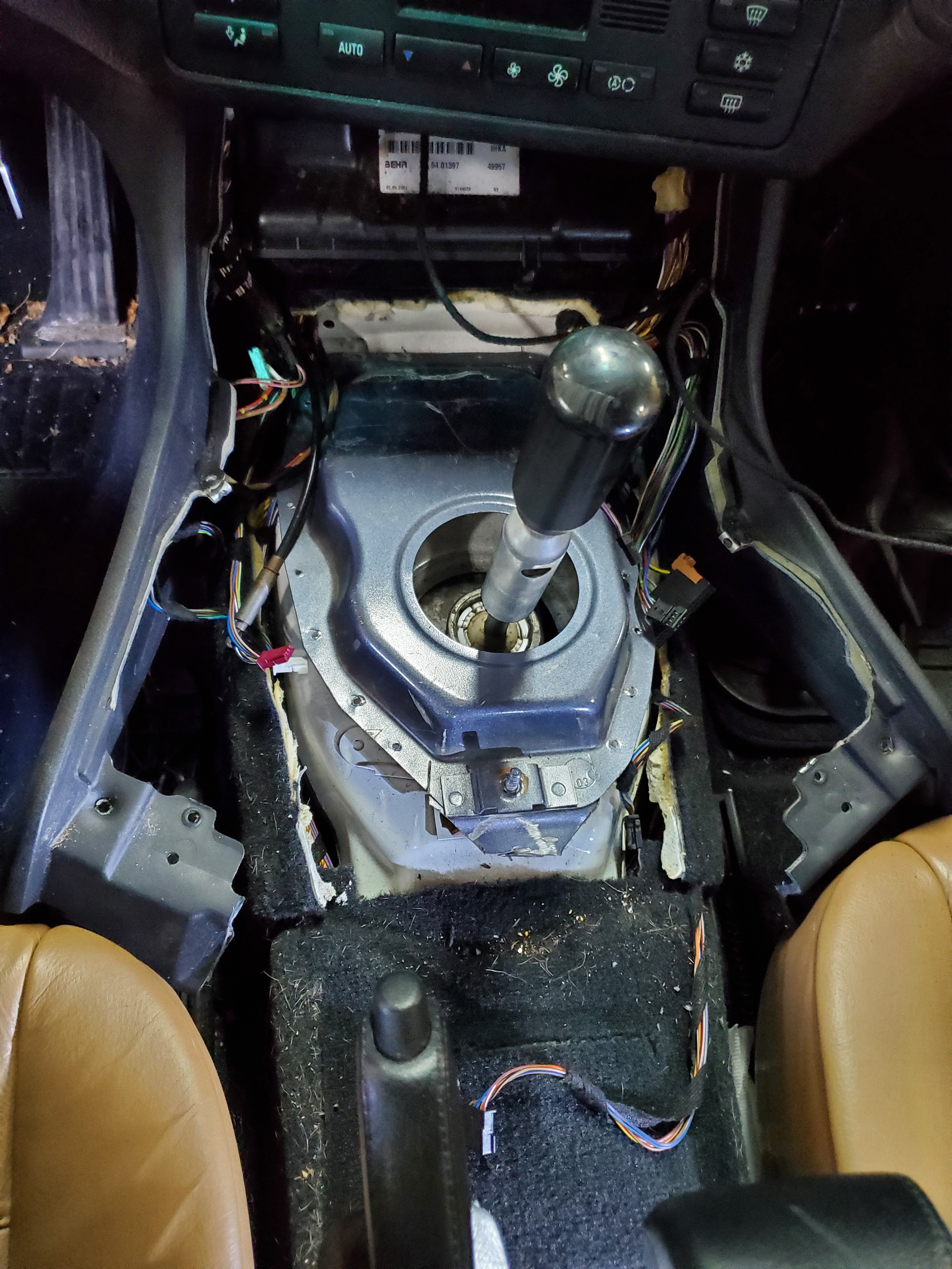

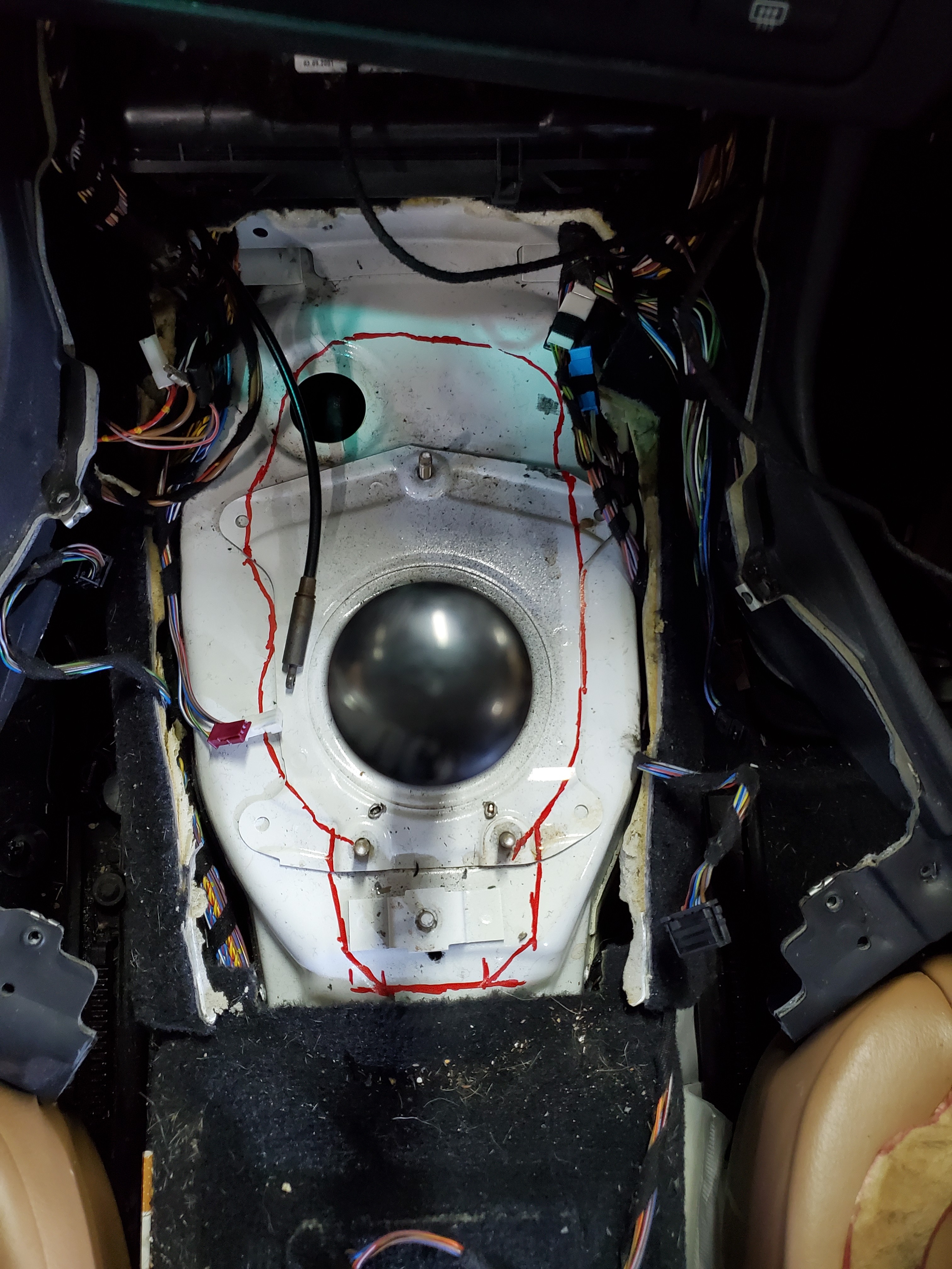

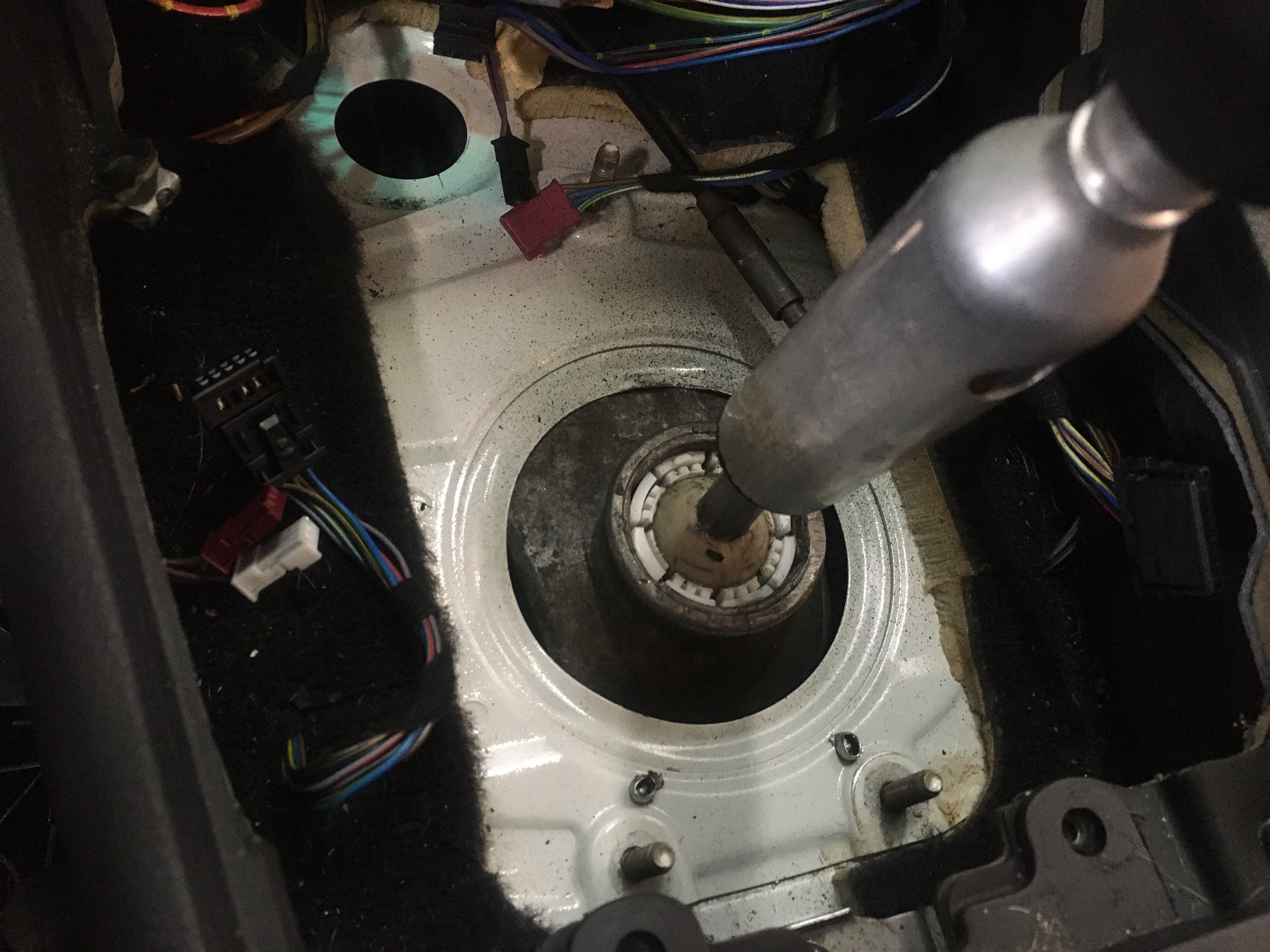

          Well I'll call that a success. Ended up cutting the dash console piece in one spot to make room. This spot will allow everything to bolt back together and never be seen. This extra space allowed me to cut back the carpet inside shifter area.
          I made a template of the inside hump piece and traced it on the car to prep for cutting.
          I then proceeded to cut it out carefully with a dremel, not to hit any of the wiring or catch something on fire.
          Fits great and shifting feels exactly as it should now! 👍
          Now I just have to get some panelbond, seam sealer and rivets to attach it permanently and put all the interior back together.

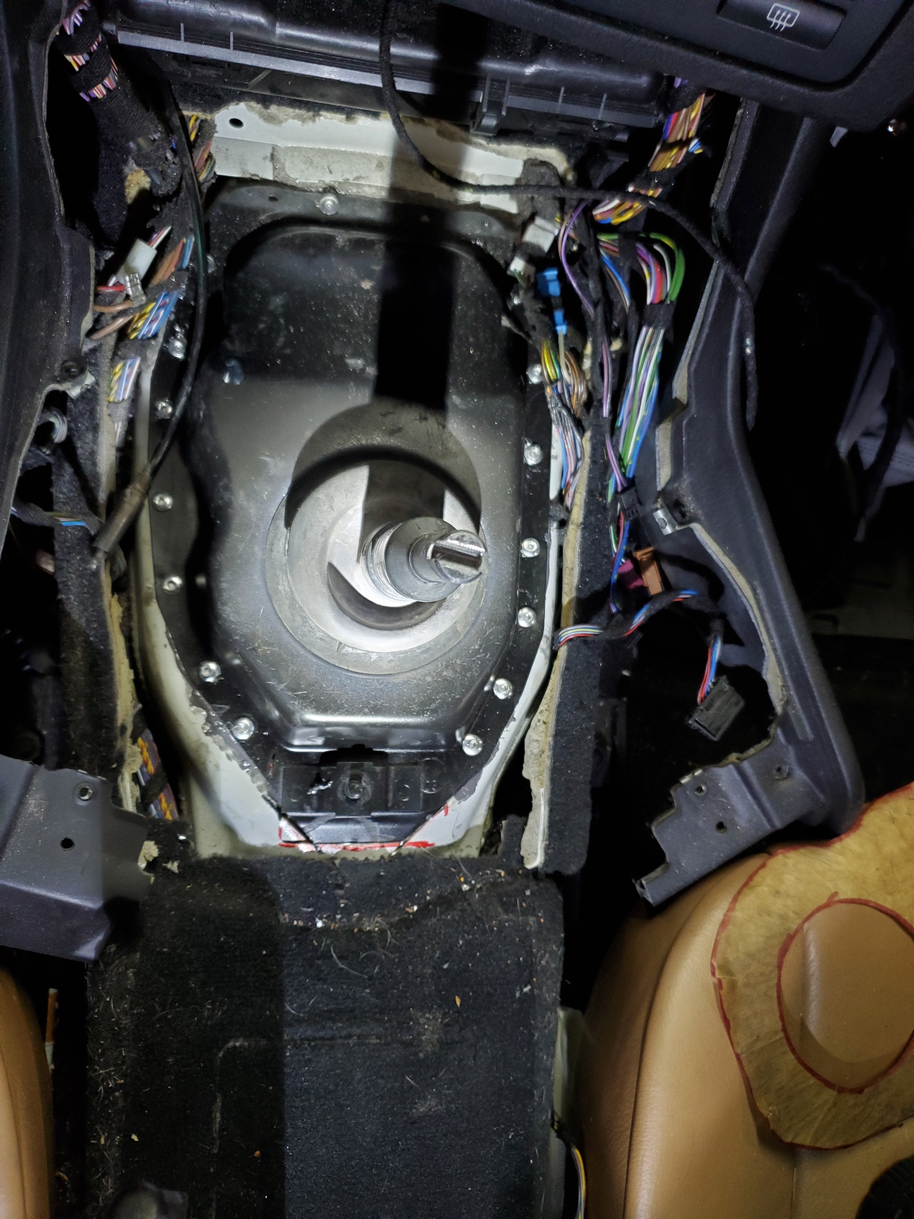

            #72
            Excellent surgical work!

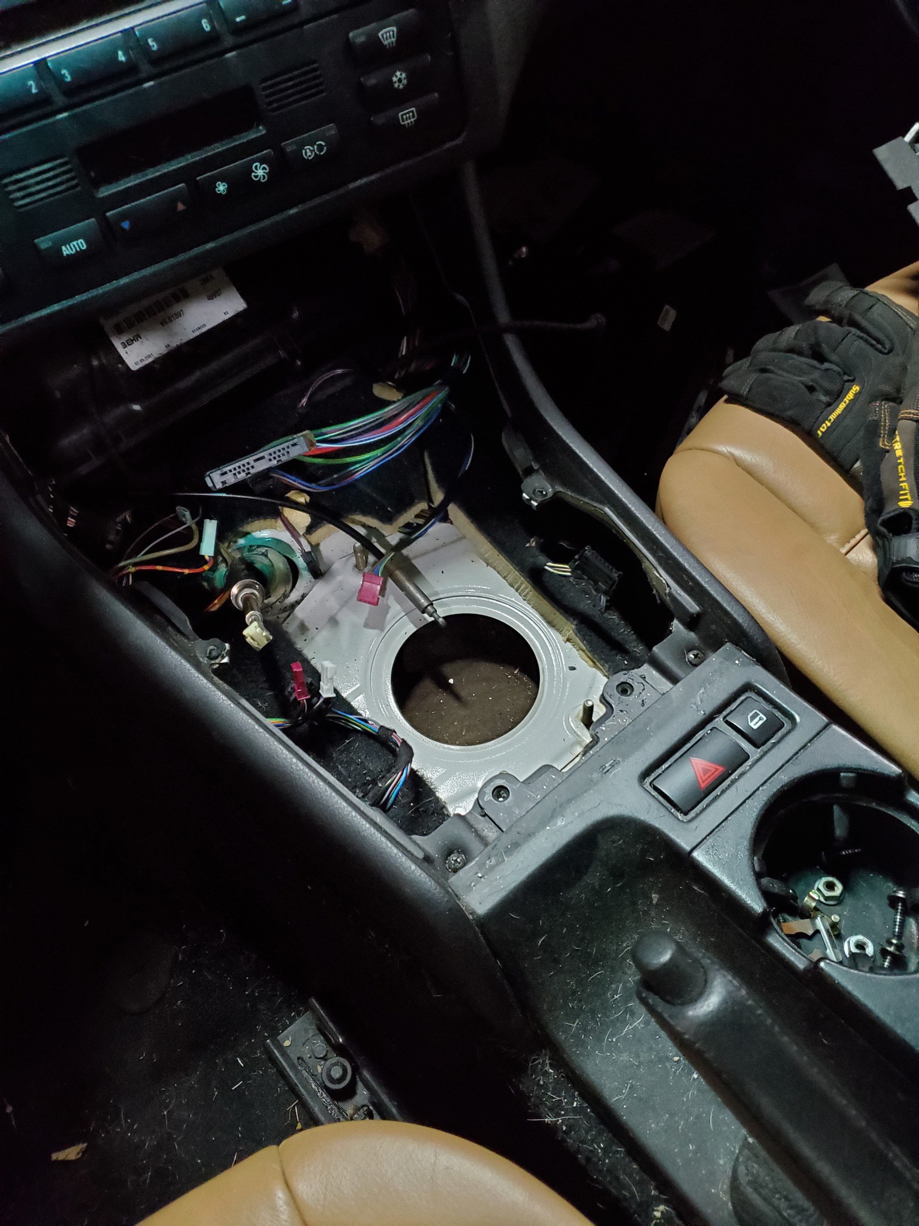

              #73
              Like it never happened...
              Still have to seam seal and undercoat the underside, but I'm very happy with it. Shifts through all gears like it should.
              I have to get a new black leather shift boot instead of the grey one I found at the u-pull. Also, once this whole project is wrapped up, this thing is getting a full interior detail for sure. Yikes!!!

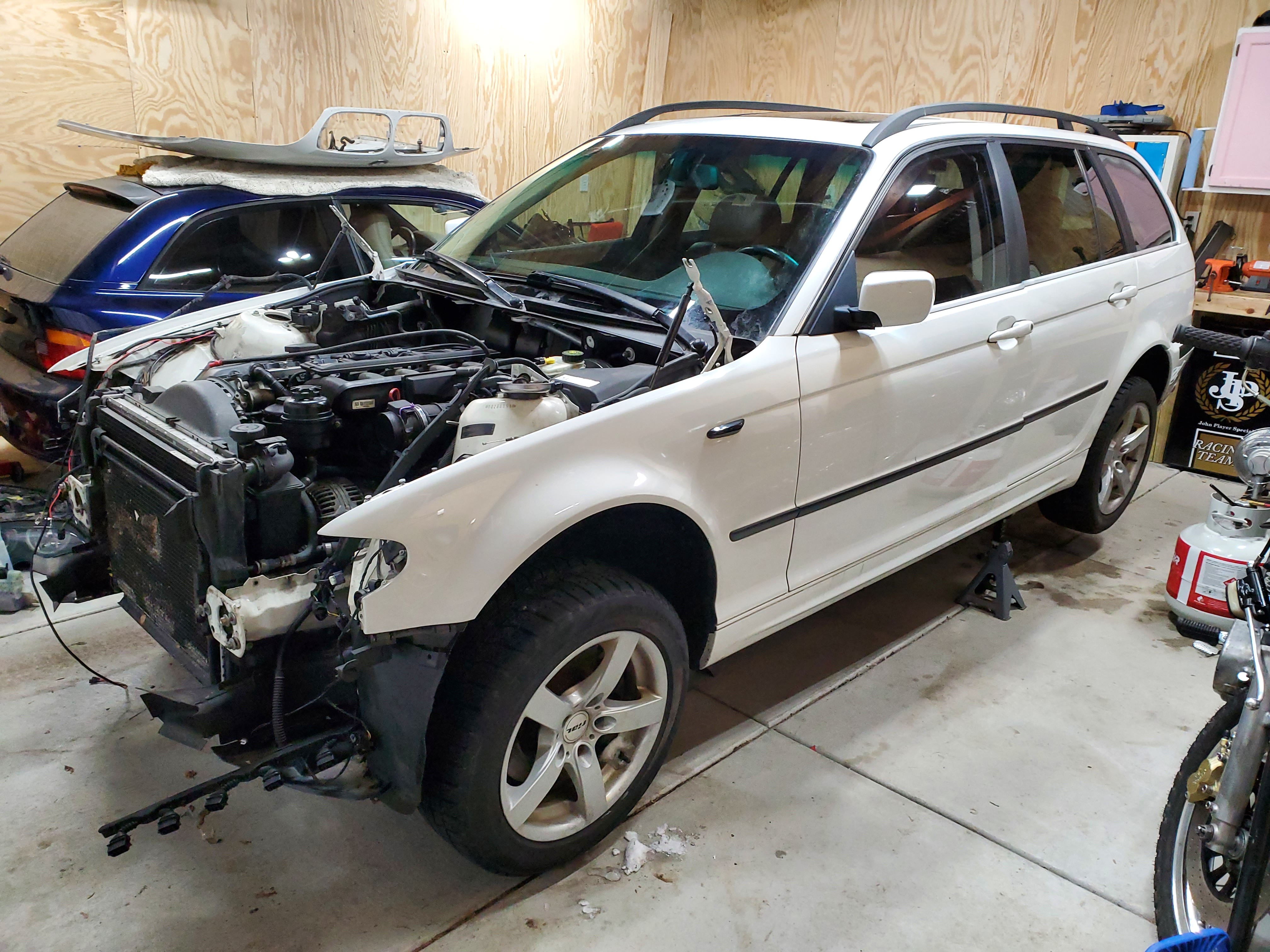

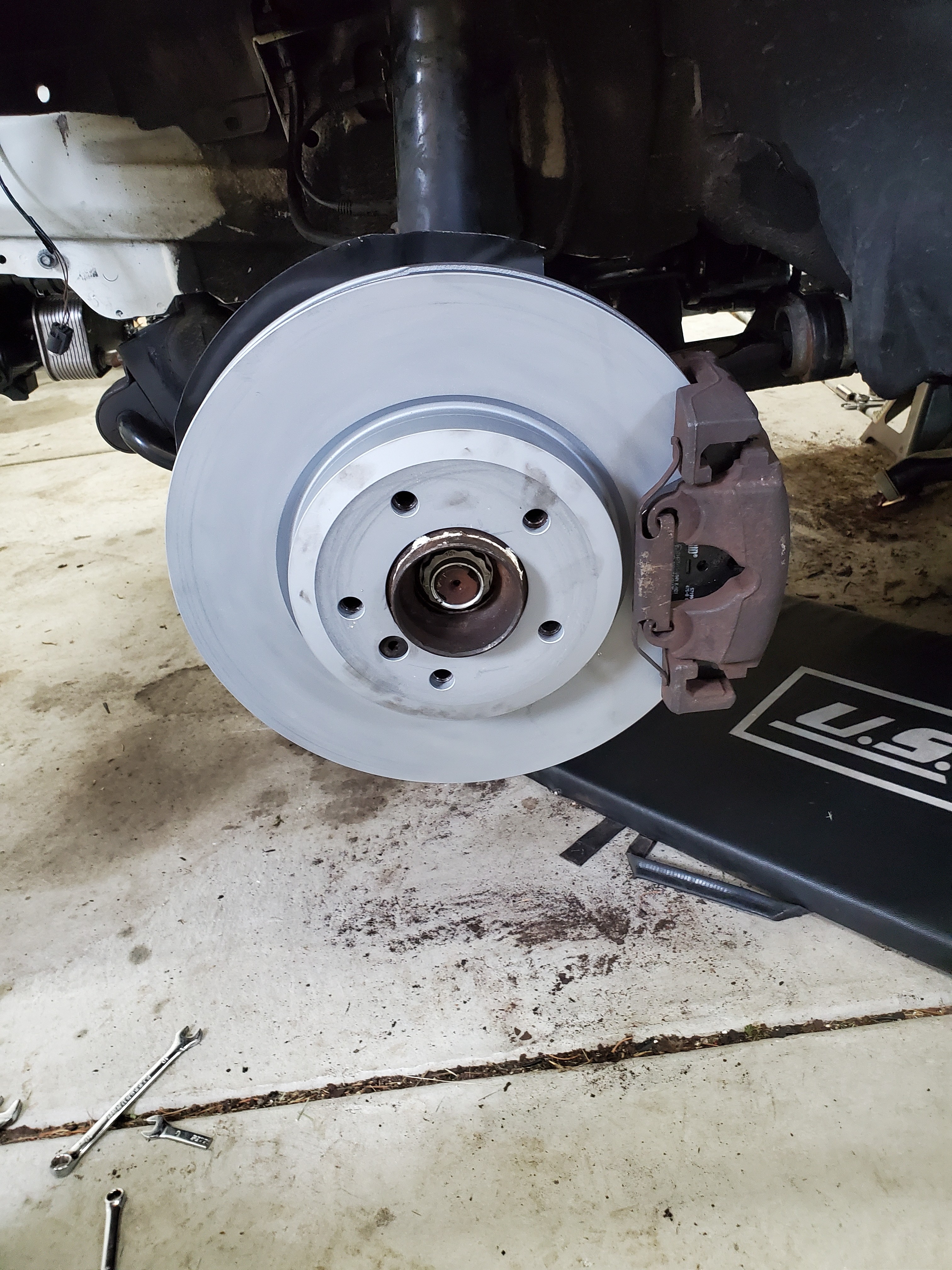

                    330i front brakes installed
                      #77

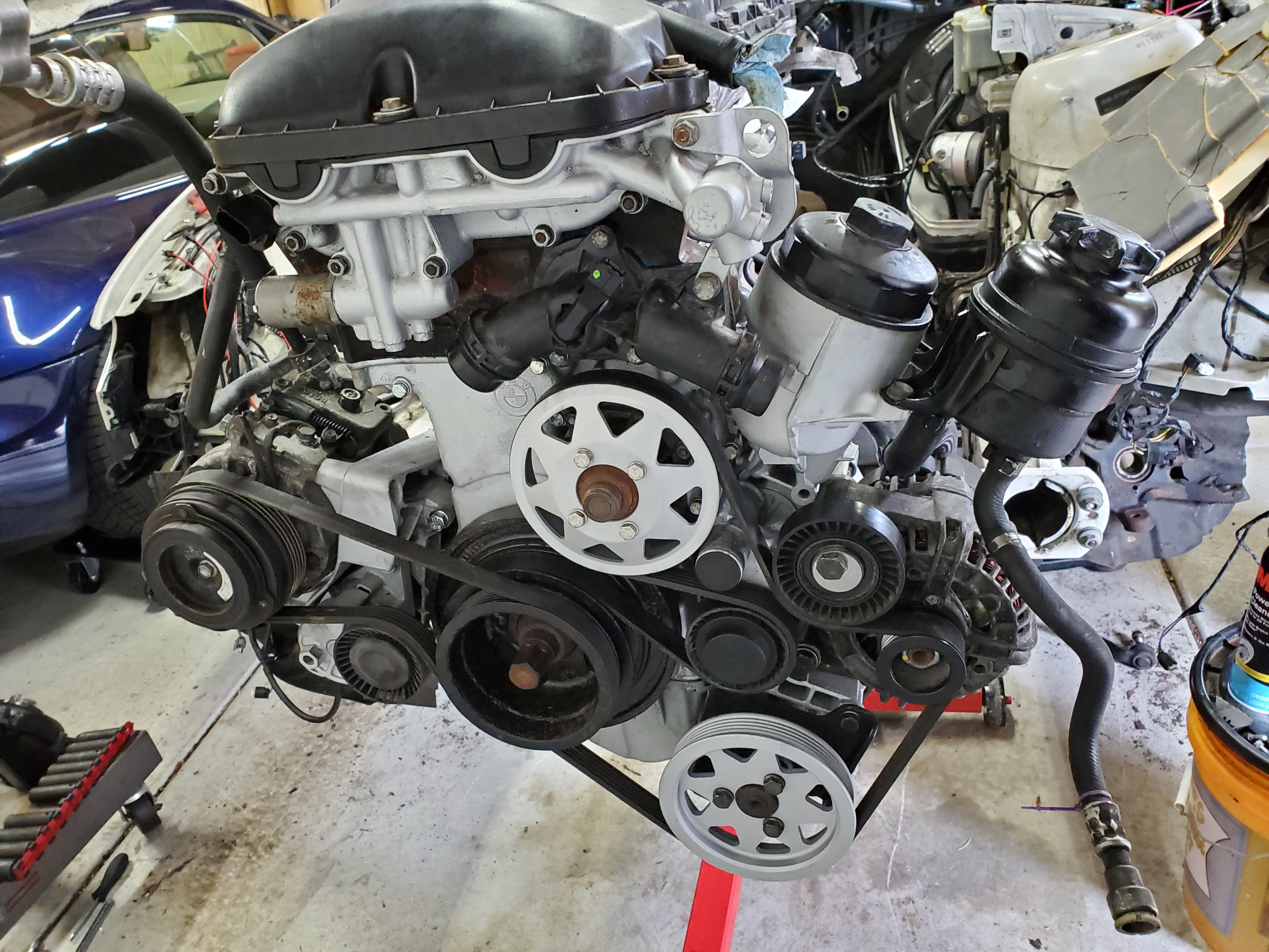

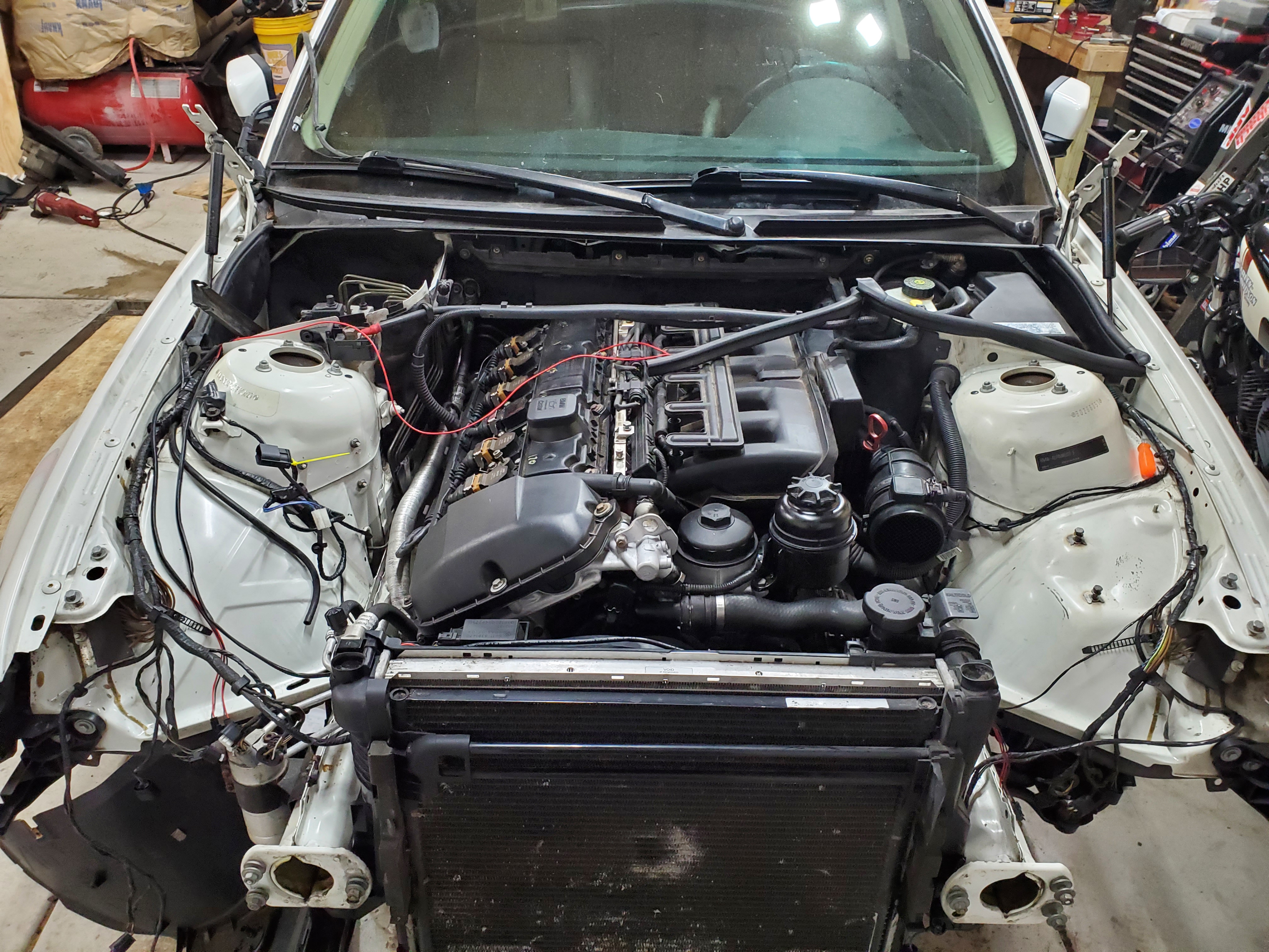

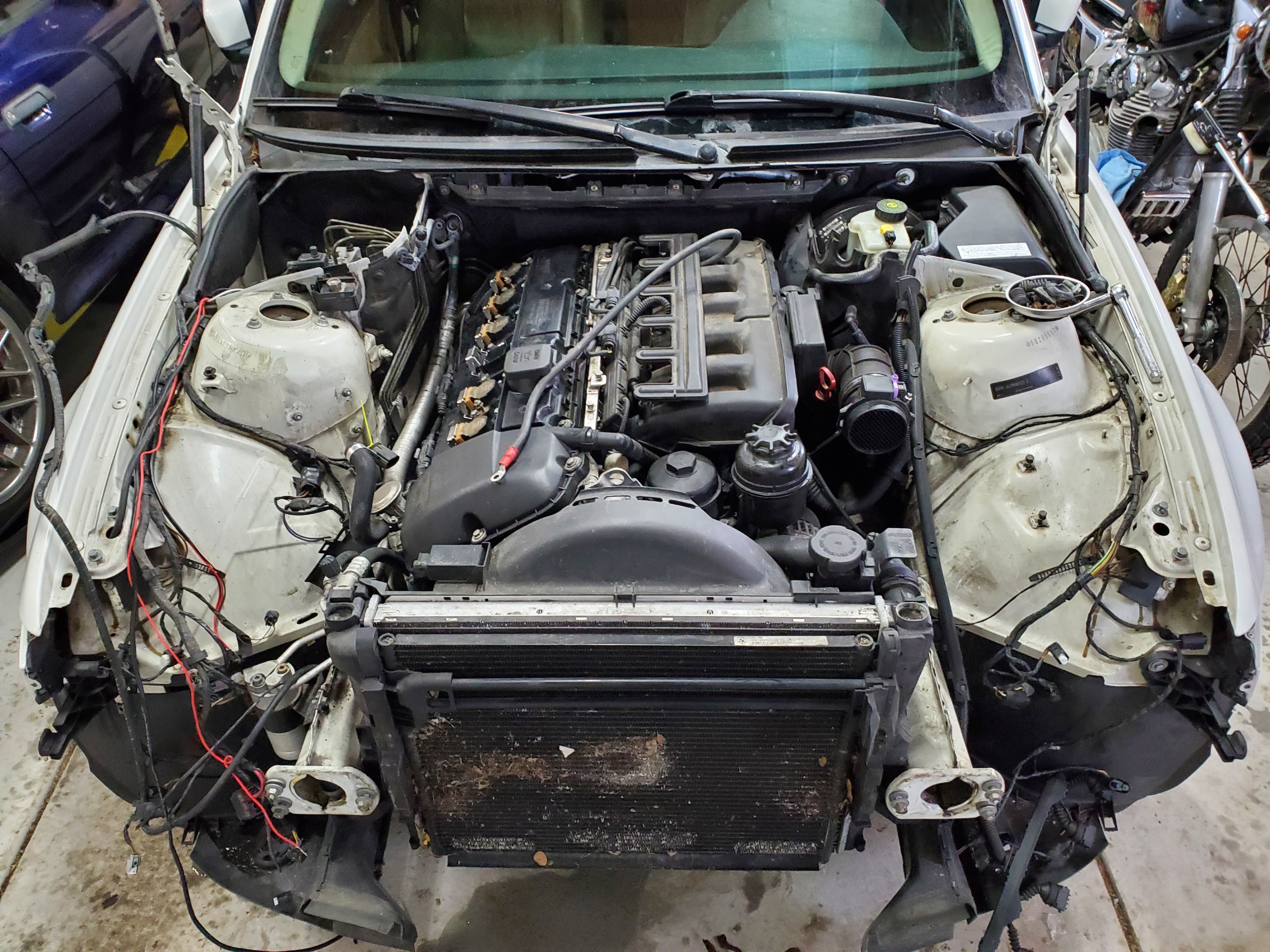

                      After more failed attempts at coding the B25 DME (kept having issues with connecting and finding the dme in the software), it was time to turn to plan b. Thanks to @m42b32 for having an extra MS43 DME and being able to flash it with everything I needed. Joe ended up putting the stock B30 tune, EWS delete and SAI delete on it and it worked like a charm.
                      After a couple startups to see how things were going, the engine started running extremely rough and wouldn't idle. @B C ended up stopping over with his computer. We checked fuel injectors, good. Checked coilpacks, good. Nothing was obvious from the outside, so we plugged the computer in to check error codes. After translating a few we narrowed it down to the DISA valve. Turns out the plug wasn't fully seated on the connector. Plugged it in and purred like a kitten. Sweet!
                      Torqued down axle nuts and crank bolt, bled the clutch a million different ways until it finally got all the air out, dropped it on the ZHP wheels and took it for a short "around the block" drive. All seems pretty good.
                      Time to throw the front end back on, hood, fill AC install airbox and start daily it. 👍

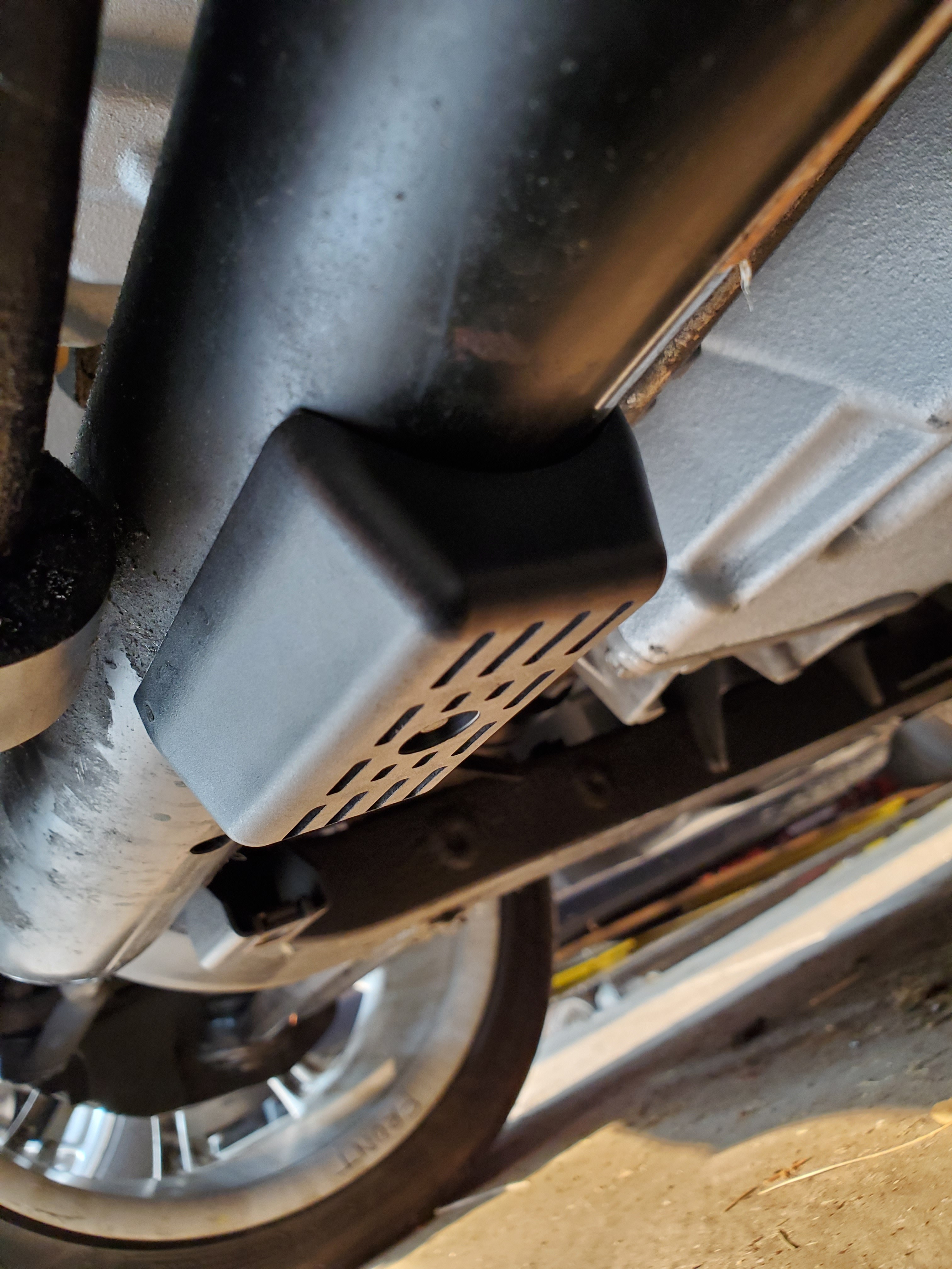

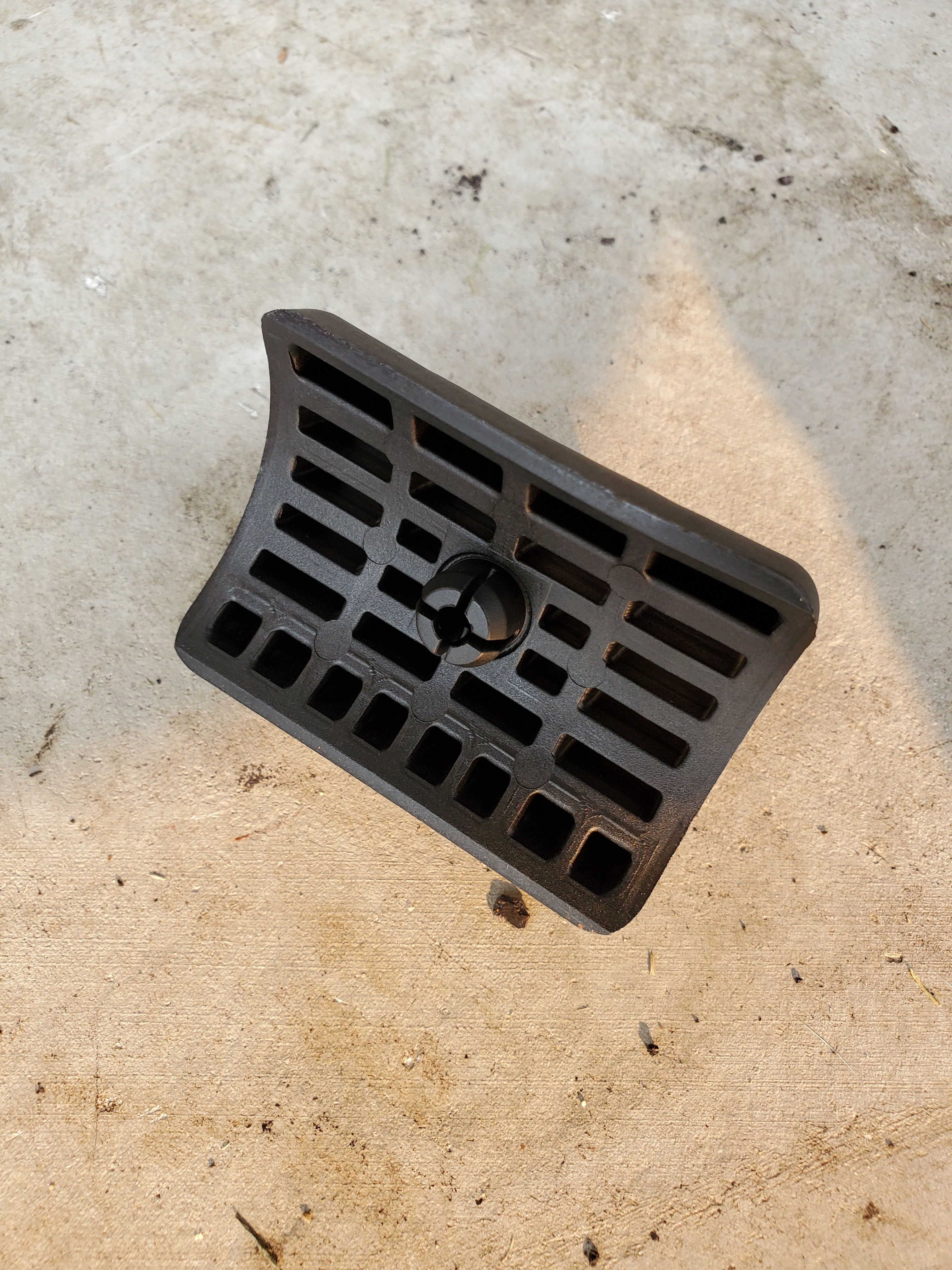

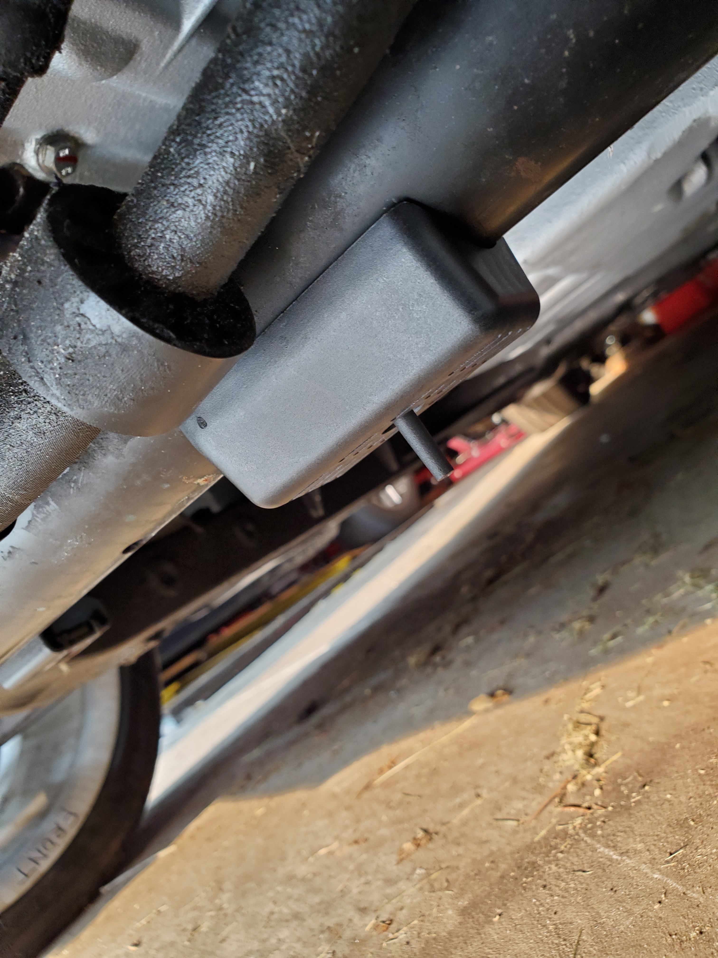

                          It's the little things that count. Front center jack pad for xi models. Mine was missing since I got the car. Finally got around to ordering a new one.

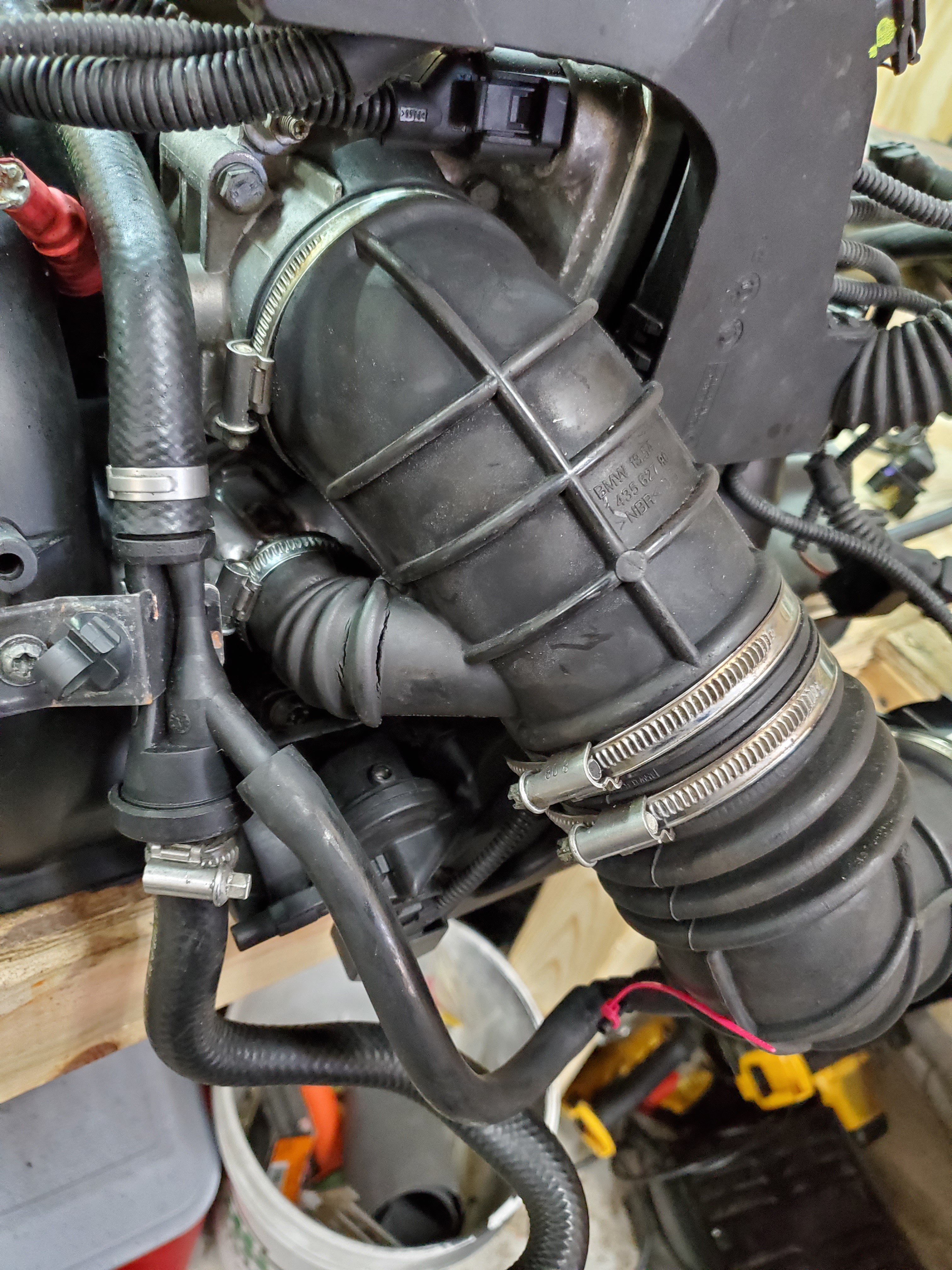

                                  So I've been having a rougher idle on the touring the past few weeks. I installed BMW Scanner and INPA on my spare laptop and connected it up. Cleared all the adaptations and scanned it for codes. These are what I pulled
                                  Error Code 106 - Control Vanos Mechanicall Outlet Blocked or Jammed
                                  Error Code 8 - Air Flow Meter
                                  Error Code 106 could if been a few different things, cam sensor, vanos seals, vanos solenoids, etc. I decided to start swapping parts off the Z3 coupe to diagnose the problem. Started with the exhaust side cam position sensor. Swapped the part, cleared adaptations and Error codes, fired it up. Luckily first try was a success! Cam sensor cleared the Error Code 106.
                                  For Error Code 8, I was going to swap MAFs, but unfortunately the 2.8L Z3 coupe MAF is the same size as the B25 MAF, not the B30 MAF. Decided to just go ahead a buy a new MAF off FCP Euro while purchasing tue new cam sensor and oring. Hopefully this is it and daily driving commences.

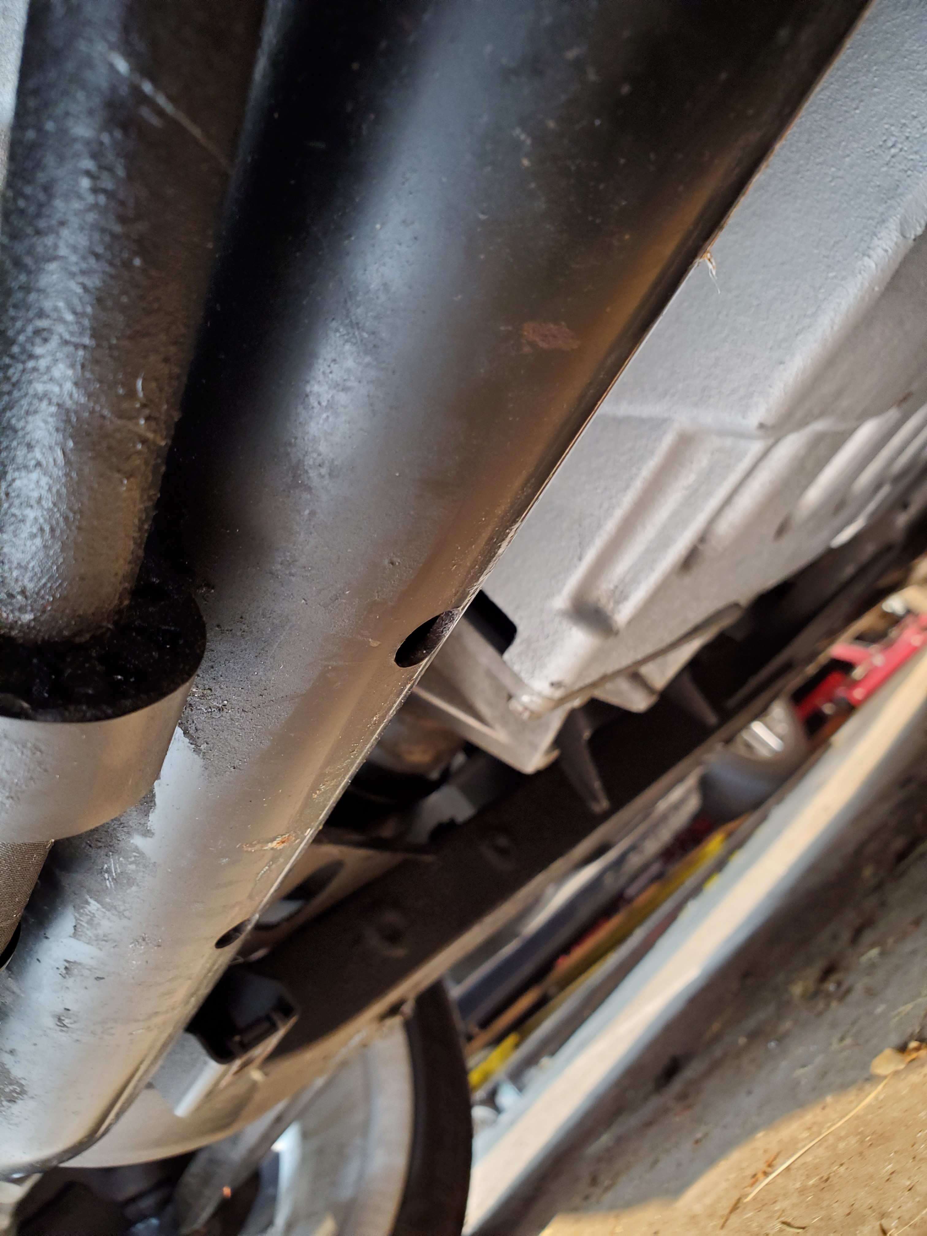

                                    Replaced both cam sensors seemed to have fixed my idling issues which is awesome. Had a bad knocking sound on acceleration off a stop which I pinpointed to the driveshaft CSB and flex disc guibo. So off with the exhaust, heatshield and driveshaft for the third time. Replaced them and all is good now.
