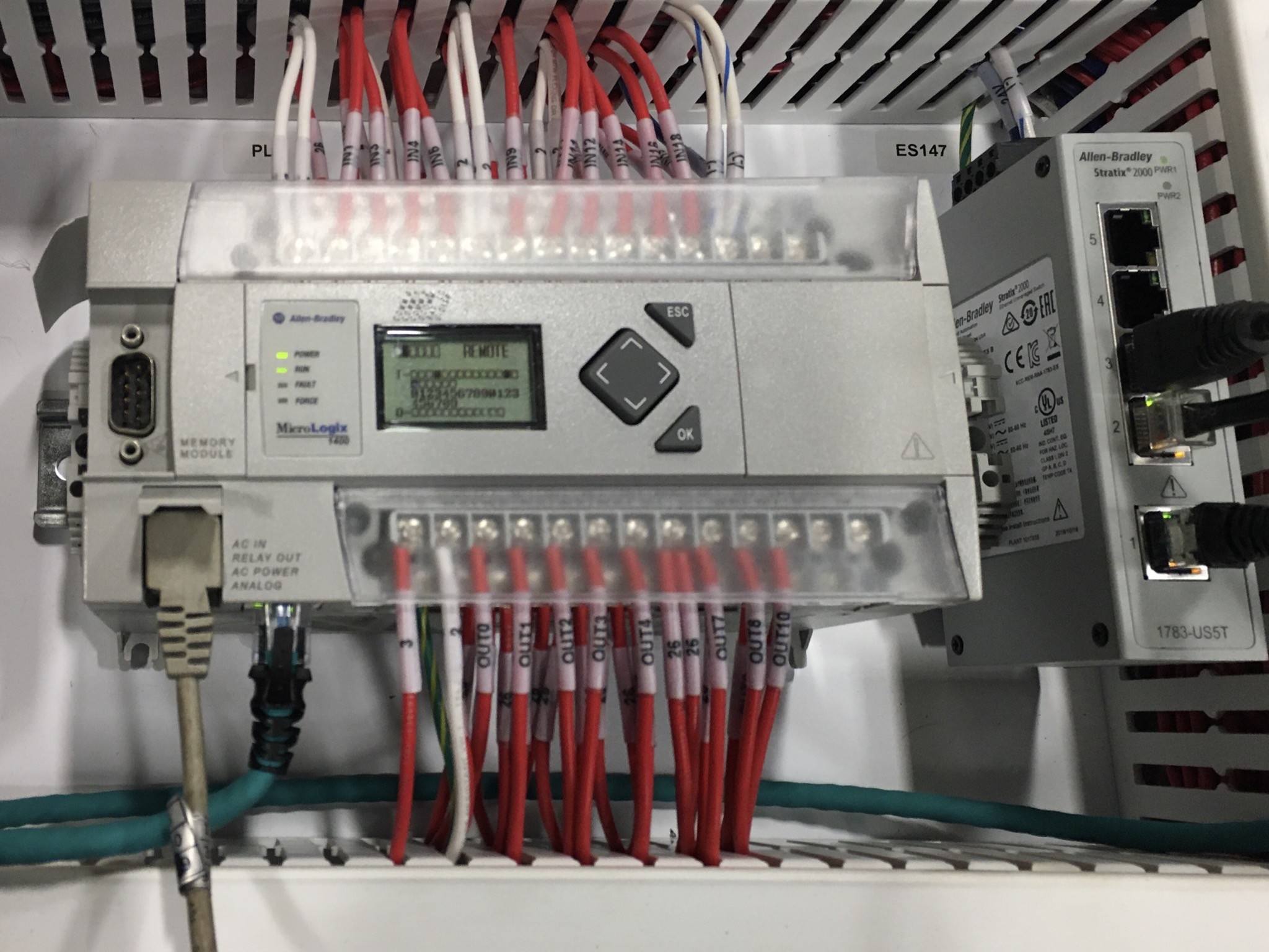

    Does anyone have experience doing PLC programming, or setting up Micrologix controllers/Panelview displays?
    I no longer have a controls engineer at work and I have to get a machine programmed and debugged before Friday.
    I have never done this before and have managed to get the program loaded onto the controller and am now trying to load the display program to the Panelview, then get the comms setup. I have had many small miracles take place and with a measure of good luck, I may succeed tomorrow.
    In case I run into some dead ends, does anyone have experience that I may be able to lean on regarding loading and setup?
    Contractors/tech support has been hard to find and to receive Rockwell/AB tech support means renewing a 3 year service contract for $4000 that will very likely never be used again.A60D31F9-F38E-48C4-9503-1F30754673F3.thumb.jpeg.f4e1cee8146a9ad85a99fe022fd4f9c4.jpeg

                More small miracles: I ended up finding instructions for establishing ethernet communication without having a Rockwell Automation service account, thanks to a cached version of the instruction page via google.  I have the 2nd program loaded up and now it seems I just need to get the IP addresses synchronized between the display and the controller and I should be good to go.

                    So you have a Micrologix 1400 and what kind of Panelview?  The Panelview program has a programmed shortcut which points to the IP of the PLC, you can't change it without software but if you know what it is you can change the PLC to match.  I'm assuming this is a Panelview plus?
                      PV800
                      I believe I have things sorted out and discovered 2 problems.
                      The IP addresses for both components need the first 6 digits to match (this is probably obvious to anyone in networking but as I am a noob, they seemed arbitrary as long as you were pointing the PanelView to the IP address of the PLC.
                      The second issue is that there are 3 places to change the IP address. One is set in the program on the PC via Connected Components Workbench, another is the PanelView Terminal settings, the third is under File Manager > Controller settings. This one was not set correctly (and apparently exists as a master/slave that can have a different IP for some application for which I am not even qualified to begin thinking about)

                                There is a lot to the network stuff.  The subnet mask determines how many octets of the ip need to match, 255.255.255.0 in the subnet mask would mean that the first 3 octets of the IP need to match.  255.255.0.0 would mean only the first 2 octets of the IP need to match.  The Gateway only is used if this is connected to a plant network and is the IP of the switch or possibly more complicated if there are a bunch of VLANs.  If it just an isolated machine it is much easier.  I sent you my phone number, call me if you have trouble.
