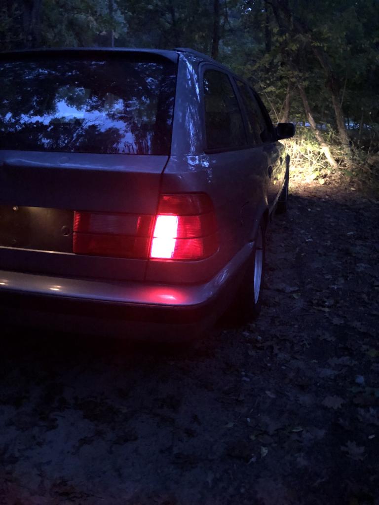

    On an hour drive yesterday, gauge cluster started showing me a brake lt circuit failure. Soon after, lots of other random warning codes flashed. Tire failure, door open, hood open, esd regelt, asc from what l remember off the top of my head.
    None of these codes were true. I have an extra CCM, and read that this relay was the issue, so l swapped it out but this didn’t fix the problem. Where should l look next? Gauge cluster, fusebox wiring? Is there another module that can cause this?
    Codes do not come on until about 15-30 min of driving. Brake lt circuit is the only one that is persistent after they all flash.
    Any ideas appreciated!
    Trent

              The only thing l have done was changing the ccm, since that was what l read on just about every forum post about the issue. Problem occured for the first time just a couple days ago. It’s hard to search for this because most of the threads/results are how to fix the individual codes.
              I’ll have to get out the ol multimeter. As for loose connection from hitting a bump this is also very possible. Seems to only go crazy with loads of codes when driving on a less than ideal road.
              As for the brake pedal switch l don’t think that is the case because the circuit code didn’t show up until all of the others did as well, and the brake lights are working fine along with everything else it says is wrong. However since it’s the only persistent code, and I’ve read that it comes on even when the lights do work when testing, whos to say they do every time. it’s possible that one is a real issue.
