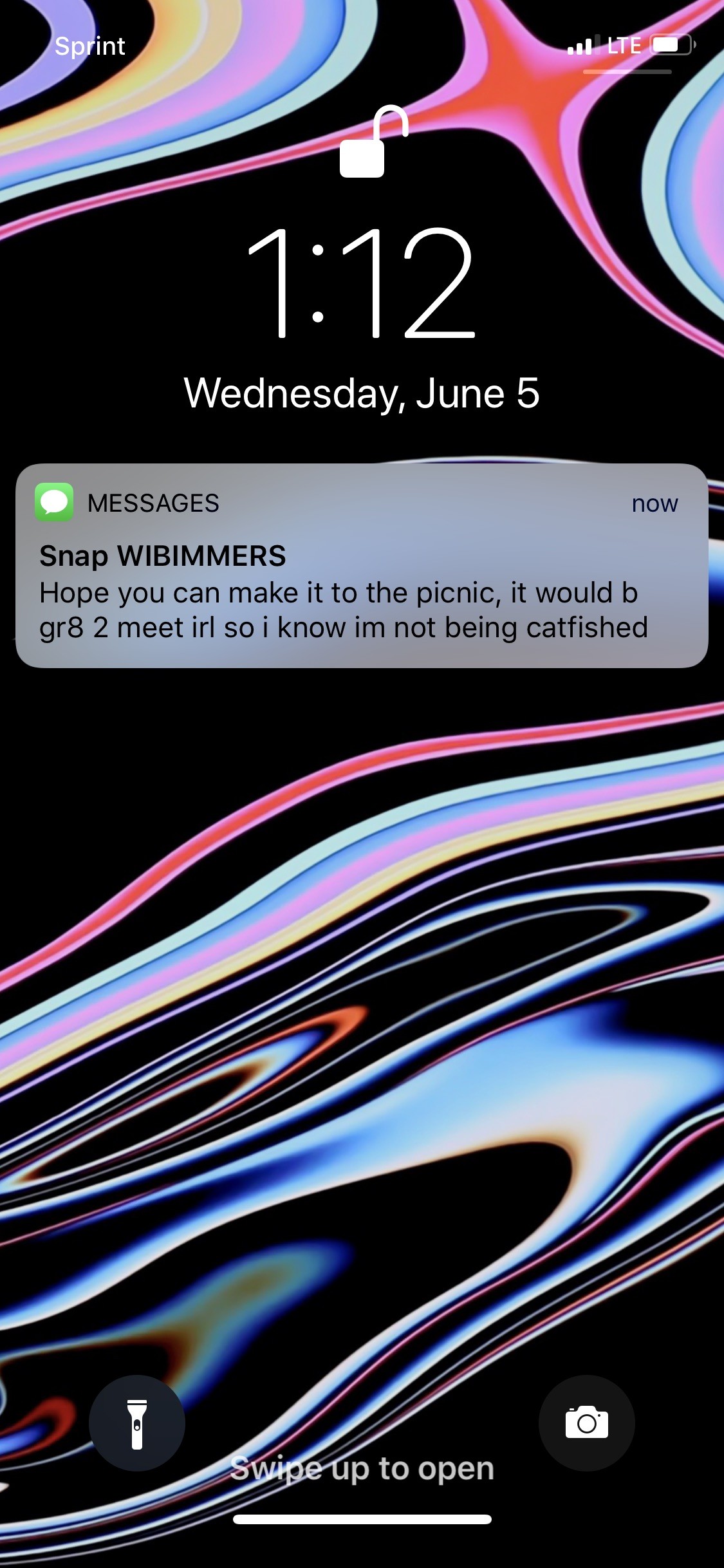

          I’ll consider making the haul in the E30. Would be nice to confirm that @B C hasn’t been cat fishing me this entire time.
          side note, this is screen shot is from like a year ago.
            #145
            The jig is up
              #146
              Literally have @B C labeled the same in my phone.

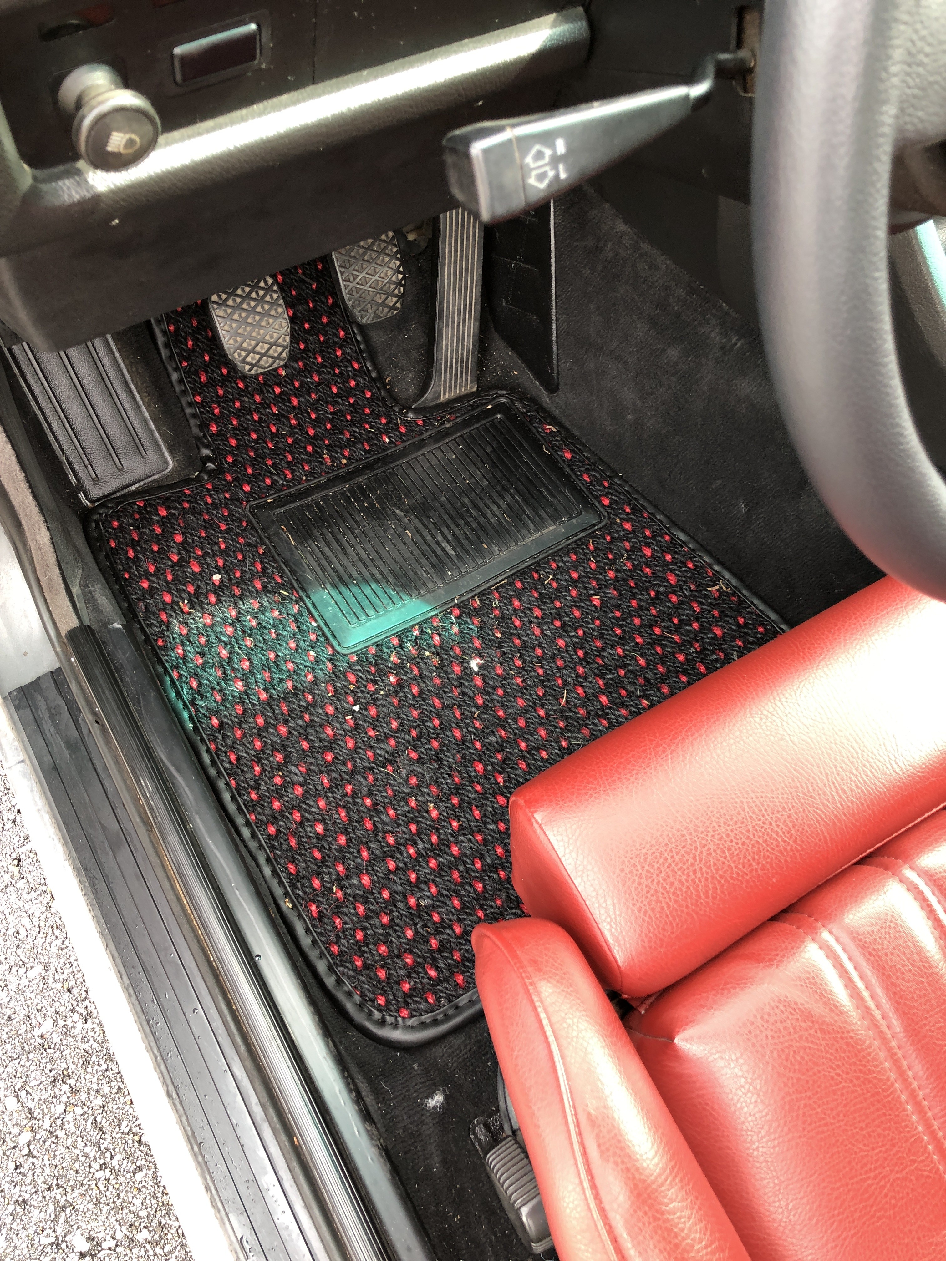

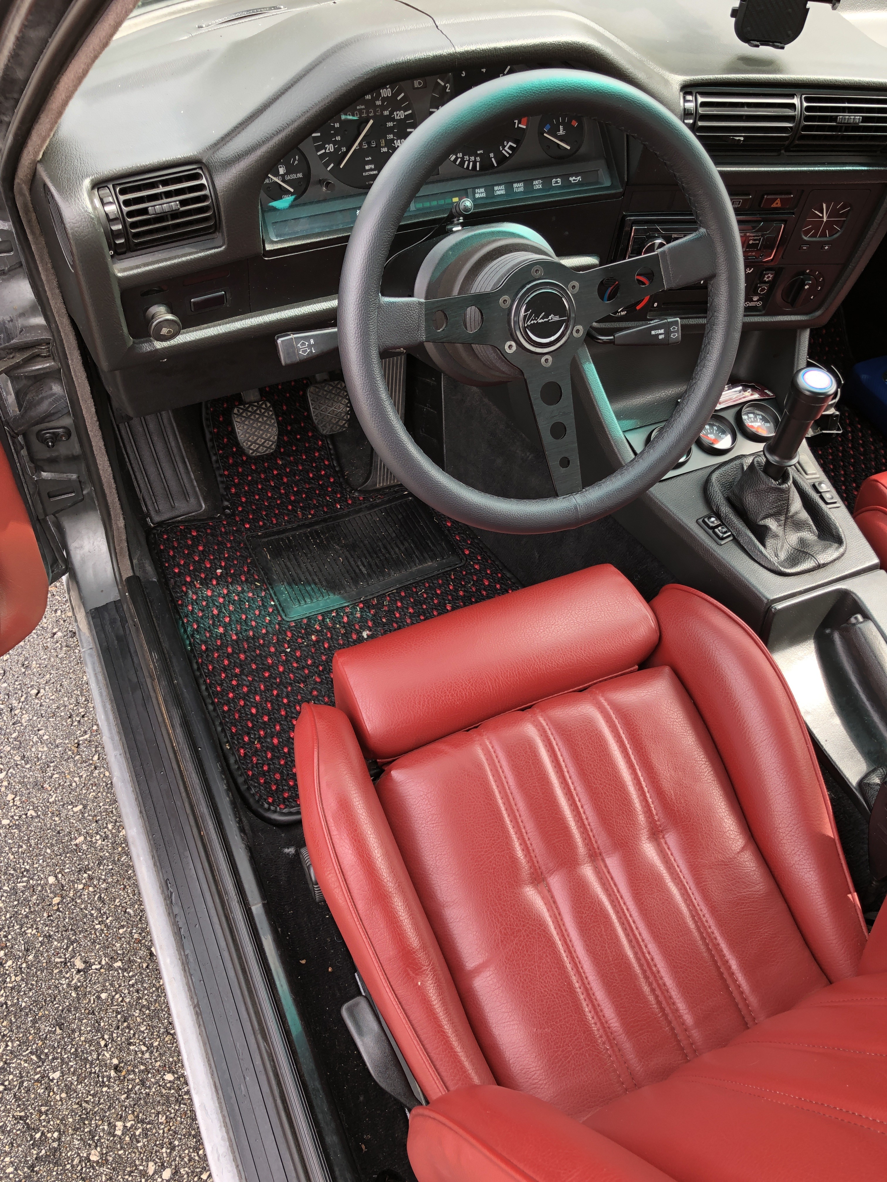

                Really liked @gilber33's Coco mats when I saw them in person. My eBay ones are already getting matted and I usually have to pull them back after driving.
                Thoughts on color? Obviously thinking red to go with the car, but maybe feel a little loud?
                Otherwise thinking black and grey, or just all black.
                Feel like all black maybe a little too subtle. Please make this decision for me.
                  #148

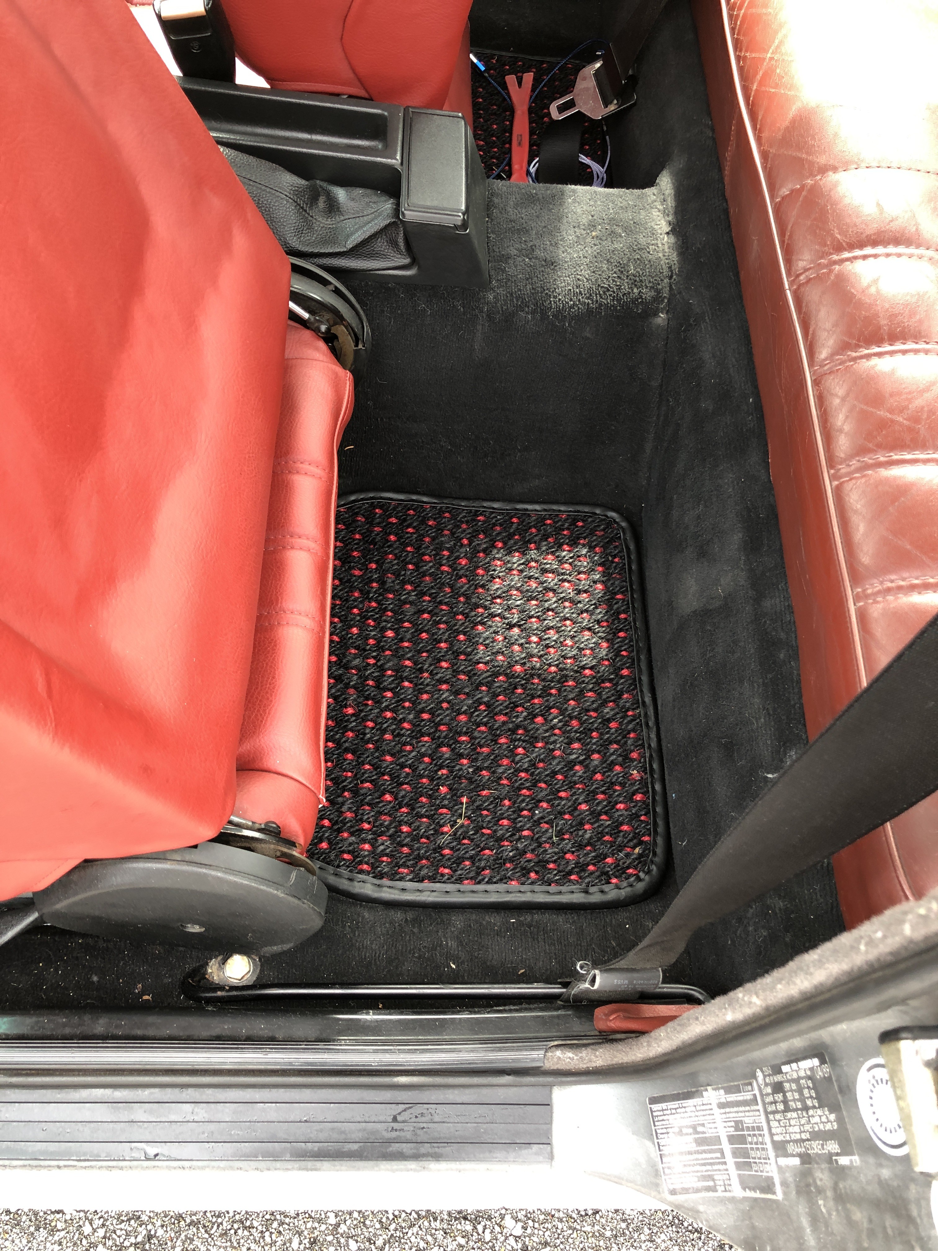

                  I can grab some pictures of mine. They look different in person, IMO. The red isn't quite as in your face as those pics make it look.
                    #149
                    Did you get the red ones to match your interior? I forget which color you had.
                      #150
                        #151
                        @gilber33 Yeah, definitely don’t look nearly as pronounced in this pictures. Think I’ll go with the red and black ones.

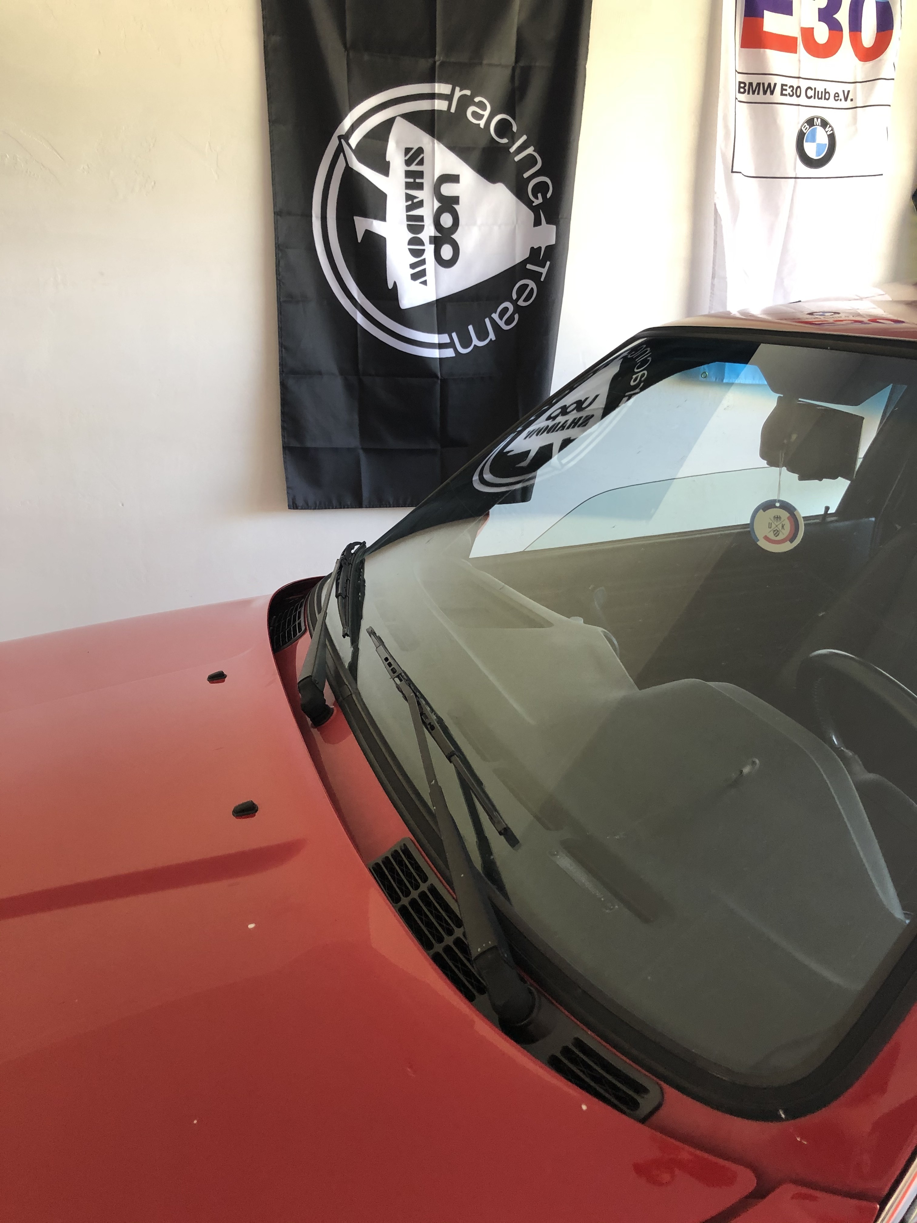

                        Have had a stumble or bogging if I quickly blip the throttle in neutral and sometimes when I’m blipping to rev match on a down shift. Figured I’d clean the throttle body and IAC. They weren’t really dirty or gummed up enough to make a difference in my estimation, but nice to have it done regardless. Throttle cable had a fair amount of slack in it. Adjusted it, response feels much better and tighter. Still get a little stumble or bog on a quick tap of the throttle, but it’s better.
                        Added a coat of black paint to the cowl vents as they were the last bit of trim that was faded.

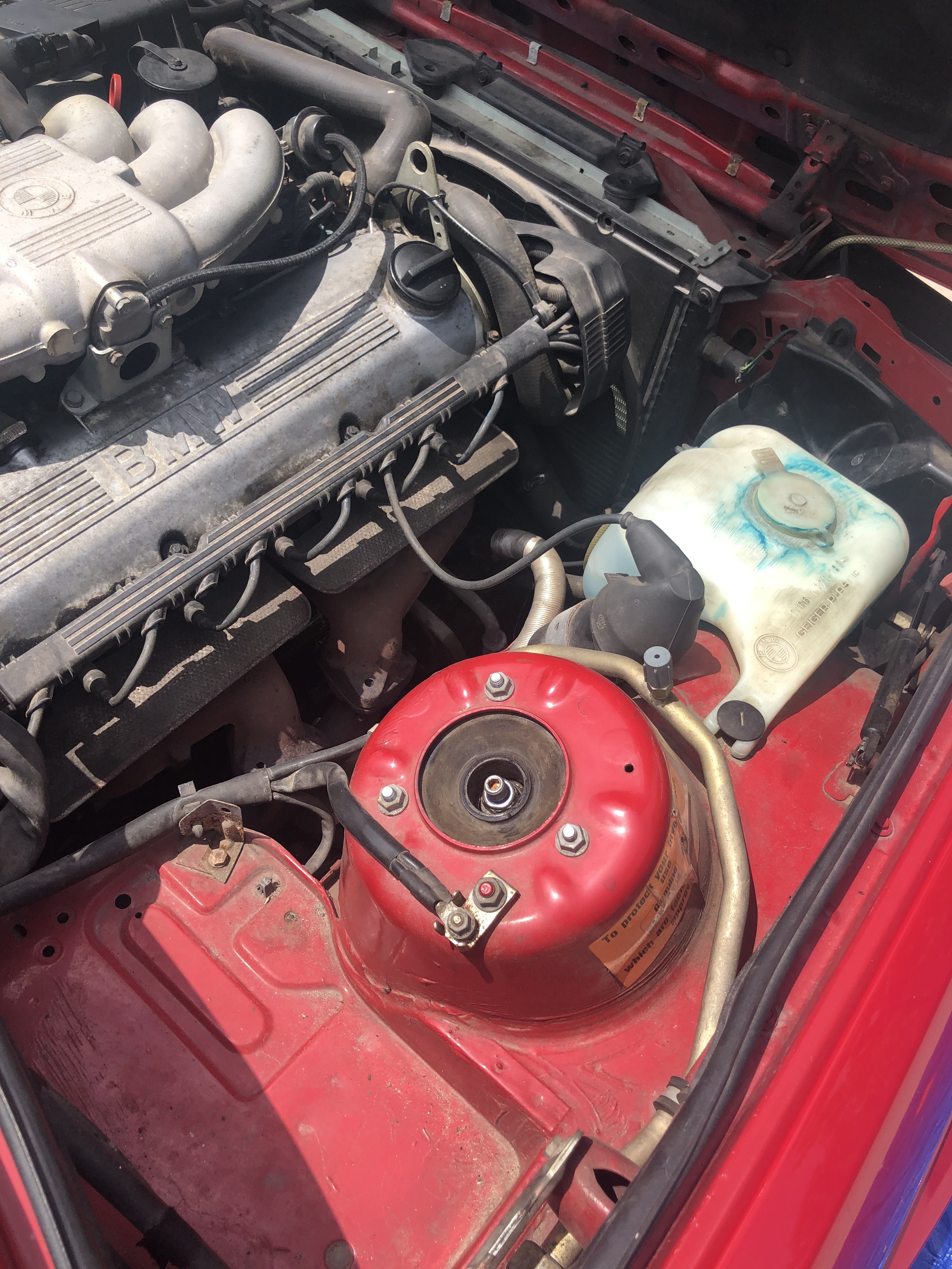

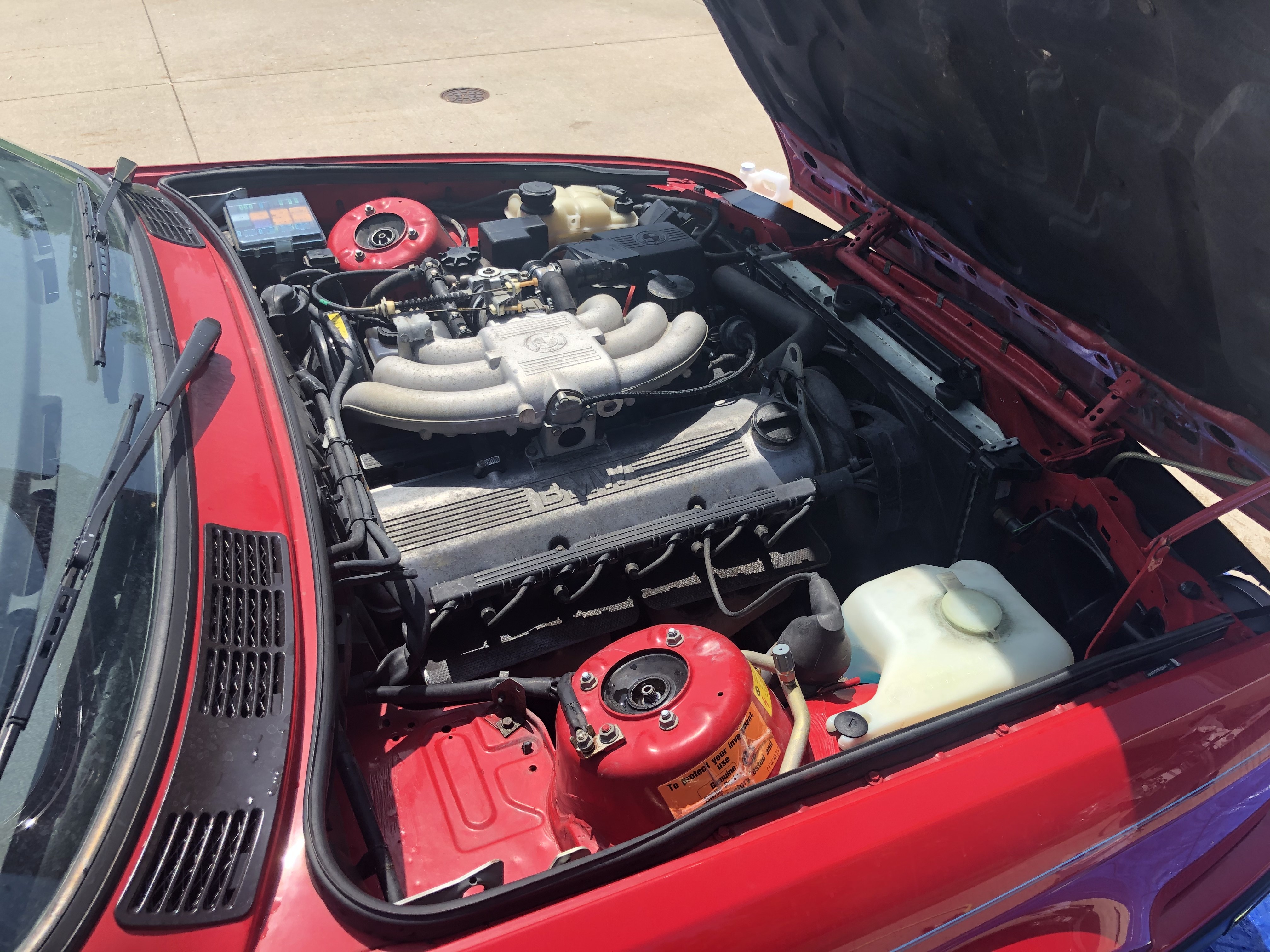

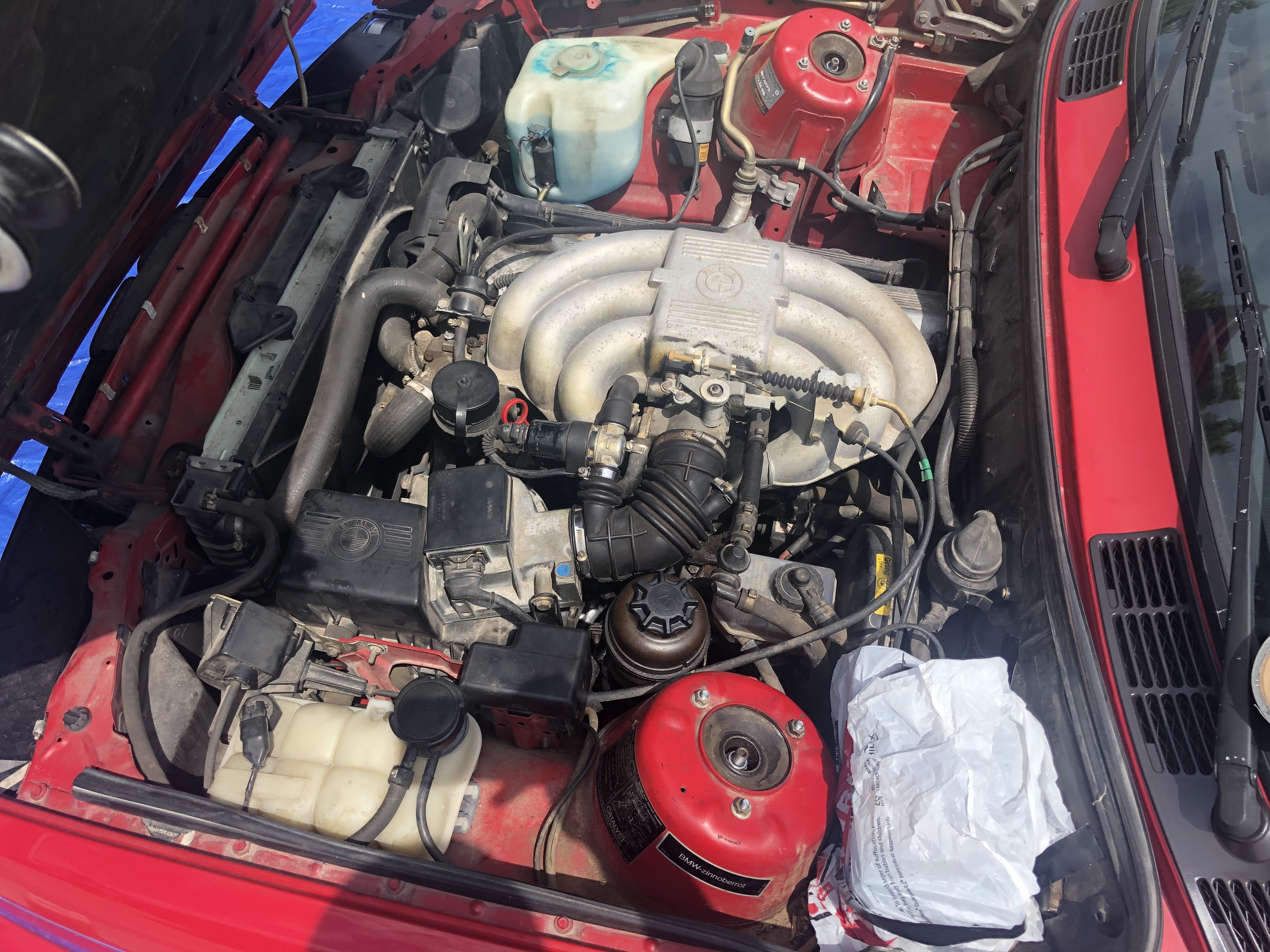

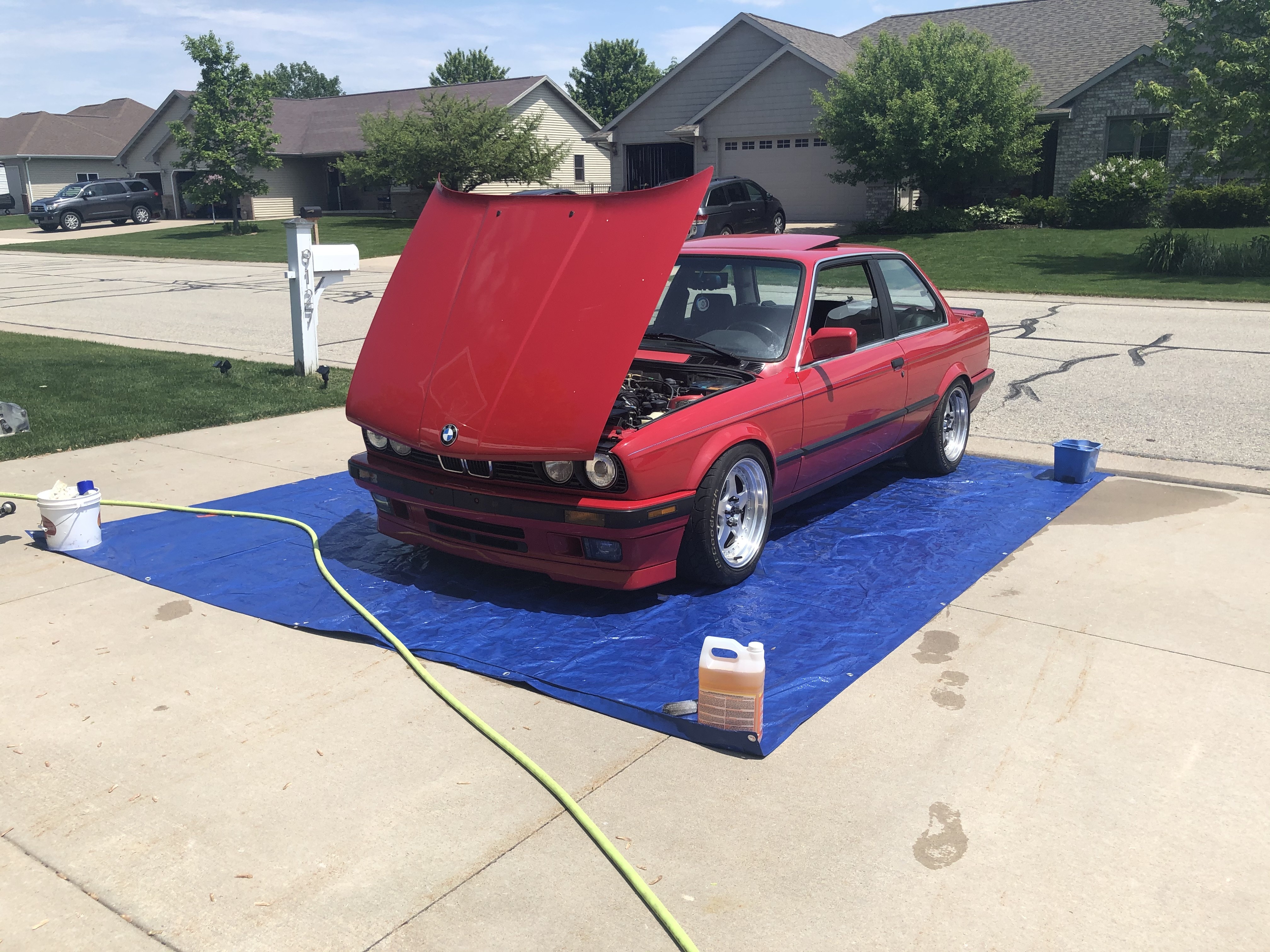

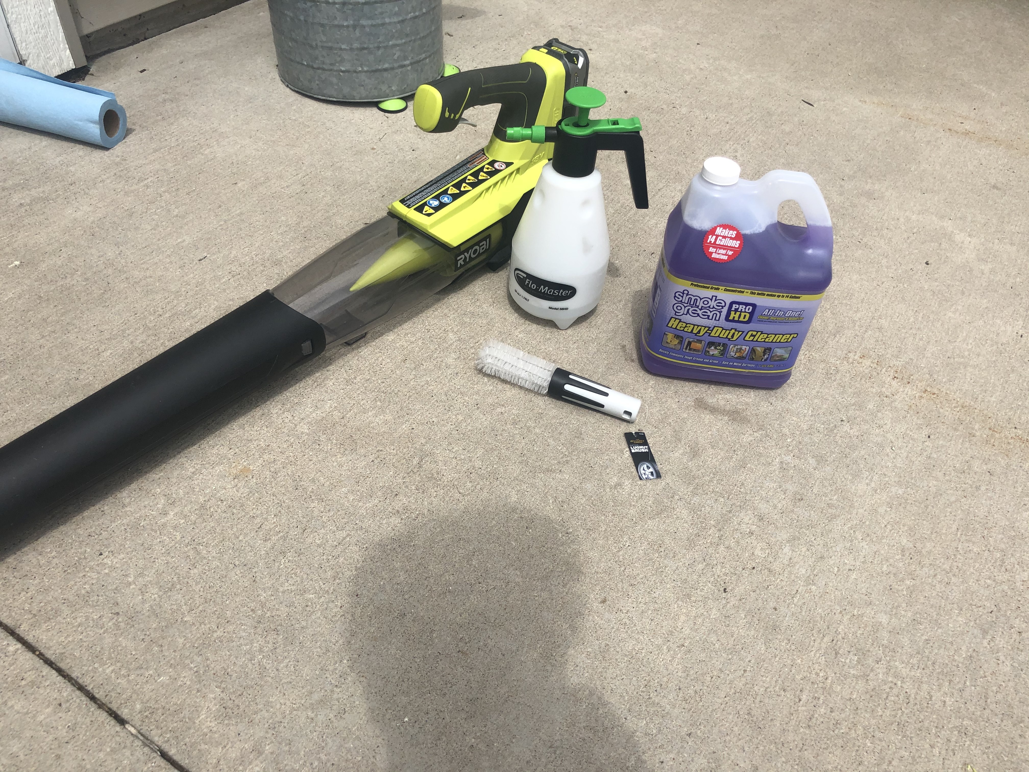

                          Wanted to do an engine bay detail as it was pretty grimey and the rest of the car has been fairly sorted.
                           Materials:
                          Wanted to use Purple Power but they didn’t have it, bought whatever was the strongest. Spray bottle for mixing cleaner. Lug nut brush, wanted something small with a half way been fine and coarse bristles, this worked well. Leaf blower for drying. Not pictured, full can of Gunk engine degreaser.
                          Put a tarp down to avoid staining my parents driveway.

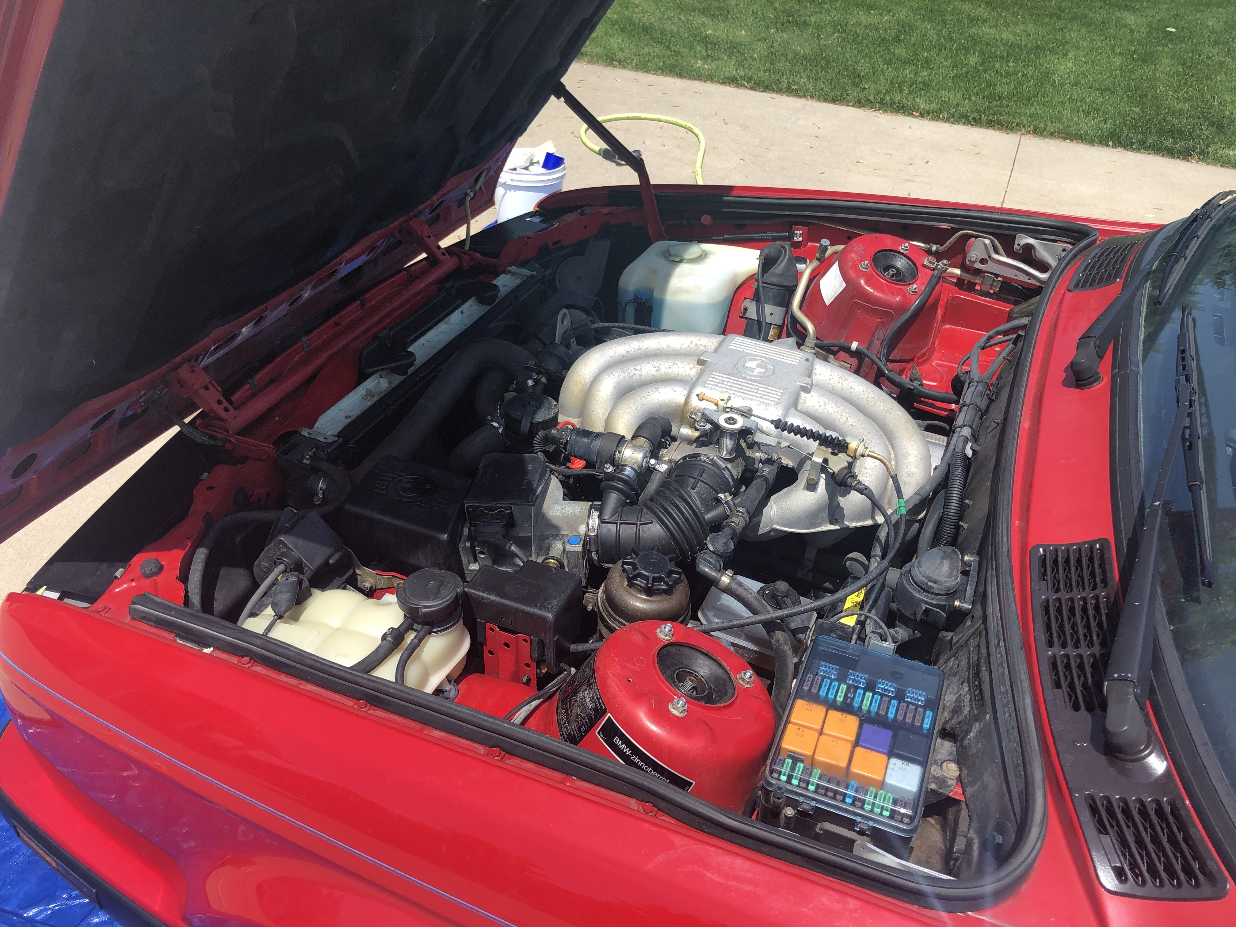

                          Before:
                          I bagged and taped a couple of electrical areas. I was not using a pressure washer, so this was mostly just a peace of mind thing.
                          Sprayed full bottle of degreaser and let sit for 10 minutes and rinsed the bay. Used a combination of the spray cleaner and the brush then to do a more thorough cleaning.
                          Blow dry off.
                          After:
                          Is it perfect? No. Am I satisfied? Yes.
                          Currently air drying with the hood open before starting. Car is going to need a wash to get the grime that splashed off during cleaning.

                            The crab and the valve cover need a nice bead blast. The cosmoline is always a jerk.
                              #154
                              Indeed. My buddy has a sand blaster at his shop I’m gonna see if I can use before I give them the universal wrinkle black coat
