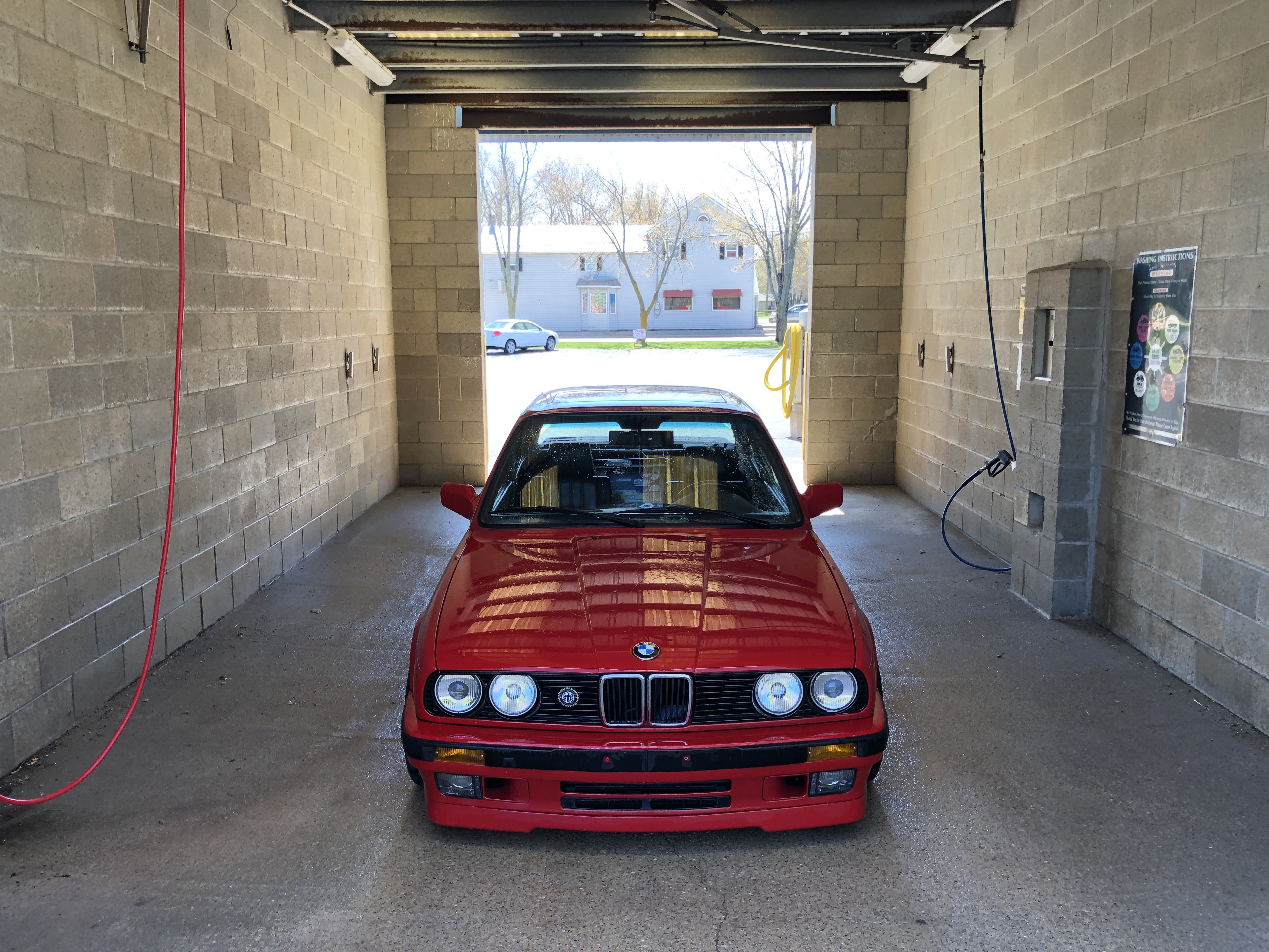

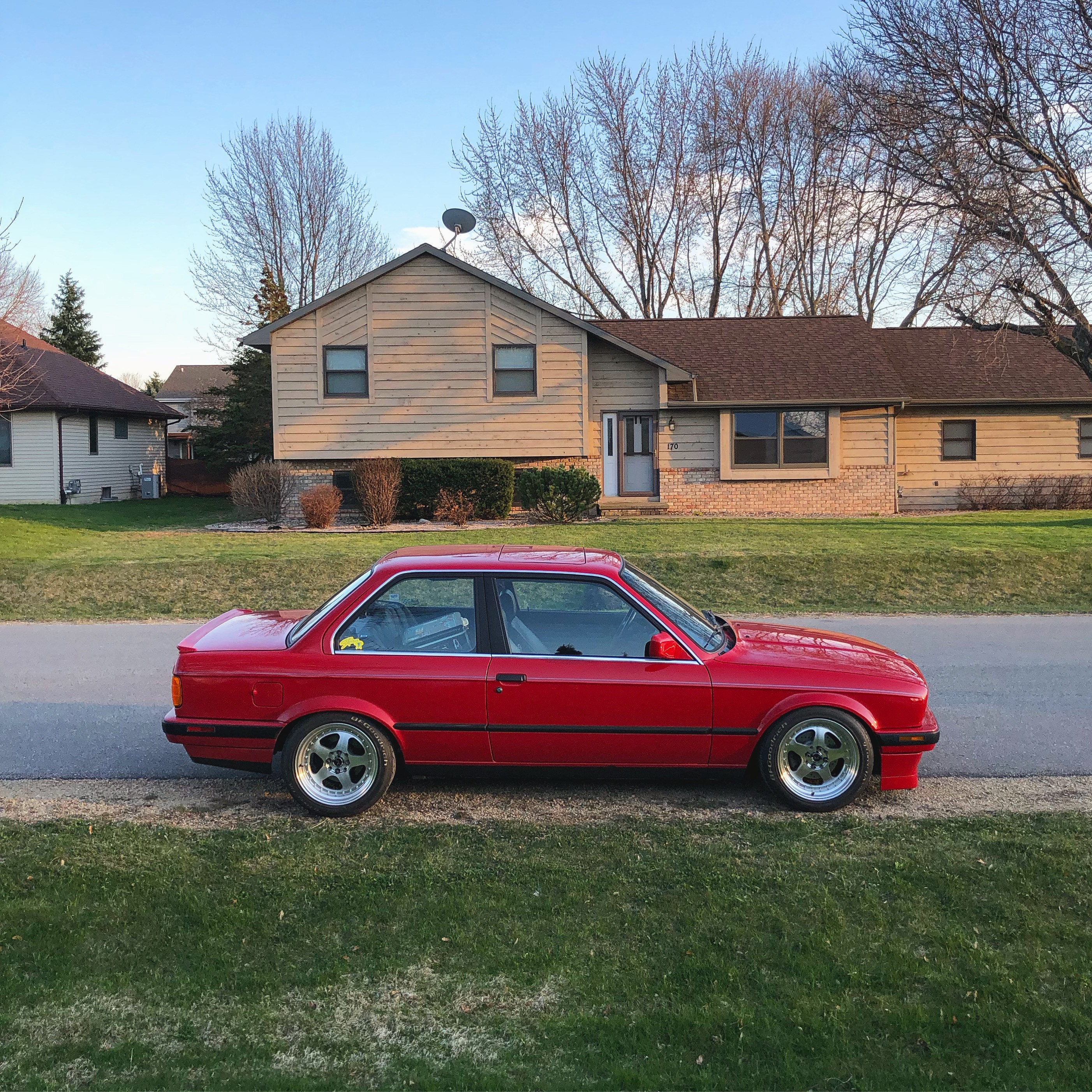

        Real nice day out today. Got the rear valence painted and swapped the rear stud conversion from the Calypso car to the red one.

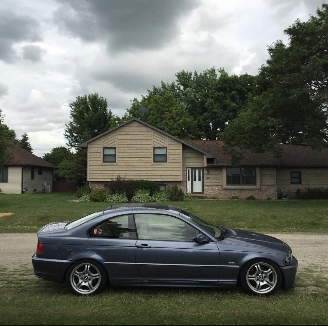

        Then vs. now, miss the E46
