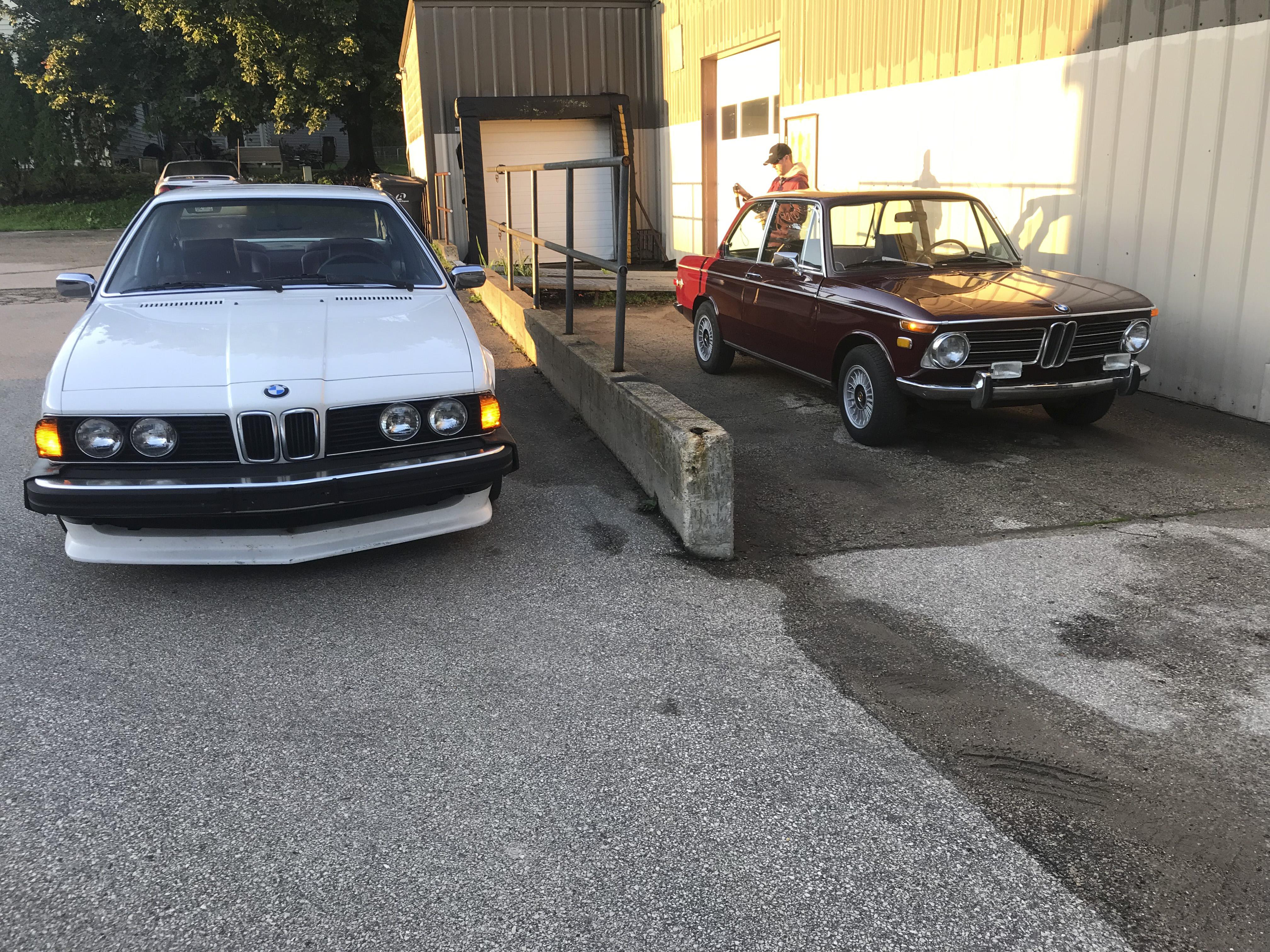

Luckily, to soften the blown on my time and wallet, this was a joint purchase with a friend of mine who is also a car fanatic.
The details are as follows:

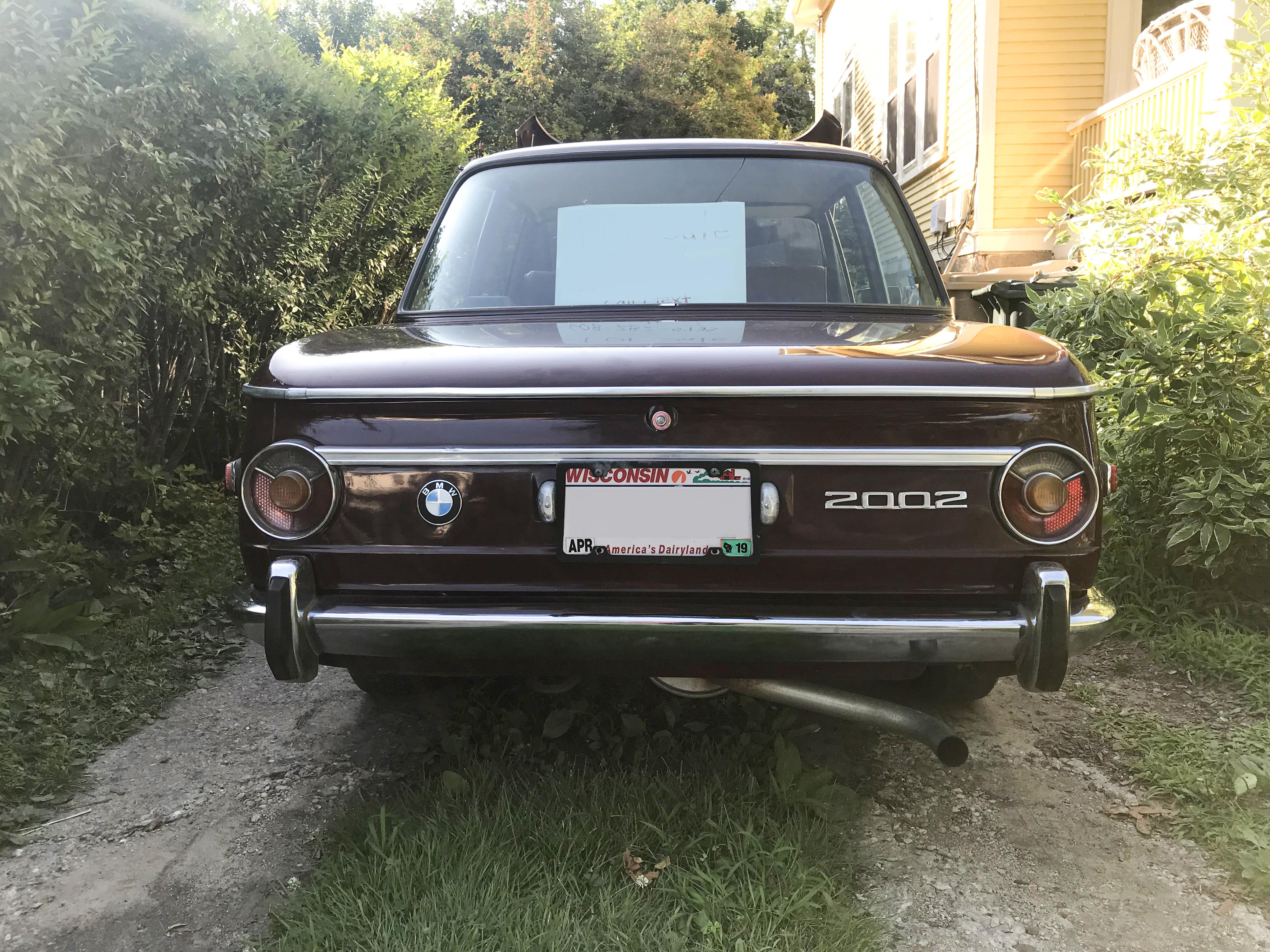

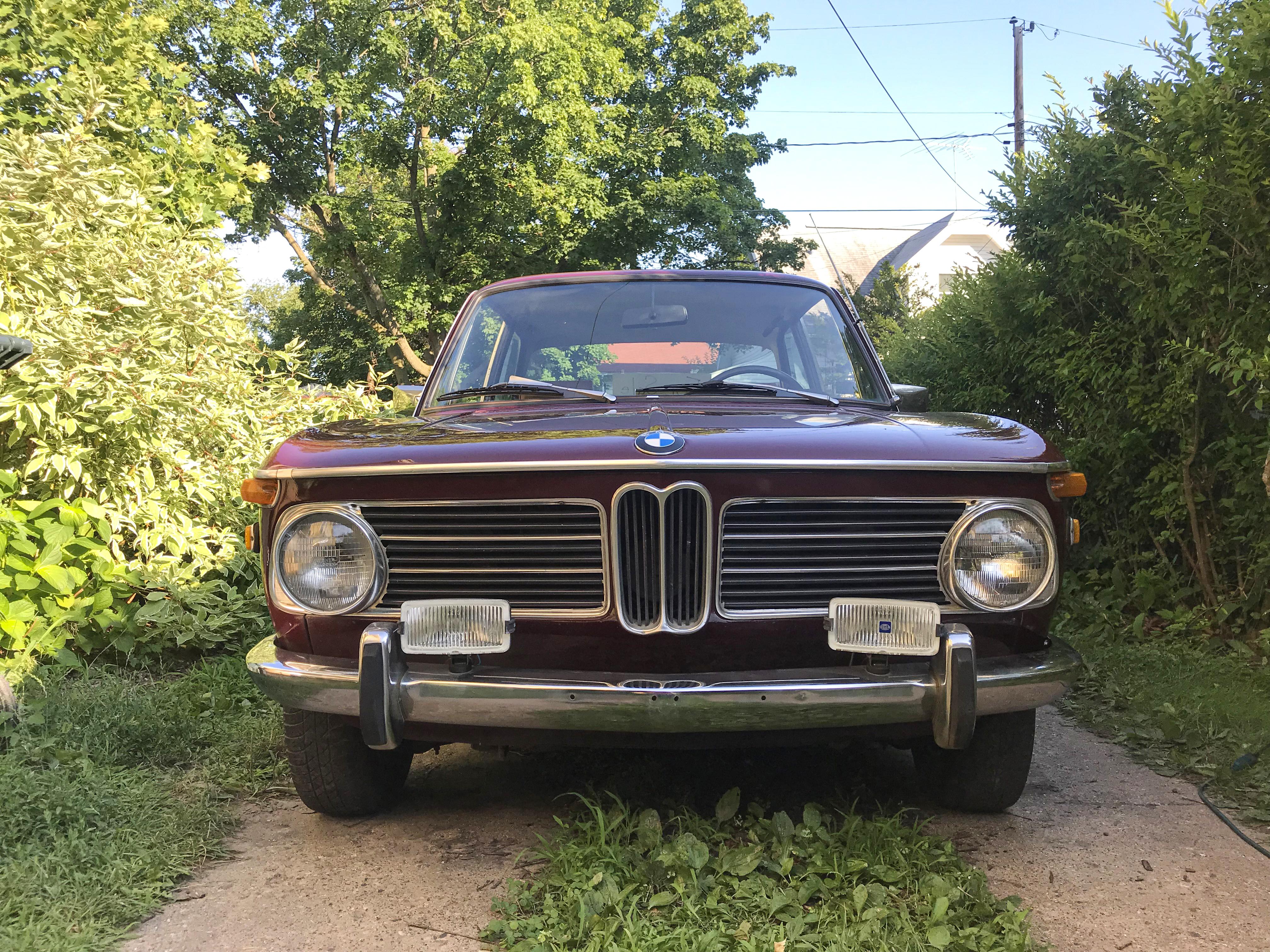

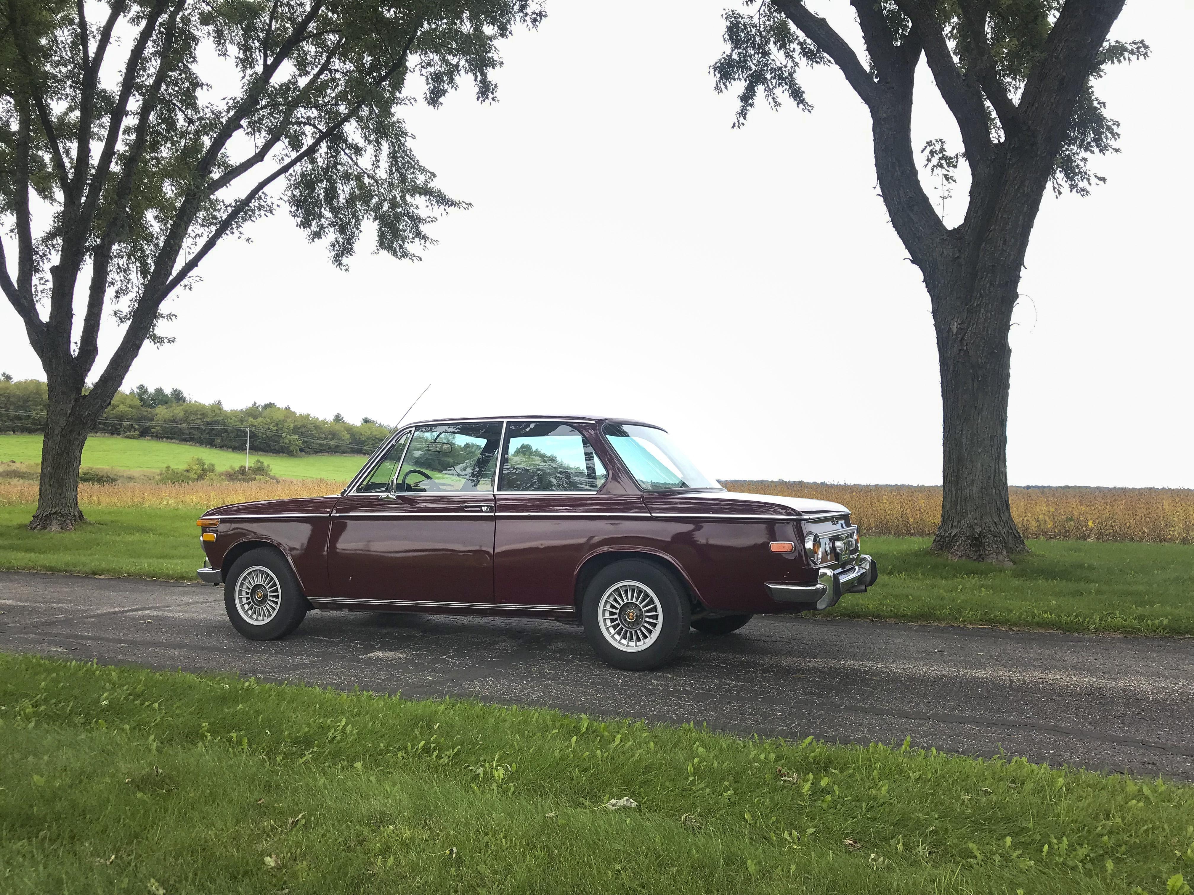

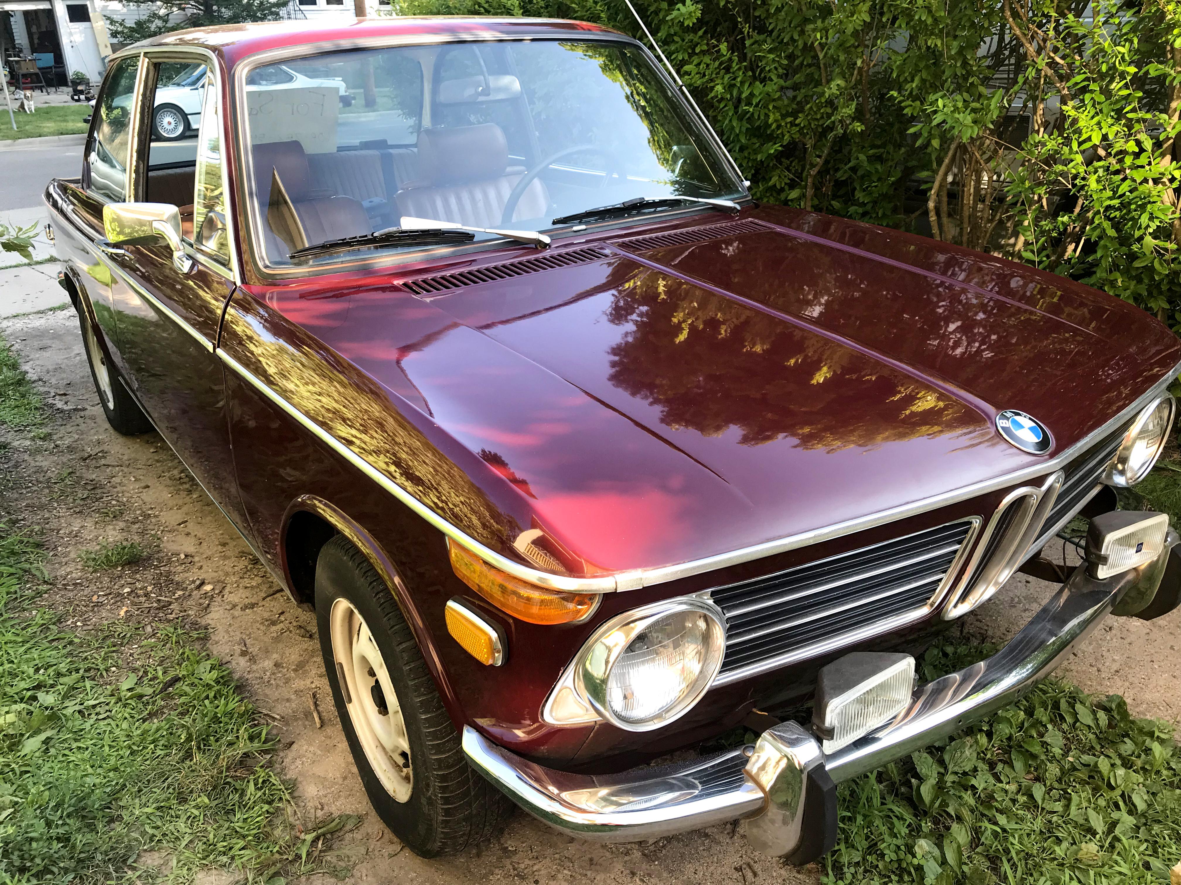

1971 early model (1970) BMW 2002 roundie in malagna over tobacco interior. The car is pretty much stock besides a dealer added AC system and an aftermarket head unit.
The plan is simple, clean, clean some more, and fix the mechanicals that need fixing.

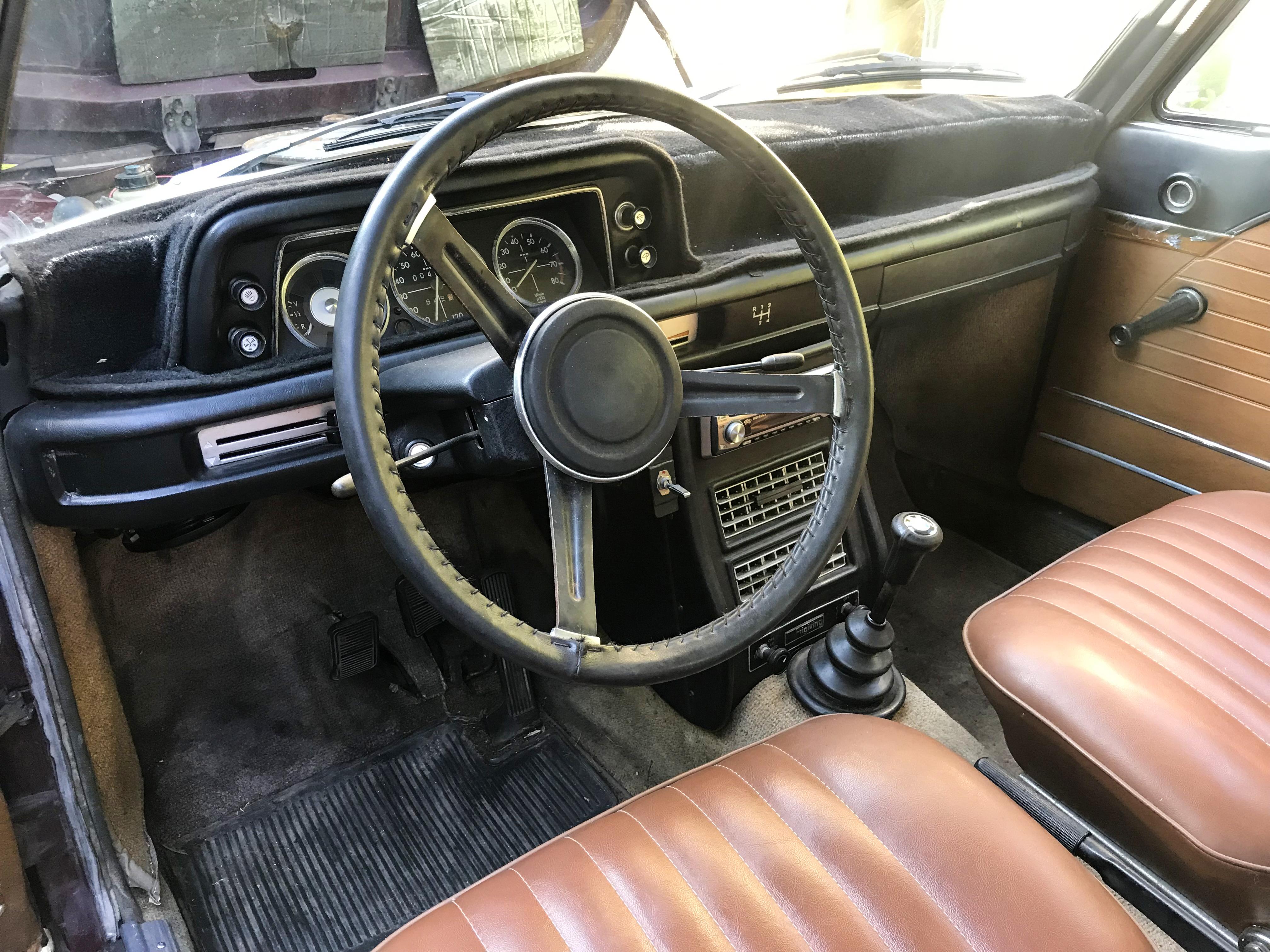

This thing is so cool. What is under that hideous dash rug? Hopefully something less hideous.
It's been awhile since I've seen the Move, but shouldn't it be "From all of us here at......" ?
1. A dash that is going to crumble if you as little as sneeze in the front seat. Luckily it came with a spare dash.

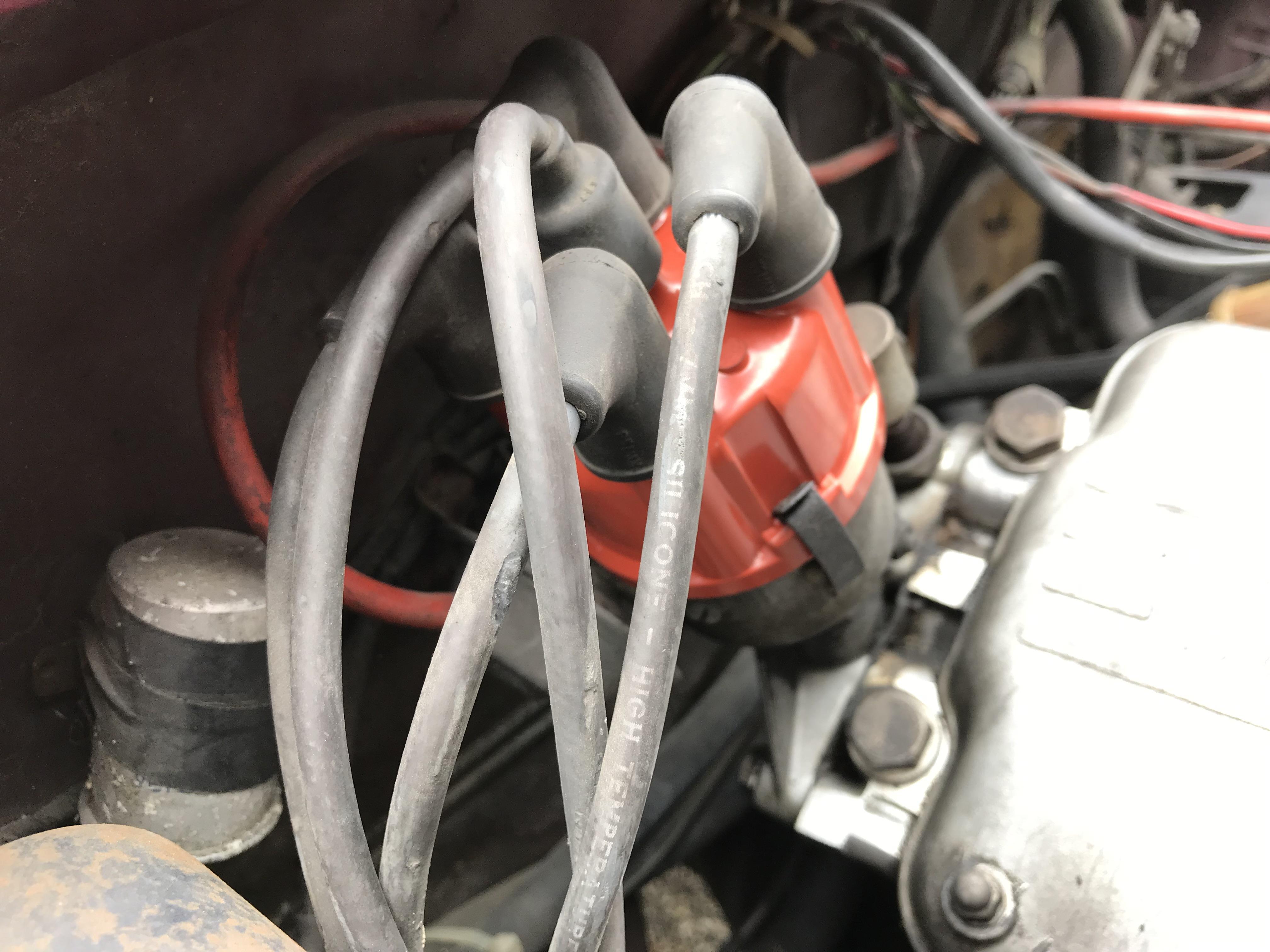

I already managed to install the battery, cap and rotor, and I cleaned the brake fluid reservoir and added fluid. After doing so I took it for a drive, massive improvement. The car ran better, the brakes worked better, and the dash light was now off. I also tried the AC again because of @YoungCR and his silly question if it worked or not. SHOCKED it works really well somehow 48 years later!

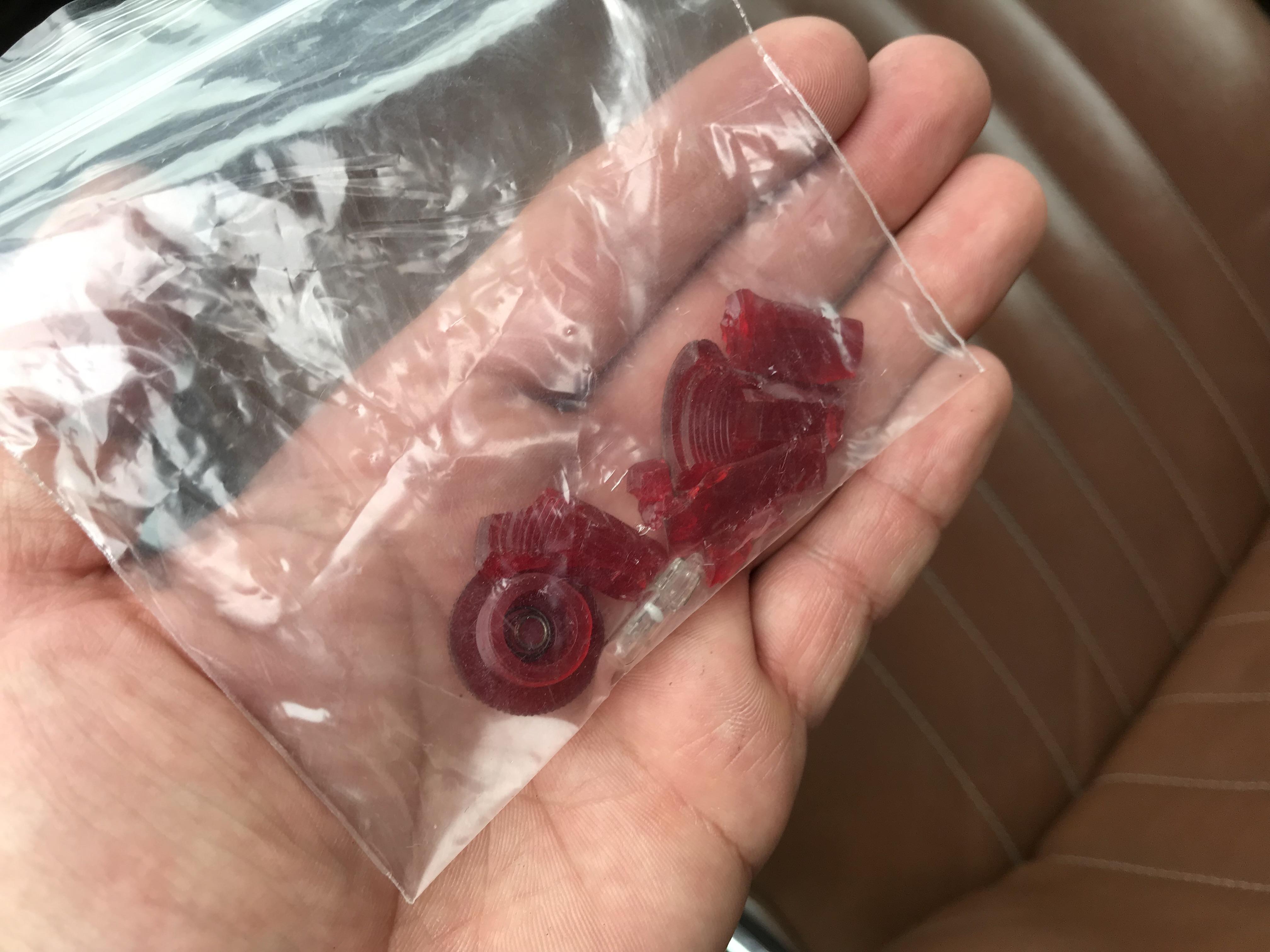

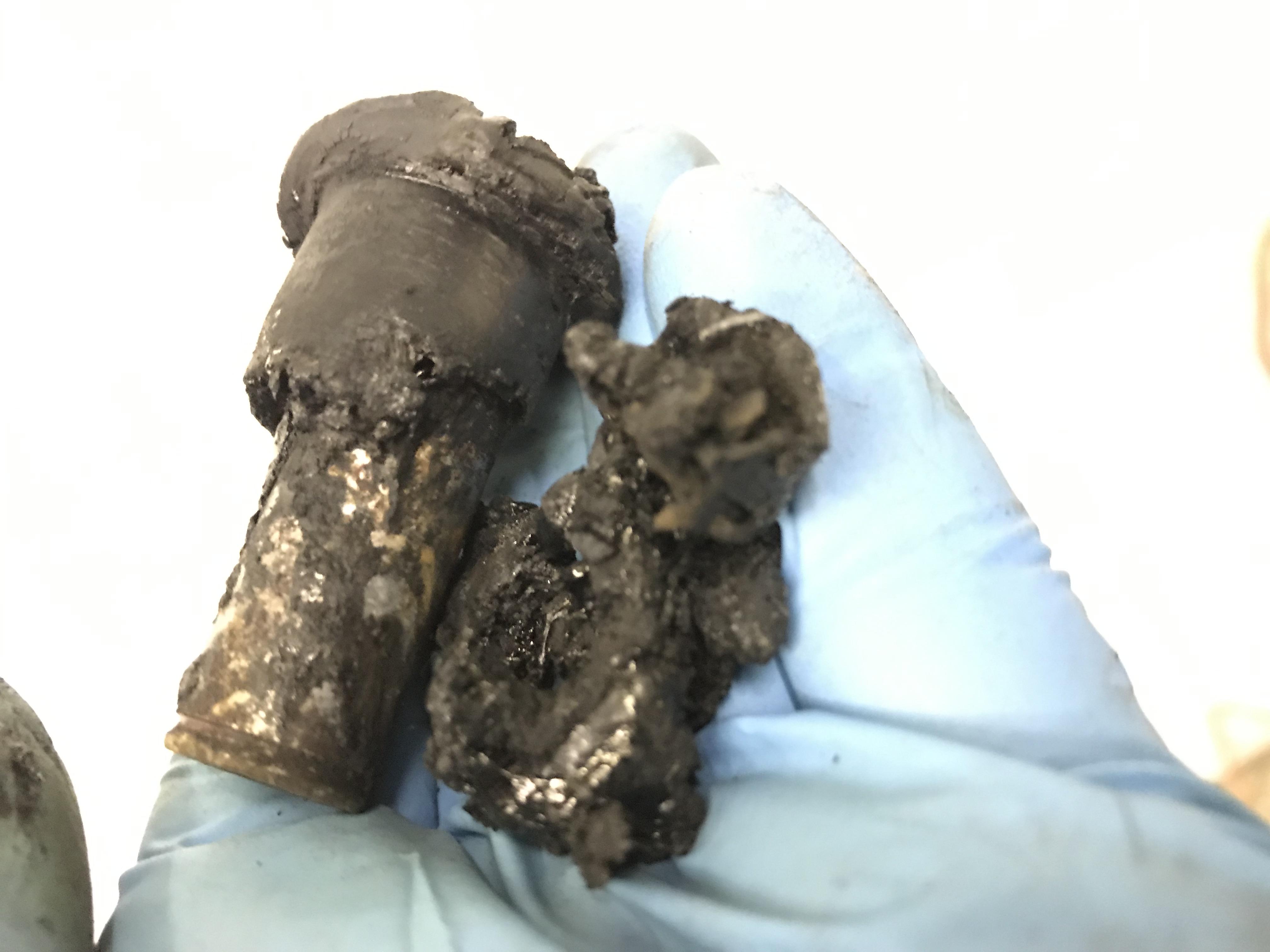

I still need to source a hazard switch though, here is what remains of the one in the car;

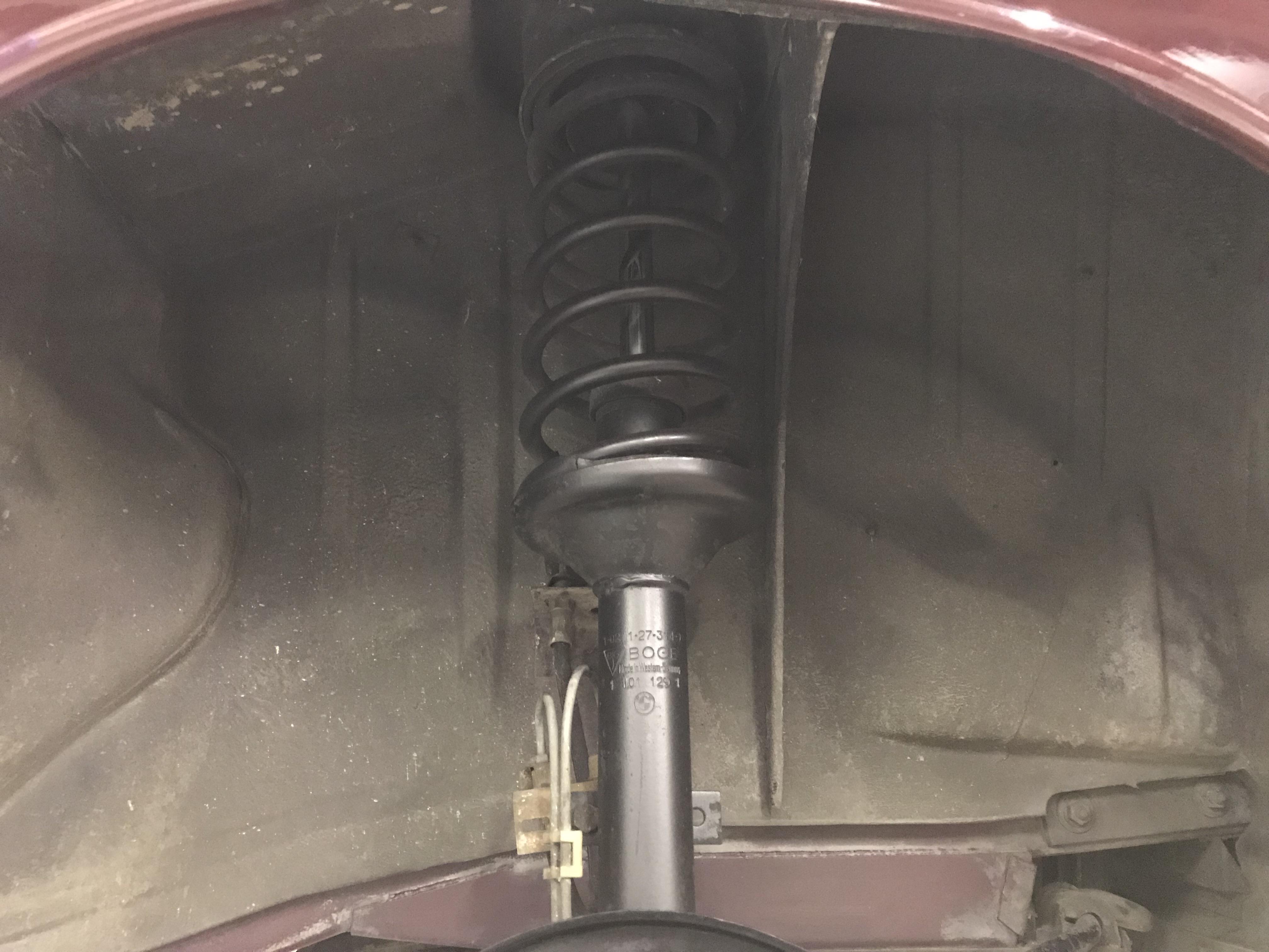

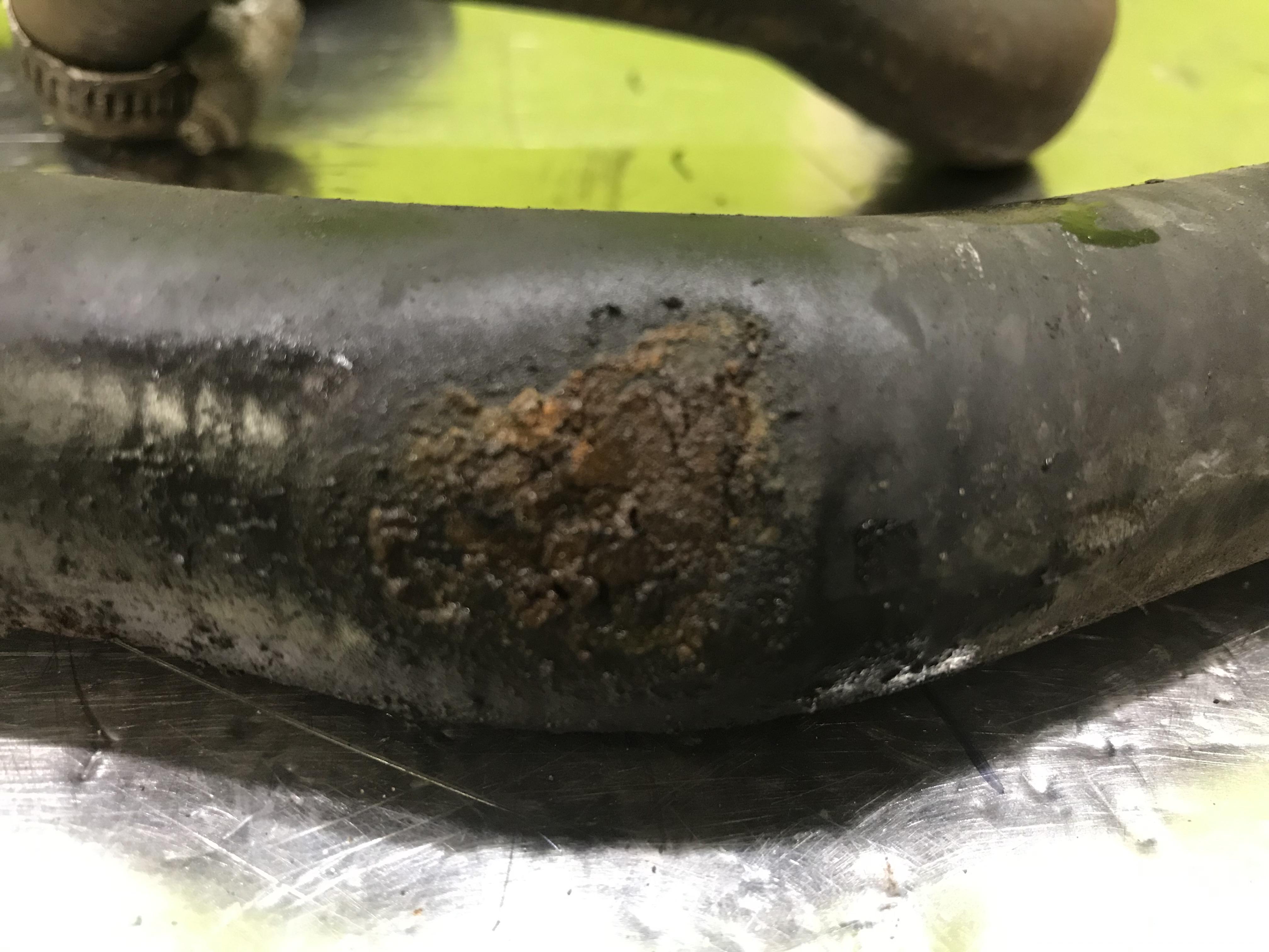

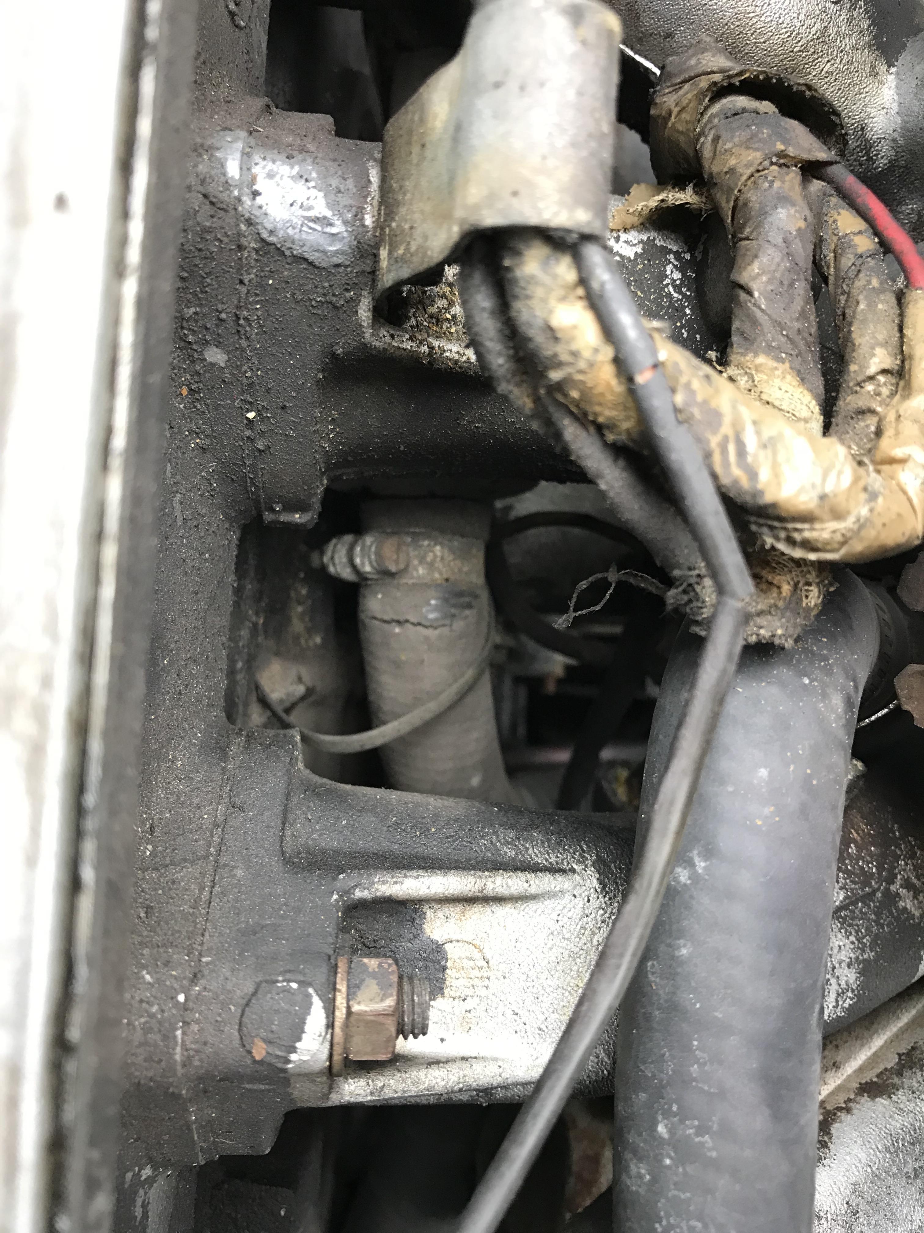

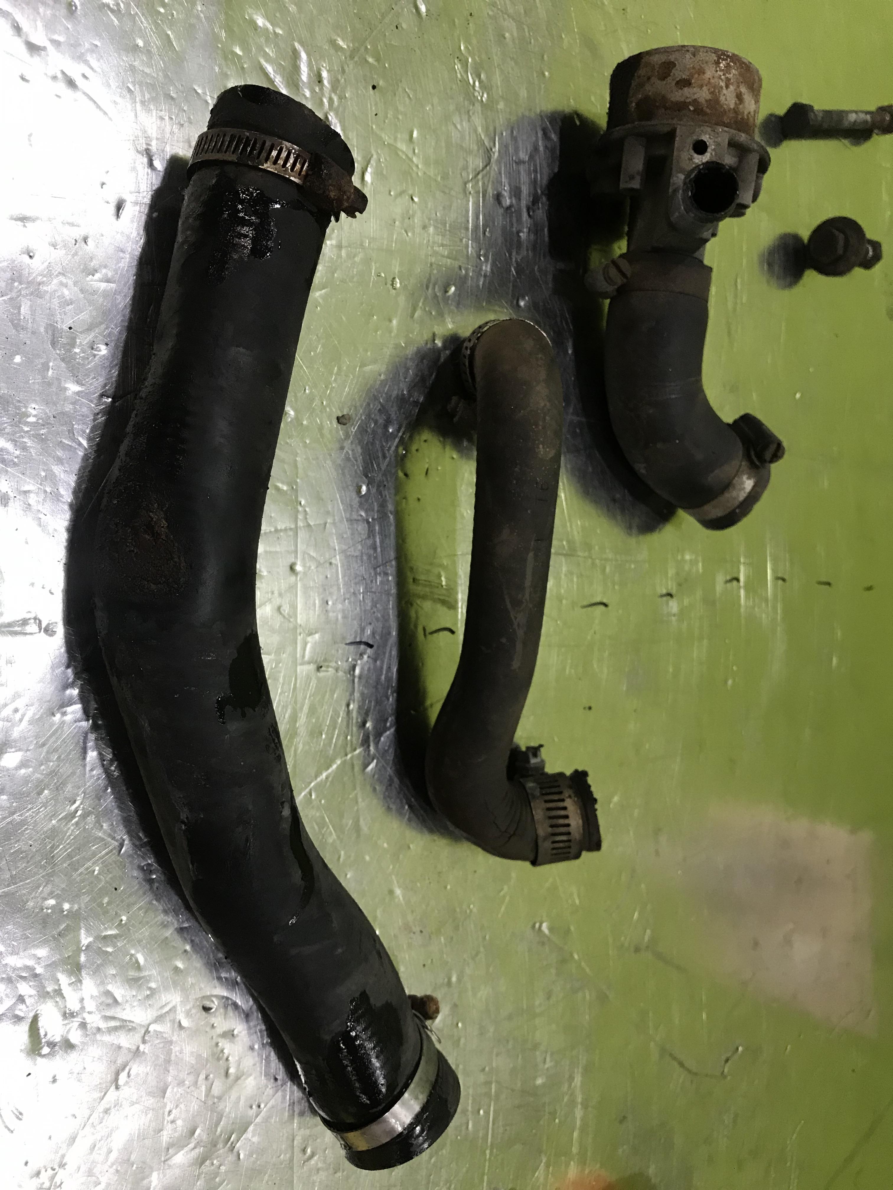

and there are alot of random hoses I need to replace. This one is a coolant hose;
New Cap and Rotor! (also fits a Opel Manta if you want to find a Bosch part for cheap

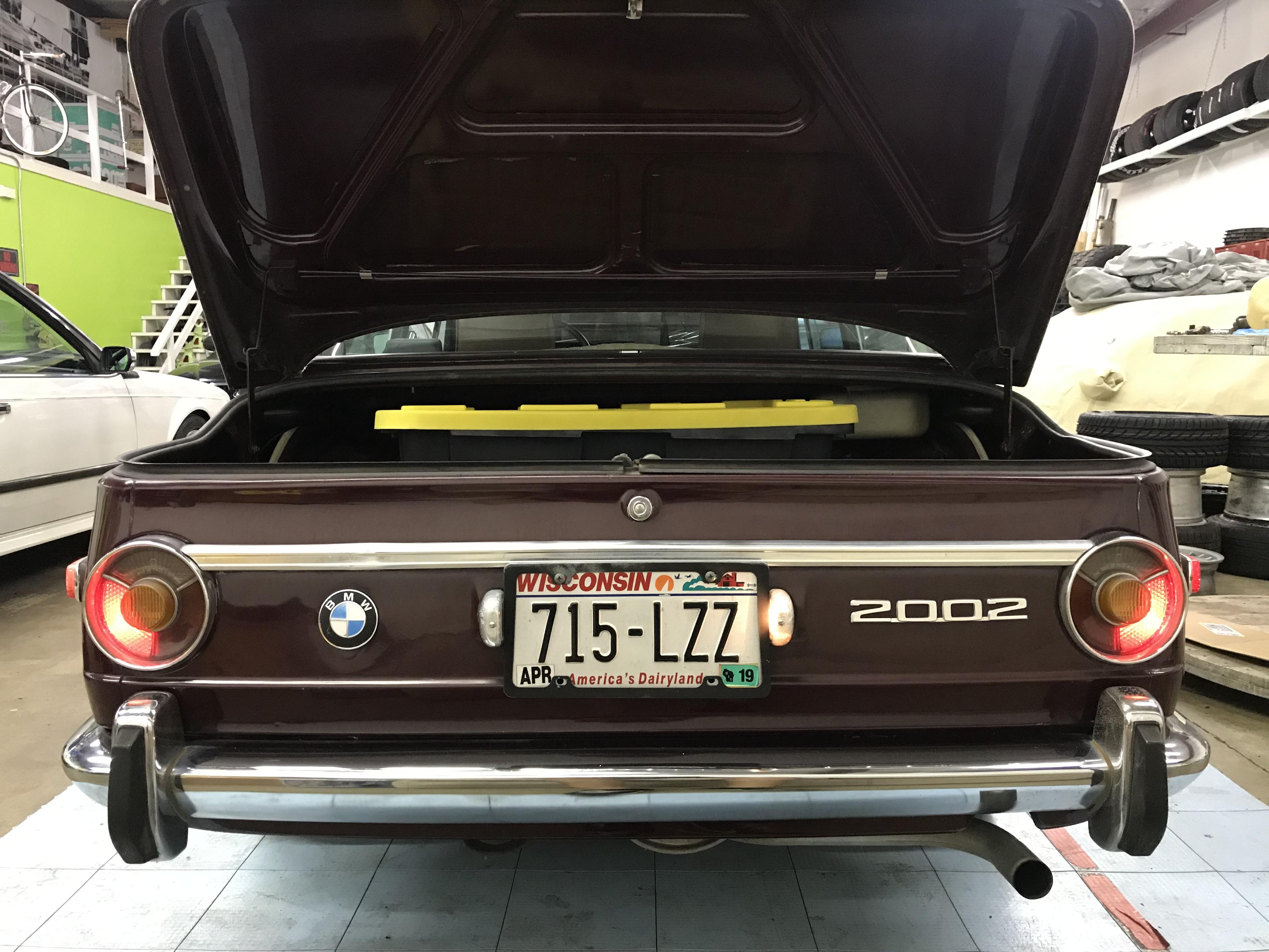

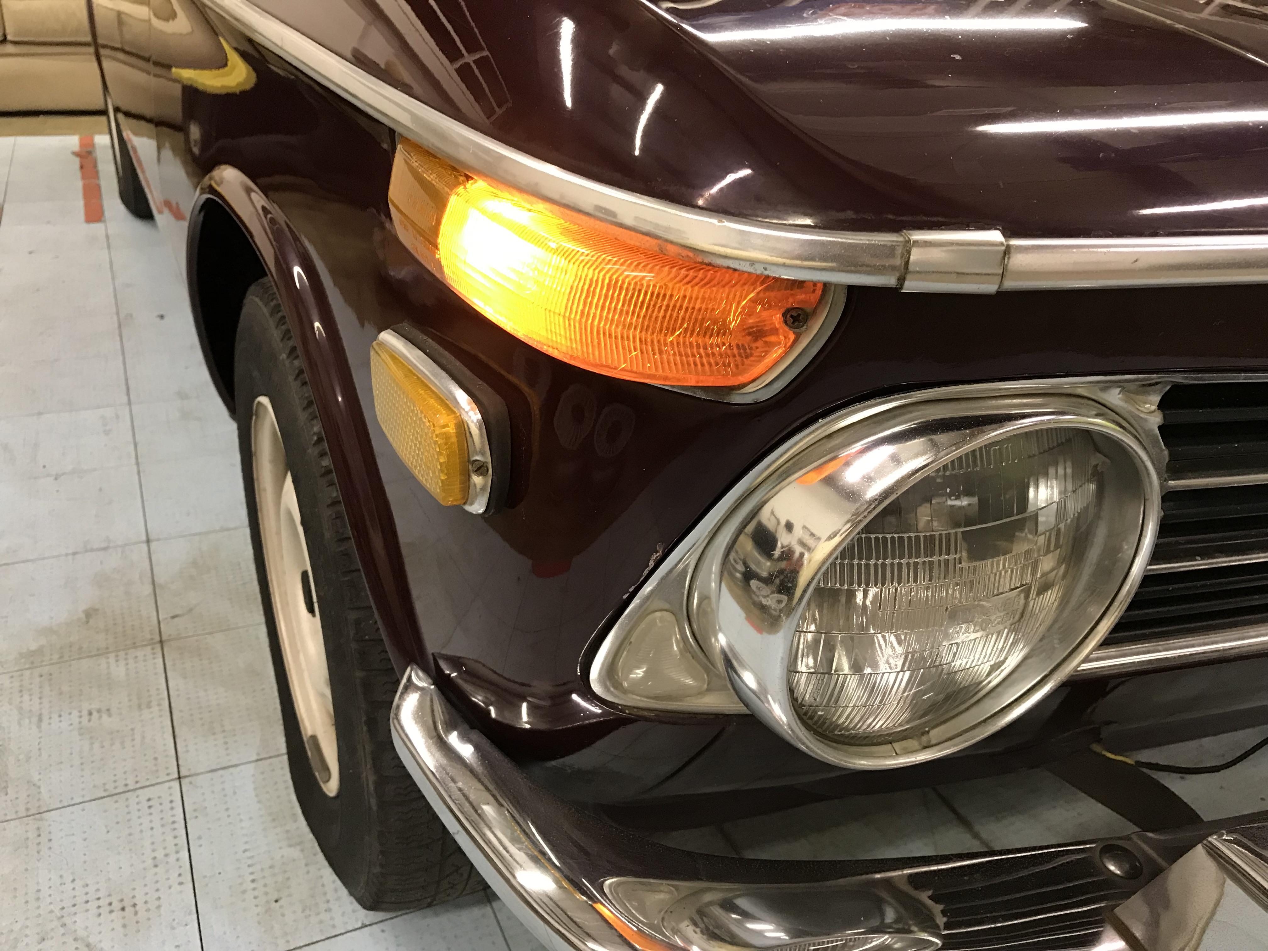

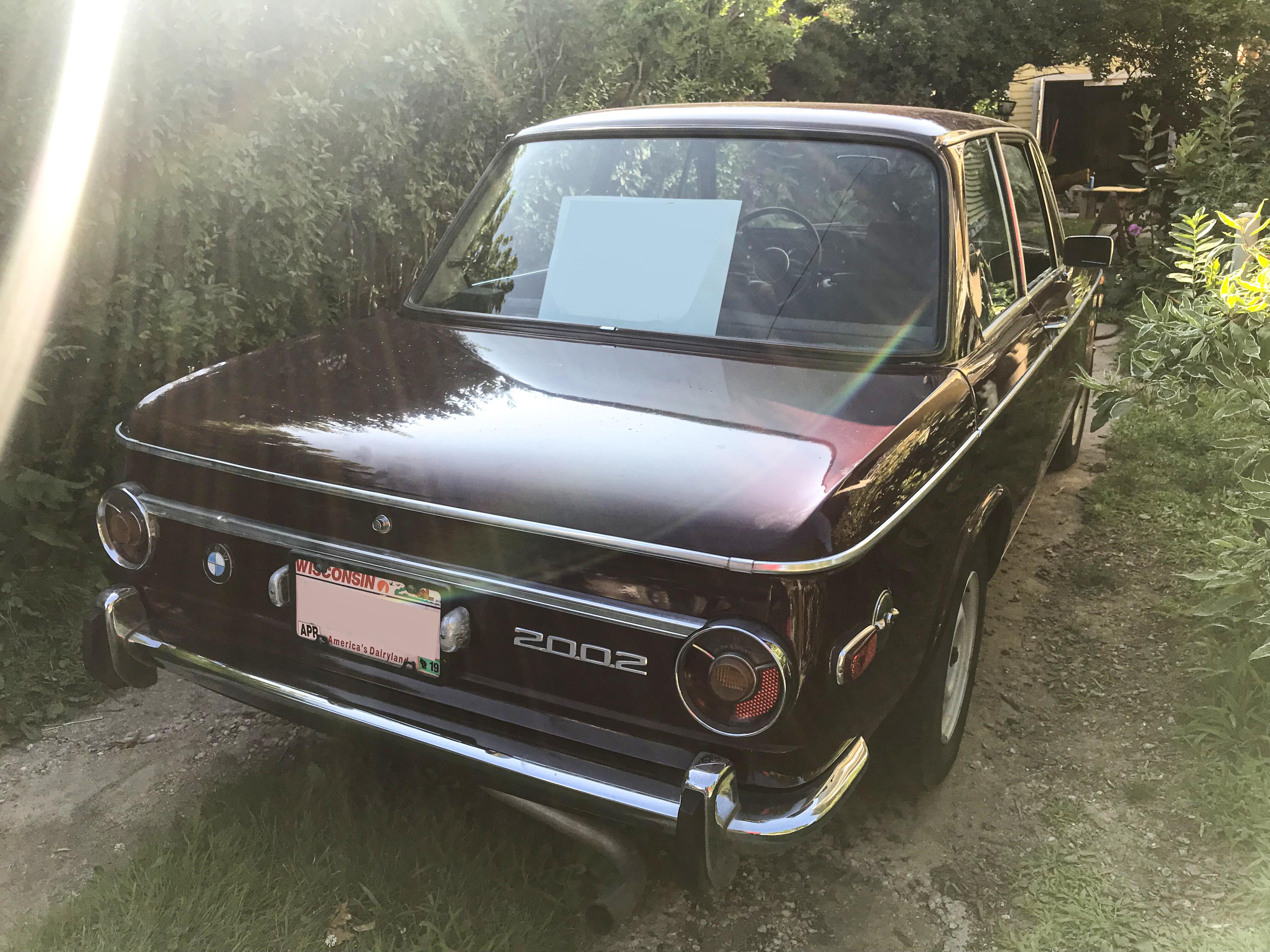

Attacked the lights on this last night. Previously it had only one tail light, one brake light, the turn signals worked on one side of the car, and the front indicators did not work at all. After a total of 2-3 hours, removing super glued bulbs, corroded bulbs, lots of wire brushing corroded terminals and rusted connections, I have fully functional lights at all corners of the car!
**Fun fact, 2002's use the screws in the front lights to ground themselves, If you test them not screwed to the car, you will really develop a headache.
(don't mind the license plate light, I fixed that too)

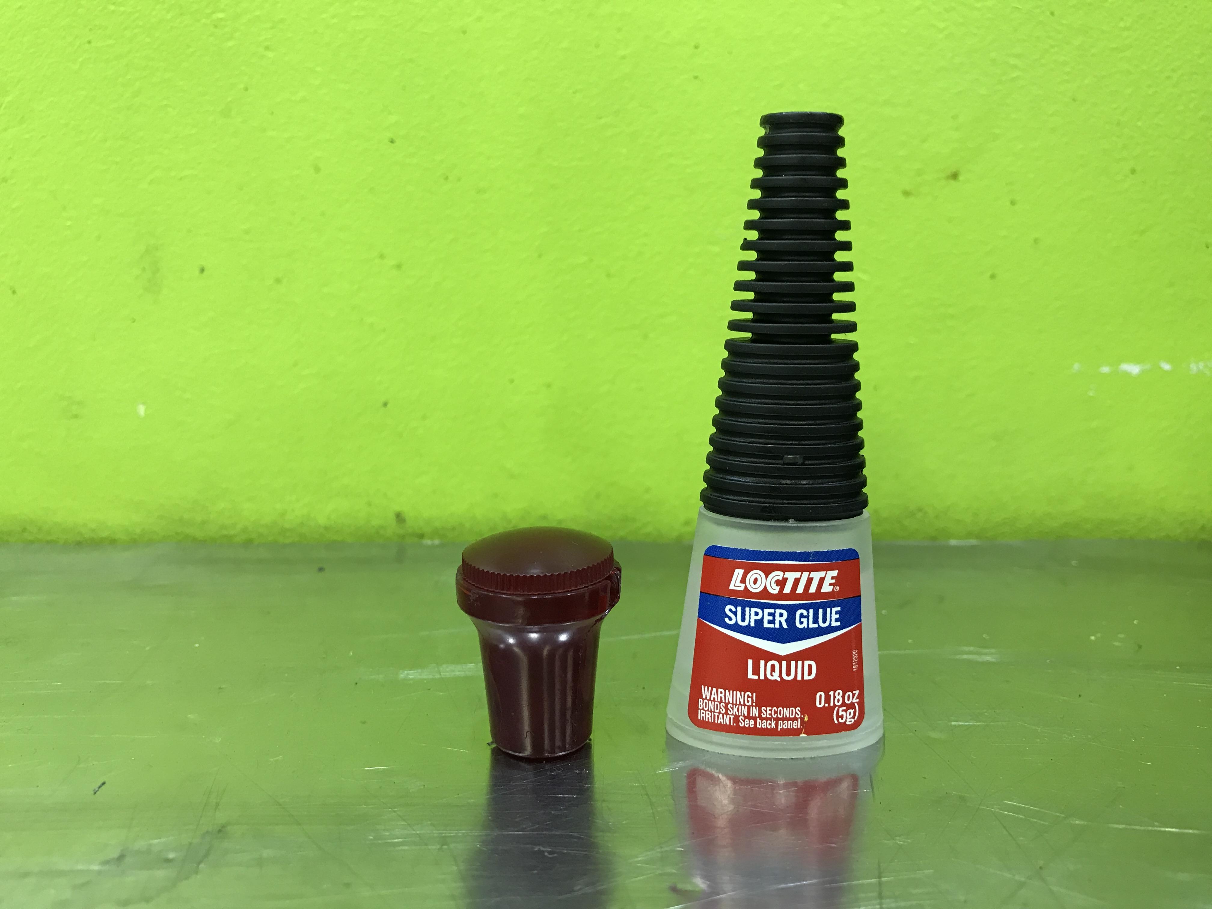

I also glued all of the parts of the hazard knob back together and "had" the hazards working. I think the switch might have a bad connection internally though, so I will have to revisit that when I swap the dash out.
If the hazard switch is anything like the e21, it will break the moment you look at it and never quite work properly EVER
Its very similar, but this is an early model so its much worse actually. LOL

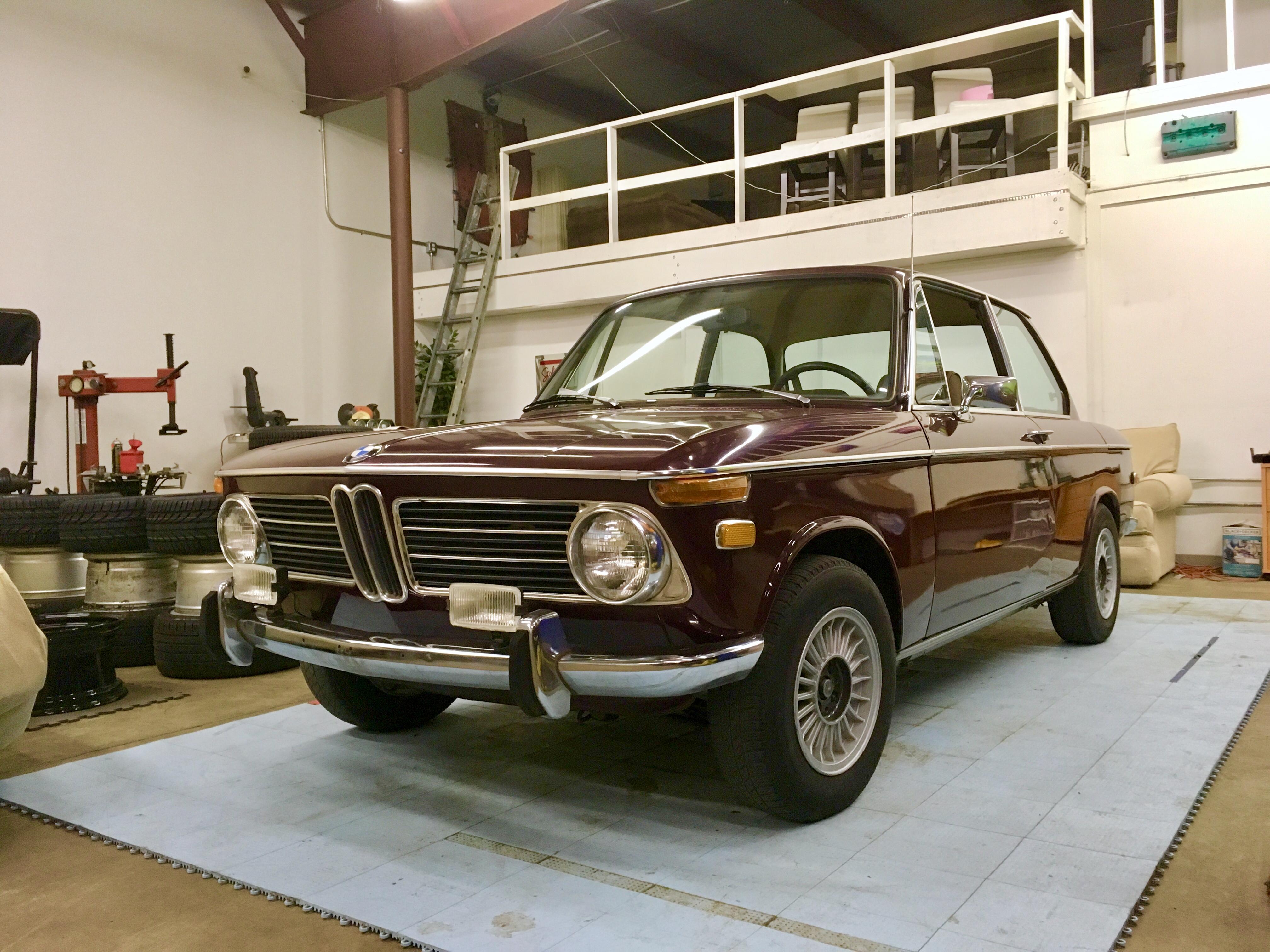

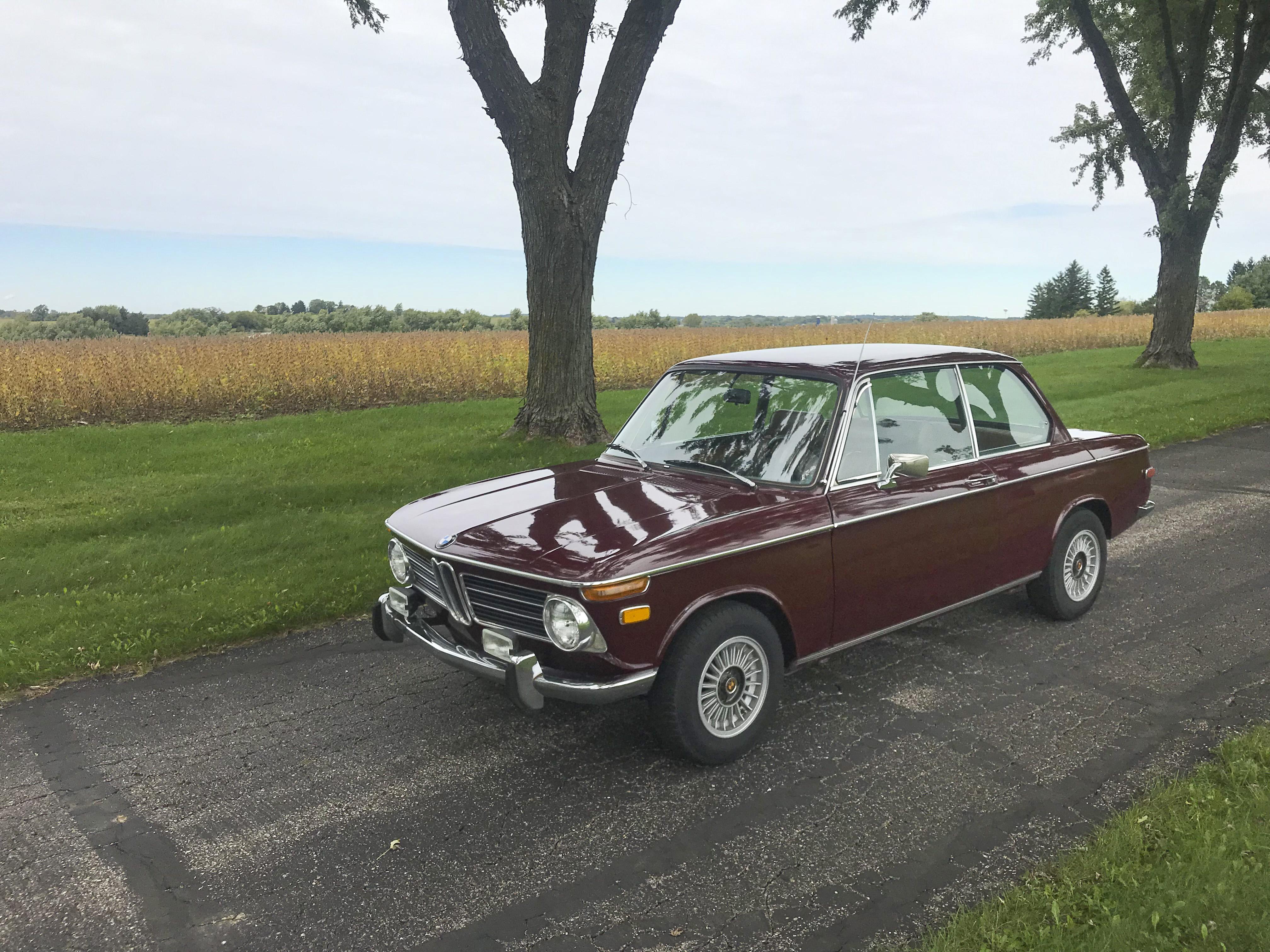

Ron got some love last weekend.

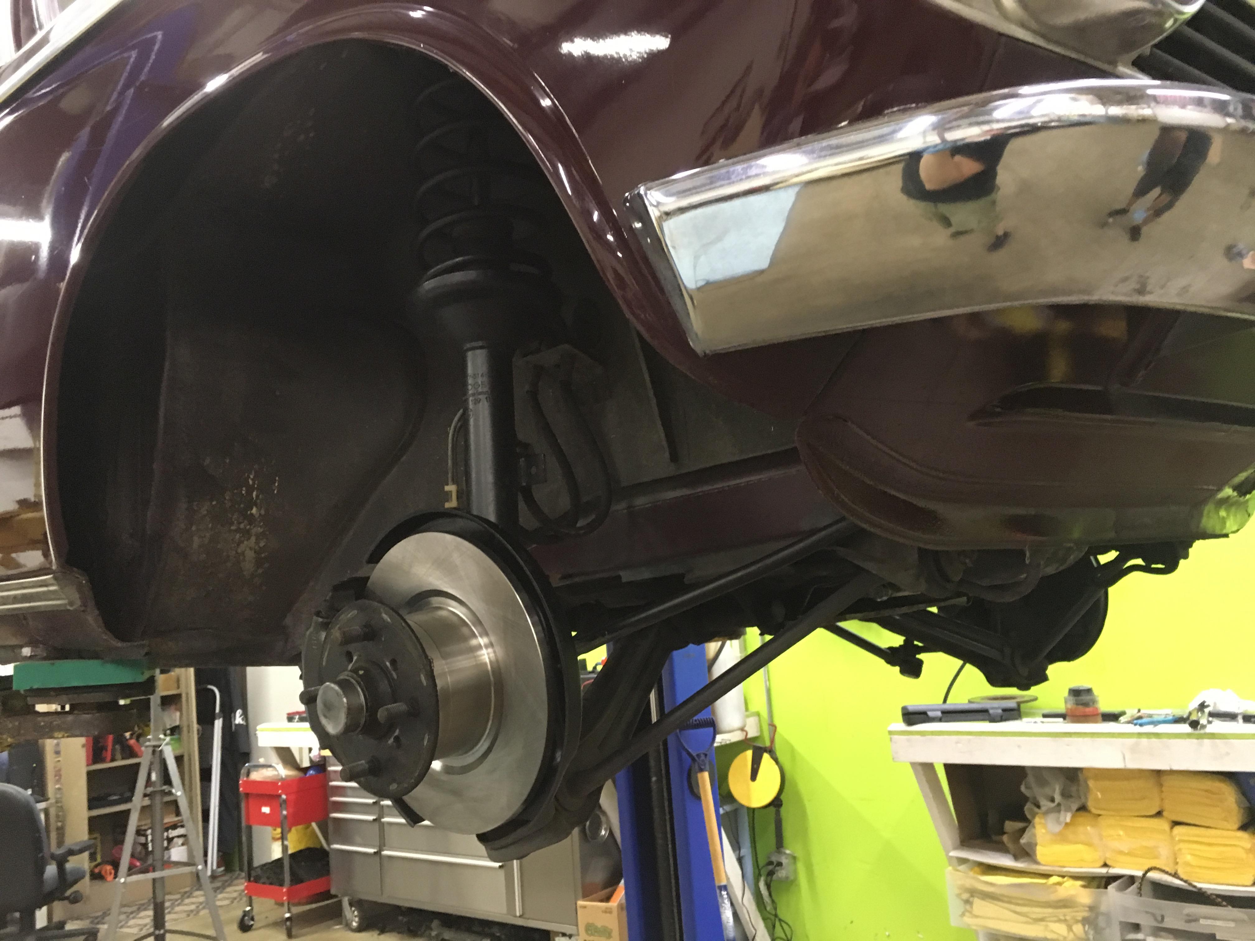

- New brakes
- new wheels
- new center caps
- New shifter delrin washers
- New exhaust hanger and fixed the muffler
- New tie rod ends
- Repacked the front wheel bearings
- Lots scrubbing and a little paint where needed to freshen things up
- New window crank

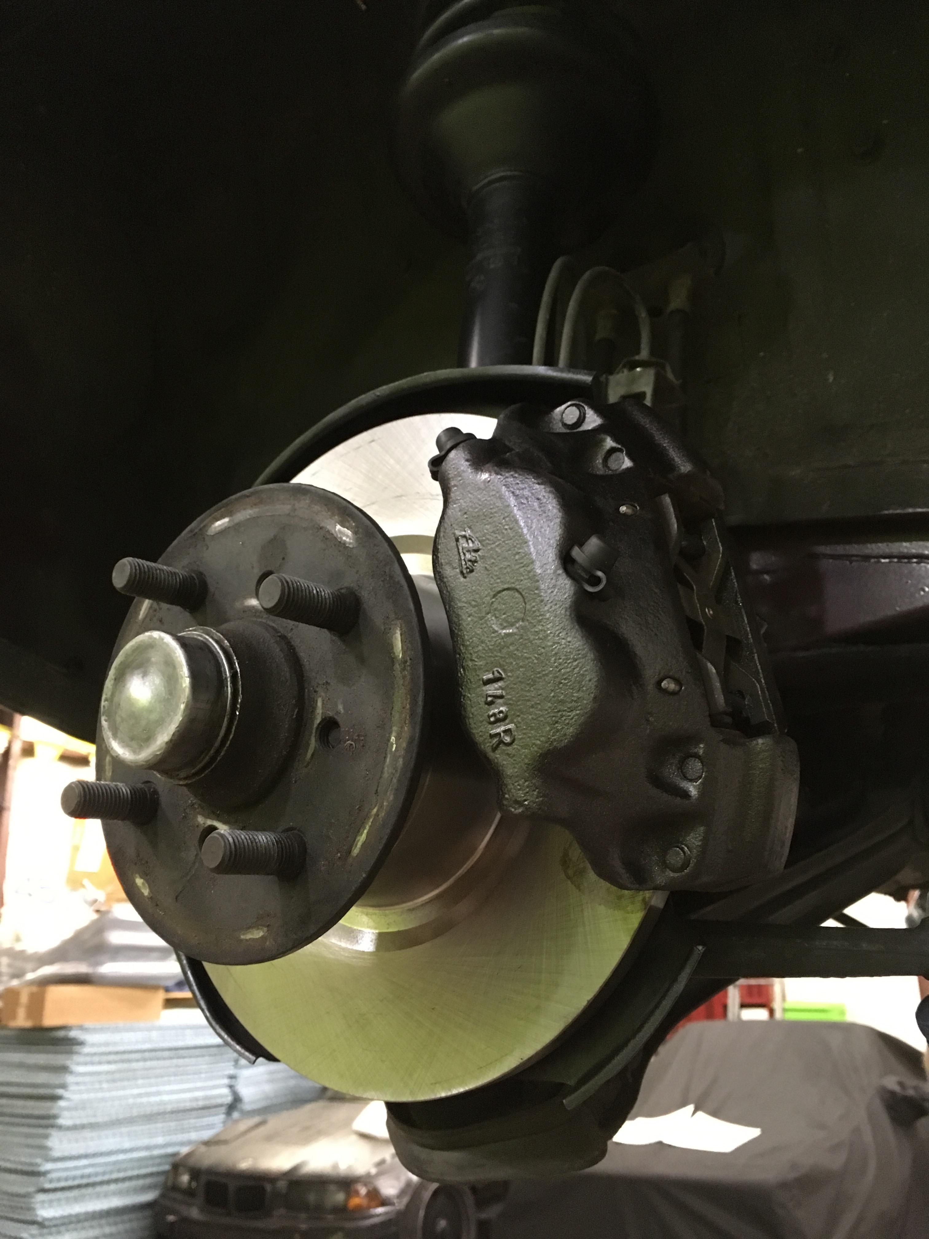

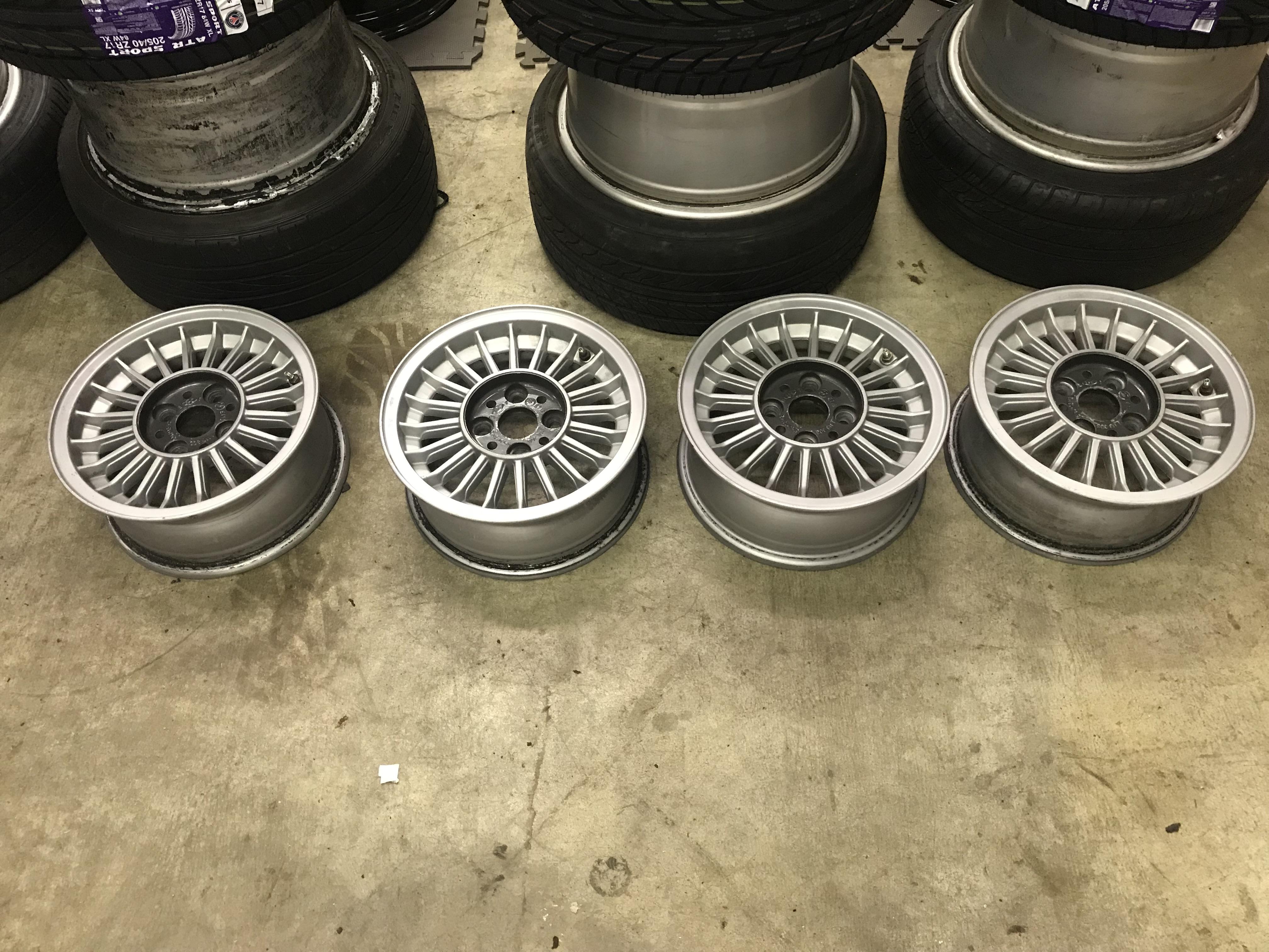

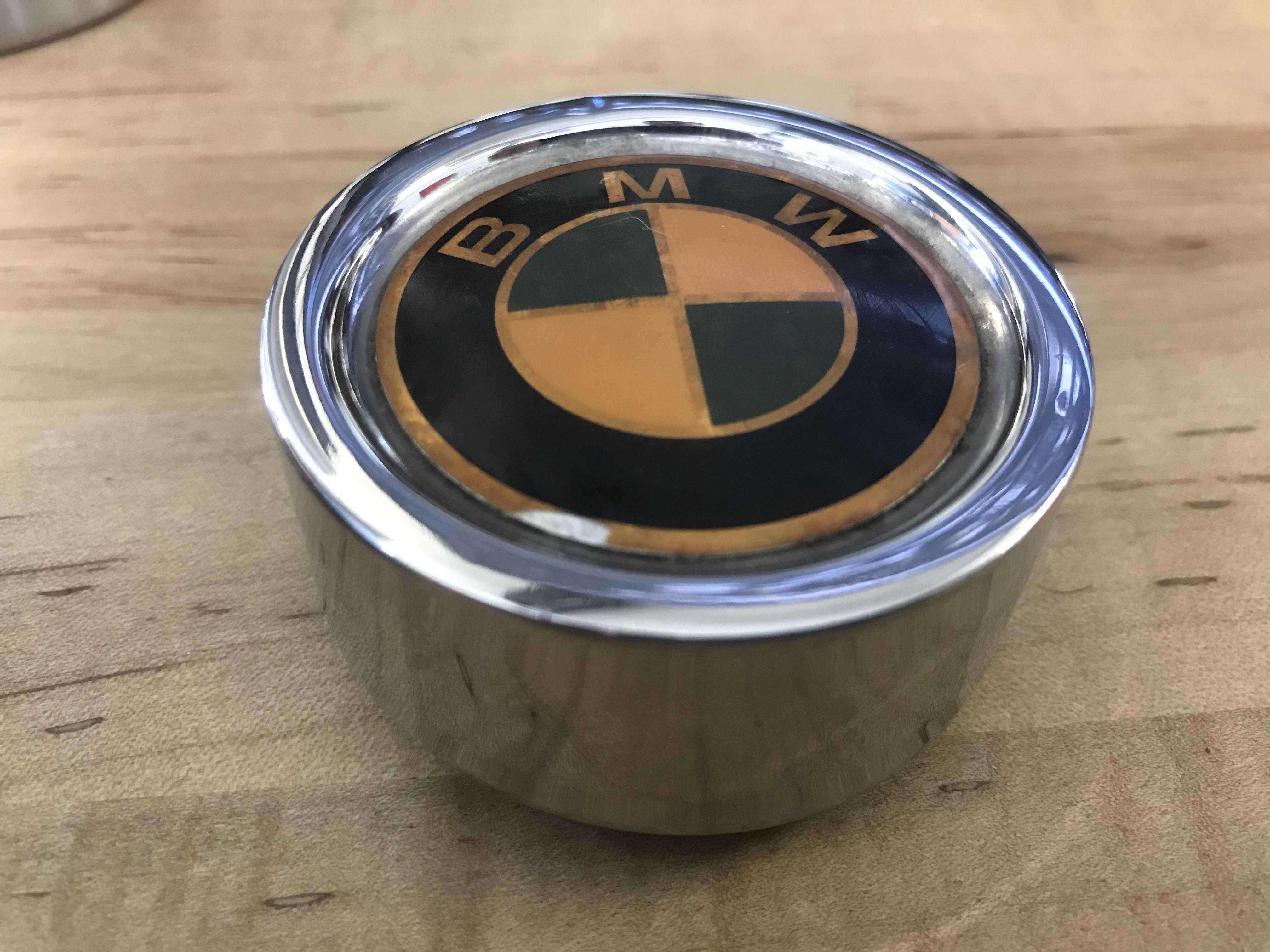

My friend swung out to get a new set of alpina wheels from "Ralph" the BMW guy I bought parts for my E24 from. He manage to also grab a window crank and a repair manual while he was there. The wheels didnt have center caps but I luckily found some on eBay. The centers are a little yellow which is common, But I will see if I can find some way to polish the yellowing off. The rest is pretty straight forward, a standard brake job and cleaned and painted the calipers / hubs. I spent a good amount of time under the car with a brush and degreaser. It was amazing to just spray and wipe sections clean and find nice paint underneath. This car is in amazing shape, Im honestly baffled.
Sadly my tire balancer died so I need too figure out how to fix that. I spent a good 4-6 hours on Sunday messing with it. So the wheels are currently not balanced, but I fit them on the car for now and noted that they need to be take care of.
