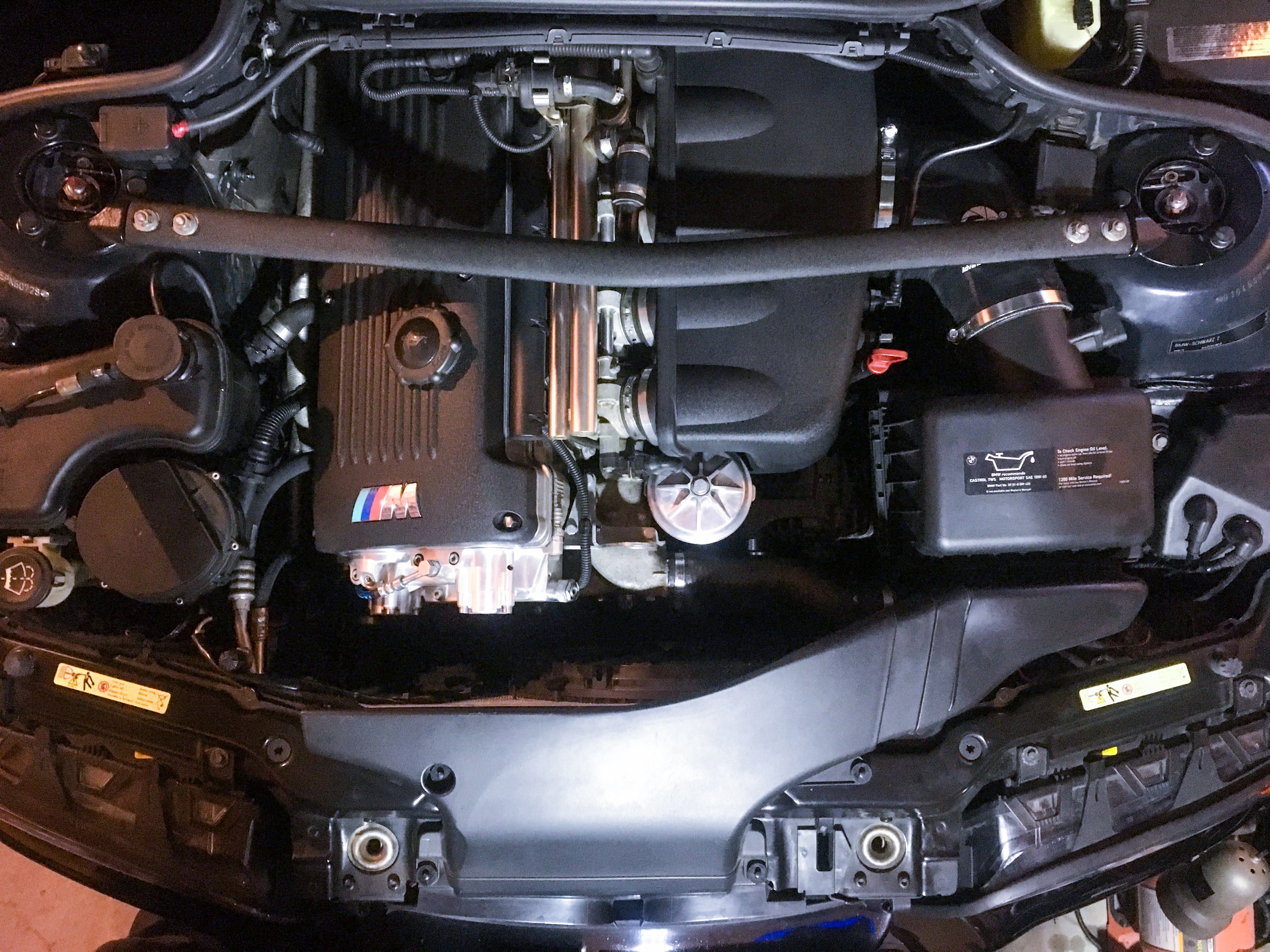

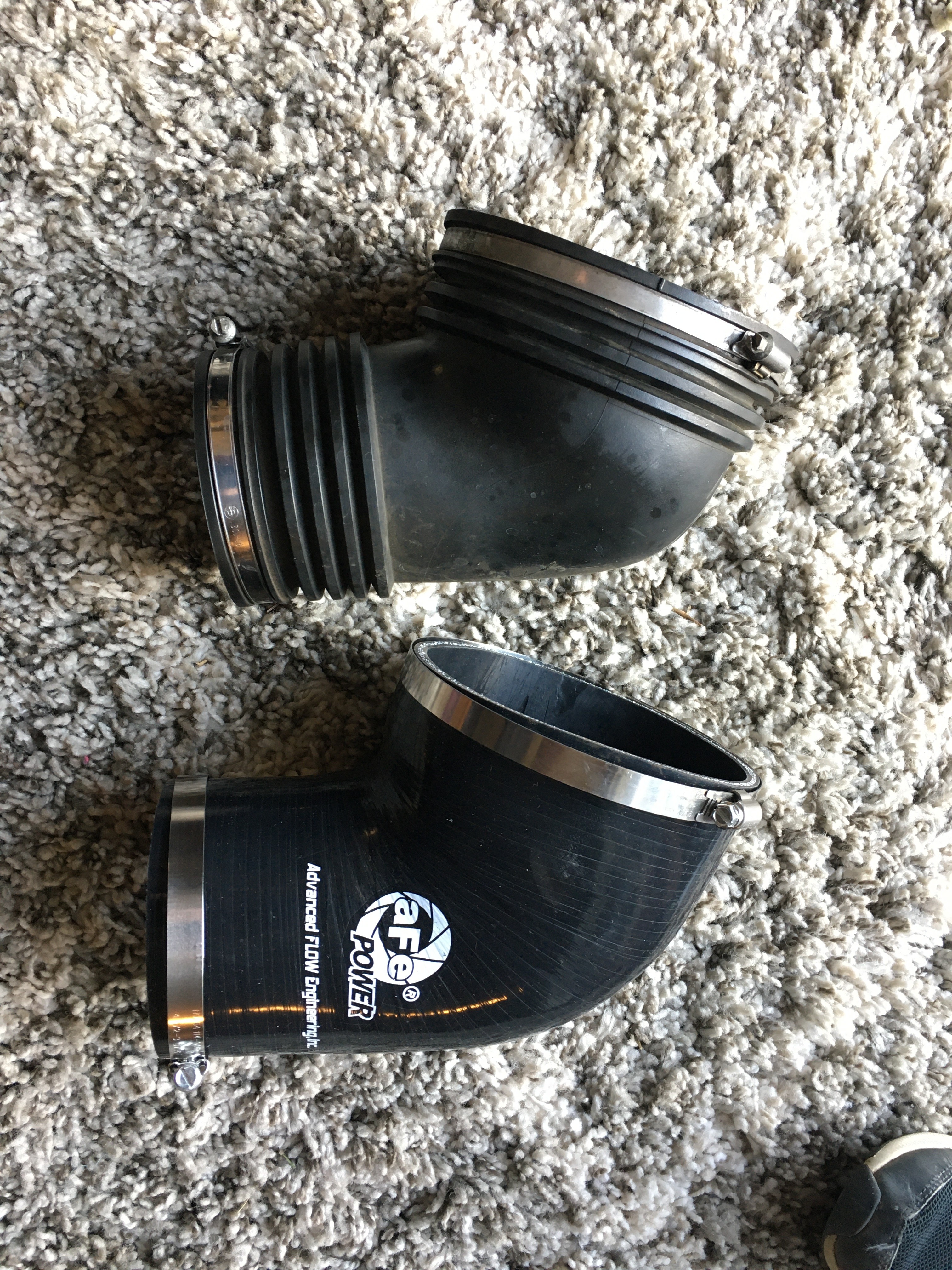

        I have lost hope that Injen will ever release their new S54 intake and I am not a fan of the other intake offerings that are under $800. If the heat shields were more substantial I would feel better about them
        For now I have replaced the stock plastic elbow with a silicone elbow.

                    157,805 miles.
                    Installed AFE intake, siphoned and refilled power steering reservoir while it was accessible. Reset adaptations.
