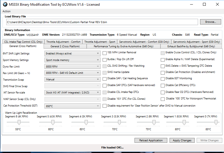

      I found a program called ECUWorx https://www.ecuworx.co.uk/  for E39, E46, and E9X M cars which allows you to make changes to a few things on your DME.
      There were a few things on my list that I wanted to figure out how to modify with just the hexadecimal code in the .bin file but this is a foolproof interface and i'm glad it exists. I pulled the stock .bin file off the DME and made the following changes:
      1. Activated the SMG shift lights. WHY?: The S54 pulls all the way to redline and feels like you can just keep going past 8 grand and visual indicators are helpful when you have a helmet on at the track. Here they are, they work!
      2. Changed the dyno redline to 8000. When on a dyno the car will only allow you to run to 6500 rpm unless you manually put it in dyno mode. I believe this is for emissions purposes. WHY?: I dont intend on visiting a dyno any time soon but in case I do I wont have to remember about the factory restriction and waste time looking up how to enable dyno mode.
      3. DID NOT CHANGE REDLINE. You can set it up to 9000 rpm.  I dont see the need. 8000 is plenty and while the S54 is robust, I like my engine hoist being tucked away in the shed and not in use.
      4. DID NOT REMOVE TOP SPEED LIMITER.   155 mph is plenty. If I had removed it, i would be tempted to try it out and see my high score. Not a good idea.

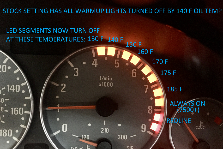

      5. Changed the warmup leds/variable redline to much more conservative values. WHY?: On newer M cars, there are some additional LED segments that light up and disappear based on oil temperature to help show when its safe to run to higher RPM. I dont agree with the oil temperatures at which they turn off. My own personal rule is that I dont run past 7000 rpm until the oil reaches 190 F and will limit visits to redline until the oil is closer to 210 F. With the stock settings, the car is basically telling you its fair game to redline the car with 140 F oil temperature. I'd like to add some padding to that.
      1. Set the aux fan temperature table to match a Z4M. WHY?: The Z4M has an electric fan. The M3 has a mechanical fan. My mechanical fan has been replaced by an electric fan running off the aux fan controller. When it is hot out and im sitting in traffic with the AC on, the coolant temperature will begin climbing a bit and the fan isn't running as eagerly as it should be. It should start to kick on earlier and at higher speed now.

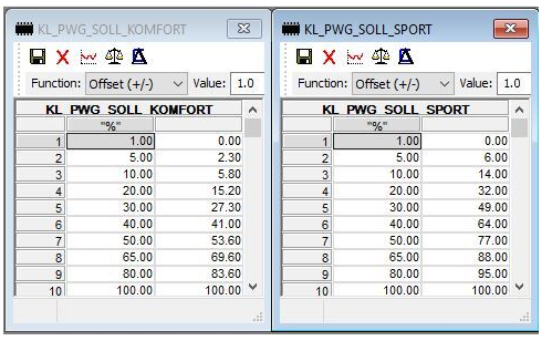

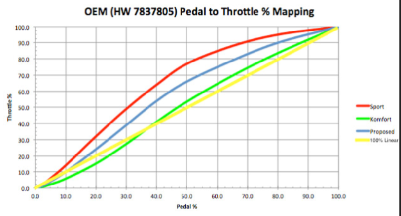

      2. Adjusted throttle mapping for both sport mode and comfort (normal) mode.
      Normal mode throttle feels fine, fairly linear, but right off the line its a bit stale.
      Sport mode throttle takes some getting used to right off the line and is very aggressive, but flat up top near WOT  and not very linear at all. Ideally, normal mode would eliminate the flat spot right off the line and sport mode would be less aggressive off the line and have more substance near WOT.
      Here is a breakdown of the % of pedal application vs % throttle opening for the stock throttle mapping. You can see on the sport mapping on right, 65% of pedal travel = 88% throttle opening which makes the last 35% of pedal travel feel like not much is going on.
      Here is a breakdown of what I changed it to:
      Red is stock sport mode
      Green is stock normal/comfort mode
      Blue is my new sport mode
      Yellow is my new normal/comfort mode (linear) 1:1

                        Im imagining a zoo of identical sounding M20s + a helmet could very easily leave you bouncing off the limiter without a visual cue. I recently coded the tach warmup lights into shift lights. Cant beat free!
