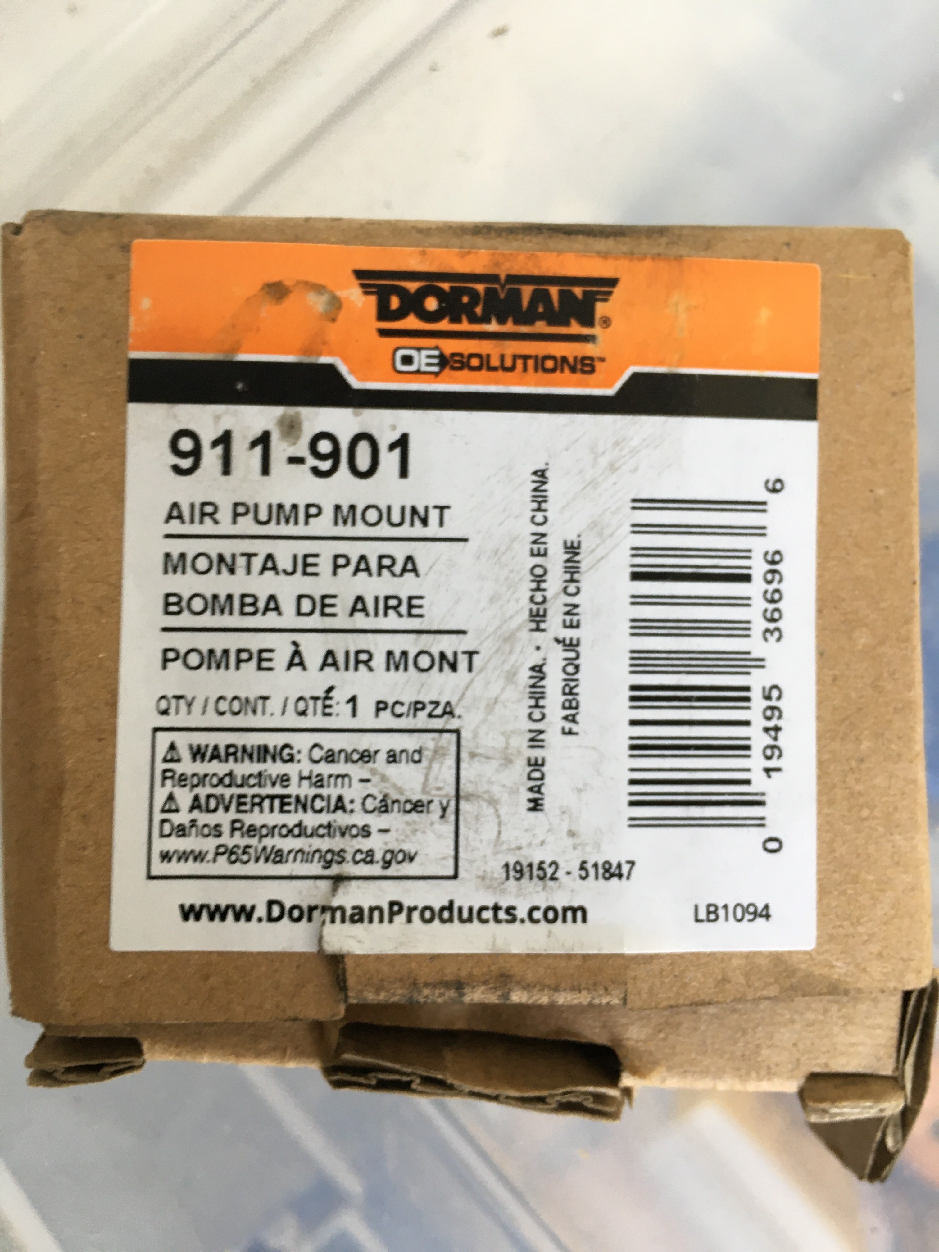

    Re PS fix. Well I'll be. Beats the zip tie fix on mine.  Dorman part#?
      #242

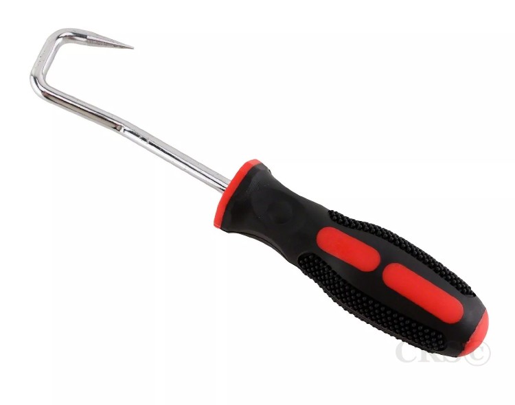

        Shoutout to my Harbor Freight “ 8” Universal Radiator Hose Pick” for being a bro and removing yet another bitch clip with ease

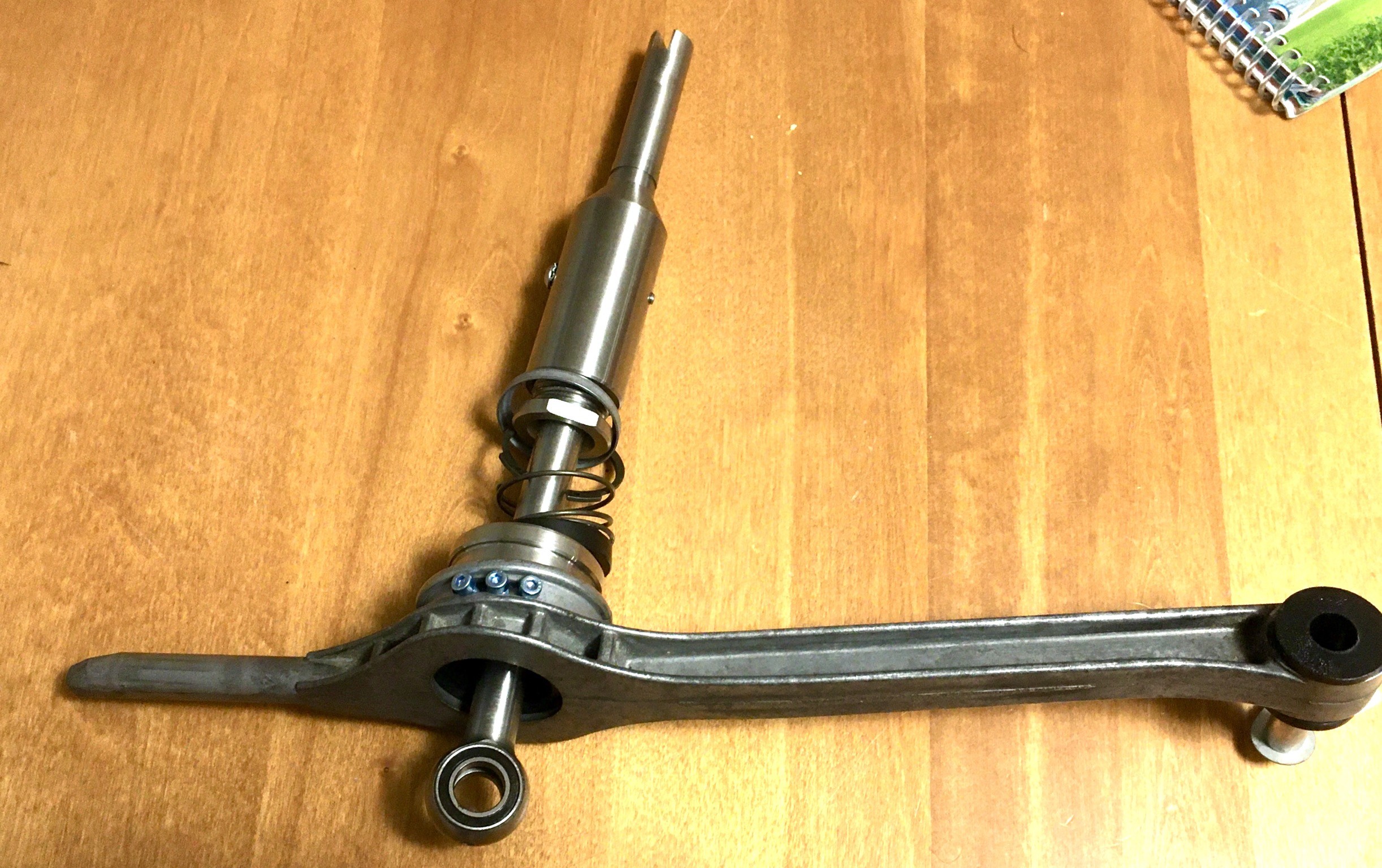

        The UUC components were loaded onto the shift carrier. I still need to determine how to remove the rear rubber mount for the shift carrier from the chassis to install a new one and get the selector rod joint off to install the new one.

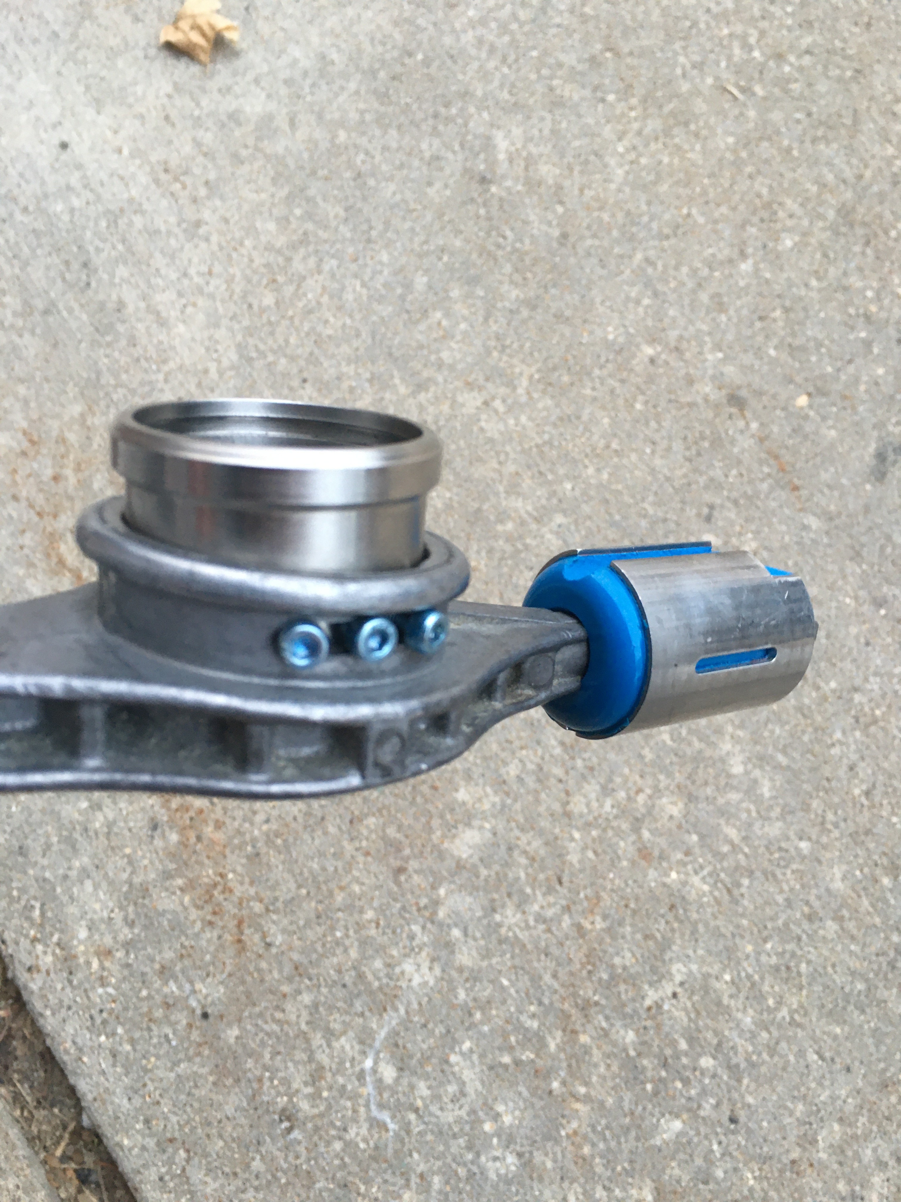

          I remember having to torch my old rubber bushing out of the carrier that bolts to the car
            #245
            just pry it off the chassis.
            look at the new one, it should have two slots in the sides. the bracket on the body just tabs into those.
              #246
              I was totally in the e30 mindset with this. Dans photos have enlightened me.
                #247
                i only remembered the e36/e46 part because the dingleberry that did the swap in my car couldnt wrap his dinglebrain around the different styles and I ended up having to fix his hack, which included the e36 bushing:

                      Progress this week:
                      -Asked @Jdesign which shop near me wont scratch my wheels during a rotate/balance, he suggested Midcoast Auto in West Allis so I dropped them off there. They seem like a nice operation. Should be picking them up tomorrow.
                      -Removed shift carrier bushing (thanks to @straight6pwr for the image)

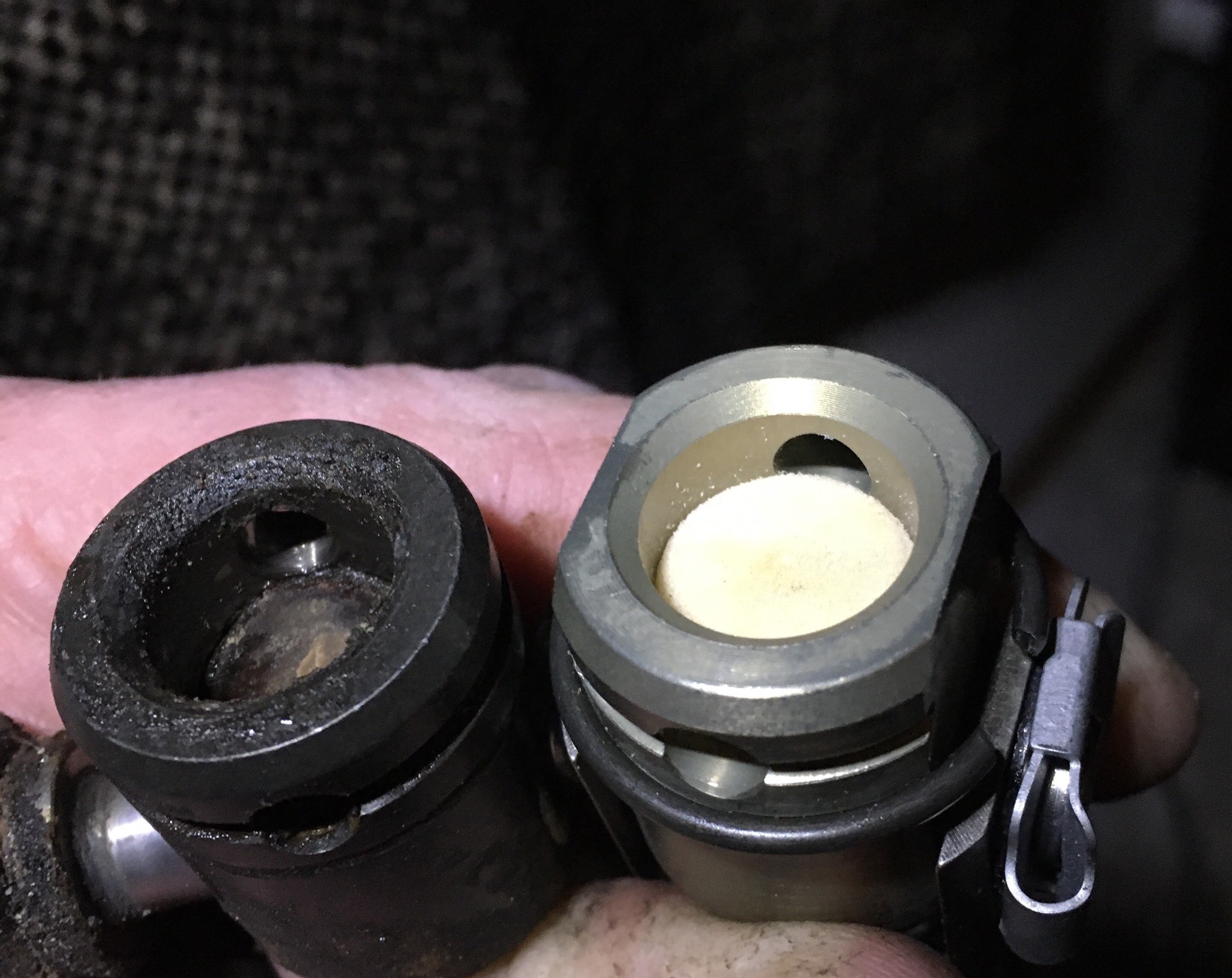

                      -Removed the selector rod joint. This is much more challenging with the transmission in the car and the driveshaft installed. Who could have imagined!?!?
                      -Installed new selector rod joint with pre-installed DSSR. This seemed like a good way to go and I think it was an easier way to hold onto the joint with the limited visibility and access.
                      The compression set of the foam on the old joint vs the new joint:
                      The stock rear carrier bushing shows no cracks or obvious signs of wear but it is so flimsy and has a ton of radial movement by design. The Turner Motorsports bushing is gon b’ gud.
                      I need to drop the trans crossmember 1/2” again to get the rest of the shifter installed (for bitch clip clearance) so I will save that for later.
                      ....plugging away 15 minutes at a time

                                      Shift carrier partially installed. I burned a lot of daylight getting the bitch clip aligned and installed.
                                      My hands and wrists feel like I wrapped them in pork chops and stuck them in a cage of hungry dogs.
                                      The rear carrier bushing (blue urethane piece from Turner) is a jerk to install. I much prefer the E30 style. I did not get that in, it is the last step of the shifter install.

                                        Good news:
                                        -Shifter is in!
                                        -Shifter sits lower!
                                        -Shifter feels great fore/aft, very snickety!
                                        Not the best news:
                                        -Turner shift bushing could not be installed with the driveshaft in the way. I will hang on to it and install it some other time.
                                        -some  side to side play still exists due to the selector rod joint pin. If I ever replace the clutch/have the trans out (lets hope not) I will have a pin custom machined to fit tighter.
