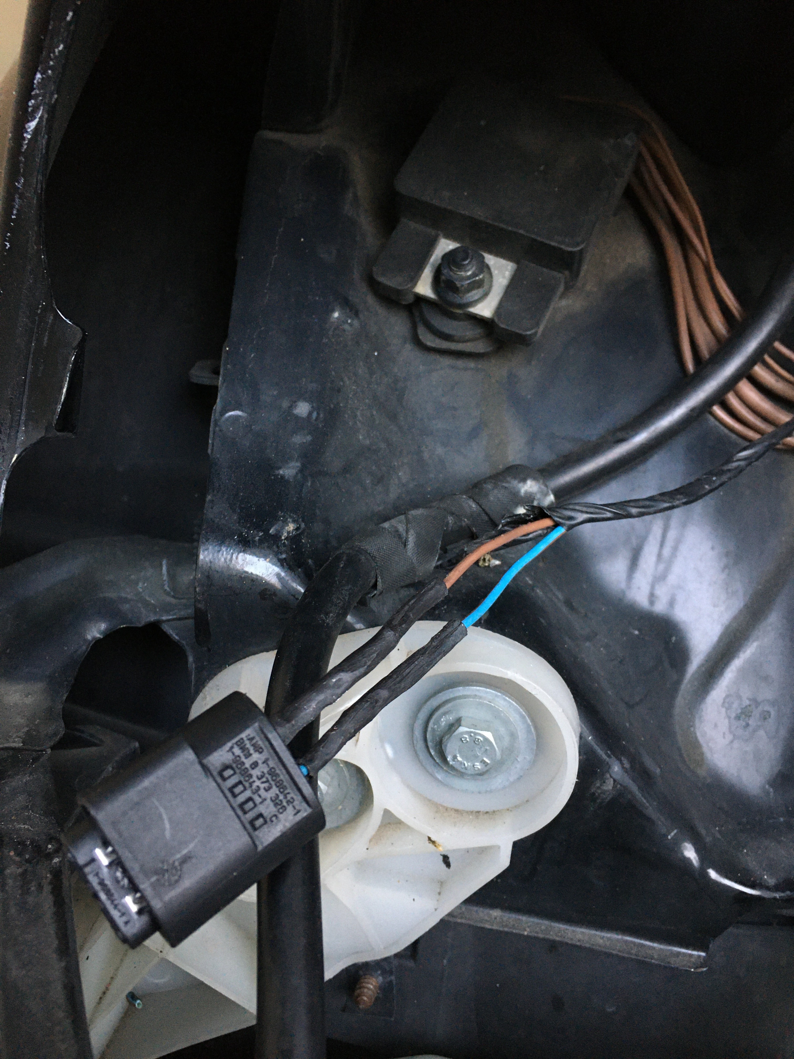

      -1) The idler pulley bolt is so long that I couldn’t remove it without removing the electric fan which required permanent removal (see also breakage) of the fin mounted zip strips. While I was investigating whether I could run longer ones through the condenser+radiator to make future removal easier (im not going to drain the coolant and remove the radiator when I want to remove the fan) I noticed the AC condenser fins are almost entirely Aluminum Oxide instead of Aluminum. They fall off when you touch them, so a new condenser is in my future. I have never seen them so brittle before. I may see how corroded and brittle the front  side of the radiator tubes are and replace the radiator at the same time.

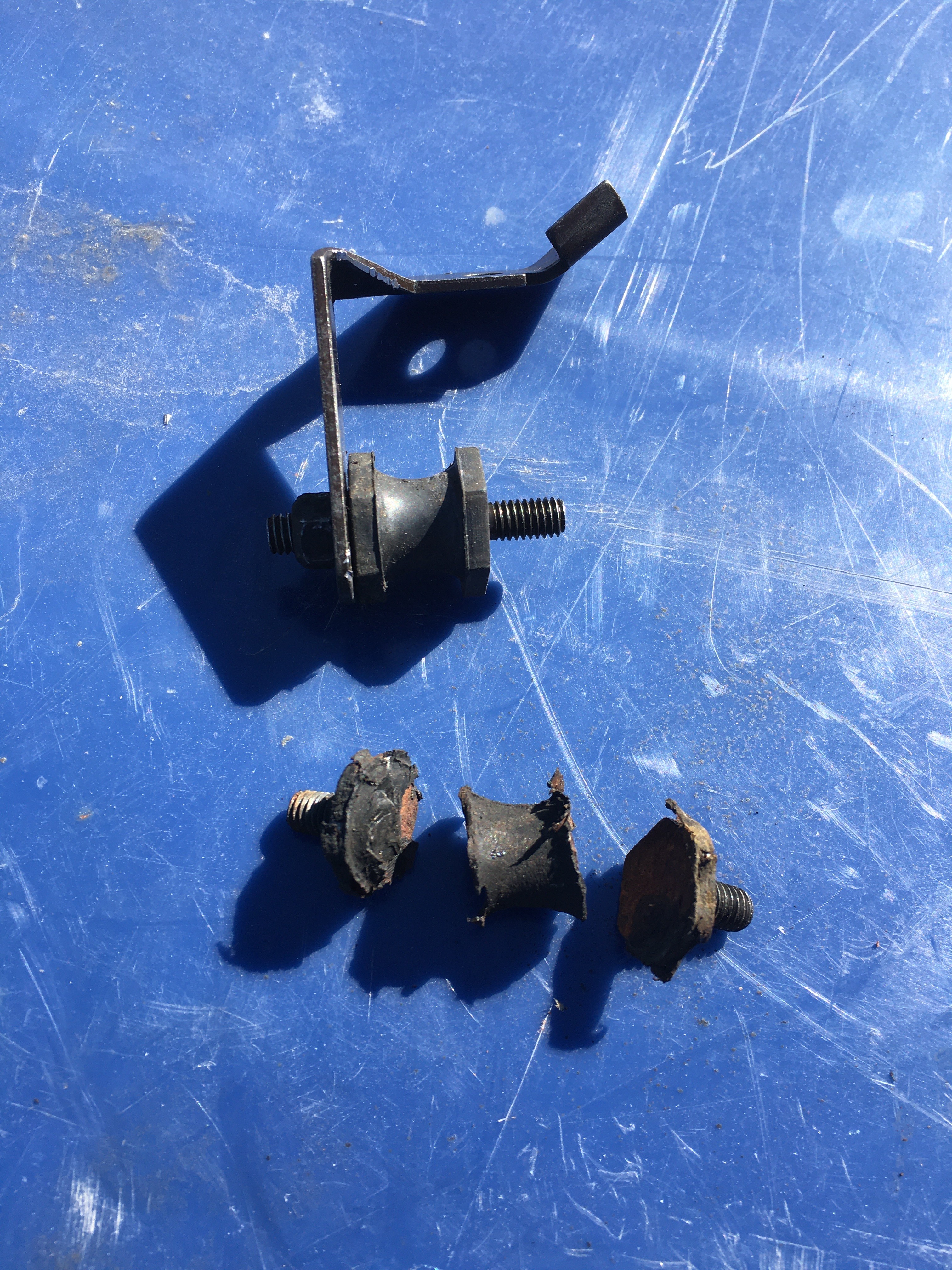

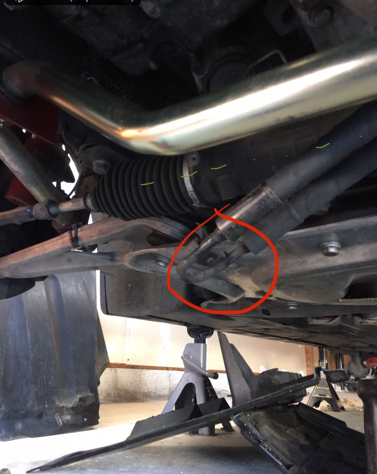

      -1) I found a broken power steering line mounting bracket under the car. Very minor inconvenience. Looks like a transmission mount and is only sold with the hard line.
      UPDATE: The part appears to be the same mount the secondary air pump uses so I have it on order.

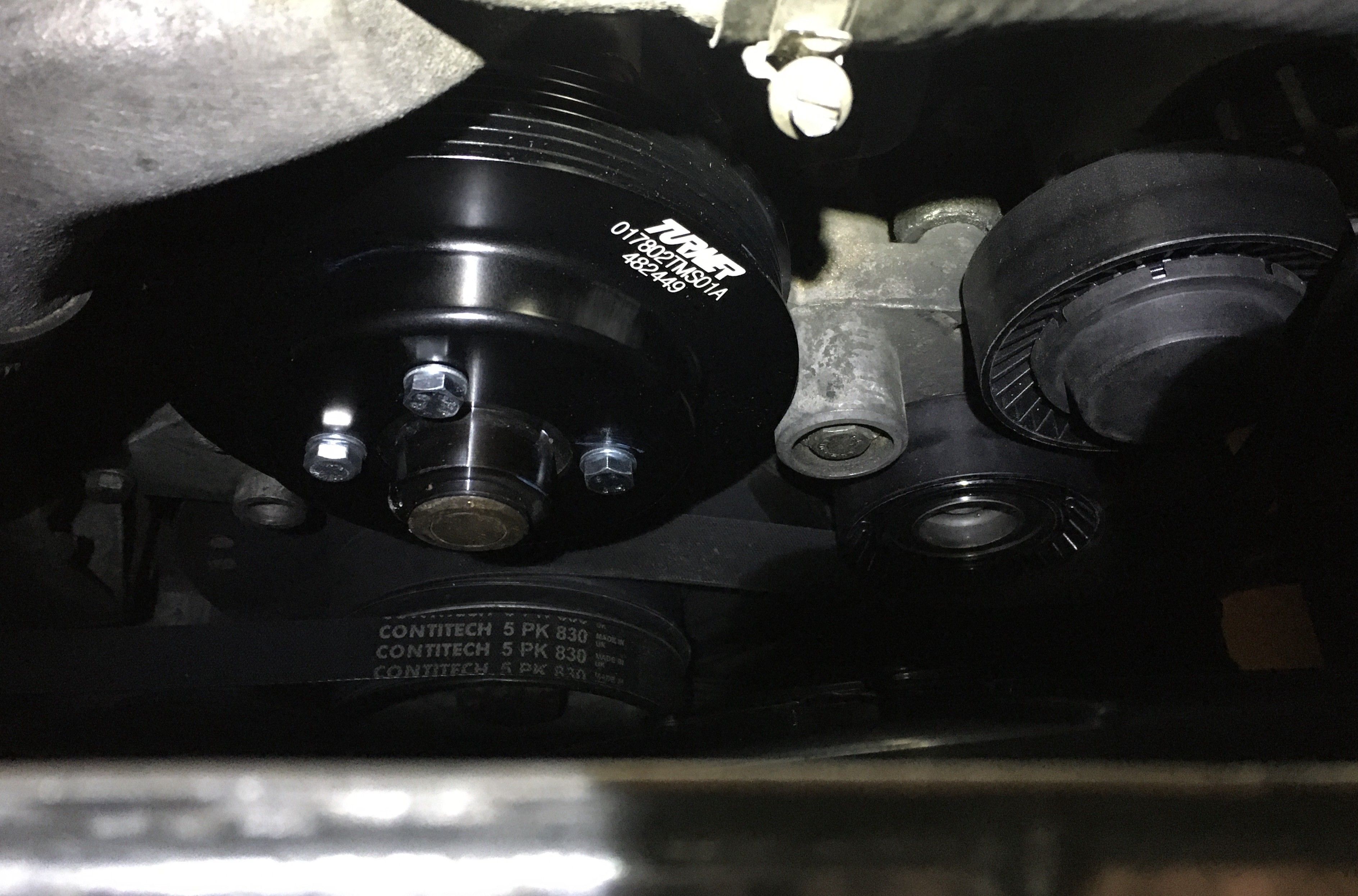

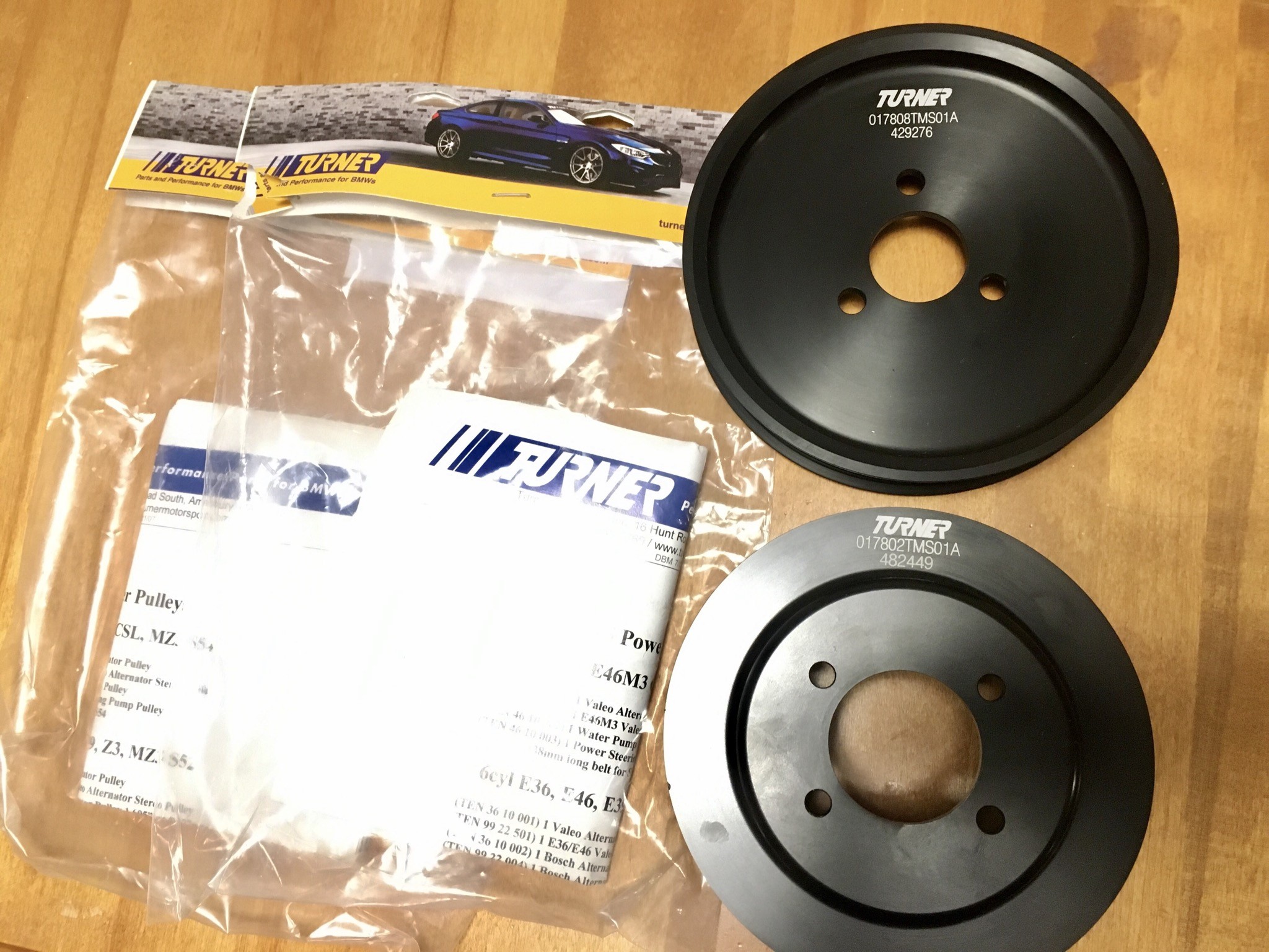

                            My fingers are frozen from installing these spinnybois tonight.
                            Replaced the hardware because oxidized hardware does not belong on sexy new underdrive pulleys

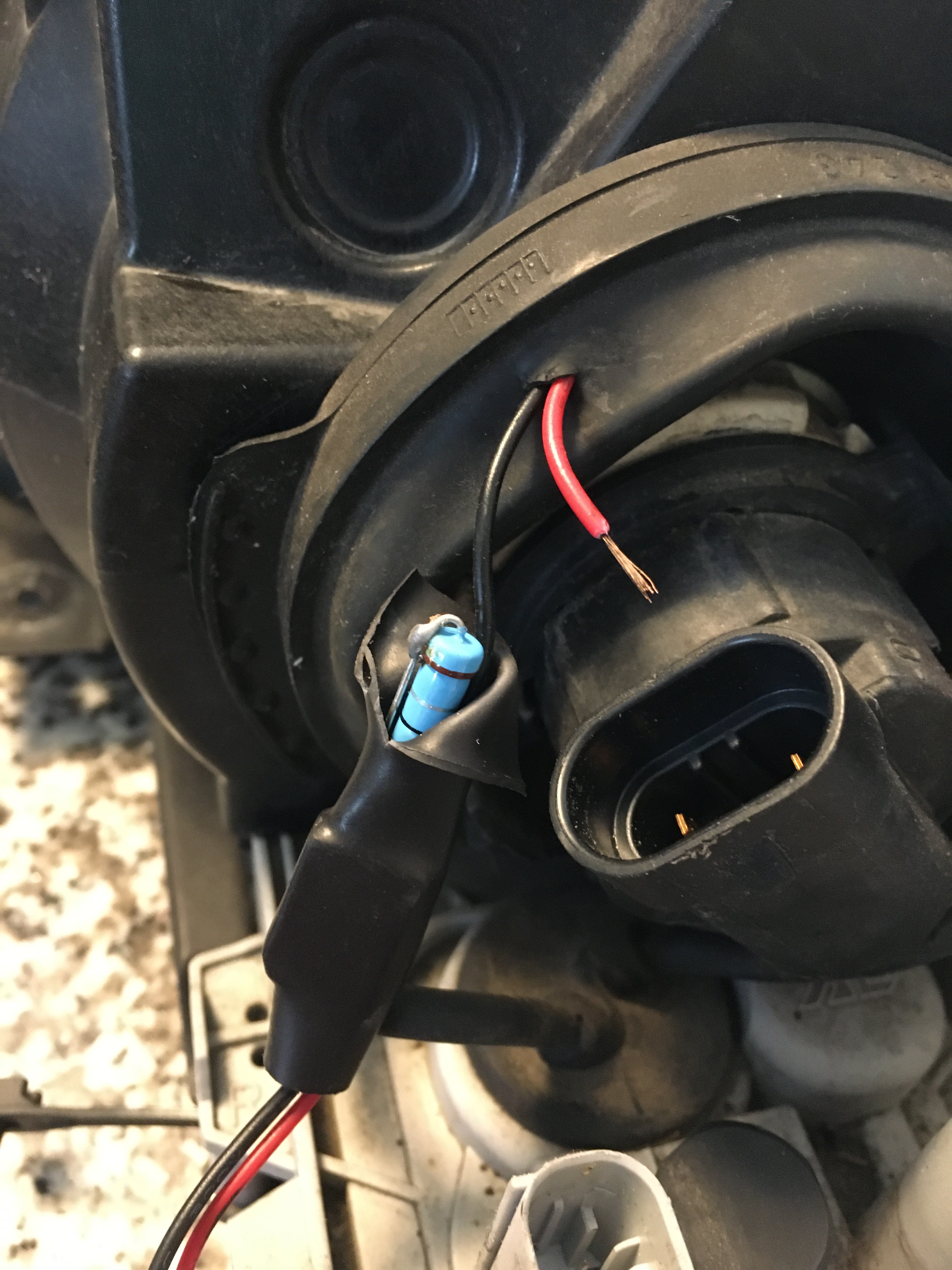

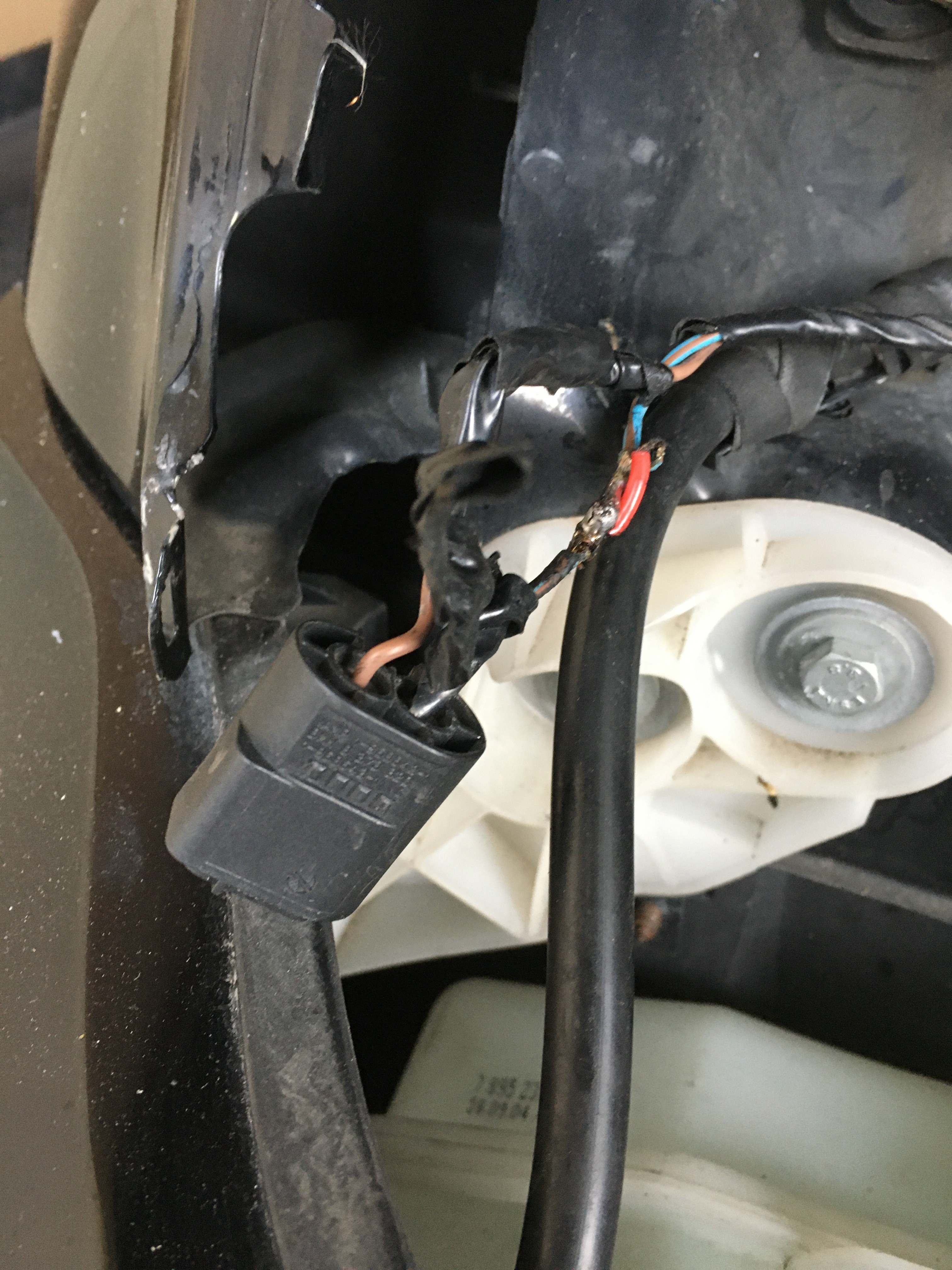

                                    While removing one headlight the solder joint on the halo wiring broke. So I mended that...
                                    Then I removed the headlight sprayer nozzles, hose, and disconnected the pump for it on the reservoir. No more washer fluid splashed all over the hood!
                                    I noticed some less than stellar turn signal wiring.
                                    so I fixed it.
                                    So I made 0 progress today on the shifter but it was nice to take care of those small items

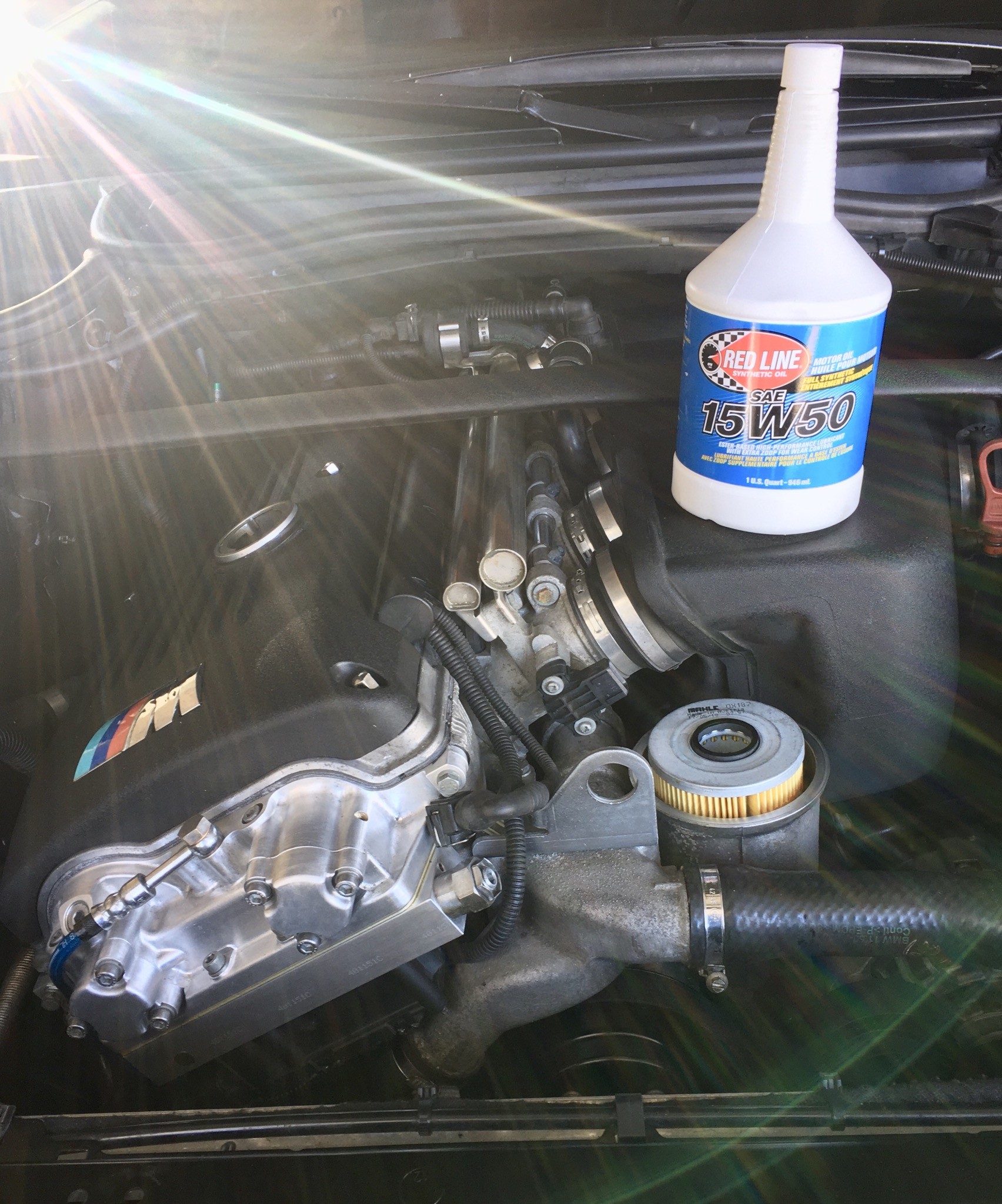

                                          Fresh oil change for driving season 2020
                                          I went to Pegasus Racing to pick up the Redline oil. The guy at the counter was a bit of a space cadet.

                                          I replaced the broken PS hose mount as it had broken and was resting on the belly pan (shown dangling circled in red). RealOEM didn’t show the part separate from the PS hose but it turns out to be the same part as the secondary air pump mount. Dorman makes them and a box of them can be had on the cheap.
