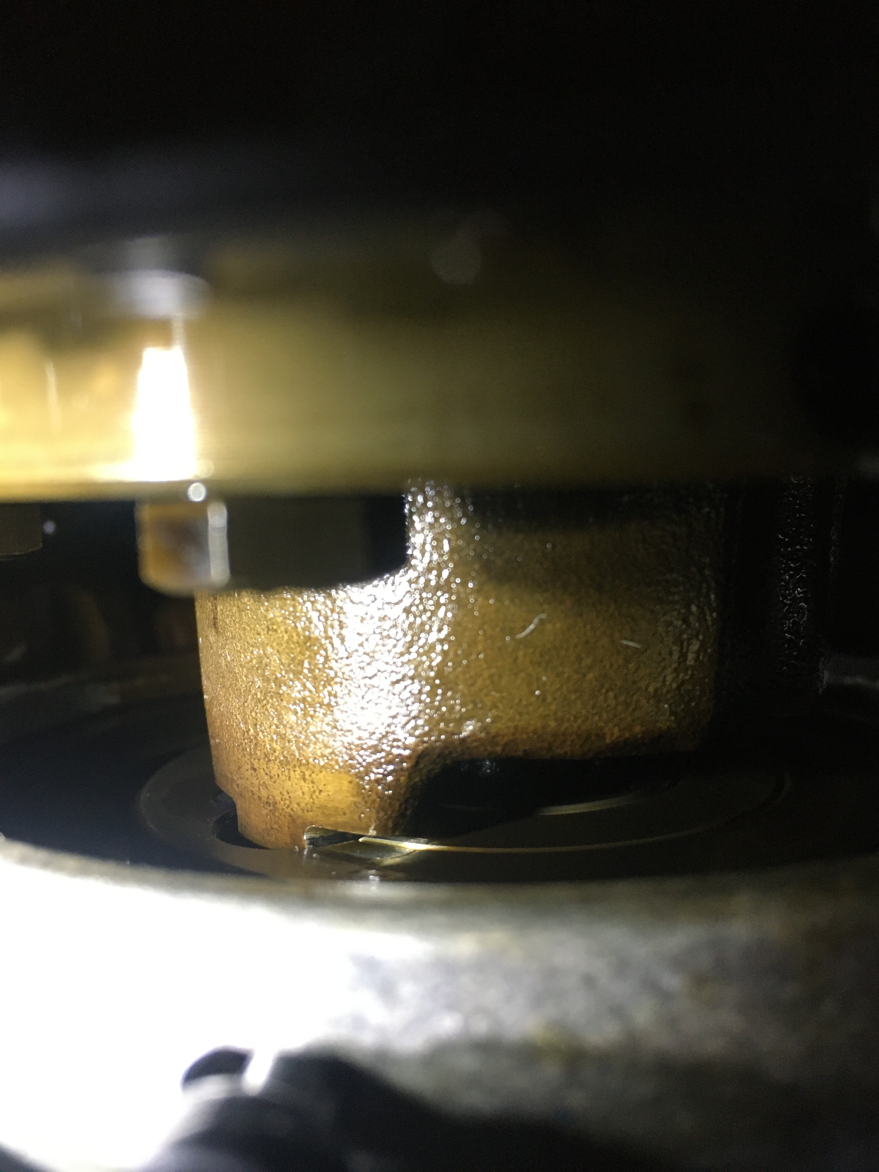

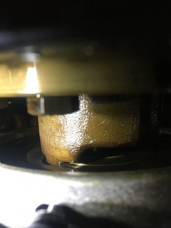

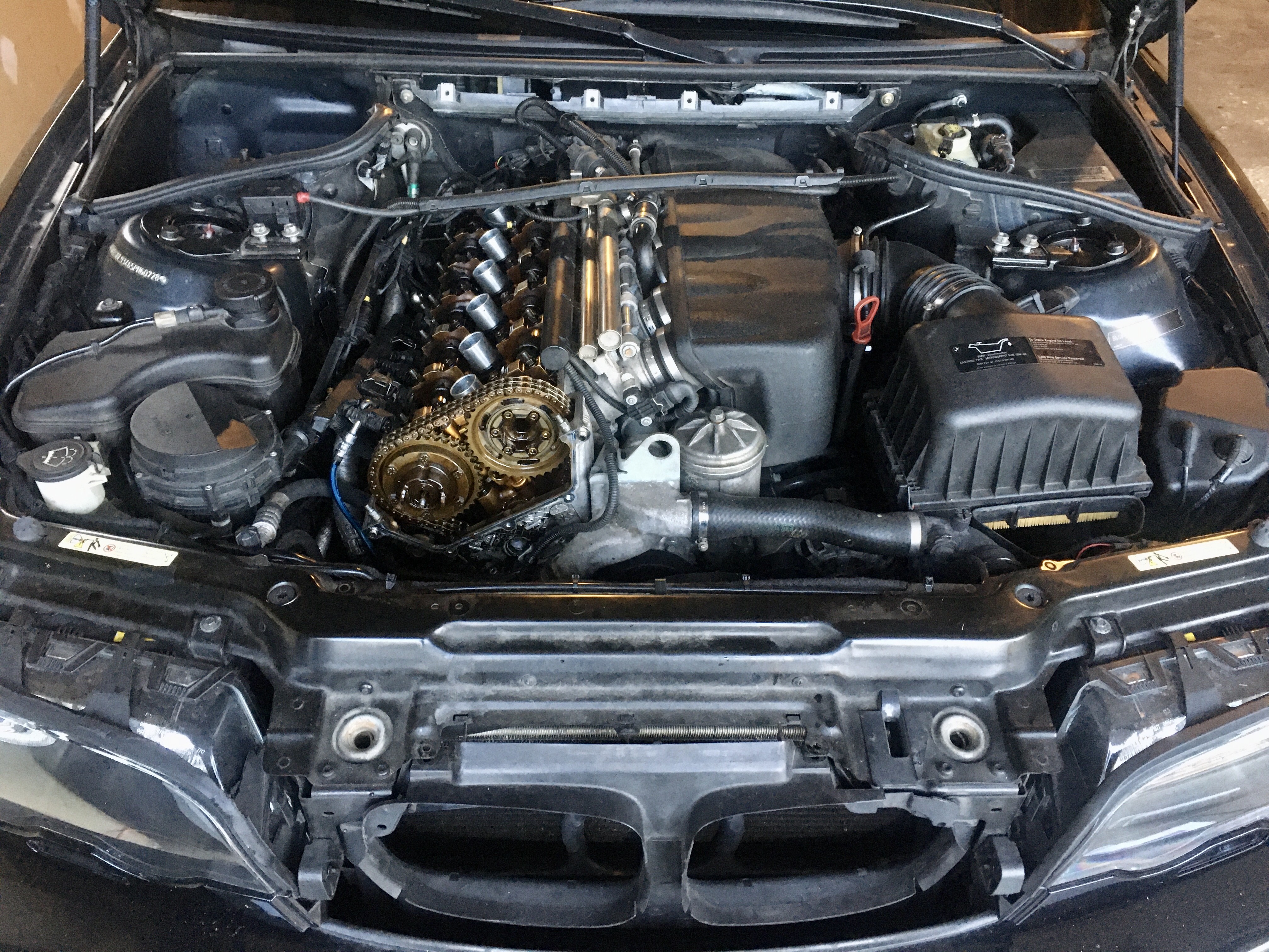

                  Valve cover is off to check VANOS exhaust hub tabs , check cam bolts, and valve clearances.
                  I had to see what I am dealing with first before ordering parts. If an exhaust hub tab is broken its no less than $400 to get back in the game with a used one on Ebay, usually people opt to spend about $600 on a cyro treated hub and another $150 on a modified oil pump disk that prevents future failure.
                  Everything checks out good so far.

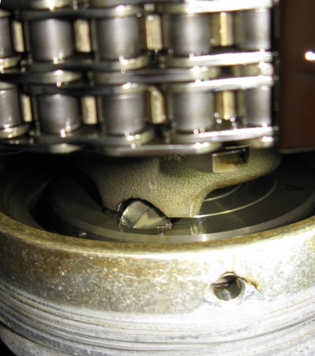

                  Broken tab shown below for reference (Not mine thankfully). The tab can dislodge, cause timing to jump and cause unexpected meetings between valves and pistons.

                        The “VANOS lockdown” has begun!
                        To-do:
                        -Replace problematic cam bolts with upgraded bolts + oil resistant loctite
                        -Replace VANOS seals with new/improved Viton seals
                        -Re-drill oil pump disk with smaller holes to prevent exhaust hub tab breakage
                        -Install anti-rattle kit with new diaphragm springs
                        -Install upgraded Nylatron upper timing chain guide

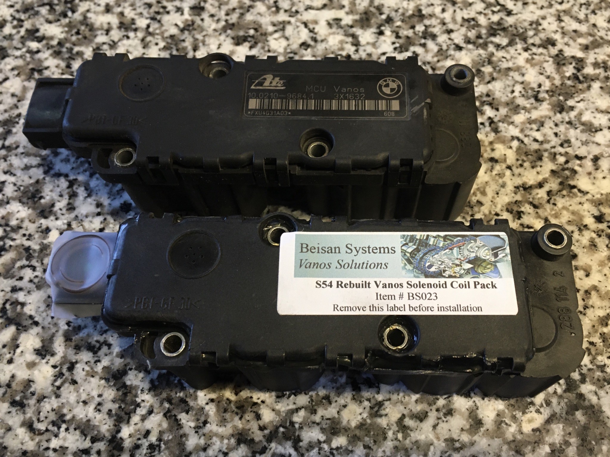

                        -Replace VANOS solenoid with rebuilt Beisan Systems unit (incorporates a few preventative fixes to eliminate failures)

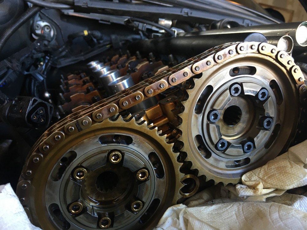

                        I received most of the parts for this project today including the cam timing tools, crank  lock pin and valve adjustment shims. I forgot a couple small items but I am in no hurry.

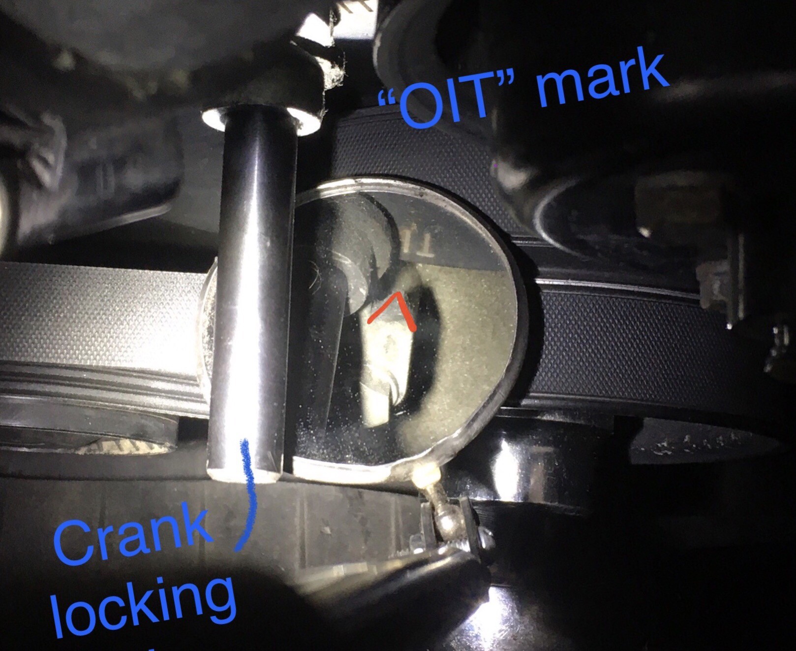

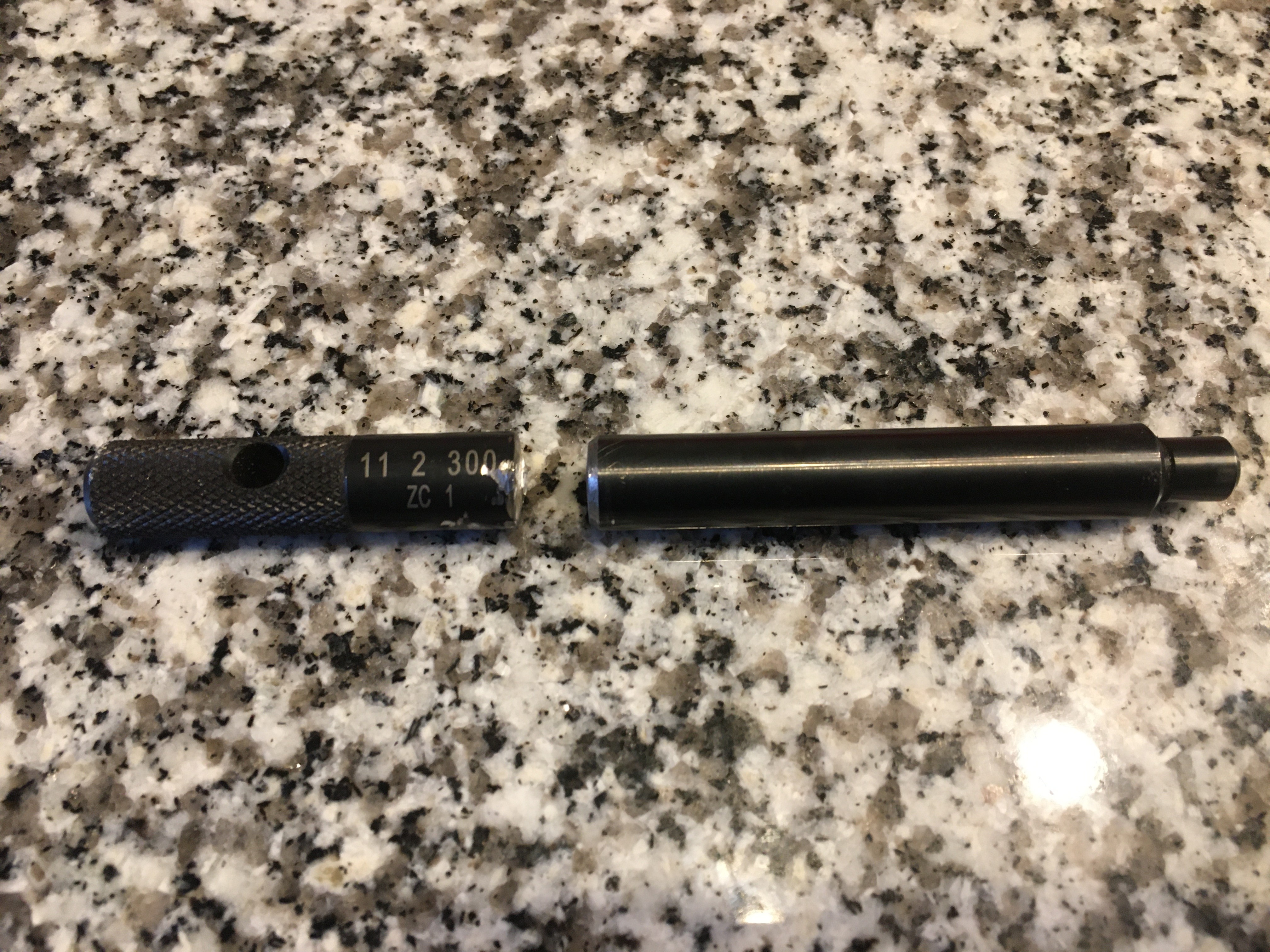

                        I had read that the Z4M cant use the same crank locking pin as the M3. Now I know why: the Z has an electric fan instead of a mechanical fan. My M has an electric puller fan in lieu of the mechanical fan and it is not easily removable without removing the radiator or condenser since it  is mounted through the radiator fins with zip strips.  Since the crank locking pin is too long to fit in the hole with the fan in the way, I opted to shorten it.

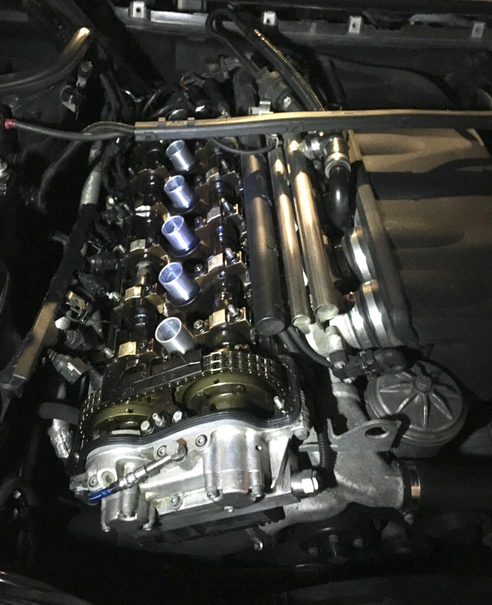

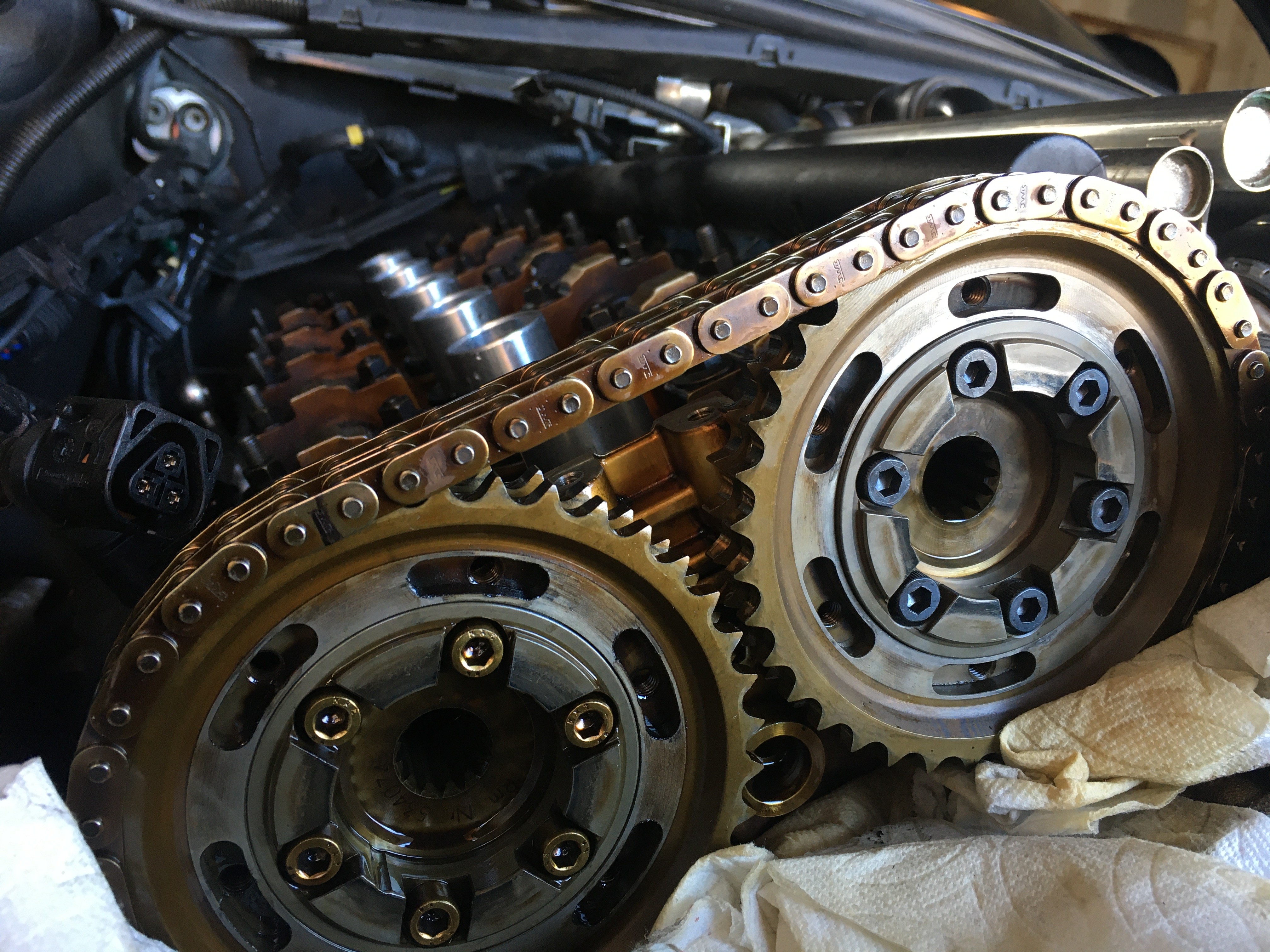

                        All aligned at TDC:
                        The solenoid was removed, I got it shipped off to get my core $ back

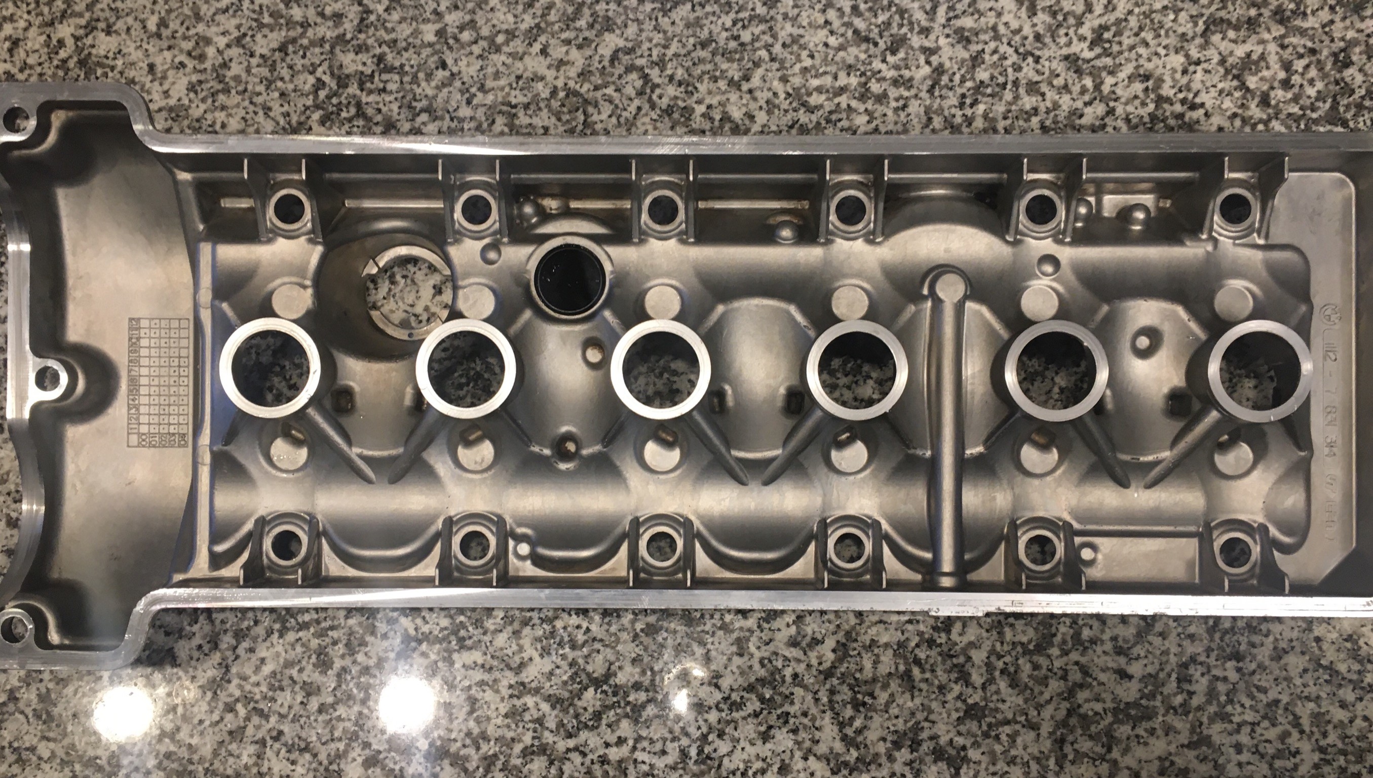

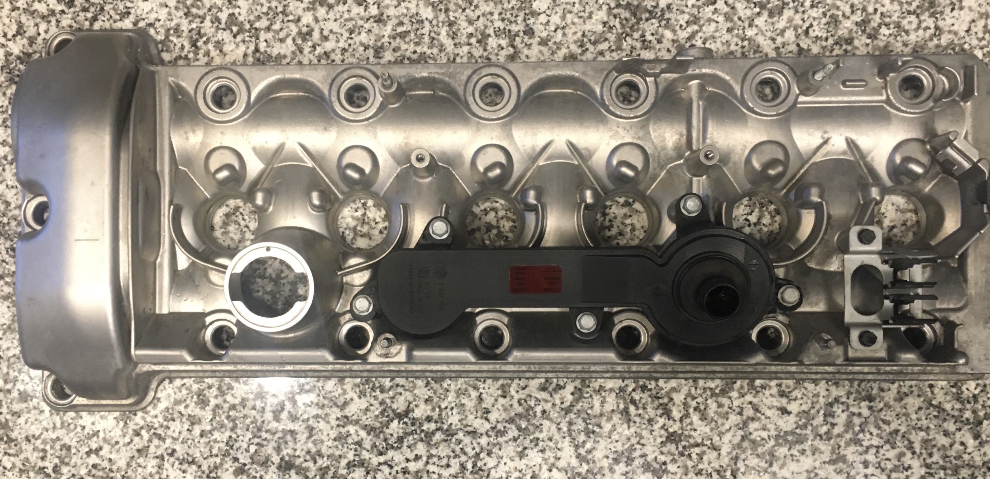

                        This is one reason I could never be a mechanic for a living. I blow a lot of time cleaning things as I go. Here is the valve cover with all the varnish on the inside removed

                                  VANOS unit off.

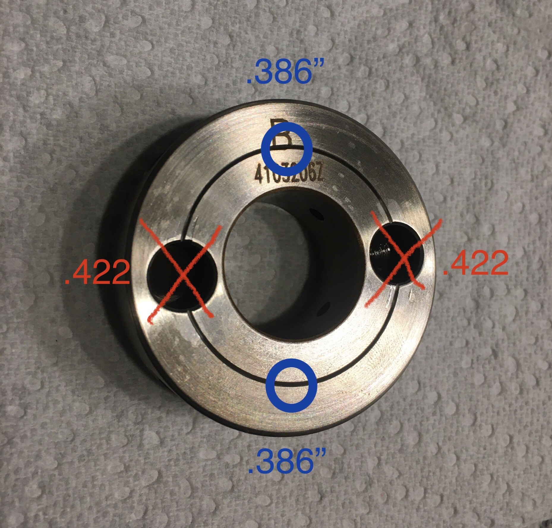

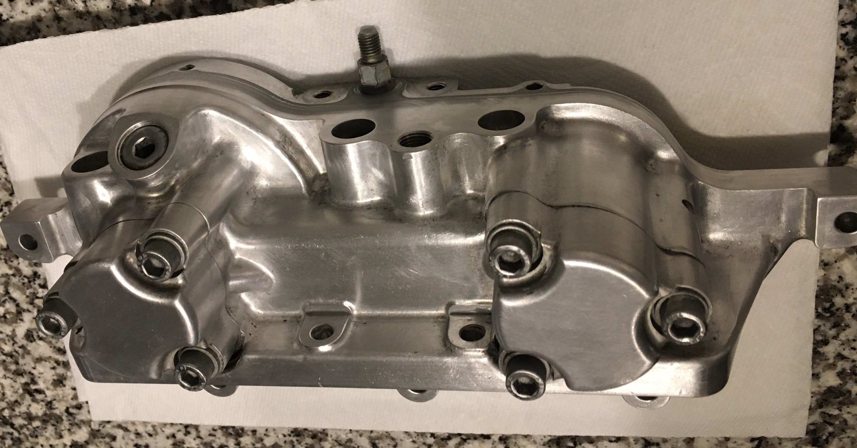

                                  Oil pump disk removed. The tabs on the cam hub that often break off fit into the holes crossed off in red. It is the same design as the Euro S50B32 but the S50 has a tighter fit between the hole and the tab so the impact force is lower and tab breakage is not a problem there.
                                  the options for preventing tab breakage  are to buy a one of the aftermarket higher strength hubs with larger tabs. Buy a cyro treated stock hub. Buy a redrilled oil pump disk. Or, be friends with a machinist and have them drill it.
                                  Mr. K Precision himself @Jeff will be adding the holes in blue above.
                                  I checked the cam timing as it currently sits. The timing is not set correctly. The exhaust cam is about 2 degrees advanced, but it must have been within the acceptable range for adaptation since there were never any codes or issues. It will certainly not hurt anything to have a wider range of cam adjustment available once I reset it correctly.
                                    #217

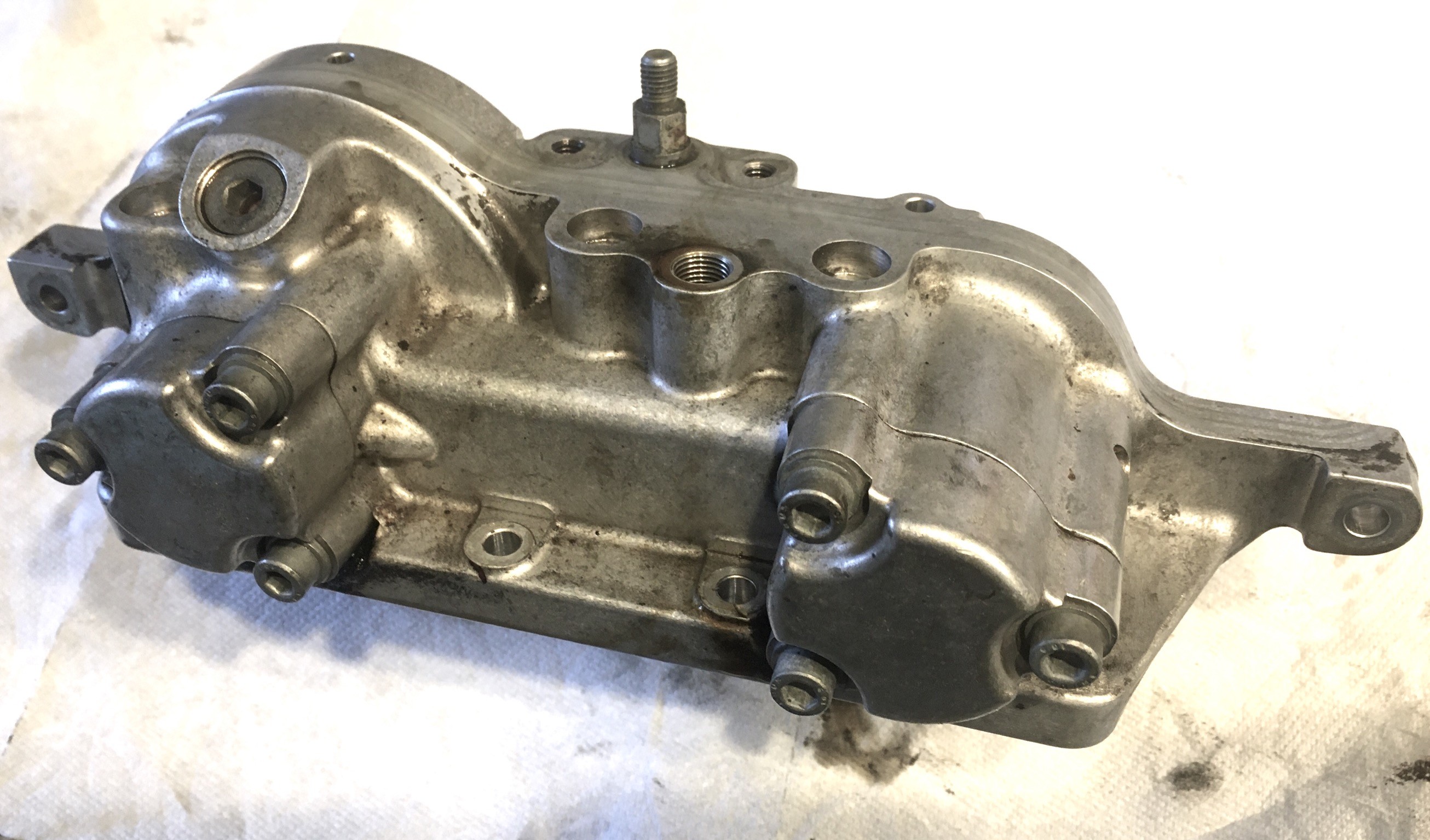

                                    Housing cleanup
                                      #218
                                      Earl would do it better.
                                        #219
                                        I installed the anti-rattle parts. There was no axial freeplay beforehand and no axial freeplay afterwards. Waste of money? Yes. The other piece of the anti-rattle solution is to use S62 diaphragm springs. They are stiffer. The only positive from this portion of the project was being able to clean the thrust bearings and housings. There was a little bit of crud built up.
                                        ORIGINAL VANOS THRUST BEARING AXIAL FREEPLAY: JUST FINE
                                        All but 1 of the VANOS seals have been replaced. I am not a fan of how the teflon seals need to be stretched to fit and don't feel satisfied with the fitment of one so I ordered another and will wait a few days to get that last seal in. Visually, the old rubber seals were in decent condition and the teflon seals were not that worn or brittle. The exhaust side appeared to be worn the most/was the only side that seems like the new seals will give an improvement.
                                        ORIGINAL VANOS SEALS: DECENT CONDITION
                                        Next I replaced the cam bolts. They were the original 8.8 bolts (shown on the exhaust side) with no Loctite and none of them were loose, but new 12.9 hardware and Loctite 243 (shown on the intake side) will provide some peace of mind despite the originals likely never having any issue in the future based on their current track record.
                                        ORIGINAL CAM  BOLTS: TIGHT AND UNBROKEN

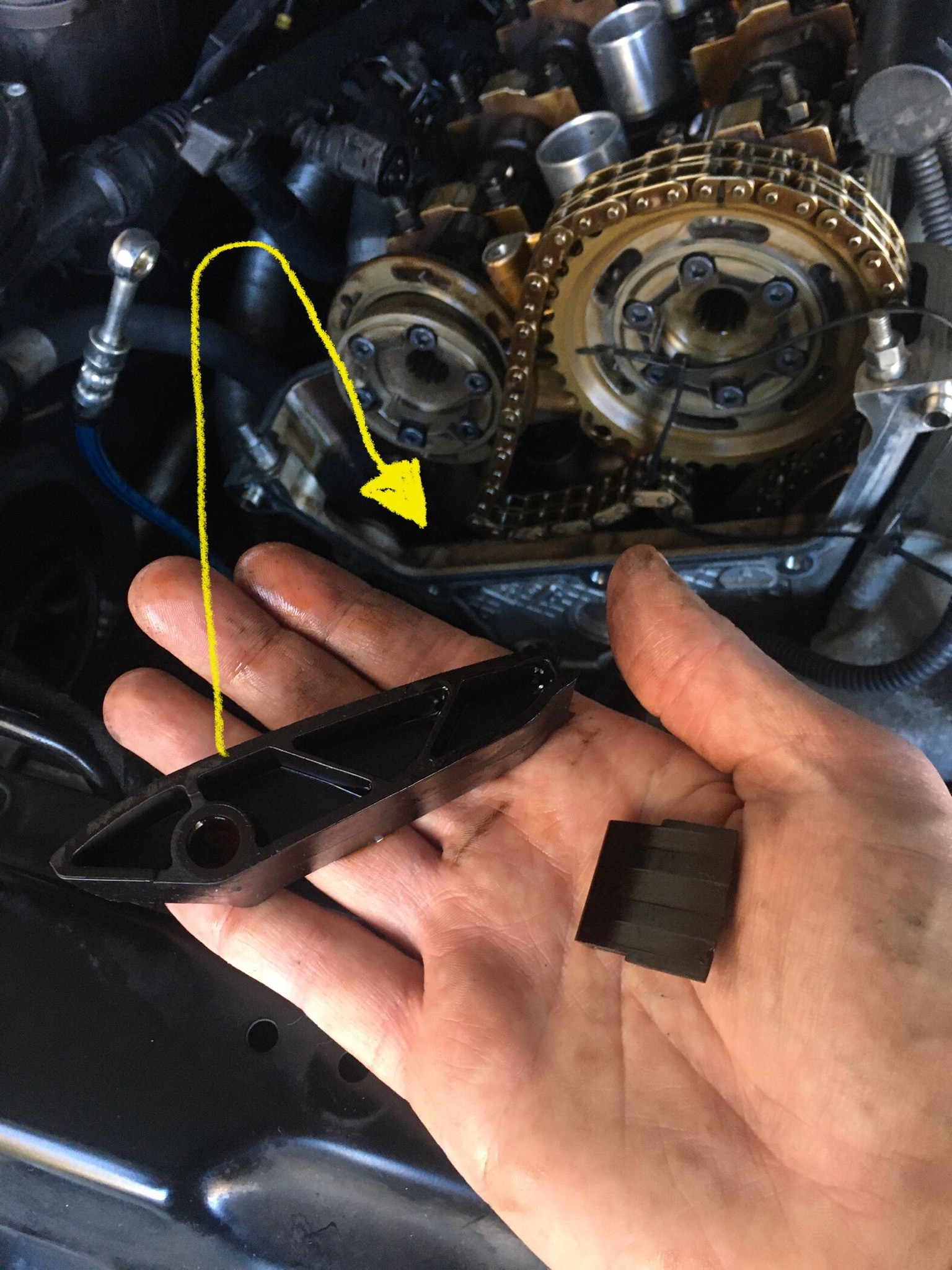

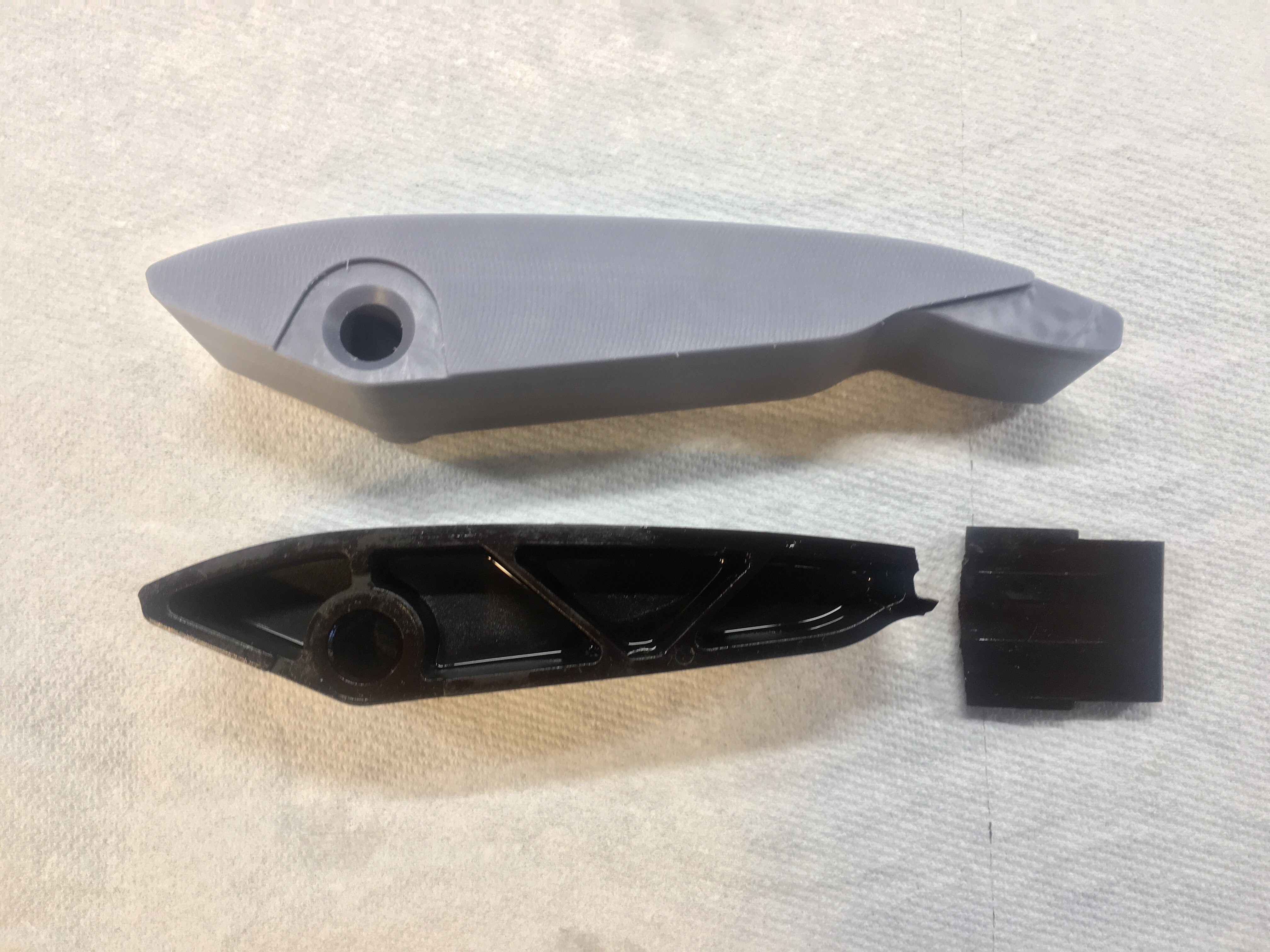

                                        Yet another reliability upgrade/“while you’re in there” piece, the upper timing chain guide. This guy is known to break and wear out fast. HEY! MINE IS BROKEN!
                                        ORIGINAL TIMING CHAIN GUIDE: BUSTED!
                                        Fishing out the broken piece without dropping it down the timing cover was a little nerve-racking. I even had a vacuum cleaner running to help try to catch the stray piece as i pulled it out with pliers
                                        Here is the upgraded piece made from Nylatron, a material I use often in my engineering work. It has good friction properties and very good wear resistance for a plastic.
                                        Everything should be buttoned together later this week as long as I get the parts I need.
                                          #220
                                          Did you make or buy that Nylatron guide?
