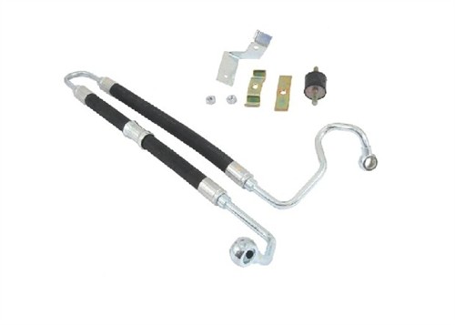

                            -1) I found a broken power steering line mounting bracket under the car. Very minor inconvenience. Looks like a transmission mount and is only sold with the hard line.
                            UPDATE: The part appears to be the same mount the secondary air pump uses so I have it on order.
