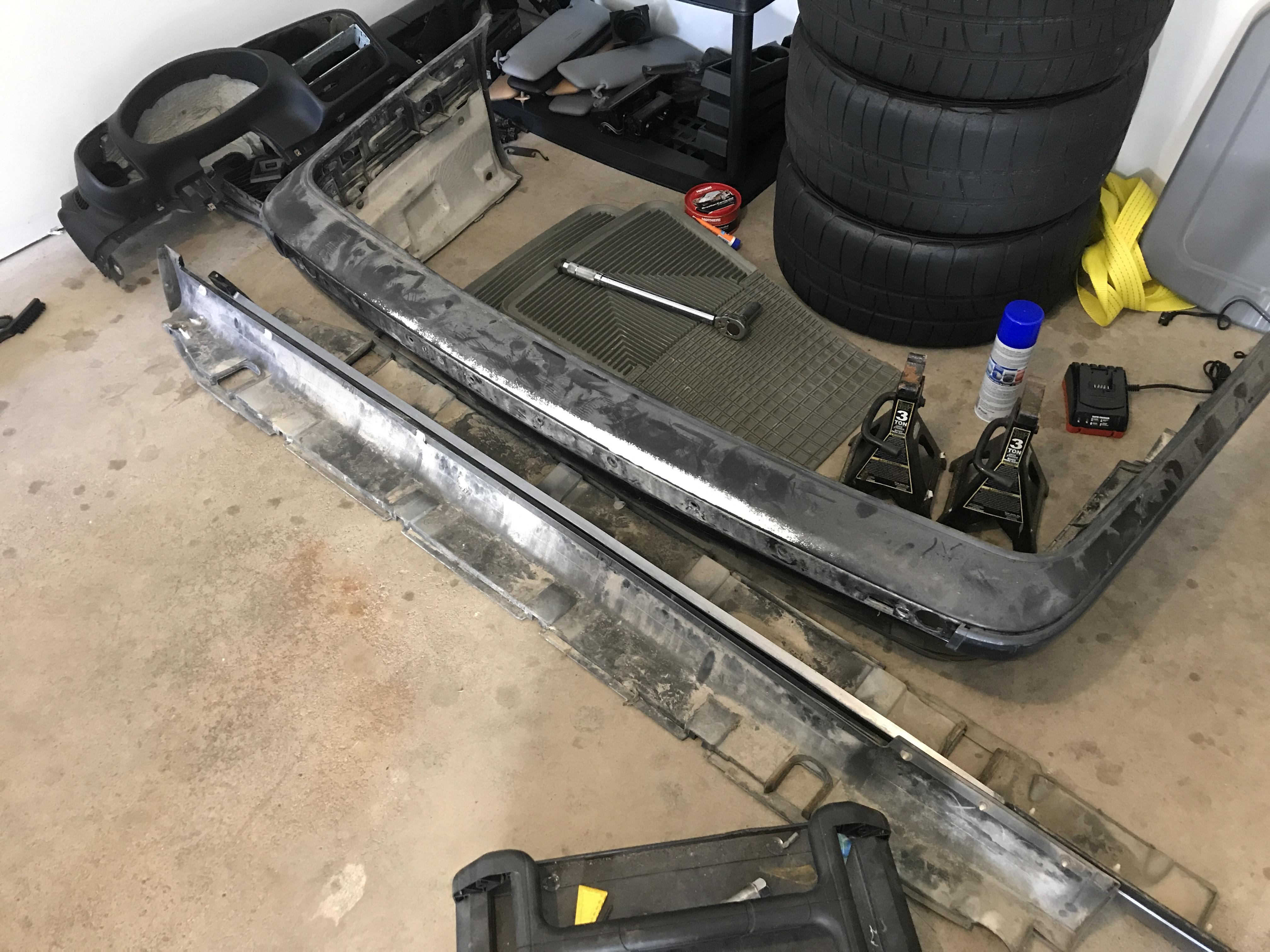

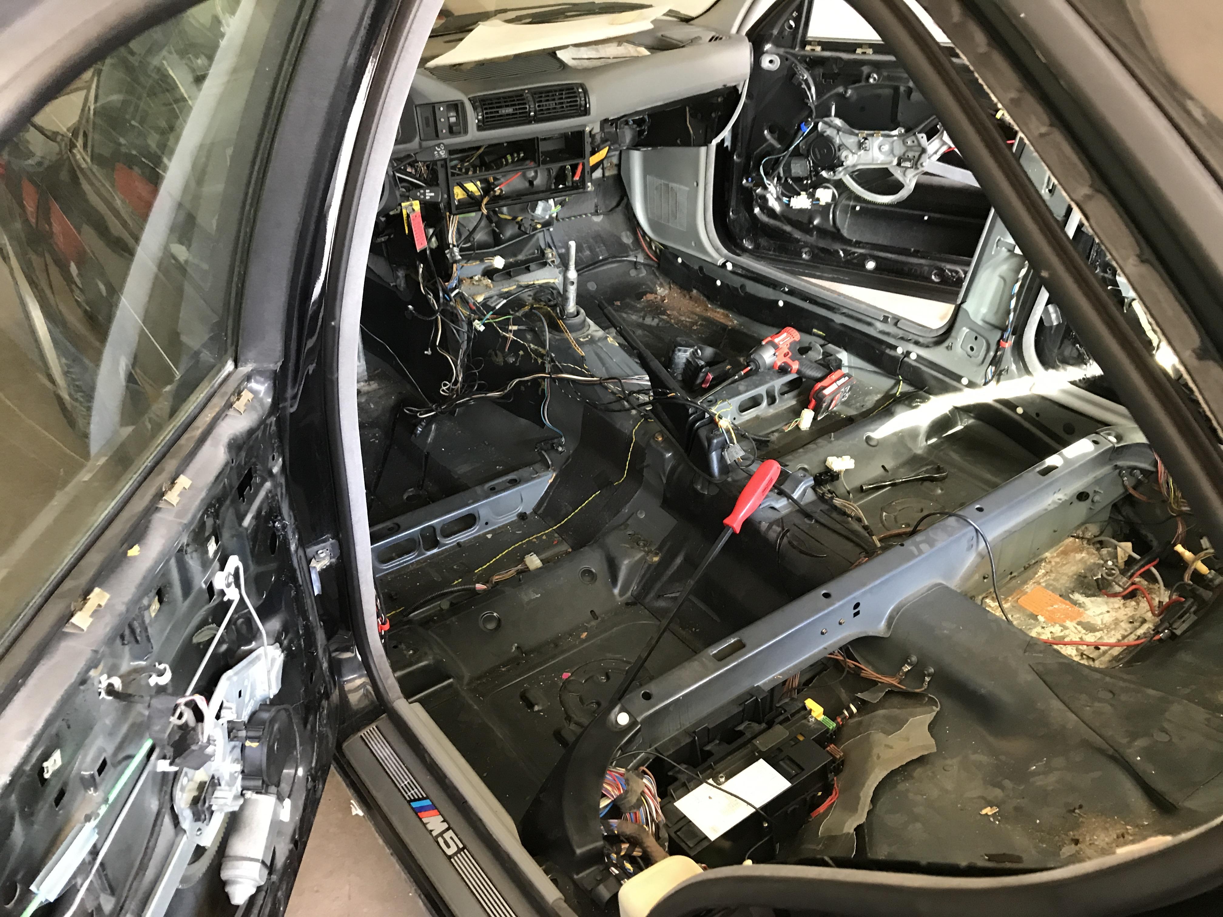

                      For now I've been pulling the car apart, I had a moment today in the garage as I was gutting it (easily lost 400lbs today) thinking how cool it would be to rebuild it, completely simplify the car, cage it, put some light bucket seats in it and use it, until the carpet came up and the skirts came off

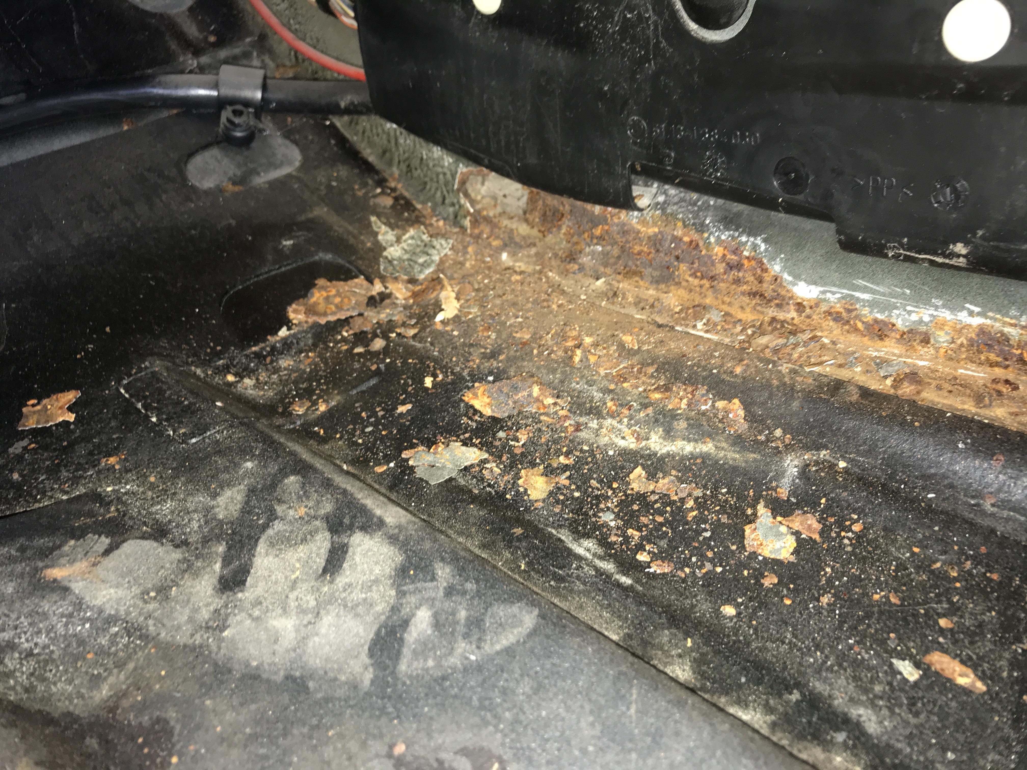

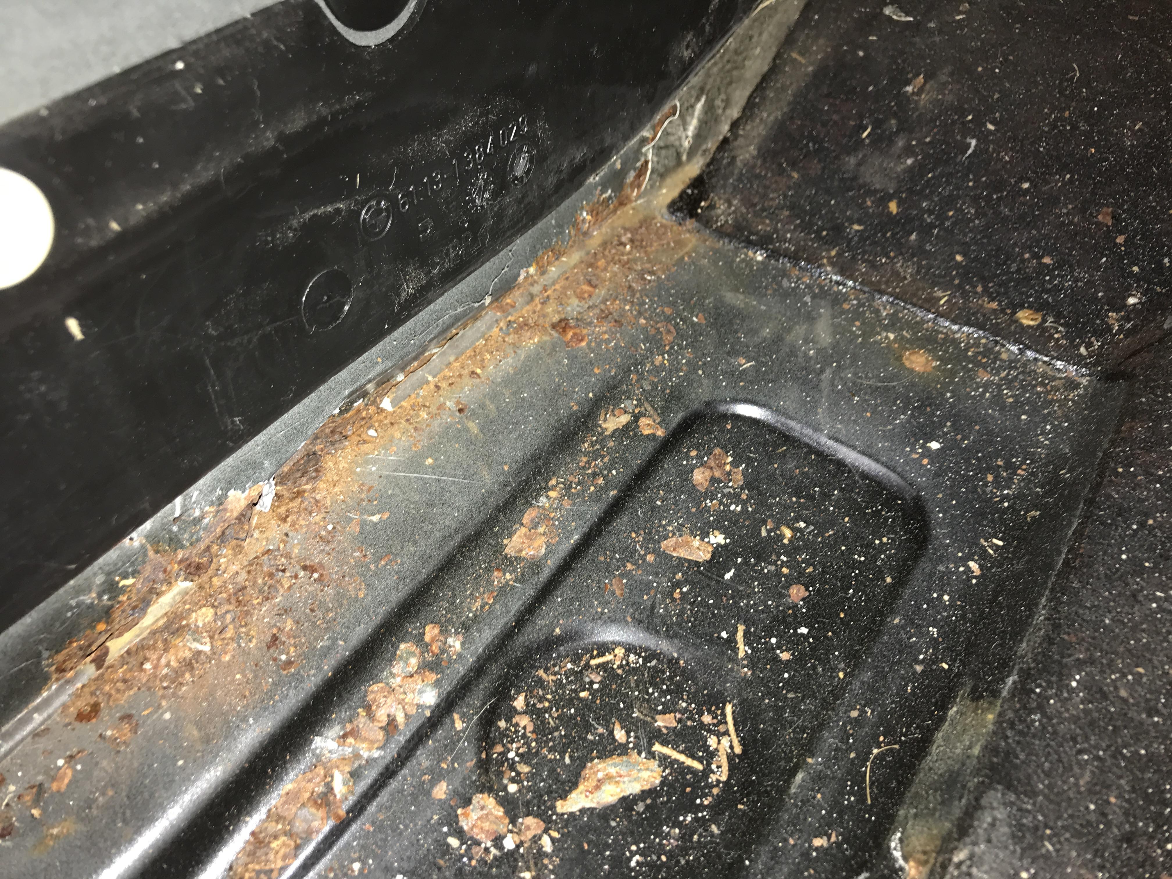

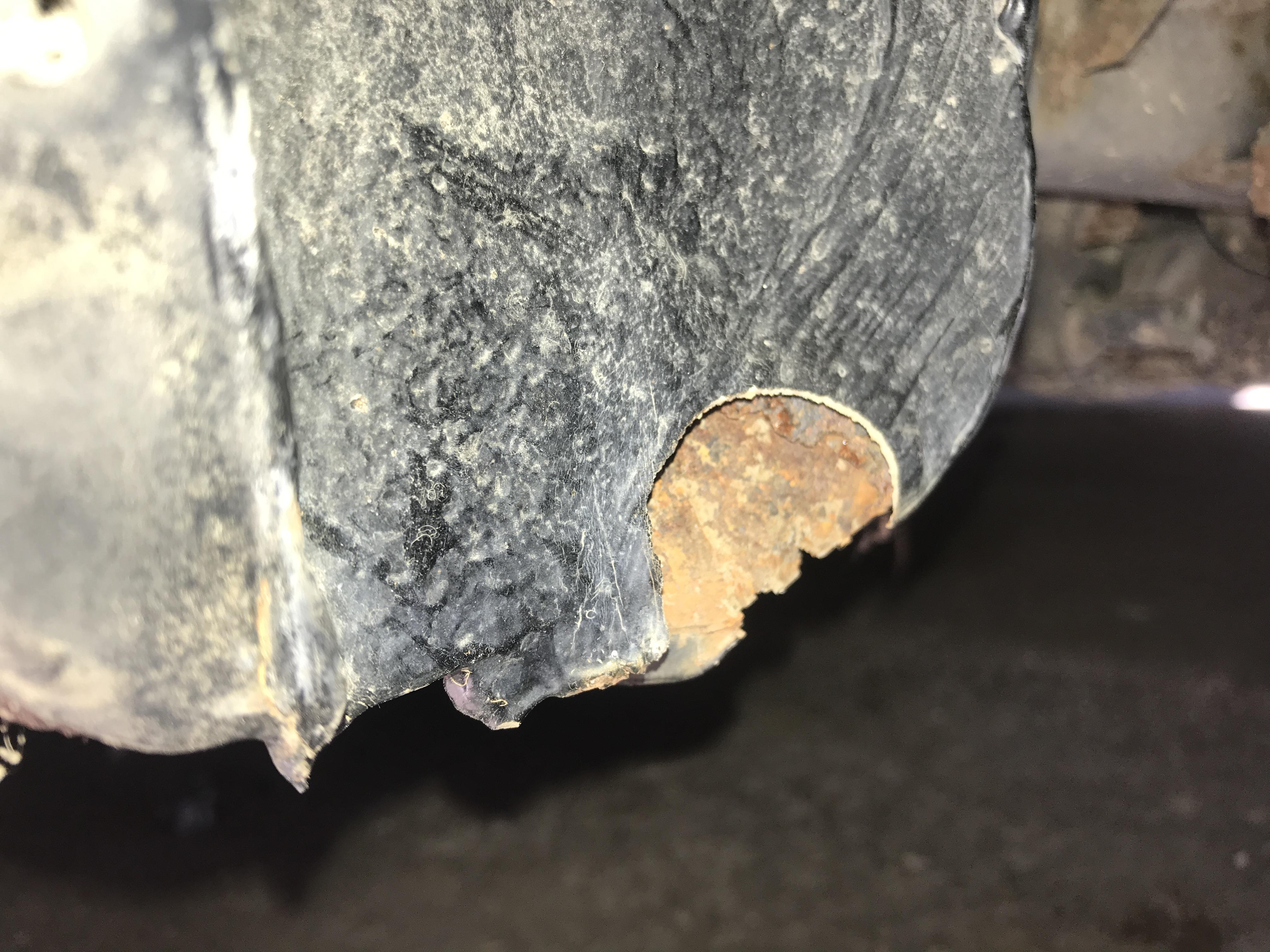

                      I had a lot of fun getting this skirt off. A PO jacked on the fender seam and bent the fender/skirt up into the body of the car with the bolt holding the skirt on smashed inwards. When all this shit fell out after the skirt came off I knew it was no good

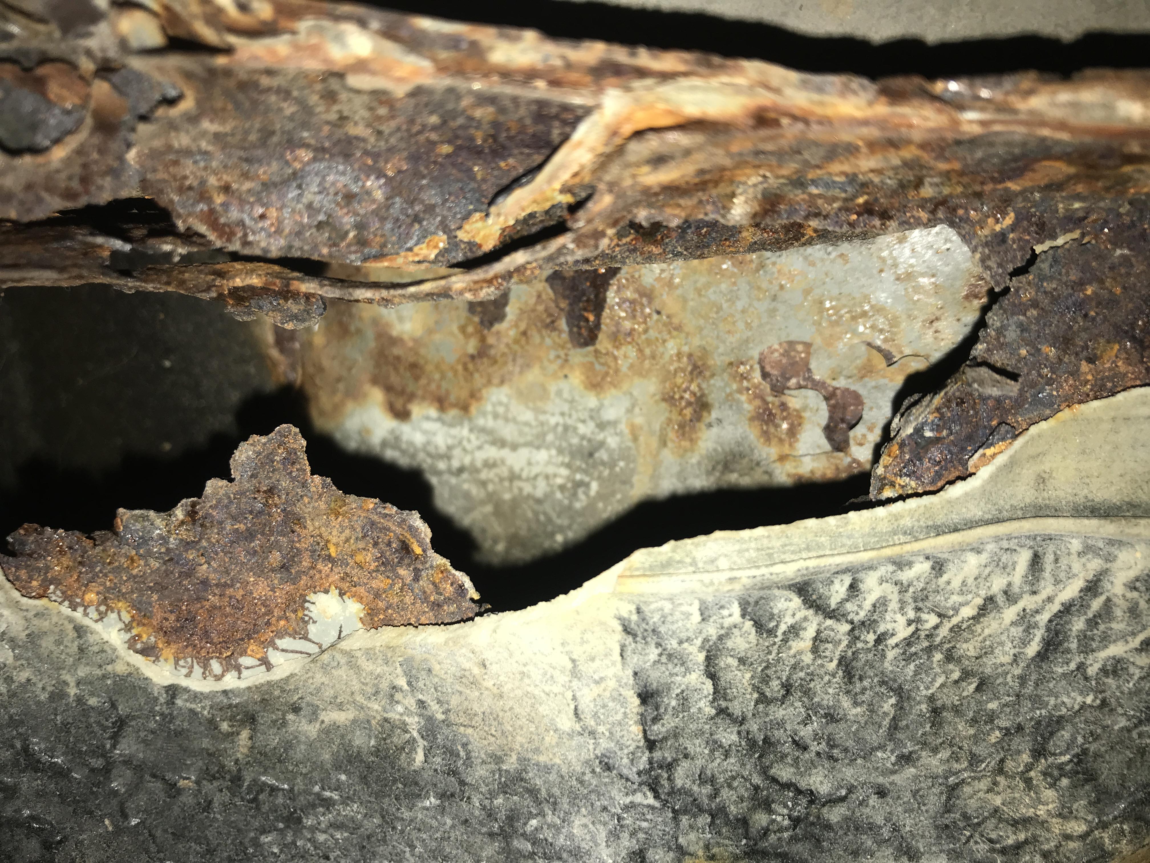

                      Yeah its bad up front. Extending beyond this hole towards the frame rails under the undercoating is completely soft. The metal has rusted away just leaving a sheet of just undercoating haha

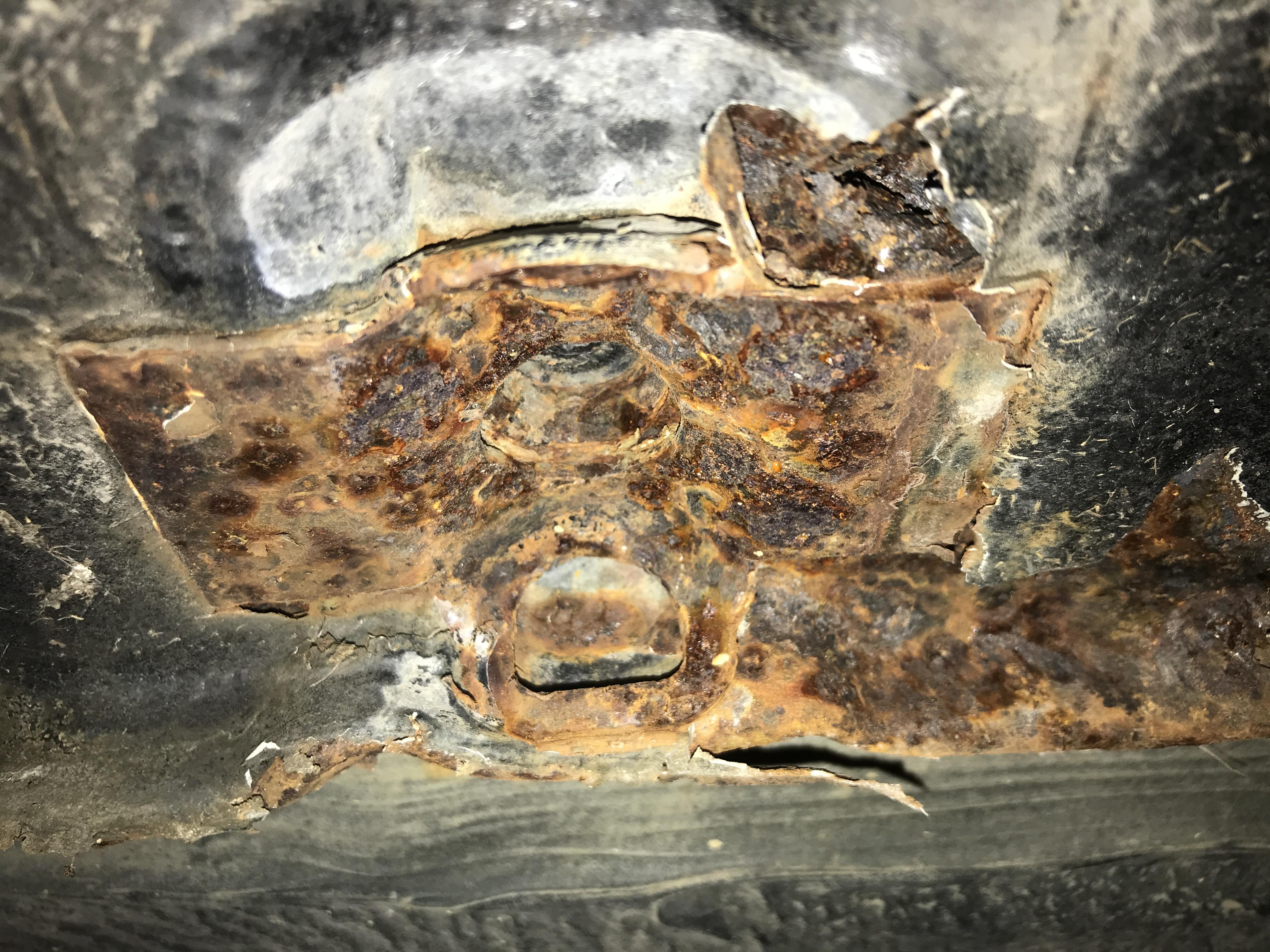

                      Can see the hole to the front right of the jack point, although it looks mostly intact it's made up of multiple layers of metal and they are all swollen with rust in-between the layers.

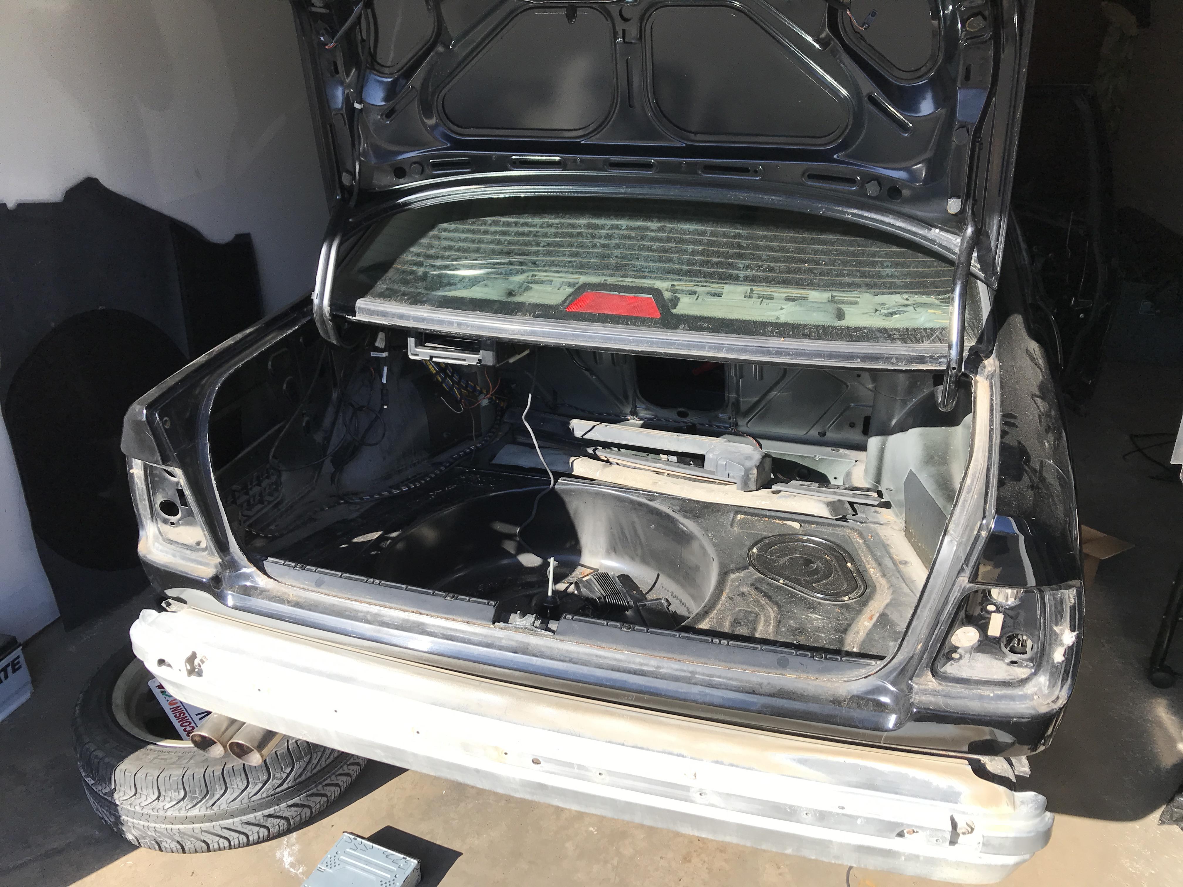

                      Rear wheel well, same story as the floor pan, completely rusted through under the undercoating up about a solid 6in beyond what you can see

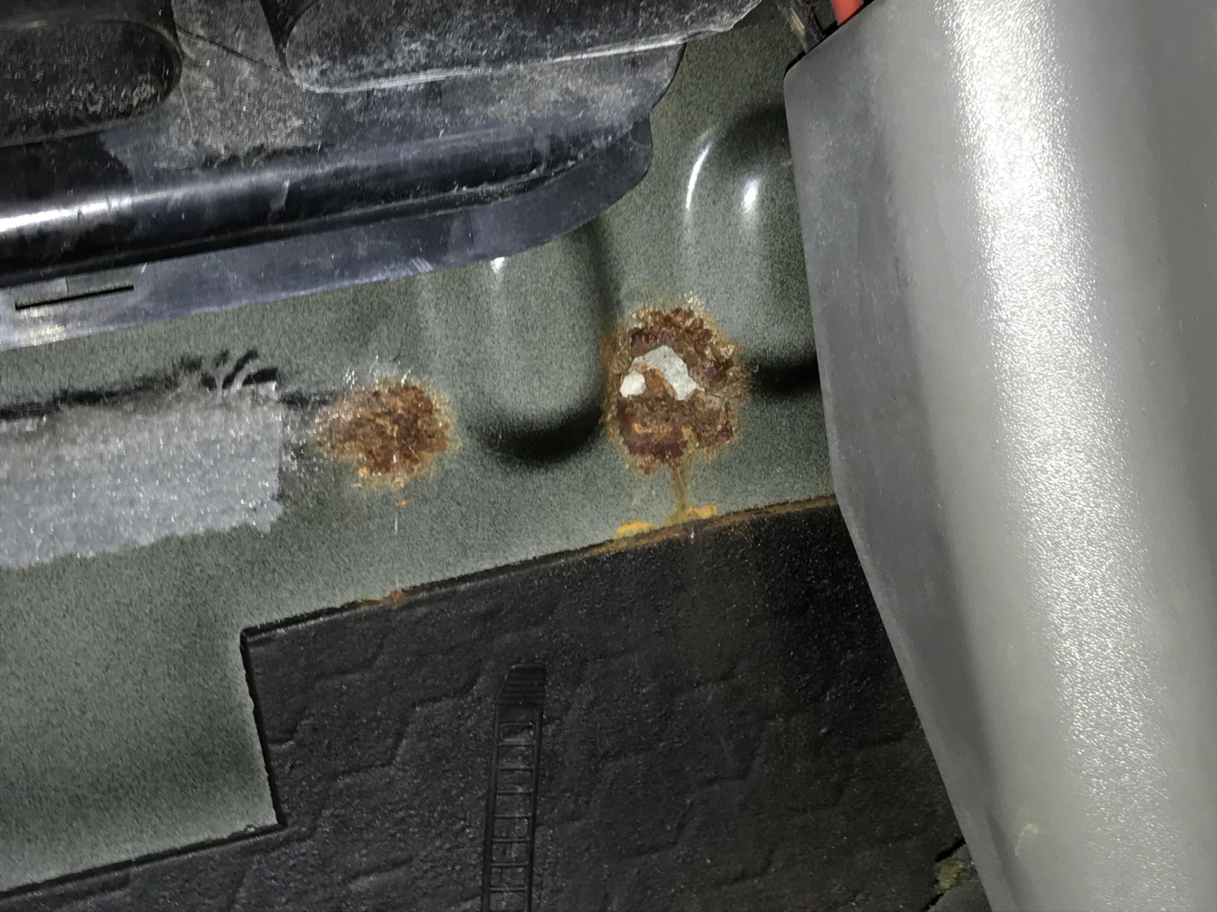

                      random firewall rust holes on the passenger side

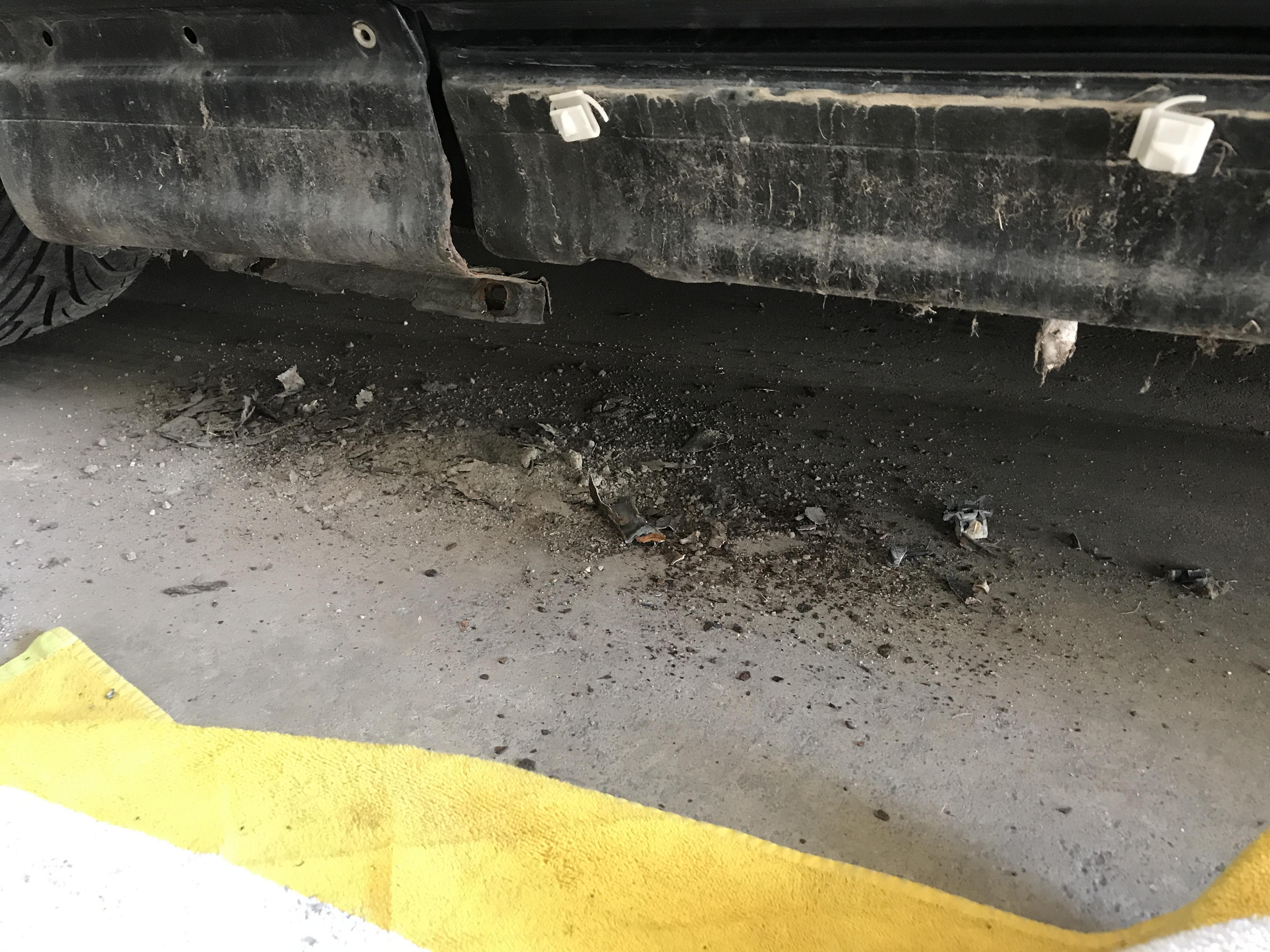

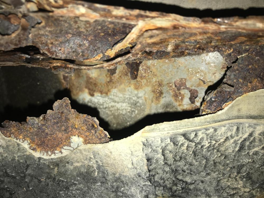

                      Hard to tell but this is a hole into the rockers
                      Same story but worse on the passenger side

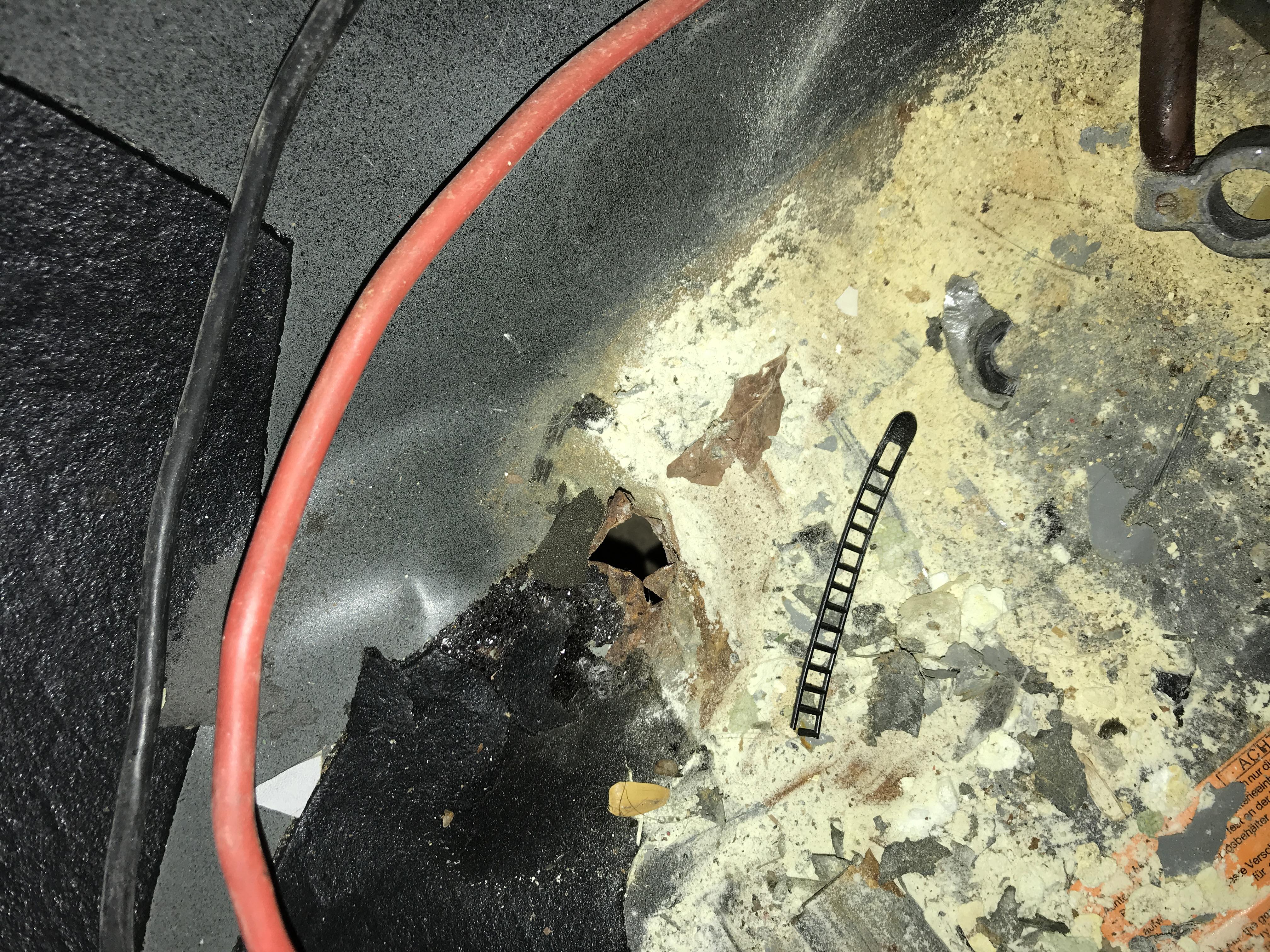

                      Mysterious rusty puncture hole in the battery area
                      Yeah so I've played this game before and I'm not going to again. I'm sure the inside of the rockers is horrifying
                      Funny thing is though, parts of this car are really rust free, the rear jack points, pan and rockers dont even have surface rust. No rust on the quarters, no rust on the rear trunk lip, fenders aren't rusted through. This was a texas car until 2002, The rust is probably from sitting uncared for in a wet environment with trapped water for 11 years and not salt. Shame
                      Making progress

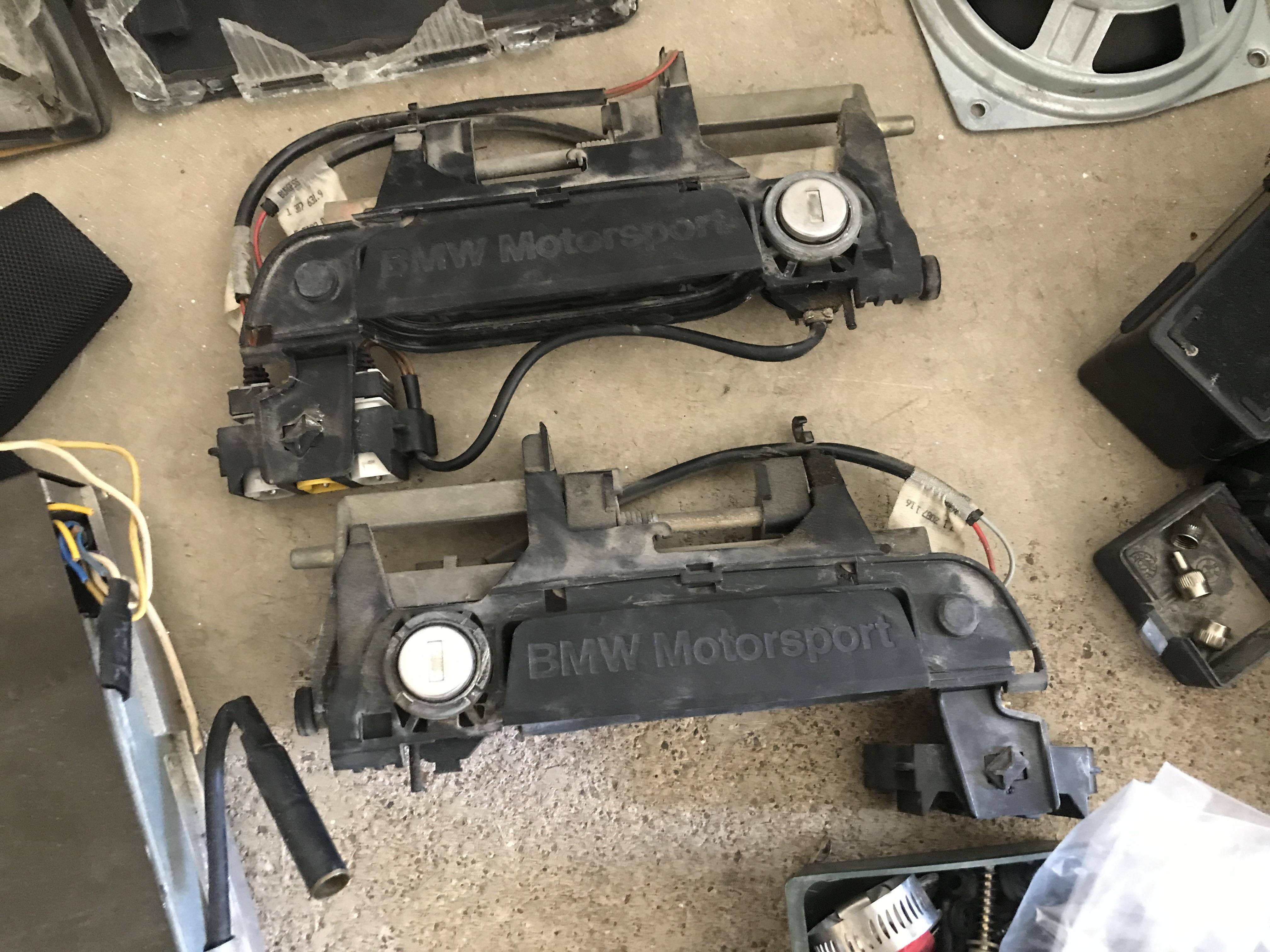

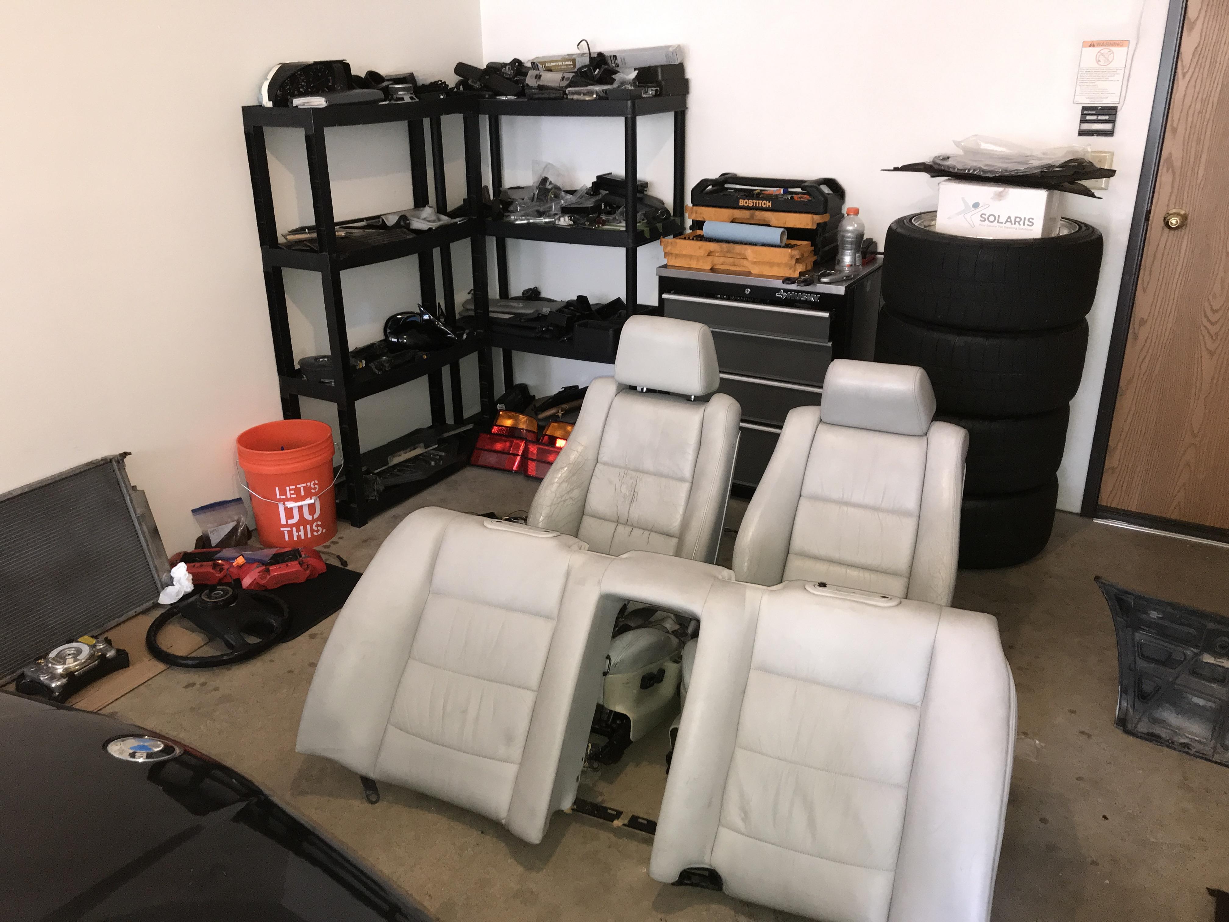

                      Idk what I'm doing with everything, I want the shell gone and all the regular e34 parts gone. I'm just kinda gonna hang on to everything M5 specific for now
                      It sucks doing this to this car, it really does. I feel bad every time my garage opens and you see such a special car with nothing but a M5 badge left on the rear.

                              Sad day. Yeah that thing is pretty gone. I feel your pain. Its crazy how much damage can happen from moisture.
                              At least you won't lose money with the parts from it.
