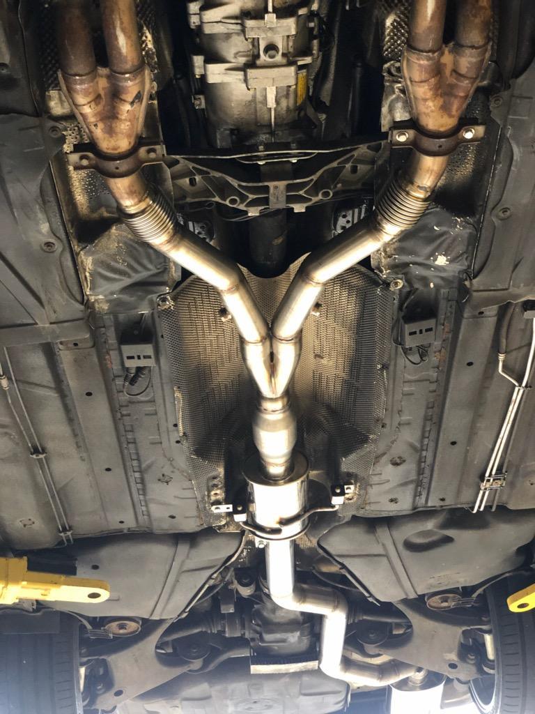

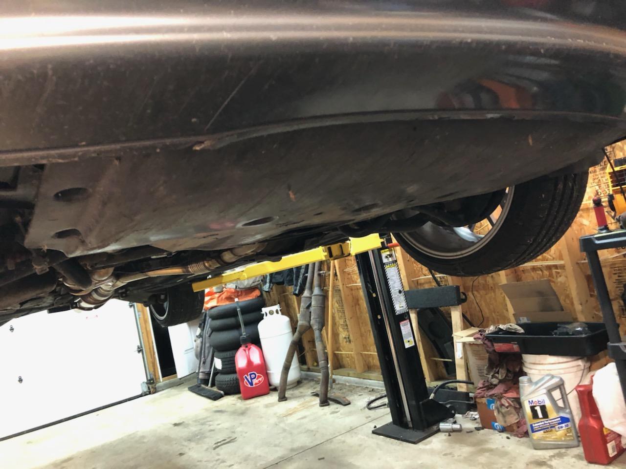

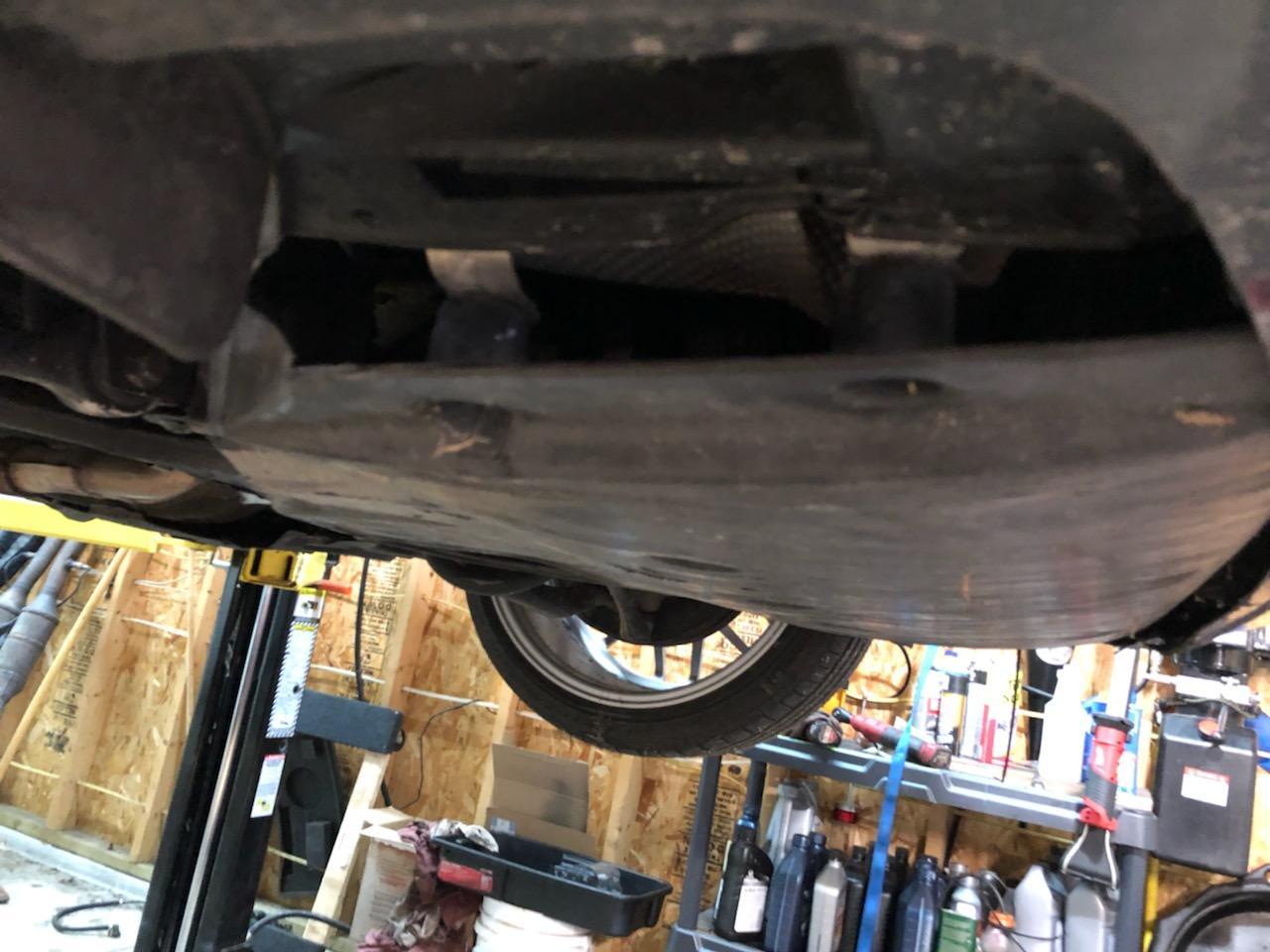

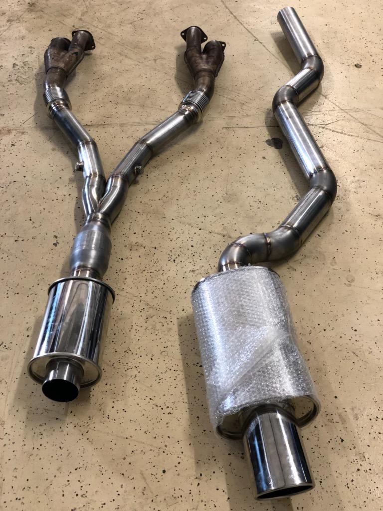

    Some sneak peek pics of the exhaust!  Can't wait to hear it!!
         @DrLeadFoot
      #122
      Wow!  That looks gorgeous!

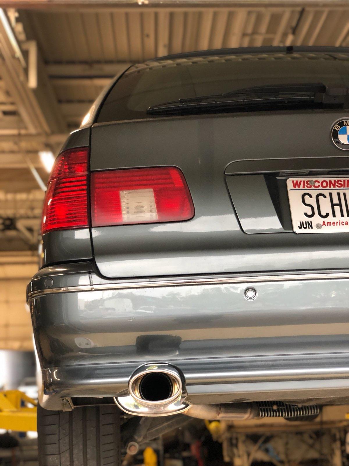

        Milo is more excited than me!!
        Loving the tone!  Quiet but sporty!  This thing hauls ass! No pun intended.

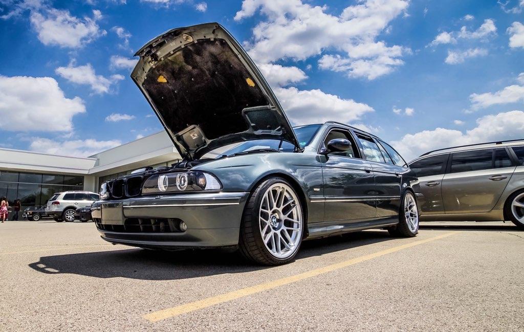

                First, family of 4, road trip to Door County was a success!
                Need to work out a few bugs and find & fix a new slow leak in the rear air suspension.
                Bugs include:
                - Code IKE to S62 coolant temp.  Getting an engine light due to coolant temp mismatch. (Need to swap back in 540i cluster to get the NCS software to work then swap back M5 cluster.  Need all VIN numbers to match in the modules otherwise I can't code.)
                - Look into fuel tank purge valve.  Getting a code from that not doing it's job for one reason or another.
                - Adjust headlights.
                     @DrLeadFoot
                  #128
                  This is so fucking practical that it makes me smile.  Glad you guys are enjoying it!
                    #129
                    Love the pics, the last one is great. Family truckster is an epic truckster. 😄
                      #130
                      I had the opportunity to see this thing in person today. Quite impressive. The exhaust note sounds spot on, especially at WOT! Thanks for swinging by, John!
                        #131
                        so much win.

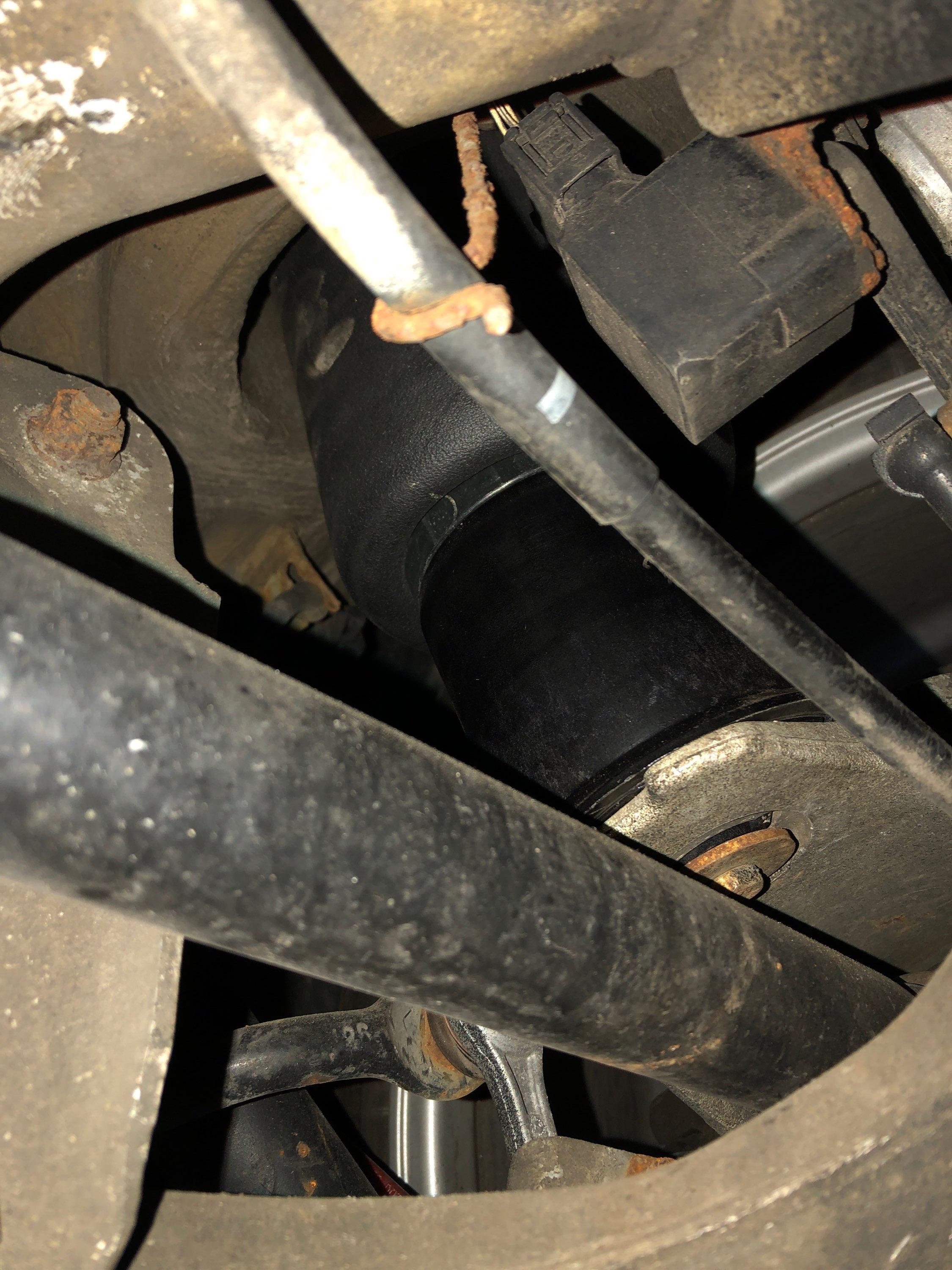

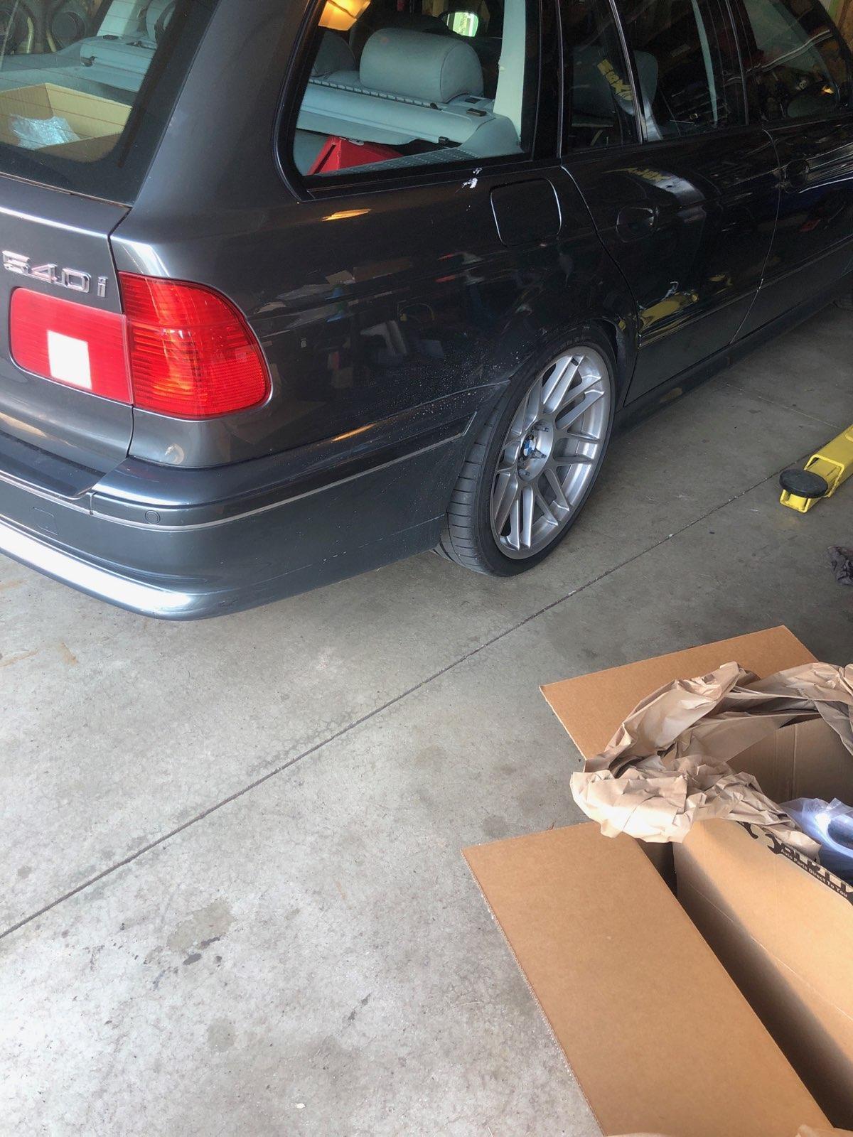

                          Driver's side air suspension bag replaced with oem bmw.  As I was pulling into Mike's garage the code for inactive air suspension came on the dash.  Perfect timing!
                          He also popped on the front M5 under panel.
                          Hopefully the confirmed old leaking bag was the problem!  The morning will tell all. Fingers crossed!
                               @DrLeadFoot
                          • DrLeadFootD
                            DrLeadFootD
                            DrLeadFoot
                            #133
                            Mike swapped lines and the leak switched sides. The 3rd Doorman pump is on it's way.  Thank goodness for a lifetime warranty.

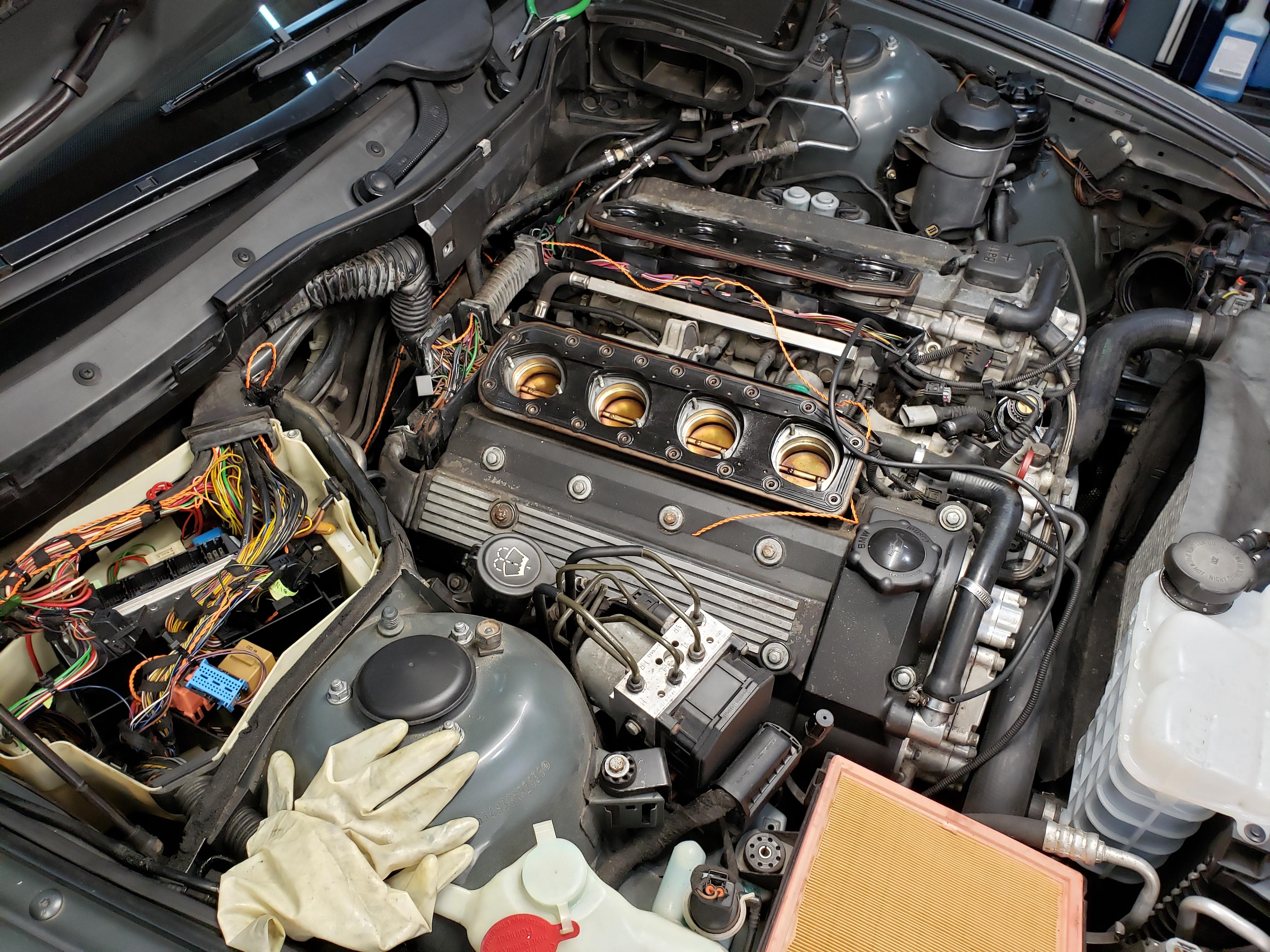

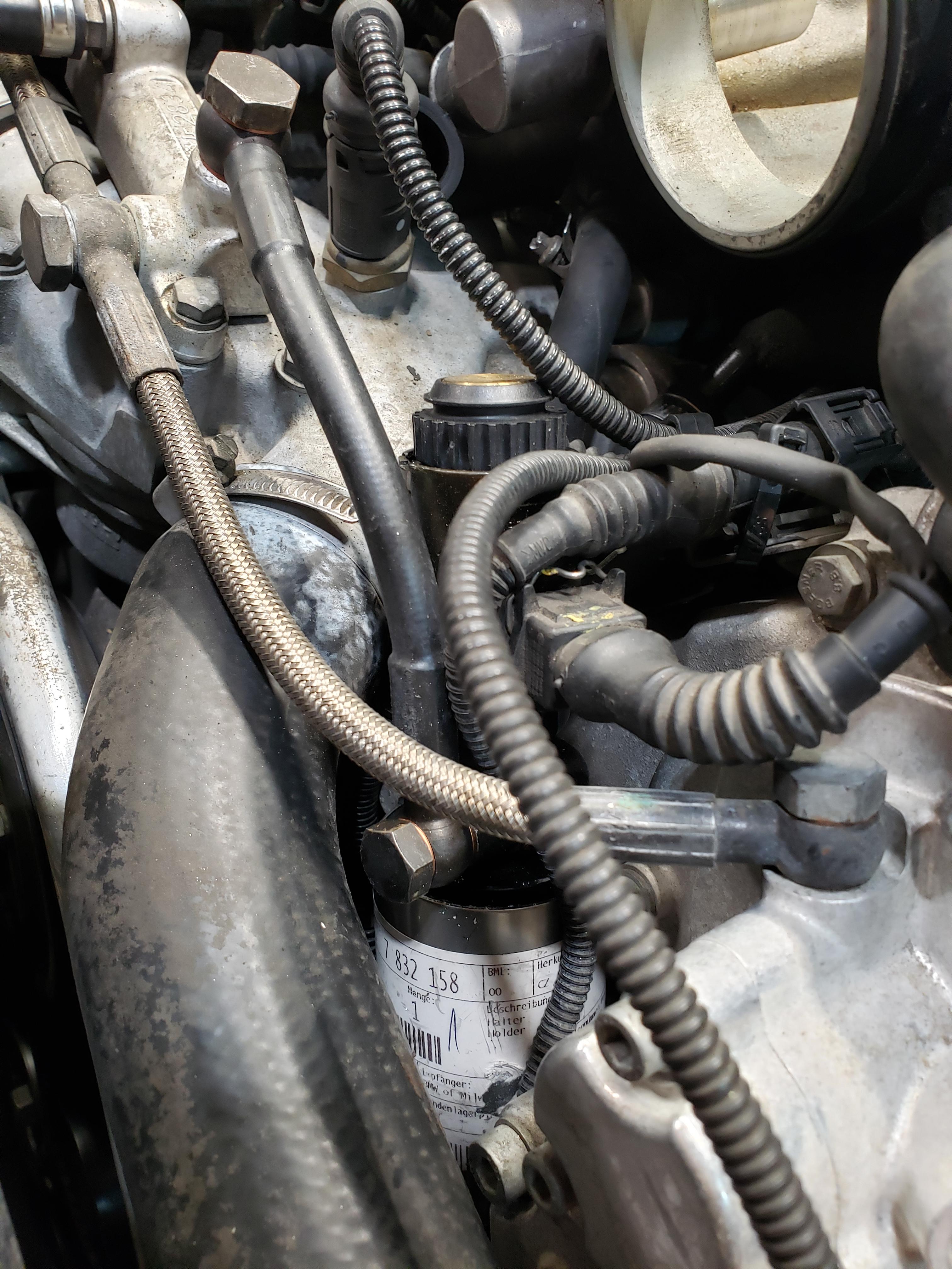

                                        Update! The wagon has been running great!  I've been chipping away at some minor coding things here and there.

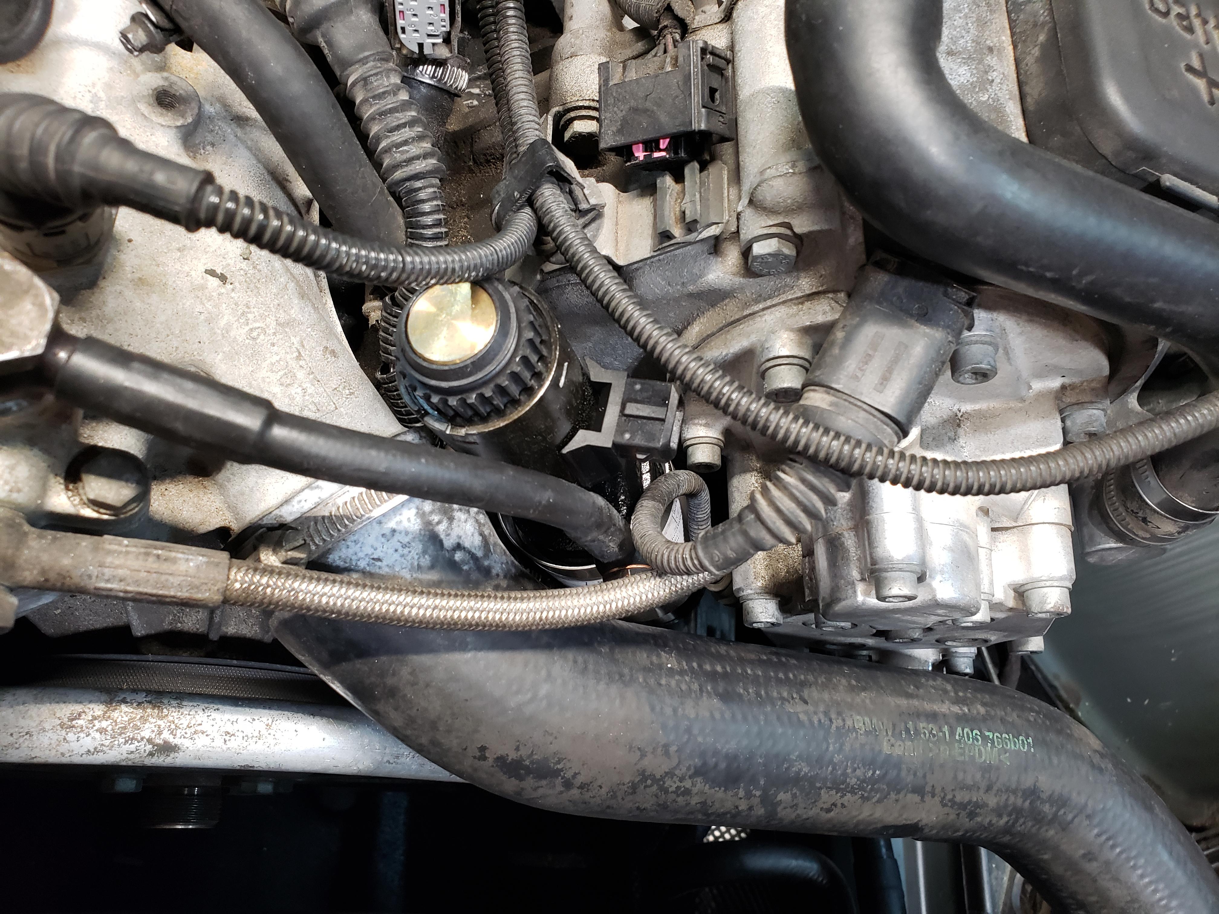

                                        Turned some wrenches last night at Mike's house and added the updated nitrogen charged oil accumulator. This one has a valve that locks in oil pressure when the car shuts down and on start up it immediately throws pressurized oil into the vanos units to stop the 12v Cummins Diesel sounds.
                                        Had to run a signal wire to the DME (Pin 8 on the module 2 connector) and splice into a ground crimp. My DME was apparently one from a newer M5 with this option as I was getting a accumulator error code.  No coding necessary!  Thank goodness!!

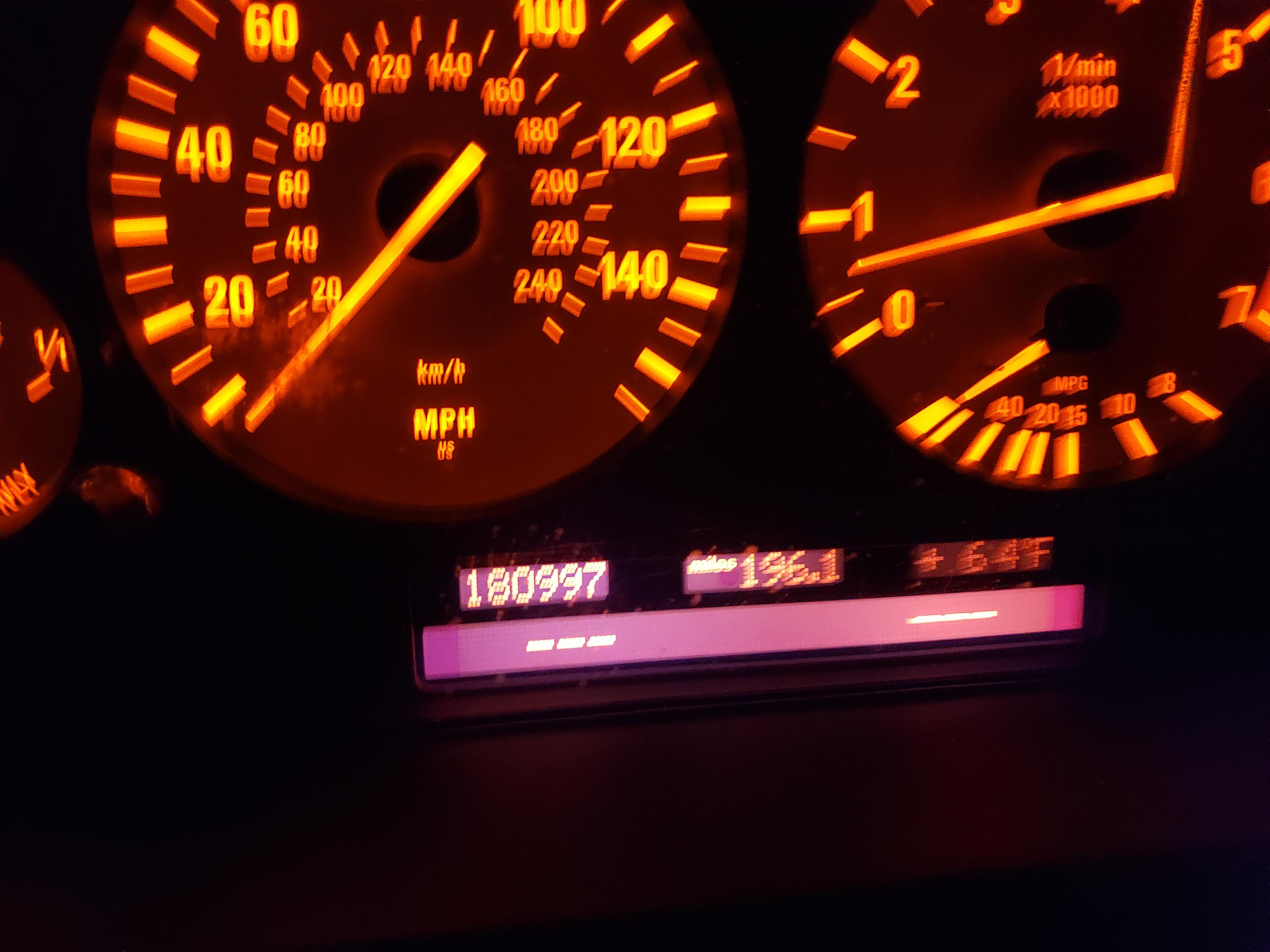

                                        Did an oil/filter change (181000 on 540i cluster) after buttoning everything up and it was clattering for a second then ran quiet as a mouse!  I'm wondering if the old accumulator lost its pressure.
                                        Replaced the cracked fuel pressure vaccum hose under the intake.  Noticed both my cyclone separator return lines are totally mush and cracking so I will be replacing those next week and doing a thermostat and possible water pump as a while I'm in there approach.
                                             @DrLeadFoot
