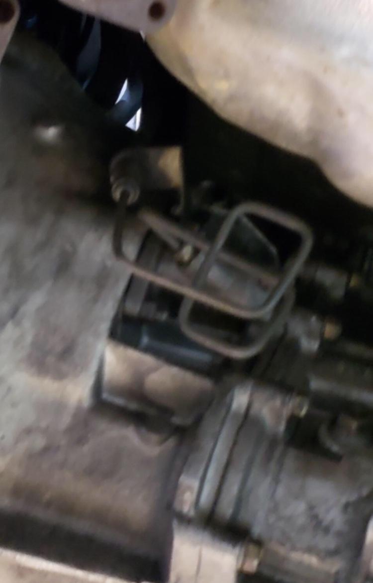

    4A3FC8BF-81A3-429E-8875-F0F5F9508600.thumb.jpeg.3f15e1e3970822abb36b5b3f6ed39f02.jpegThat is quite the clutch hydraulic line!

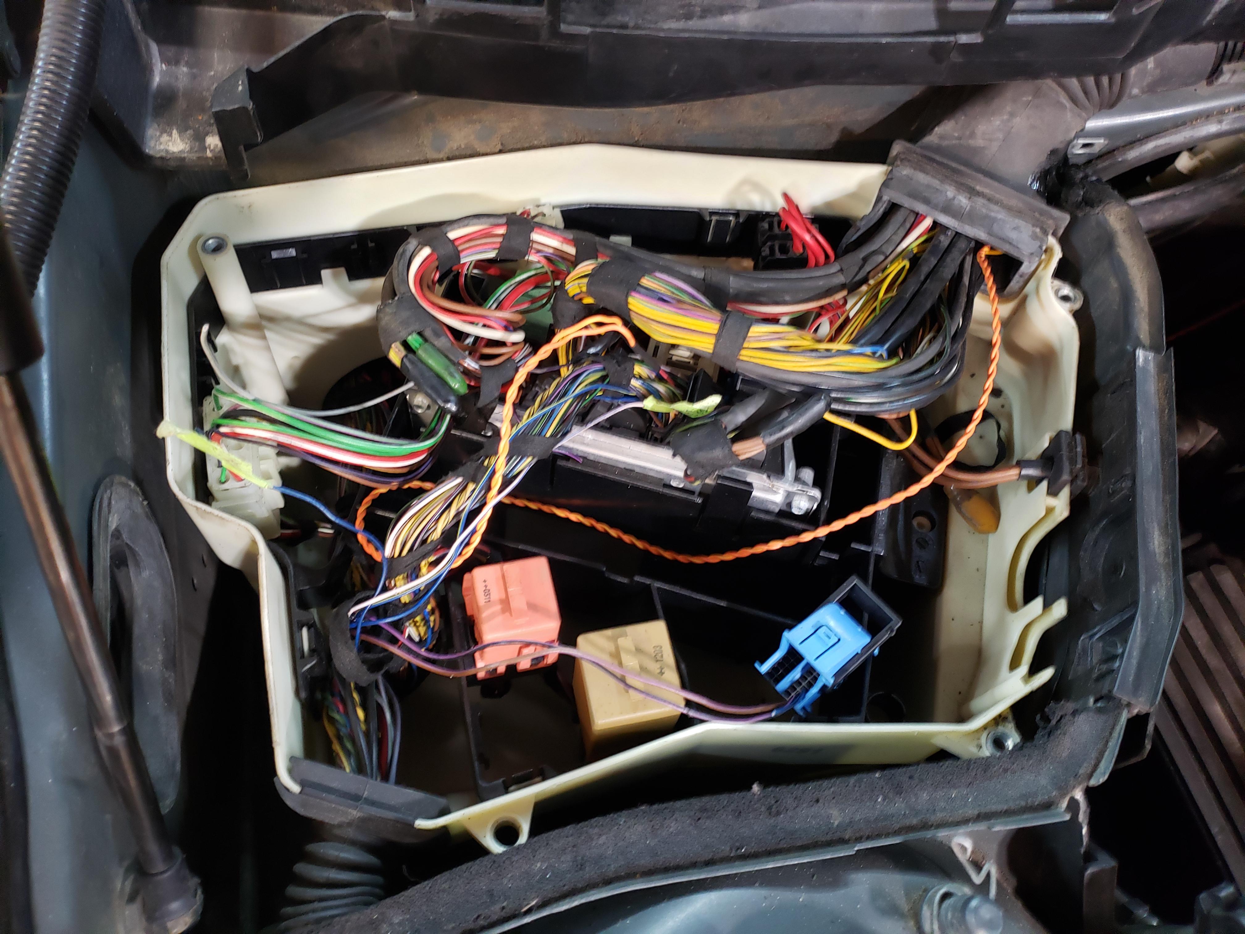

      Got the topside wired up, sport button and servtronic!
      Need to pop in new style fuel pump relay. Have run a ground wire to it and move a pin on the 540i female side of connector and the new style relay will be good to go.
      Pin 2 wires behind the cluster.  One to the DME for reverse lights and the other to the clutch switch.
        Not looking forward to bleeding that! Lol

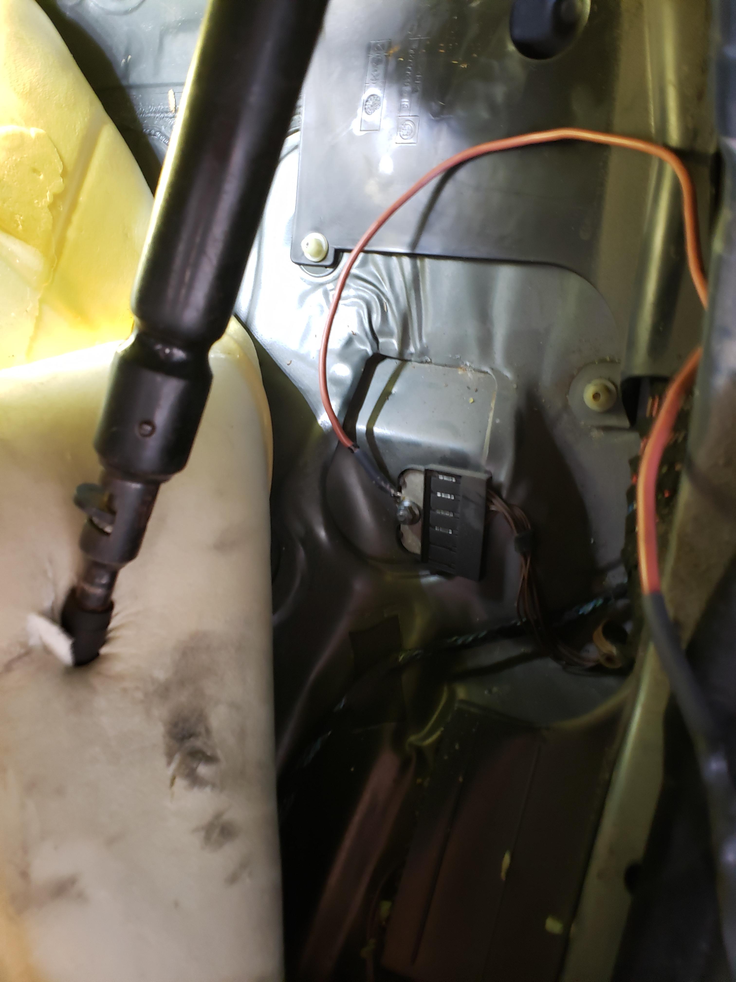

          Finished up the cruise control, clutch interlock and M5 fuel pump relay wiring.  Mike added a proper ground for the fuel relay.

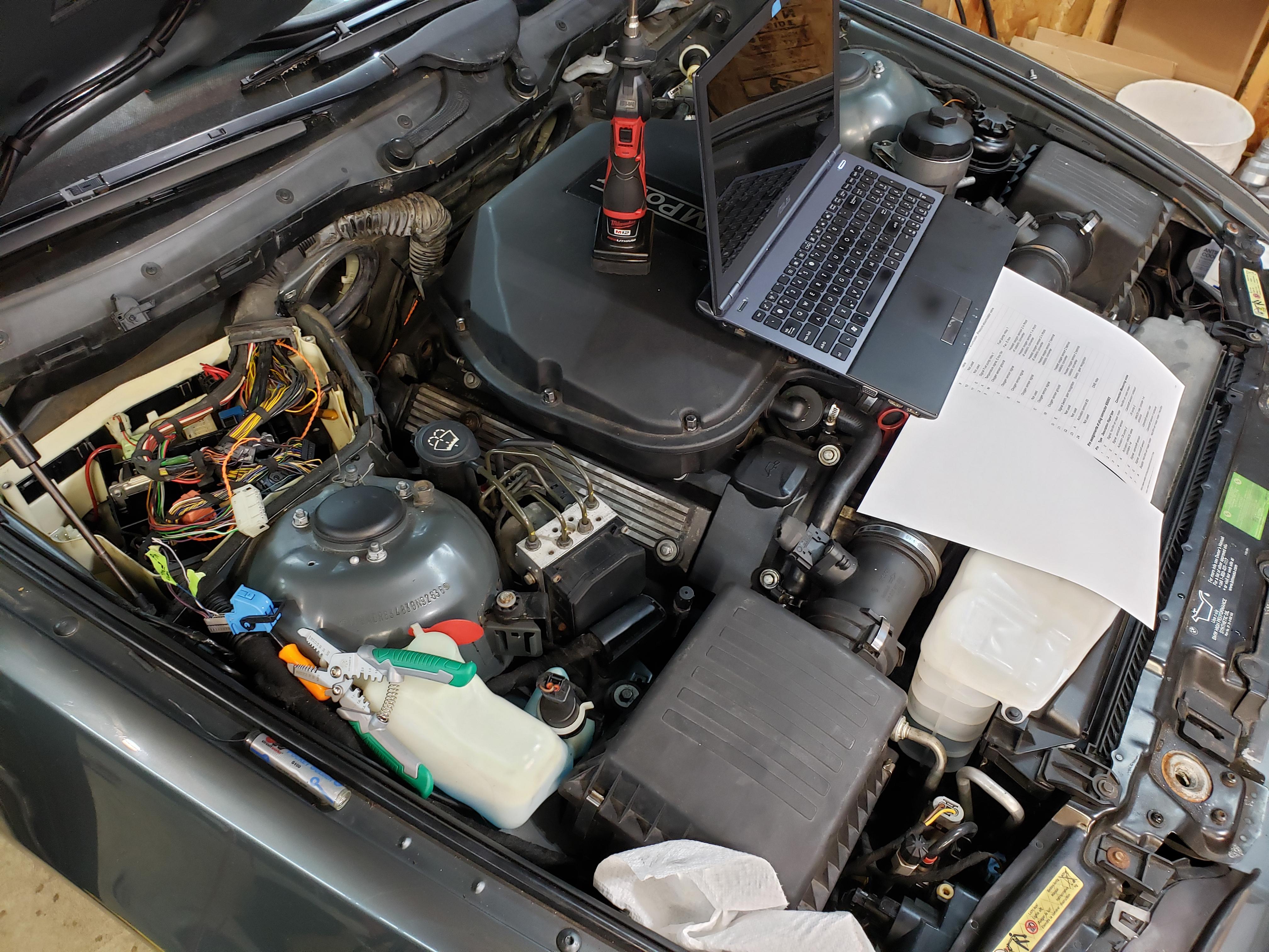

                                    Did some coding to get the DSC light off and threw on the summer wheels!
                                    Had to switch 2 sensitivity settings to S62B50 and the light went off!  Went from 10 to 13 on one and 3 to 2 on the other.
                                    I still need to get the dsc/abs module to think it is a manual but that needs to be done through the IKE (cluster) but I already popped in the M5 cluster so the VINs don't match up.  Might need to pop in the 540i cluster to code it to manual then swap back to the M5 cluster. Need to look into this further.
