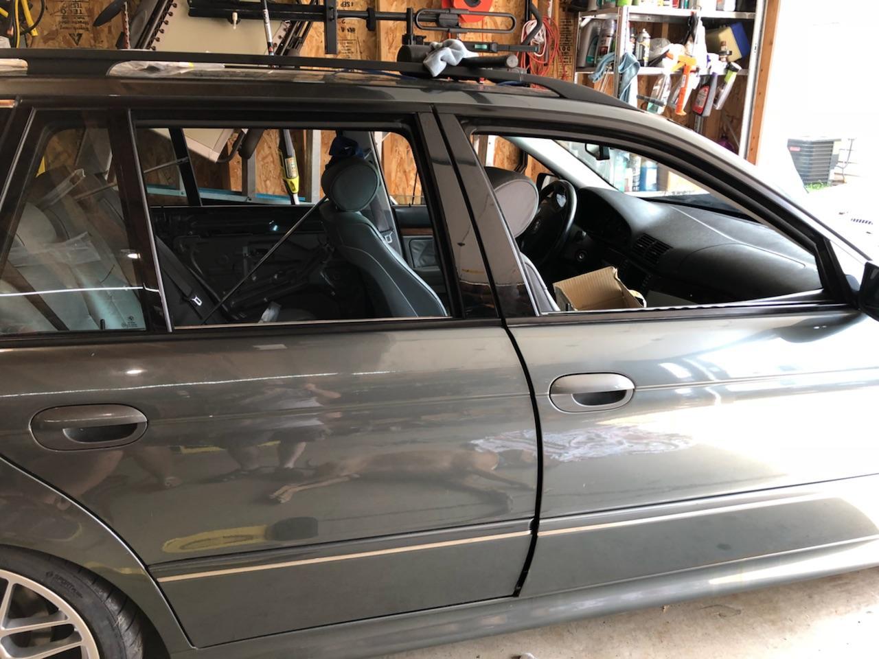

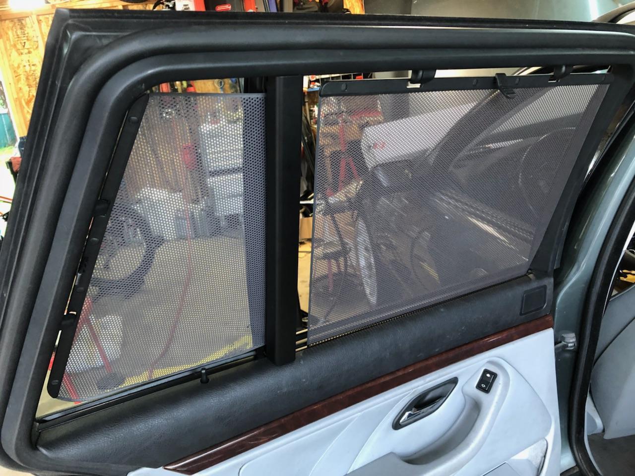

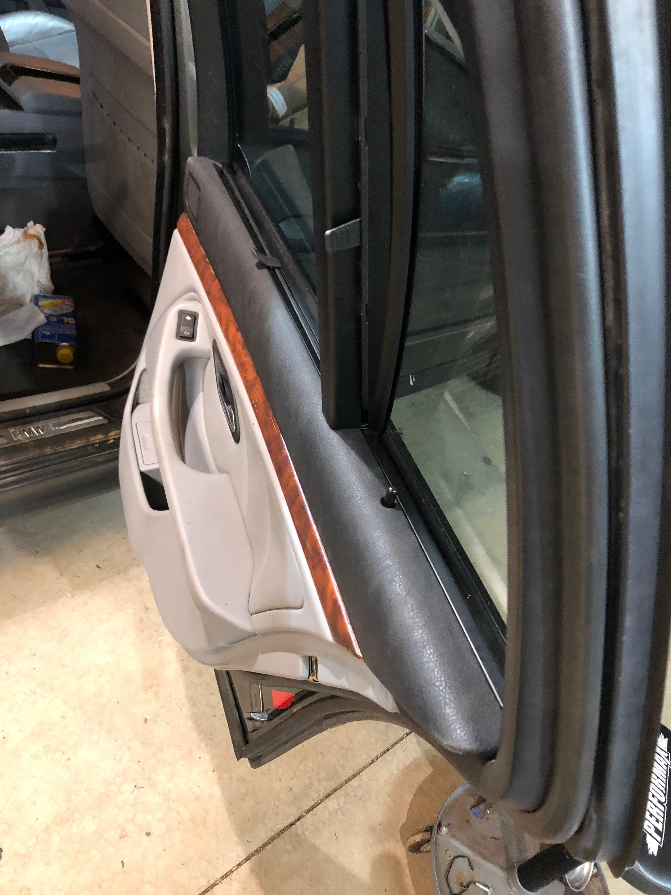

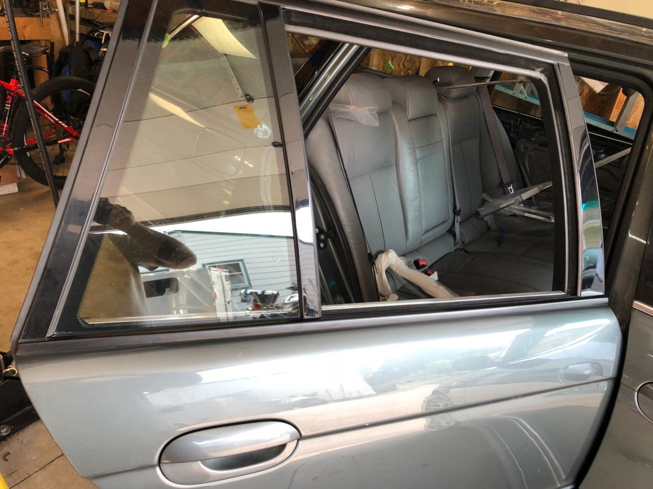

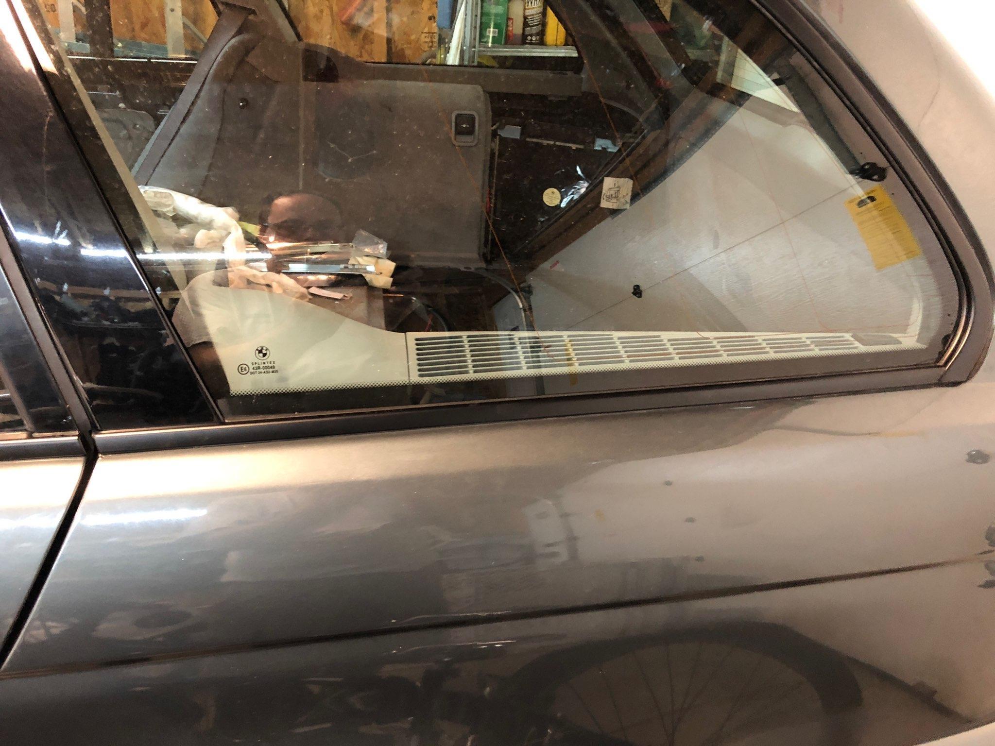

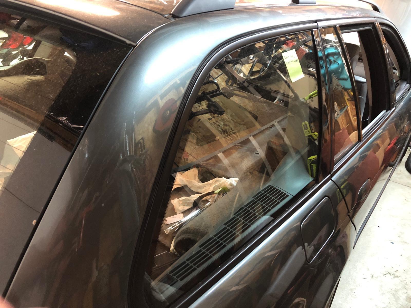

    The car didn't come with rear shades but I found some shade door cards but had to new new OEM shades as the ones with the doors were ripped.
    Started switching all the chrome window trim, inside & out to the black sport trim. With new interior & exterior weather stripping as well.

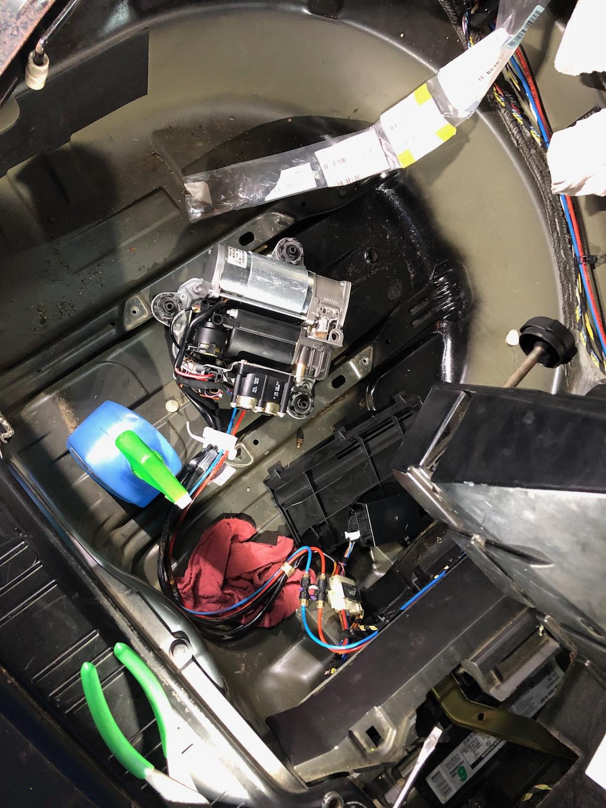

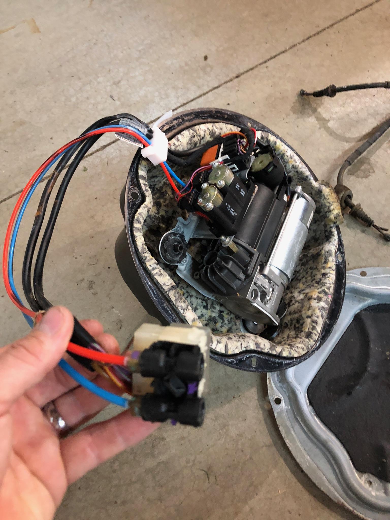

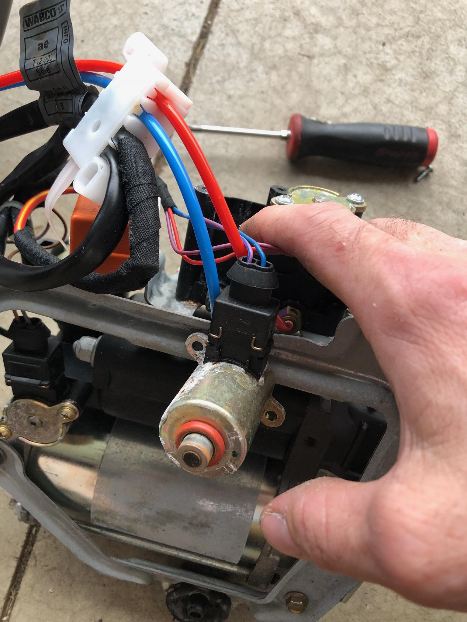

    Air suspension troubleshooting headaches engaged. Had to get a new pump.  New pump was leaking so got a new, new pump.

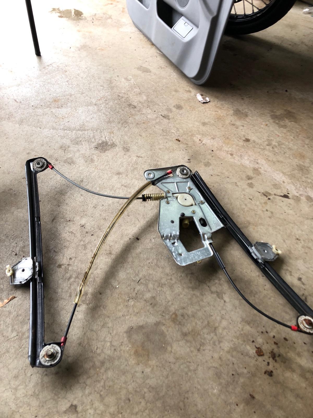

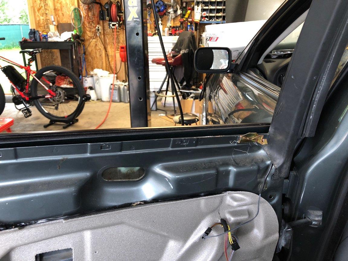

    New, used, front drives window regulator.

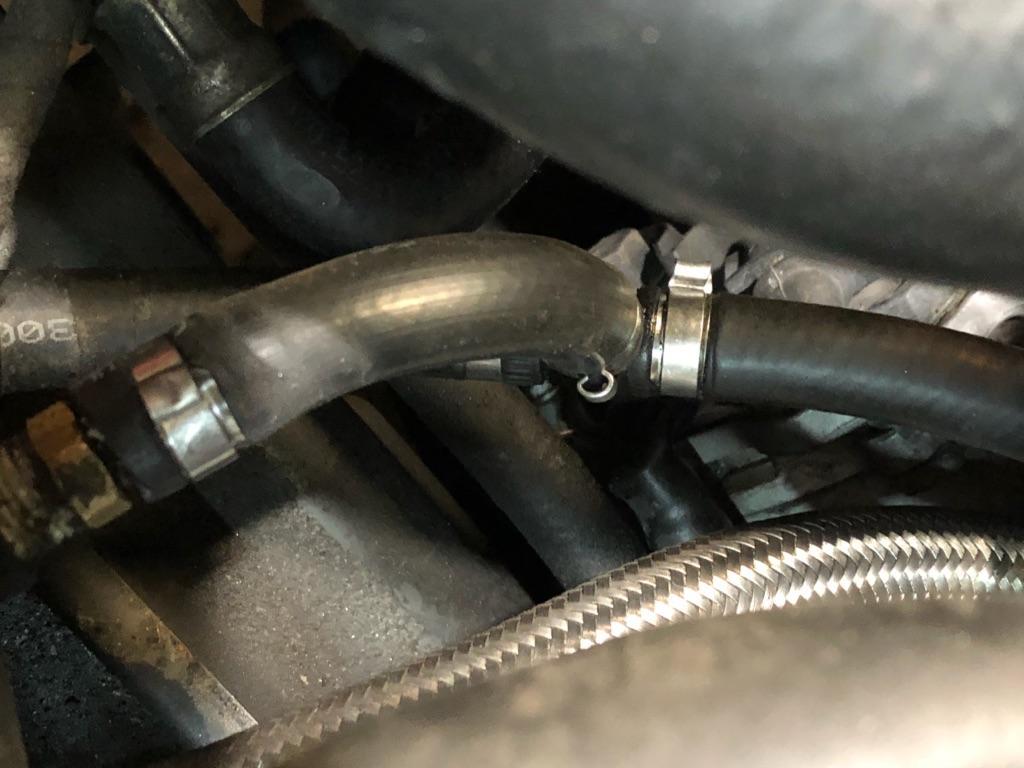

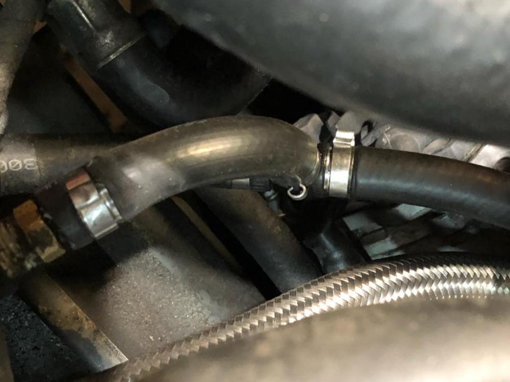

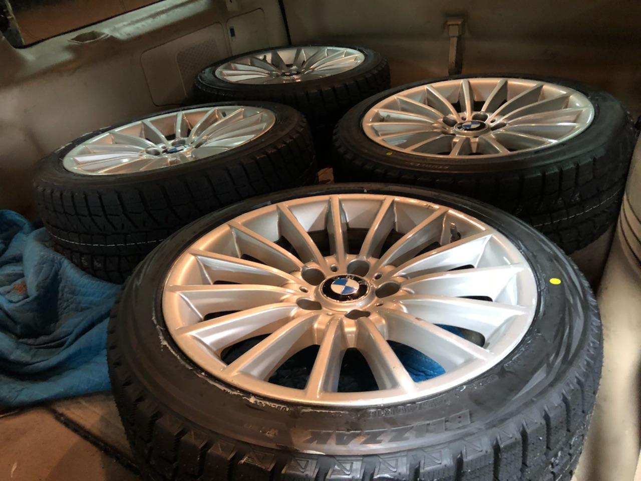

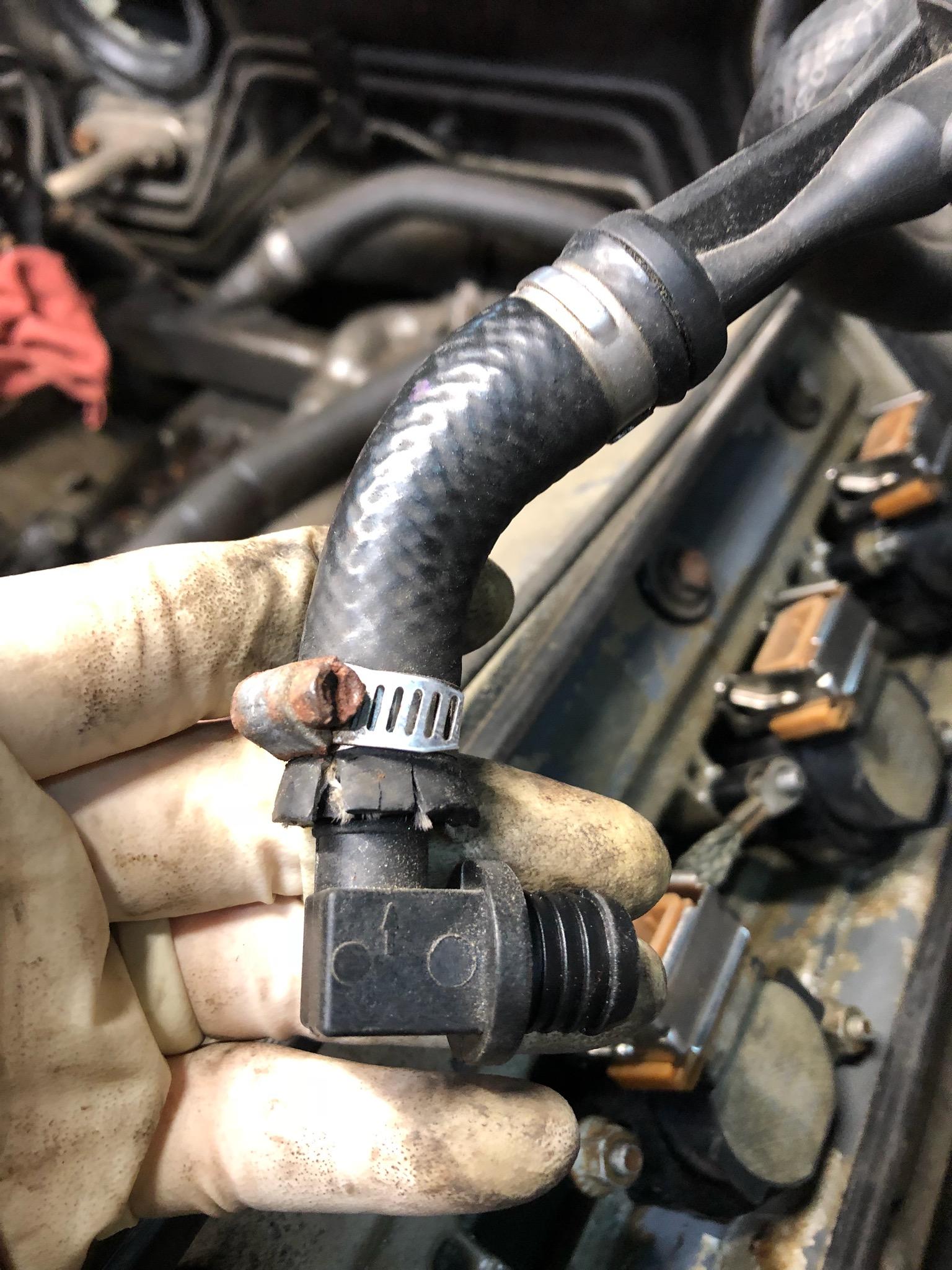

    Replaces some old hose clamps with the crimp style.  Got the winter tires/wheels ready to go.

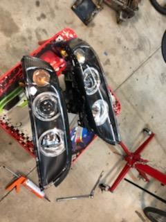

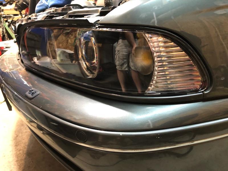

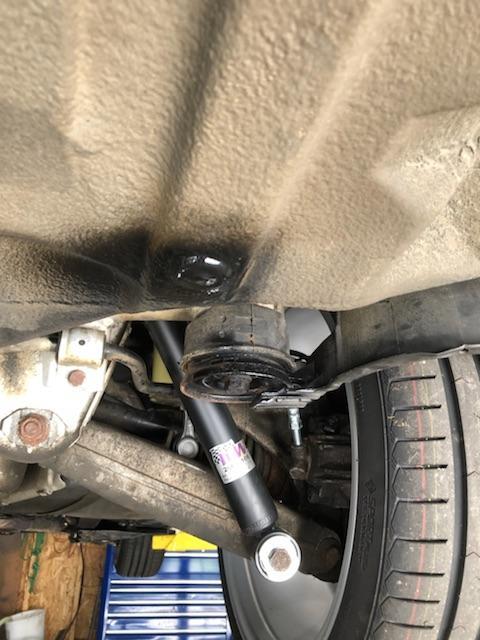

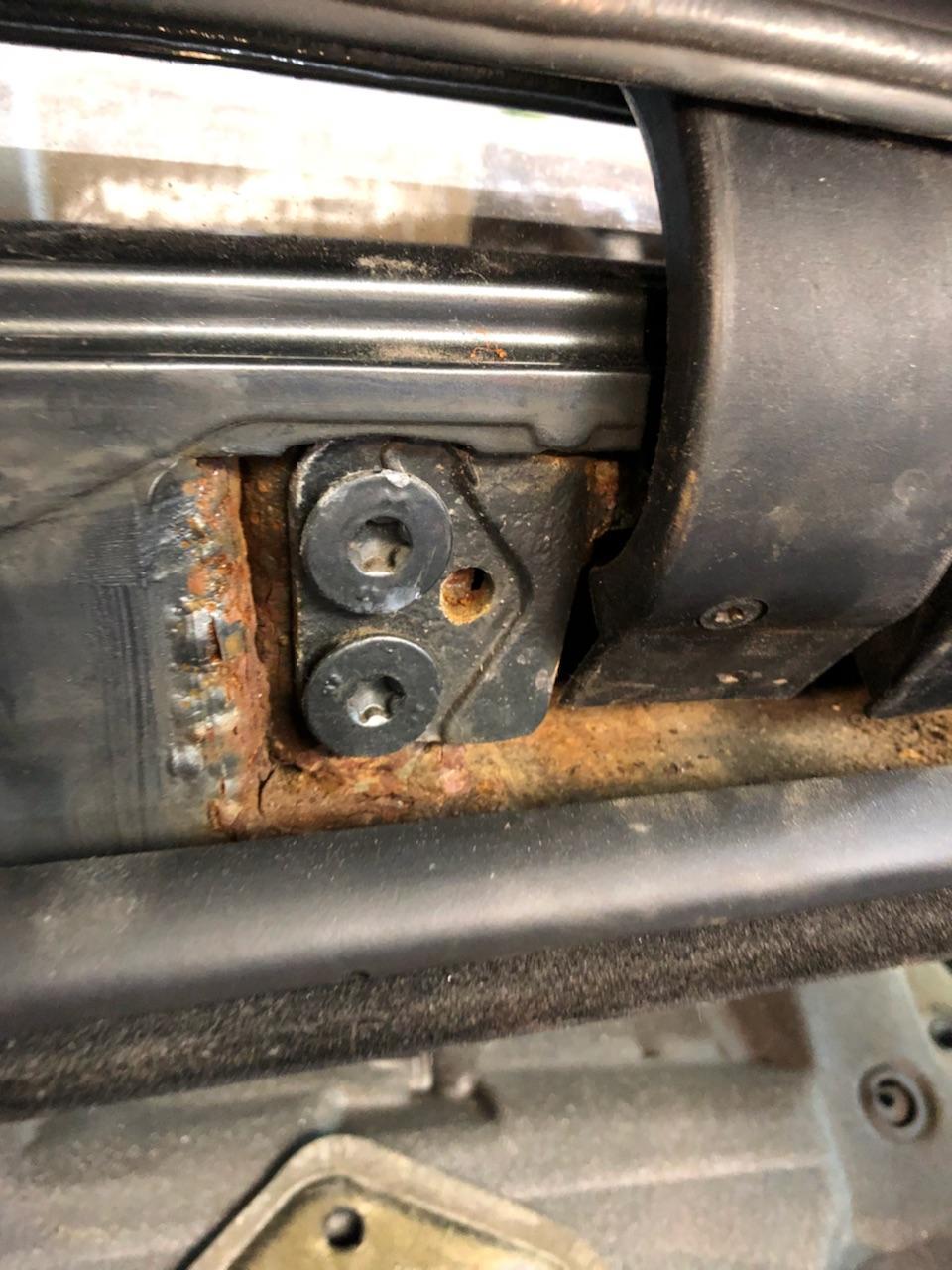

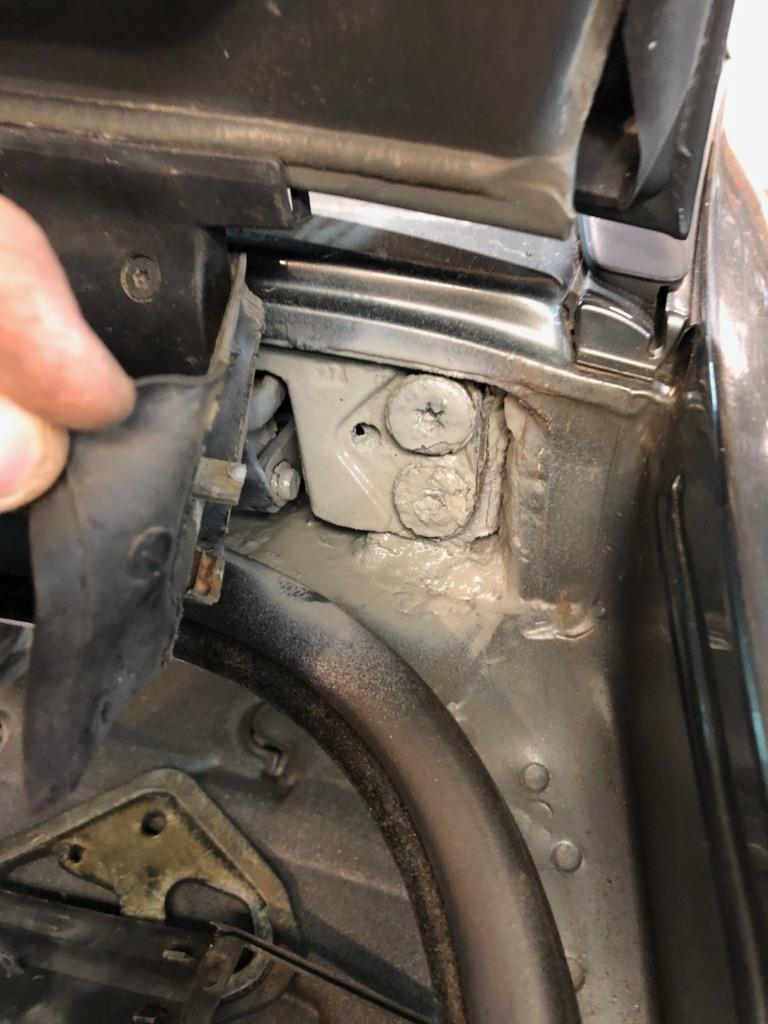

      New headlight lenses.

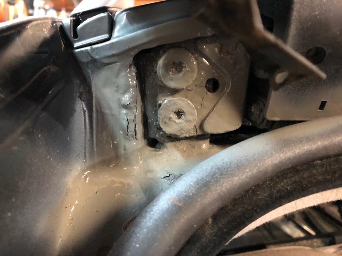

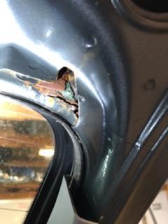

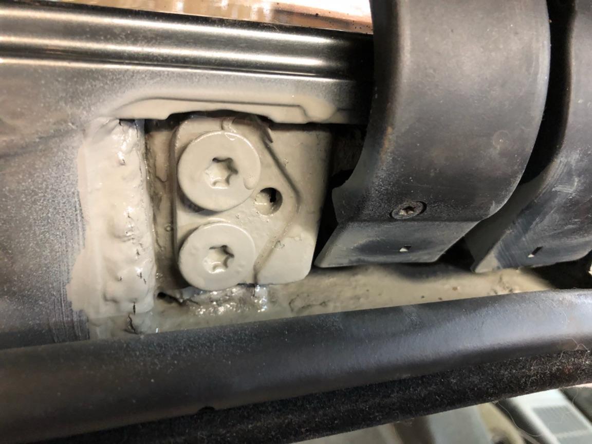

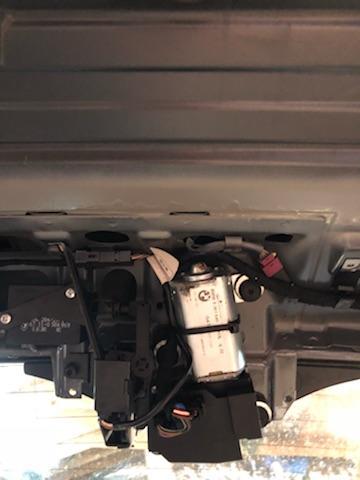

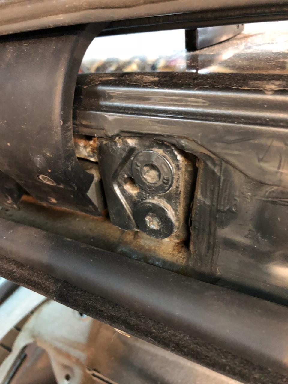

      Tailgate is rough.  Might try to buy a new one.

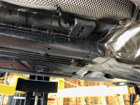

      Scraped, primed and painted a bunch of rust.

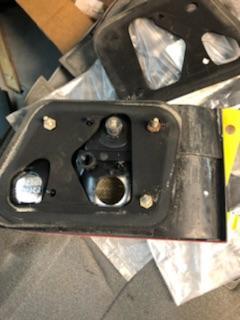

      New taillight seals.

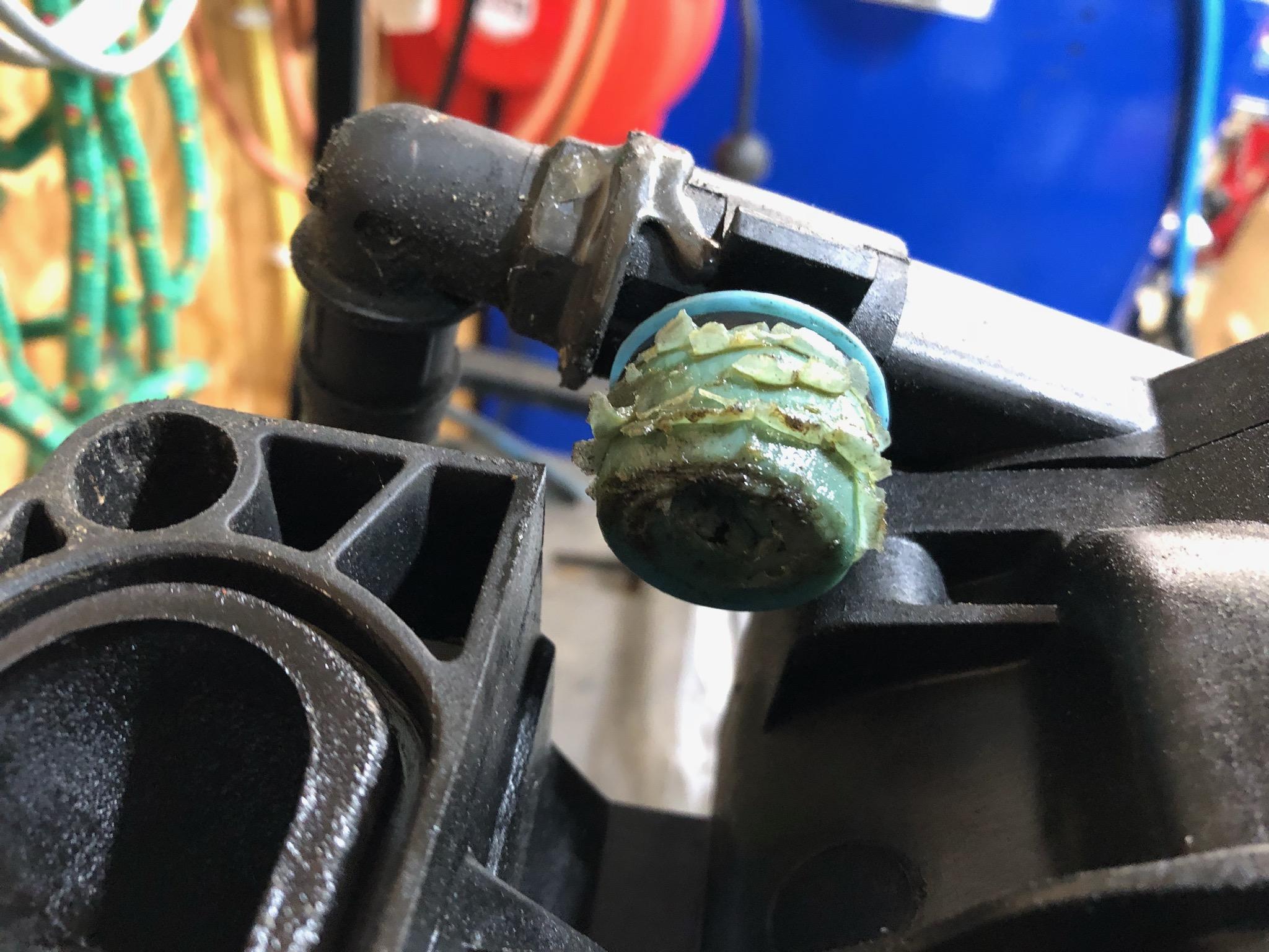

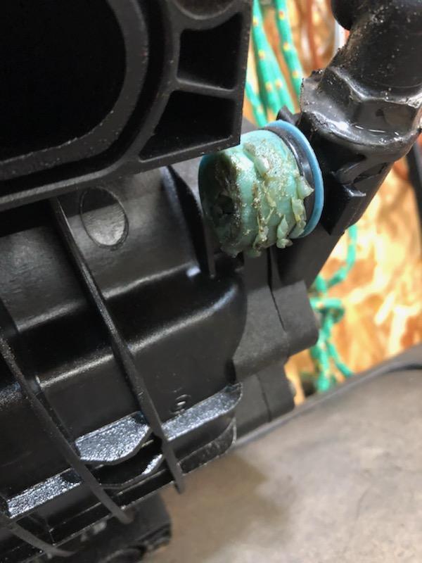

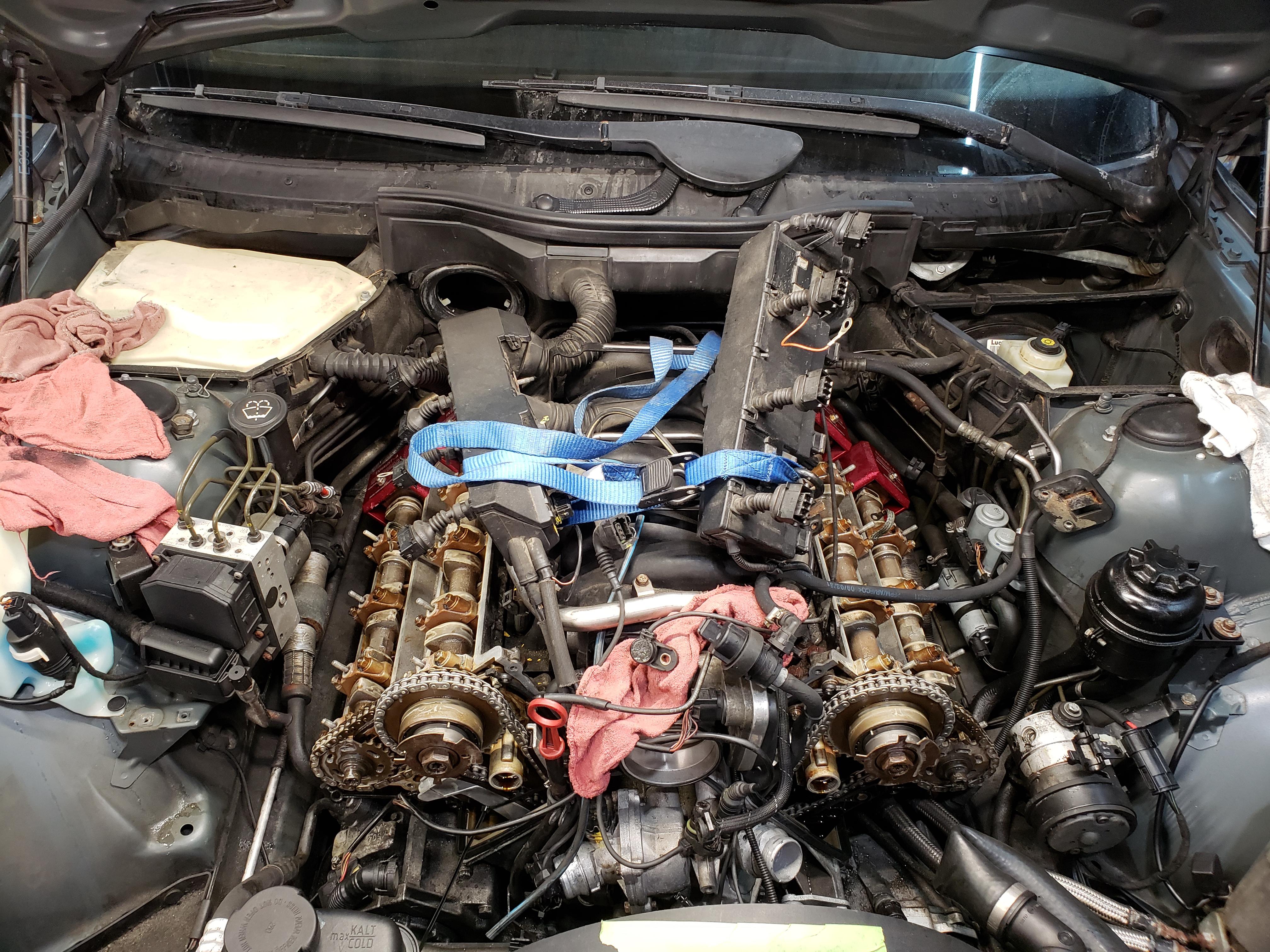

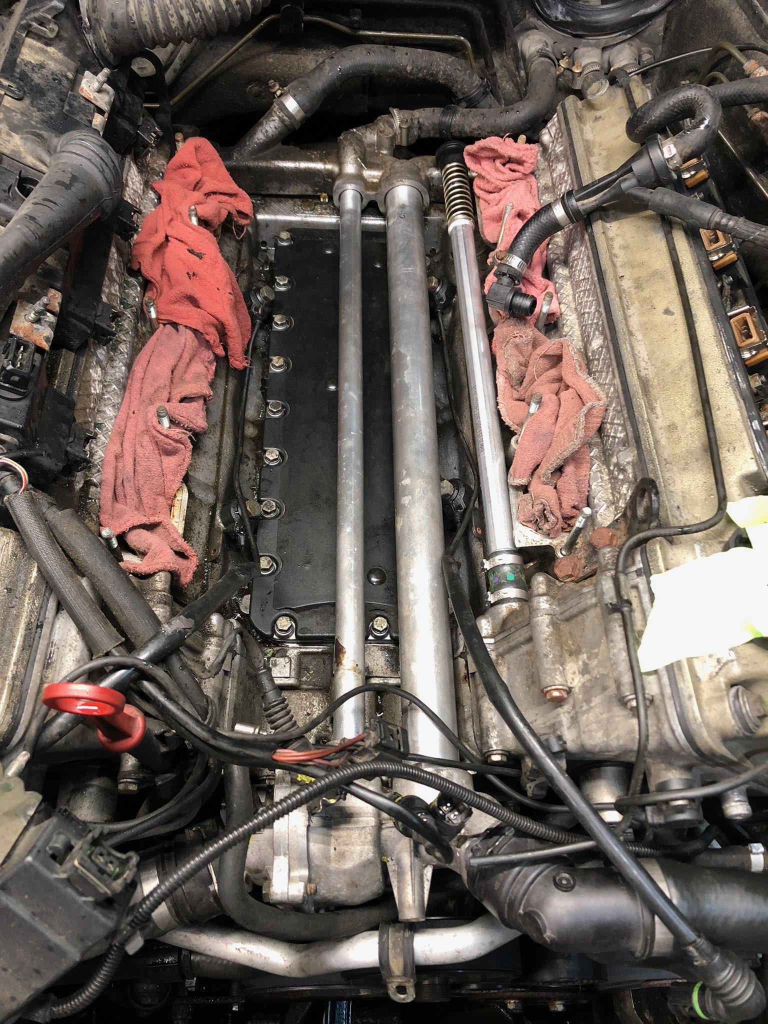

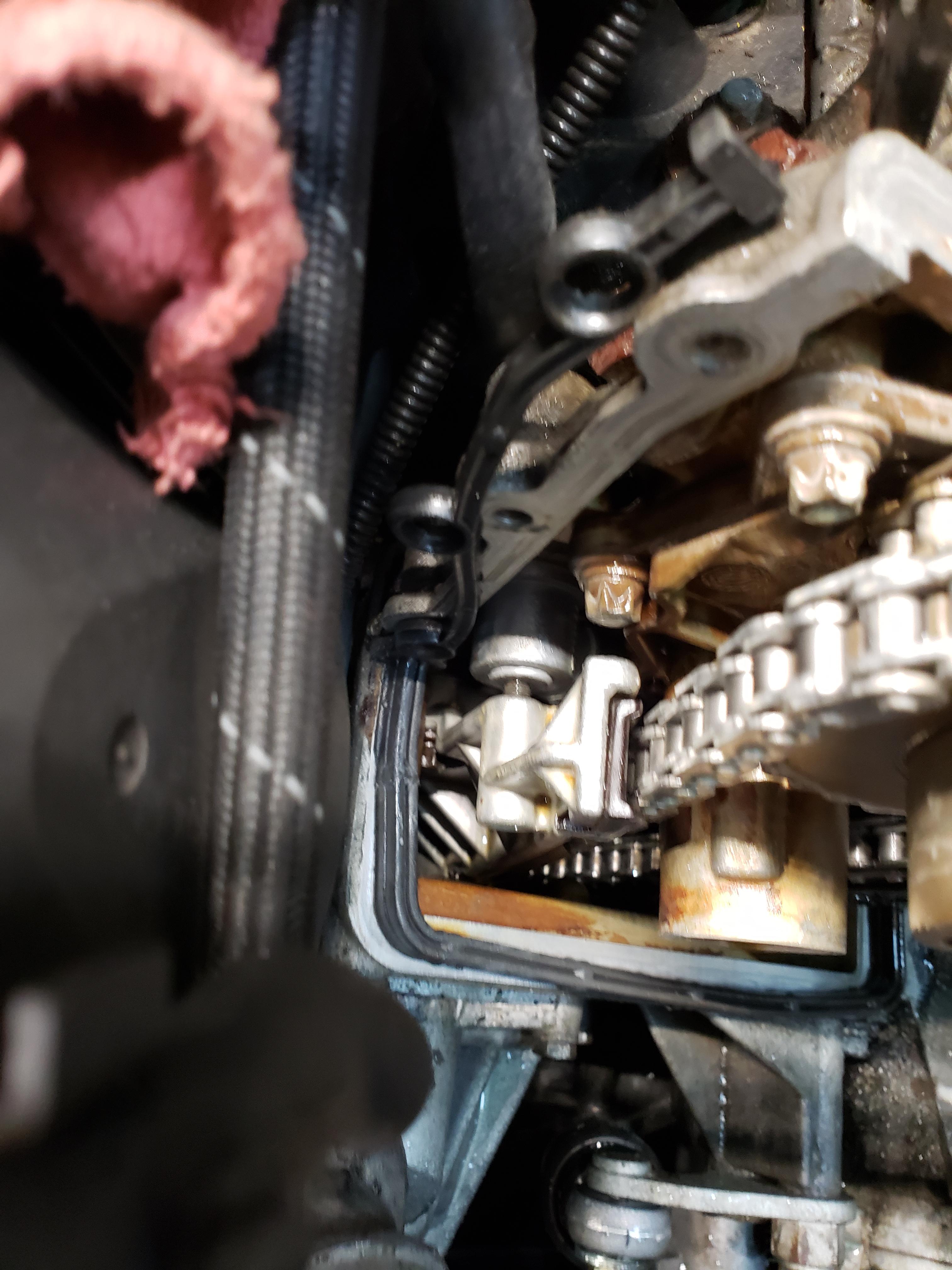

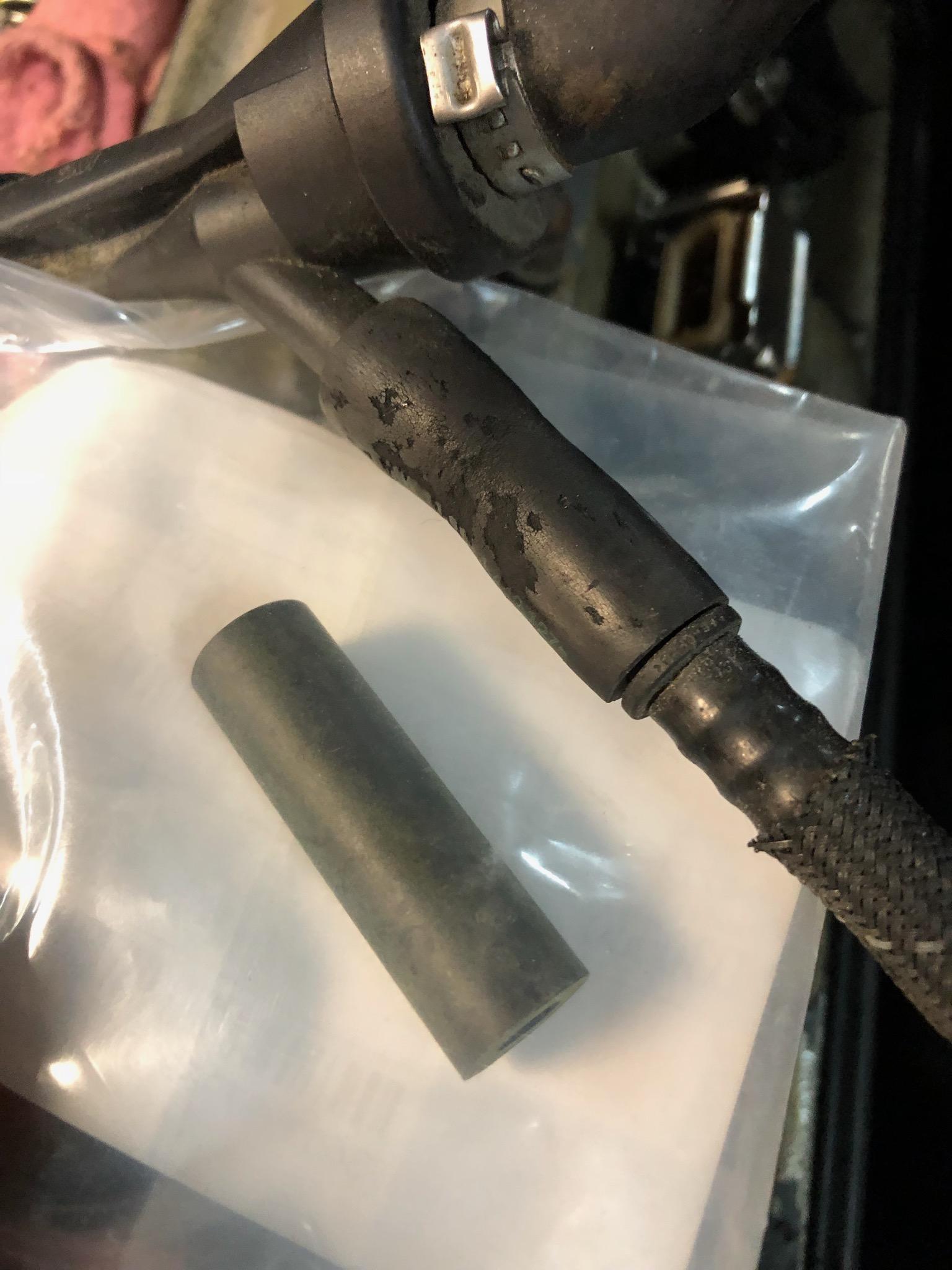

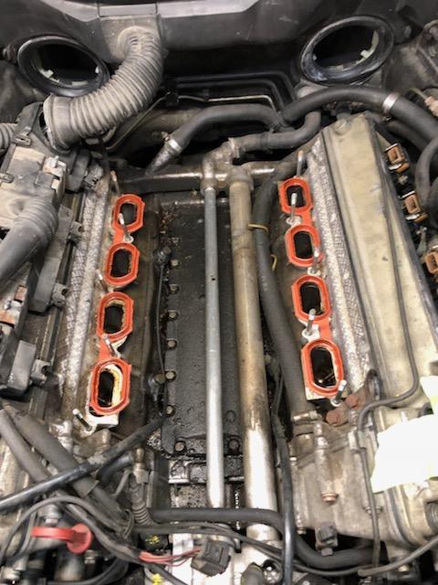

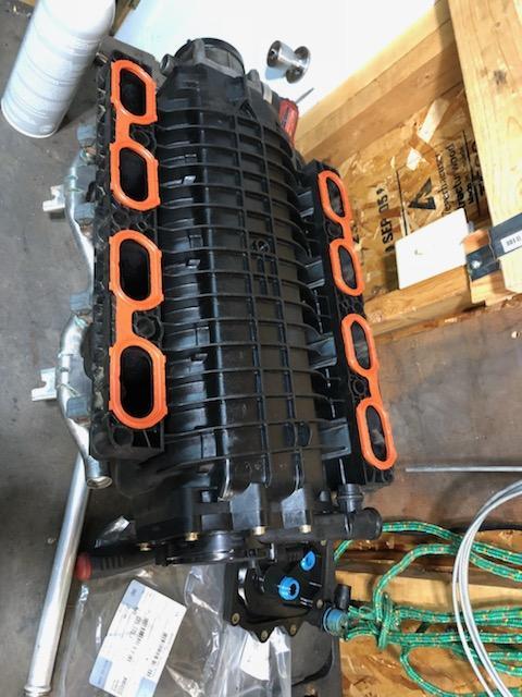

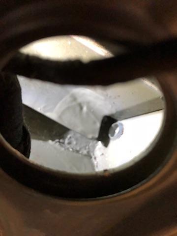

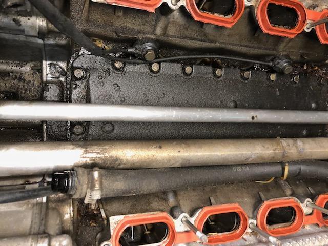

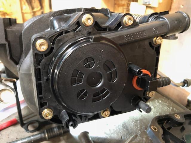

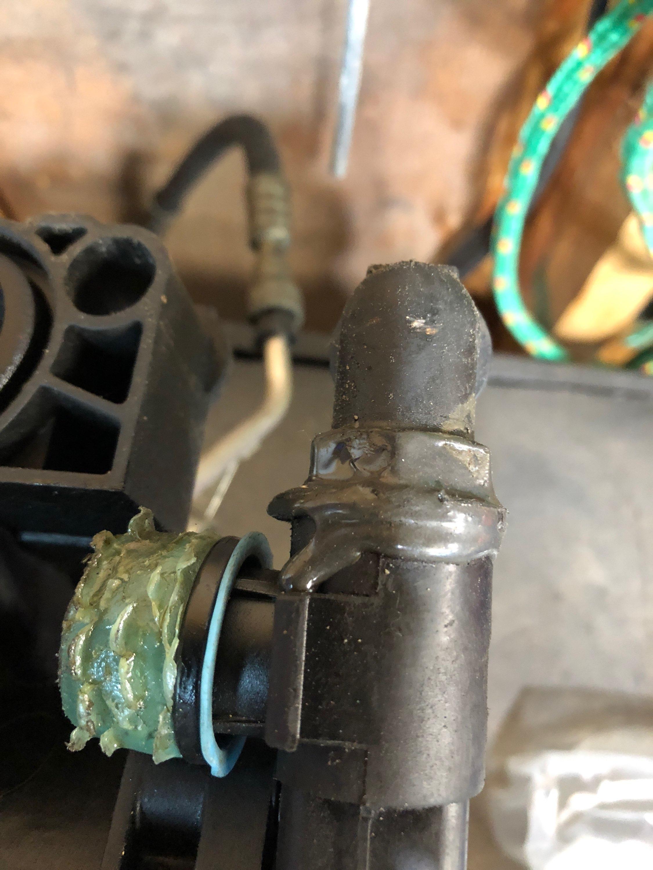

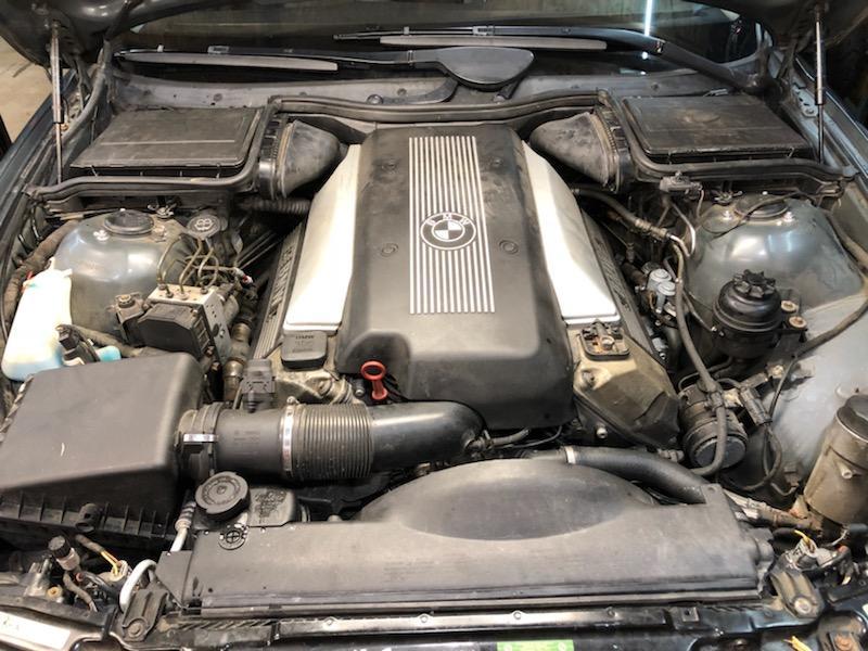

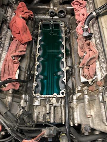

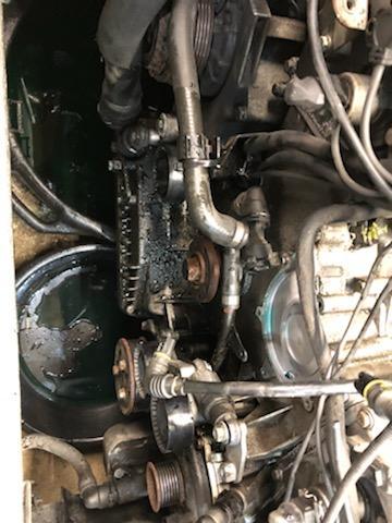

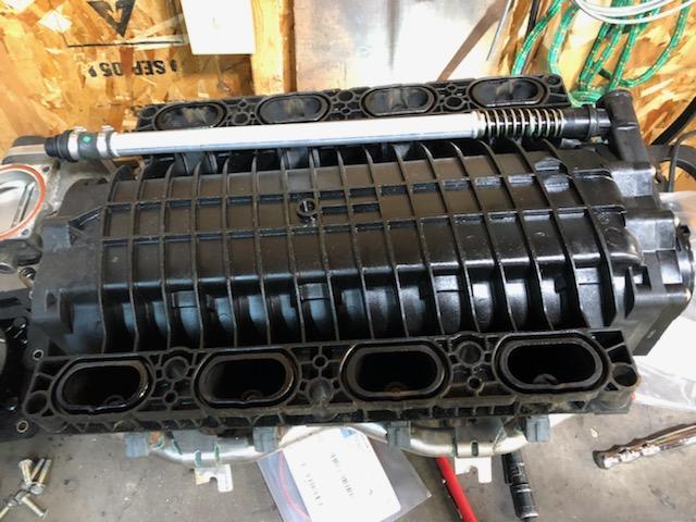

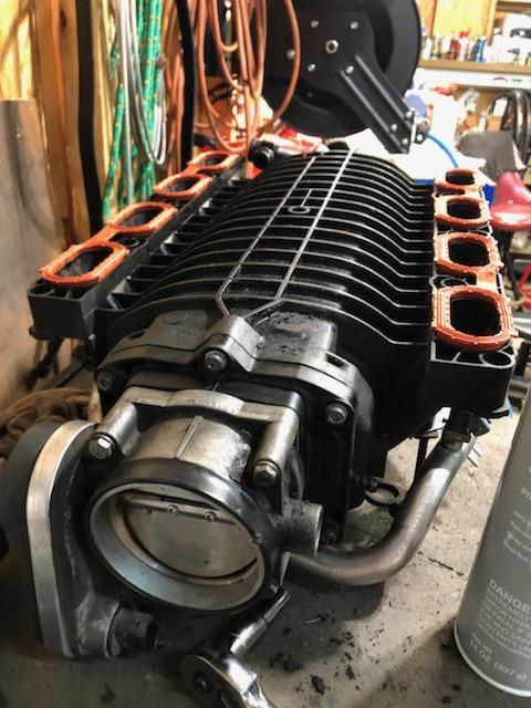

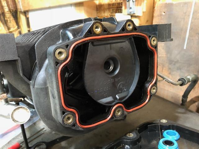

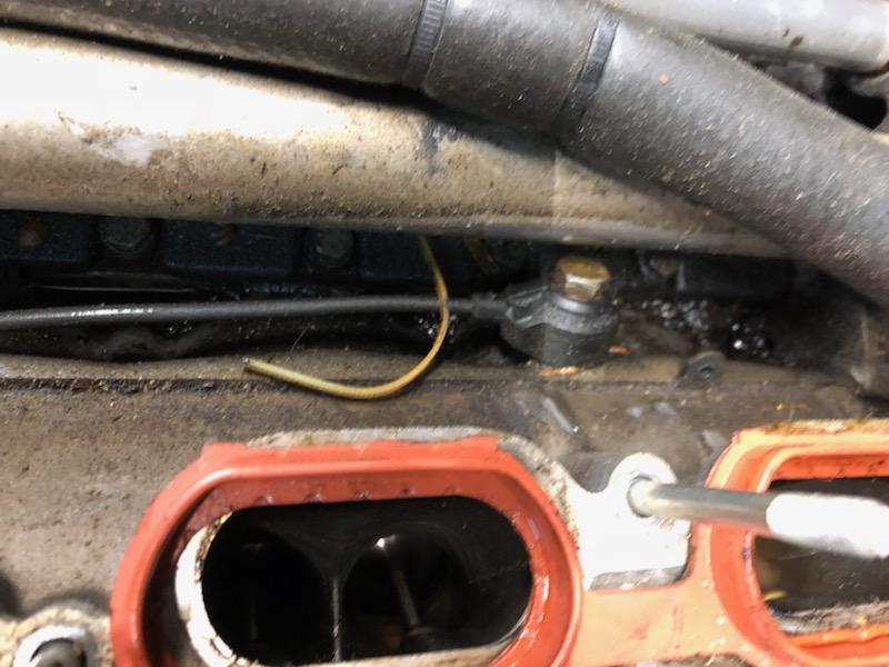

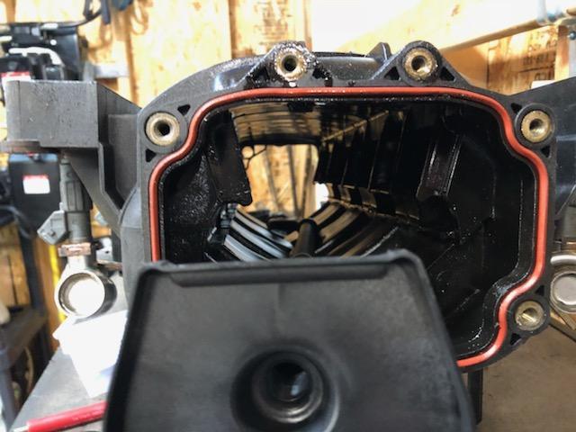

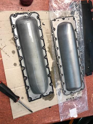

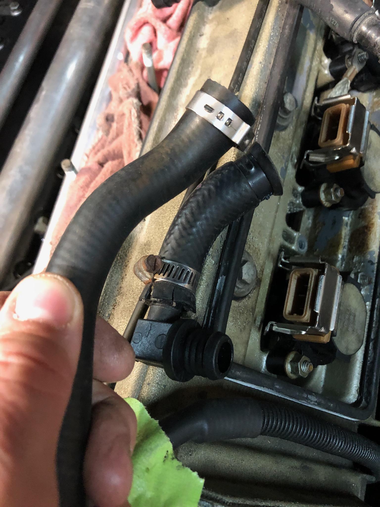

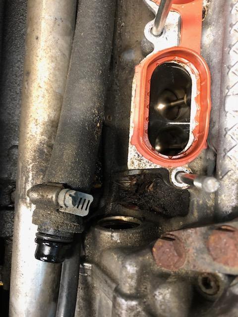

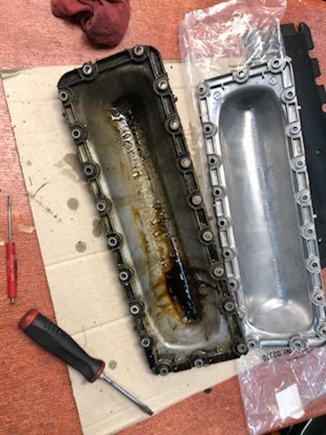

        Crank case vent was making a horn noise.  Dug into it and found a bunch of sketchy stuff from a PO.  They tried to bypass the CCV and run it through the weird catch can I posted about earlier. One hose for that catch can was being pinched by the intake manifold. So weird.
        Glad I was able to get into the top of the motor to replace all the brittle things.
             @DrLeadFoot
          Glad you replaced the torx bolts on the intake manifolds, I've had a few of those strip and they suck to cut out.

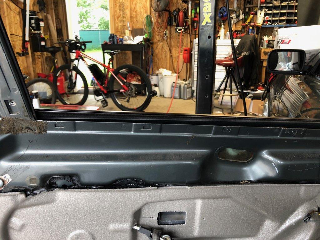

          Man what is up with the tailgates on these cars, yours looked perfect. Is there just no primer inside them?
            Awesome job bringing it back up to par. Looks like an awesome car now!
              #26
              Nice Updates! Looks like you spent some time going through this thing. What the hell is that blue condom looking thing in a few of the last pictures?
              Also, I want to see more "final" photos. Lets see the interior all put together and shinned up after that intense deep cleaning! Looks like you did a great job!

                  It was under the knife for about 3-4 months of hitting it hard.  Now just working out the smaller bugs from daily driving it but I think I'm almost to being 100%.  Sunroof rattle is next up. That condom thing was ziptied on there to block that hole.  So weird.  I'll get more final pics.  Thanks!!
                Thanks!  I wish they did a fiberglass tailgate like the  XJ Jeeps did.  Lighter and it doesn't rust!  Blunttech just quoted me $1650ish for a new tailgate.  It might be worth it!
                     @DrLeadFoot
                  #28
                  BMW's first attempt at a tailgate on the e34 is an abomination. it seems their 2nd attempt isn't much better. why do i feel like those silly germans tried to engineer it from square one instead of studying some proven designs and learning a thing or two?

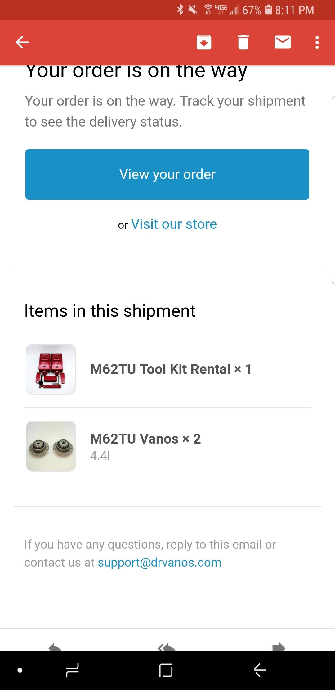

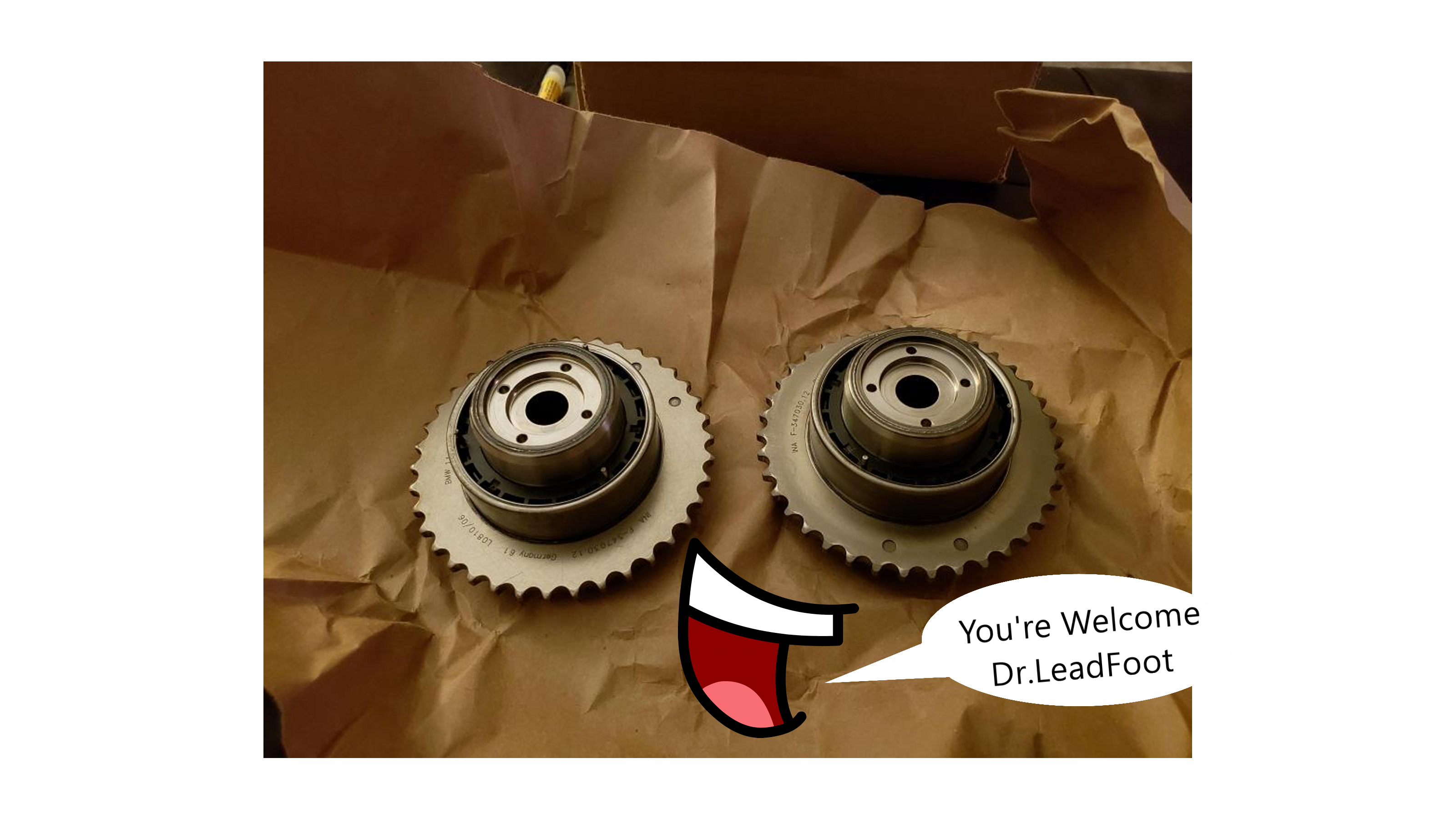

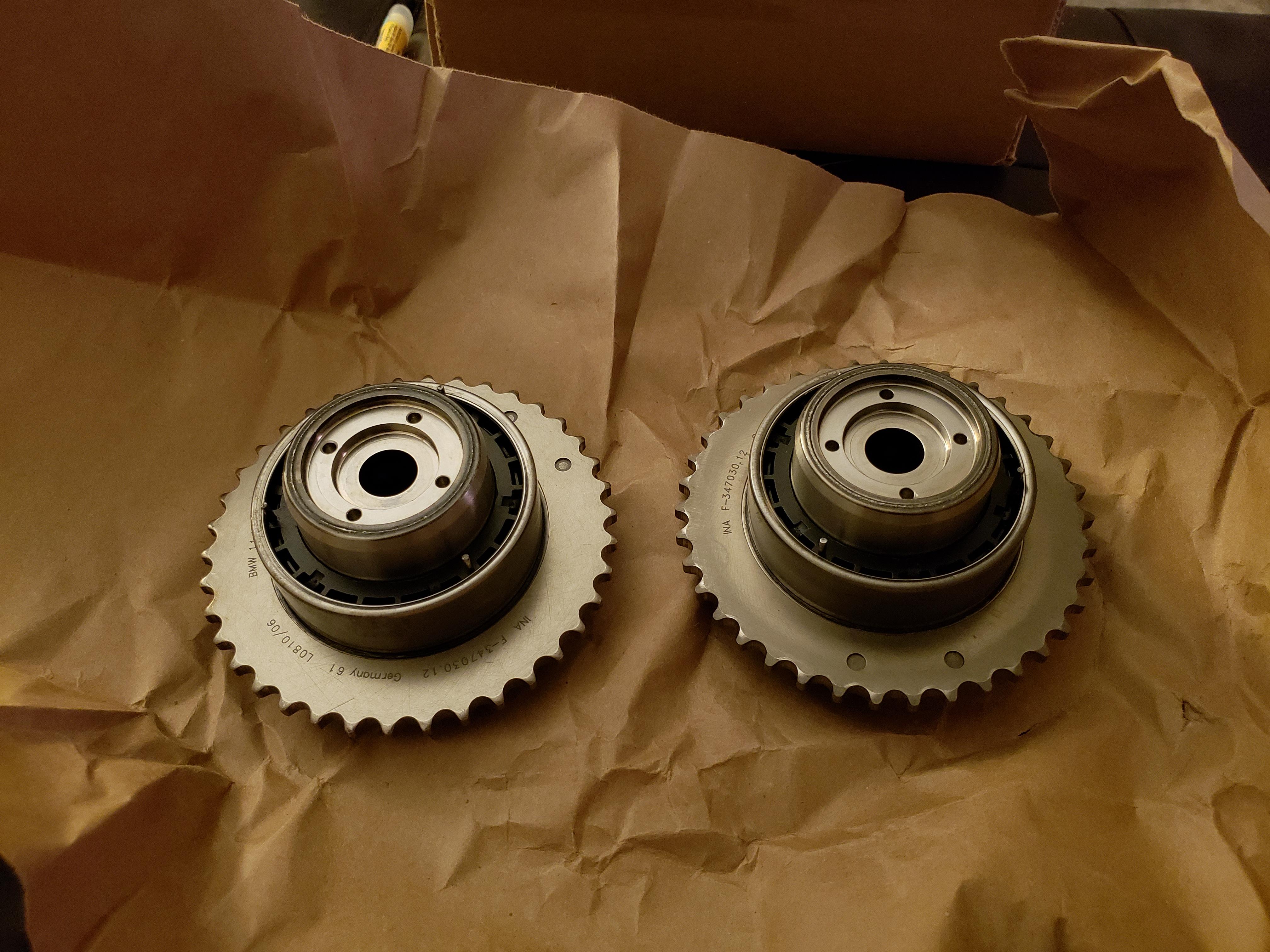

                              They have arrived. Thanks, Dr. Vanos!
                                   @DrLeadFoot
                                #35

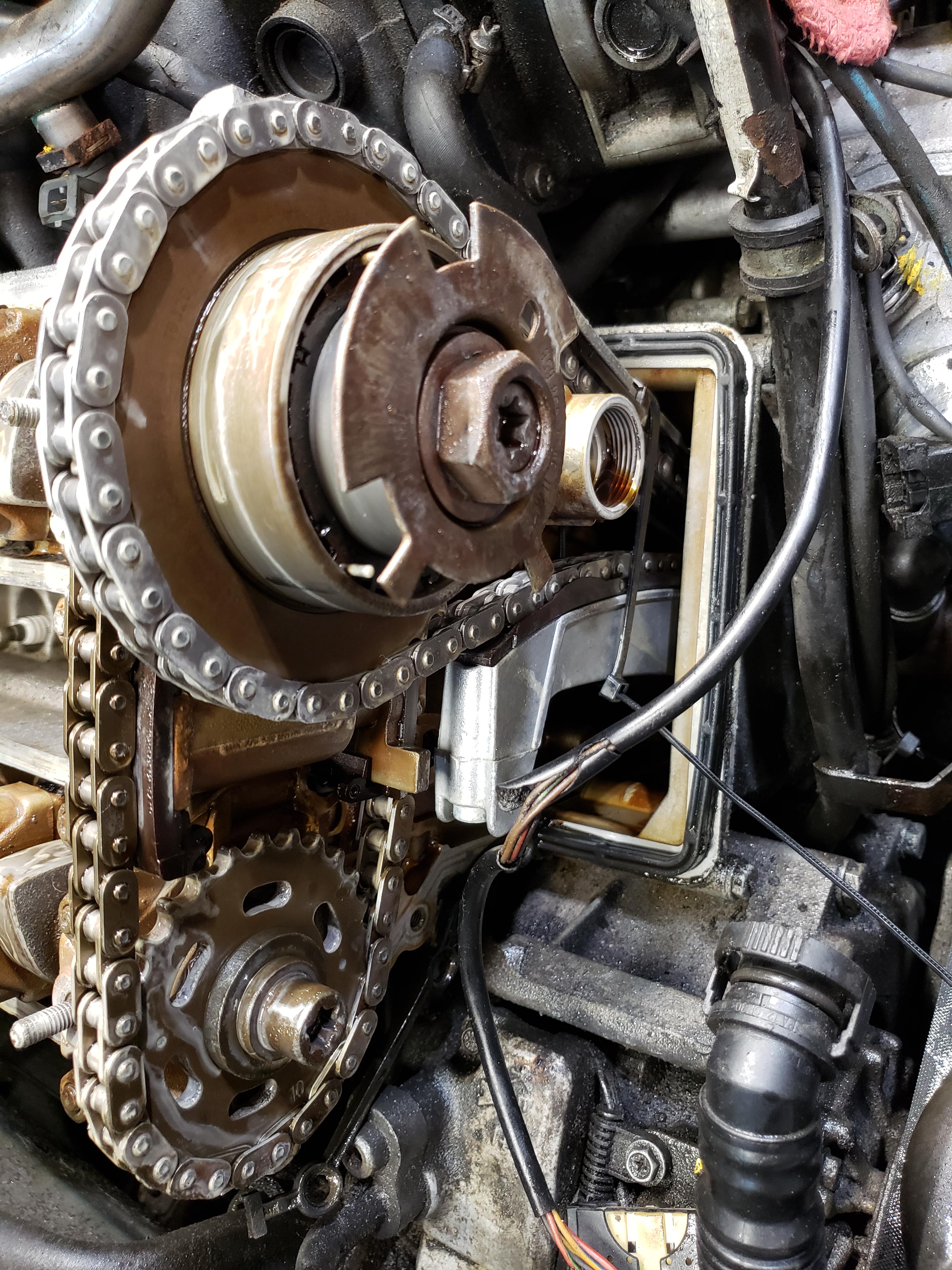

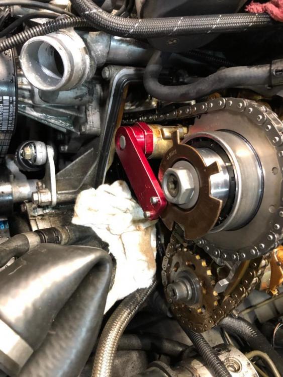

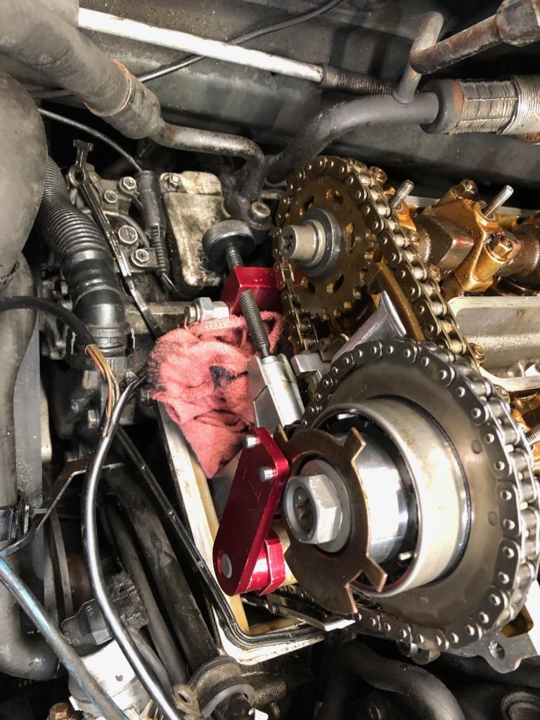

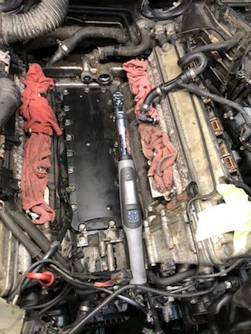

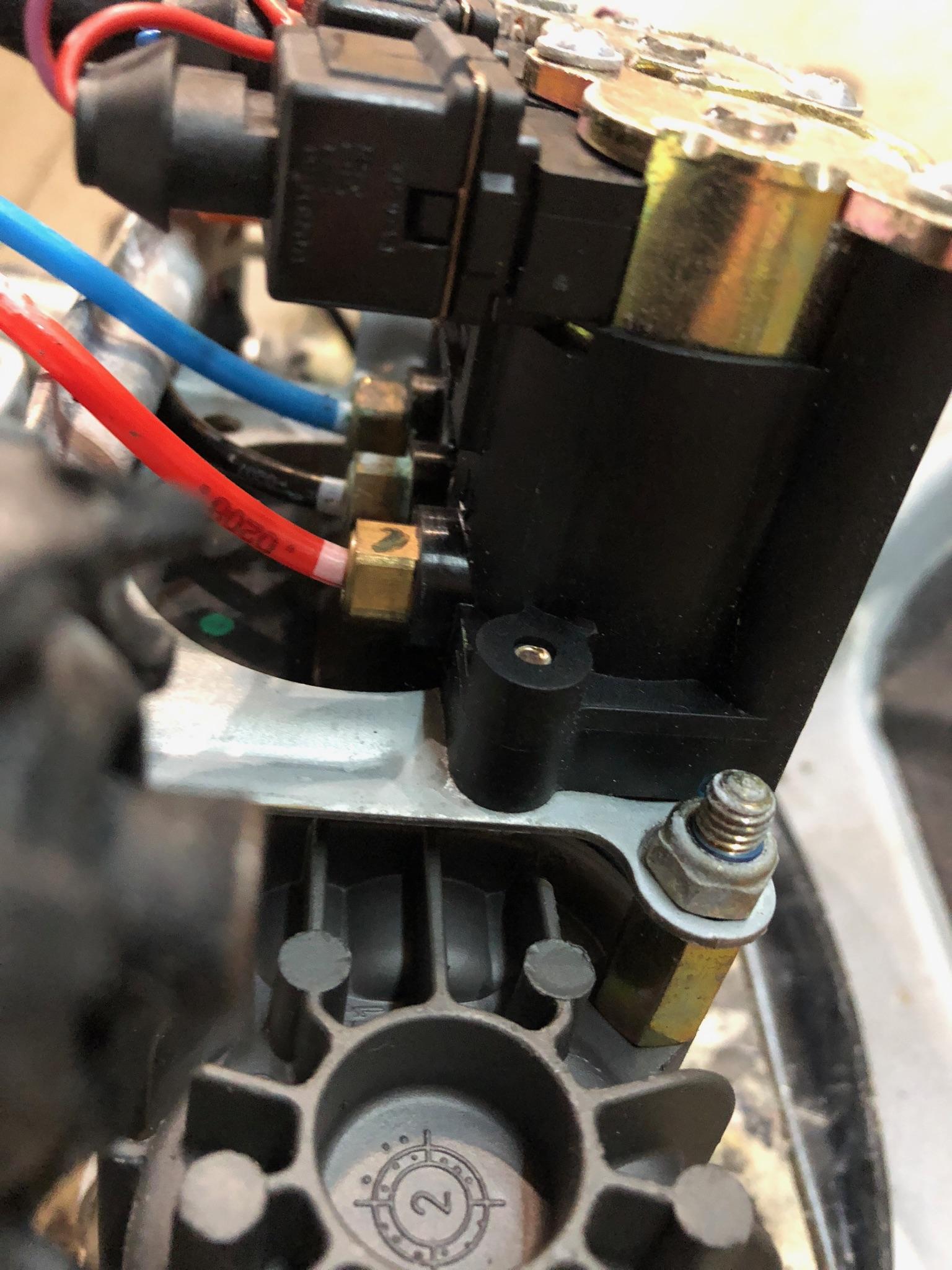

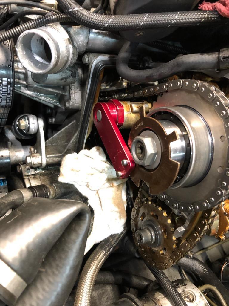

                                  Vanos time is here!
                                  After getting the top, front covers off it does look like the PO did do the timing chain and guides.
                                  Engine looks relatively clean which makes me all warm and fuzzy on the insides.
                                  Will be replacing the vanos units, vanos solenoids, chain tensioners and spark plugs.
                                       @DrLeadFoot

                                    Vanos is all done! The diesel sound is mostly gone.  Probably should have replaced the exhaust chains but this will do for now.
                                    Time to drive!

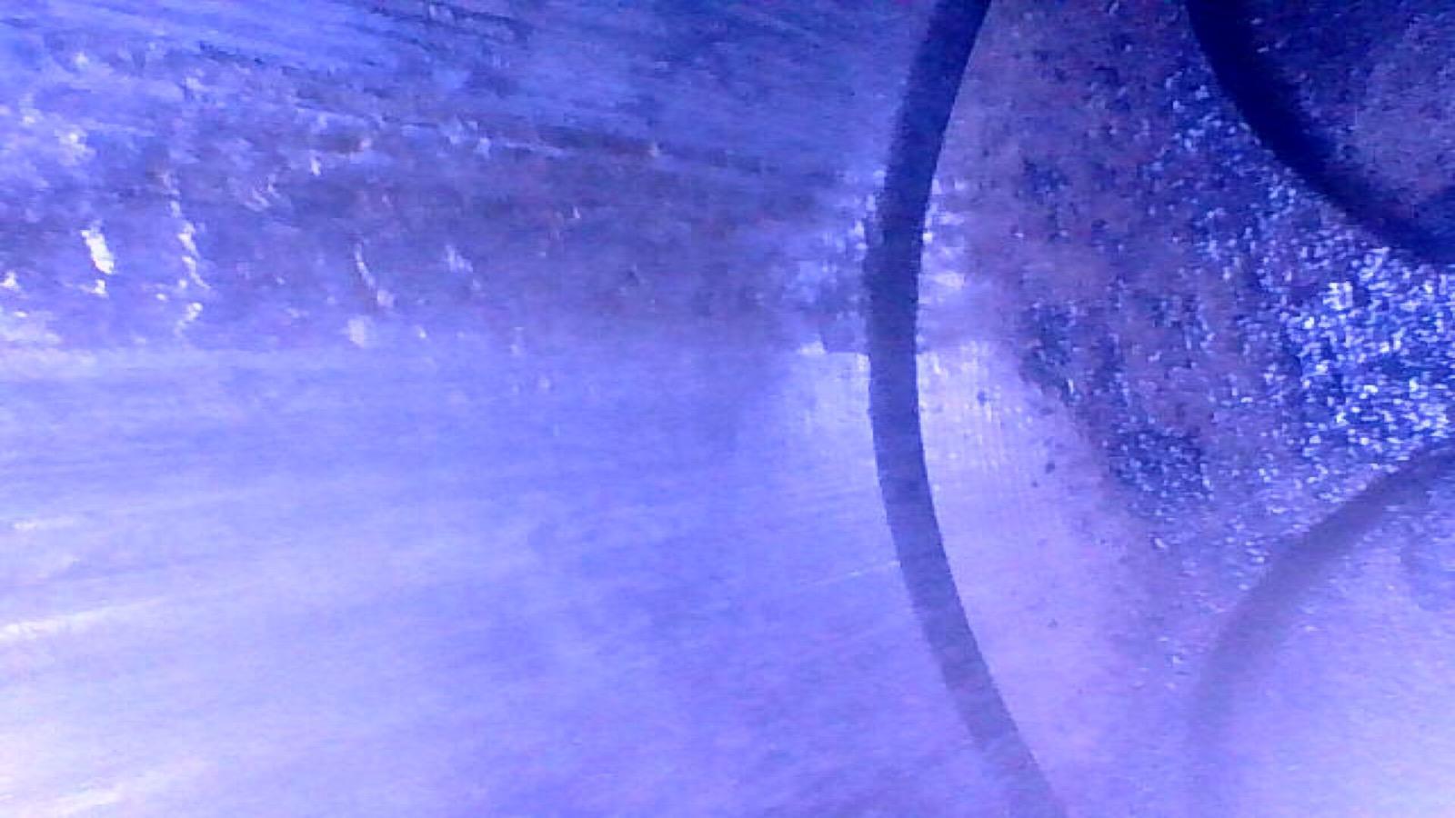

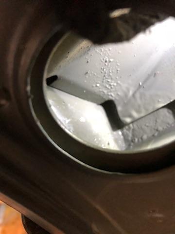

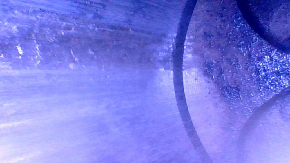

                                      Cylinder #8 is shot.  Need a motor... hmmm.  What to do, what to do??
                                           @DrLeadFoot
                                        #39
                                        Damn, only 180k too 😔
                                        Options:
                                        1. Replace M60B44 and life carries on
                                        2. Get a B40 bottom end and build a stroker motor. Car value raises to $20k on BaT.
                                        4. Commence GMW #2, worth $40k on BaT
                                        4.  S62 swap, car becomes worth $80k on BaT.
