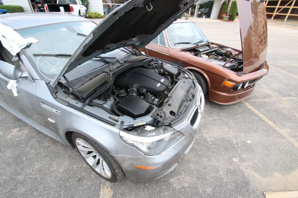

    Now, on to the real exciting news - Steve at Blunt Tech posted a 2008 M5 on R3V a few days ago with only 33k miles on it, totaled due to side impact (see photos). He sent a video of the car starting right up and mechanically it is all good. Other than being an SMG, it's a perfect donor. It was only $7k which I am sure I can recoup most of by selling the Dinan exhaust, rear end, low mileage SMG, suspension, wheels, and probably the currently ruined interior to a tracksuit-wearing russian with a 530i (E-fab made up the part about the russian but I'm taking credit anyway).
    The car has been acquired as of now. Sometime over the next month I'll likely be down there in the shop helping Eric part out the shit I want to sell. The actual swap work will likely begin in January/February and hopefully be done by April.

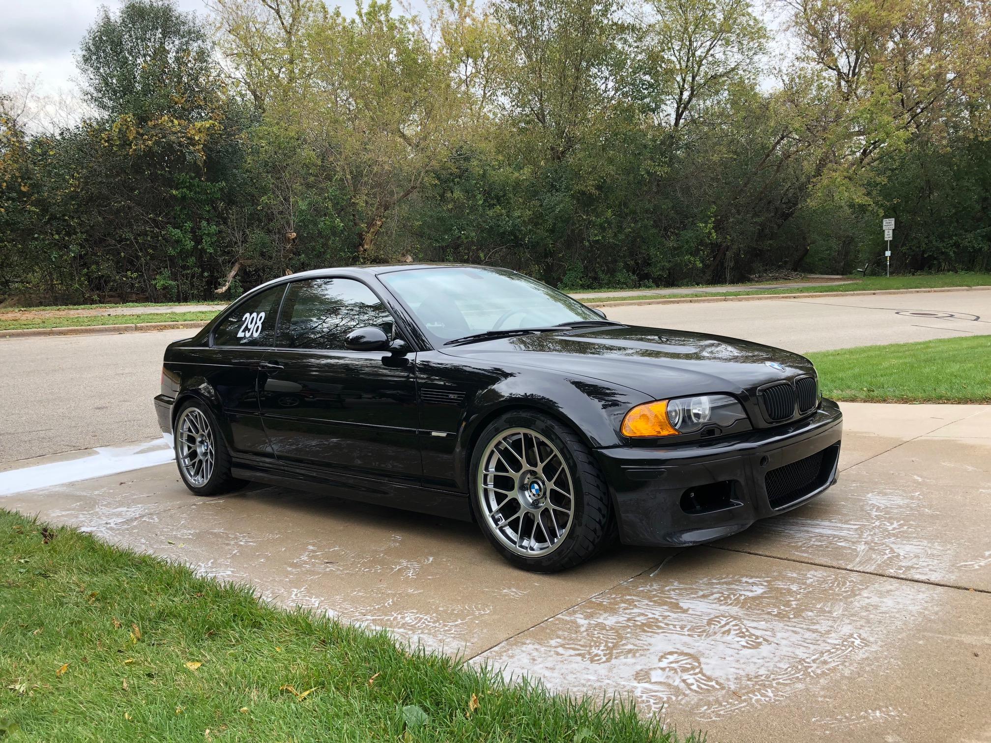

    For posterity, I have to post 1 pic of the E46 as it currently is. Pics of the M5 donor are below:

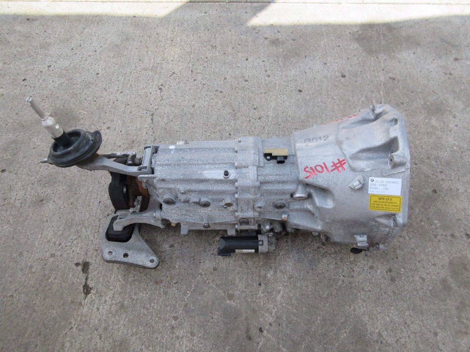

                      Picked up a really clean E9x 6MT just now on ebay. 56k miles on it at $1800 shipped is maybe 100-200 bucks overpriced but it obviously includes the knick knacks like shift linkage, etc. as opposed to being just a bare transmission. May need to end up fabricating a custom shift linkage anyway but I'd rather have the stock parts with the transmission if I can, so this makes sense I think.

                        The transmission I had got on ebay arrived with a giant crack in the bellhousing among other problems - basically everything got fucked up by the freight carrier. So I have been refunded for that and am back on the hunt for a transmission again. If anyone catches a beat on a decent E9x 6mt transmission, let me know.
