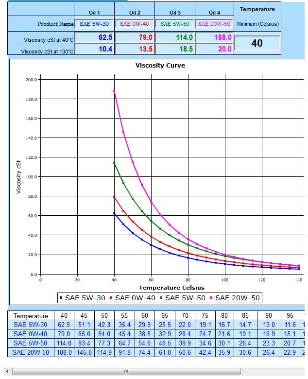

                      20w- anything is an archaic spec that belongs back in the 50-60's. Only guys using it are into old muscle cars with sloppy clearances, because some of the oils are blended to protect flat tappet push-rod valvetrain.  Or they like to see 100psi. on the gauge on cold starts and think it's a good thing.
                      Most older BMW engine clearances are designed to run a 10-13cSt oil viscosity. Or ~30weight oil running @100c. All oils start much thicker when cold.
                      Running a thicker oil doesn't make sense unless you run the oil hotter the 100c. A 20w50 will be ~20cSt @100c but it will thin to ~12cSt at 120c. engine thinks it got 0w30 in it. It's happy.
                      The cold end of the scale looks much worse. A 0w30 is 65cSt @40c while the 20w50 is 180cSt at 40c. It takes that much longer for the oil to warm up and flow throughout the engine.
                      This is not even looking below freezing. In those temps the extra drag can defeat a good battery and starter. You're trying to pump molasses through a coffee straw.
                      The 0w40 synthetics are a good compromise of performance and protection. With a 75cSt cold and ~13 cSt hot. It's on the thick side of spec.@100c thinning to ~8cSt @120c still giving you some track protection, without relying on the additive package to keep the bearings from seizing for 2-3 times longer on cold start.
                      everyone says that most of your wear comes from cold starts, so why use an oil that will take twice as long to warm to running temp.  If you need to run your oil that hot add a oil cooler, or as a last resort run a 5W-50 (115cSt cold, 18.5cSt hot). Not as a first step.
