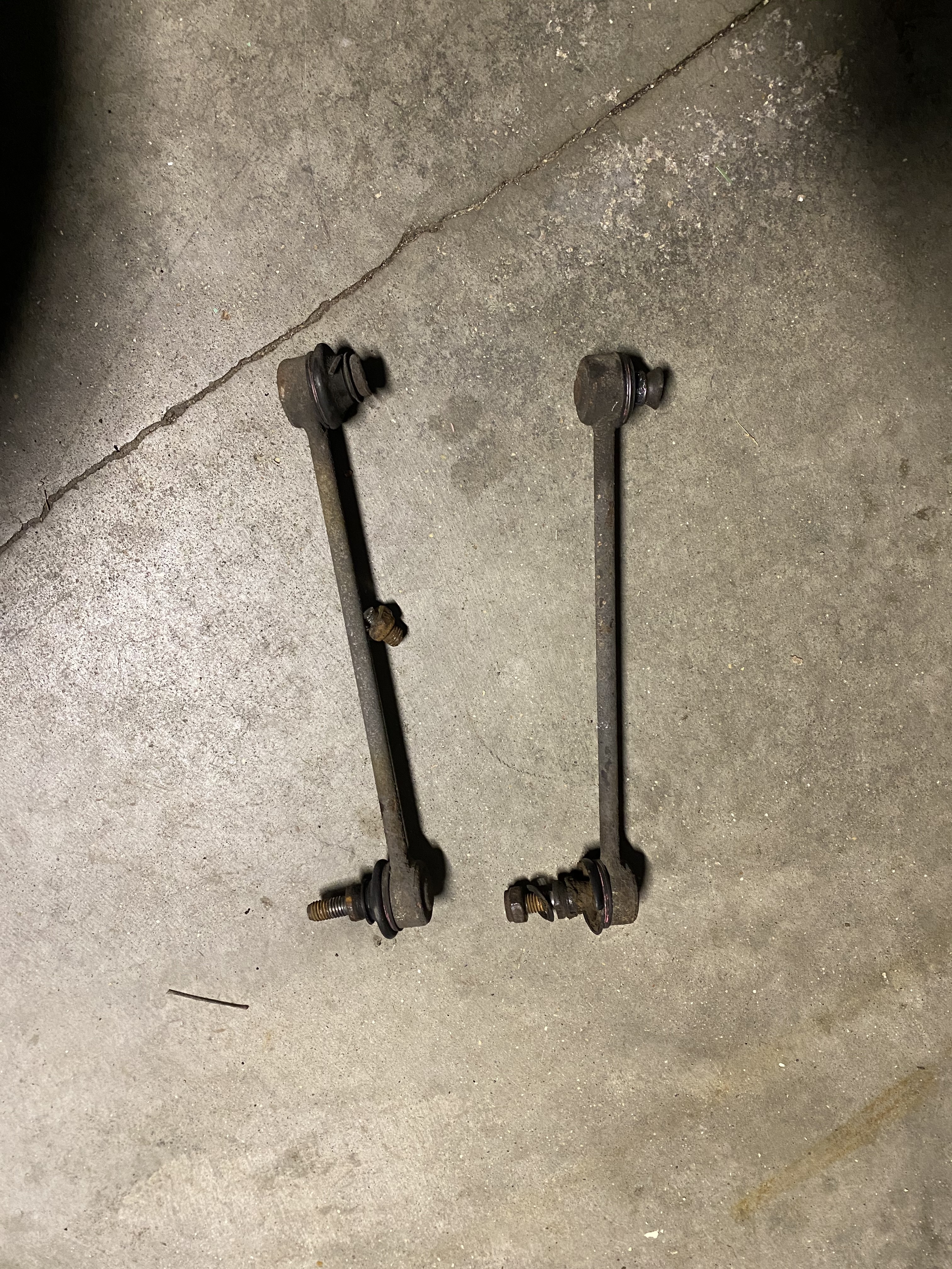

                              Finally, I have a new set of front sway bar links on the way to address a front end clunk that started a few months ago.

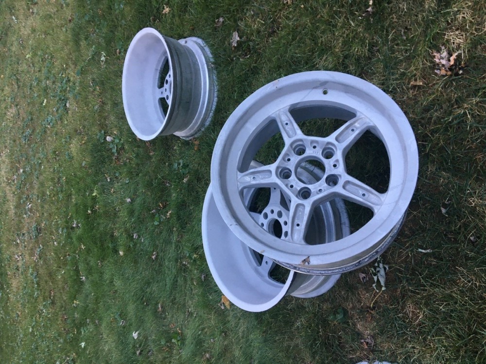

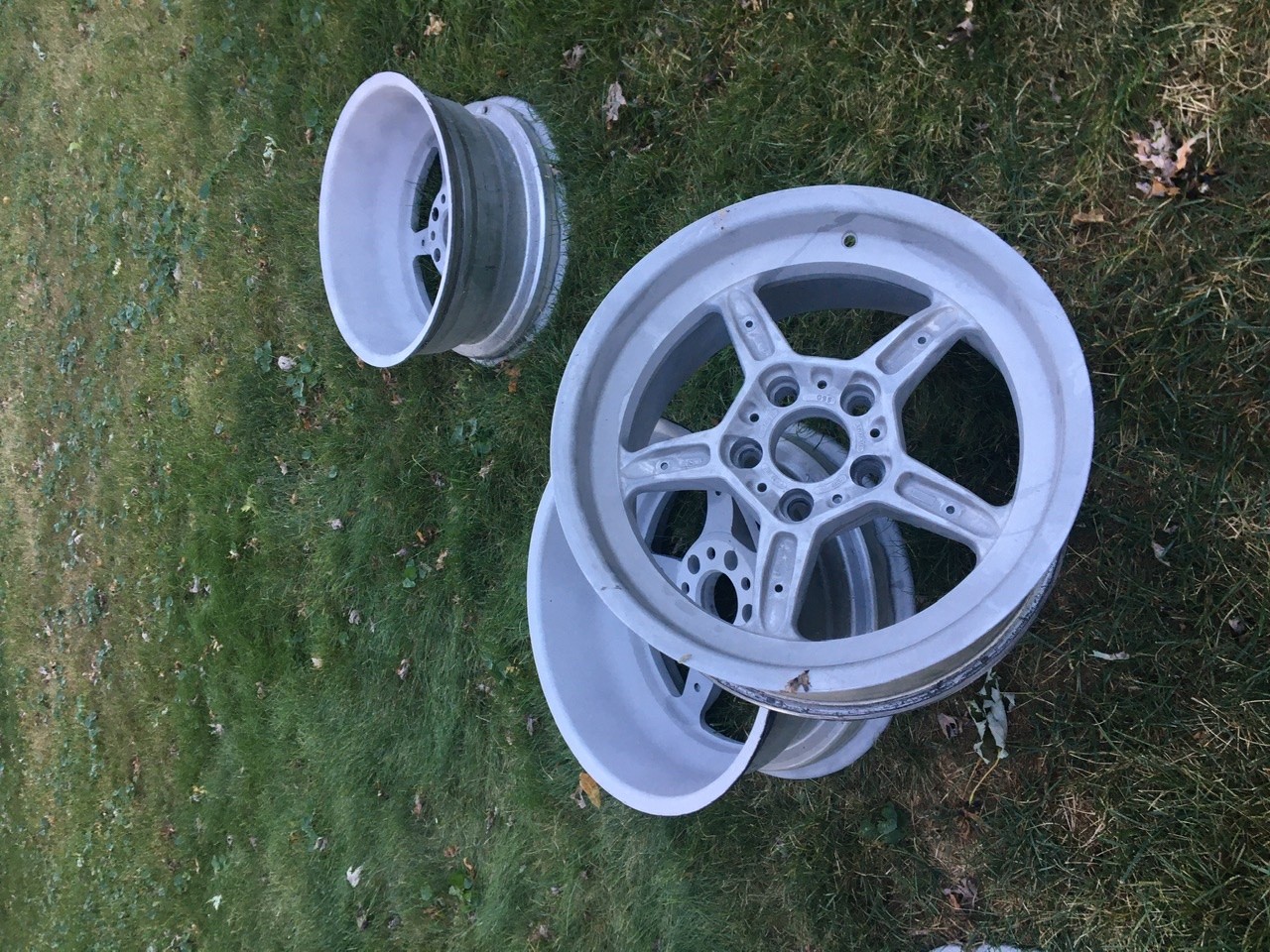

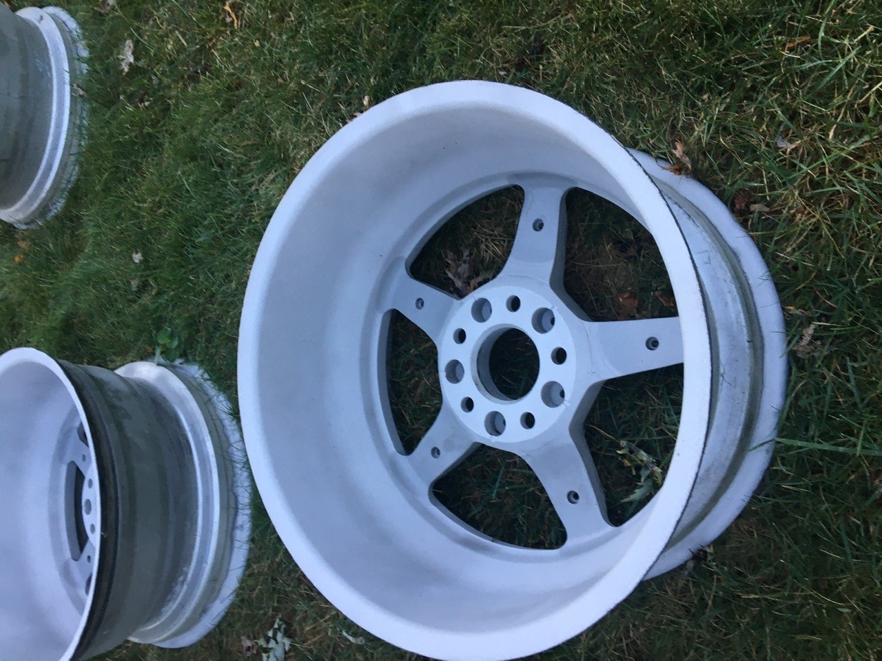

                              On a different note, I’m ready to begin priming and painting the m-systems after stripping and media blasting all the old paint off. I was told by the seller that they had been previously stripped and painted, but it seemed that only one of the wheels had received that treatment; the other three had what looked to be the OEM paint underneath the rattle can paint. No matter, it was all coming off anyways.
                              After some discussion and deliberation, I decided against my original plan of polishing out the lips and will instead stick to paint for the whole wheel. With that said, any thoughts on a color for the lip? I can’t decide between a bright, almost “polished aluminum” type paint to give the look of polished wheels, or if I should just stick to the stock OEM BMW silver paint. Stock paint will likely be easier to sell, but I do really like the polished lip look. Any opinions?
                                #95
                                Its challenging to find silver paint that looks natural on a surface which we normally expect to be machined or chrome plated.
                                personally I would try to avoid silvers that have a high metal fleck and definitely clearcoat it. OEM BMW silver would be my pick

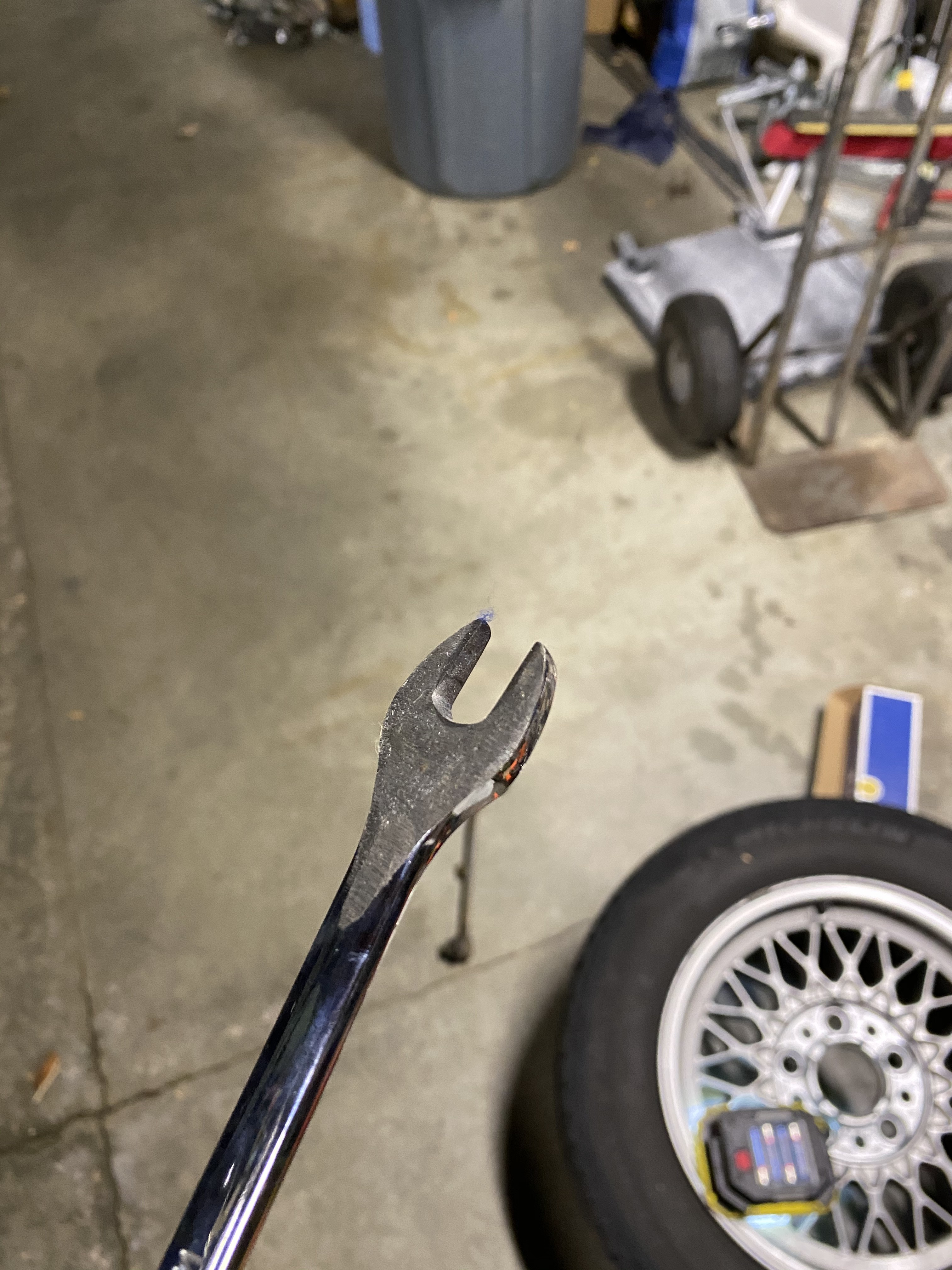

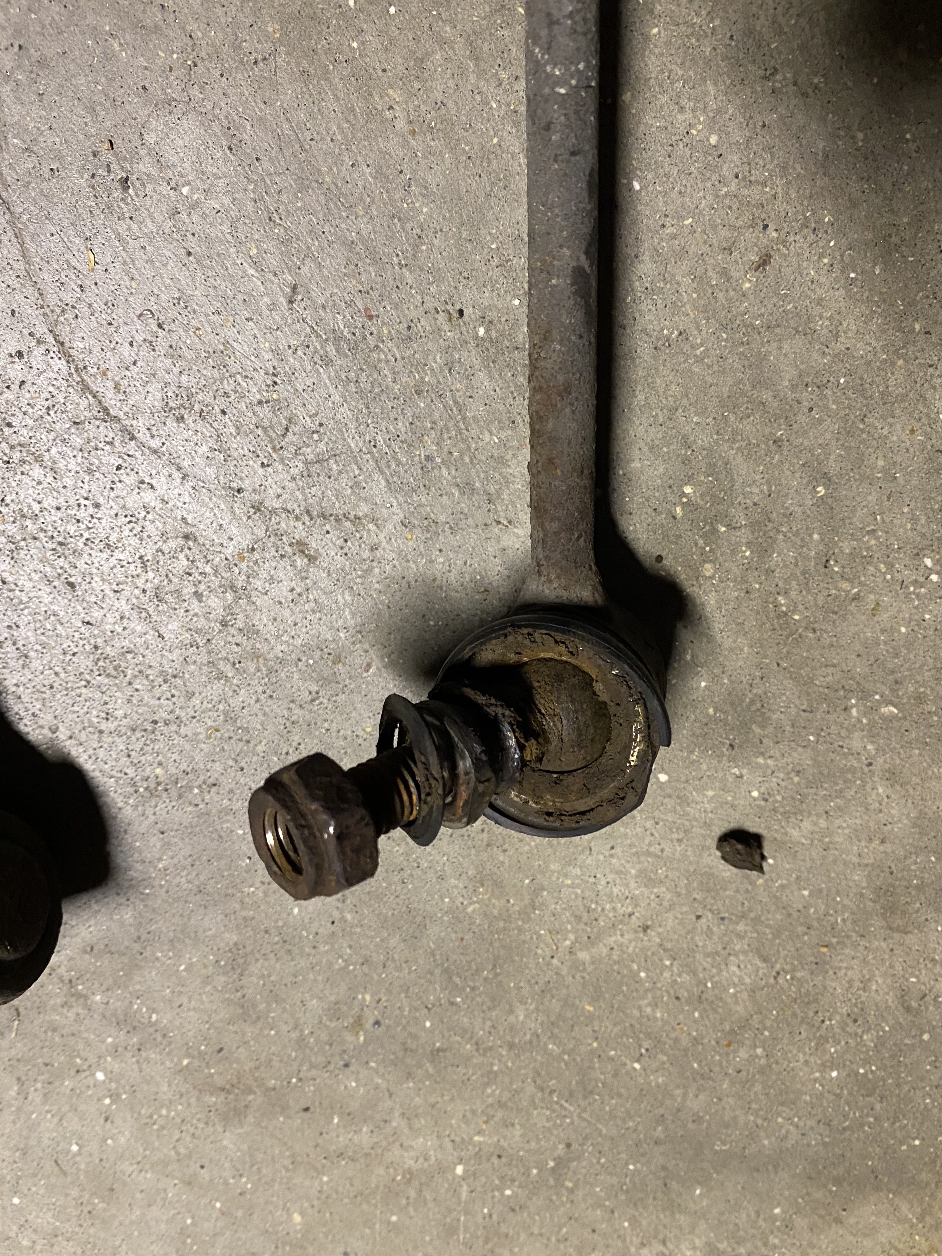

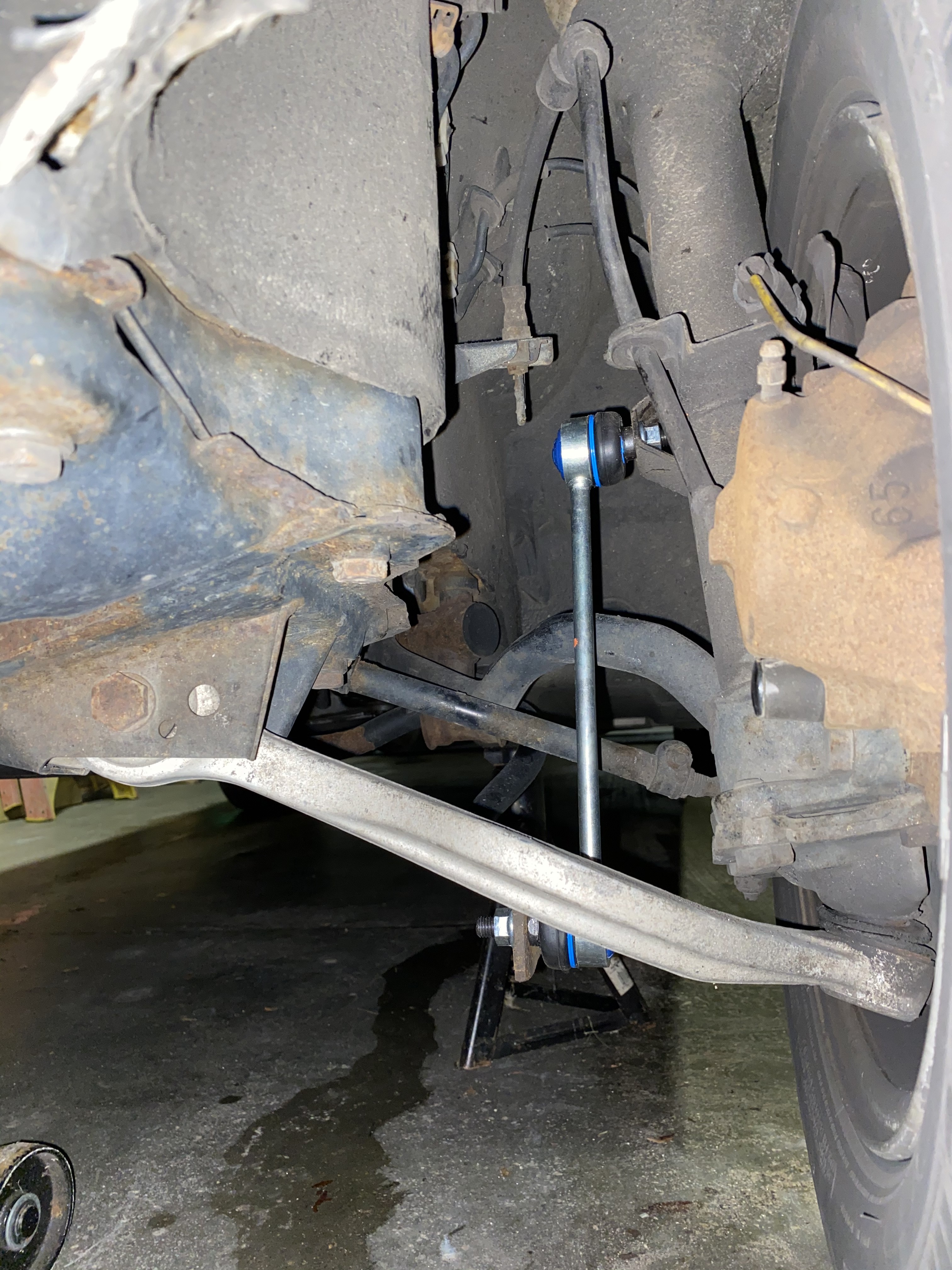

                                      Replaced front sway bar end links, which solved the main clunking noise in the front end but left a smaller one that is (I think) isolated to the right side. Going to inspect the upper and lower control arms the next time I’m home, I’m thinking the uppers are the likely culprit.
                                      Yuck.
                                      Double yuck. Ended up just cutting the upper nuts off, way easier than grinding up a wrench to get into the tiny little recess to hold them. Speaking of:
                                      Going to put this into the pile of tools I’ll probably never use again, but I can’t bring myself to get rid of.
                                      Much better.
