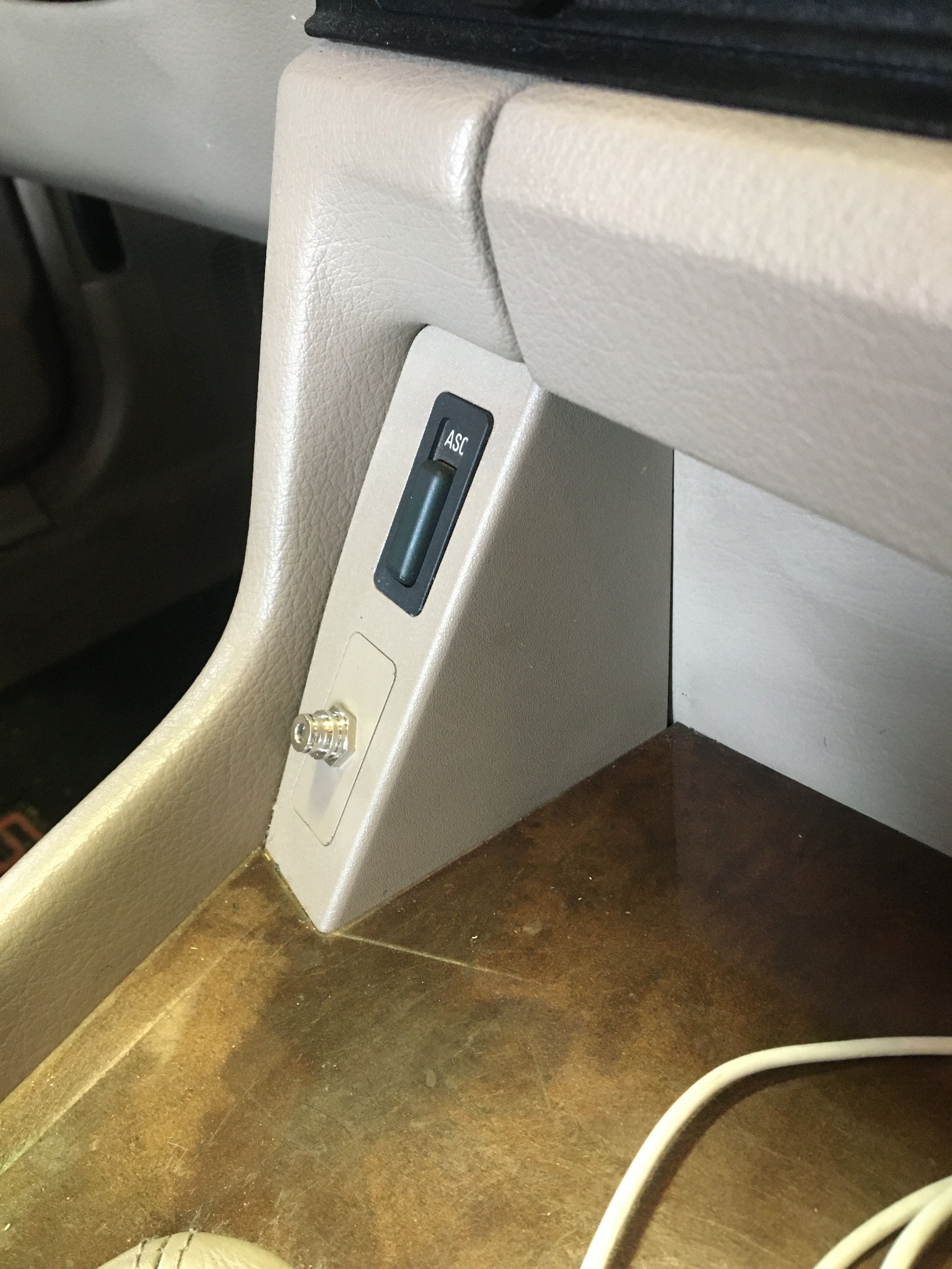

                        Too late, just installed it.
                        I'm not too concerned, I have the exact same setup in the e30 for the auxiliary input and it works fine. In reality the cord doesn't get reoved enough to make it an issue, and I've never had issues with the plate popping out in normal use. I certainly wouldn't be opposed to a different solution, though. Perhaps something with the OEM auxiliary input/usb charger for the newer cars? Not sure if it would fit, but would be cool to make work.

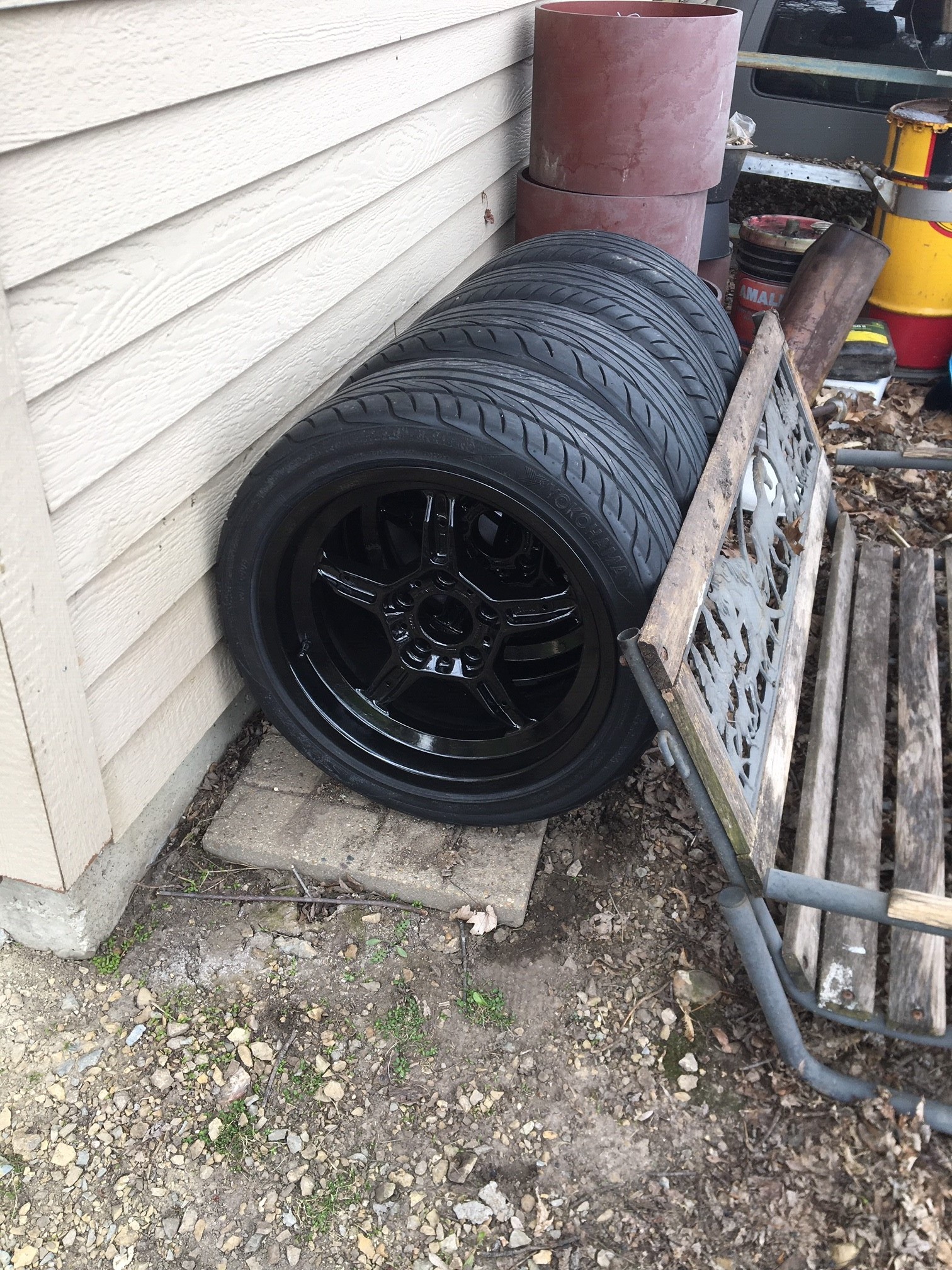

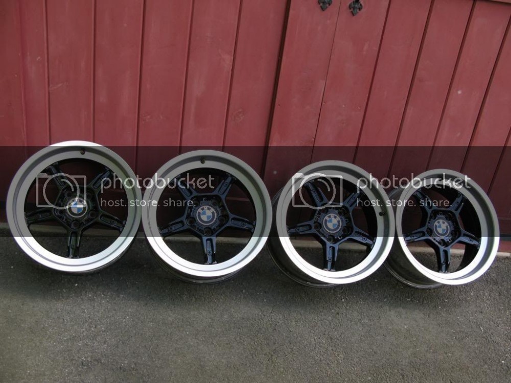

                                  Decided to go a different way on the wheel front! Going to run them as-is with the older tires on there for a little while. Haven't decided for sure whether I'm going to repaint the lips back to silver like they should be, but I really like that look. Either way, I'll be figuring out something for a BMW center cap like shown in the third photo.
                                  Long shot, but has anyone heard whether the reproduction fiberglass throwing star covers seen on Ebay and various forums are any good at all? They're around $300 a set, I don't think I can bring myself to cough up the dough for the real ones. I'm normally not one for fake stuff, but man are those things pricey.

                                        Realized I never commented on this... M-systems are probably in my top 3 favorite OEM wheels, nice find! those are going to look fantastic! I actually really like the no-cover look you posted with a center cap
                                          #80
                                          Thanks, I do too! Dresses it up just enough for a relatively stock car.
