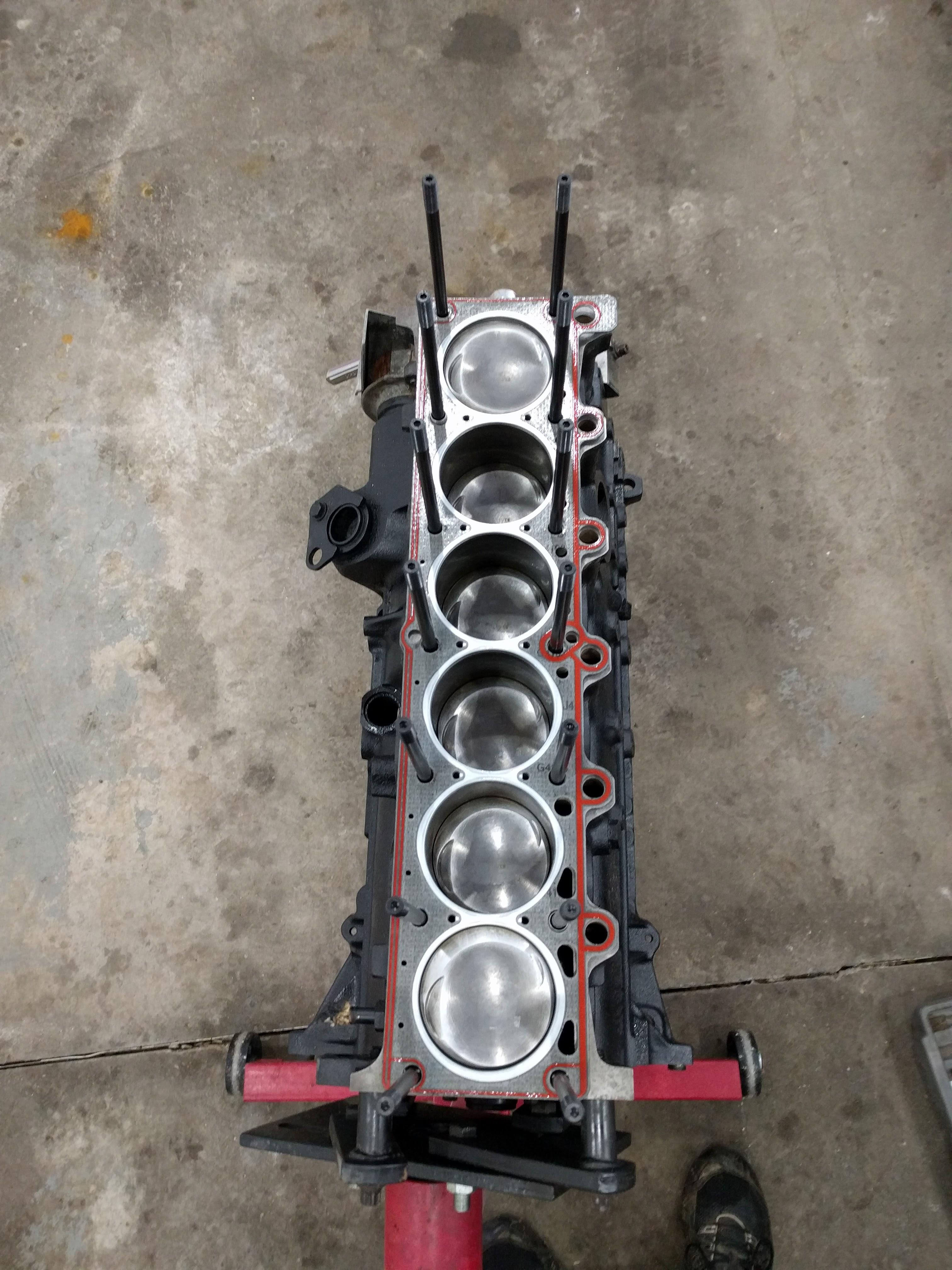

    Last spring while wrapping up our build we made an error and popped the motor, we then spent all fall and winter tearing down the motor. After ball honing the block, new-used pistons, rings, rod bearings we completed wrapping everything up this spring and worked on fixing all the little bugs. @snap was gracious enough to help us get the tune dialed in so we can finally drive the car and make some really nice WOT pulls which feel o-so-good.

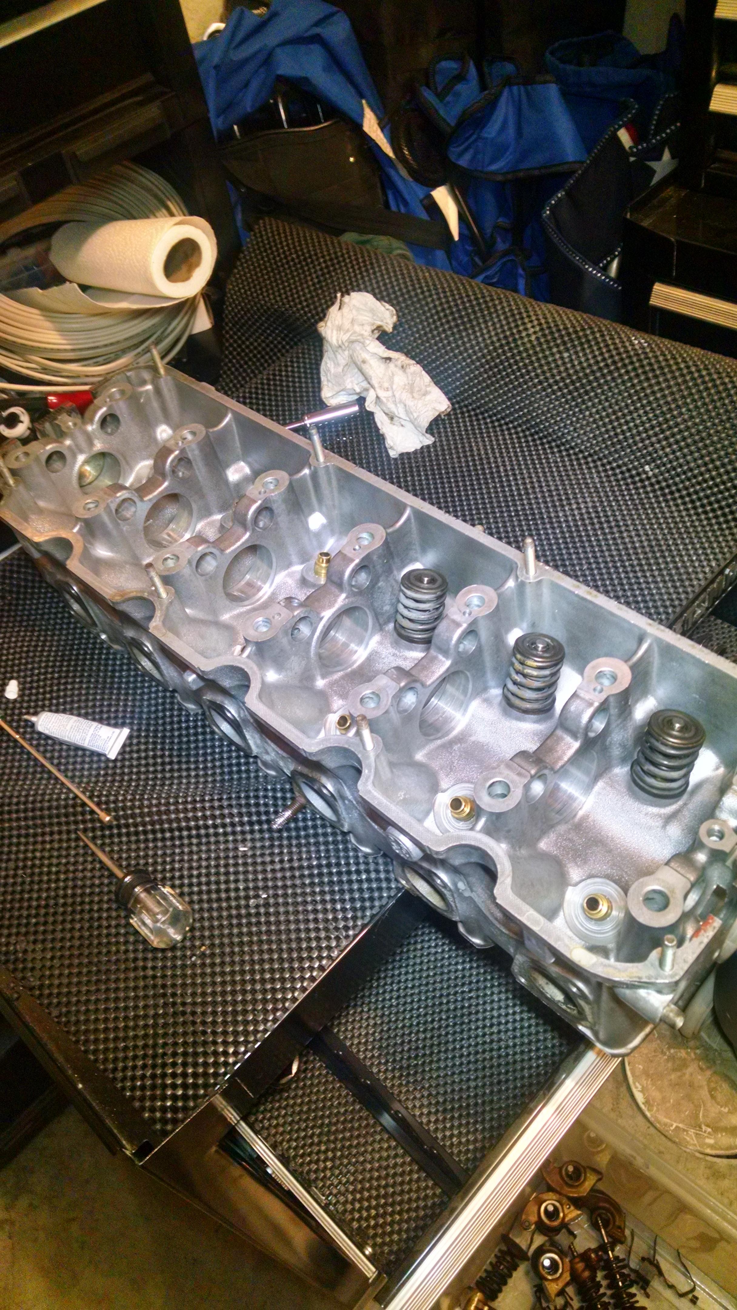

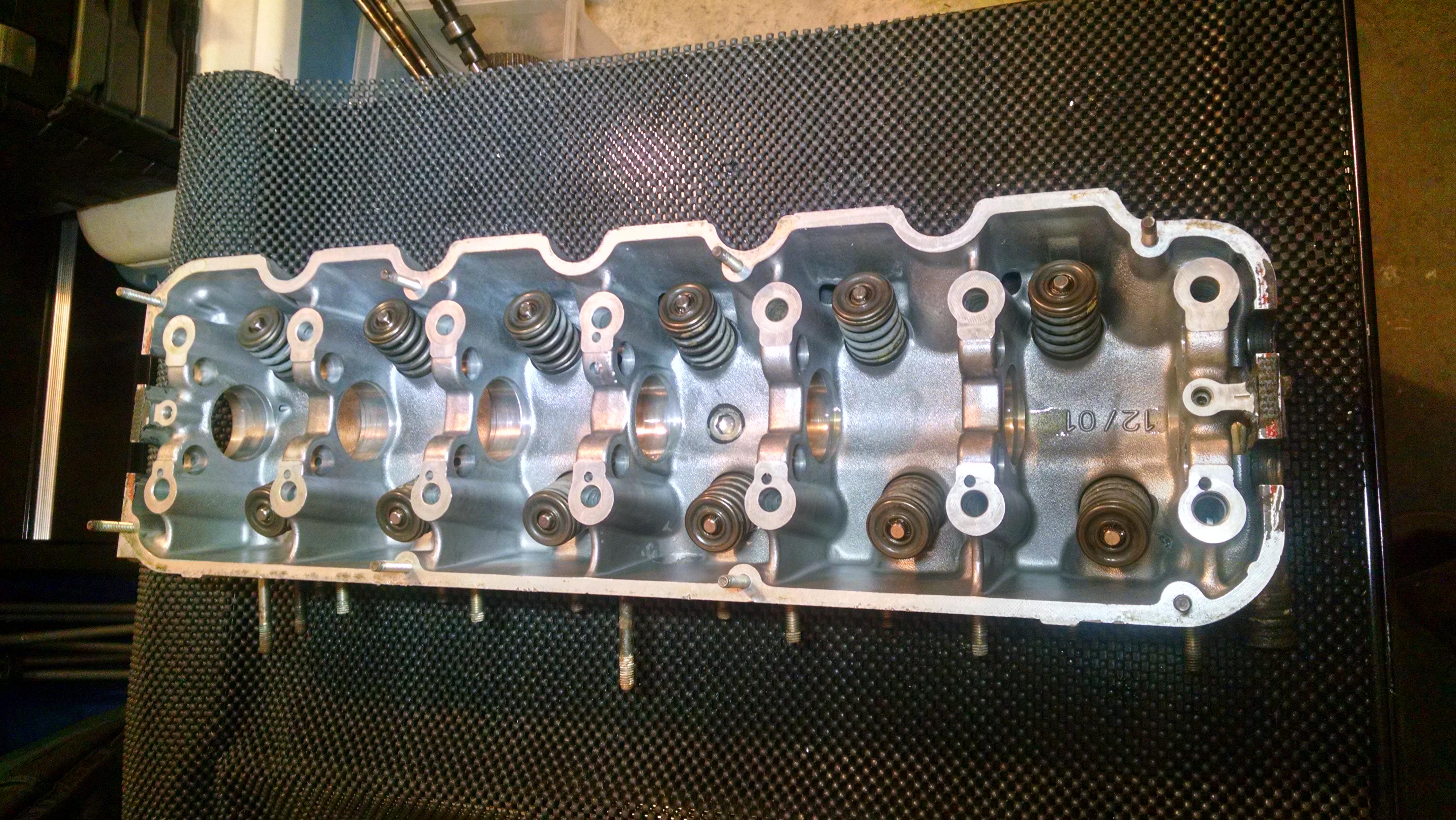

              Freshened the head up with new valve seals, re-lapped and resurfaced.

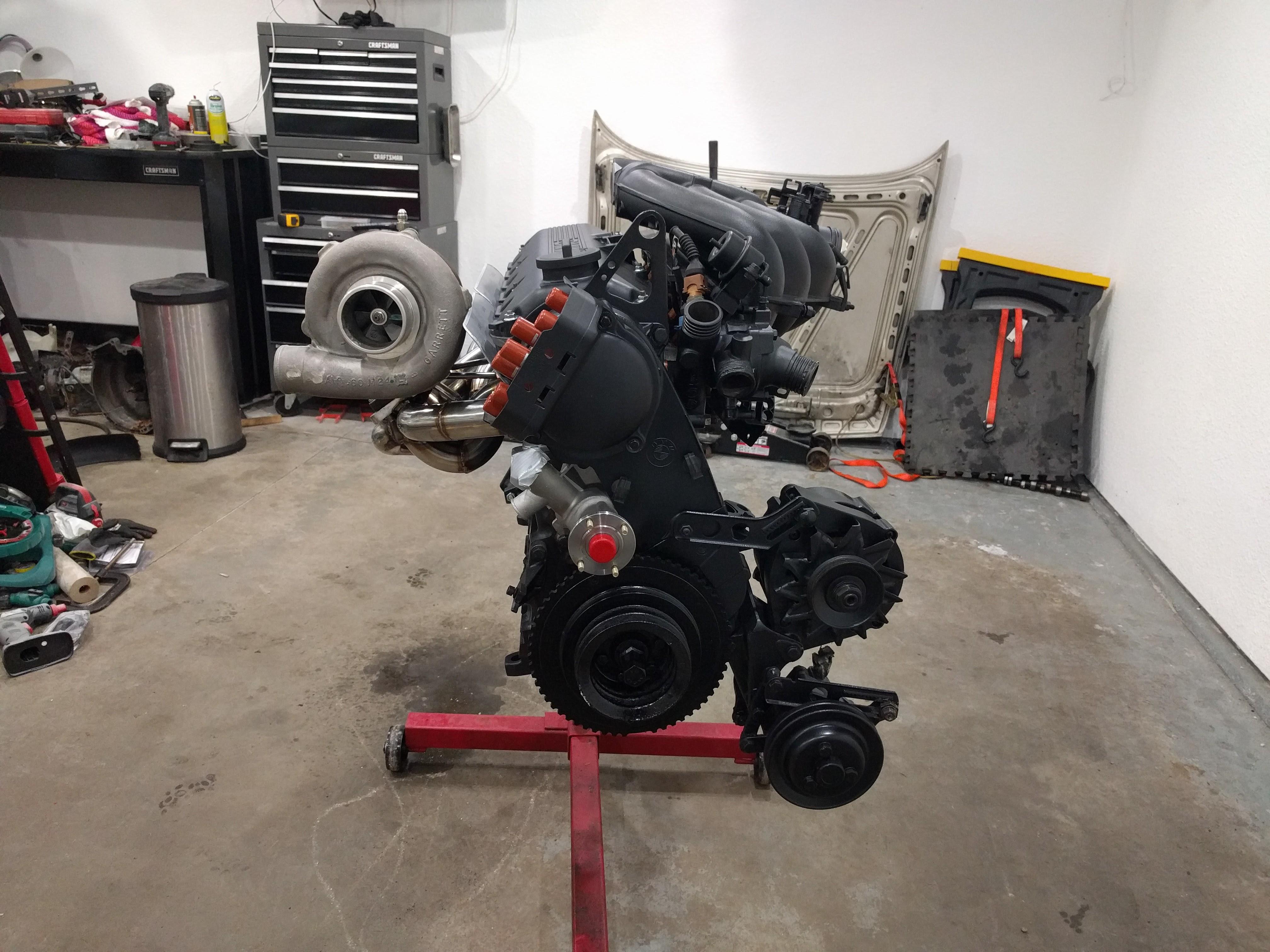

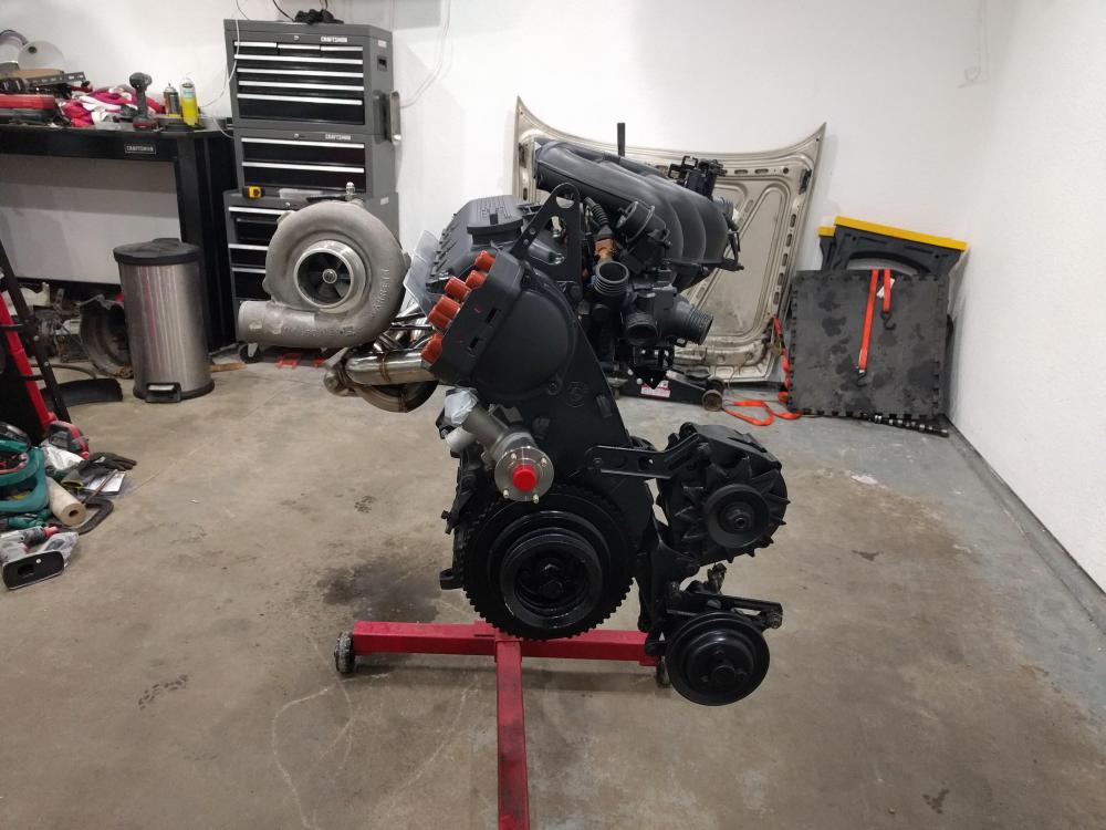

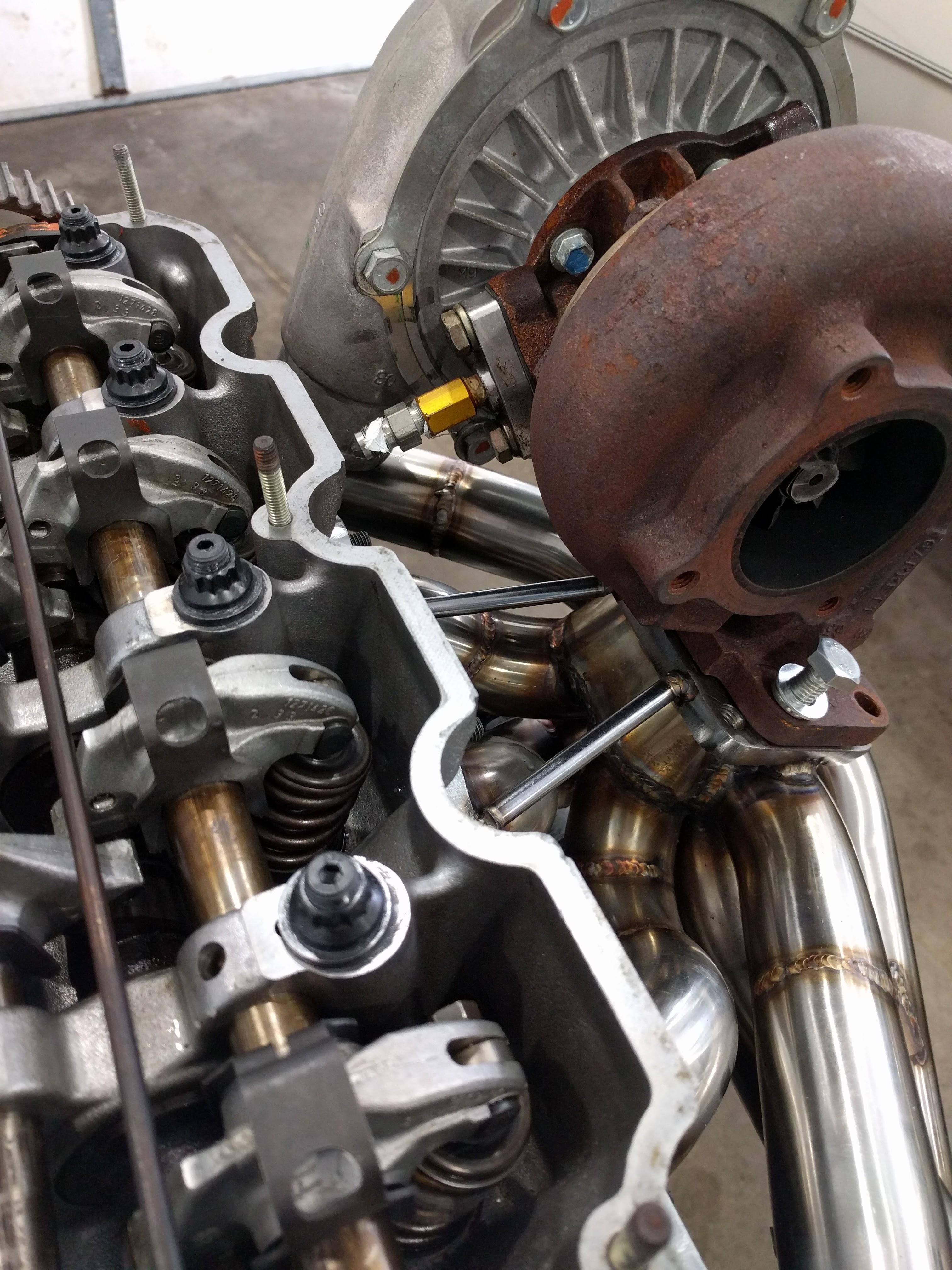

              Testing the fitment of our ebay manifold and Garrett T04e

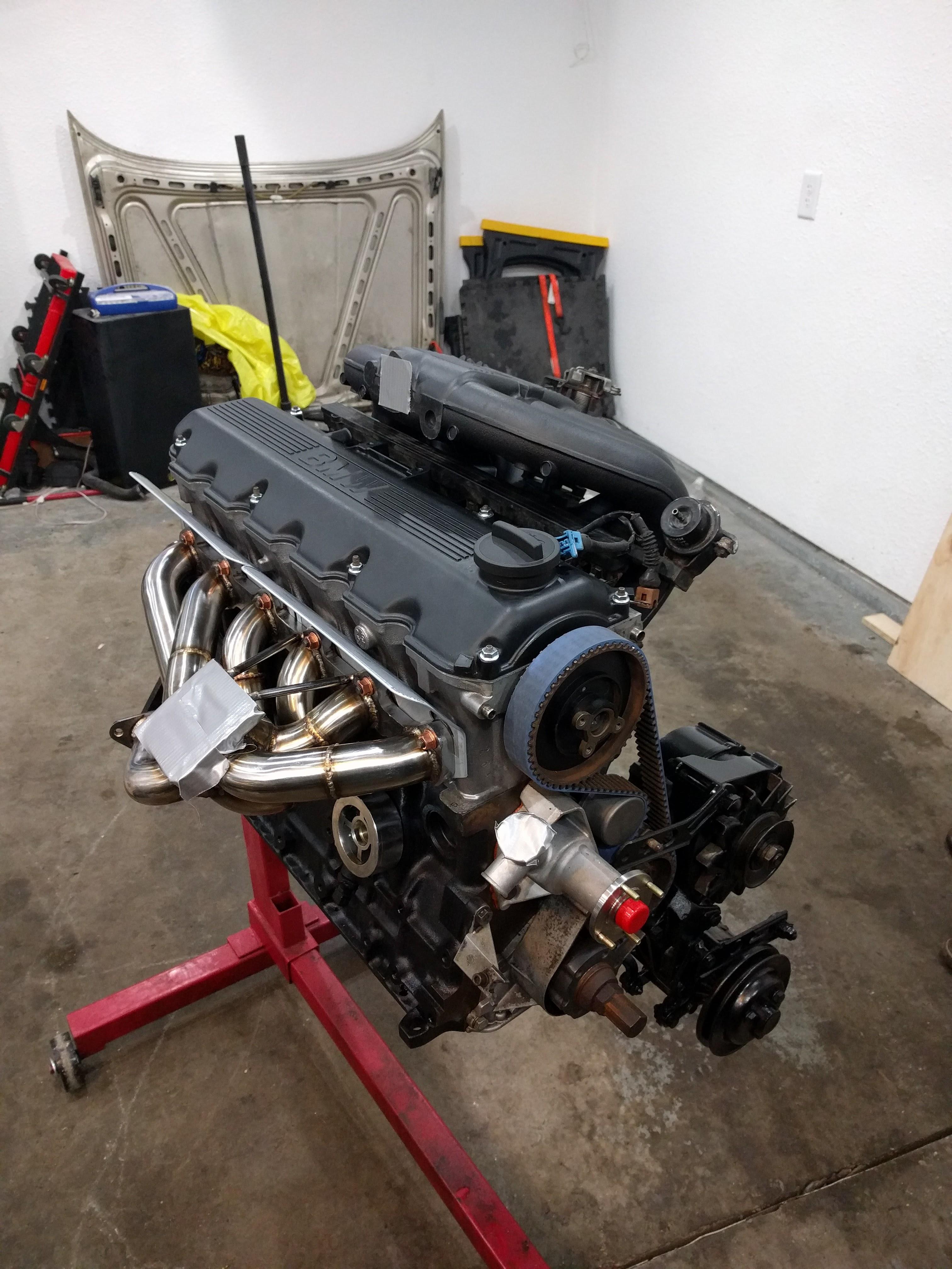

              Getting the Gates belt on and some accessories.

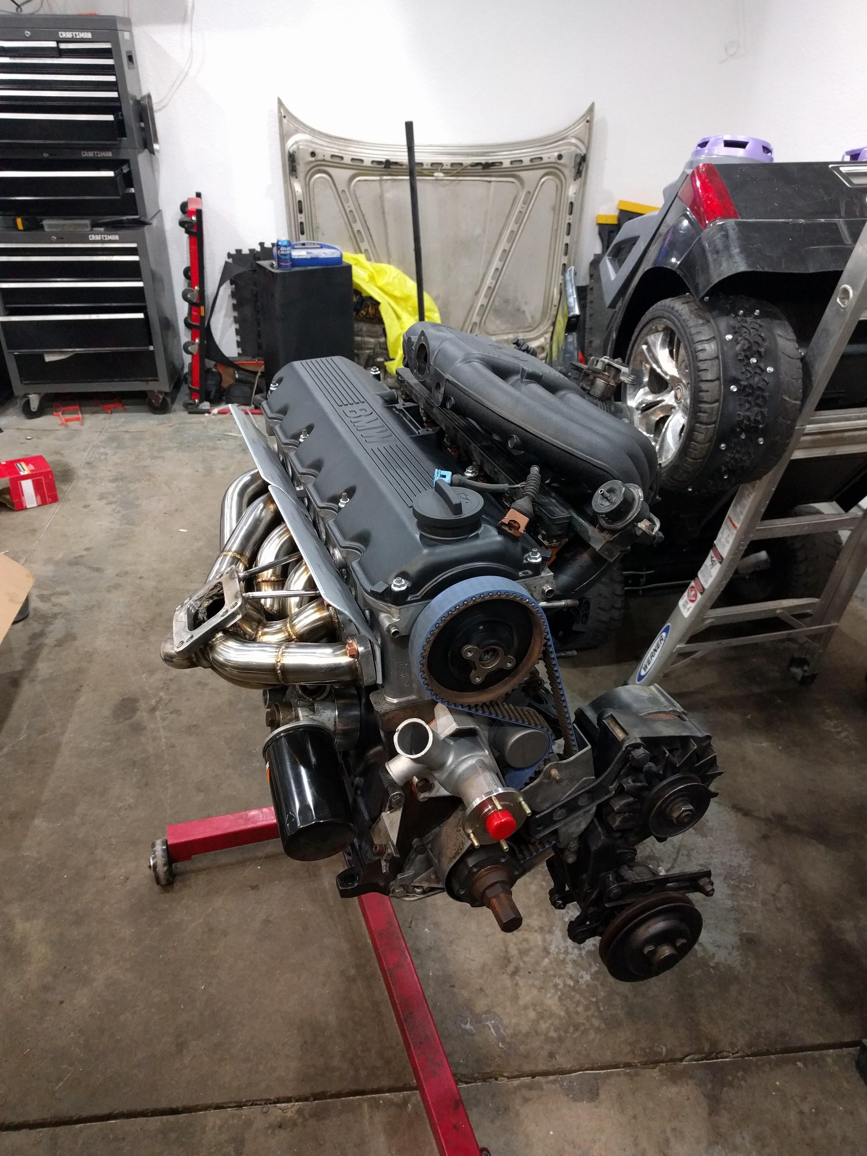

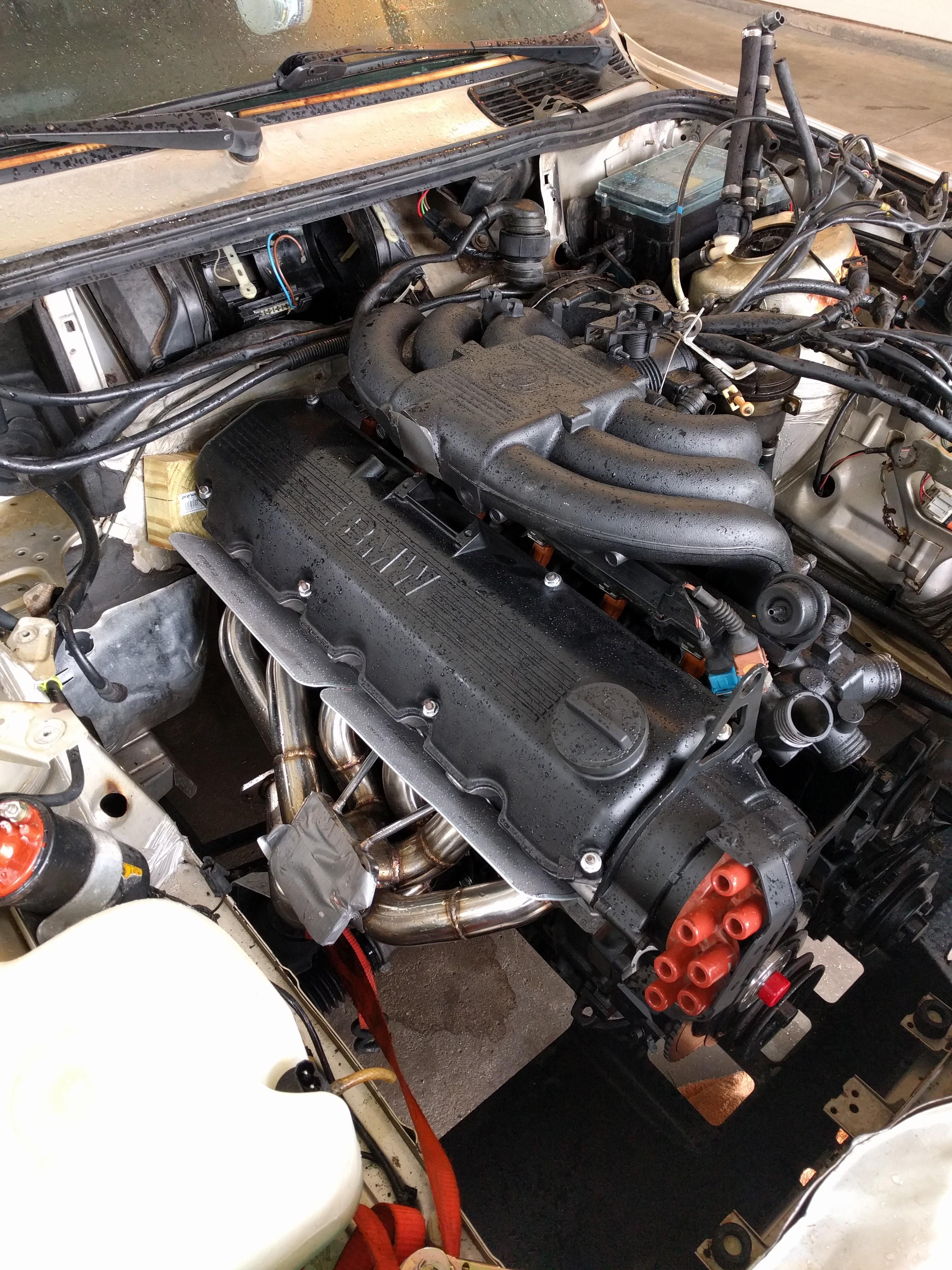

              Motor is finally in the car!

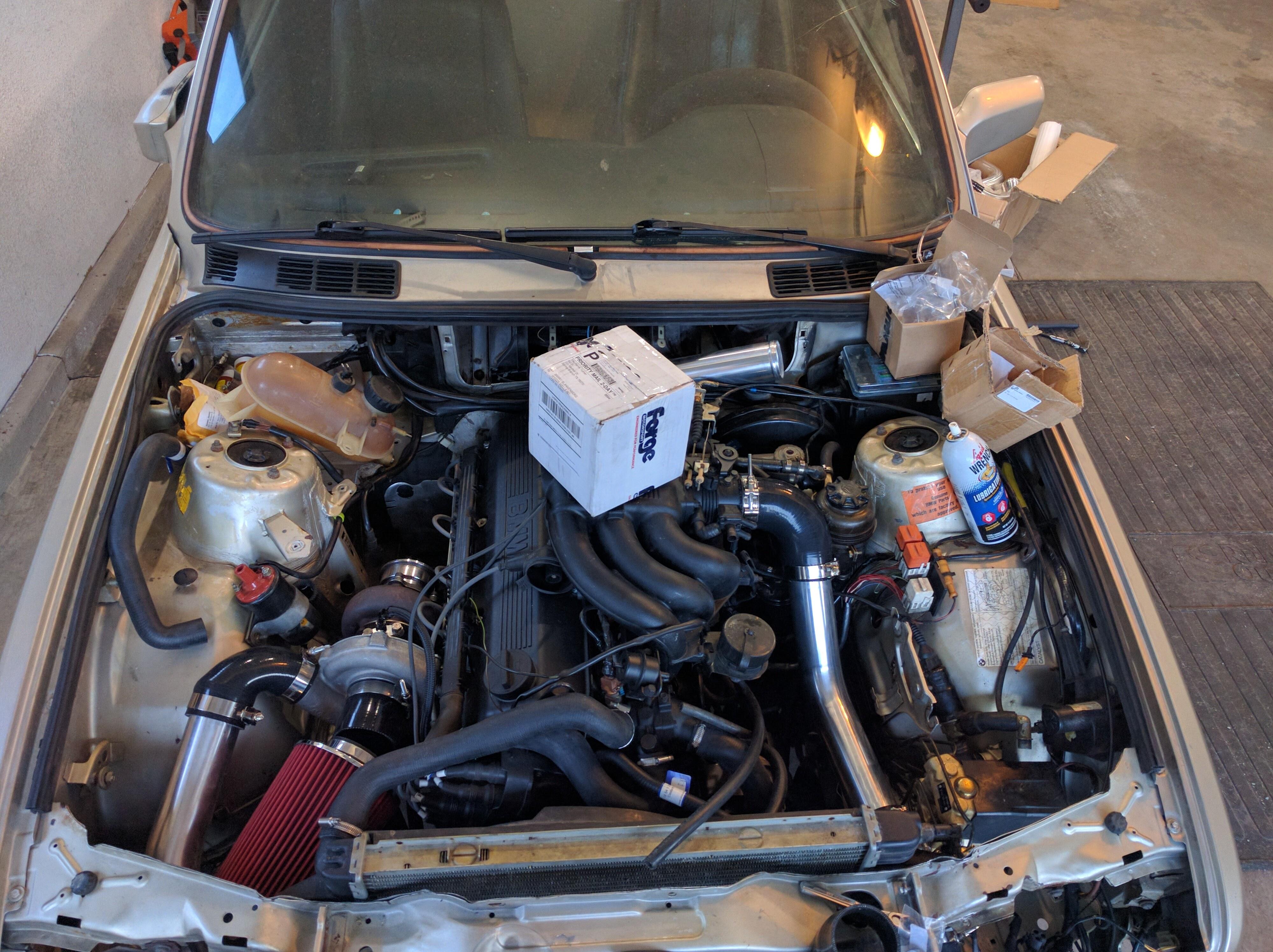

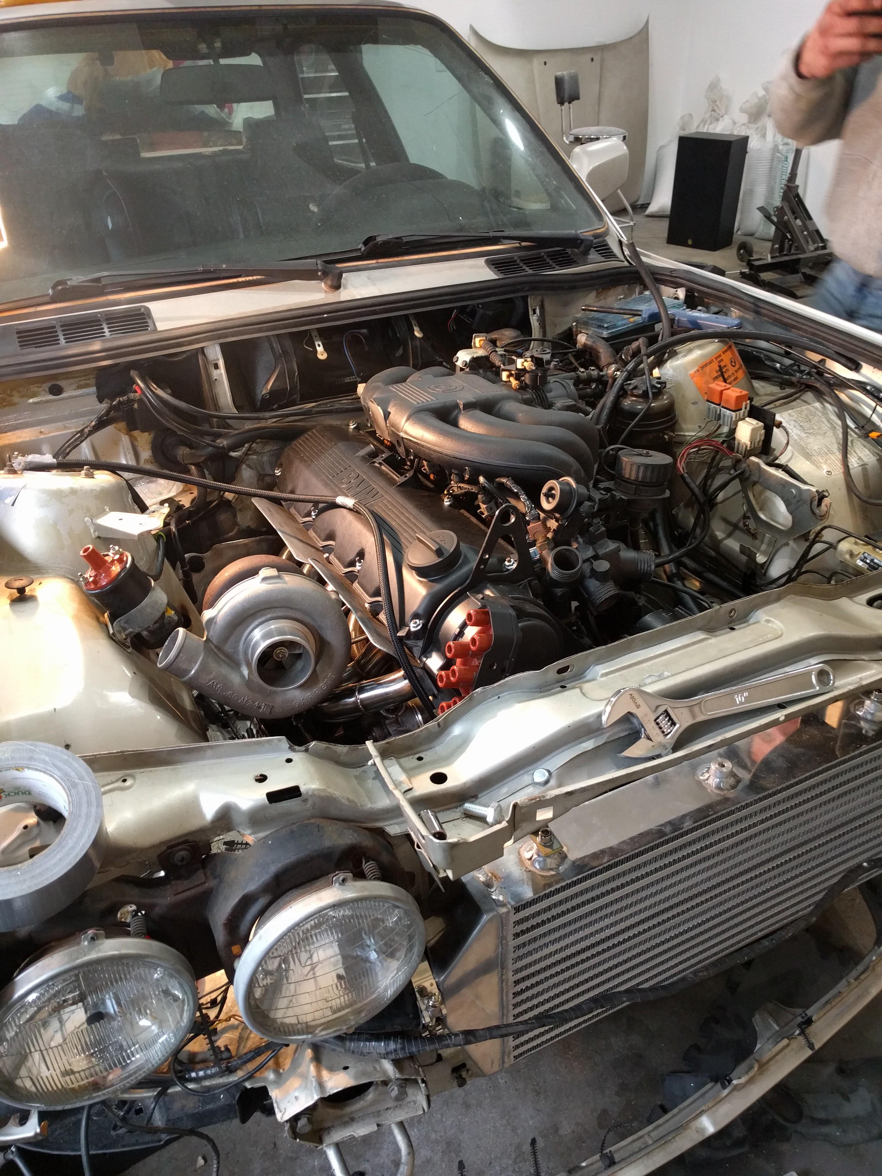

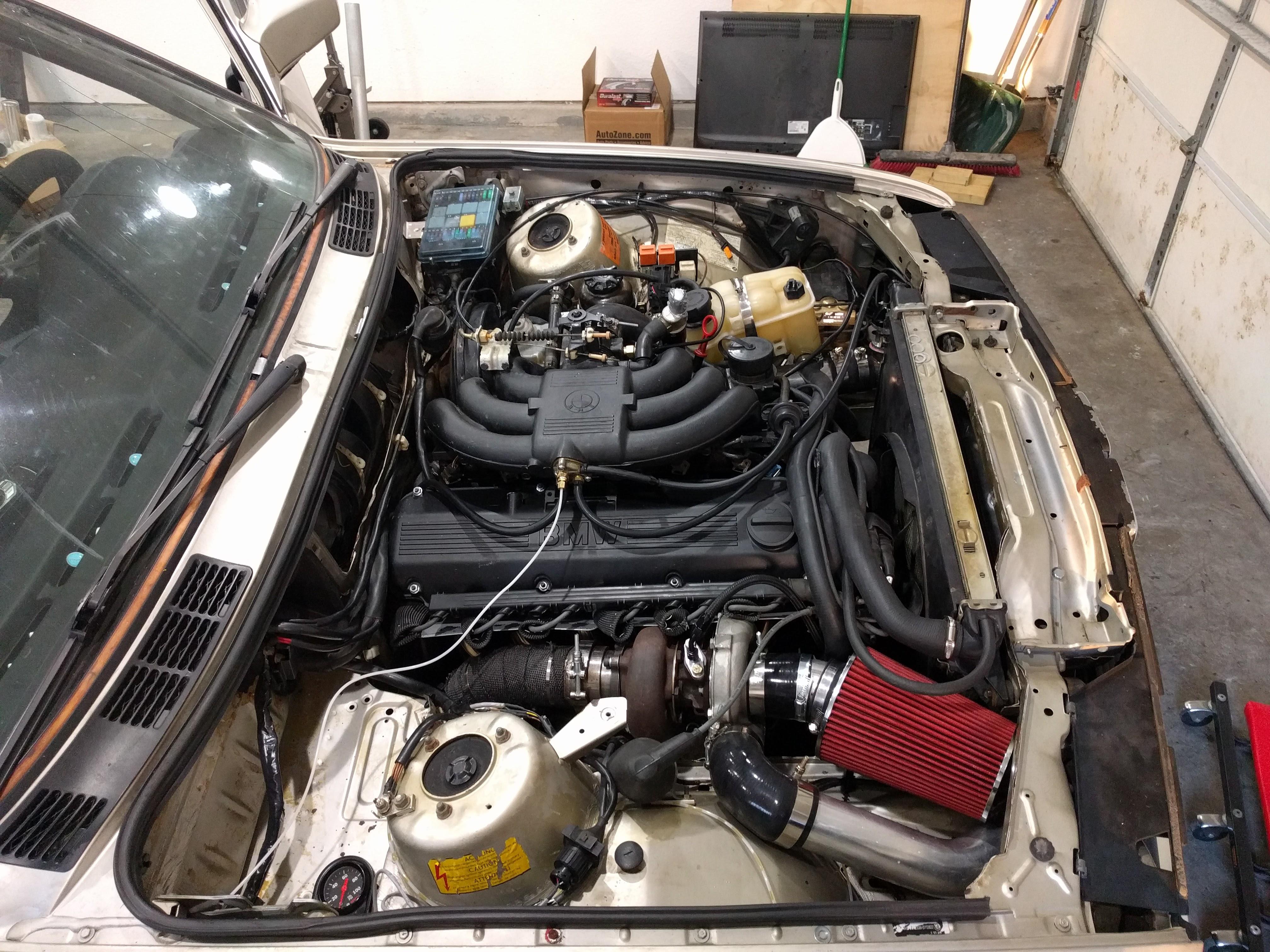

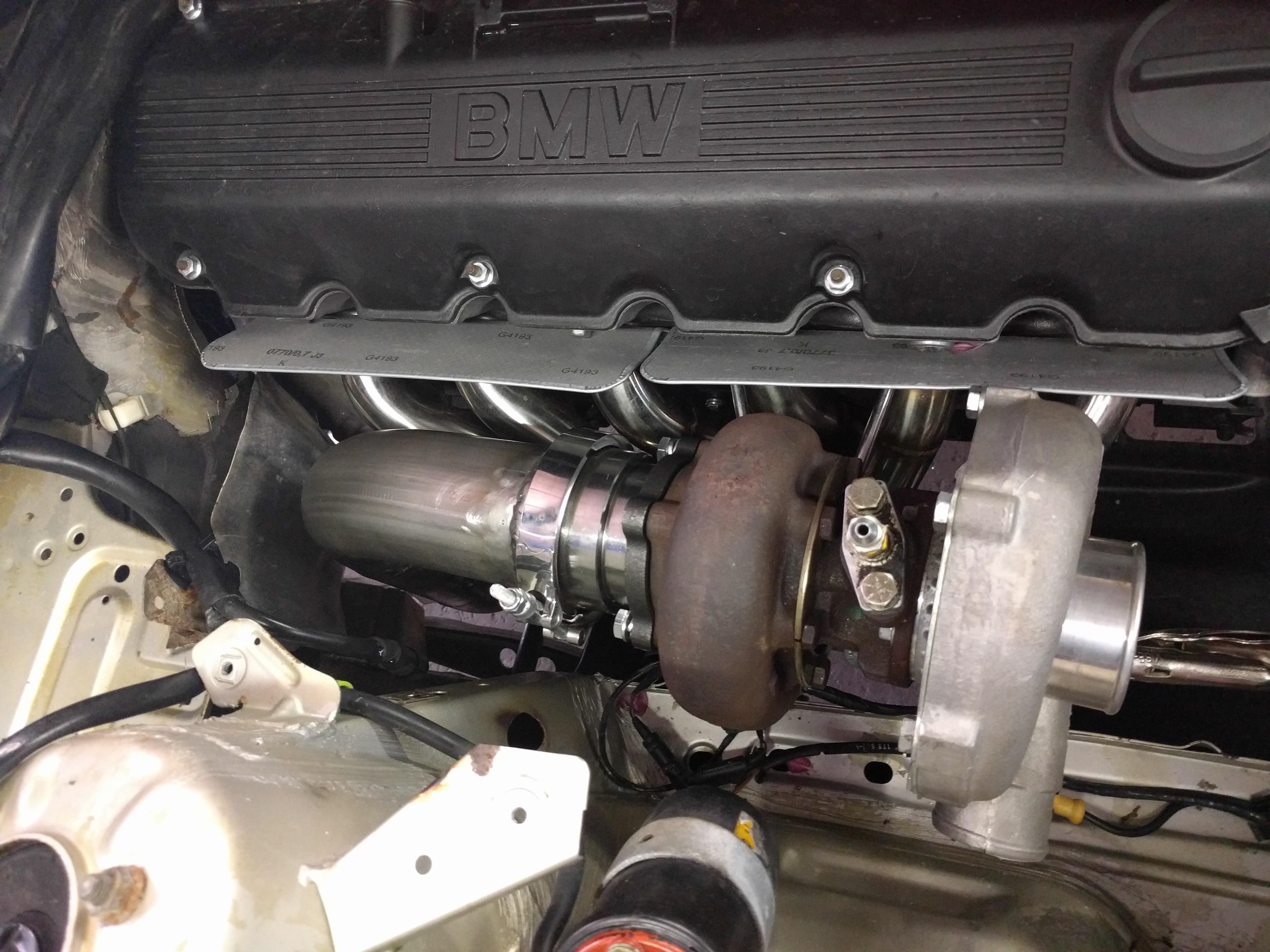

              Here you can see the manifold, turbo and downpipe fitment in the car.  -Thanks to our buddy Jeff on the awesome fab work on the downpipe\exhaust!

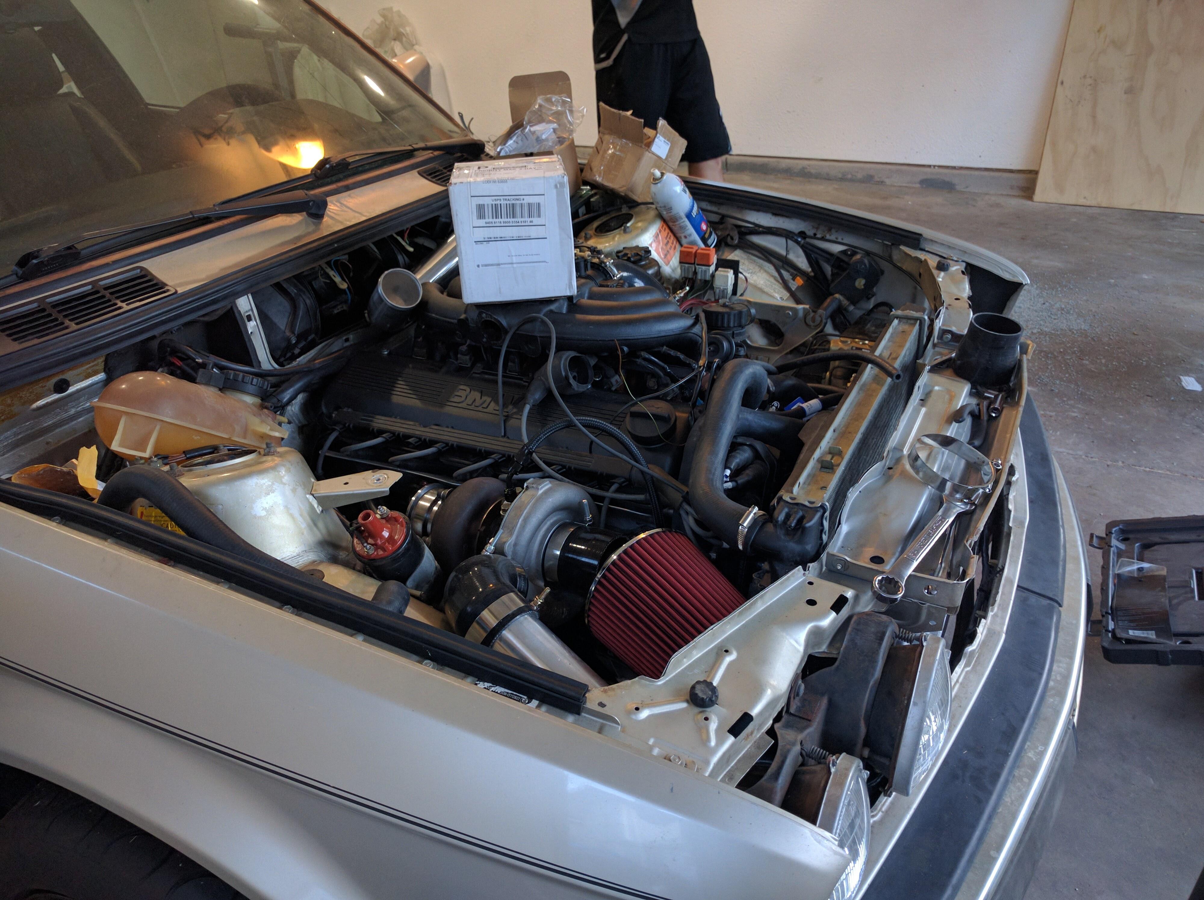

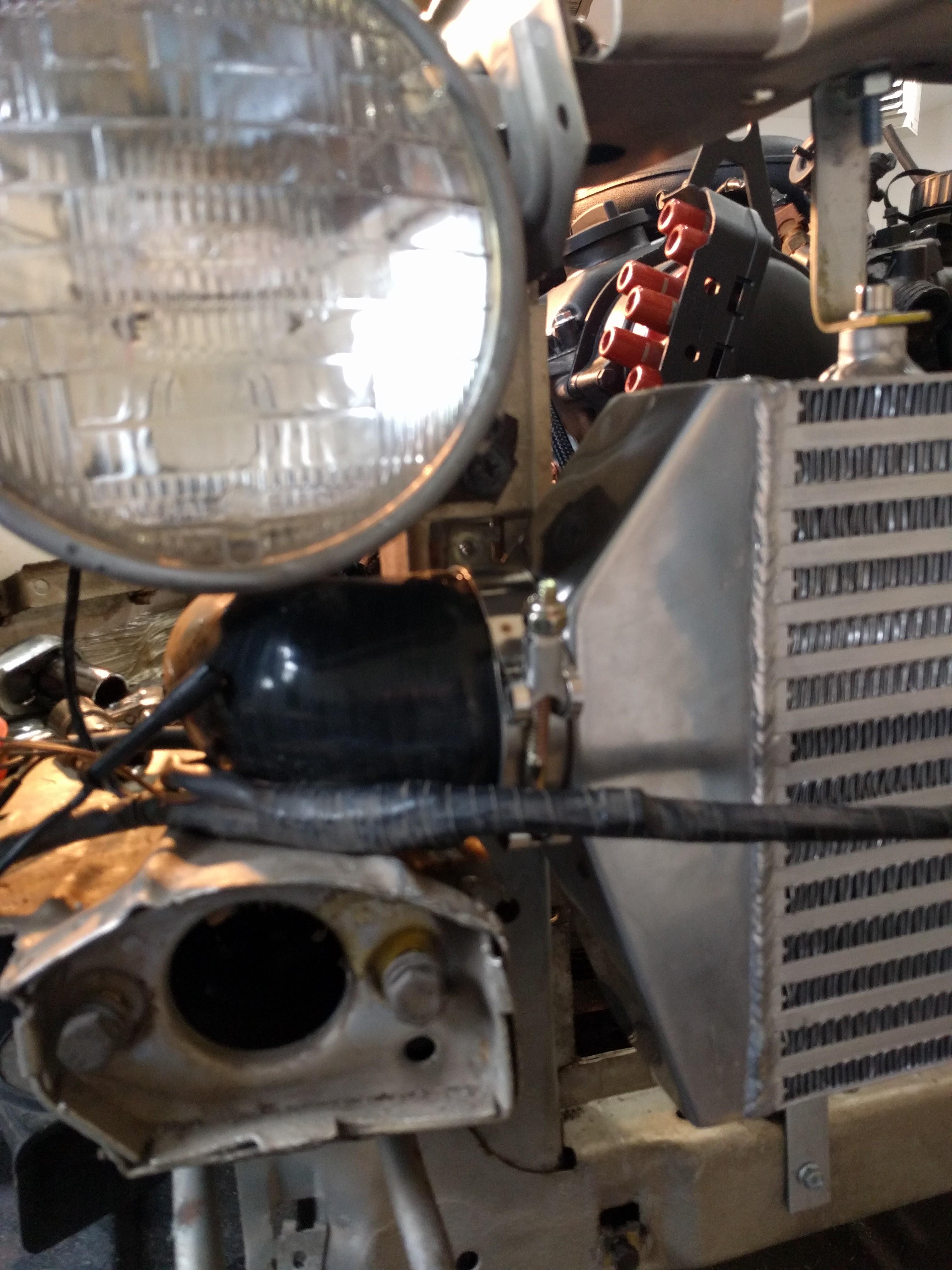

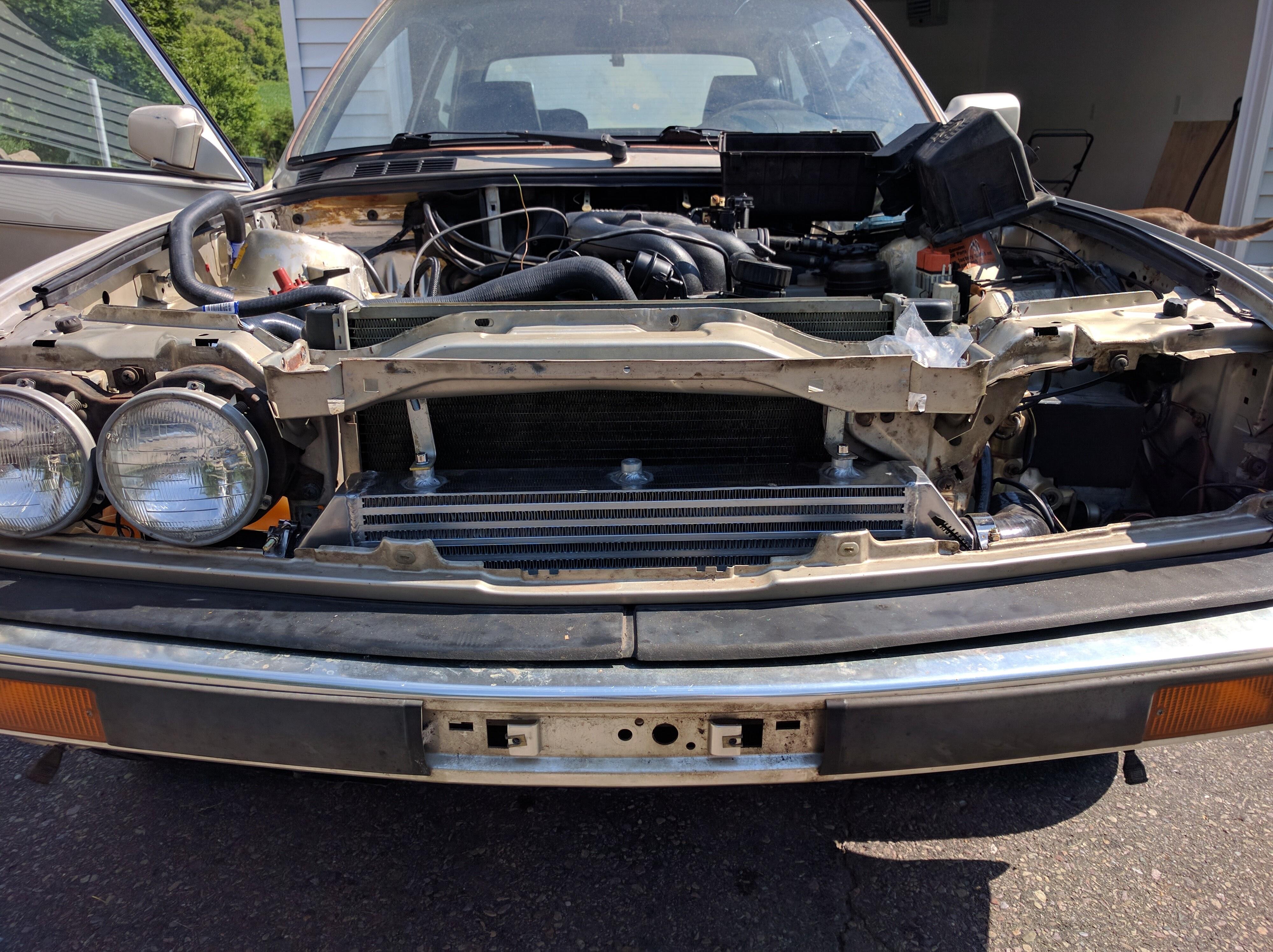

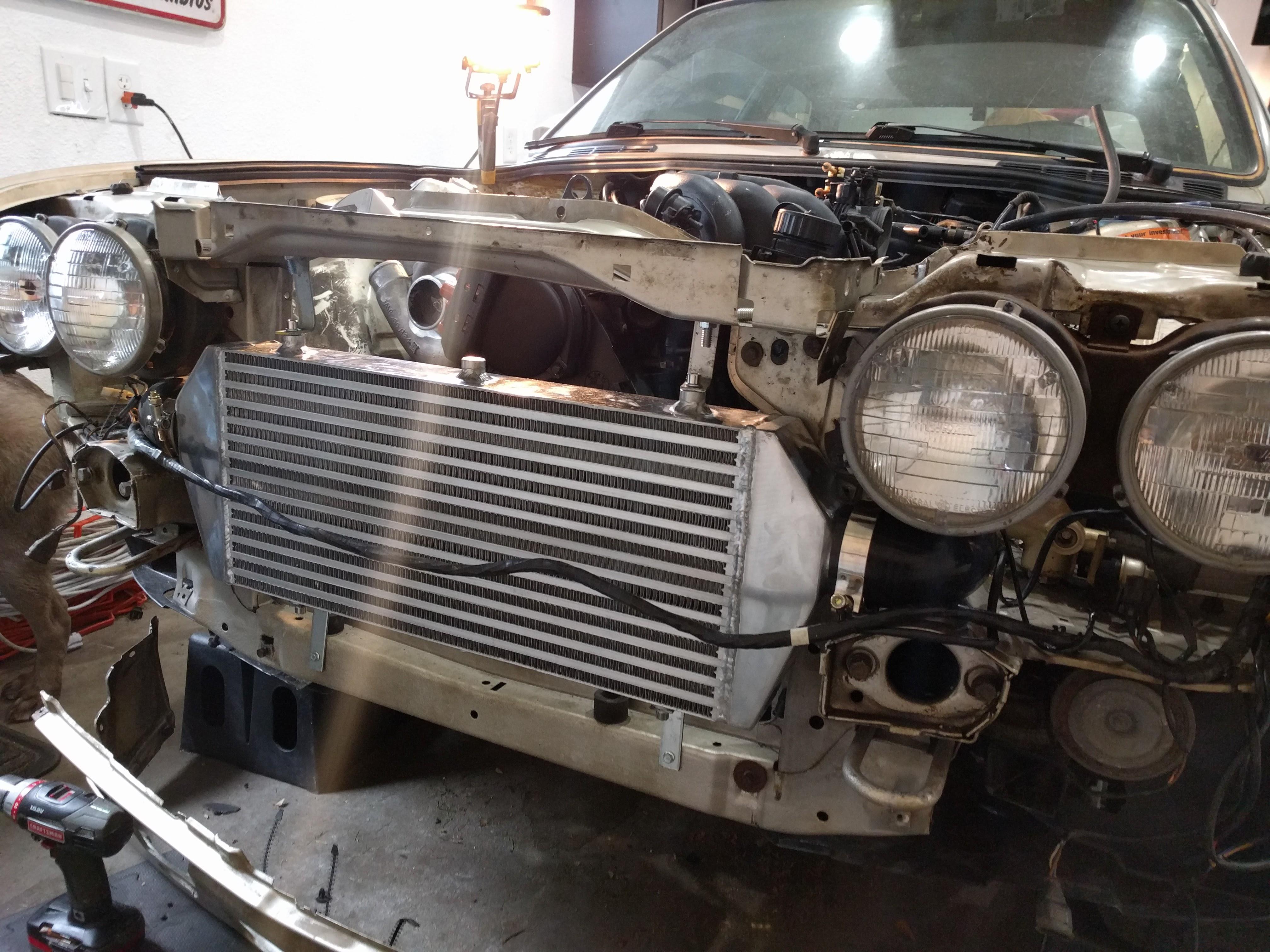

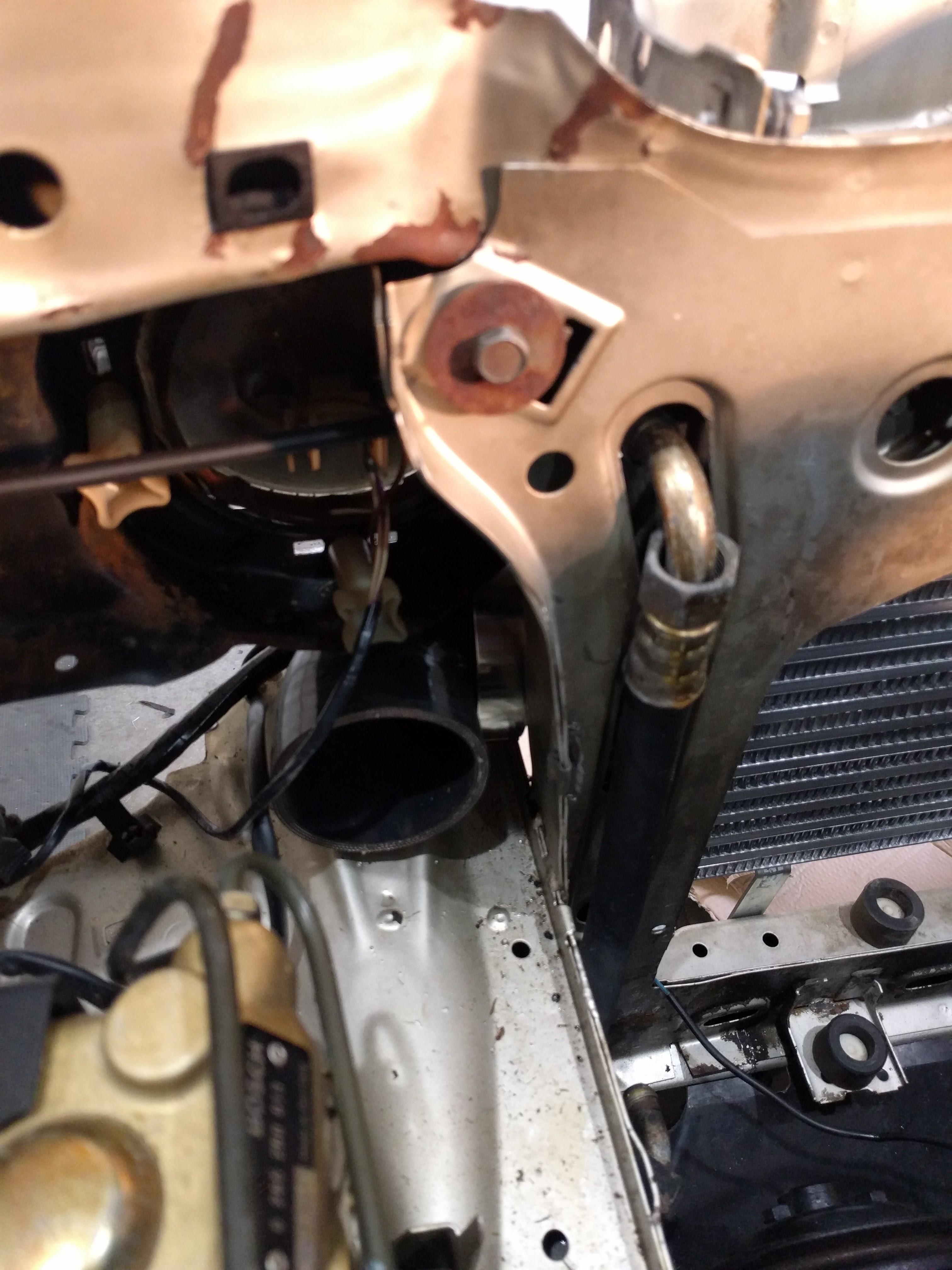

              Squeezing in the intercooler, we were able to fit inlet and outlets under the headlight brackets (they did have to be trimmed slight). But this tucks up nicely for an almost stock like fitment.

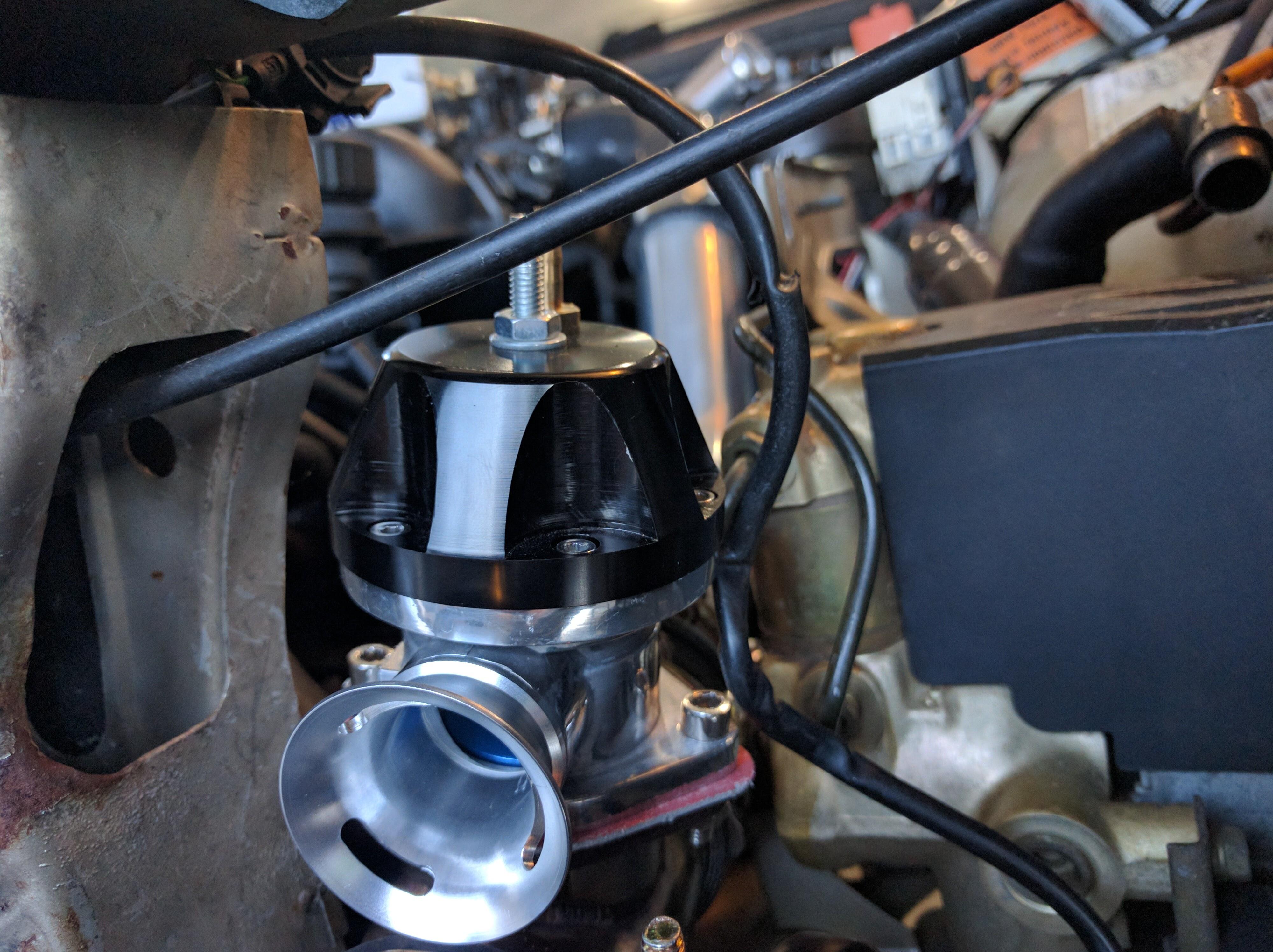

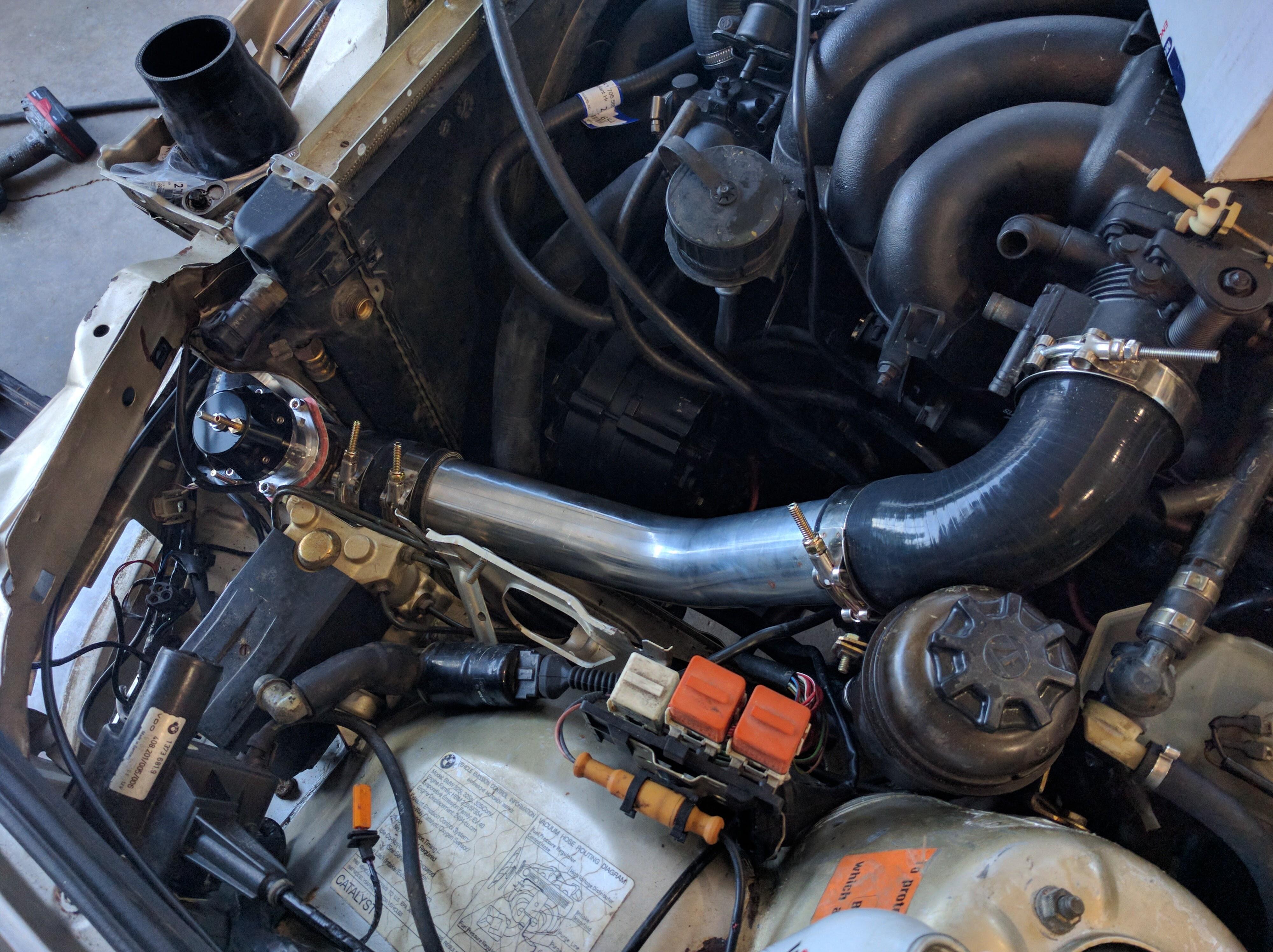

              BOV and intake piping is routed.

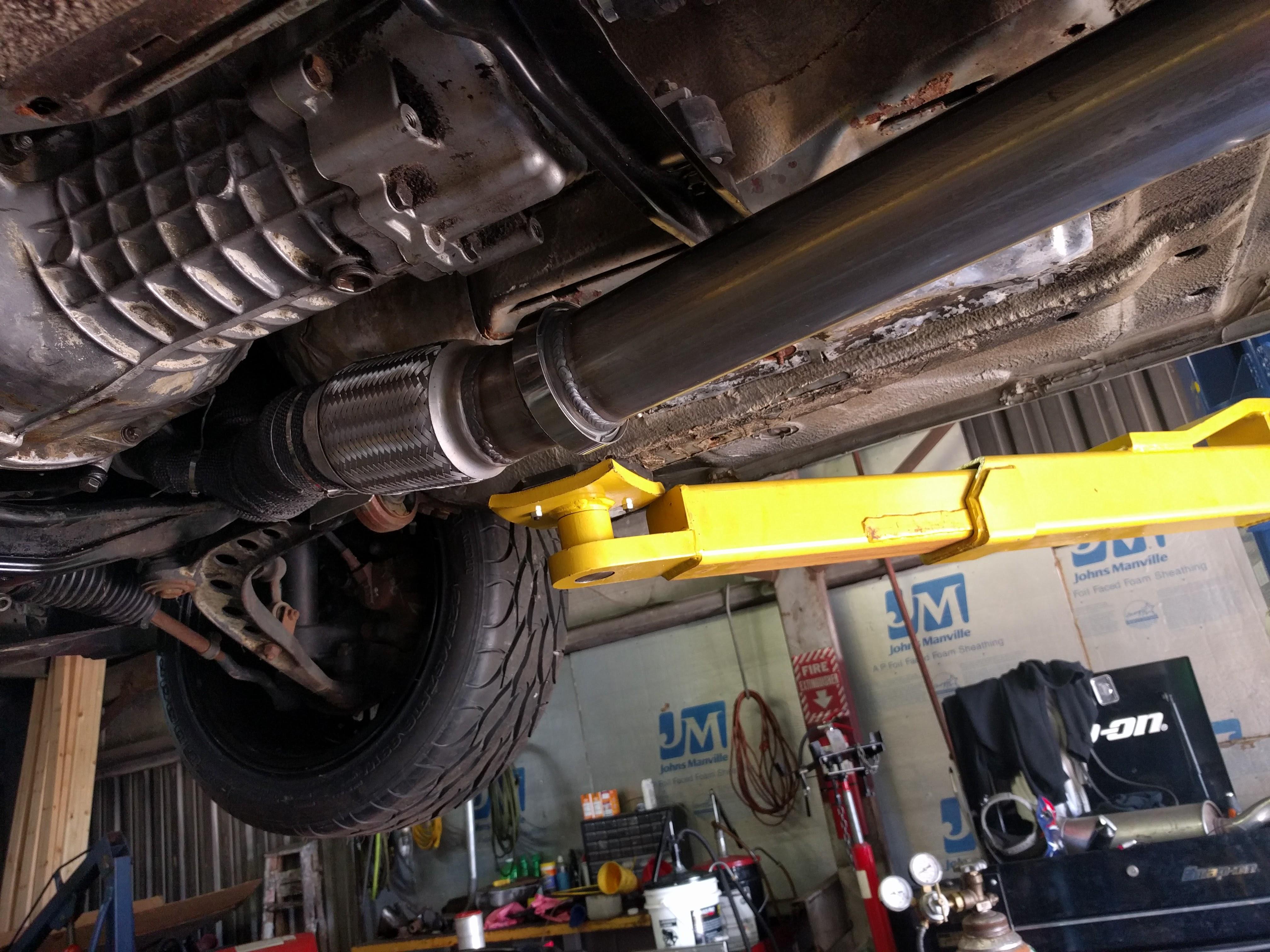

              Here you can see the downpipe my buddy Jeff fabbed up along with a flex coupler with vbands. It is 3" stainless all the way back. It does tuck nicely!

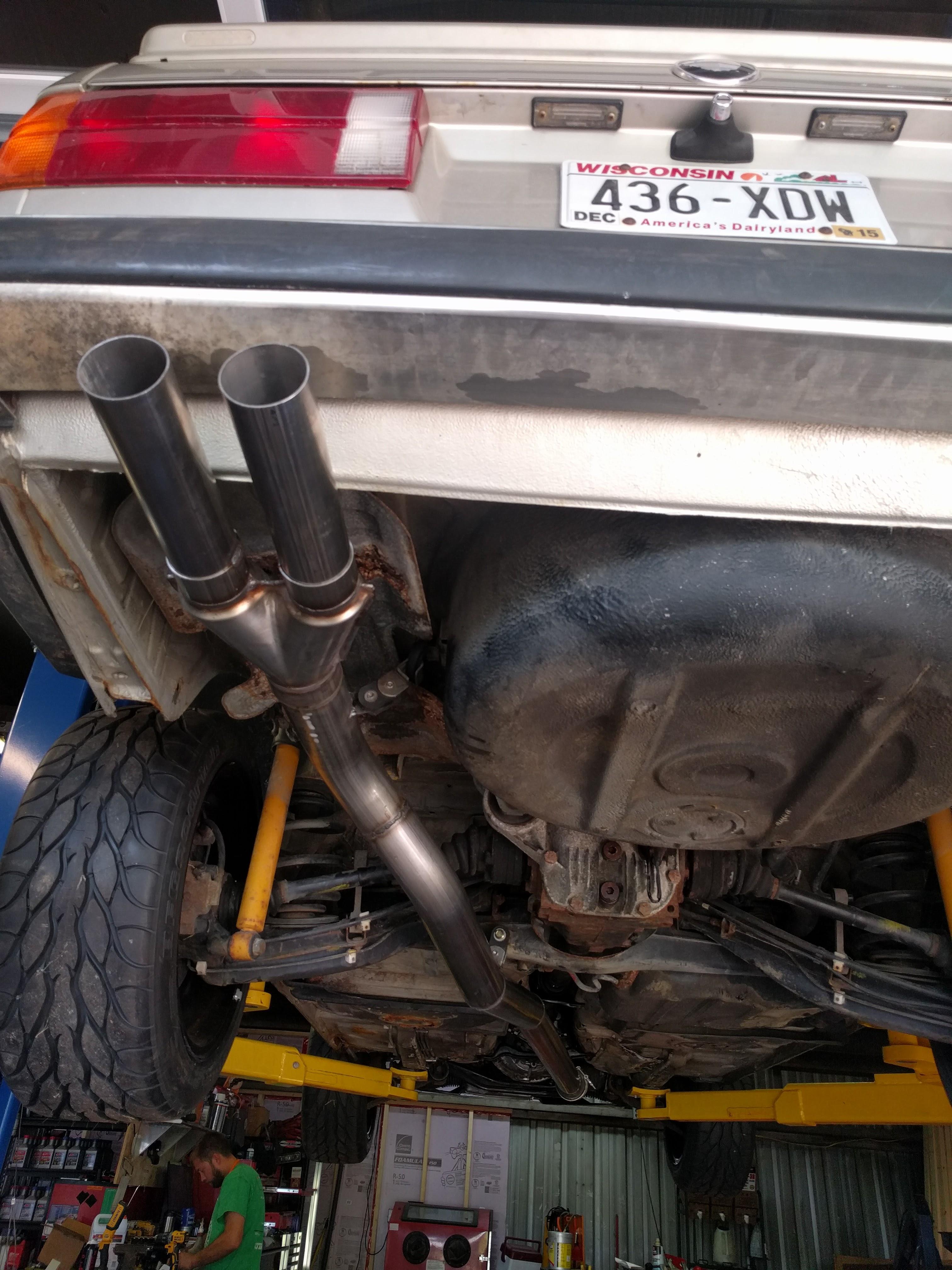

              3" to a magnaflow Y.
