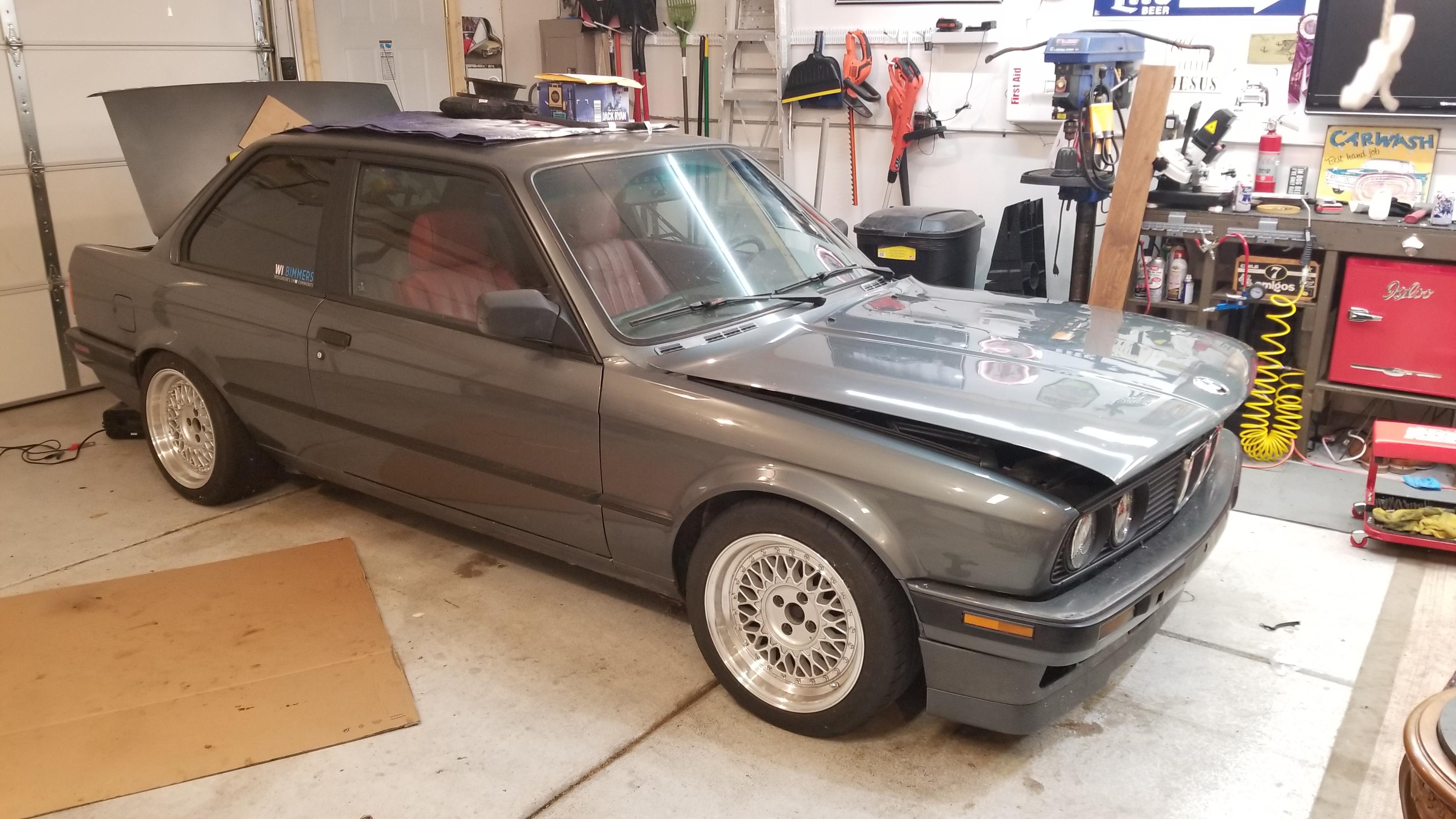

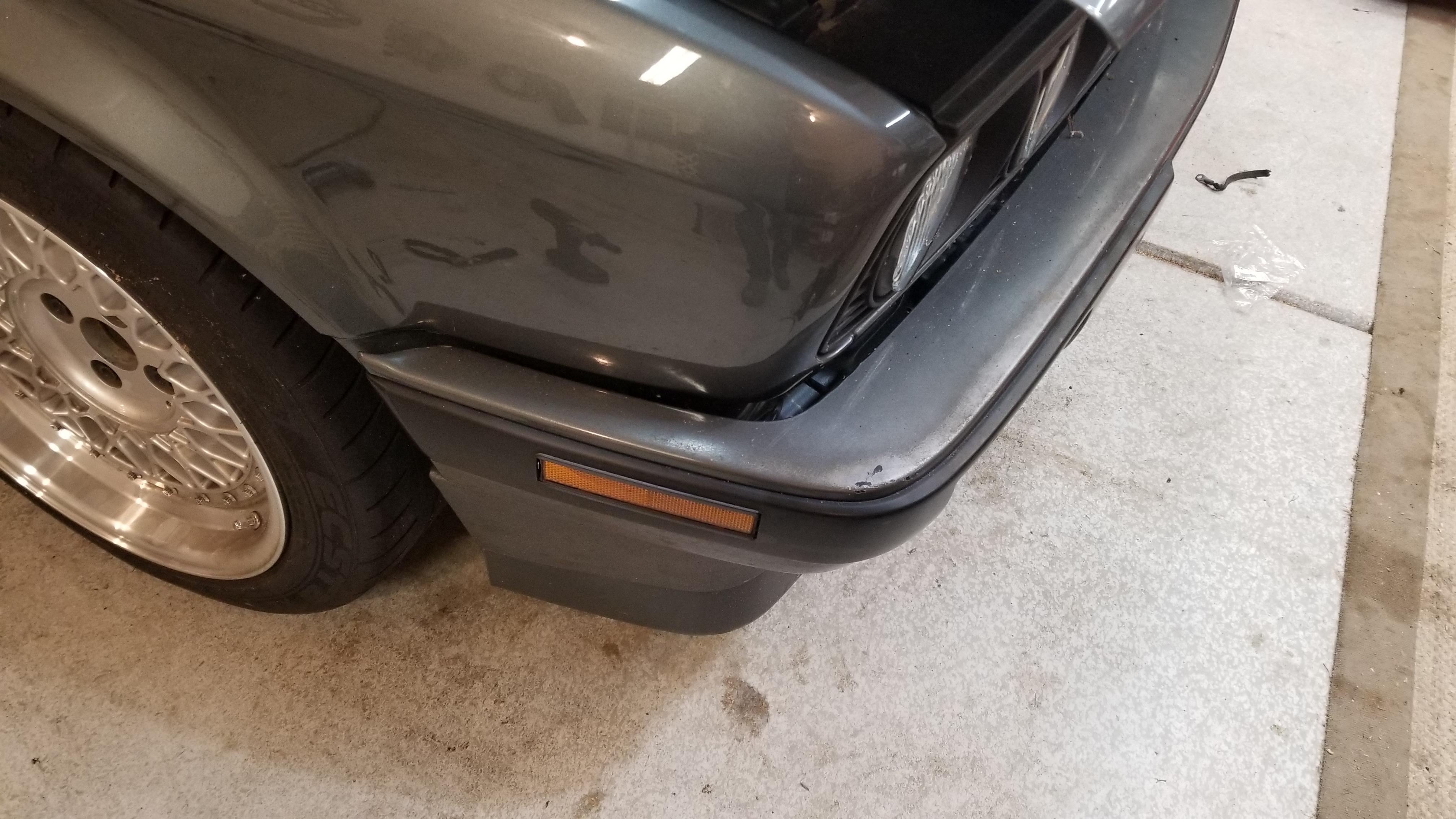

                    Back on the ground! Hopefully for a while this time. One of the tie rod securing nuts was frozen, so it got new tie rods. Oil is drained out and new stuff goes in tomorrow. Fixed the hood ground strap. Getting the lights finished. Pretty excited.
                    Now my standard question. How would I go about aligning this bumper?
                                  I LOVE how this car looks. What are the wheels?
                                    #177
                                    They're RS reps made by ESM. They make a lot of bbs reps and they're pretty cheap/affordable.
