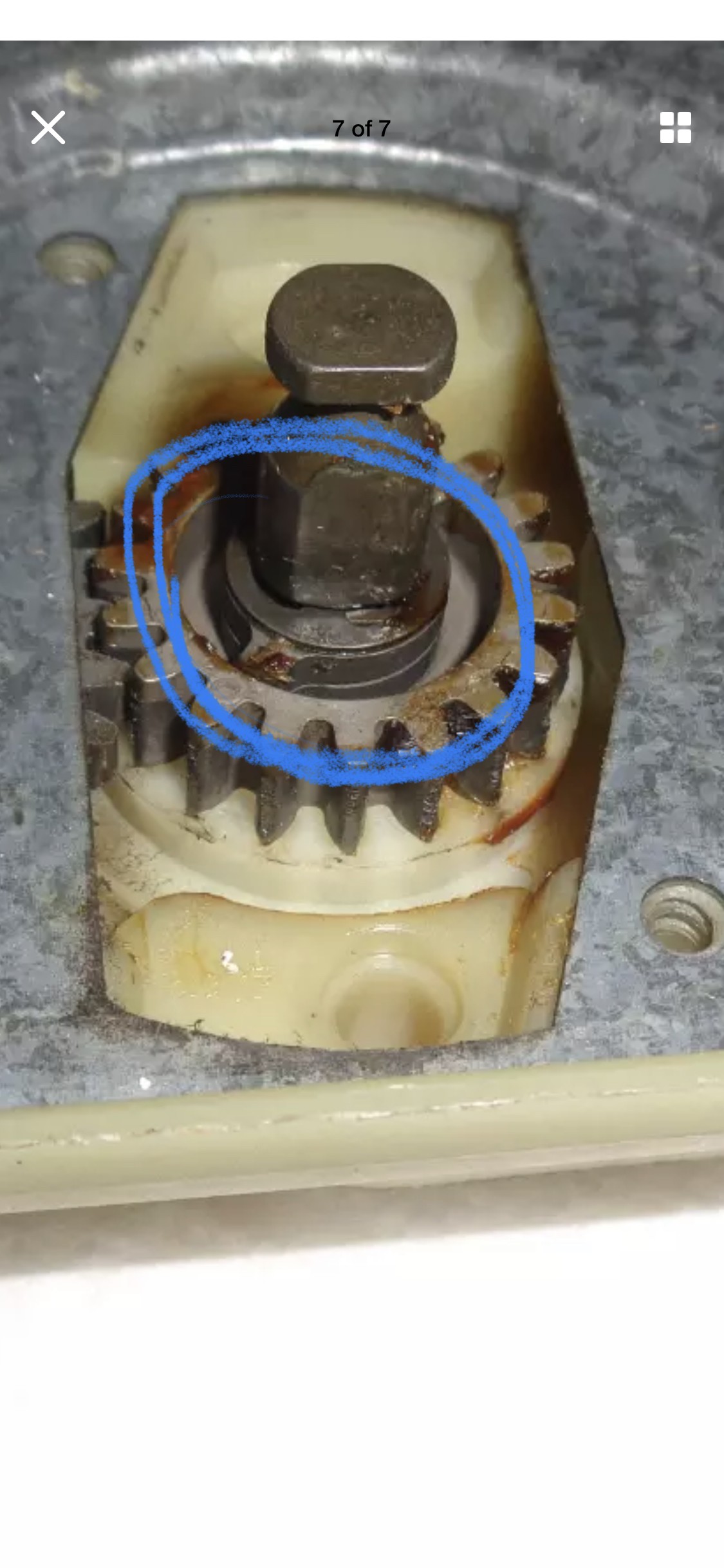

    That is for a power sunroof. So the emergency key isn’t for manual sunroofs. I found that what I’m missing is this little gear here:
    As you turn the handle, the little tooth on there catches the tooth on the inside of the gear that drives the gear to open and close the sunroof. So I need to source one of those. I am assuming that the handle broke - as appears to be very common - and the PO removed the handle and this stuff fell apart. I’m crossing my fingers the whole mechanism still works once I get the crank back together.

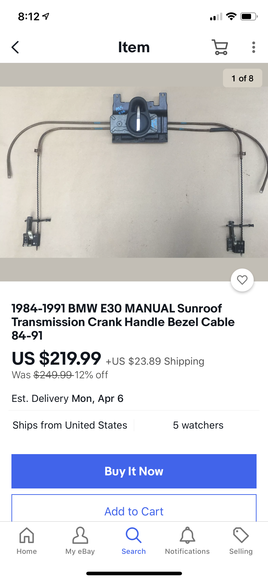

              Not knowing much about these: do I just get the crank and install that or do I buy the whole thing with the cables and everything as one large assembly.

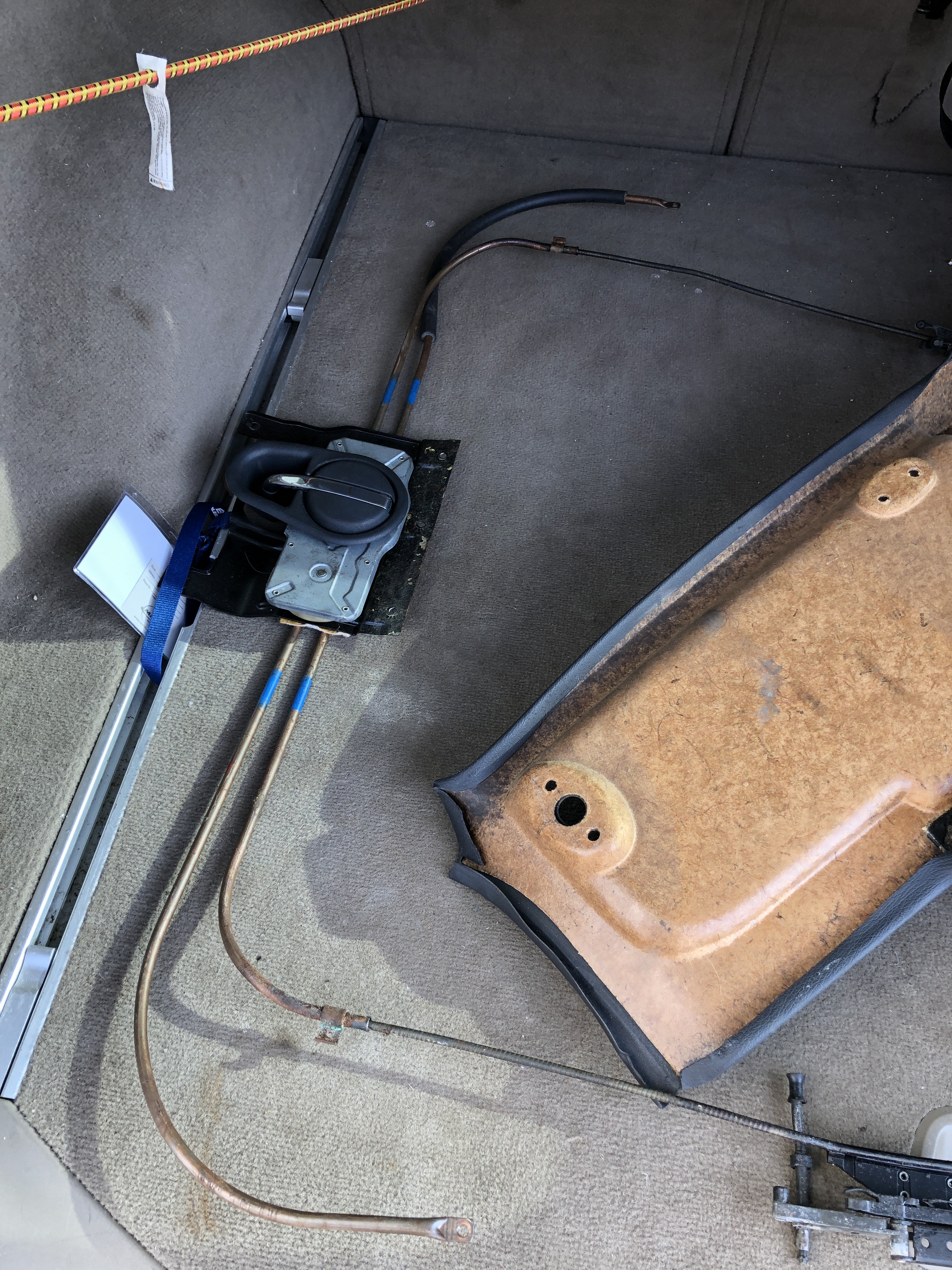

              Ebay prices are ridiculous, do people actually pay that much for those?? I have an entire manual sunroof mechanism that worked perfectly when pulled that I have absolutely zero use for since neither of my cars have a sunroof. I'll PM you.

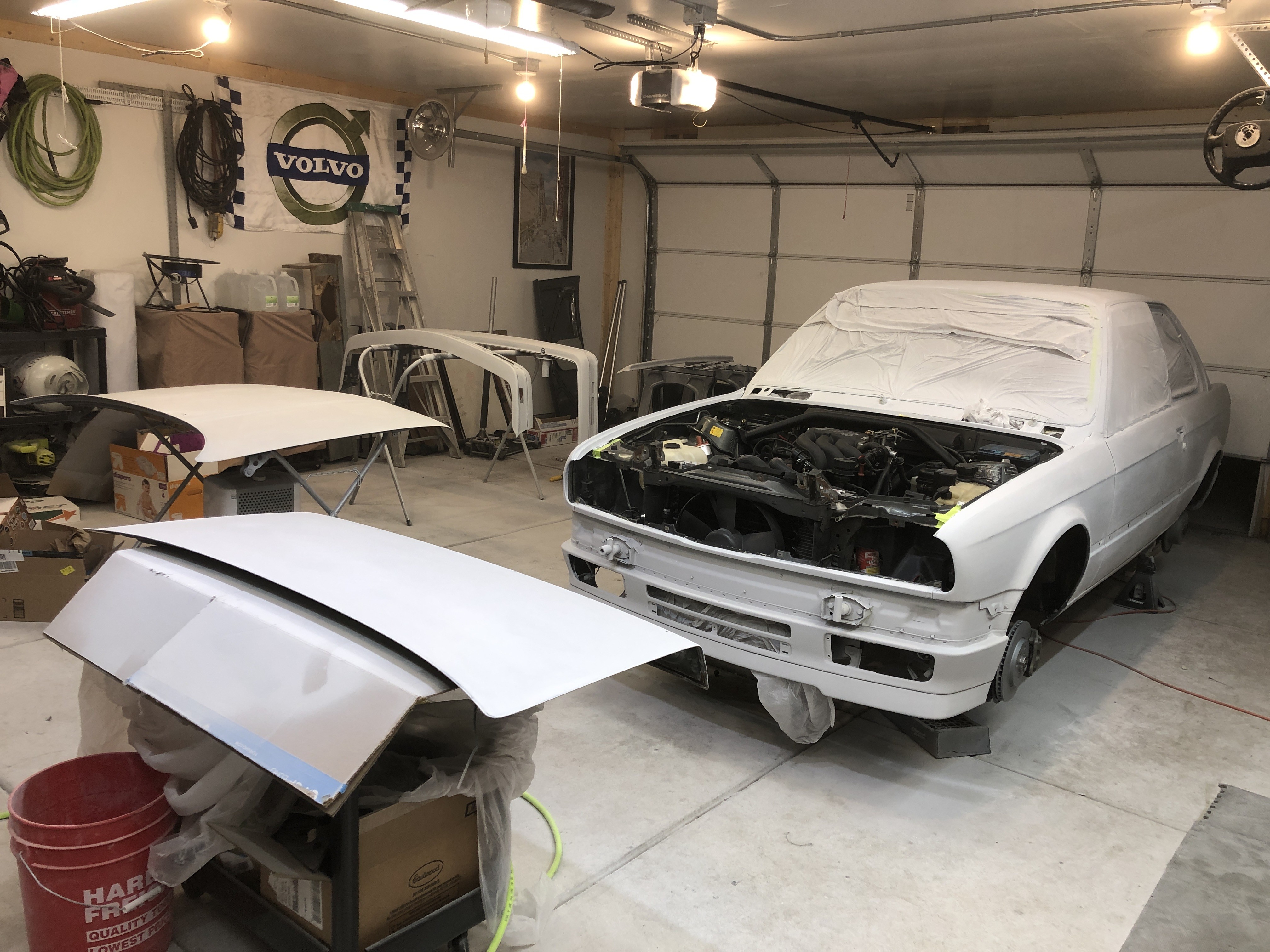

                Sanding is 99% done! I did some touch up with 320, then 400 everything, and then a quick once-over with 600. After cleaning everything up I found a couple spots that need a little attention, but all in all it's done. I cleaned up the garage, blew it out, took down all the plastic and started taking off some of the masking. Next up is to put up new plastic and masking. I plan to paint everything not on the car first and then paint the car a different night to keep paint dust from collecting on parts to a minimum.
                And @m42b32 to the rescue! I'll be able to at least use this to see if my sunroof still works, and if it doesn't, I can swap in this working mechanism. Saved me a ton of money so it is very greatly appreciated.

                    Dont forget to wet your floor before painting! Itll grab dust and overspray!
                      #810
                      Got a garden sprayer that I’ll be using for just that!

                        Using the spare sunroof gears my sunroof tilts open but the gears are very sloppy when I try to slide it open. I am hoping the cassette is bad and I can replace that and be fine.
                        The hard part is the front headliner panel is attached on top under the sunroof and to access those screws, I need to slide the sunroof open. I got a spare panel, so I may need to cut off the wrap that’s on it to access the cassette and hopefully fix it, and then put in the spare panel. 🤷🏼‍♂️

                            Still need to apply clear coat. It took five coats to get the hang of it. Had terrible issues with striping. Once I turned down the material adjustment a little bit and did much tighter passes it came out awesome. Doing large, flat areas is really hard. This is definitely not as easy as they make it look on YouTube.

                              Clear coated. Very happy with how these turned out for being my first time.
