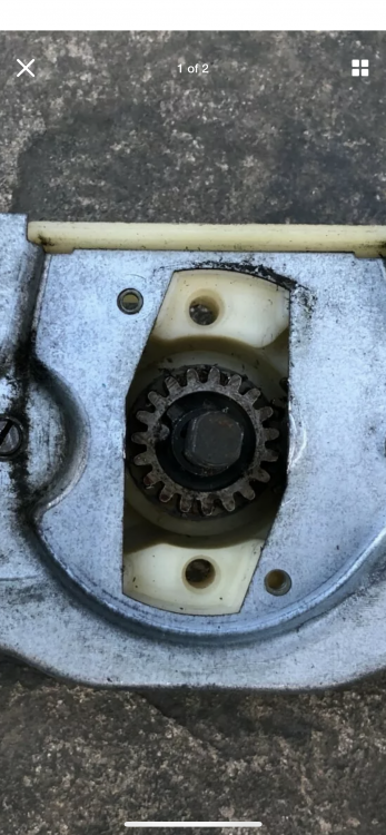

          Some questions about my sunroof:
          The car came with the handle removed and I never really looked into it. So I’m trying to figure out where I’m at with it.
          Here’s what I have:
          I tried putting what pieces I have back together into the crank assembly but all of the gears where very loose. Is there supposed to be a gear on both sides of the crank assembly? And looking at this picture, it looks like there’s a gear I’m missing. Like there’s a smaller gear inside the hollow gear that I have.
          Not knowing much about these: do I just get the crank and install that or do I buy the whole thing with the cables and everything as one large assembly.

              Looks like there is only one gear. Found a better pic of the assembly:
              So I just wonder now if I assume the remaining assembly is okay and just replace this or the whole thing.

                      That is for a power sunroof. So the emergency key isn’t for manual sunroofs. I found that what I’m missing is this little gear here:
                      As you turn the handle, the little tooth on there catches the tooth on the inside of the gear that drives the gear to open and close the sunroof. So I need to source one of those. I am assuming that the handle broke - as appears to be very common - and the PO removed the handle and this stuff fell apart. I’m crossing my fingers the whole mechanism still works once I get the crank back together.
