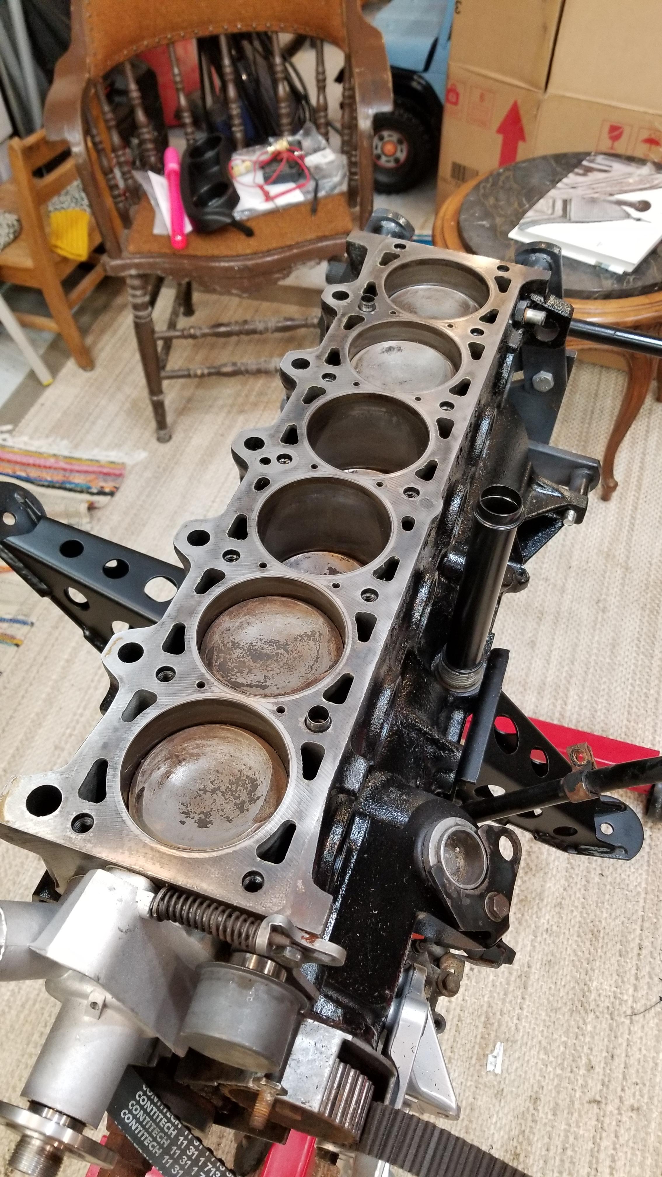

                      More input wanted. I used a victor reinz head gasket and now I'm reading quite a bit of info about them being pretty bad quality. Also a lot of people who said they're fine. Anyone able to weigh in on this?
                        #71
                        They’re fine. i ran one with boost. OEM is best but VR is just fine. At worst you may have a tiny external oil leak on the exhaust side but many M20s do that and its a lucky break if yoir M20 doesnt
                          #72
                          Hmm. If I'm going to put a different one in, now is the time to do it. I read Goetze is the OEM replacement. For $50, it might be worth it.
                            #73
                            They are different. The BMW gasket is something quite different than VR, Goetze, and Elring Klinger in my observations. i had heard similar but comparing them side by side they were different
                              #74
                              Ended up pulling the head back off last night. I'm glad I did. I didn't clean it as well as I thought I did and found some old hg remnants. Took more time cleaning it up. Going to get the Goetze head gasket and will feel better about it.

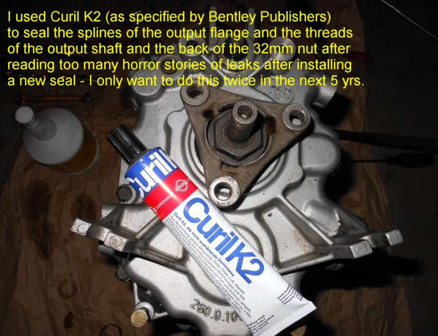

                                Going to be doing the input and output shaft seal on the transmission. I read its advised to use thread sealant on the splines, threads, and backside of the flange of the nut. OEM stuff is the curil k2, does anyone know of a good product that can be had locally?

                                  Ive attempted to use all the right sealants and ended up at the following personal mantra:
                                  Black RTV on all gaskets and seals that touch oil, gray rtv on thermostat housings and warer pump gaskets, ans copper rtv on exhaust manifold gaskets.
                                  black rtv is what I used on my transmission stuff
                                  and please feel free to not take my advice/opinions.
                                  i am generally a dummy

                                    So you're putting gray rtv on each side of the paper gaskets?
                                    And you've used black rtv on the parts associated with the rear output shaft seal with success?
                                      #78
                                      yes. I run a “toothpick” bead or less on surfaces that have a paper gasket. I had to re-do a water pump replacement once because I tried to take the advice of “if both surfaces are clean then all you need is the paper gasket.
                                      rubbish.
                                      On the rear main seal gaskets Ive replaced  I used black rtv.
                                      If you are referring to the transmission rear output shaft seal then thats just a typical shaft seal, no rtv of course. The input shaft has the bolted flange that needs it though. The instruction to use some rtv/sealant on the splines is important. I will try to find an image or cutaway that shows why.

                                        More and more people I've talked to have said they use some sealant on water gaskets, too. I'll be doing that as well, then.
                                        And I noticed the input shaft had some sealant on the flange, so I'll get something for that. And then yes, the splines on the output shaft an the threads.
                                          #80
                                          This is what I was thinking of:
                                          RTV is always going to make things a real PITA to remove and clean up again but then you ask yourself how soon will you actually be revisiting that area, 1 year, 5 years, never?  so for me its worth the added cleanup/hassle if having to dive back into it.
