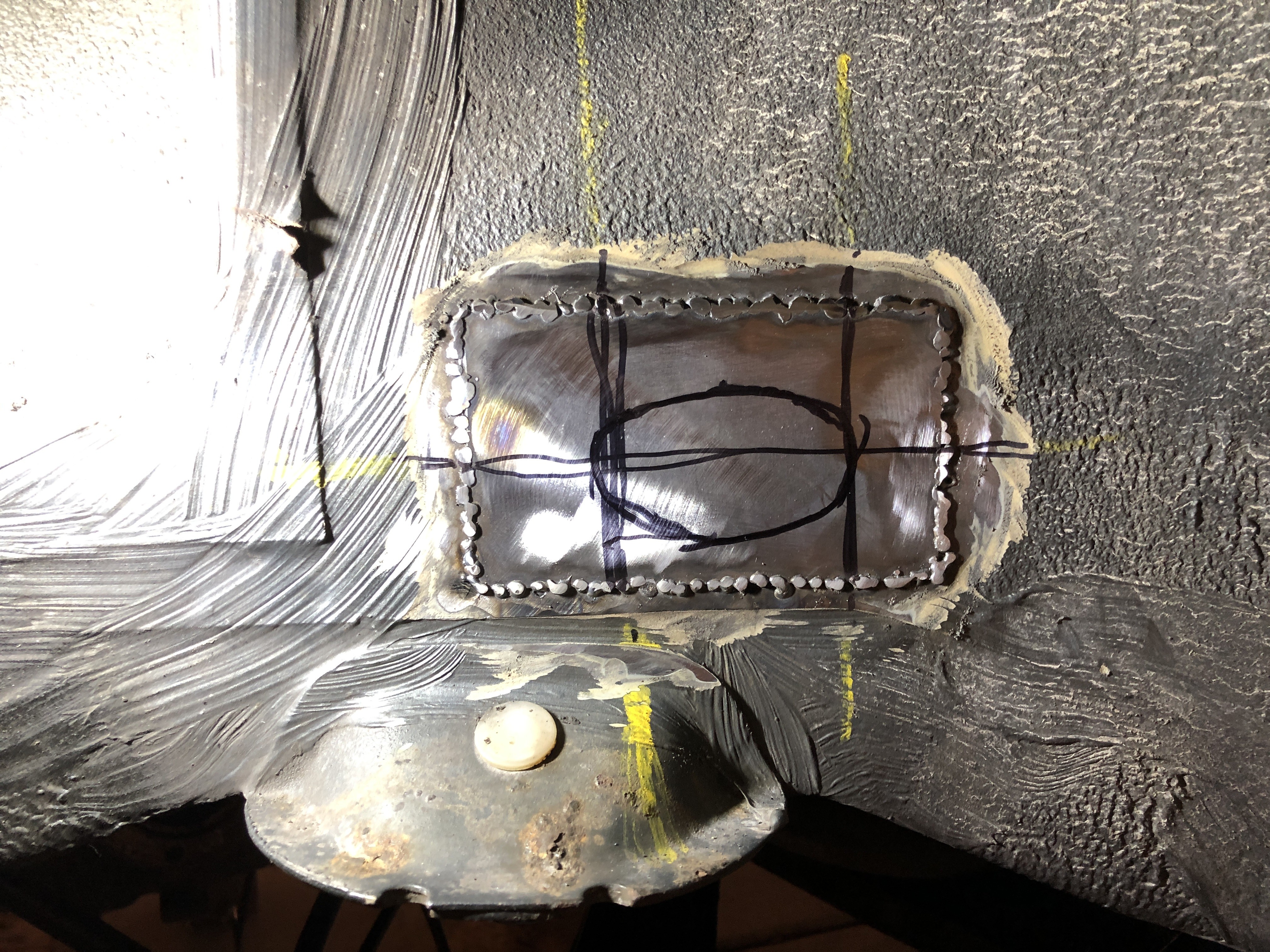

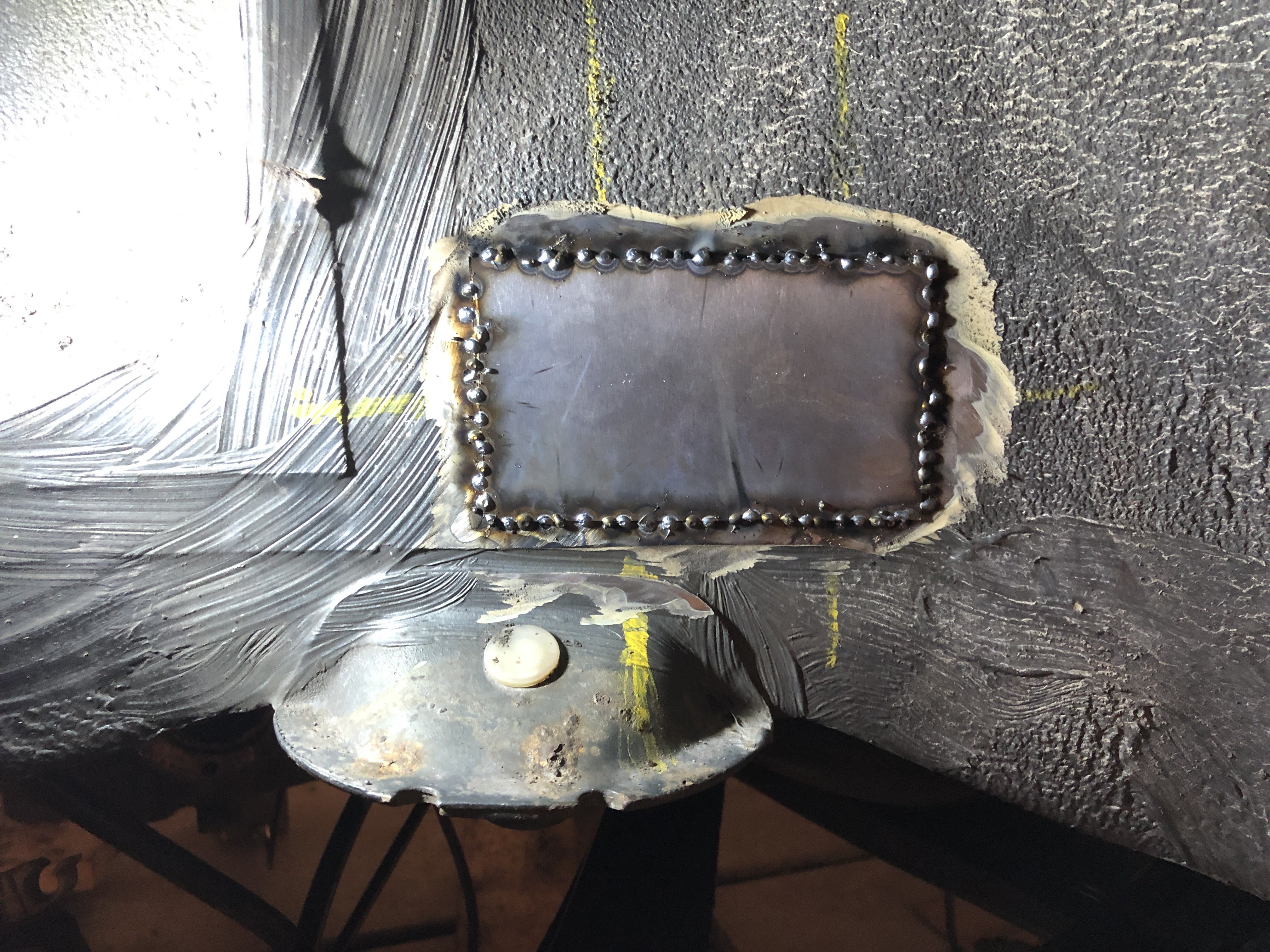

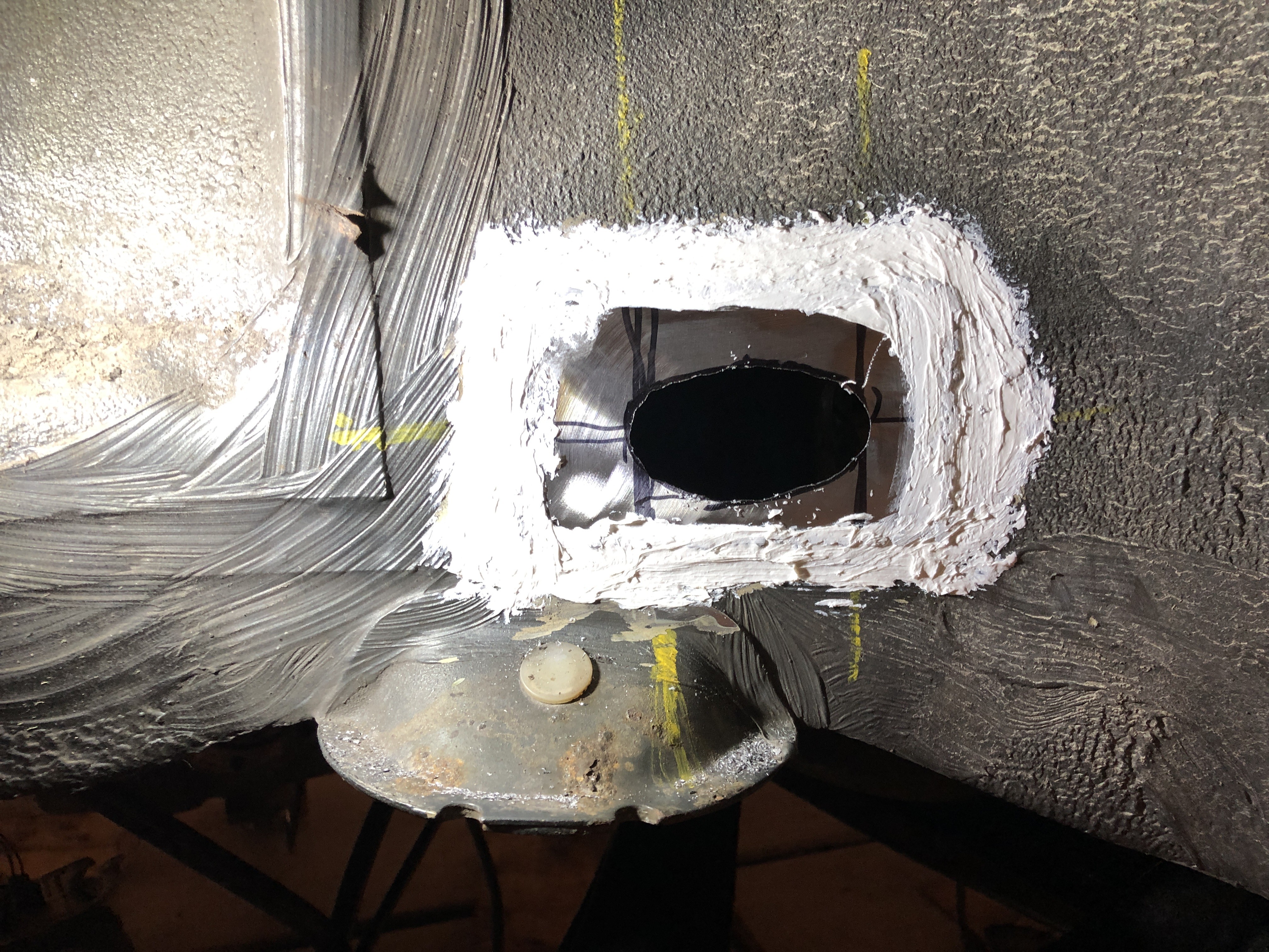

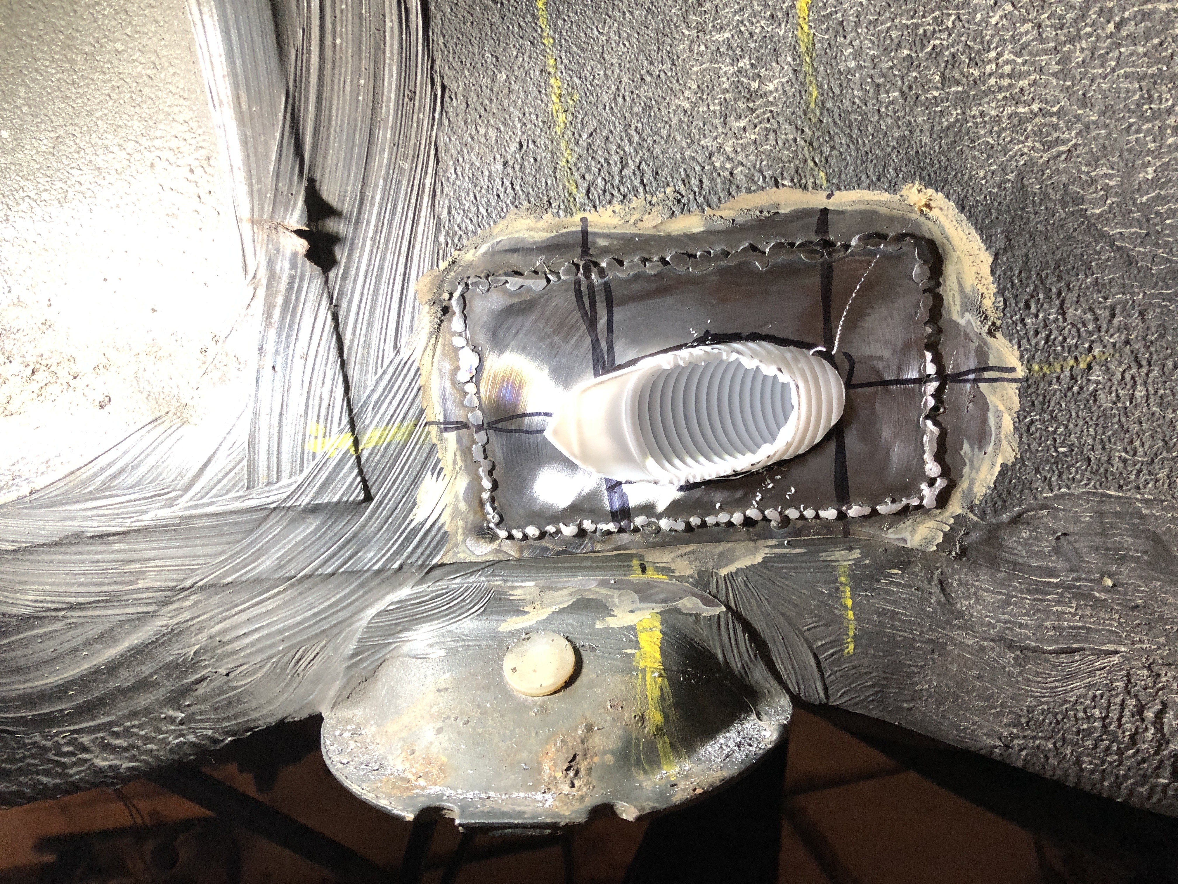

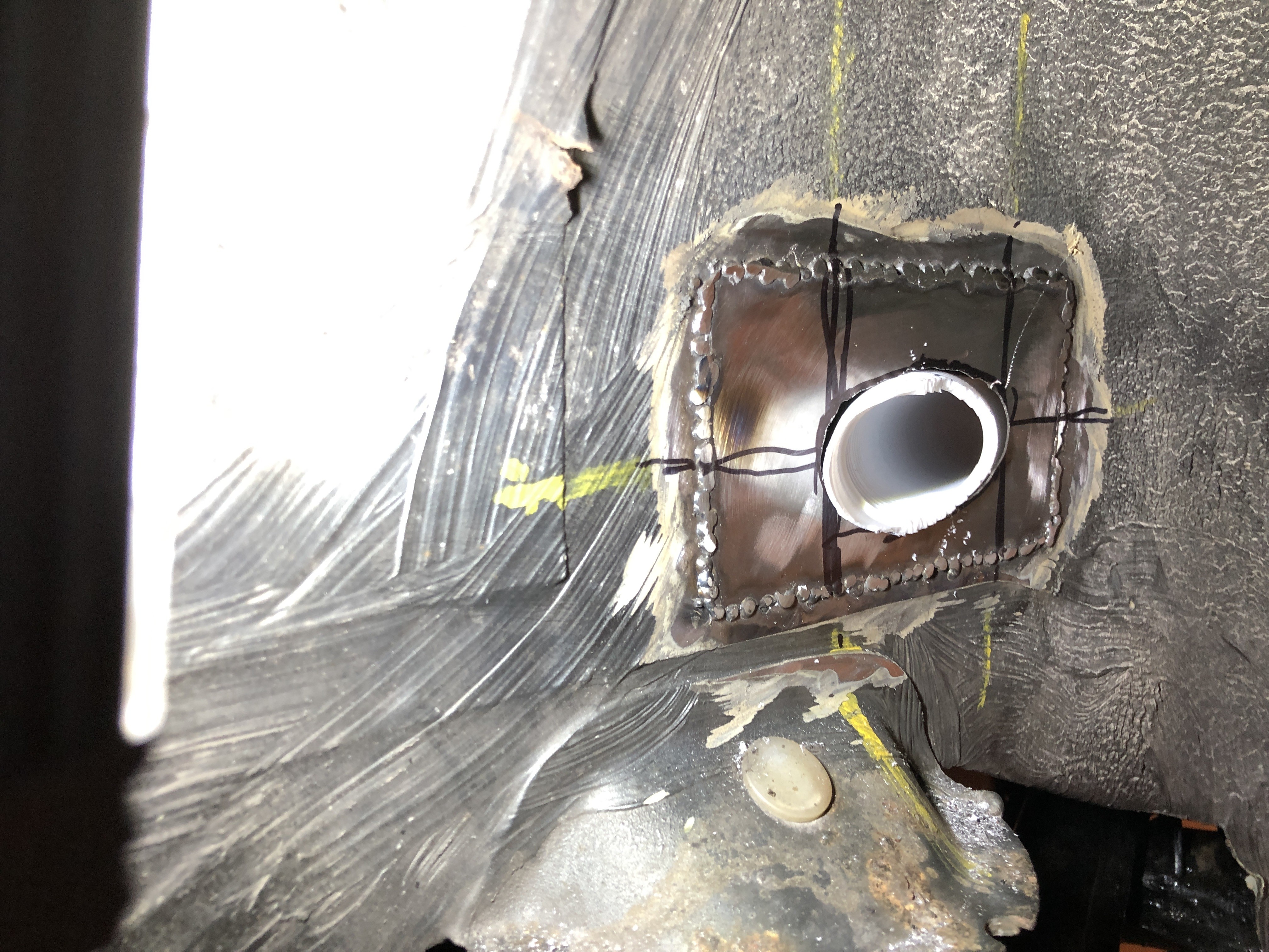

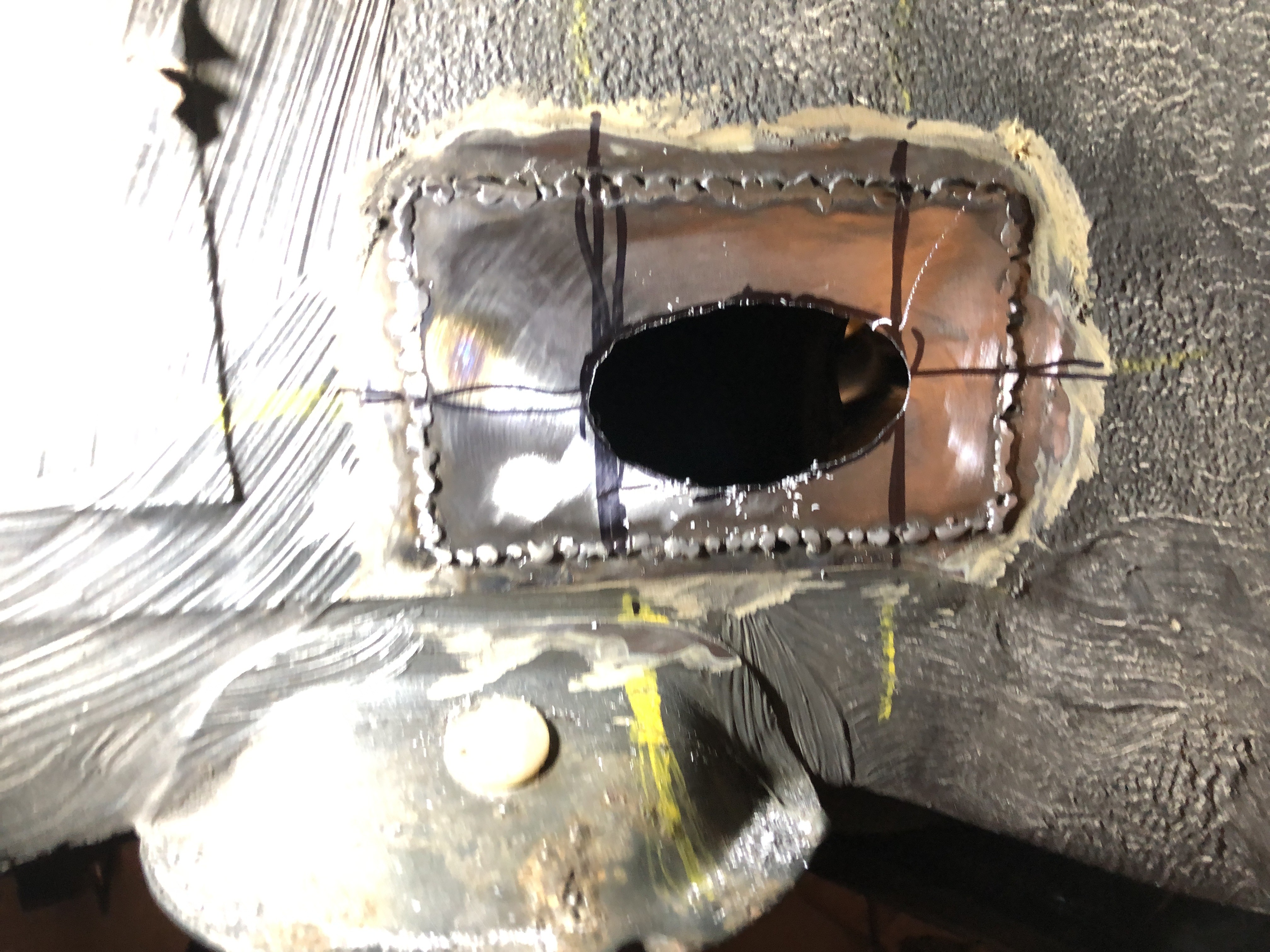

    Worked on the car for a bit after everyone went to bed. Although it’s not much, it now means I can put in the new pass through tubing, the vent tubing, the rear seats, the gas tank, etc. So I am really happy to have this done.
    Patch started.
    Traced the tubing outline and drilled a bunch of pilot holes then went around it with the dremel.
    And fits nicely. Will put in a rivet with a washer on the tip of it to help keep it in place.

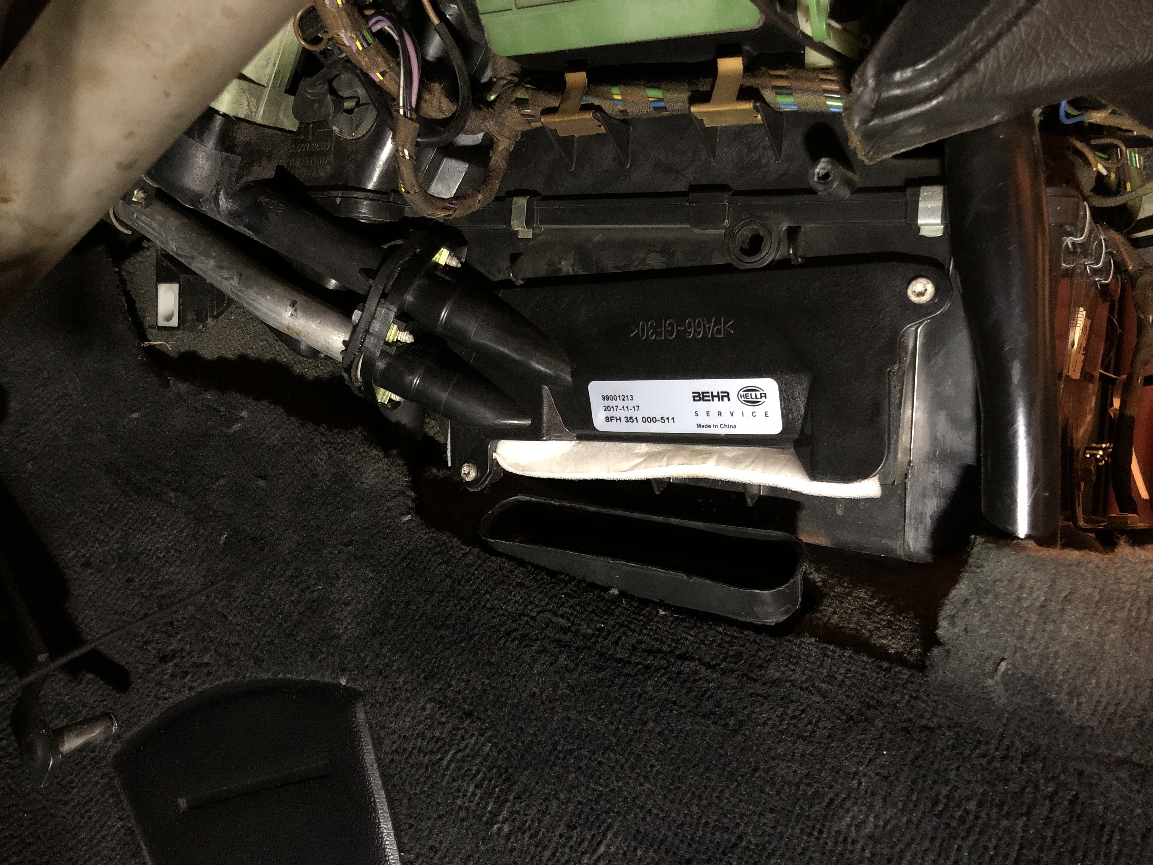

        Heater core is back in with appropriate insulation.

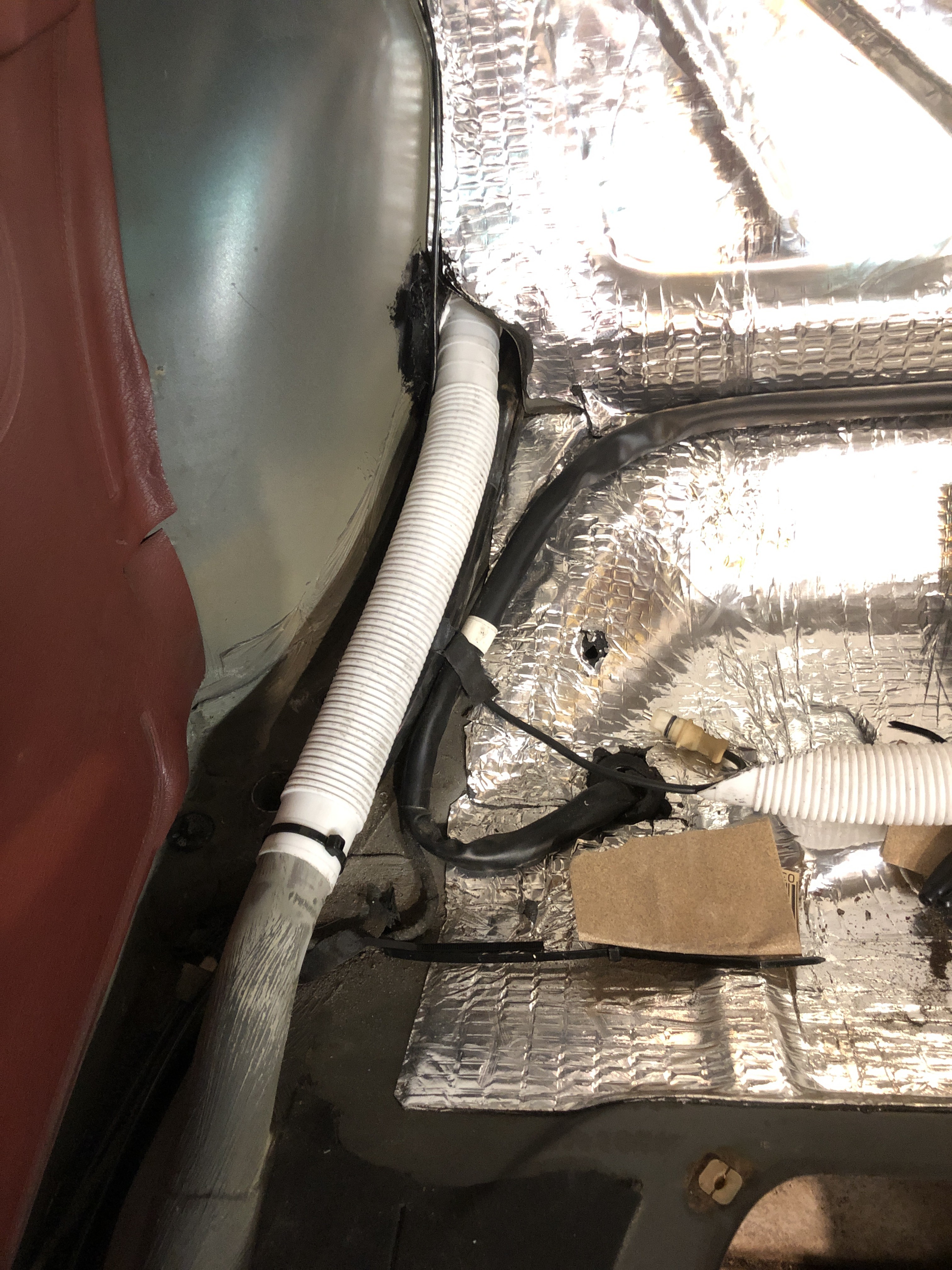

        The fuel vent lines are back in and the hose in. I need to get one of those covers for the lines.

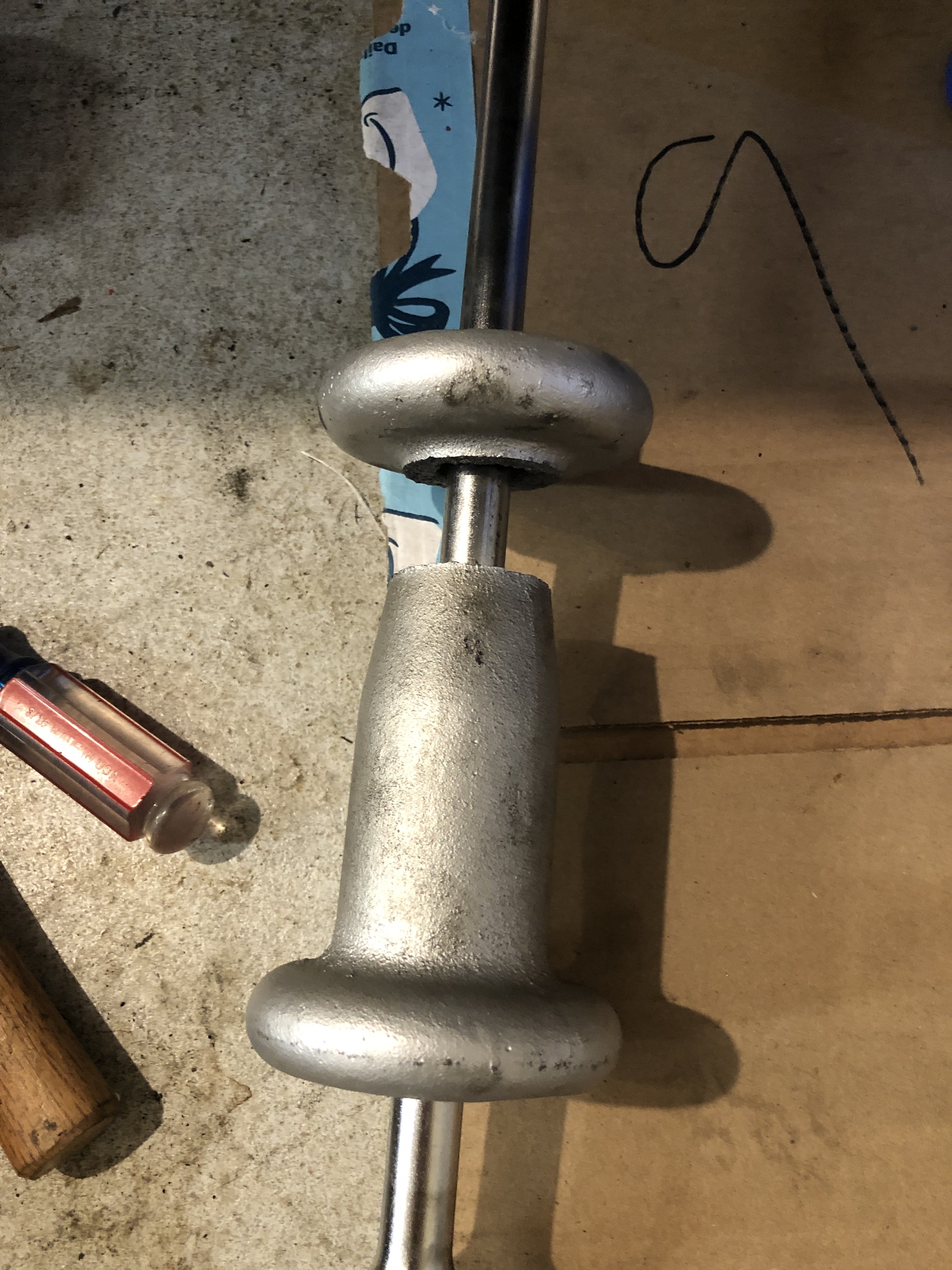

            FINALLY got the rear hub back out. My slide hammer only came with the shallow/wide hub attachment which means I can only get one bolt on it. After many attempts and using a big hammer on the slide hammer to help, my slide hammer broke.
            Rented a slide hammer and the right attachment from Oreilly and after putting the propane torch on the hub for about 10 minutes it popped off with only a few blows. New bearing gets here today.

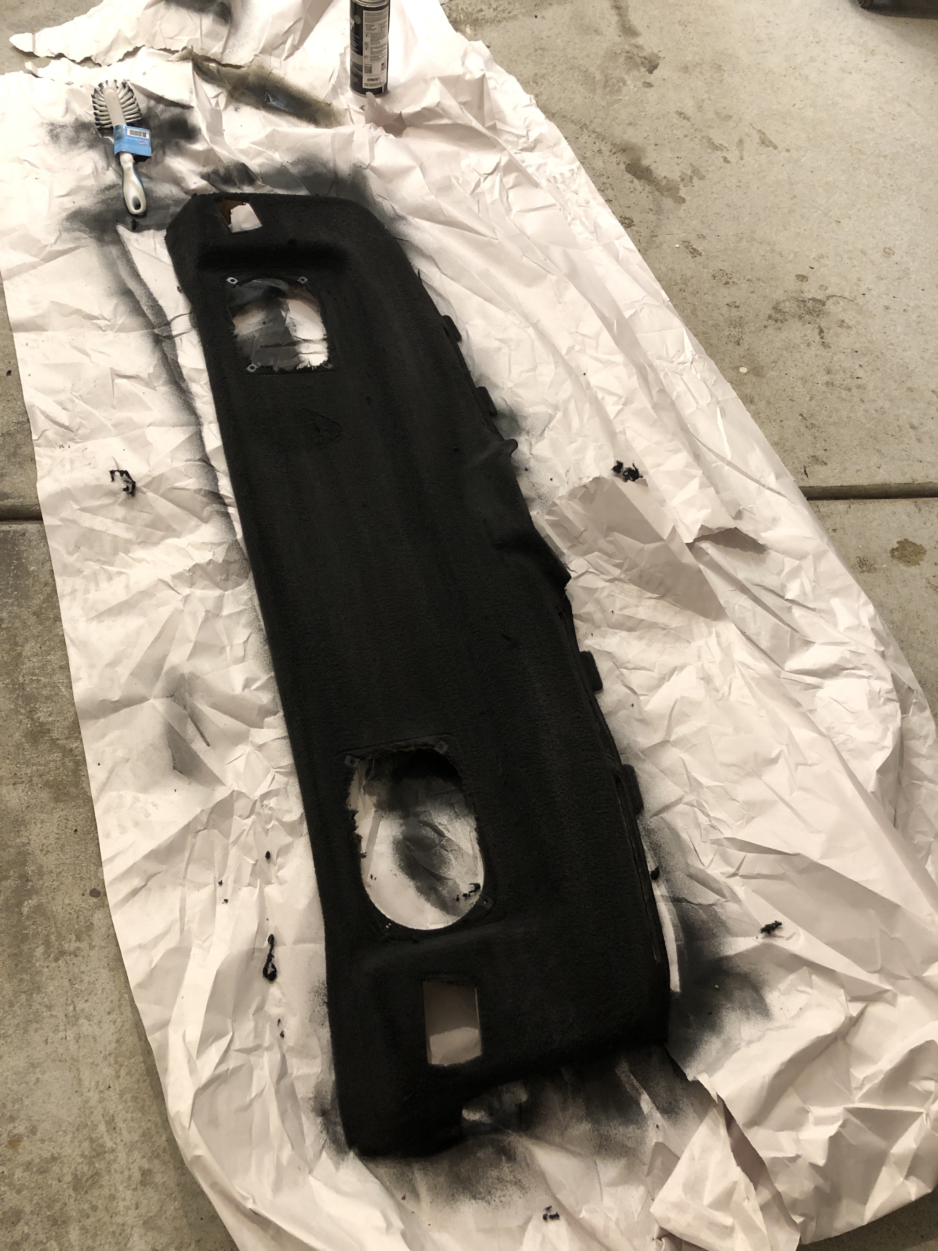

            In the meantime, finished dying the rear shelf and sprayed undercoating on the vent pipe. I’m pleased with how it turned out.

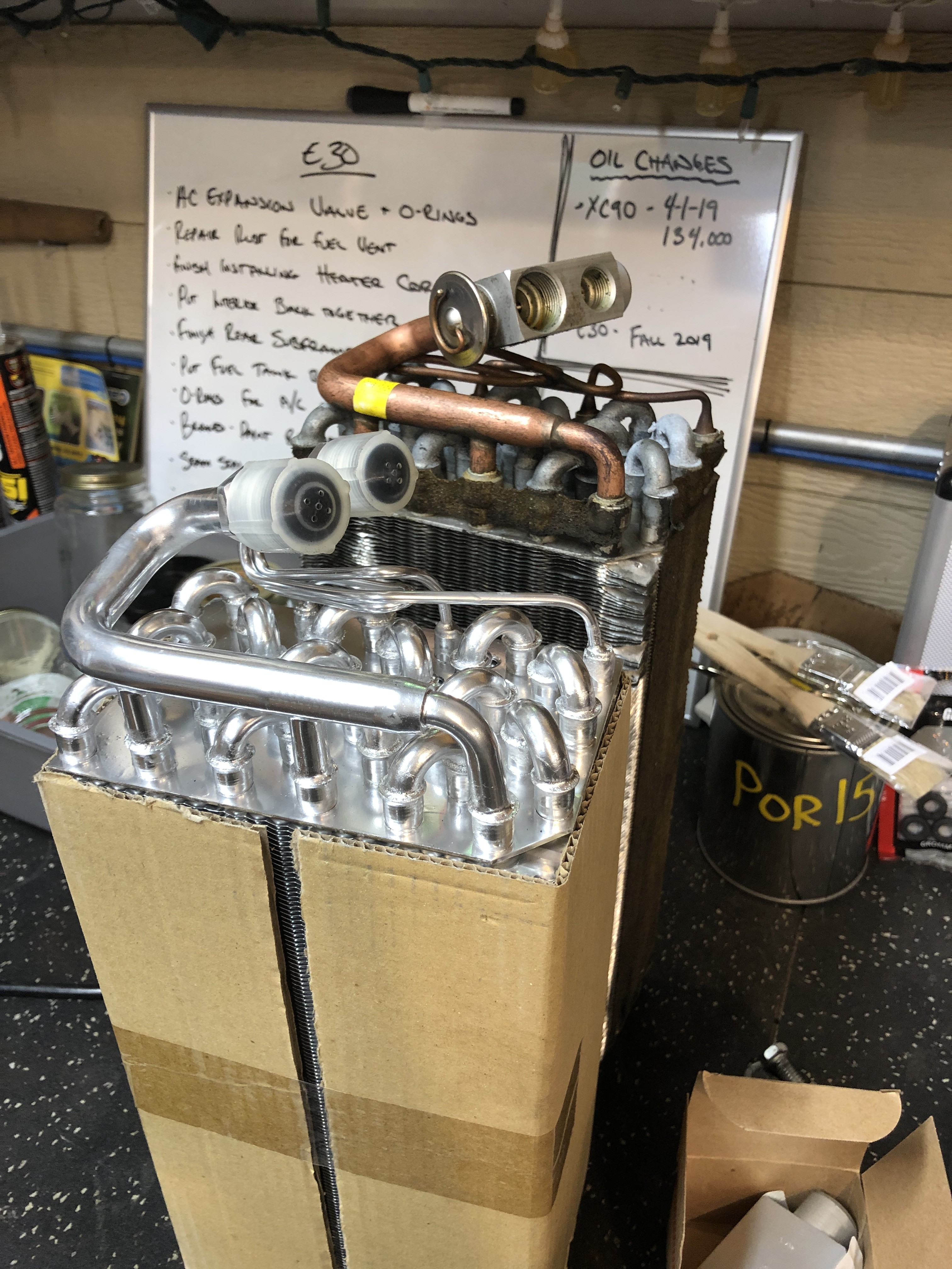

            And new evaporator compared to the old one:

              That evaporator is so shiny you will have to cut some holes in the dash and HVAC box so you can see it while driving!
                #687
                I didnt know you could buy chrome plated evaporators.
                  #688
                  chrome plated? That looks like it was spray painted with nail polish in a 409 bottle by a blind person.
                    #689
                    I was thinking of putting it on a chain and wearing it as a necklace.
                      #690
                      Nice! How about building a plexiglass housing, with led light ropes to show it off? Not as much bling as your neckwear idea but easier on the wardrobe.
                      It does look sweet though. I kind of feel the same way about the Stromung stainless catback on my 318is. It's the cleanest thing on car and you can't really see in its glory unless you crawl underneath the car. Plus side though is you can hear it.

                        The rear shelf turned out really good!

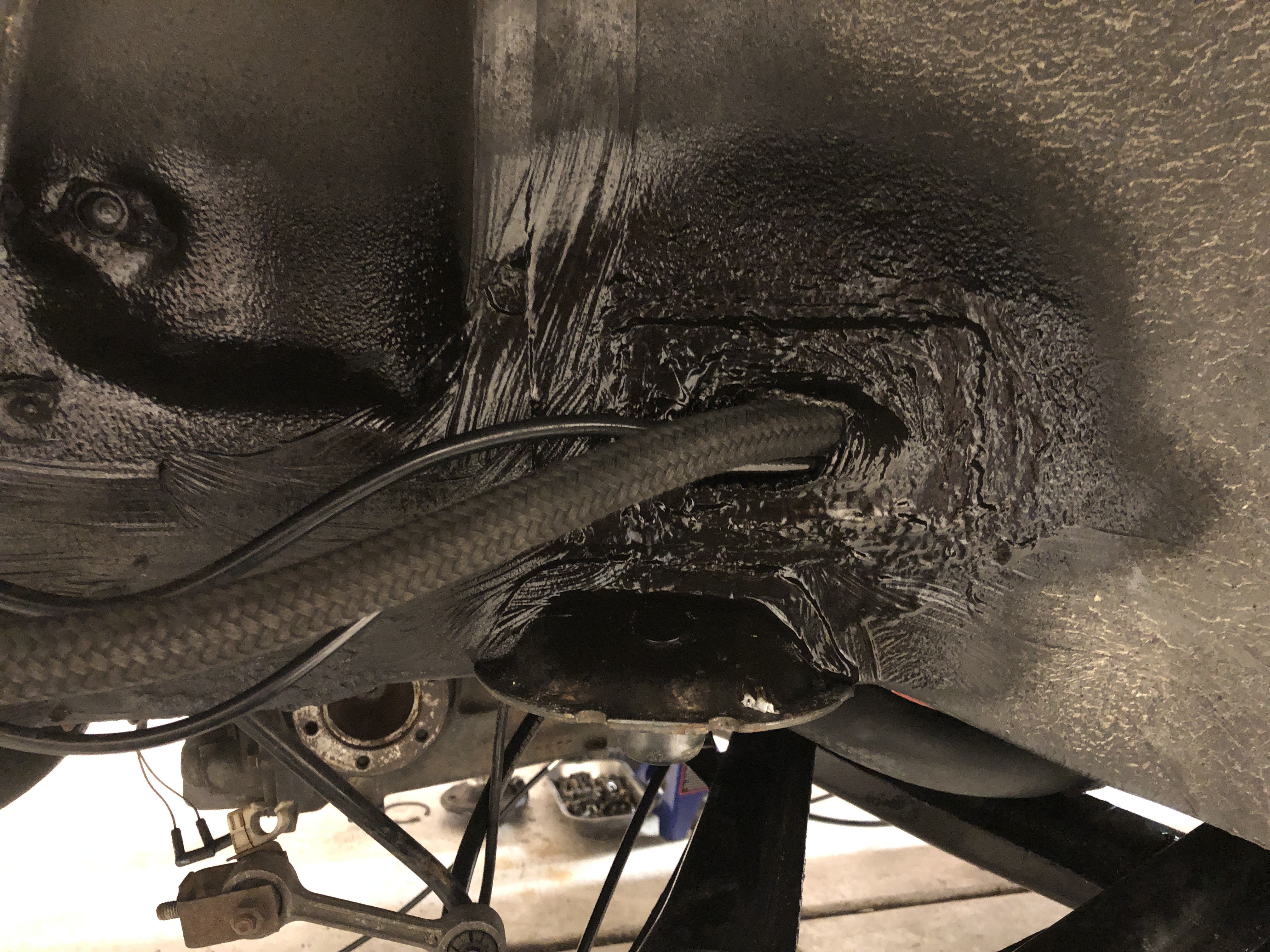

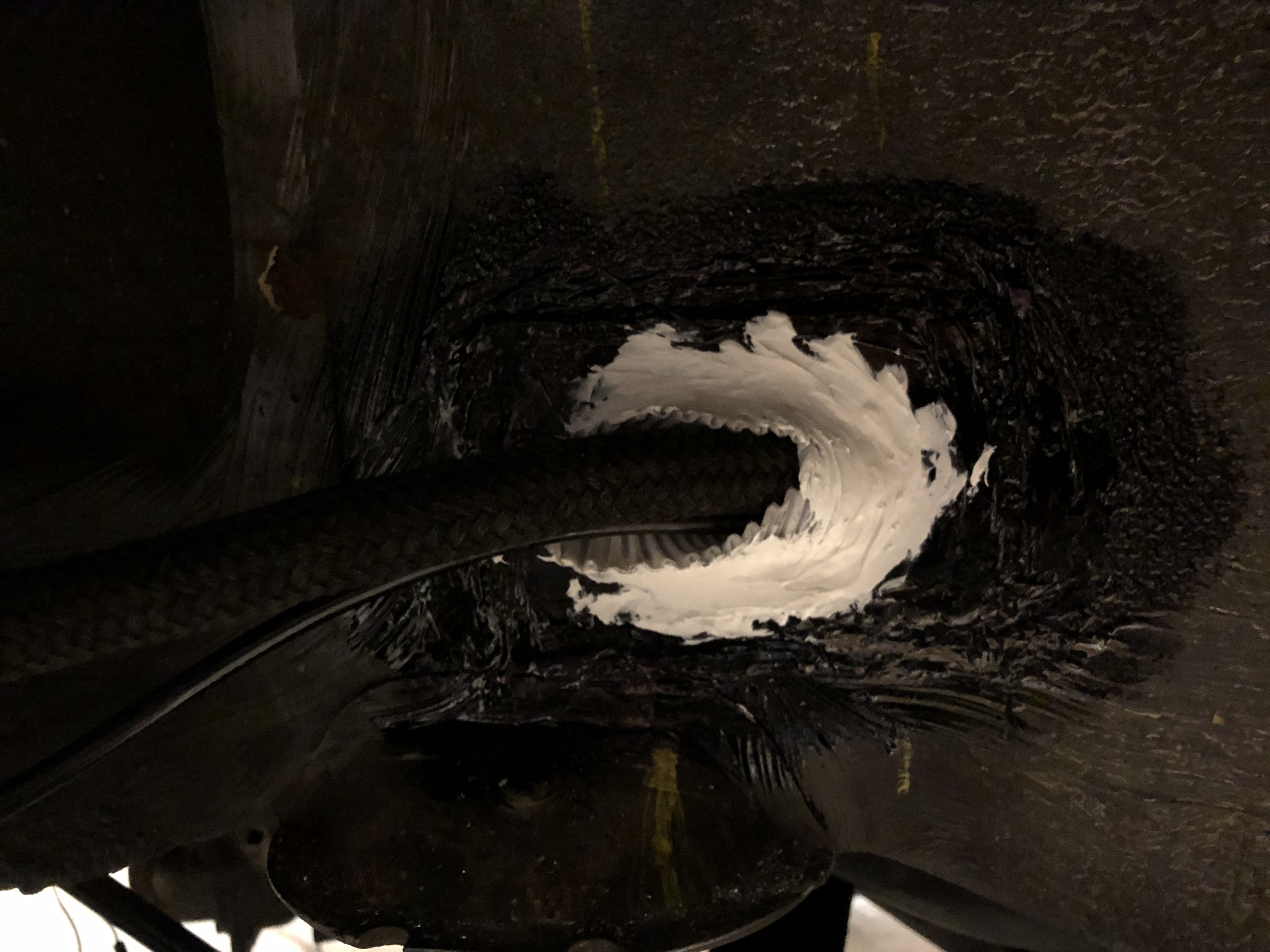

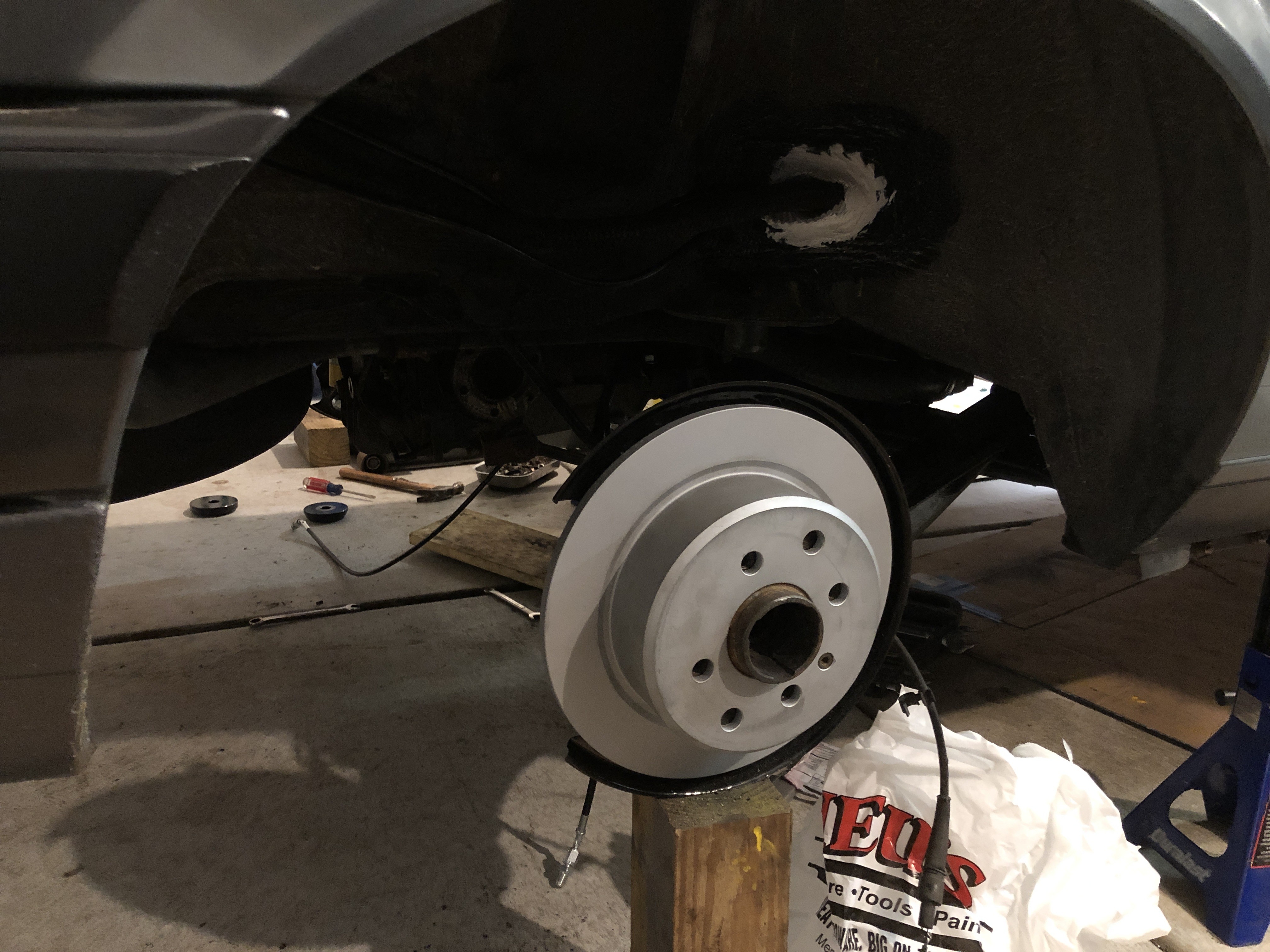

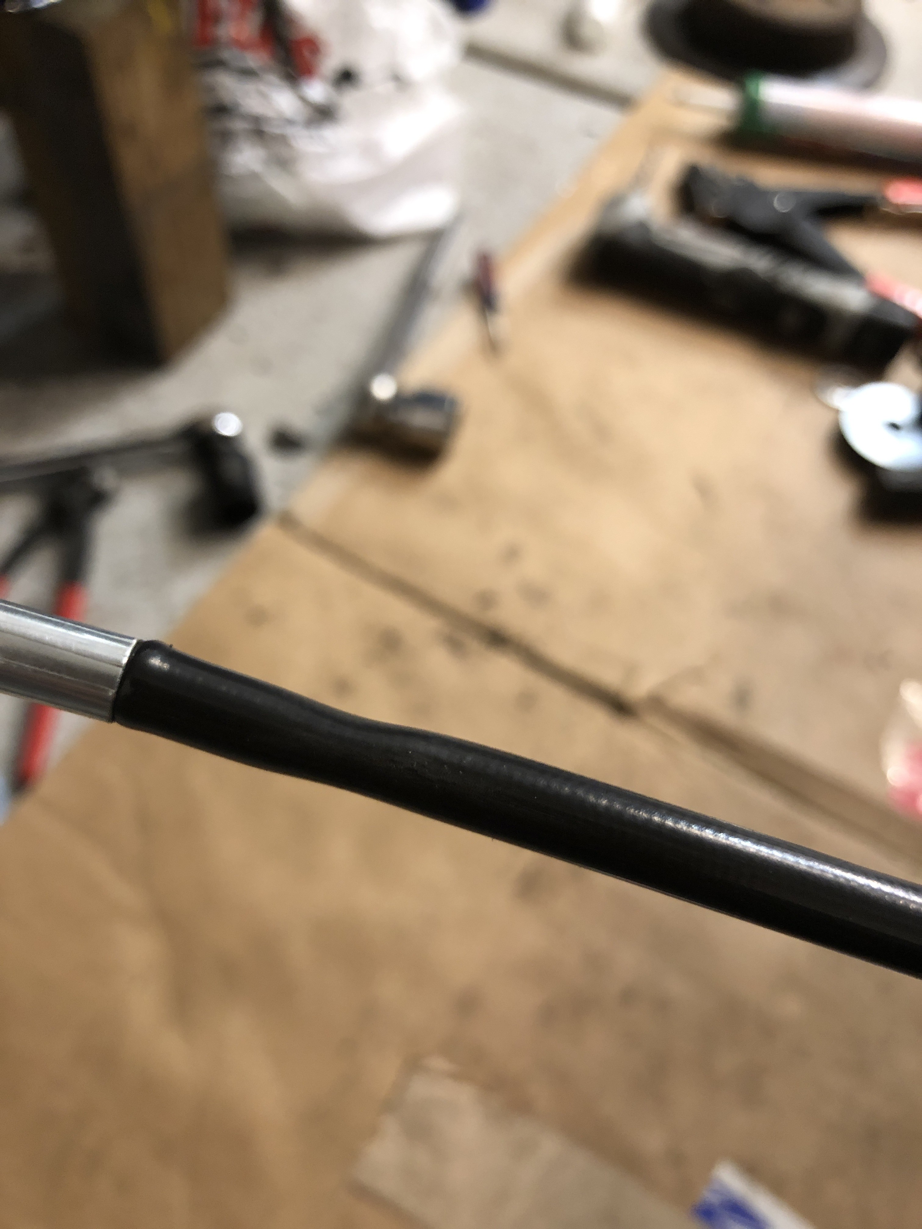

                          Got the new bearing in and the hub in on the DS and all it’s all tight. New rear brakes and pads and the new brake lines mocked up where they should be going. I ordered a replacement hose from Chase Bays and need that before I tighten down the lines to make sure there is enough slack to go this route.
                          I have grommets to go in the hole where the factory brake line went through and that’s where this new line will go also
                            #693
                            is that a one piece brake line from the body to the caliper? (removed the hardline from the trailing arms?)
                              #694
                              Correct. There’s a line from the front to a junction in the rear and then a single line to each caliper.

                                Finally back at it for a little bit after Christmas. The AC evaporator is back in and it’s really cool to see how the interior is going to come back together with the console set in.
