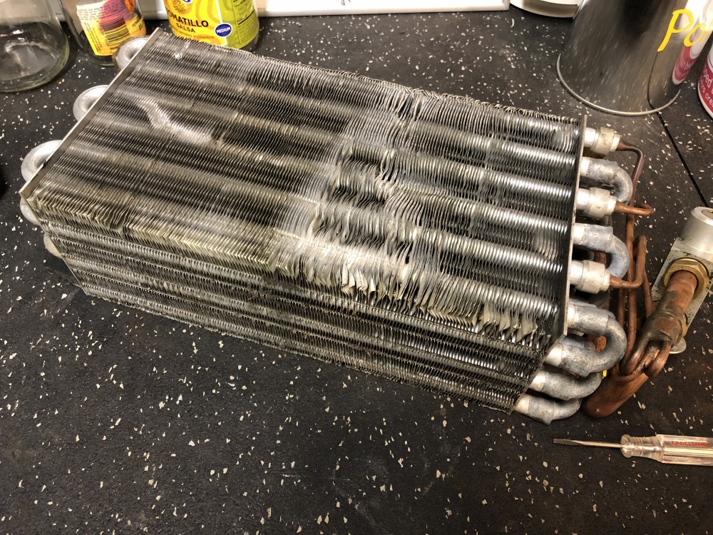

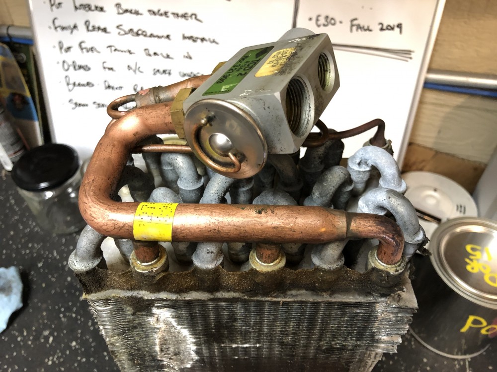

      Does anyone see any issues with the evaporator (other than the fins)? Are these prone to faililng? I am considering just replacing it while its out since now would be the time to do it. On the old Volvo's that I've owned, the evaporators always failed. This one looks much more robust, but still, I would hate to do all this work on the AC system, get it back together and the evaporator has a leak that I can't see.
      I'm also wondering if it being so dirty would impact its effectiveness. There was a ton of debris on it that I had to vacuum off.

                    And new evaporator compared to the old one:

                      That evaporator is so shiny you will have to cut some holes in the dash and HVAC box so you can see it while driving!
                        #687
                        I didnt know you could buy chrome plated evaporators.
                          #688
                          chrome plated? That looks like it was spray painted with nail polish in a 409 bottle by a blind person.
                            #689
                            I was thinking of putting it on a chain and wearing it as a necklace.
                              #690
                              Nice! How about building a plexiglass housing, with led light ropes to show it off? Not as much bling as your neckwear idea but easier on the wardrobe.
