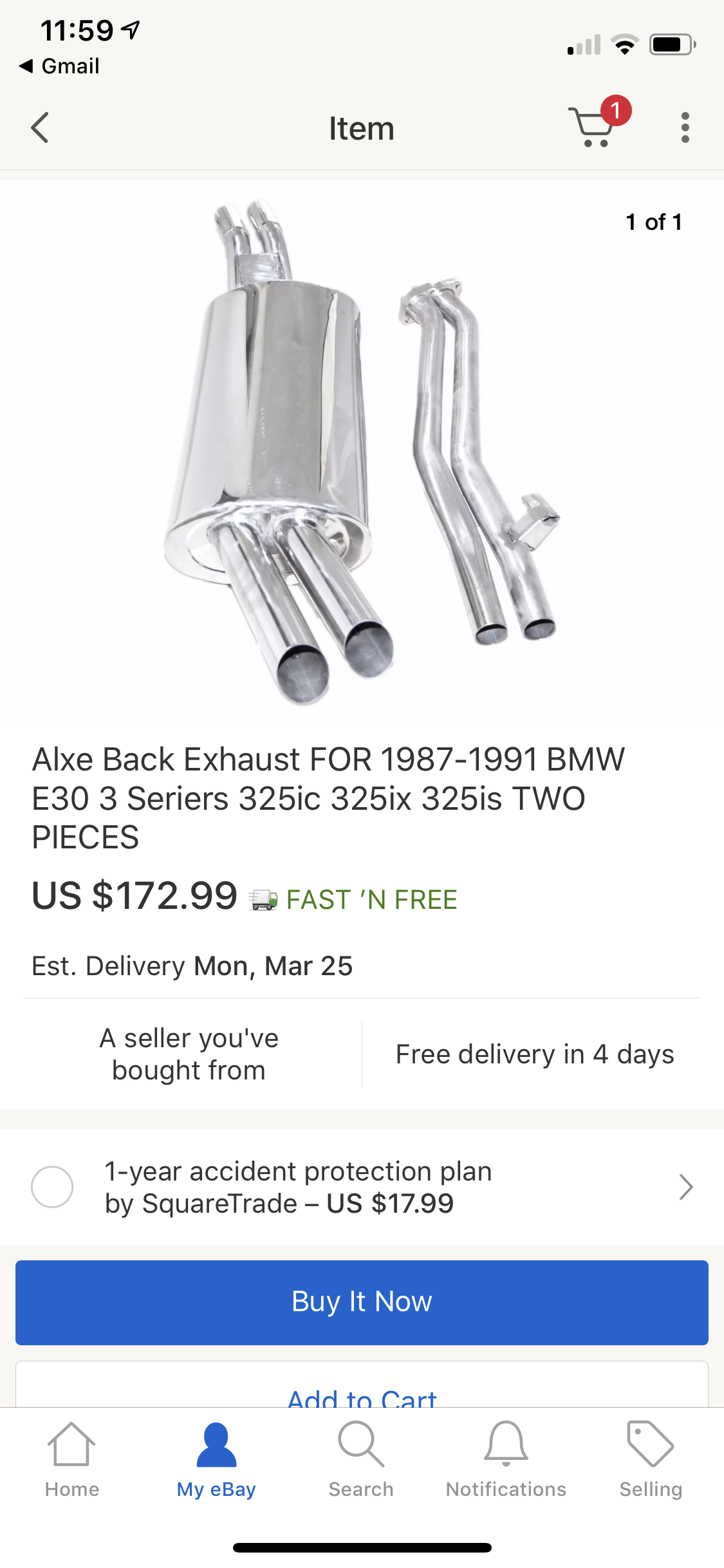

            What eBay “brand” did you go with for the exhaust?
              #326
              This one:
              Fitment was actually pretty good. I haven't clamped the two sections together yet and I'm a little skeptical if the provided clamps are big enough, but we'll see tonight.

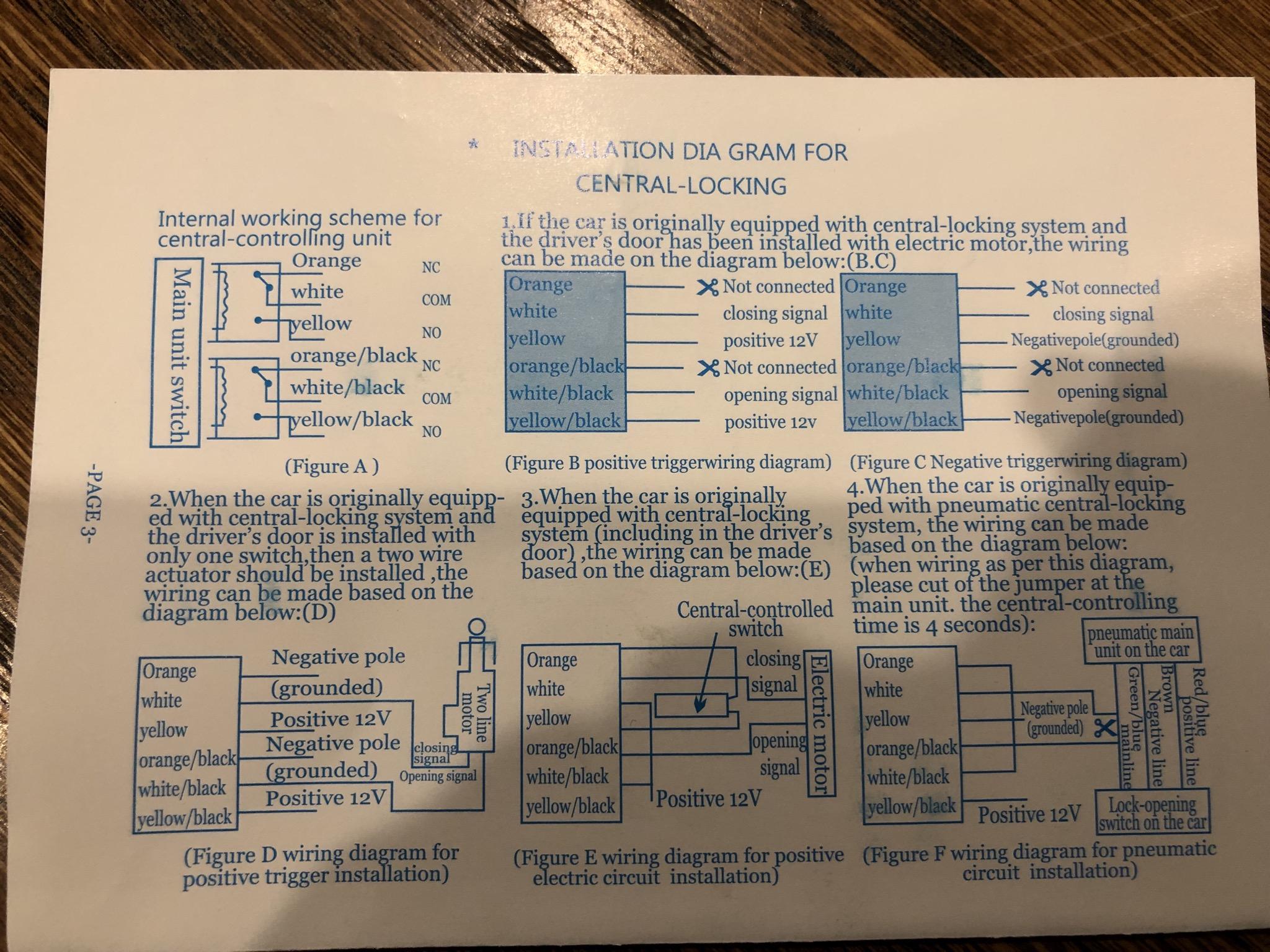

                  Question time: I ordered a keyless entry box and I'm trying to figure out what wiring diagram I should use. I have read the write-ups for the REC-43 keyless entry and that one is very simple with a power, ground, and an opening and closing sign wire that is spliced into the harness in the trunk. I found one on amazon for a bit cheaper with great reviews but it has more options than the REC-43, thus a more complicated wire harness. Here's the wiring options for it. There's different options for how your car is equipped; this is only showing the section of harness related to the lock/unlock signal. There is a separate 12v and ground for the box.
                  I think I'm going to start with splicing the white (closing signal) and white/black (opening signal) into the correct wires in the car harness, unless someone reads this differently than I do.

                    you've read it right.
                    white - closing signal wire
                    white/black - opening signal wire
                    yellow + yellow/black - connect both to ground (e30 is "negative pole" grounded)

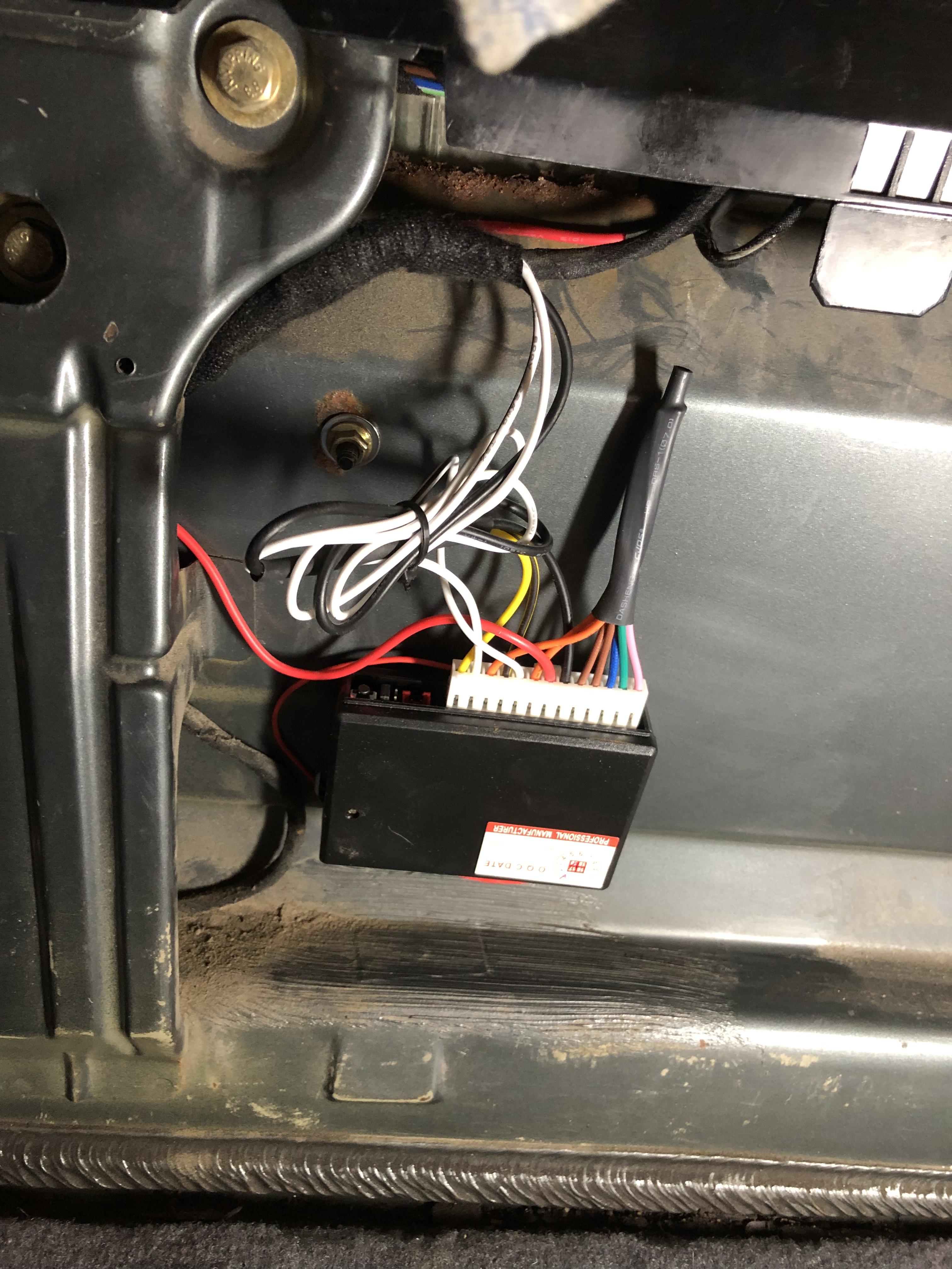

                    i used the signal wires found in the harness right under the truck lock. i ran the unit's constant 12v positive back along the drivers side to the antenna harness and i ran the ground to the battery. sorry, my wiring is messy - i connected the whole unit with quick-connects in case it fails in the future i can just swap it out quickly instead of cutting out splices. . you can actually see my unit has the same colors as yours. red = 12v constant, yellow/black = ground, solid white = closing, white/black = opening

                      Thank you so much! That is a ton of help. I was going to use everything you described, so the confirmation is great.
                        #331
                        I also did the same thing to double confirm on both my E24 and E30.

                          Thanks for your help on the keyless entry. Made install so much easier and it worked! Super gratifying to have something as simple as remote locks.

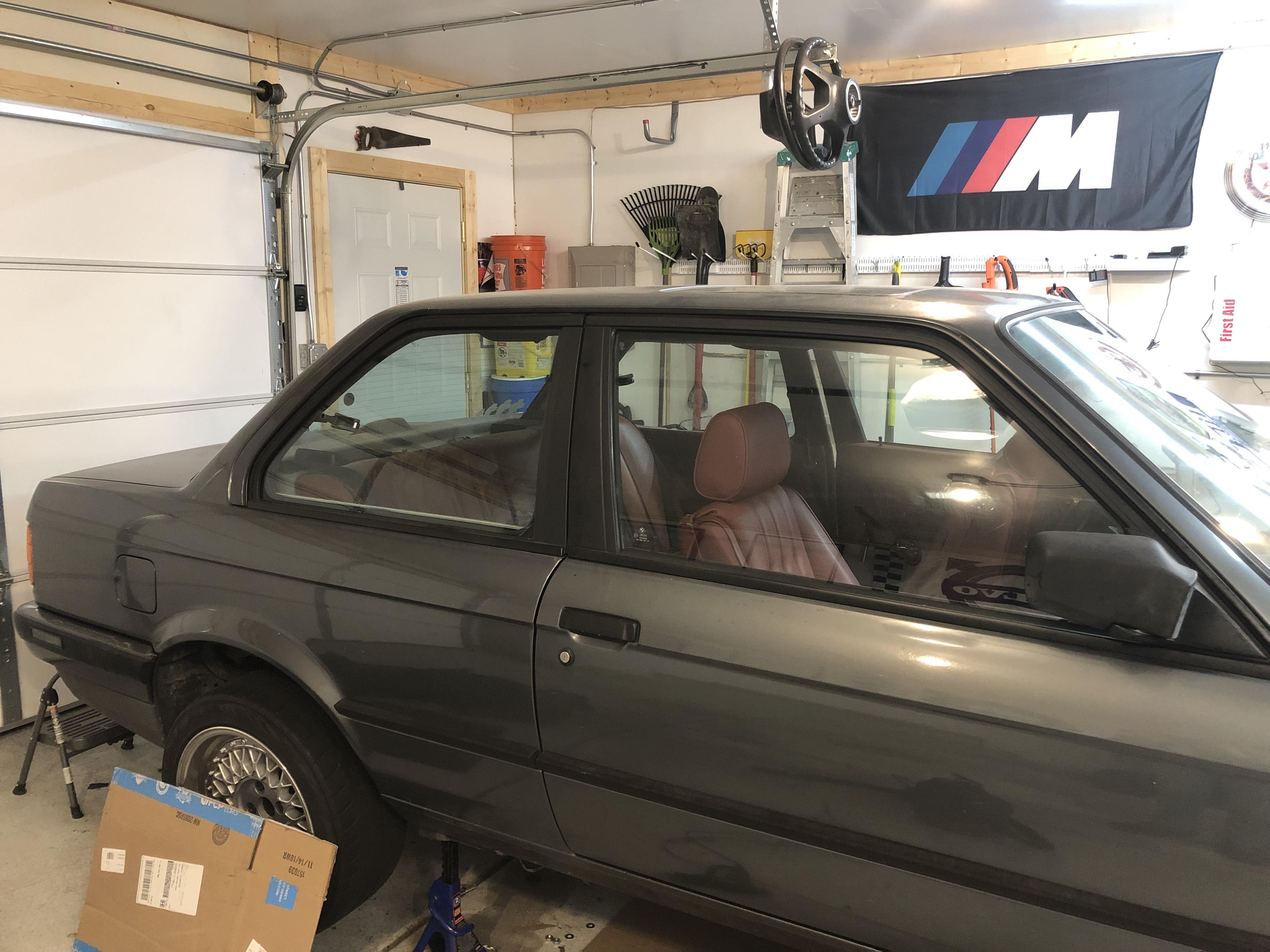

                                  So I had an appt scheduled for April 10 to have the tint removed on the bmw and have the XC70 tinted. I figured why not try removing it myself and see what happens. Used my heat gun to heat up the area I was working and a razor to get a corner started. After about 45 mins I had it all off. Must have been cheap tint. Still some adhesive I'll have to get off, but I absolutely love it without tint. Fits the car so much better.
