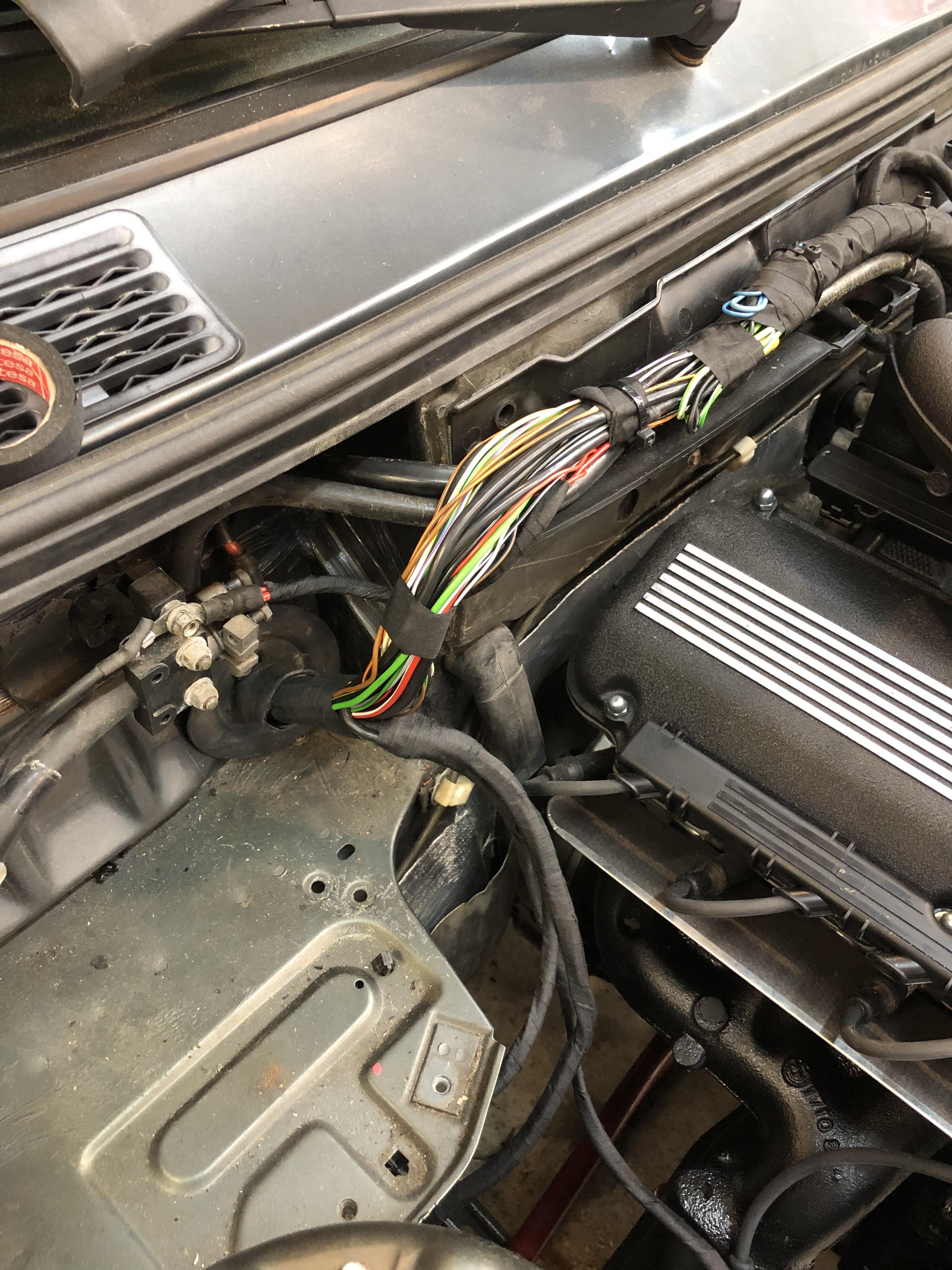

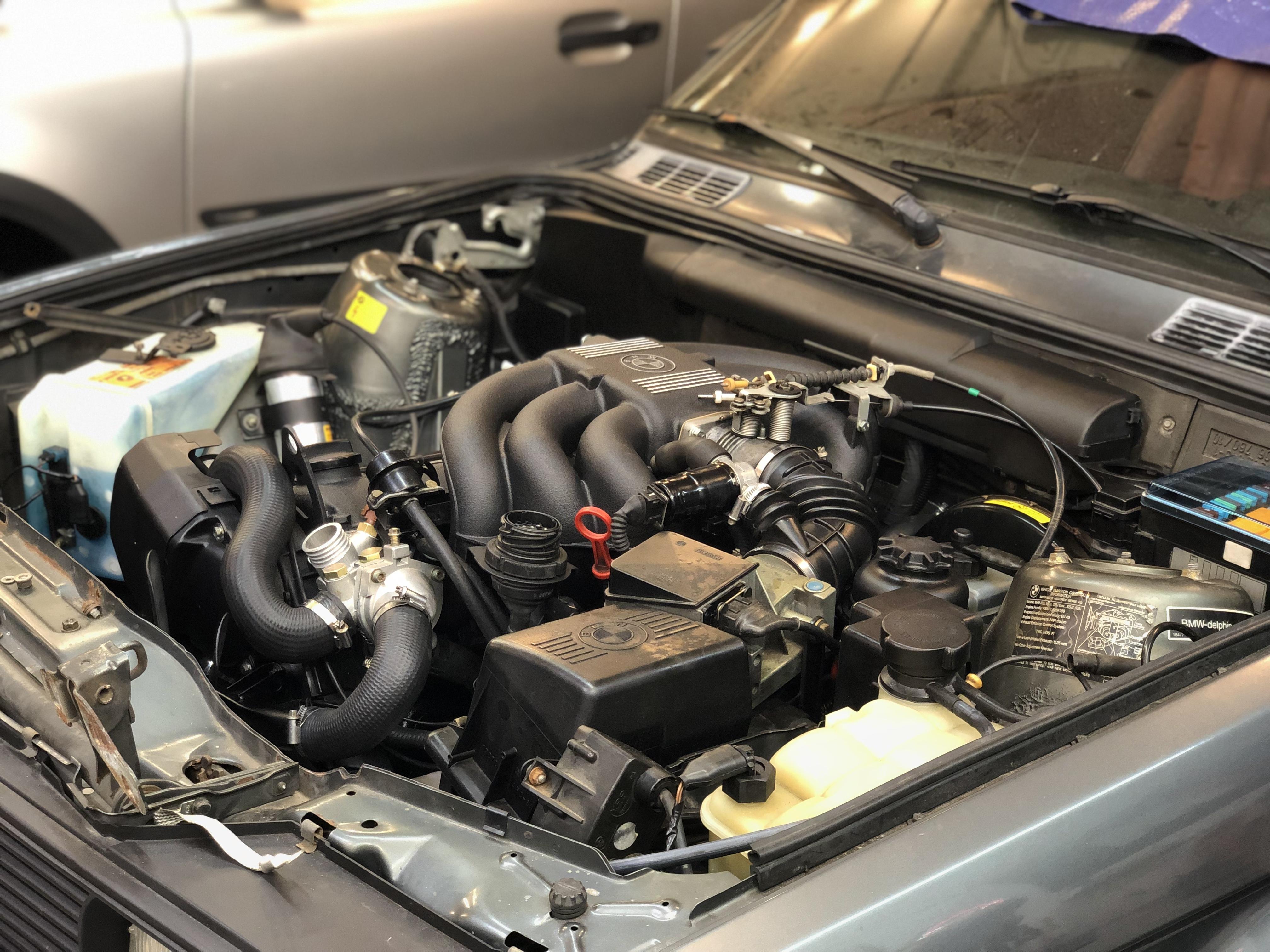

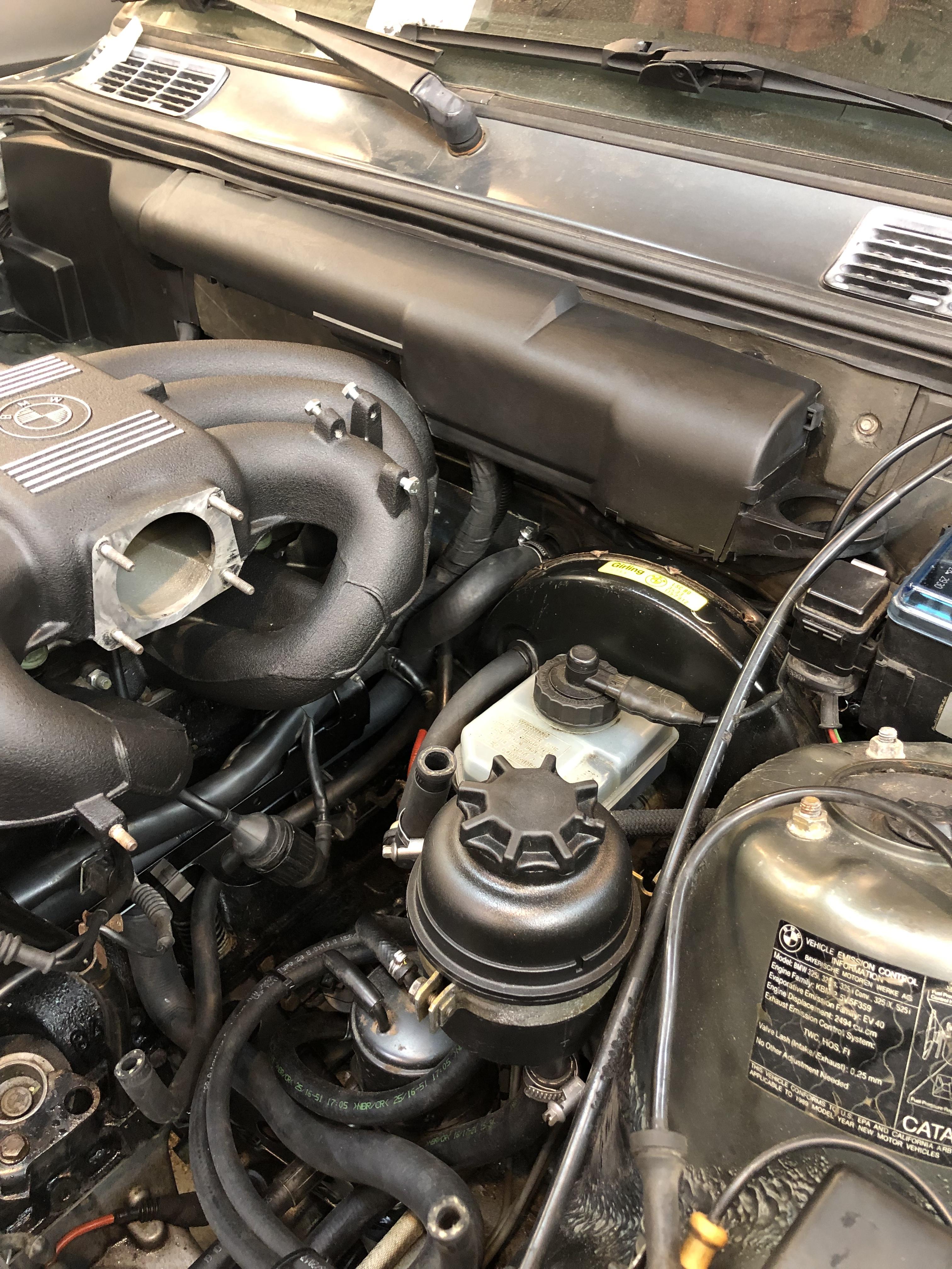

    This was way more difficult than it needed to be.
      #302

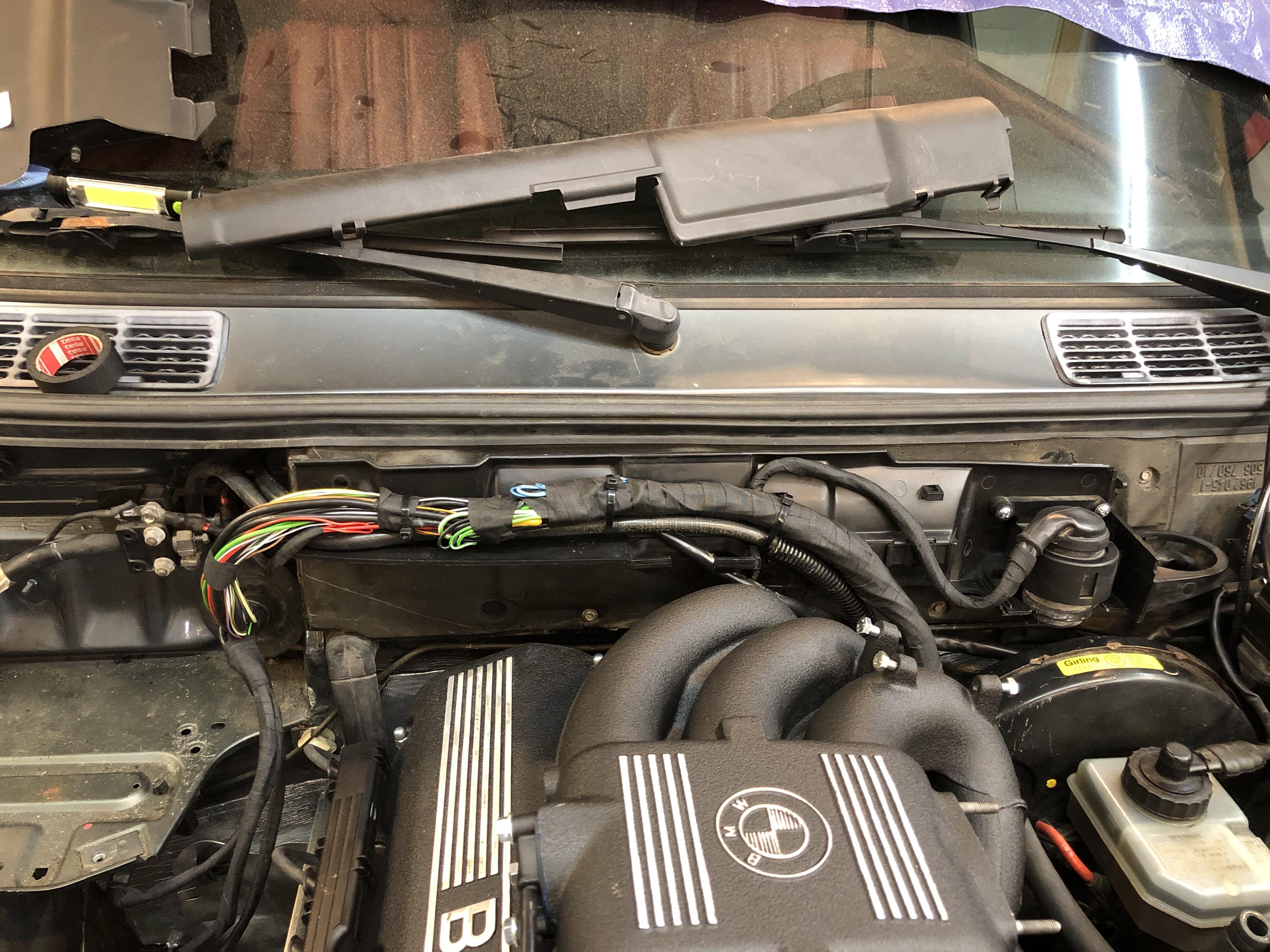

      It looks nice with the wiring all tucked up in there!

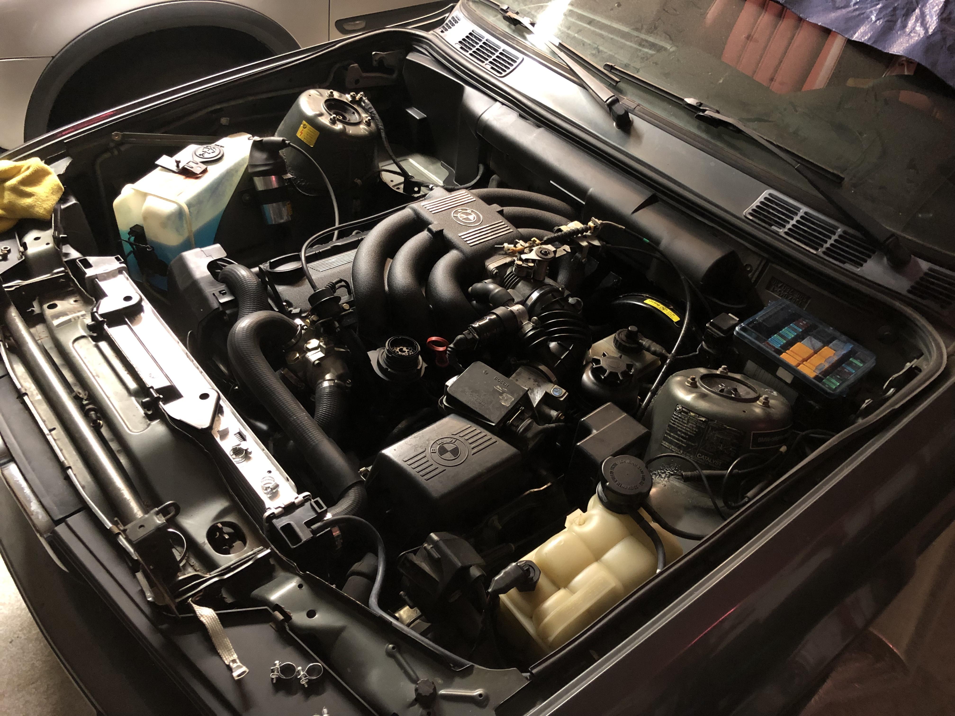

        But the results are WELL WORTH IT!
          #304

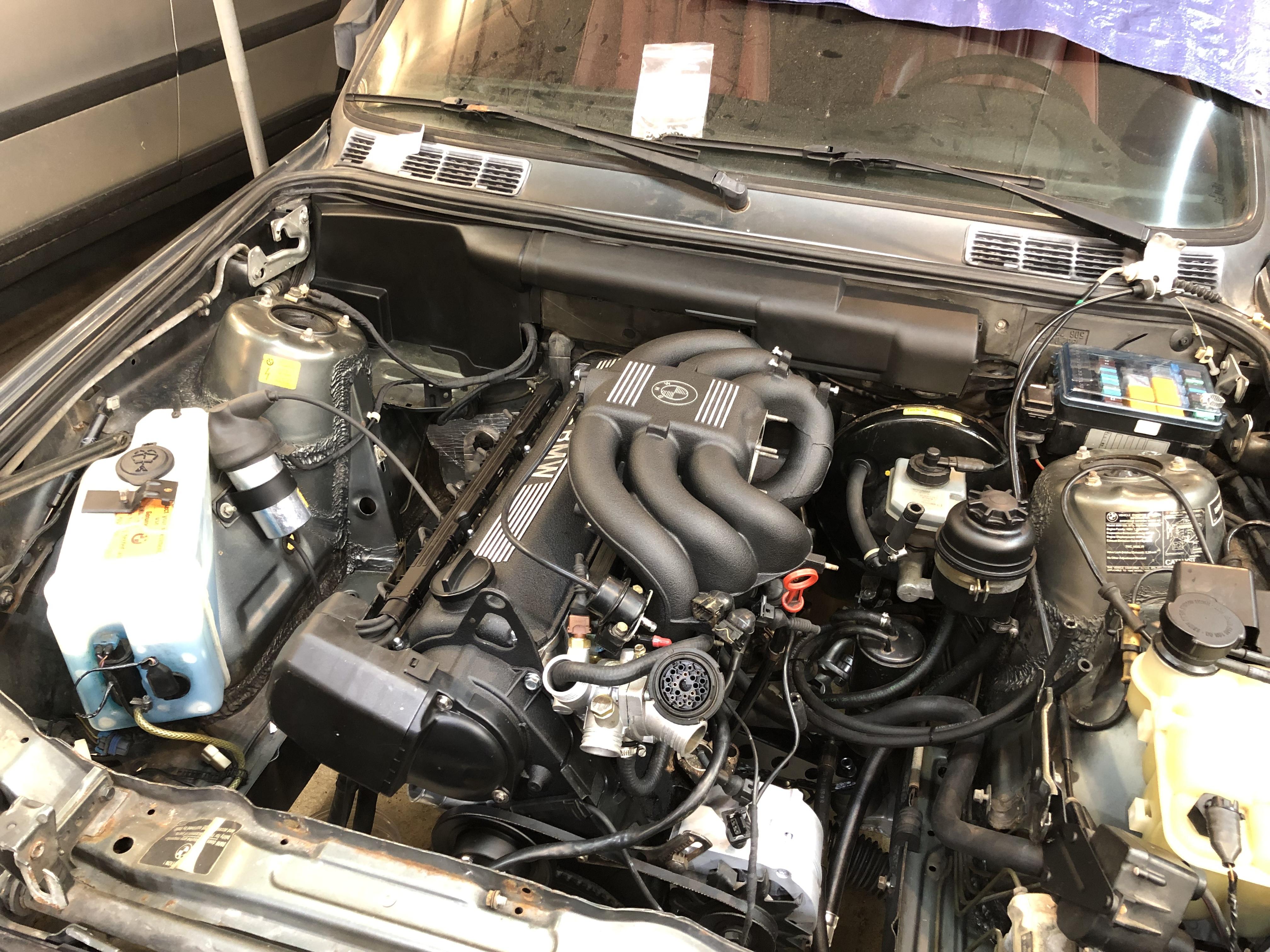

          Yes, in the end it was worth it. Also got new headlight covers to help clean up the front of the engine.

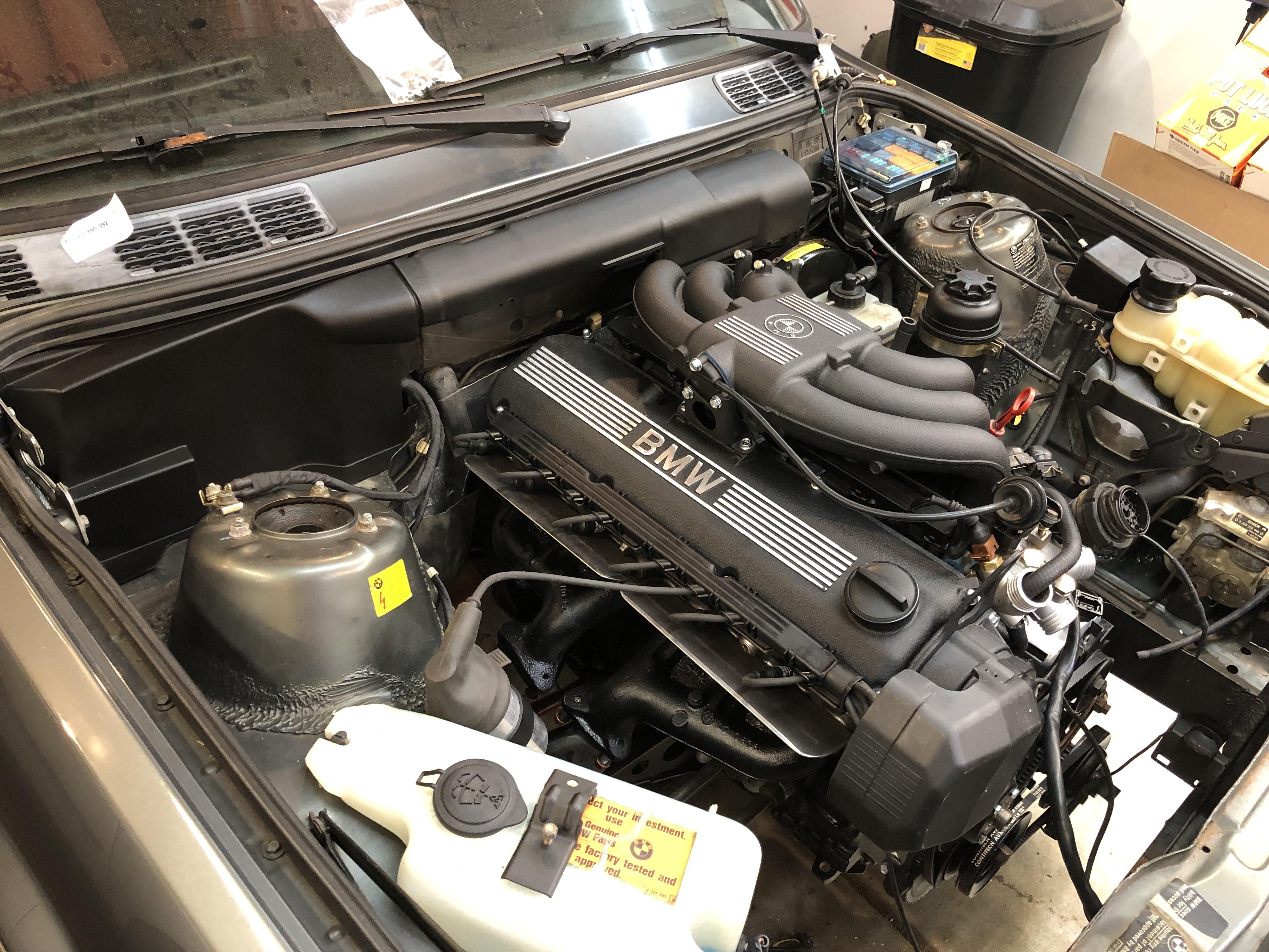

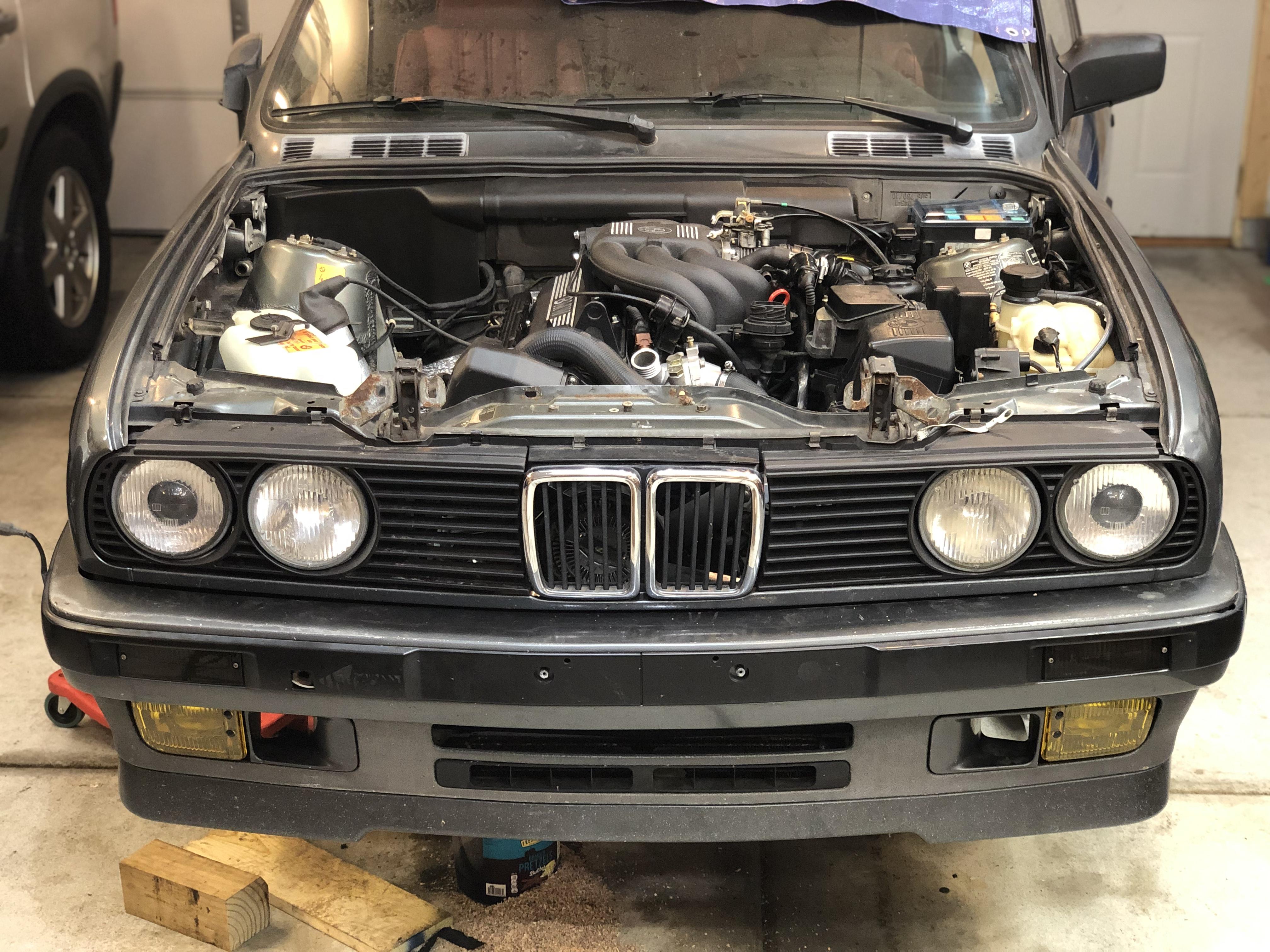

            #305

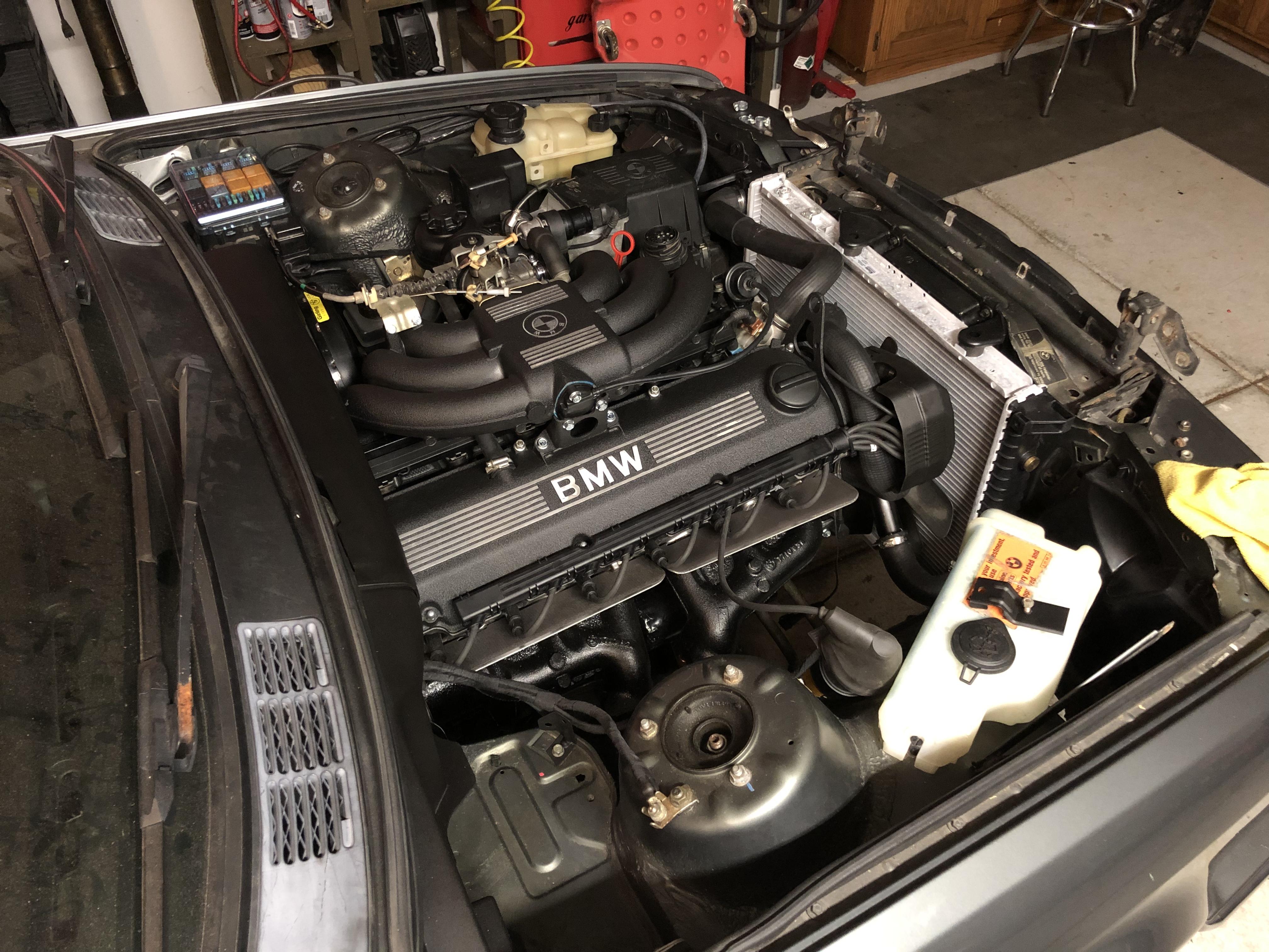

            Getting the engine almost all put togrther. Accidentally tossed out the radiator rubber mounts with the old radiator so waiting for new ones of those to finish that up.

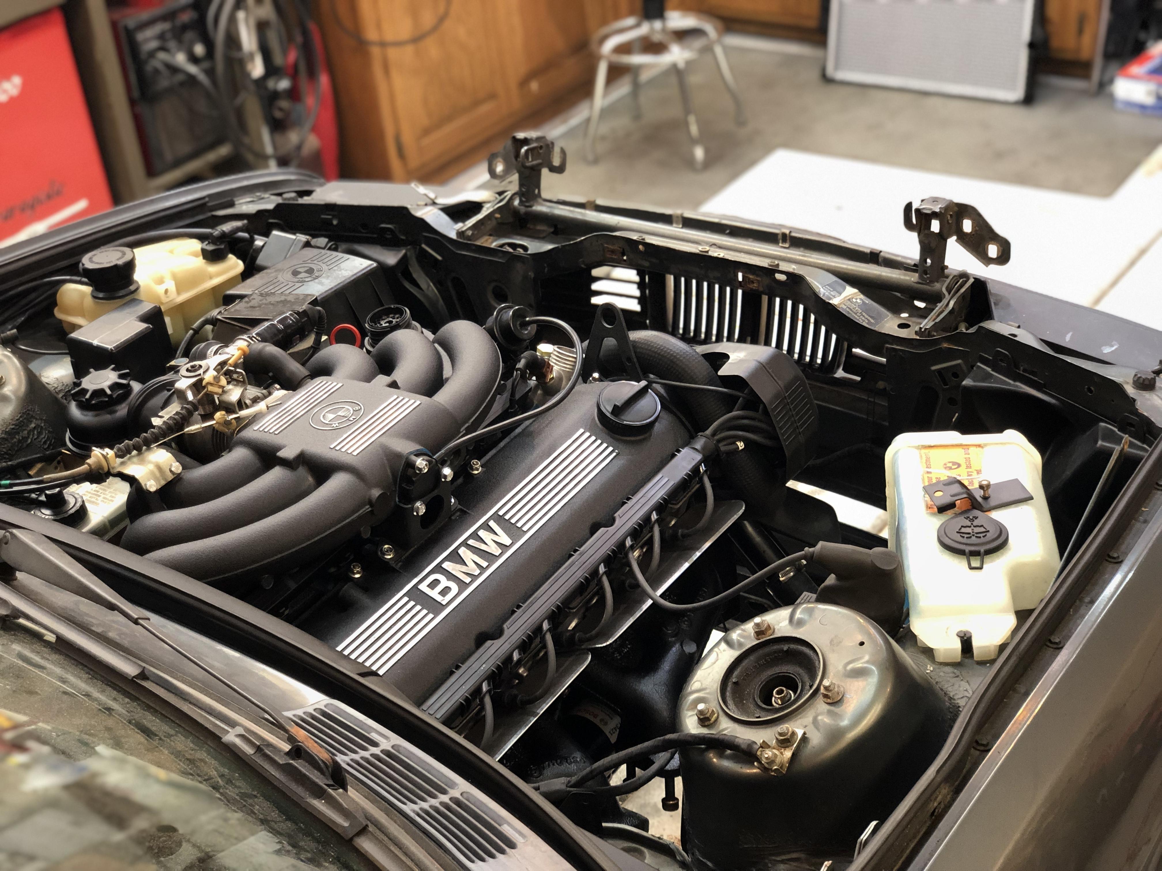

              The old dirty delphin is looking good!  Can't wait to own it again after you get bored.
                #307
                Lol. Well, lots of credit to you for so much of the powder coating in there.

                    #309
                    Other than the exhaust a few small things in the engine, the big stuff is all done. Last few to do's are remote door lock thing install, new head unit that blends in better than the cheap one I got last year, would like to attempt to peel the tint off.

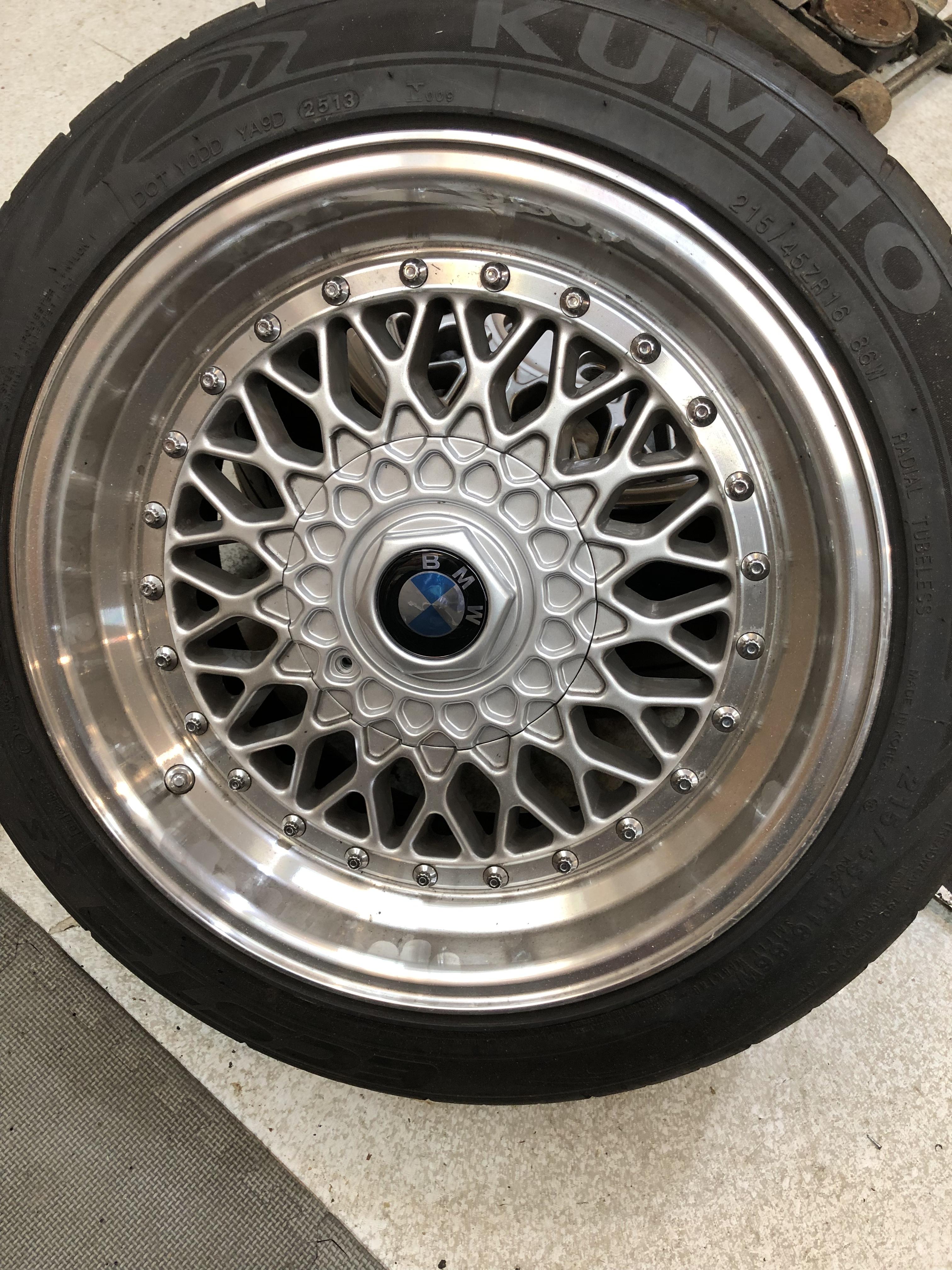

                    Got some bmw center stickers

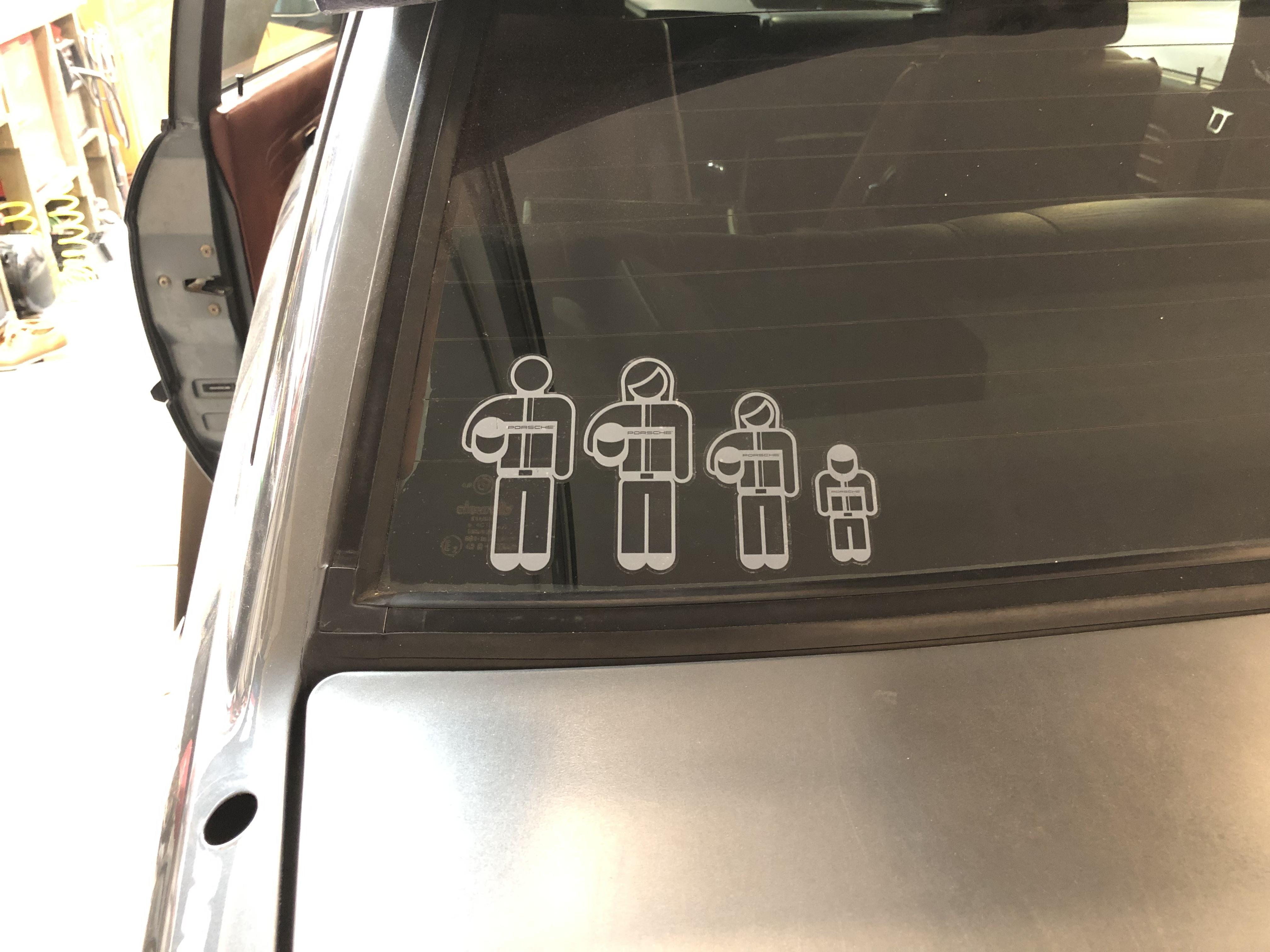

                    And finally put my family stick people on it. Lol. Came free in a Road and Track magazine.

                      At first, I thought your stickers depicted two wives of varying sizes.
                      Engine bay is looking fantastic!
                        #311
                        I've always had a thing for wives that were my exact height and wives who are just a hair shorter. Couldn't make up my mind so I got one of each.

                              #314

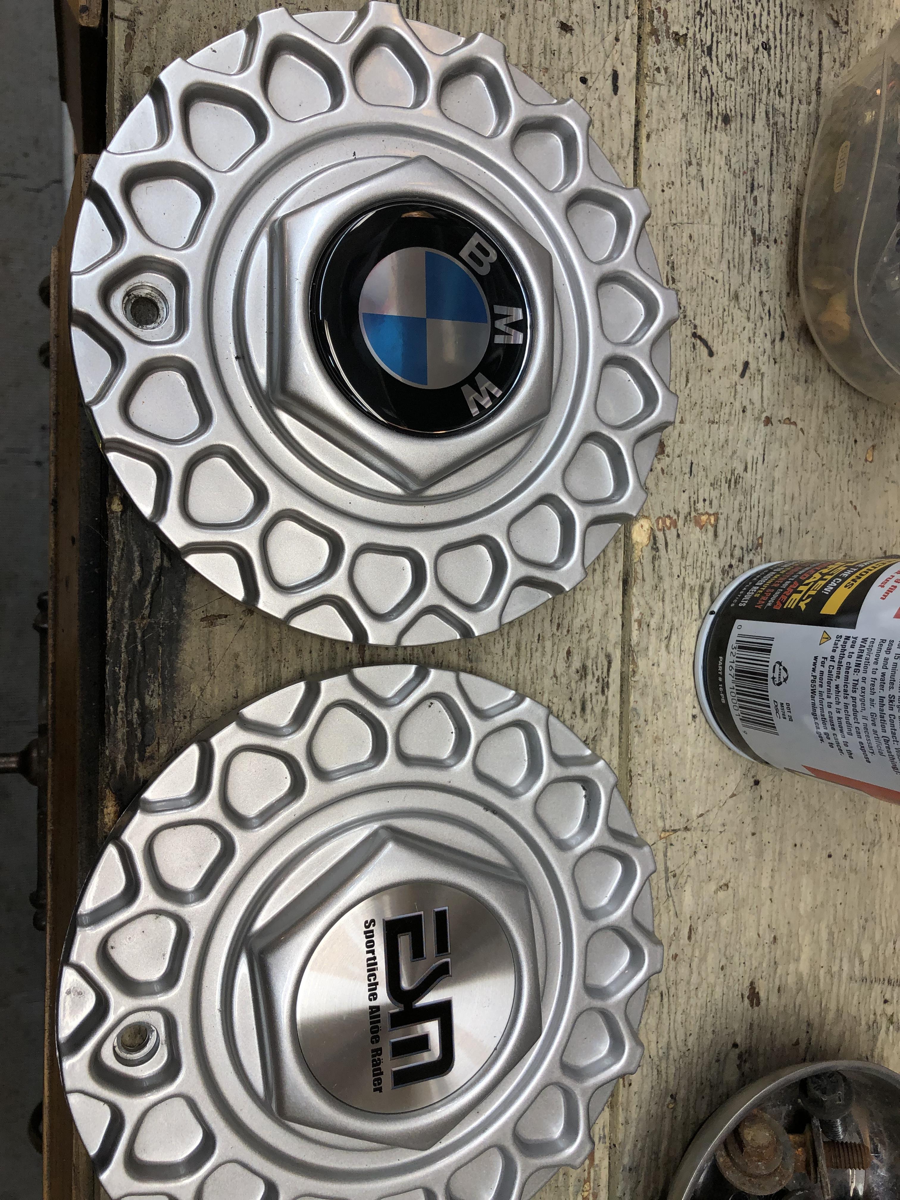

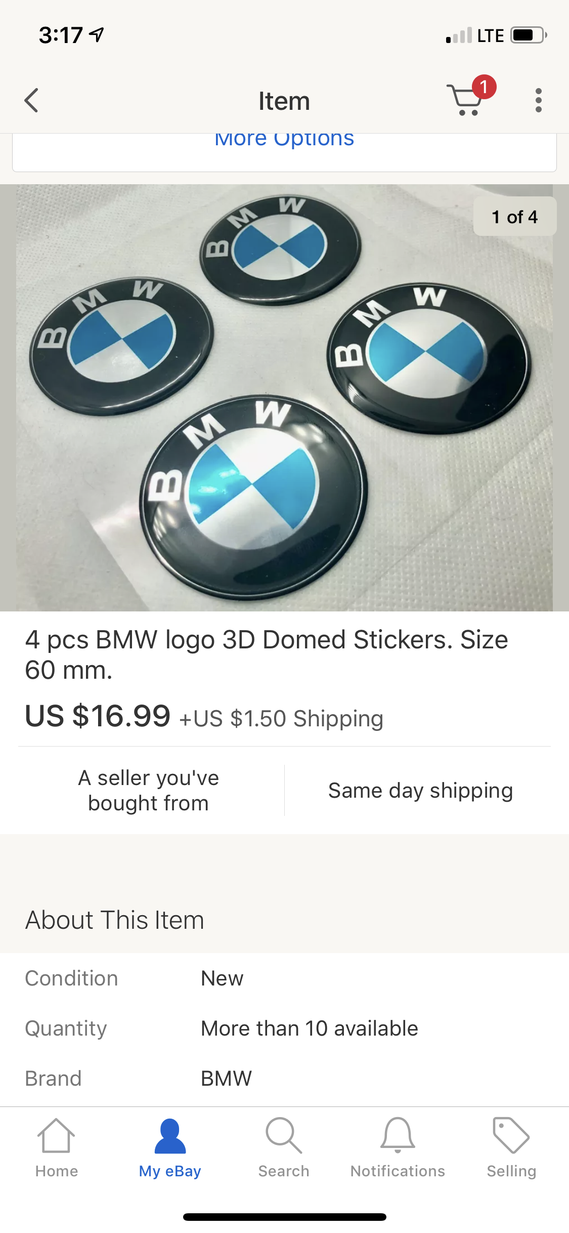

                              what size were those stickers?
                                #315
                                I'm assuming you mean the wheel stickers and not the people? Lol
                                  #316
                                  you got it! thanks.

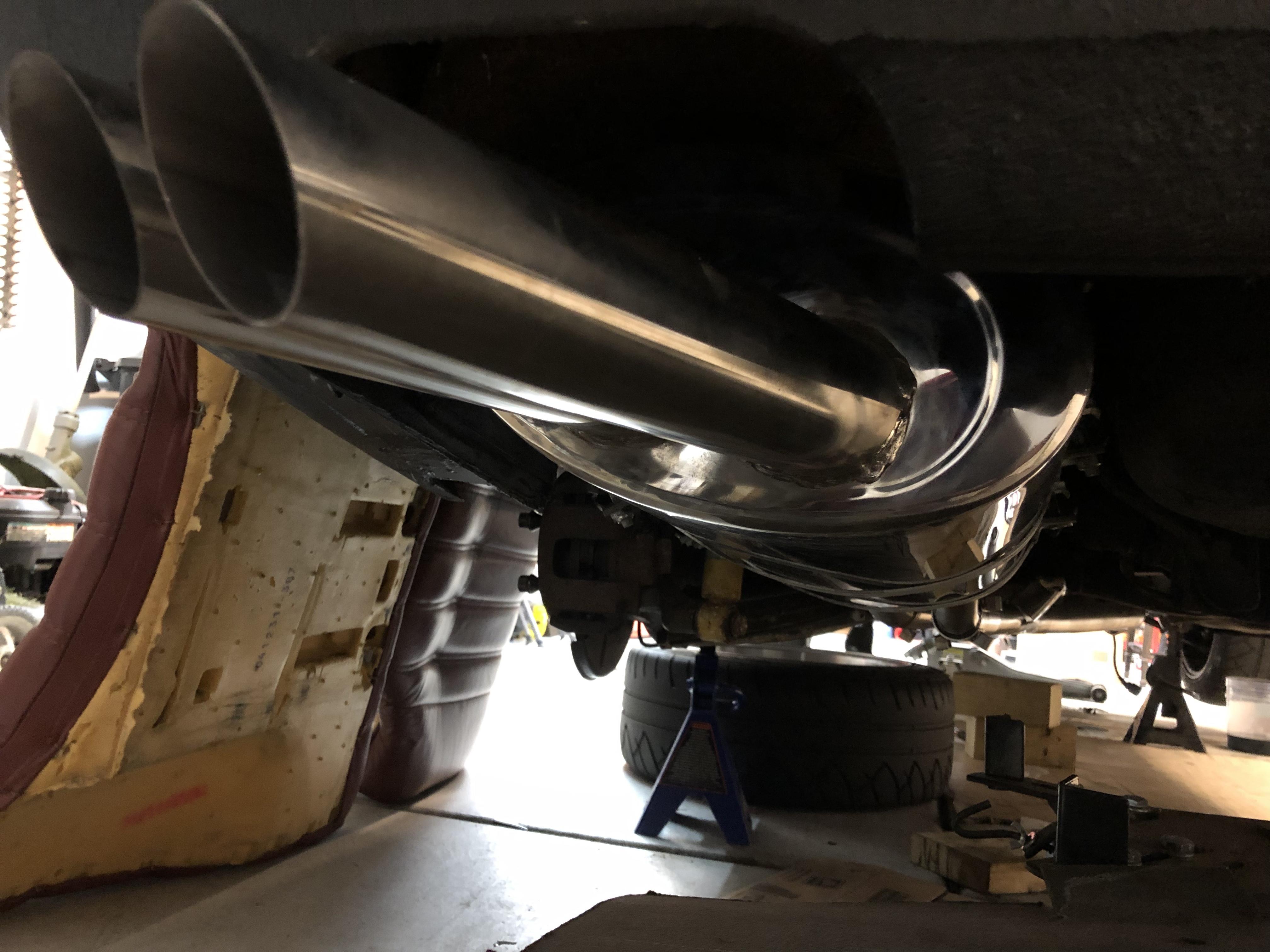

                                          In the meantime, exhaust back in including new eBay cat back.

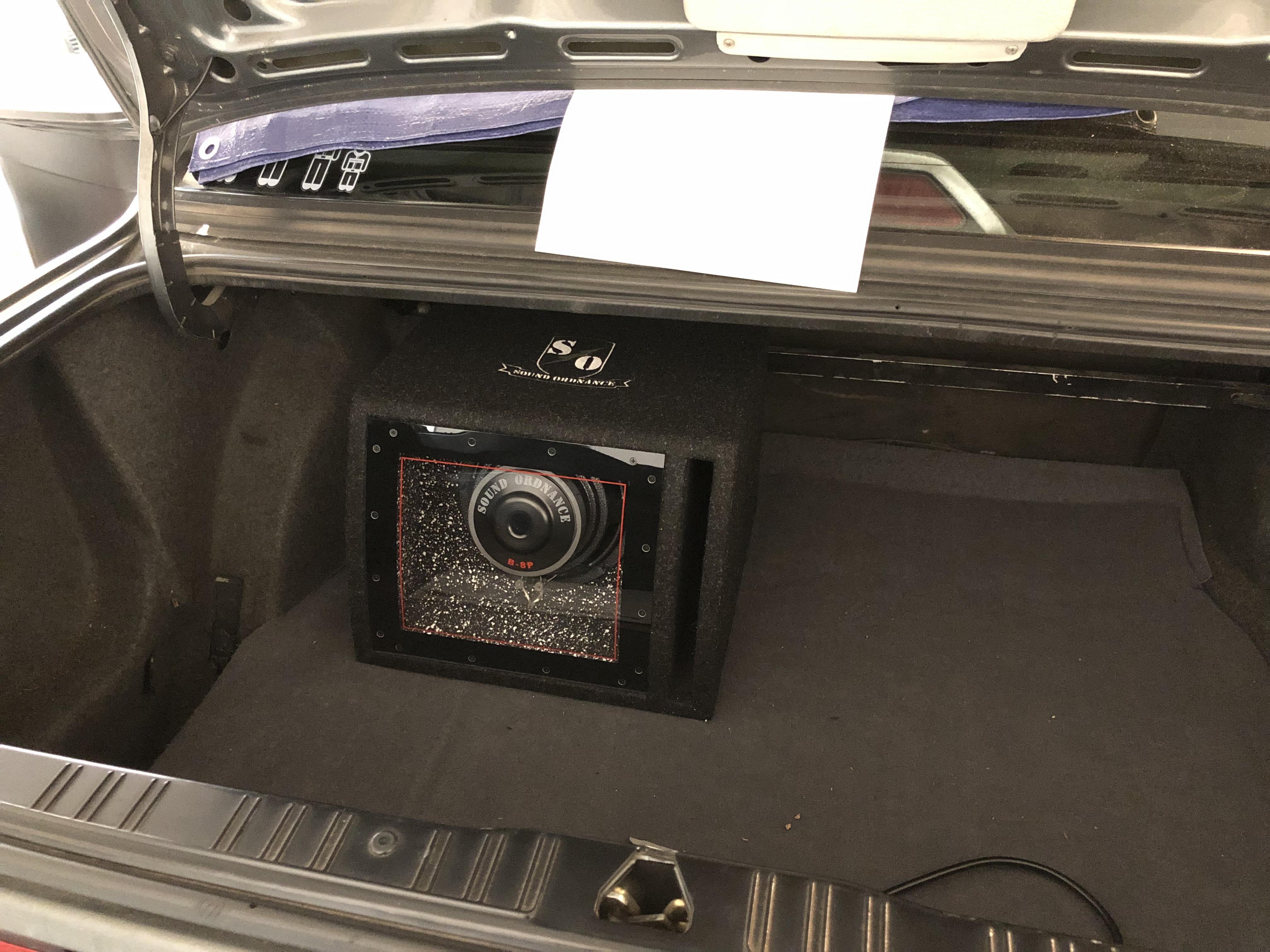

                                          Got a subwoofer for the trunk to fill in some bass from the old speakers.

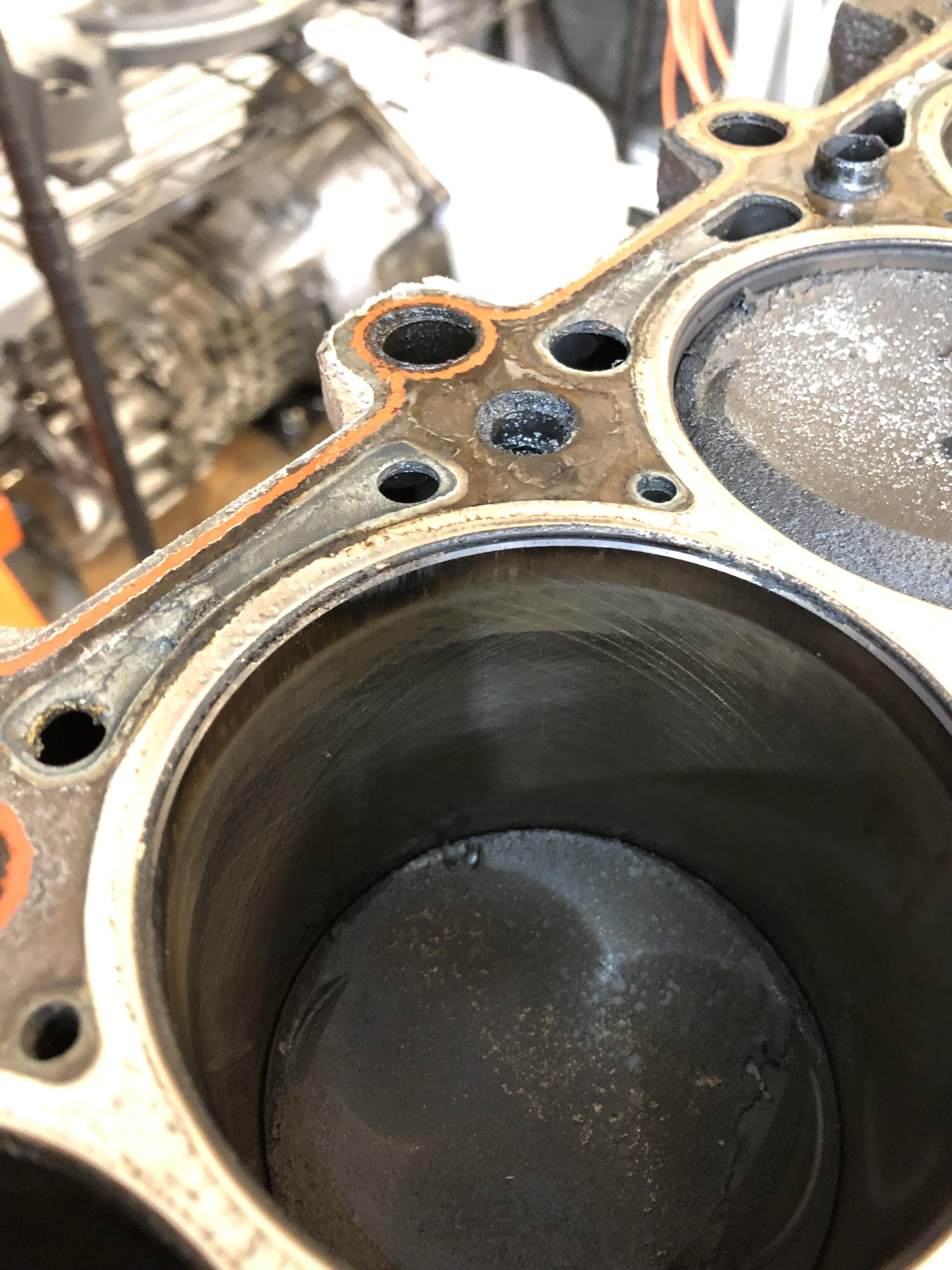

                                          Got the head off the donor engine and really happy with how the cylinder walls looked.
