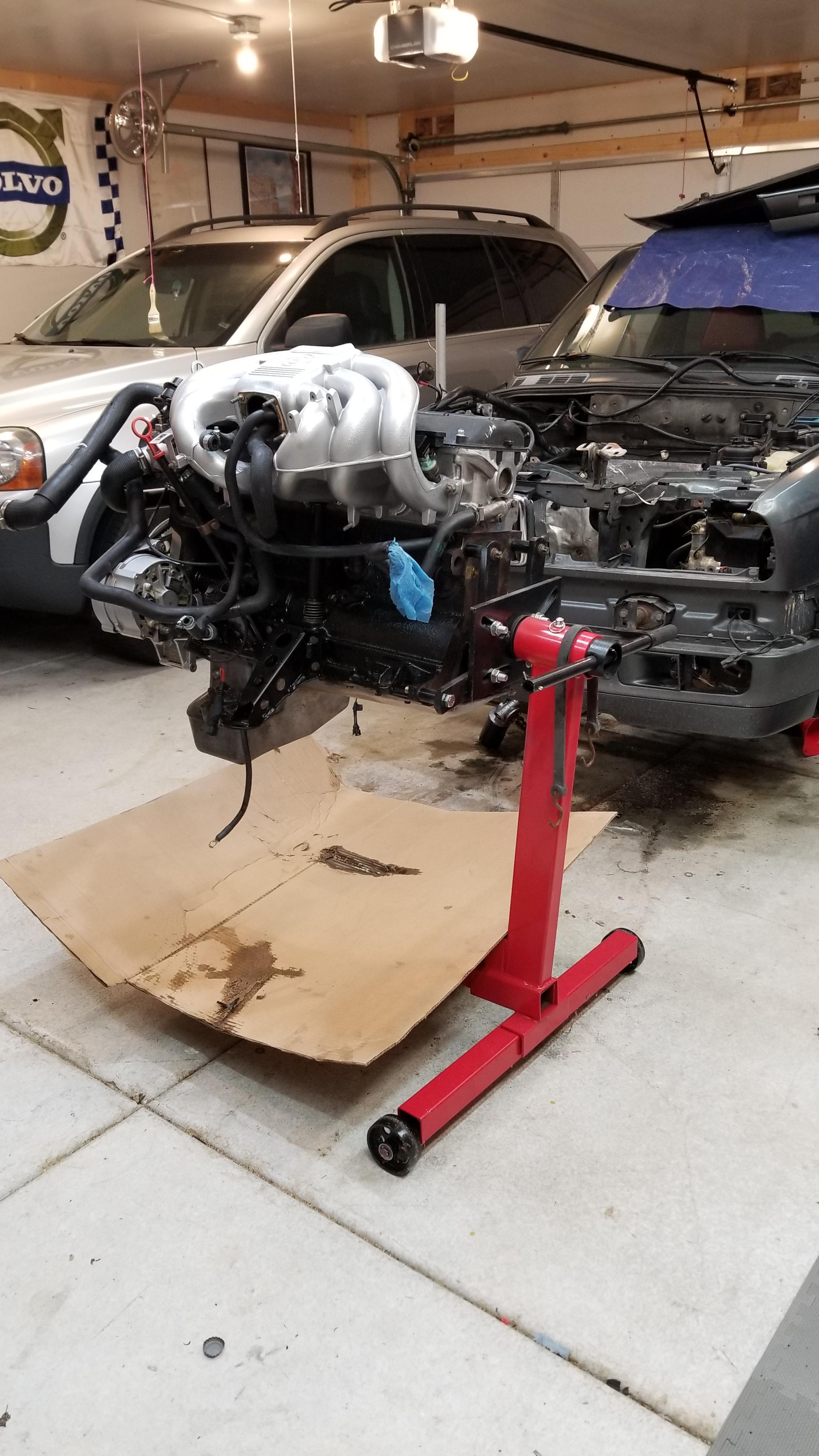

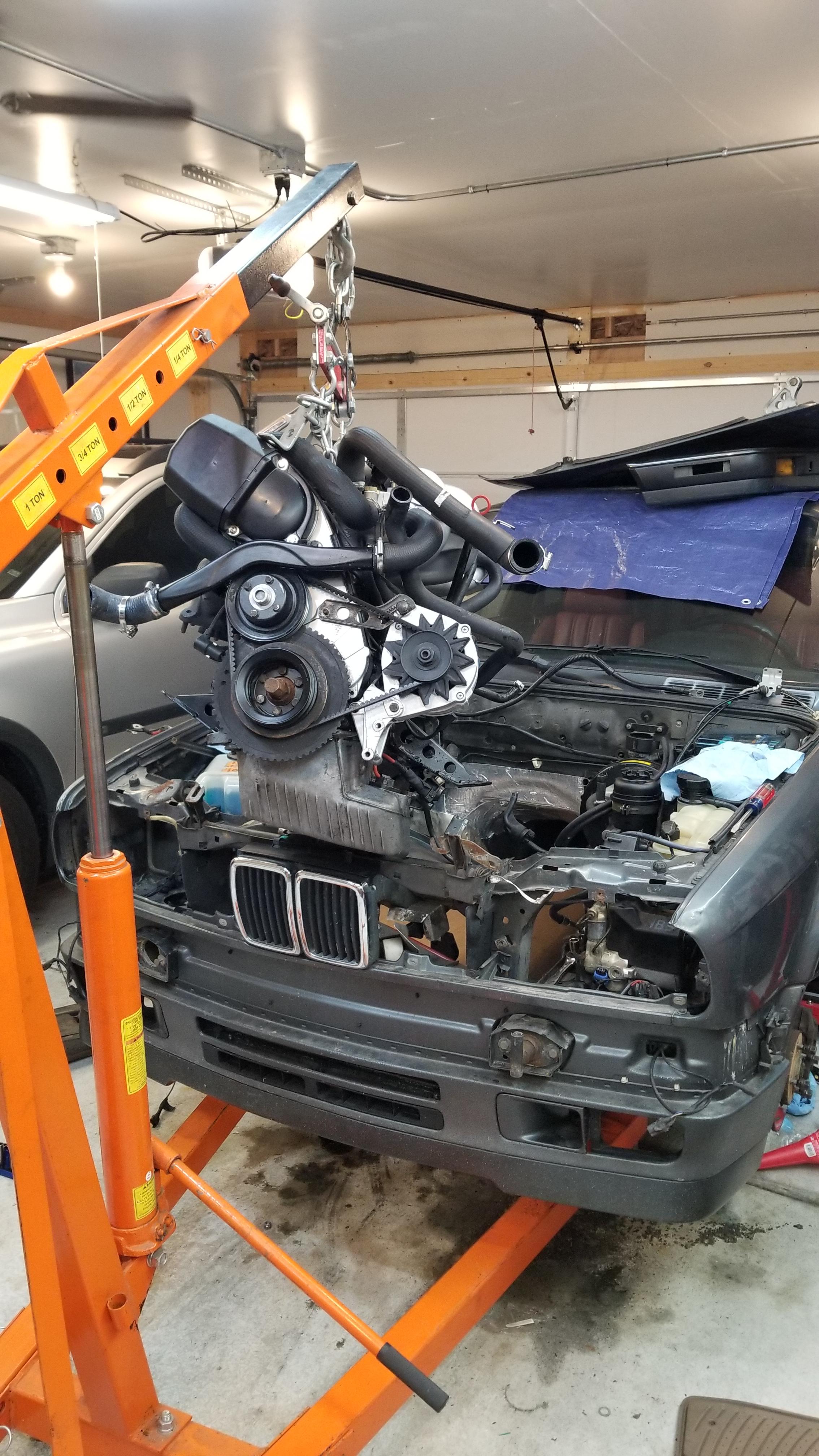

    Engine coming back out.

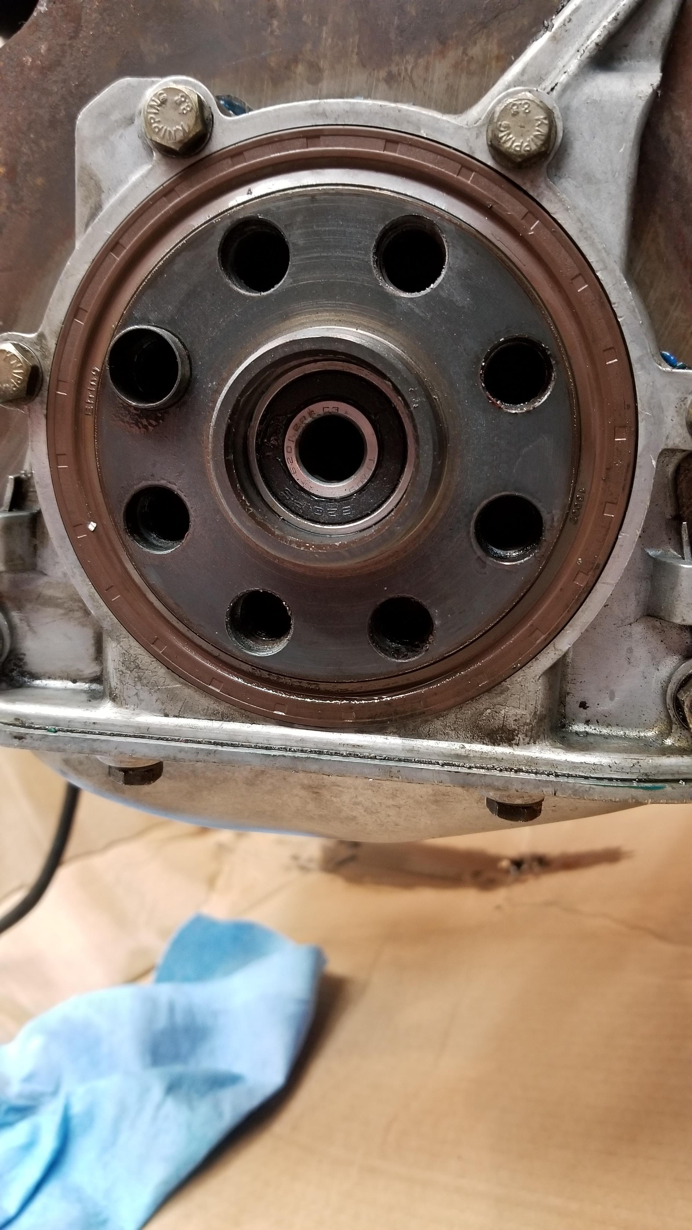

    Confirmed the RMS
    And asleep for the winter.

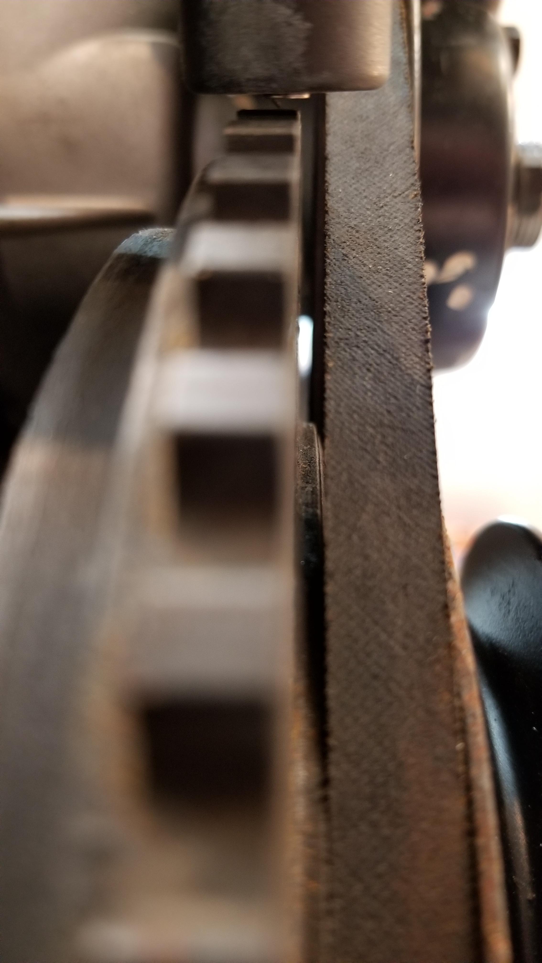

    Hoping the CPS being weirdly offset like this is contributing to my cutout issue when driving.
    And, a couple of the new daily. I'm really liking it. Totally different than the 325i wagon, but I like being back in a Volvo and the swedish styling is great. I had a 2010 S80 for a little while and it is one of my more favorite interiors.
      #262
      That offset CPS could be a problem for sure.
