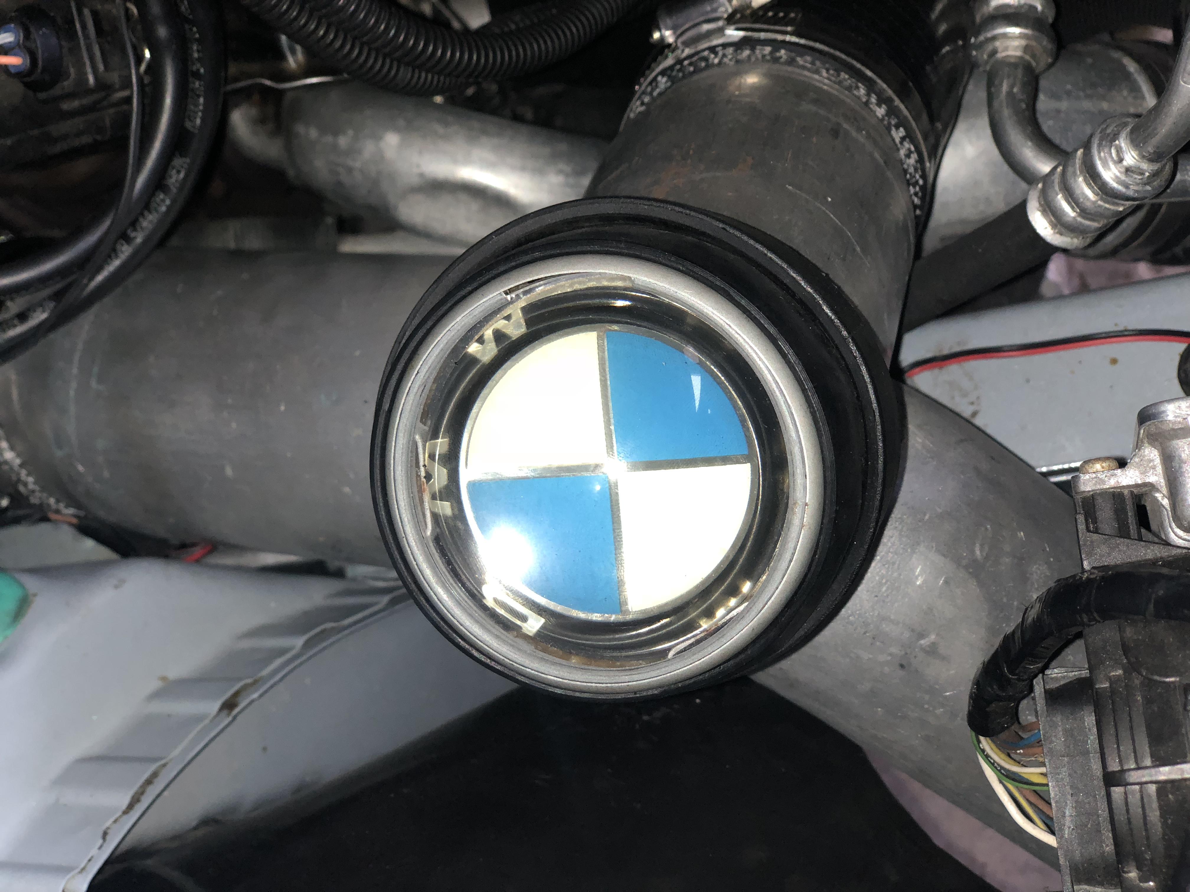

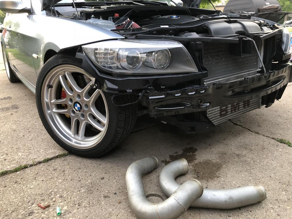

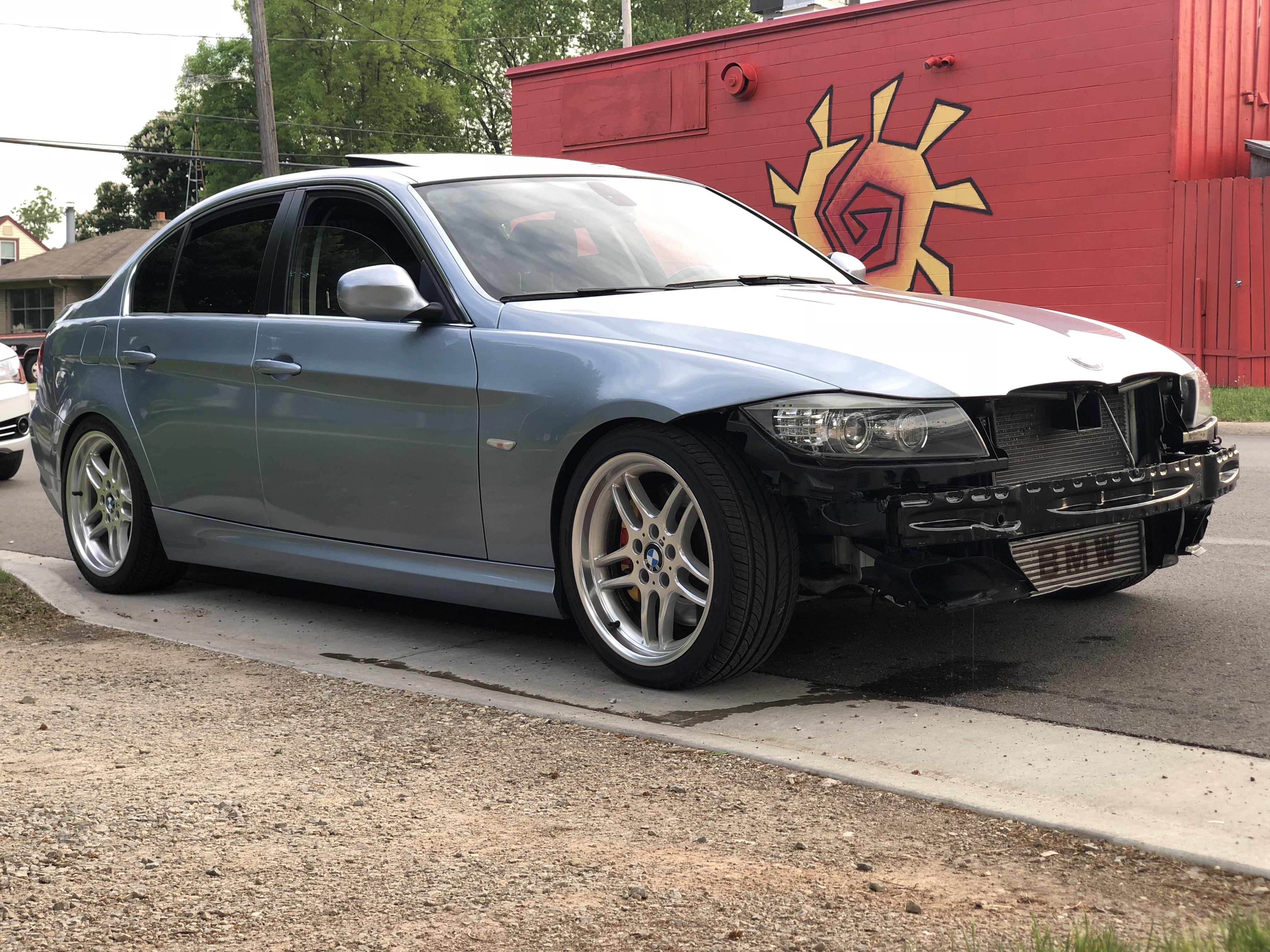

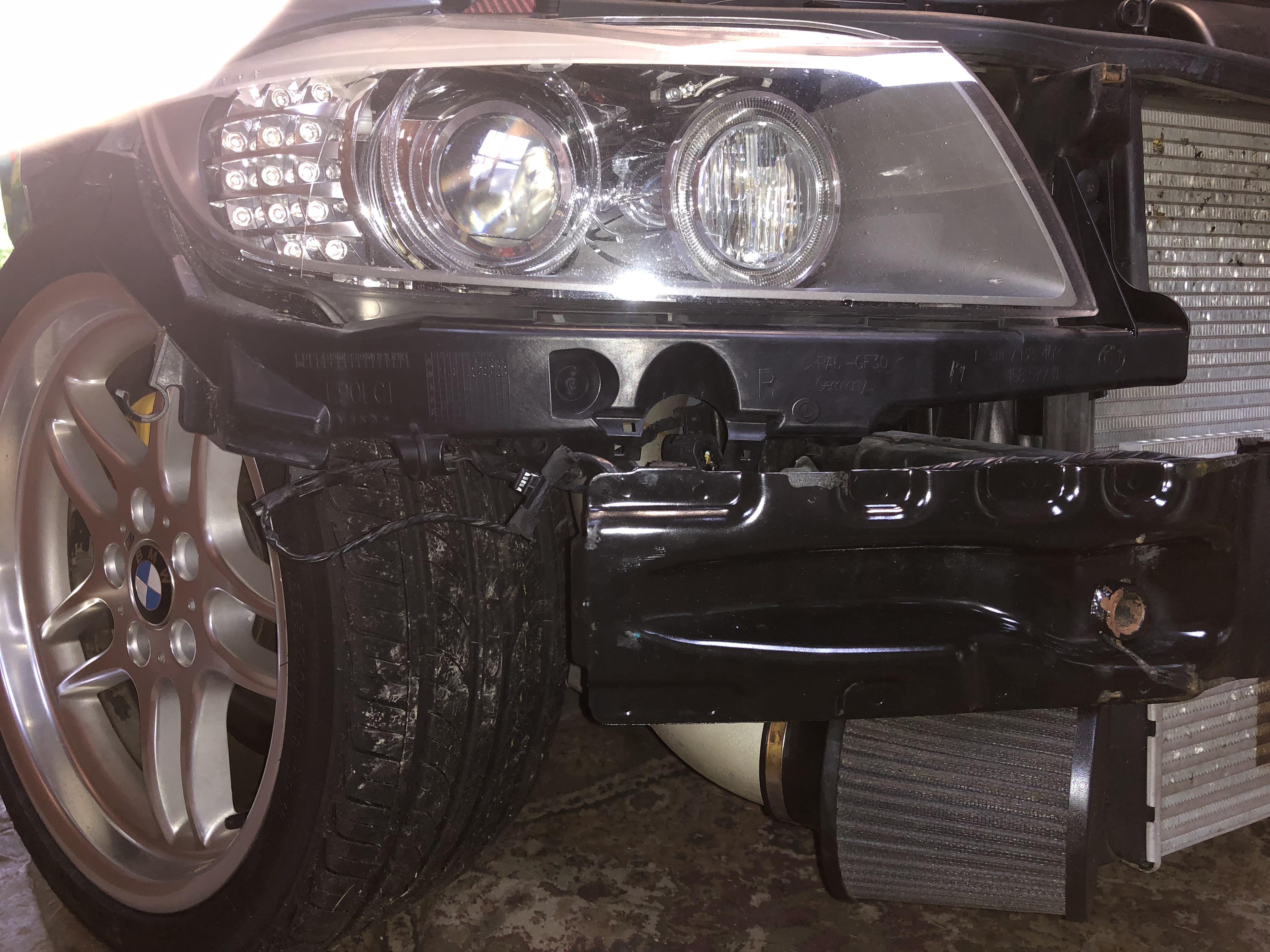

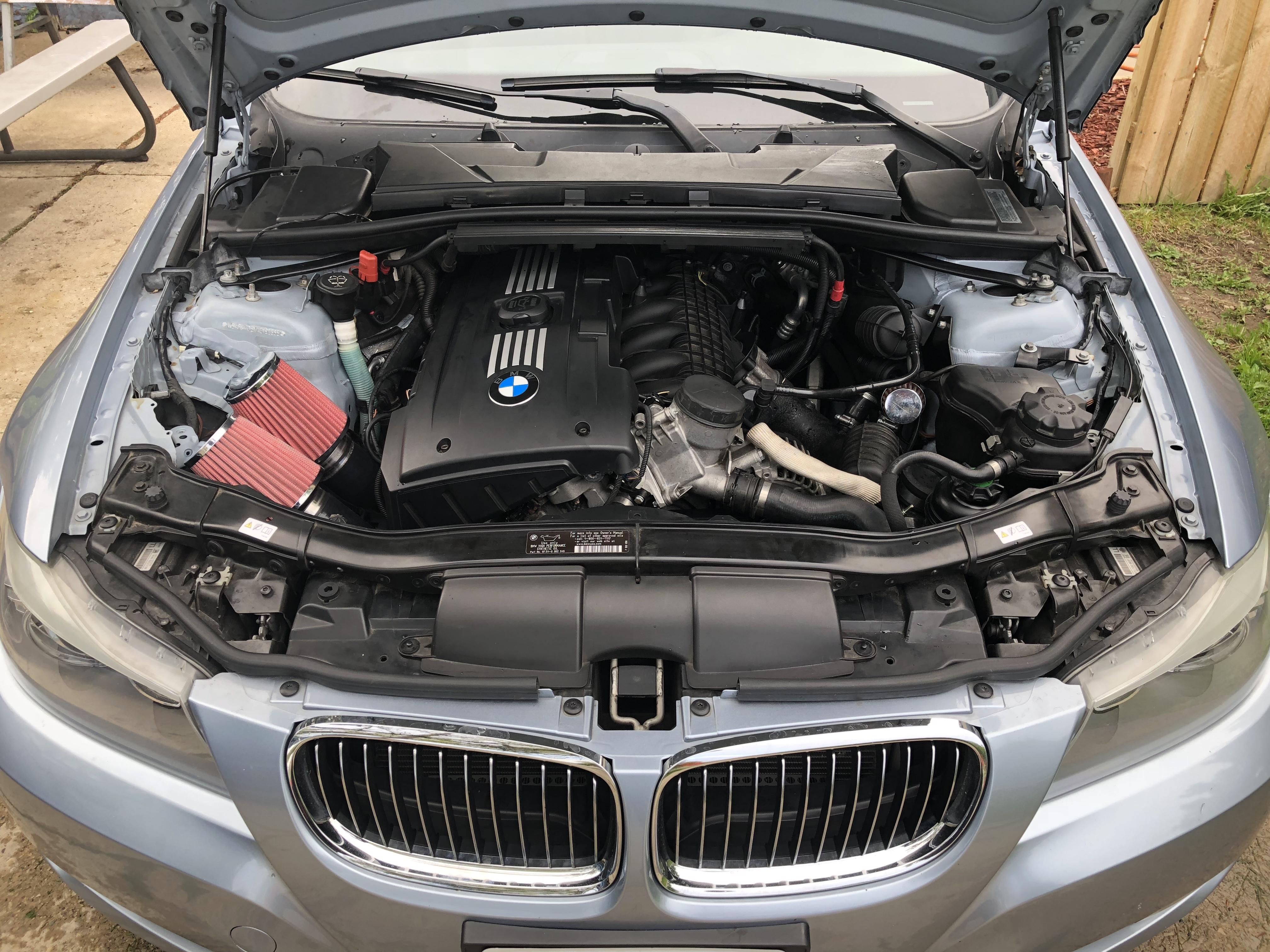

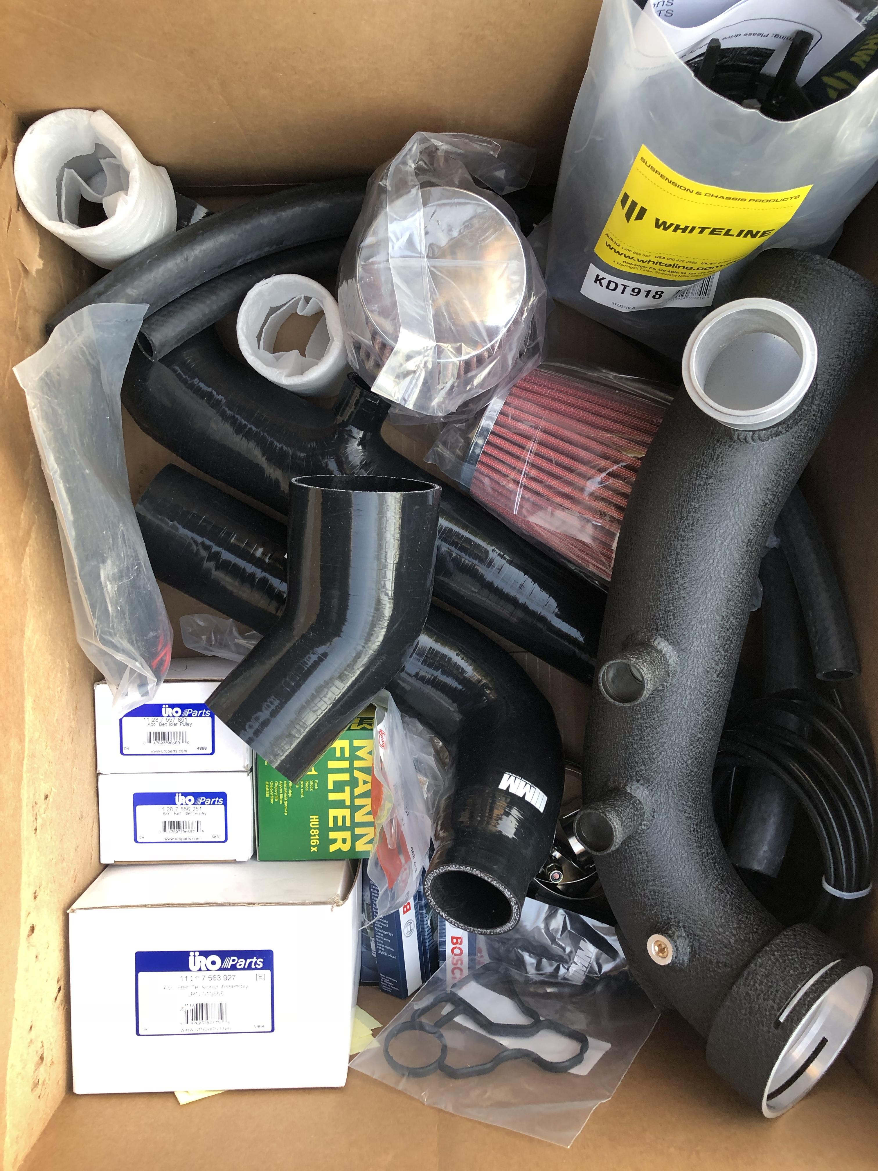

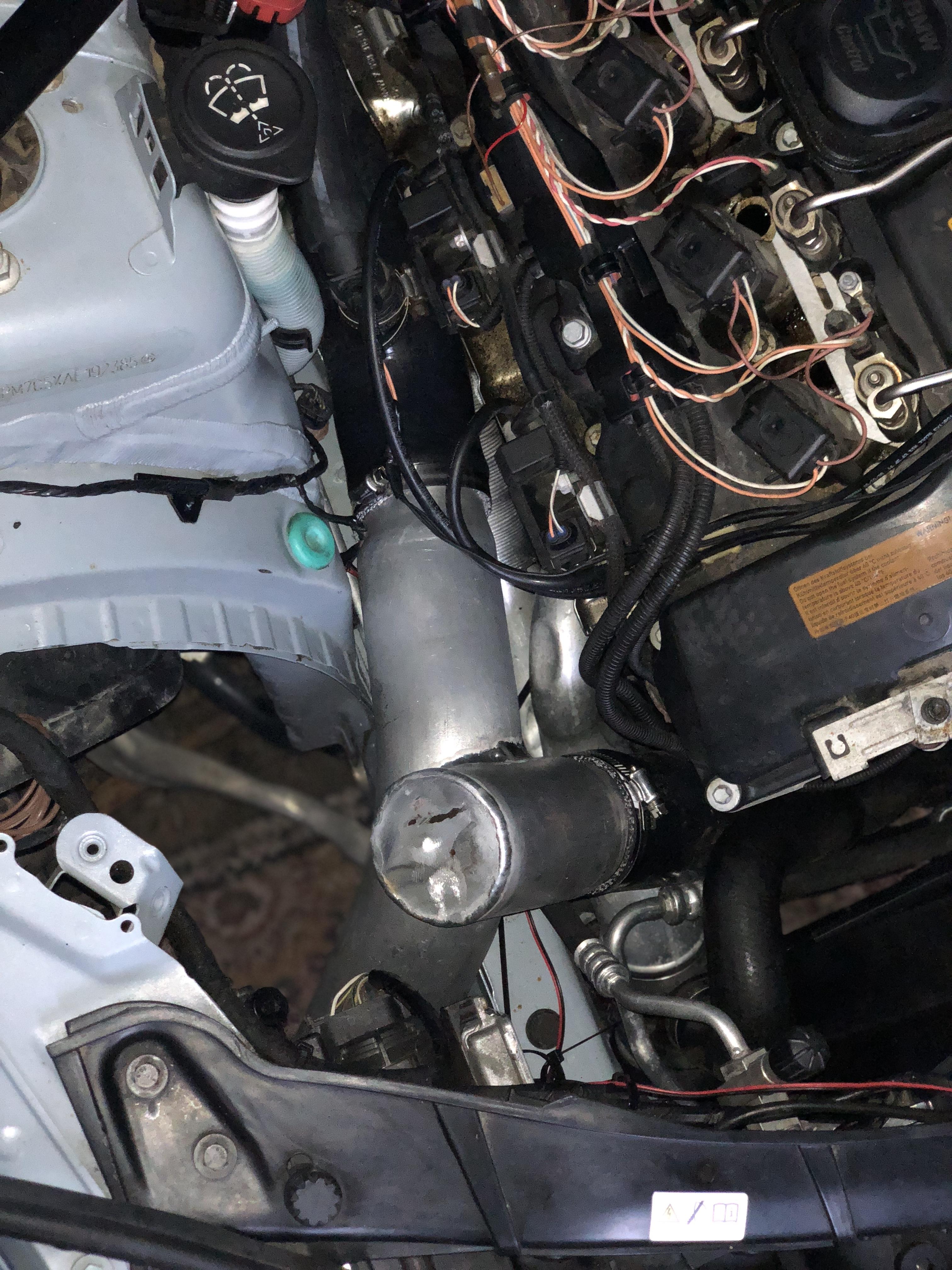

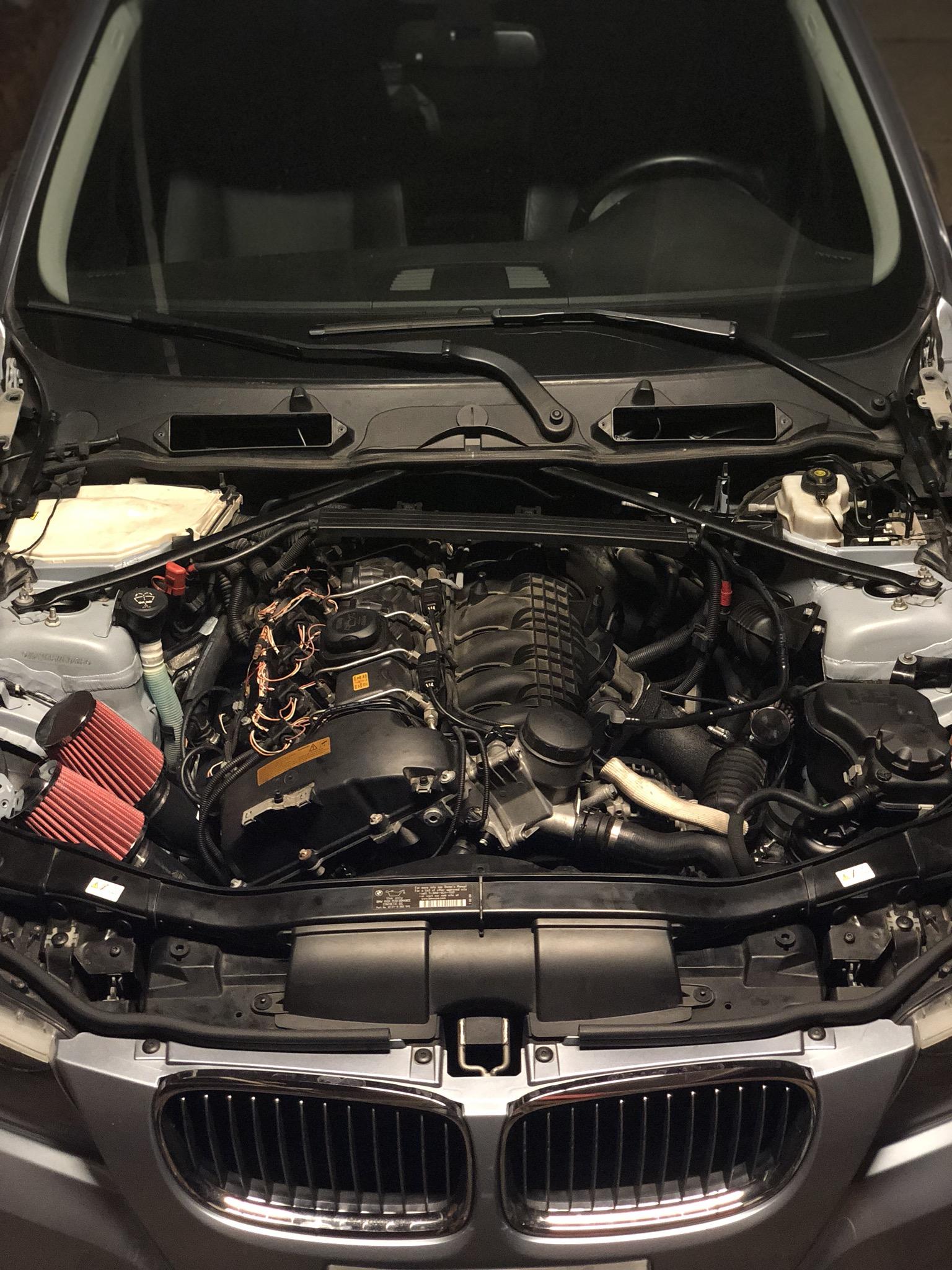

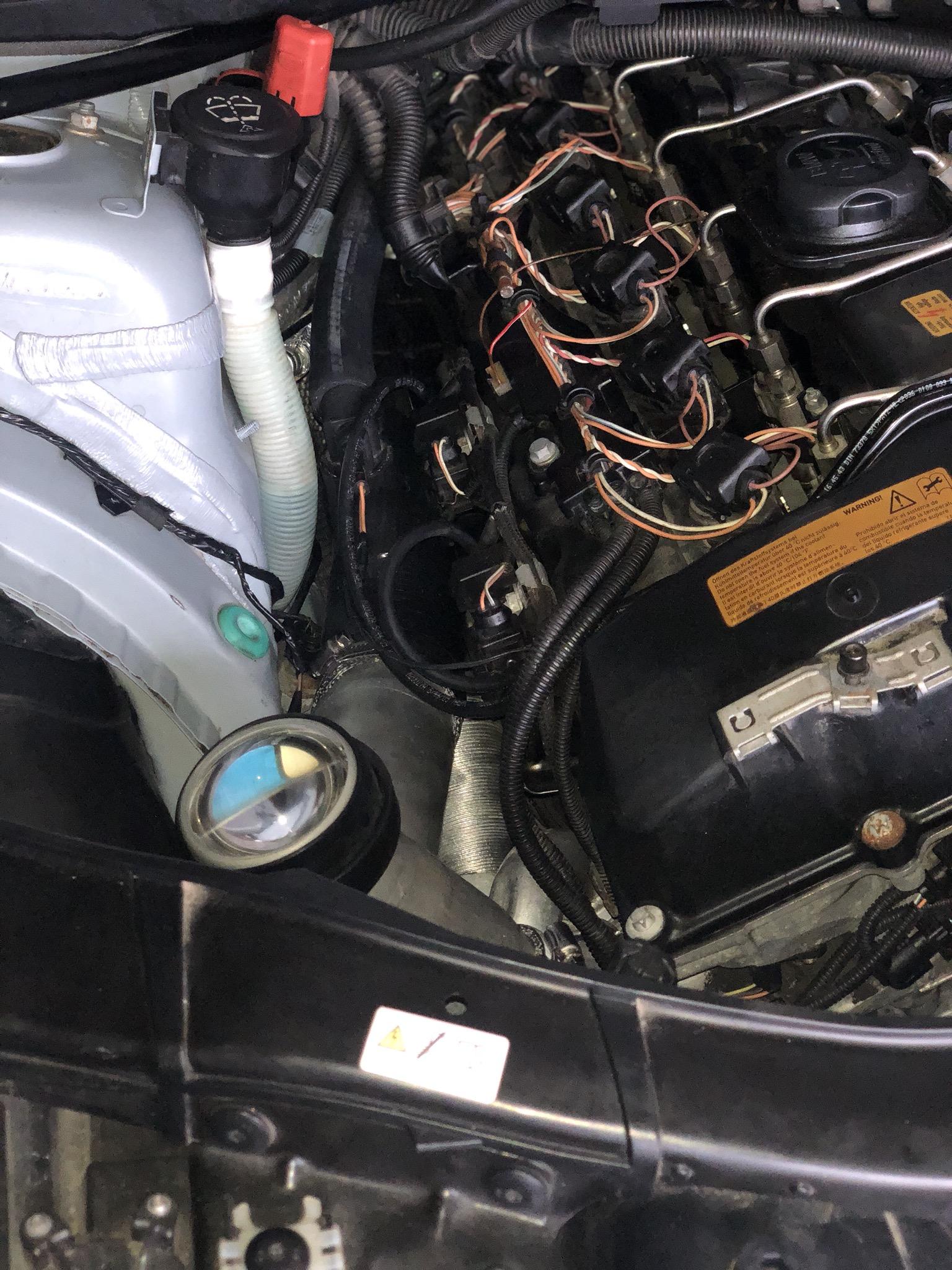

    Ferrari mechanic for a living I’d have to say this challenge took me longer with bloodier hands than a full service on a f355! ,lmao,pita...so again getting a weekend to my own projects so I’ve decided to start gathering parts over the last month,still currently awaiting downpipes to show up ,the list’ was starting with the Schwaben scan tool from turner on sale wich I like and suggest.., chargepipe, relocation inlets,catless downpipes 3”,oil filter housing gasket again ..with intake ports walnut blasted and new gaskets,spark plugs and coils packs , new serpentine and tensioner along with rear subframe bushings inserts for a start, tho the relocation inlets set me back alone that project took over ten hours the rear turbo inlet was such an enormous pain the the ****,it took me under car 20+ times without a lift ,a 30” crowbar from top pushing down and someone wiggling from top back and forth with the stock downpipes in the way it is sooper tite ,I’d say half the time was on the rear turbo inlet getting aligned now I can finally get to the rest of the Jazz with ease now all that plastic crap out of the way ...,I was really hoping to install downpipes since I had the entire weekend to get things done but I’ll have to wait. So here are few pics after and I’ll keep ya posted on the rest ..also awaiting xpipe for resonator delete ,then a good buddy from the Ferrari shop is building me a custom air box along with finishing up the exhaust another weekend..pe mod is done so that’s taken care of ,one day at a time ..

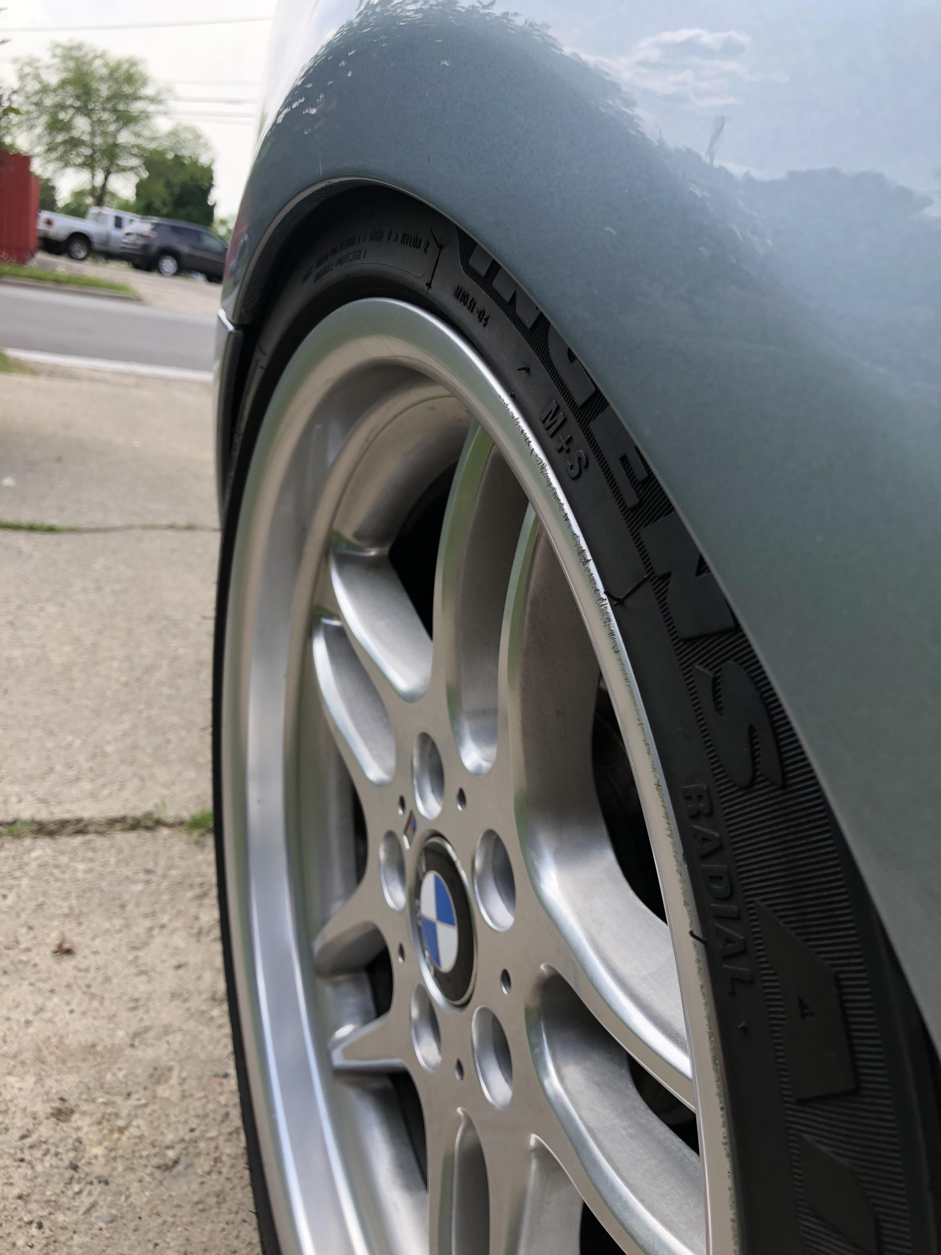

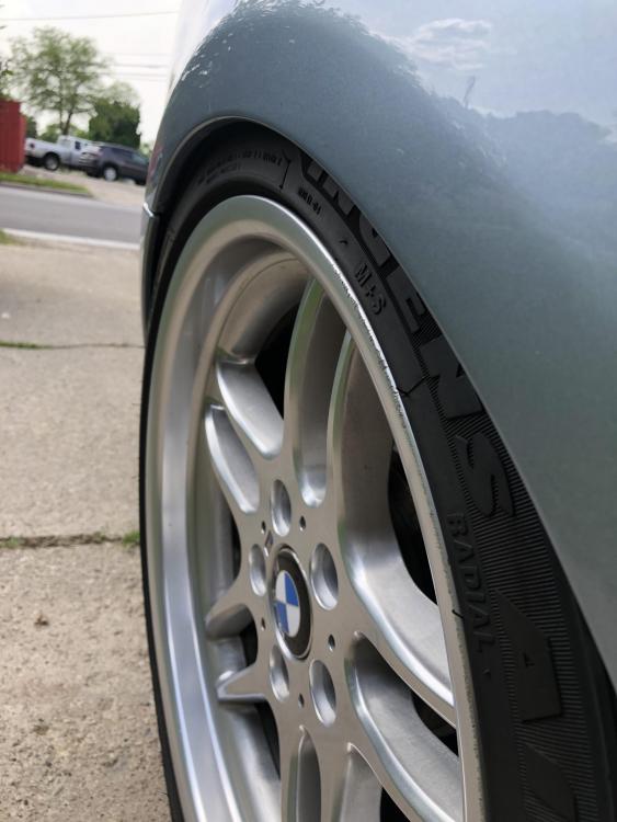

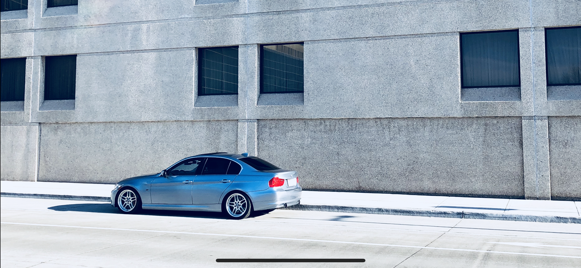

                  Are those M Pars 18s or 19s? Did they even make 19s?
                  • Drgt5683D
                    Drgt5683D
                    Drgt5683

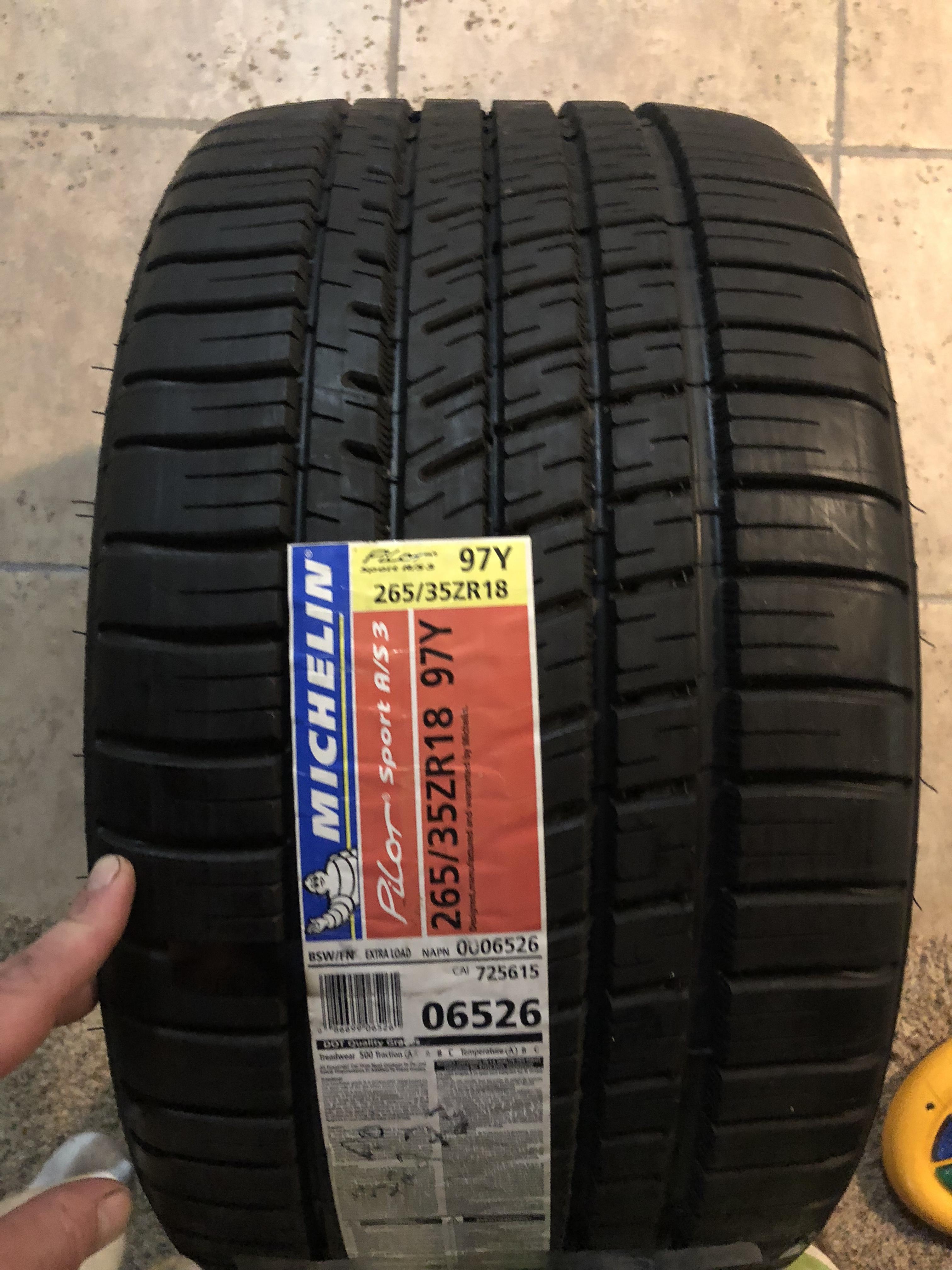

                    18” and I don’t think bmw made a 19” mPar.,these are actually 4 front e38 mPars,I’m working on purchasing new tires for the rears wich are a little wider, currently running 225/40 and will have 265/35’s on the rear once finished with wheels and tires arrive

                        Your struggle with the rear inlet reminds me of doing mine. What a pain in the ass.

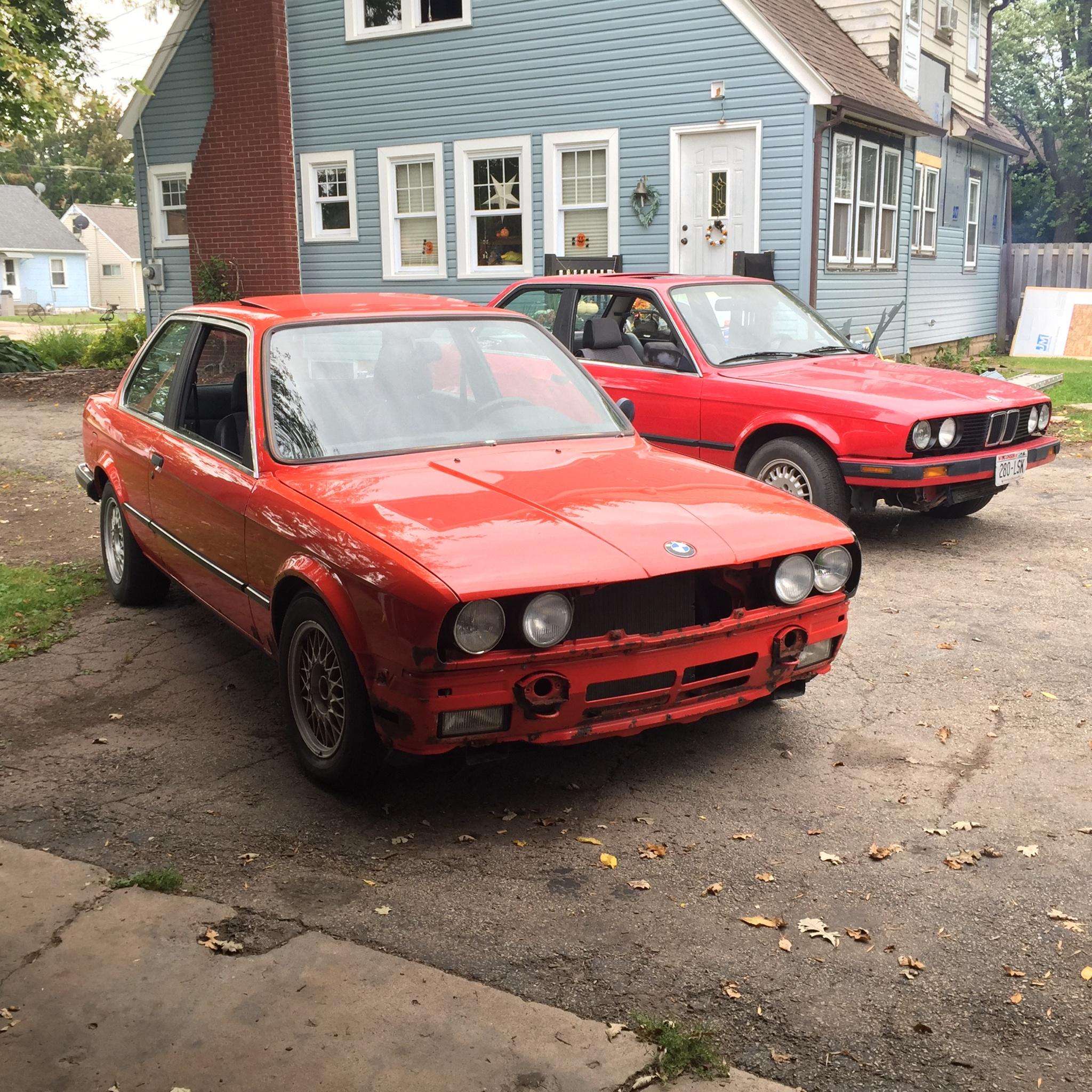

                                  here some more fun photos,previous cars ,projects exc...enjoy enjoy !!

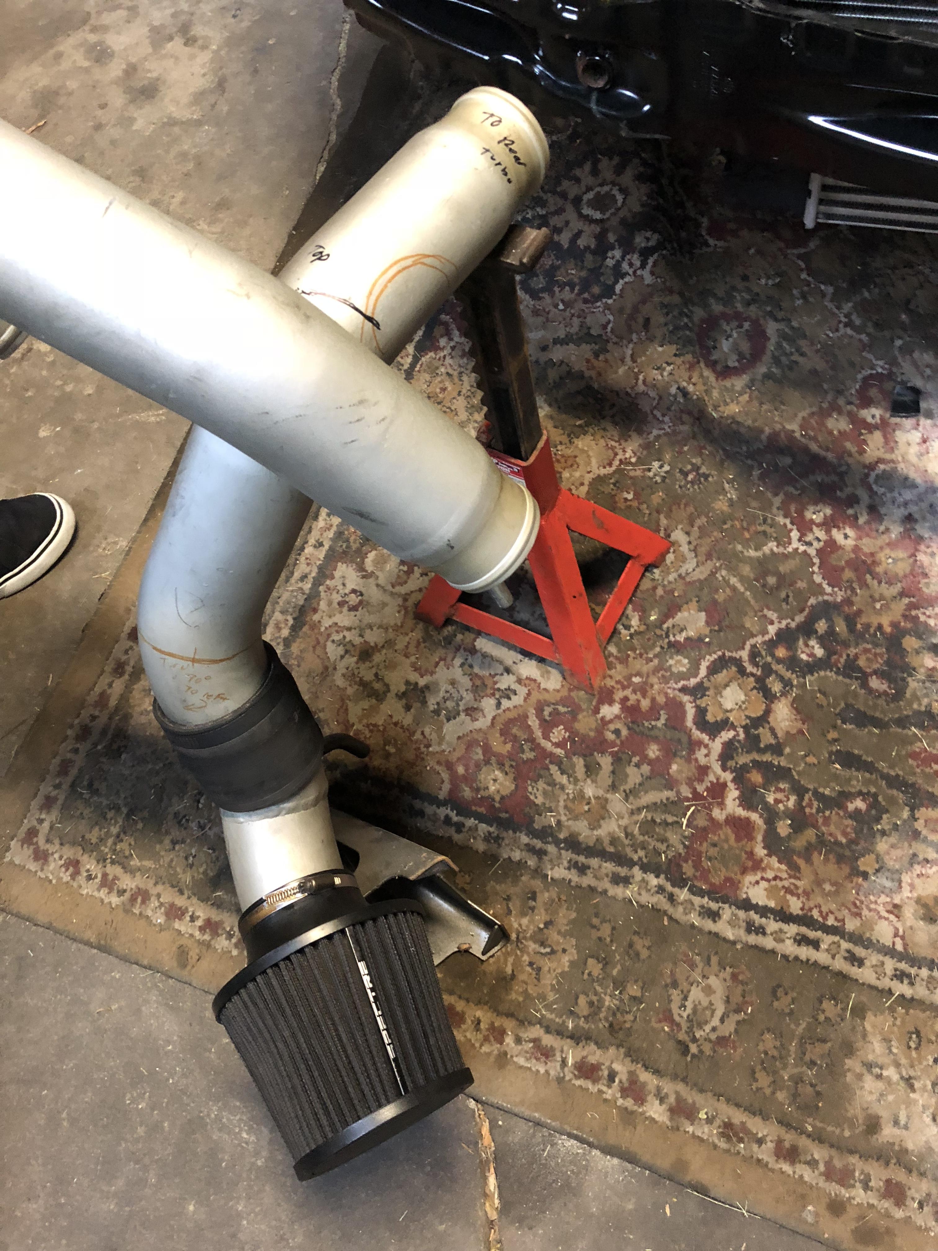

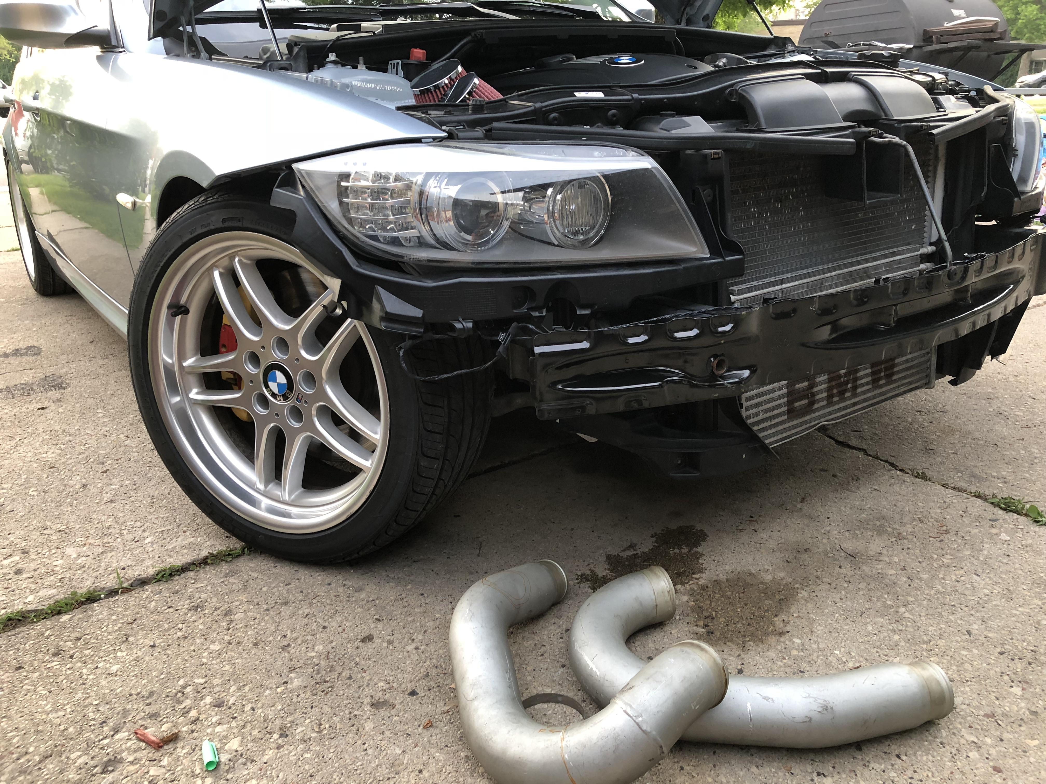

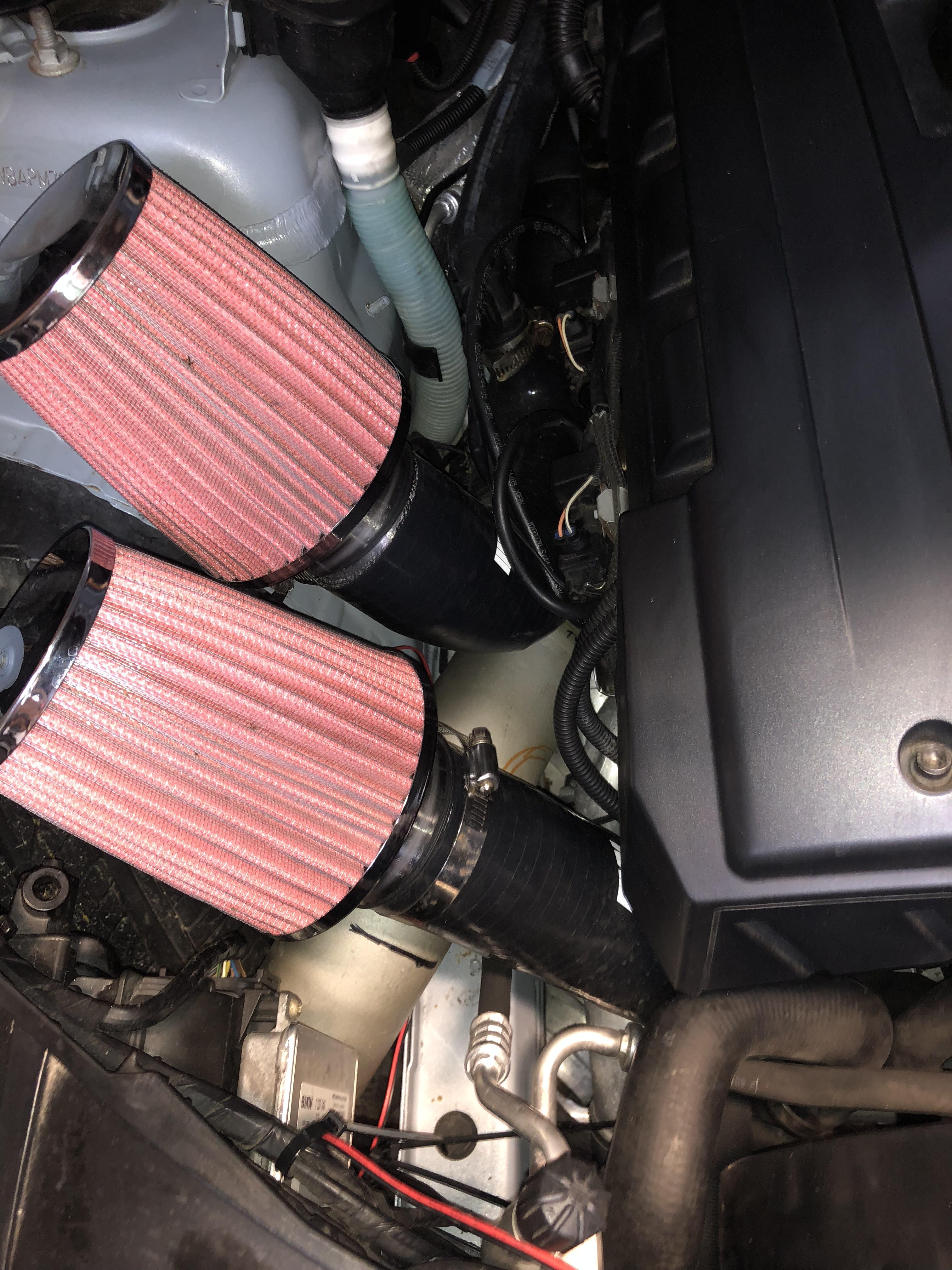

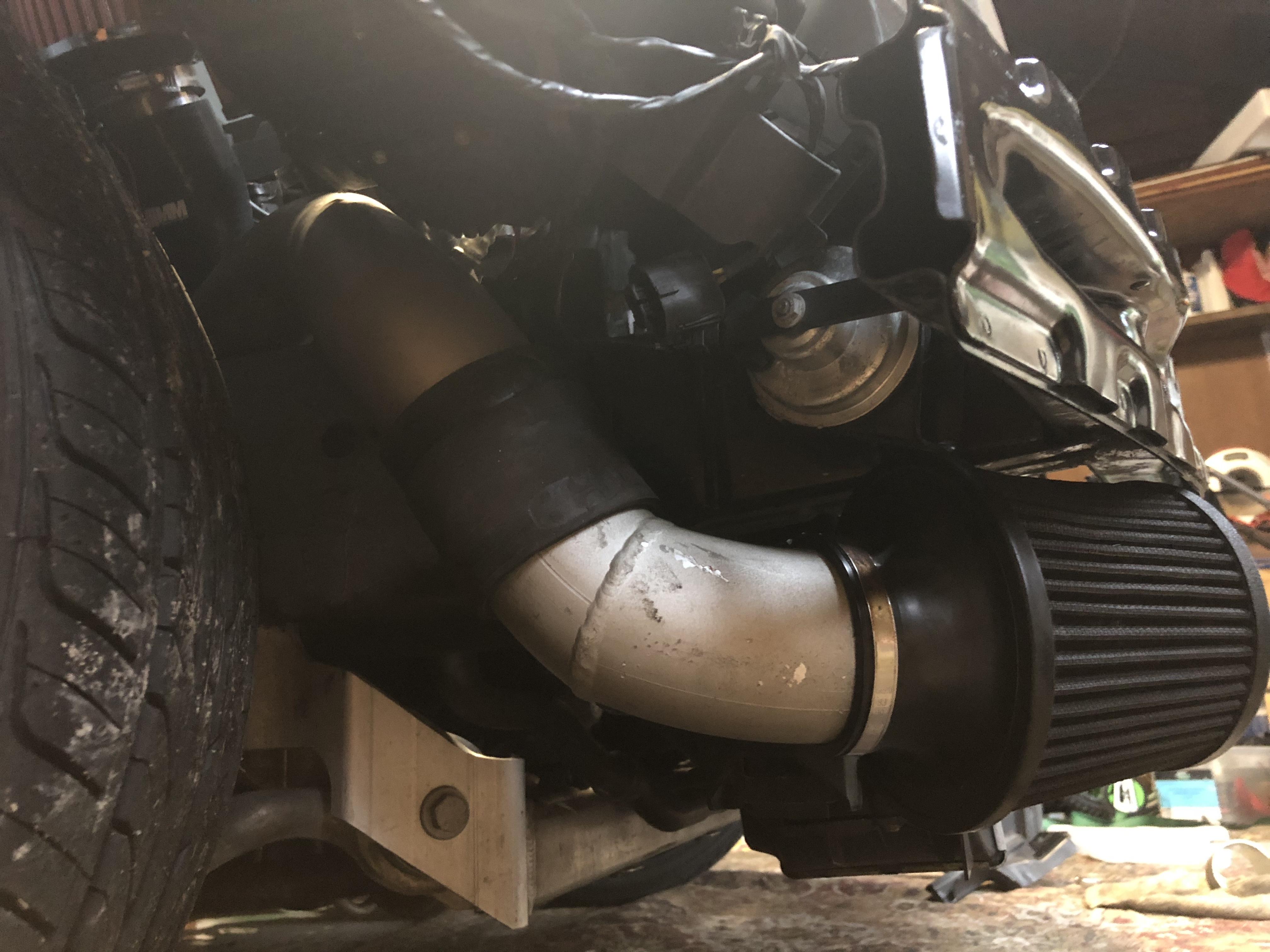

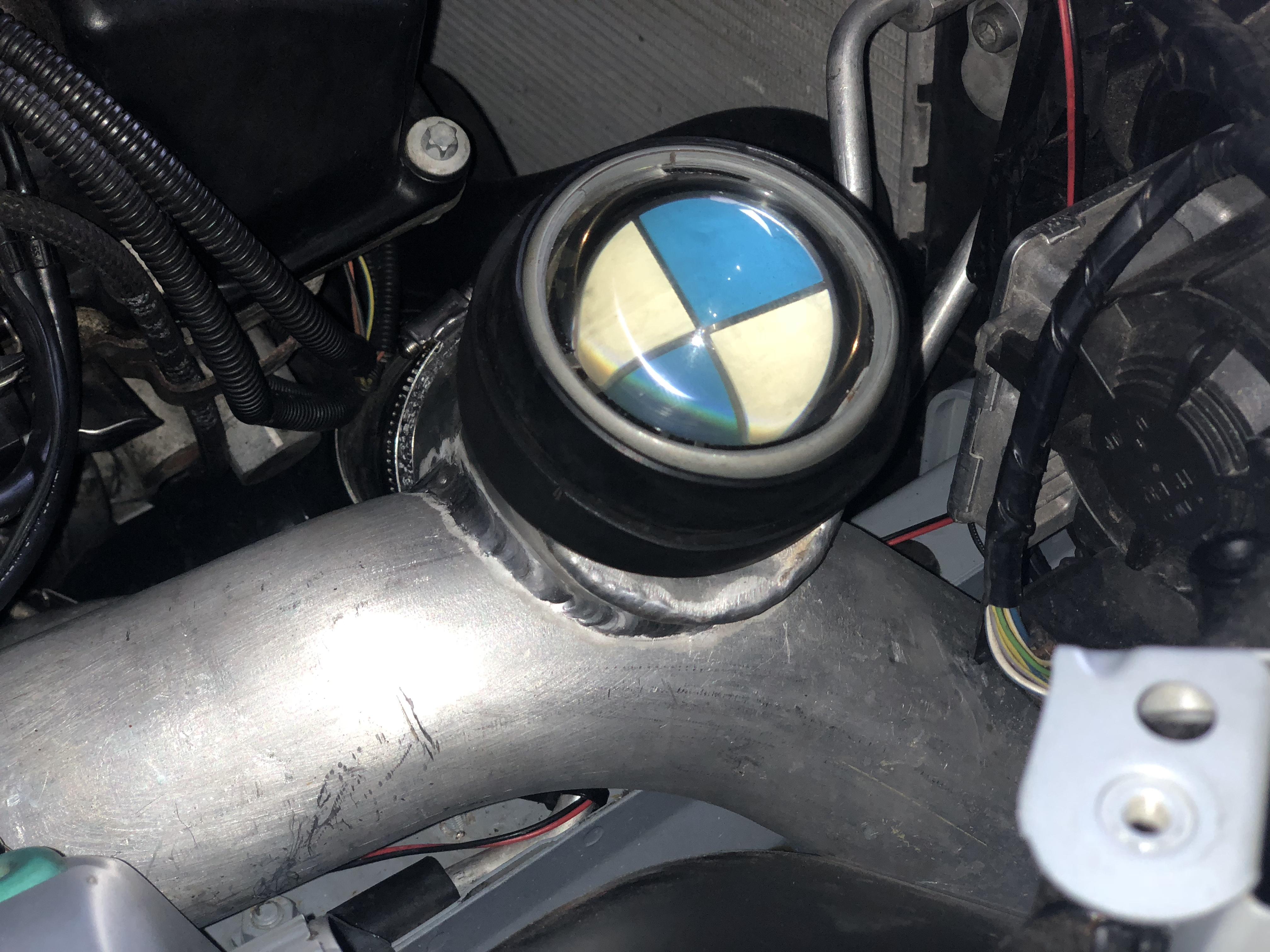

                                    So again I had time to tear into the car a little bit been running very well and I’m sooper impressed with everything so far unfortunately tho my gDanm a/c has a leak now between the condenser somewhere and maybe the lines idk excactly yet so I’m tearing into that I went ahead and ordered a new condenser/w/dryer almost positive it’s cracked rite there...,along the way I also decided it’s a perfect time to start modifiying a custom cold air inlet system out if some other pipes I’ve been saving for a project just like this one,very excited! ,once I mark it,cut it all up and route it, I have a buddy from work who has very good skills in metal I plan to have him finish up along with the resonator delete to x/pipe conversion with mandrel bent downpipes ...I’ll keep ya posted,can’t wait 😆

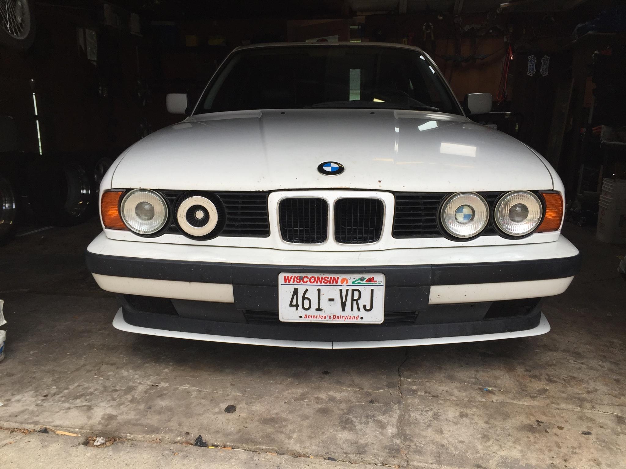

                                      Ah, you're in my old hometown. I still remember when you could rent Neo-Geo from Tri-Star... The Mexican food there is better than the old video rental place ever was though.
                                      Edit: just noticed the pick of the e34 with the ladder on the roof. I remember seeing that car around before I moved a few years ago. Why were you always hauling ladders around?
                                      • Drgt5683D
                                        Drgt5683D
                                        Drgt5683
                                        Yea I used to do construction for years as a sub then work on car/bmws for side jobs and fun after ...untill I realized it was actually more enjoyable to me working on cars then I gave that all up and picked up a job with a local bmw friend at a transmission shop ,now I work on and take care of some of the rarest and most sought after cars ever made😂🤯😳 not just Ferrari’s ..

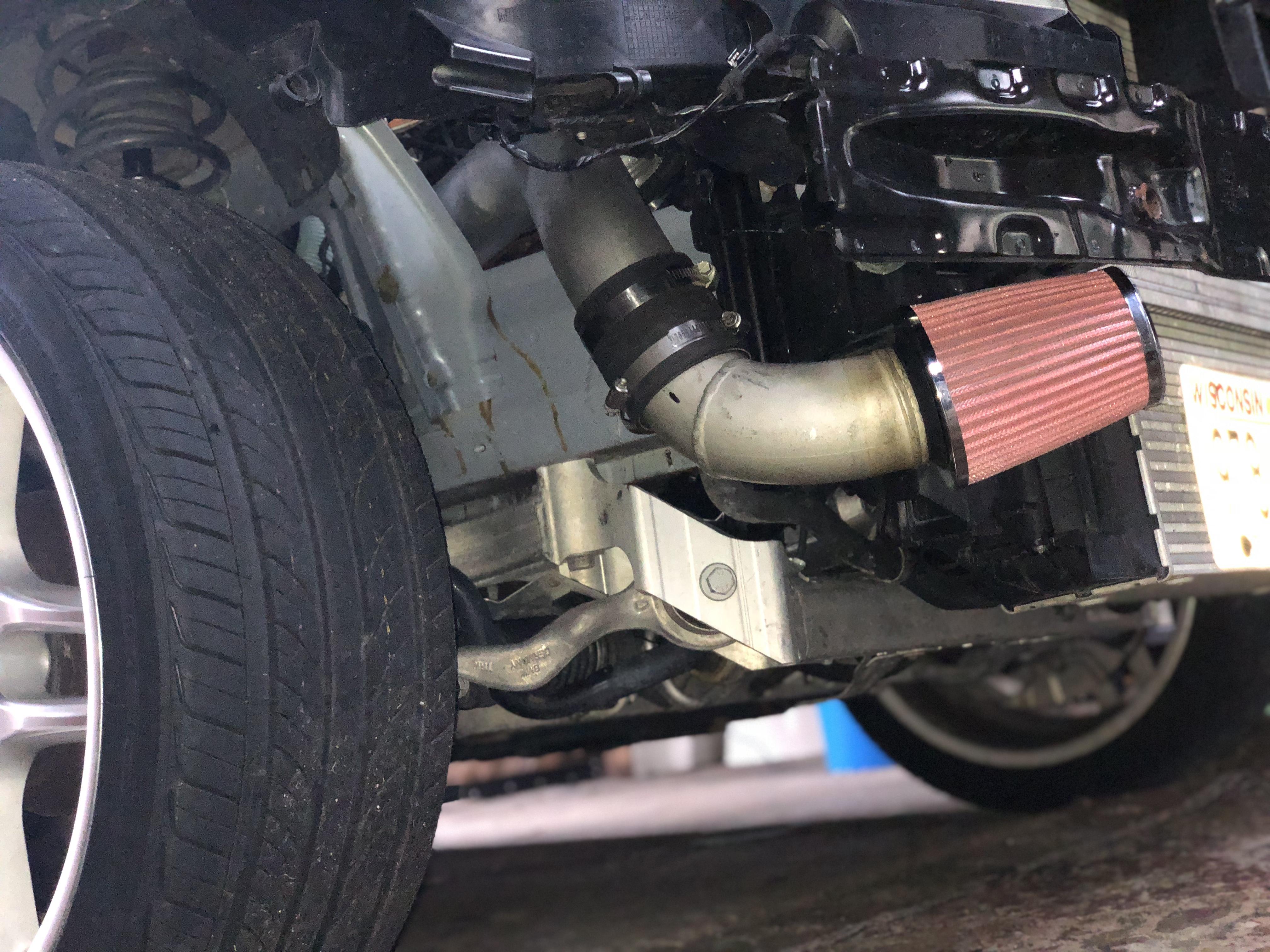

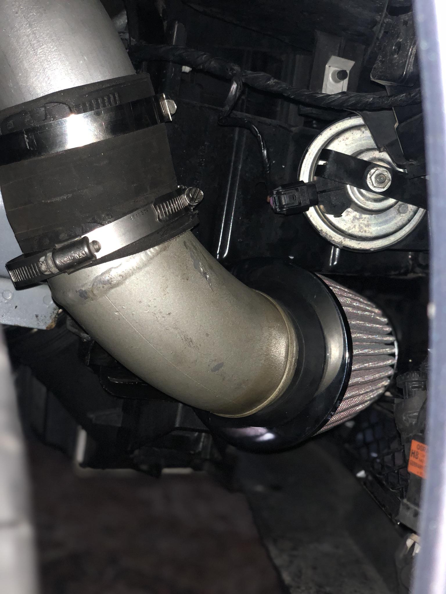

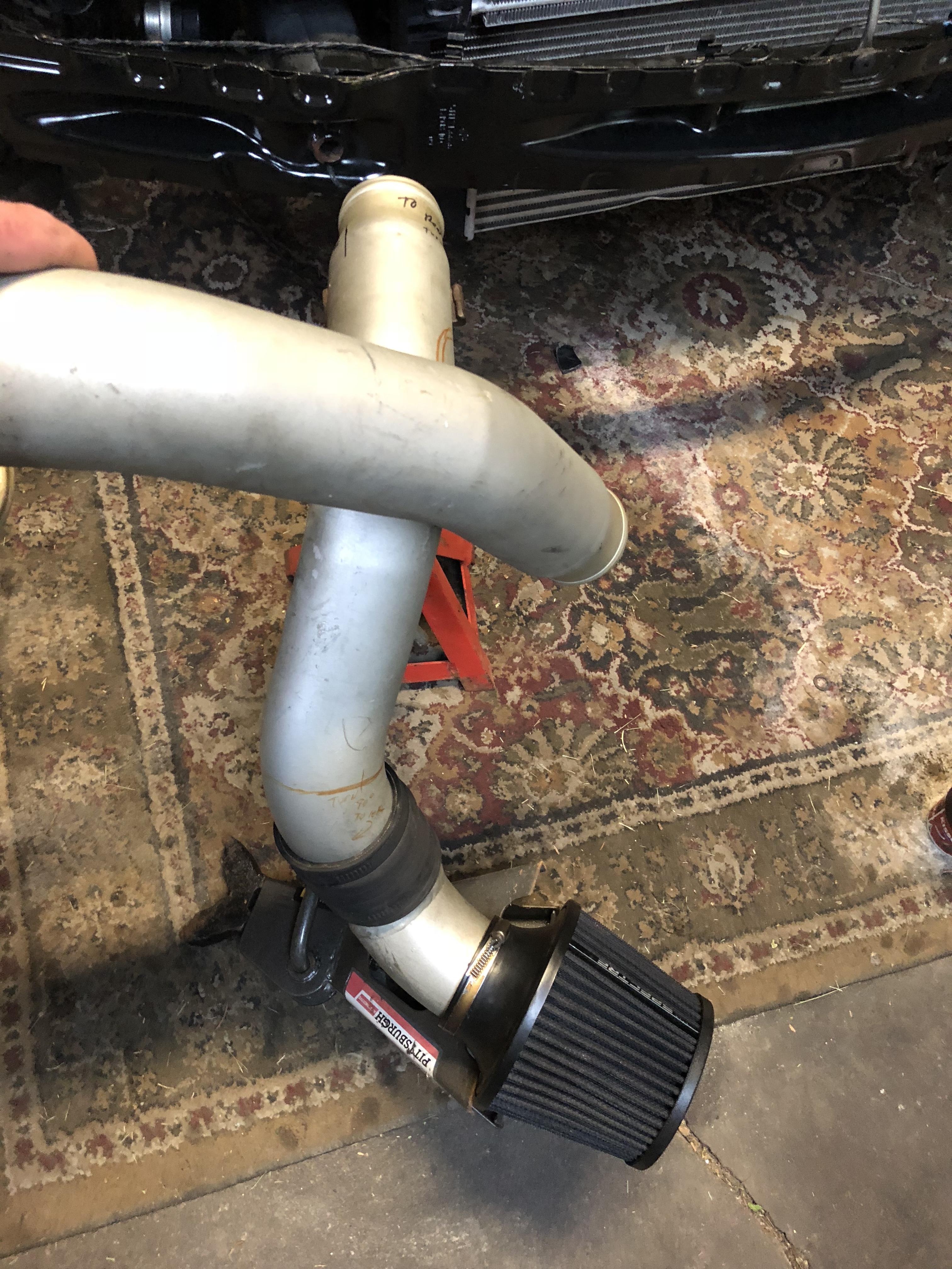

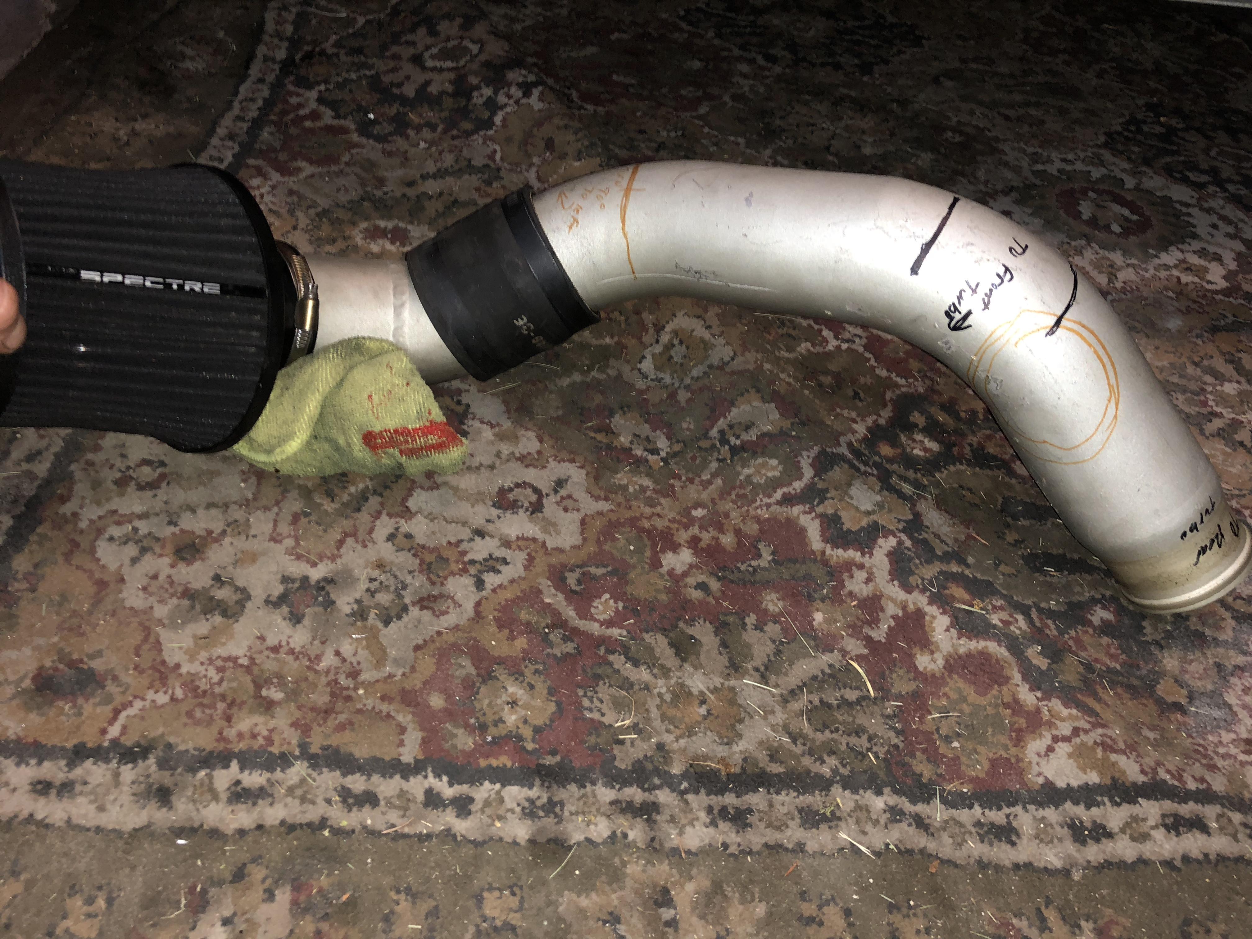

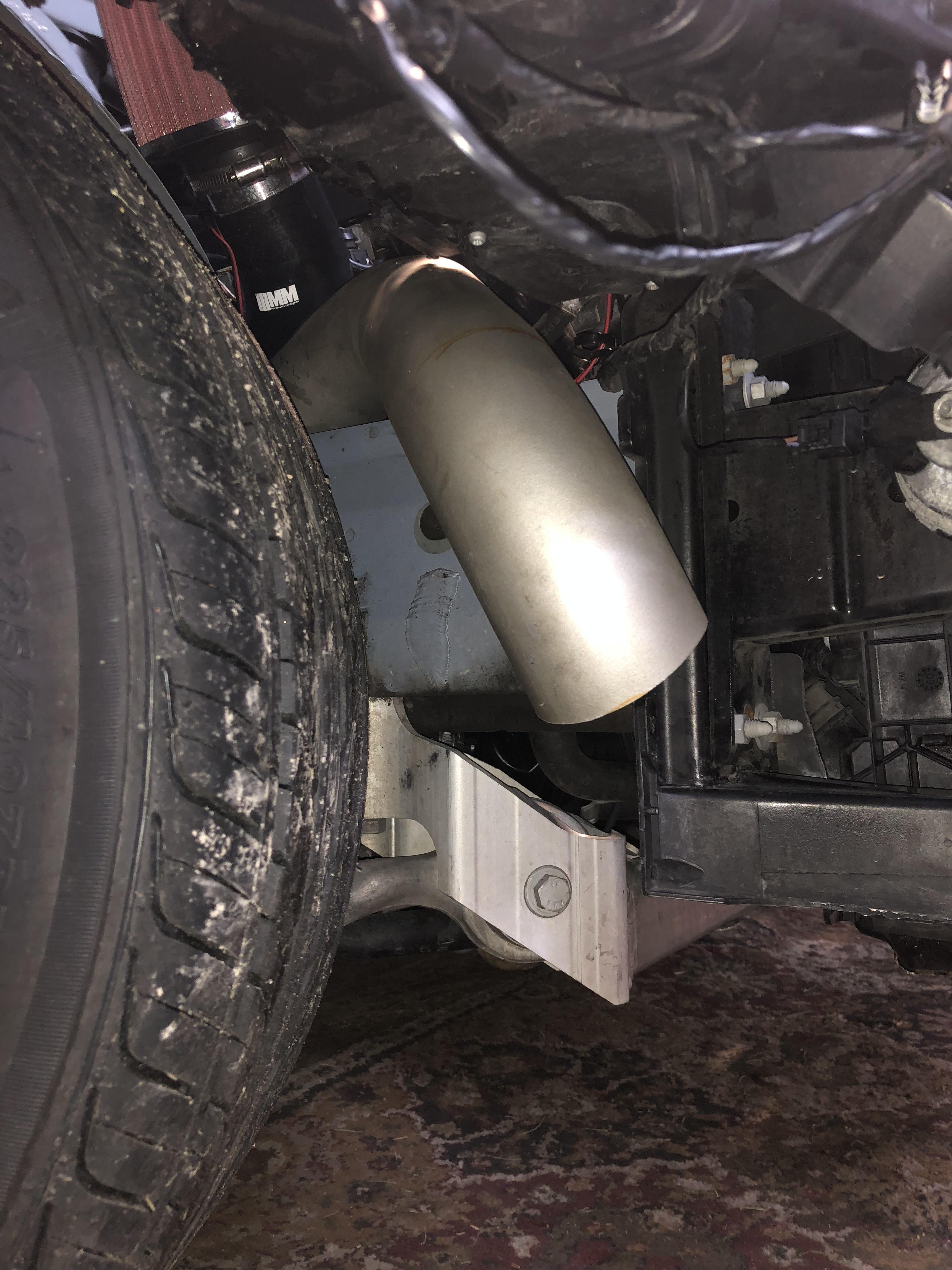

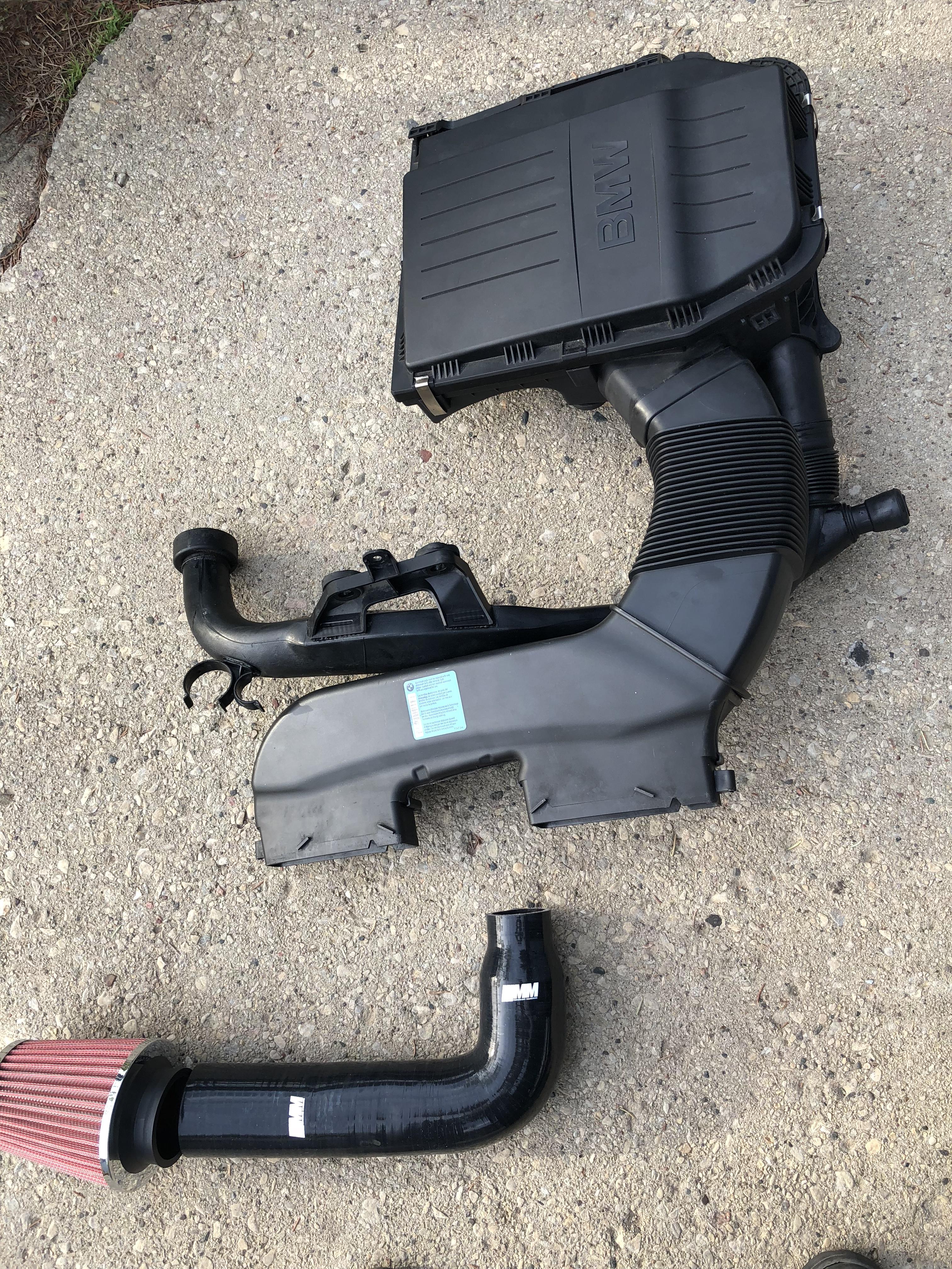

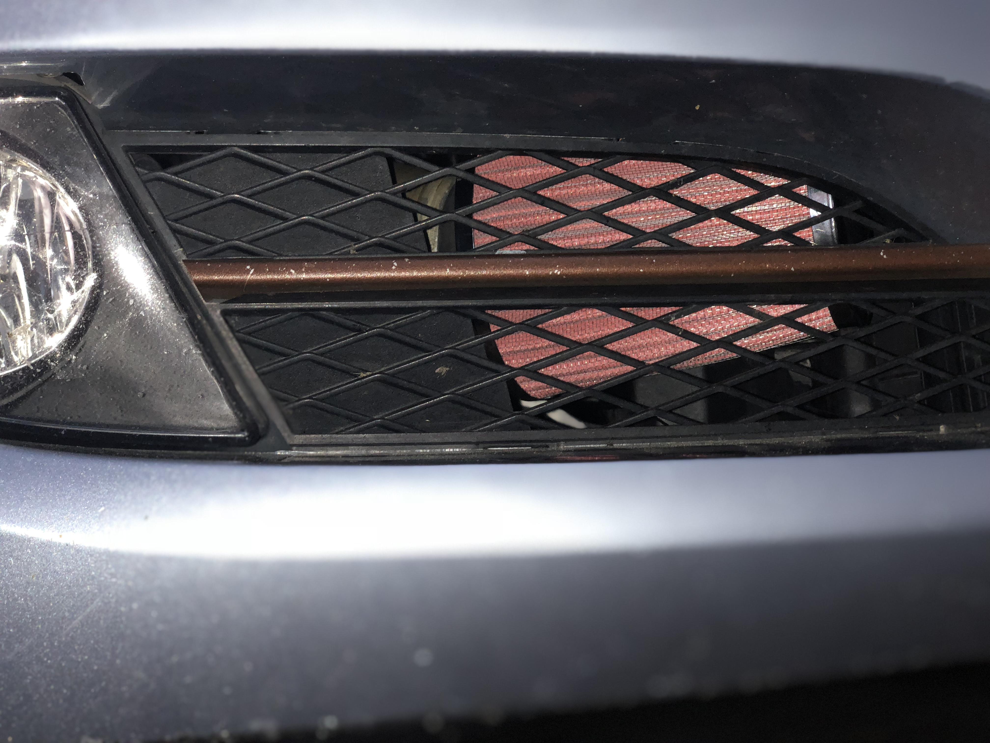

                                        well I stayed up last nite to start making my colder air relocation inlets even tho the ones from mmp are cute and all I still prefer them boxed off of colder air so this is what I came up with so far I think it will work ,I’ll have to still notch out the front pipe to turbo to connect to the other pipe basically like a Ypipe inside the bay and yea I decide to trash out some plastics on the very front wich were kindof just in the way for me ,tho I’ll still have to make the fender liner itself fit properly ..should be almost plug and play when I’m done !
                                        • D
                                          Daggerty
                                          265s, put them in the front. Interested to see how the pipe looks all welded up. Now you won't have to run the quad double double deep intercooler the n54ish guys are running.
                                          I would say make a jig for the pipe and sell them but the stuff you got rid of wouldn't be considered plug and play for the home gamers.
                                          keep it up
