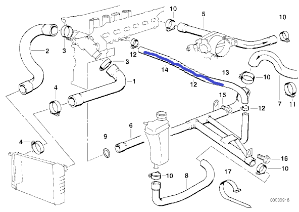

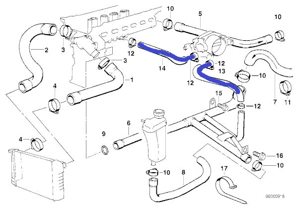

      My current question/issue involves the throttle body.
      Deleting coolant lines to the TB. Where do I need to block this off on the motor so that I don't have coolant pouring out somewhere? Is it the one of the openings on the head? Is this where I would run the E30 brown top coolant sensor? Car will not be run in cold enough temperatures for this to be useful and I want to delete/clean up as much unnecessary stuff as possible.
      edit** Looks like bypassing it is the way to do it? Taken from this thread

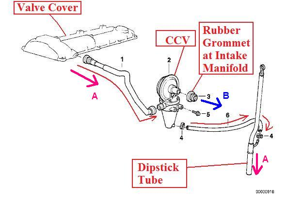

      CCV delete. I removed the diaphragm/cone circle thing(pictured below). Which leaves this hole in the bottom of the manifold(circled in red). I've watched this video which essentially shows plugging where this used to go in the manifold. Can I do this? Is there a "proper" way to do this?
      CZhnujF.jpg?2
      Are yellow and blue lines in this related to CCV?
      Can I run one of those small air filters on the crank case opening at the front of the motor? Or simply just run a hose to somewhere on the block where it will vent to the atmosphere? I was talking some of this over with @GunMetalGrey but he is not as familiar with OBD2 manifolds.

        You can plug the hole in the head where the throttle body cooling line was with an oil drain plug and crush washer.  M12x1.5 thread, same as the stock oil pan plug.
        Why did you remove the CCV?  It catches blowby oil and separates it from the air and routes it back to the oil pan via the dipstick.  There is no gain by getting rid of it.  You may even cause oil leaks because the crankcase is no longer under a slight vacuum but now has slight pressure.  Vacuum in the crankcase is a good thing, in fact there are race engines that have a vacuum pump just to pull vacuum on the crankcase.  https://www.gzmotorsports.com/SPVPK-LSX-vacuum-pump-kit.html
        On the M50 it just routes the blowby into the intake manifold without a the CCV and a fair amount of oil gets run through the engine.  The CCV is really just a factory installed catch can that automatically drains itself back to the sump.

          you can either connect the two coolant lines together, or cap both ends. either is fine for the engine, as the stock system functions in both ways. personally, i hooked mine back up like stock, but added a manual valve in place of the thermostat that was in the intake box on the e36 chassis, that way i still have the option of running coolant through if the car gets driven when its cold outside. unnecessary? maybe. but even with a 1 in 1,000 chance I'd experience intake icing, i'd rather be safe than sorry.
          another vote for keeping the CCV. if its cost of replacement you're concerned with, you can fit the smaller, cheaper e39 m5 ccv in its place. these engines burn up enough oil already, do you really want to burn through more unnecessarily?

              So after doing some more reading and taking your suggestions into consideration, I will keep the CCV and just order new hoses for it.
              Is there any issue with the hose that drains into the dipstick now that the oil pan is in the front as opposed to the back? Or should routing the house really not be that big of an issue? I'm having a hard time imagining what the distance between stock S52 oil pan location and M50 oil pan location would be.
              Hose #6 in the below diagram. Which is this part 11151740393

                I don't think the dipstick location should matter.  You might have to fabricate a support for it.  Also compare lengths to make sure it will indicate the correct amount of oil.
