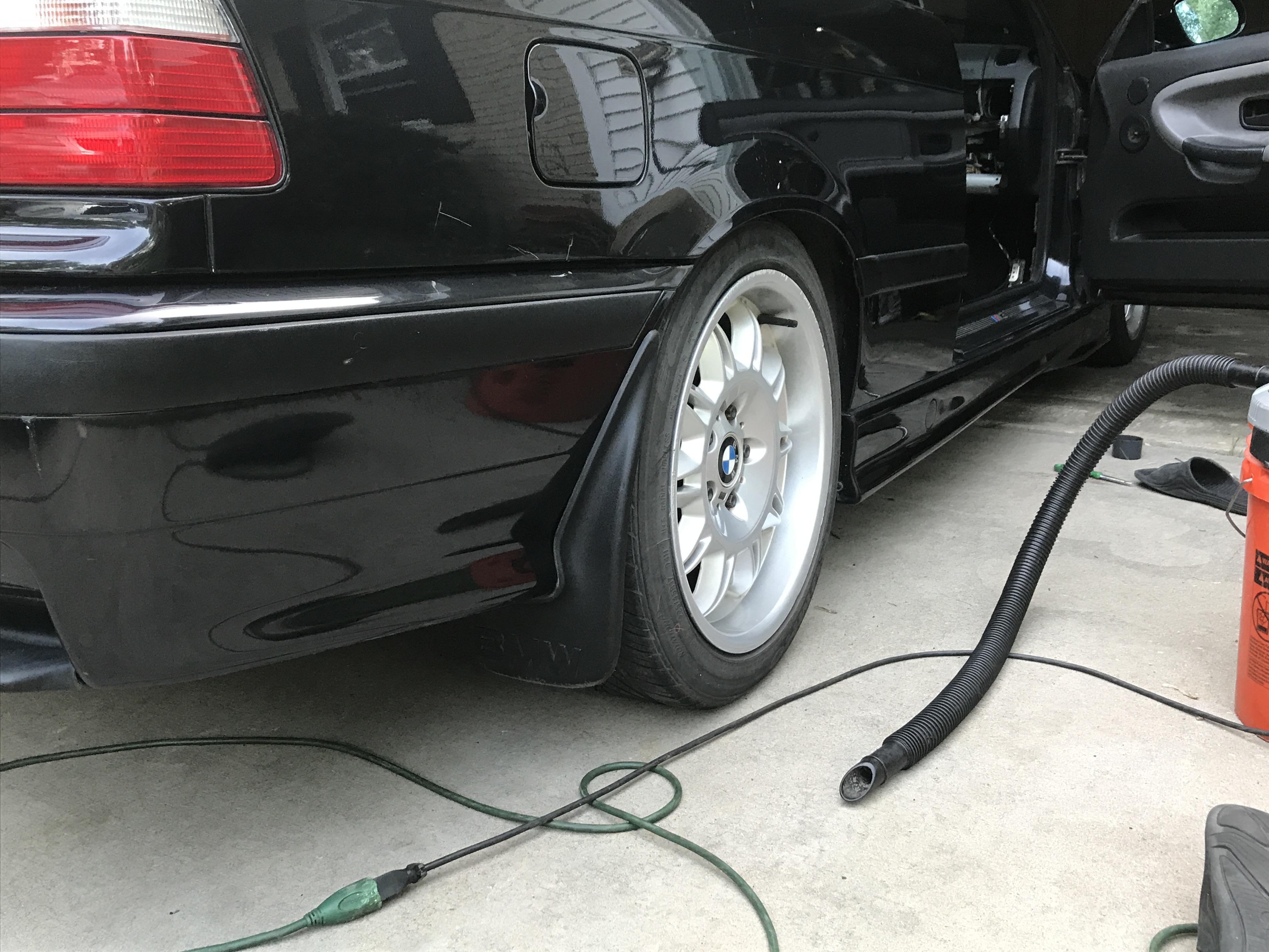

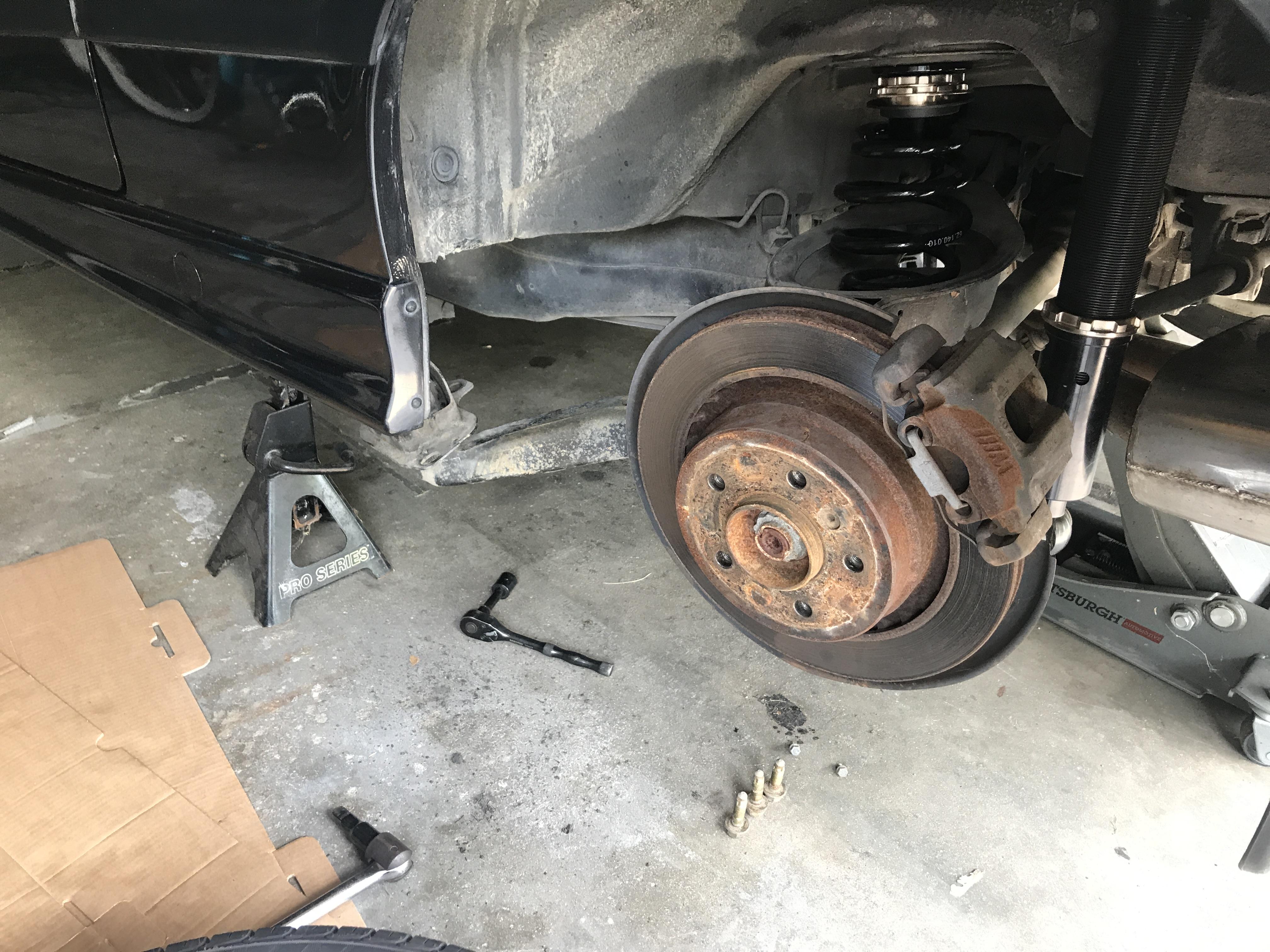

        Did some suspension adjusting today and threw the rear wheels on finally
        Rear wheels rub when I hit bumps, I might have to go up a hair all around. My front and rear arches are mildly rolled already, so i'm going to rent a fender roller and roll them a bit more. I have adjustable rear control arms sitting in my garage, but I don't wanna have to run excessive camber and it's a pain moving the diff forward to put them in etc.
        I was going to do my rear sway bar bushing and links today, but the bushings don't seem like they could possibly fit
        I was trying to force the bracket around the bushing, and there is no way it's going in like that. I don't know if ecs sent me the wrong bushings on accident, or if I'm doing something wrong. A few years ago I was going to do the front sway bar bushings on my old M3 and I had the same problem. Bad luck twice?

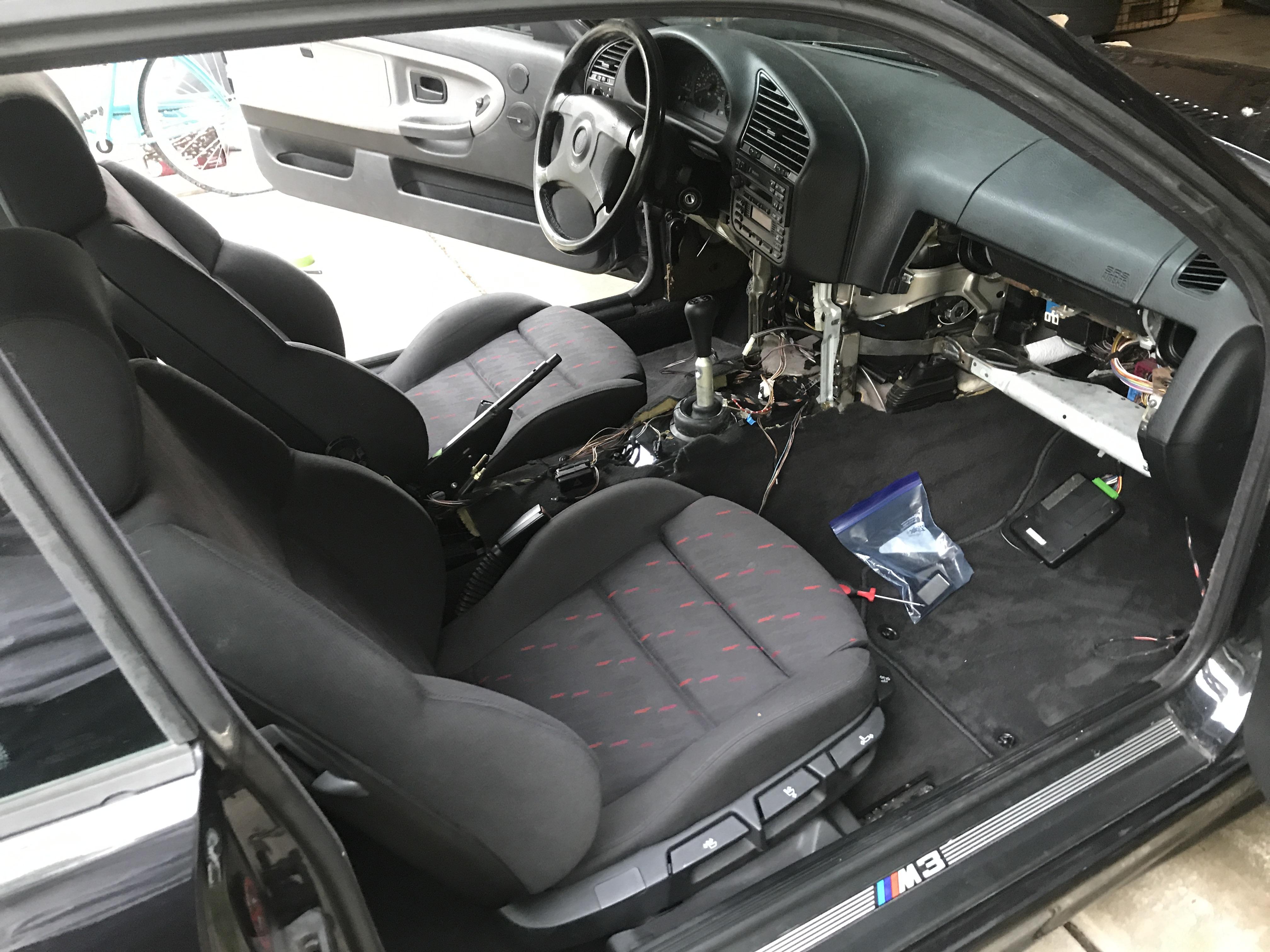

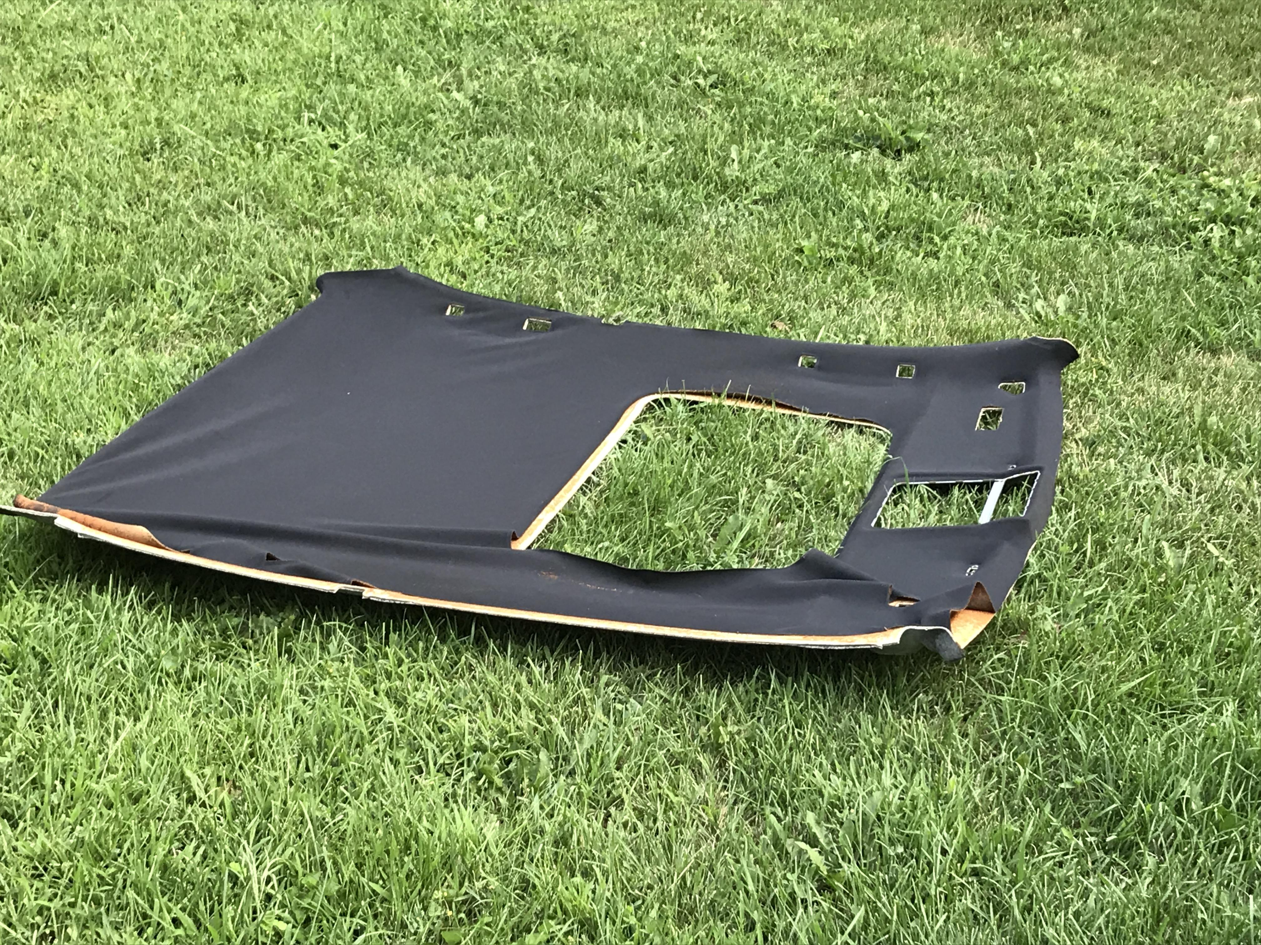

                                Quick little update, I really need to start busting my ass on this car so I can have it daily-driveable for school
                                Washed my floor pan like a weirdo and put my black carpet in, I haven't replaced that firewall gasket still but the dashboard can come out with the carpet in. The car remains garaged 24/7
                                Putting a carpet in is always a PITA
                                Got some mudflaps from a guy on Bimmerforums for $10
                                Took my really bad sagging headliner out, glad I got it out before that foam/glue shit started getting all over everything. Very hard to clean off, happened on my last M.
                                I put all the handles and visors back in, probably just gonna drive it like that for the fall

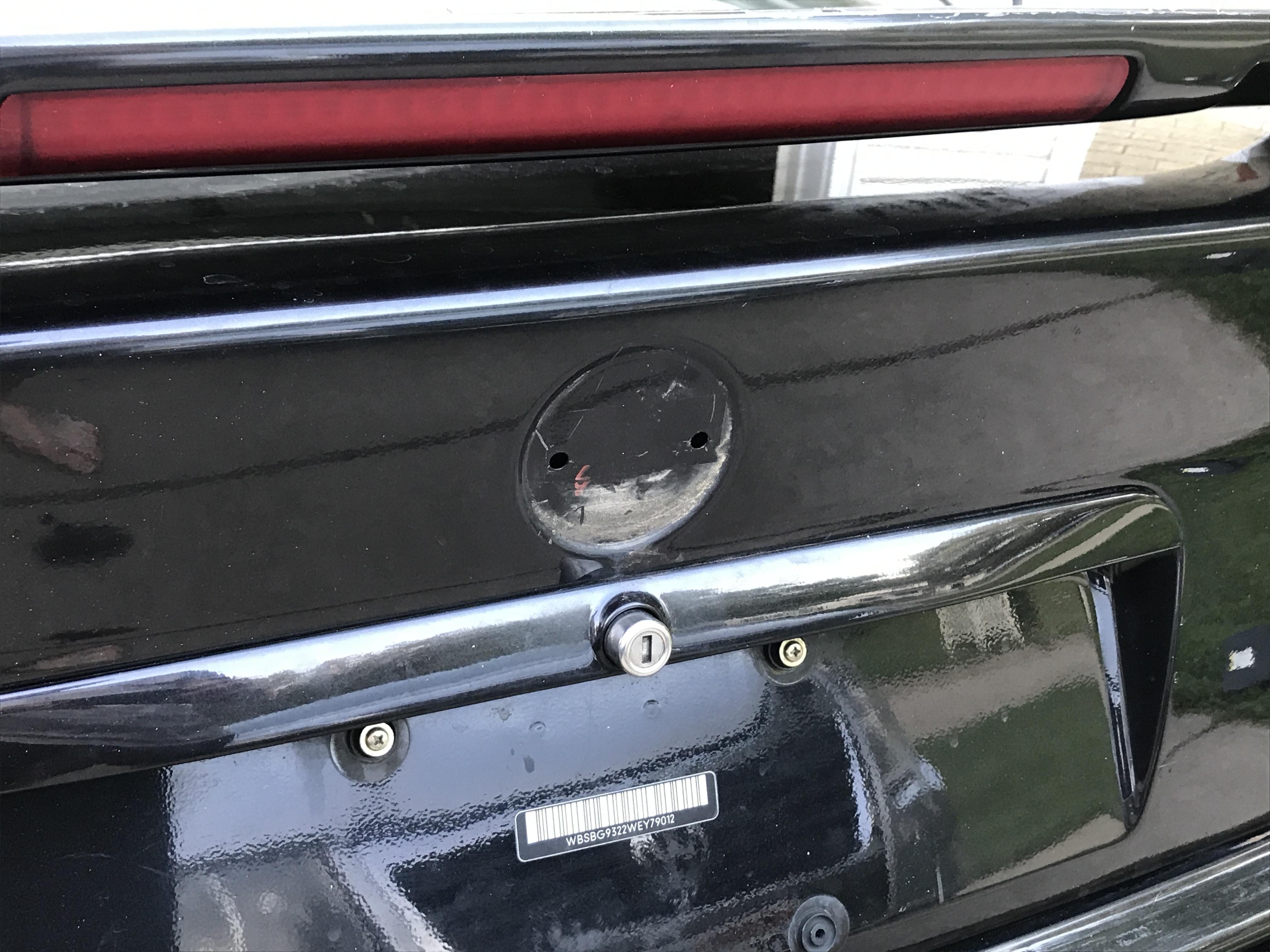

                                I also tried to replace my rear emblem that was flaking apart, I got lucky and found a oem one off a e60 (same size) at the scrap yard.
                                It was surprisingly hard to take off, it took a ton of force and I scratched the paint behind the emblem up 😐. The little pegs broke off inside the grommets. I ended up ruining both grommets getting those pegs out, so I have to order some of those.
                                Check out that orange peel. I'm gonna guess this trunk is a respray, at least it has the vin still
                                I also lined up my bumper and fog lights and it looks 1000x better then before

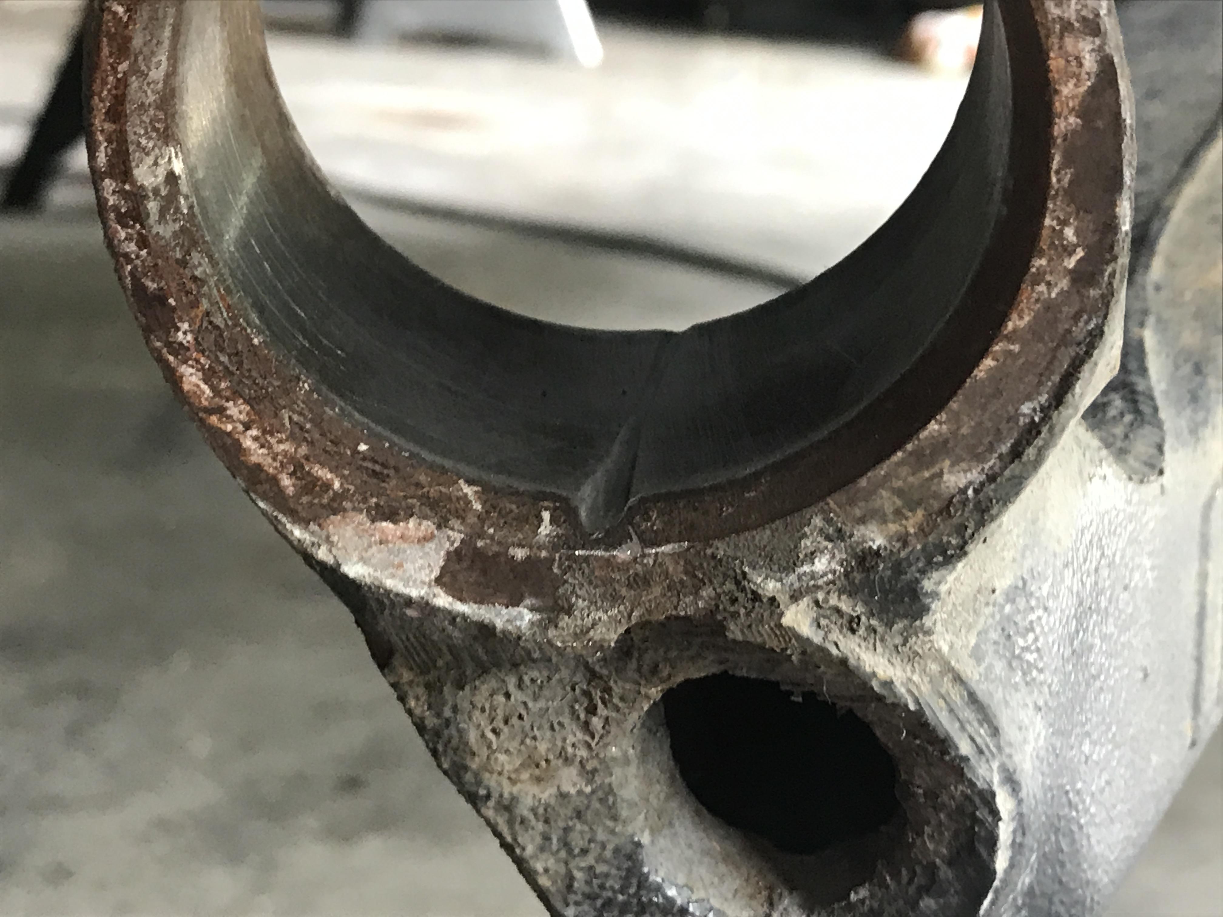

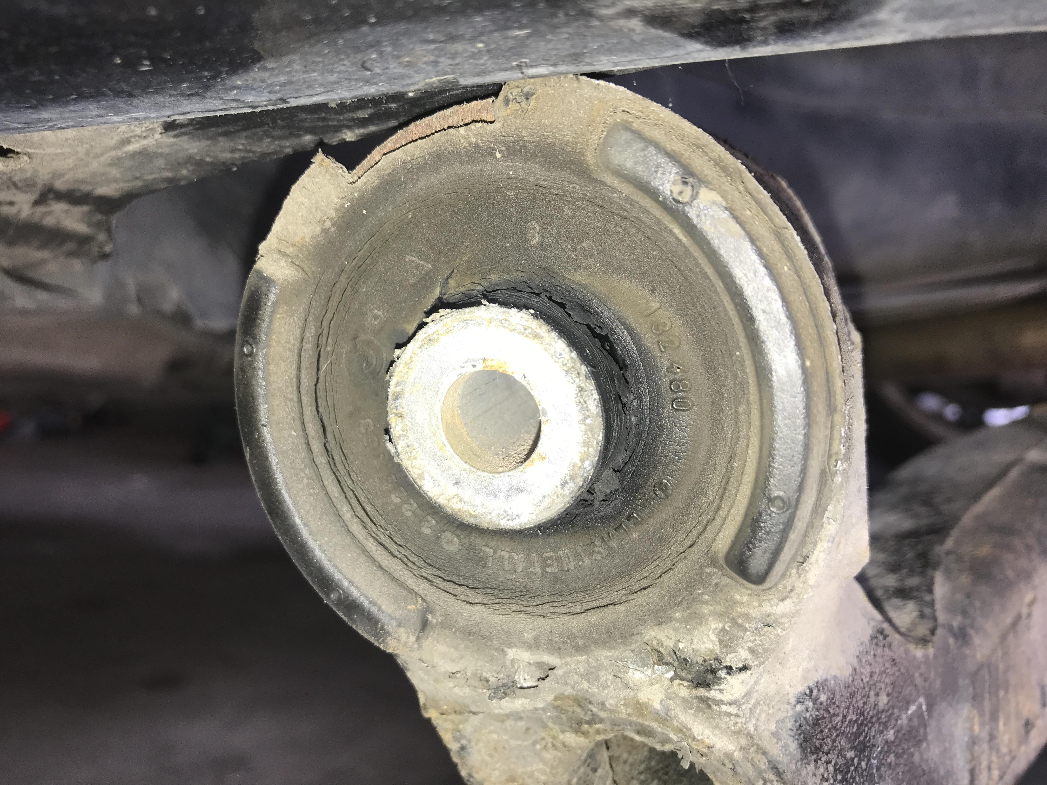

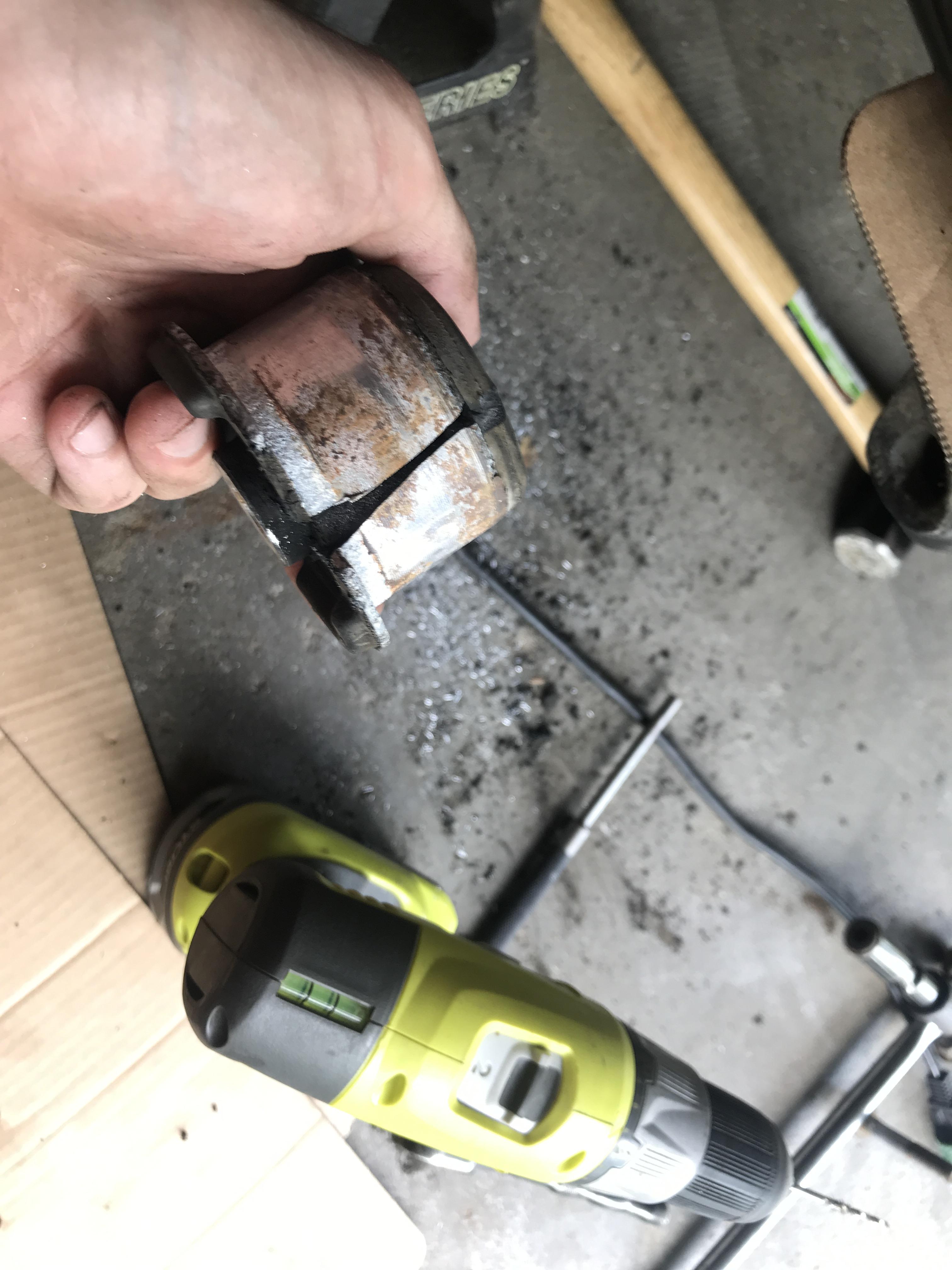

                                          Currently doing my RTABs,
                                          Blown out pretty bad
                                          The drill method worked pretty good, but I left a small notch in the trailing arm. Opinions on if it'll ever matter? It's obviously not huge, it's in the thickest spot of the arm and it's circular so it wont crack I'm thinking. The poly bushings went in snug

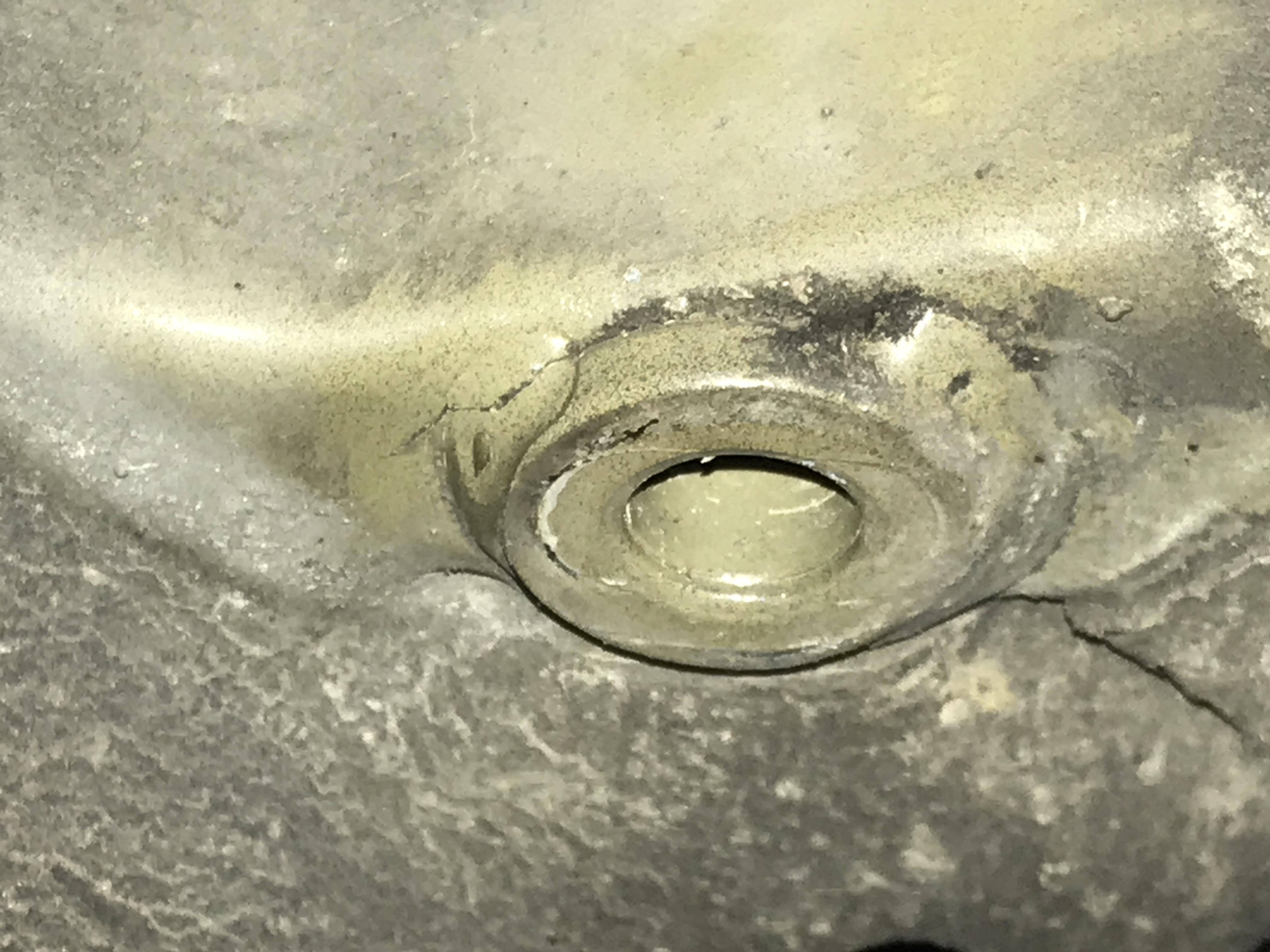

                                          So I have the poly in, everything torqued and the arm is back in the car on the drivers side. unfortunately I found a small hairline crack at the mounting point. I'm not going to risk driving on it, so I need to have it welded and reinforcement plates welded in ASAP, I only have 2 weeks before I go back to school. Can anyone recommend a shop that will do this right? I don't want it rusting or anything like that because a shop didn't prep it right.
                                          I hit it with some sand paper, and it is indeed a crack. The other side is the side that clunked bad, so fingers crossed
