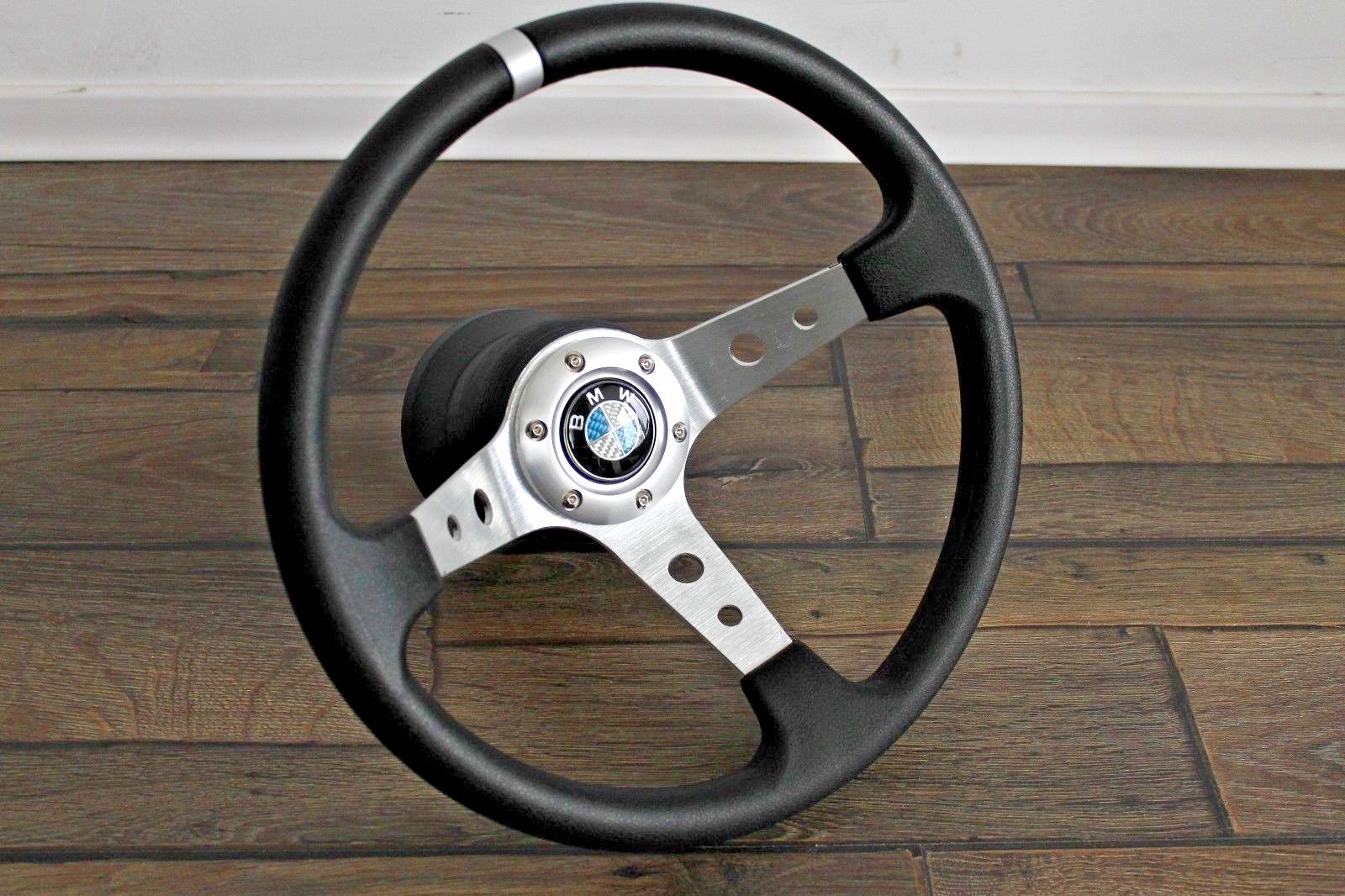

    I have a non-airbag vert steering wheel in my E30 right now. I'd like to get something a little smaller diameter (360-370mm), and a little fatter.
    I dont particularly love the M-technik steering wheels but I prefer the M-tech II wheel. They are priced like a dang S52 though so im not too keen on spending over $250 (normally they are $450+) for one.
    Aftermarket stuff may be questionable in terms of rigidity/quality/fitment. I dont want something too close or too far away, or that has an adapter hub that makes it look gaudy.
    My car is not a stripped racecar, its not pristinely buffed show car, its just an enthusiast's toy and I would just like for the wheel to be comfortable and not look horribly out of place.
    I have only began looking but let me know what you can find, what info you may have on steering wheels, or any opinions.

      In my opinion I wouldn't mess with a cheap steering wheel. Very unsafe and I have seen instances where the wheel brakes. Personally I wouldn't buy an aftermarket wheel under 180$ But make sure its from a reputable brand like Key!s Racing, MOMO, Nardi, Grip Royal, OMP, ETC
        I've heard mostly positive things about Renown wheels, and I really like the look of their Clubsport and 130R wheels in particular. If I remember correctly, I think @straight6pwr has a Renown in his car so maybe he could weigh in as well.
        http://www.renownusa.com/
        You also need a hub adapter for these to work, it's about $80 for a MOMO one which seems to be the go-to for most people.
          I really like the MOMO mod 78 and Monte Carlo. I currently have them in 2 cars. Whatever you buy, go name brand.

              For the wheel itself, I'd stick to mainly name brand wheels like MOMO, sparco, OMP, Raid, etc. I've heard good things about Renown as well.
              I really like the 360mm Raid wheel mounted to a MOMO hub in my car (with an aluminum 10mm adapter in-between). Its very sturdy, and I like the style of the flatter face wheels. It's actually the same steering wheel as what came in most Lamborghini Countach's from the factory, but I just don't have the horn pad. Also, as a tall person, a more 'flat' wheel is at a comfortable distance from me though maybe still a little close to the turn signal/wiper stalks.
              For an E30, you'd want the MOMO #2006 wheel hub. They're technically designed for the non-airbag column but you can fit them with a spacer between the hub and a nut like any other non-airbag stock wheel. They're around $90 to buy new, but I got mine on ebay for about $60 as a new/open box item. Did a quick search and found this used one for $40 if you don't mind it being used.

                  My turn signal cancel still works with the MOMO hub, as does the steering wheel lock when the key is removed
                  The prototipo is probably my favorite MOMO wheel, and had I not found the Raid that's what I would've gotten.
                    I would like to suggest looking into a Momo Corse wheel. I have had two of those in my time, and they are time-less, fit the hands well, come in almost any size and finish possible, and can be had for $100-150 with an adapter. The or Monte Carlo isnt a bad option either, I just think the proportions look odd to me.

                        i like my Renown wheel, and the quality is good. i was fairly concerned with keeping my car OEM looking, and i think it blends in well with everything else from the factory.
                        it has great ergonomics at 10/2 and 9/3, but not good across the spokes if you like to rest your hands there. the BMW horn button is a plus, as well. fits with a momo hub, turn signal cancel feature works still. it is strong, none of that ebay flexible crap.
