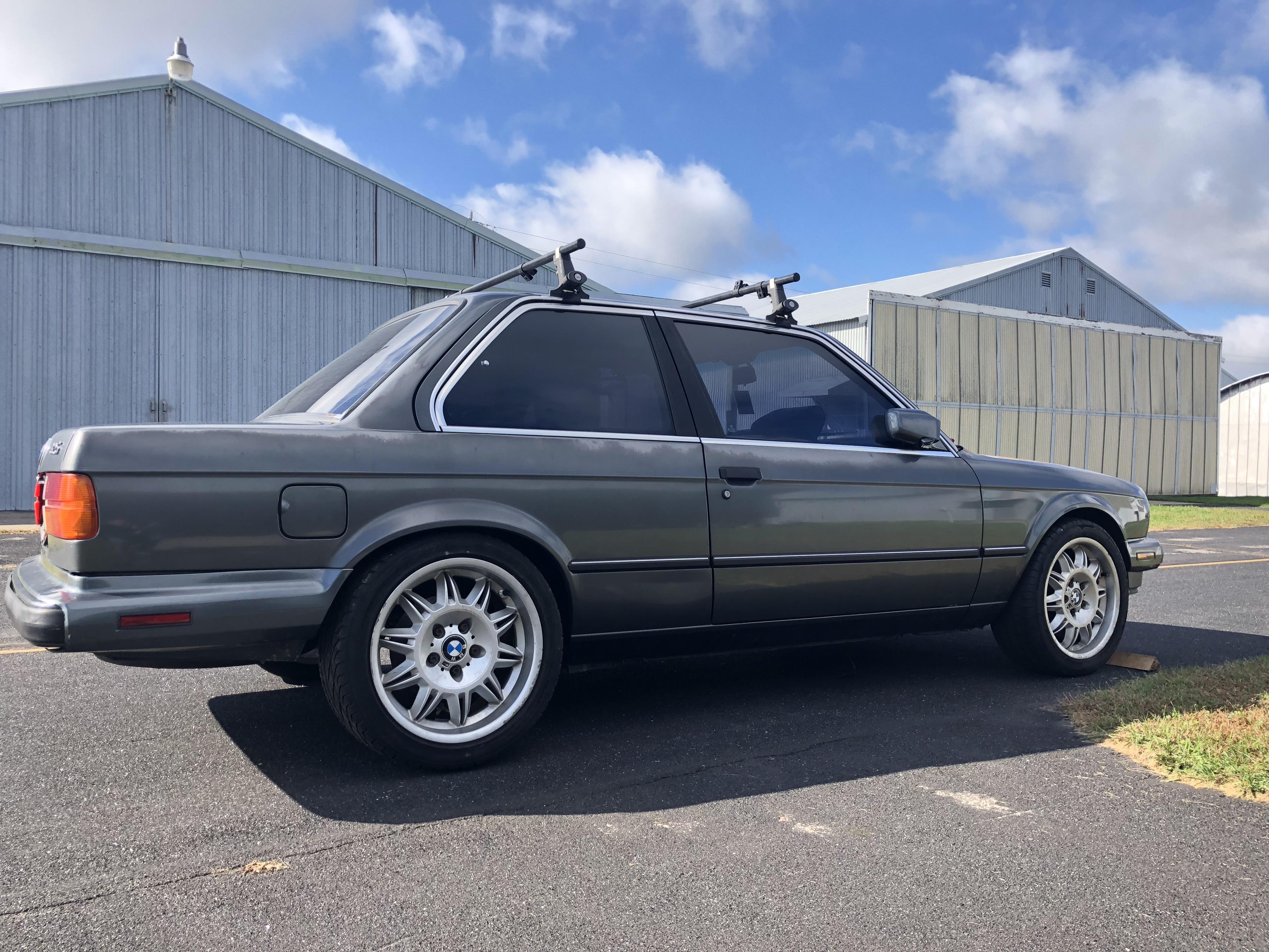

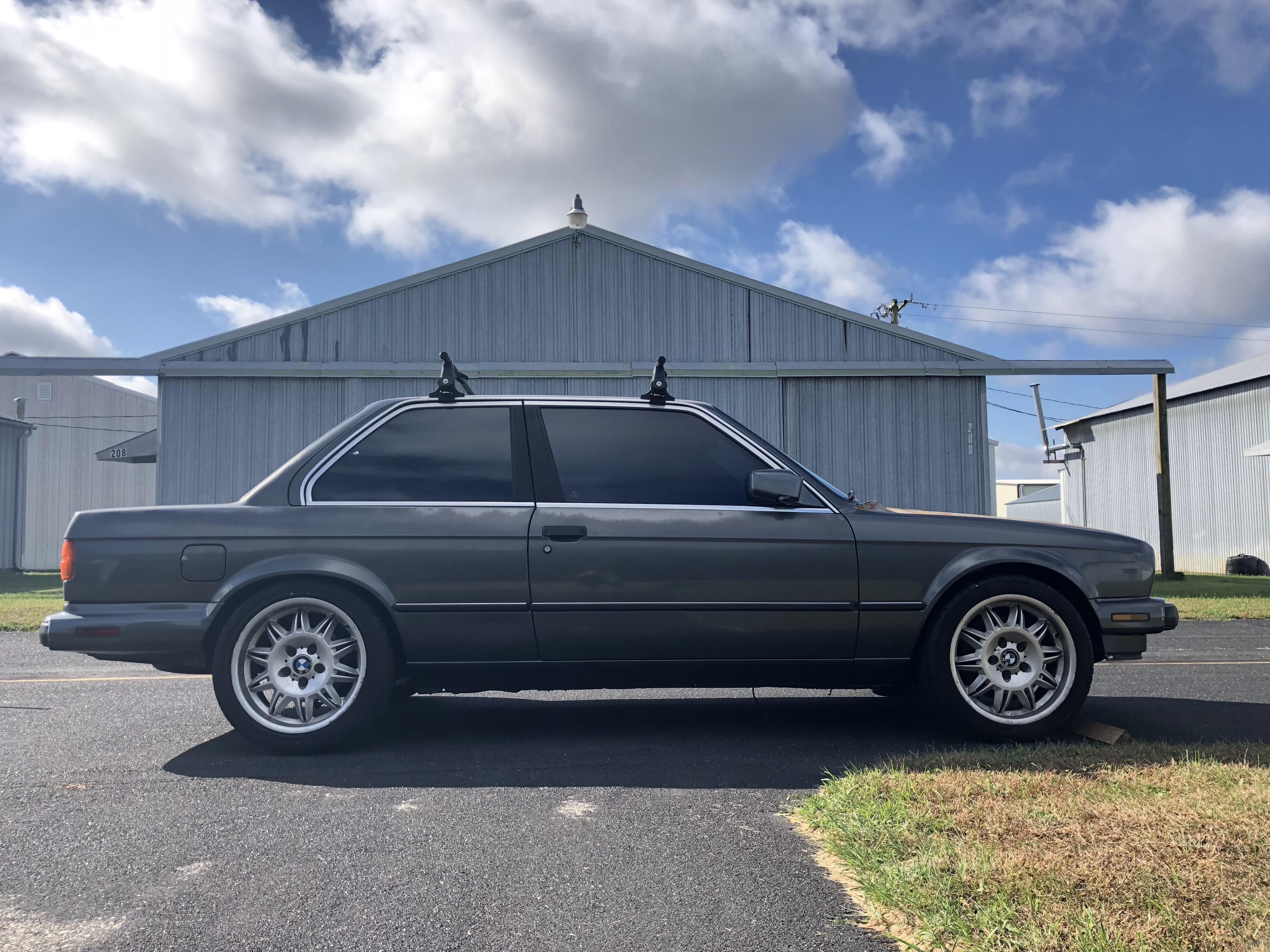

                          Looks great!! Are the DS2's on adapters or did you do a 5-lug swap?
                          • AJK430A
                            AJK430A
                            AJK430
                            #27
                            No adapters. Its for real.
                              #28
                              Awesome! What did you use on the rear?
                              • AJK430A
                                AJK430A
                                AJK430
                                #29
                                z3 components
                                  #30
                                  AJK430 said:
                                  z3 components

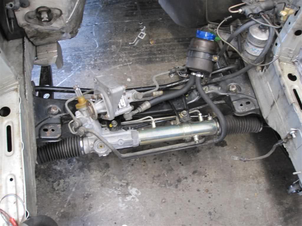

                                  Nice, I have been thinking of selling my setup (but don't own any 4x100 wheels so I want to stay 5 lug) and have been considering switching to some sort of e36 m3 combination. Have you noticed any brake bias or handling differences from stock geometry/brakes?
                                  • AJK430A
                                    AJK430A
                                    AJK430
                                    #31

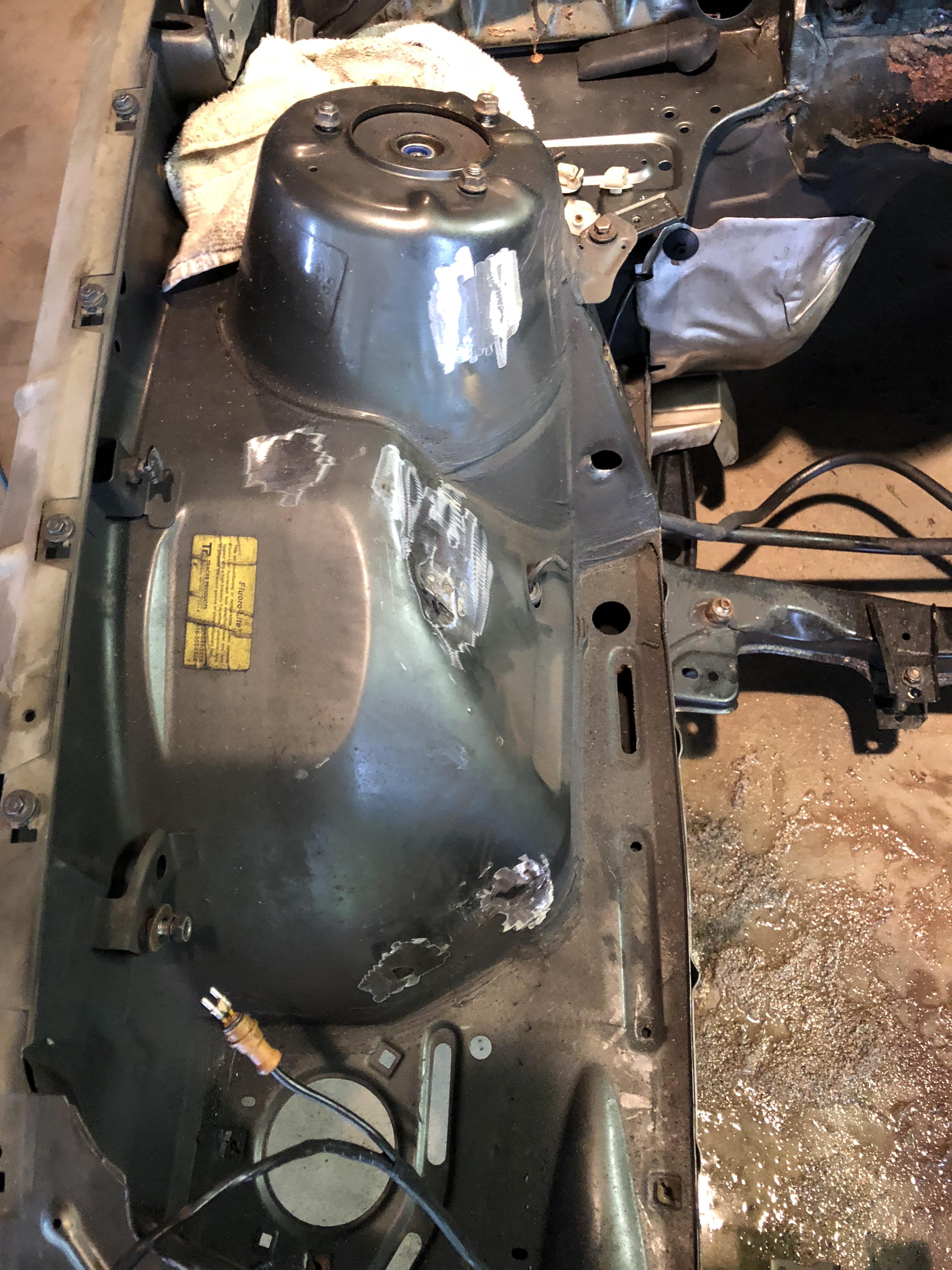

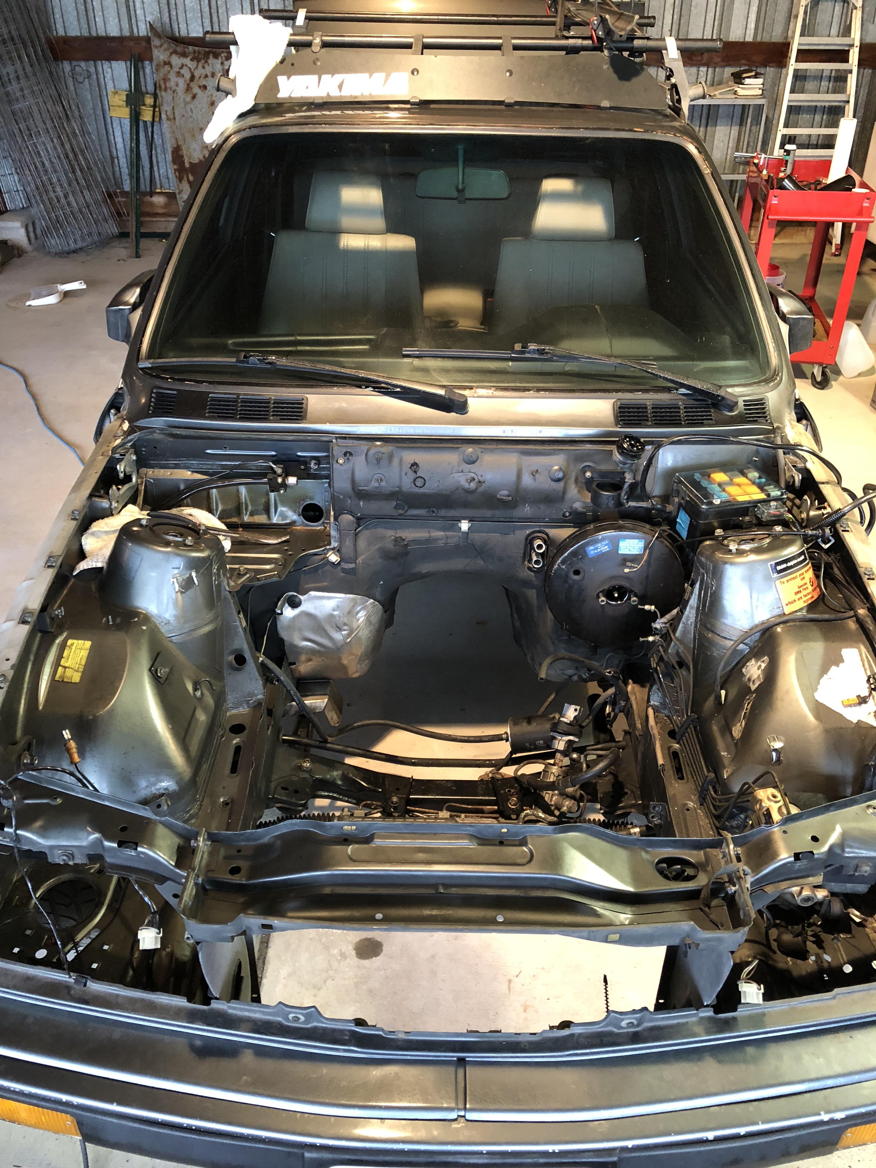

                                    Well considering the engine isnt in the car and its basically just a roller I have no opinions to share. Other than the brakes are massive and according to everything I've read the parts I've used are the best set up for the e30 in regards to handling improvement (late e36 m3 control arms up front)
                                      #32
                                      Fair enough haha, it didn't click in my head that the empty engine bay pic went along with the suspension swap, I'm definitely interested to hear how you like it once it's on the road!

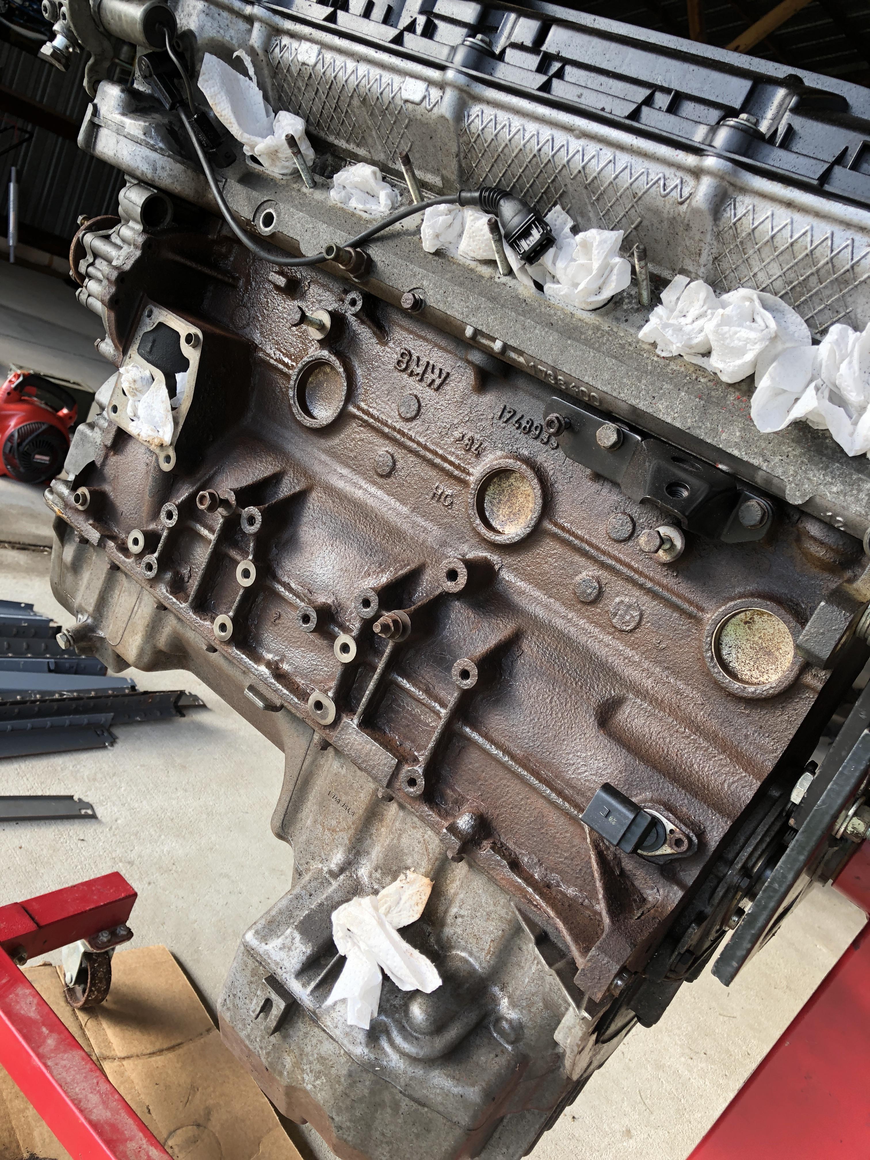

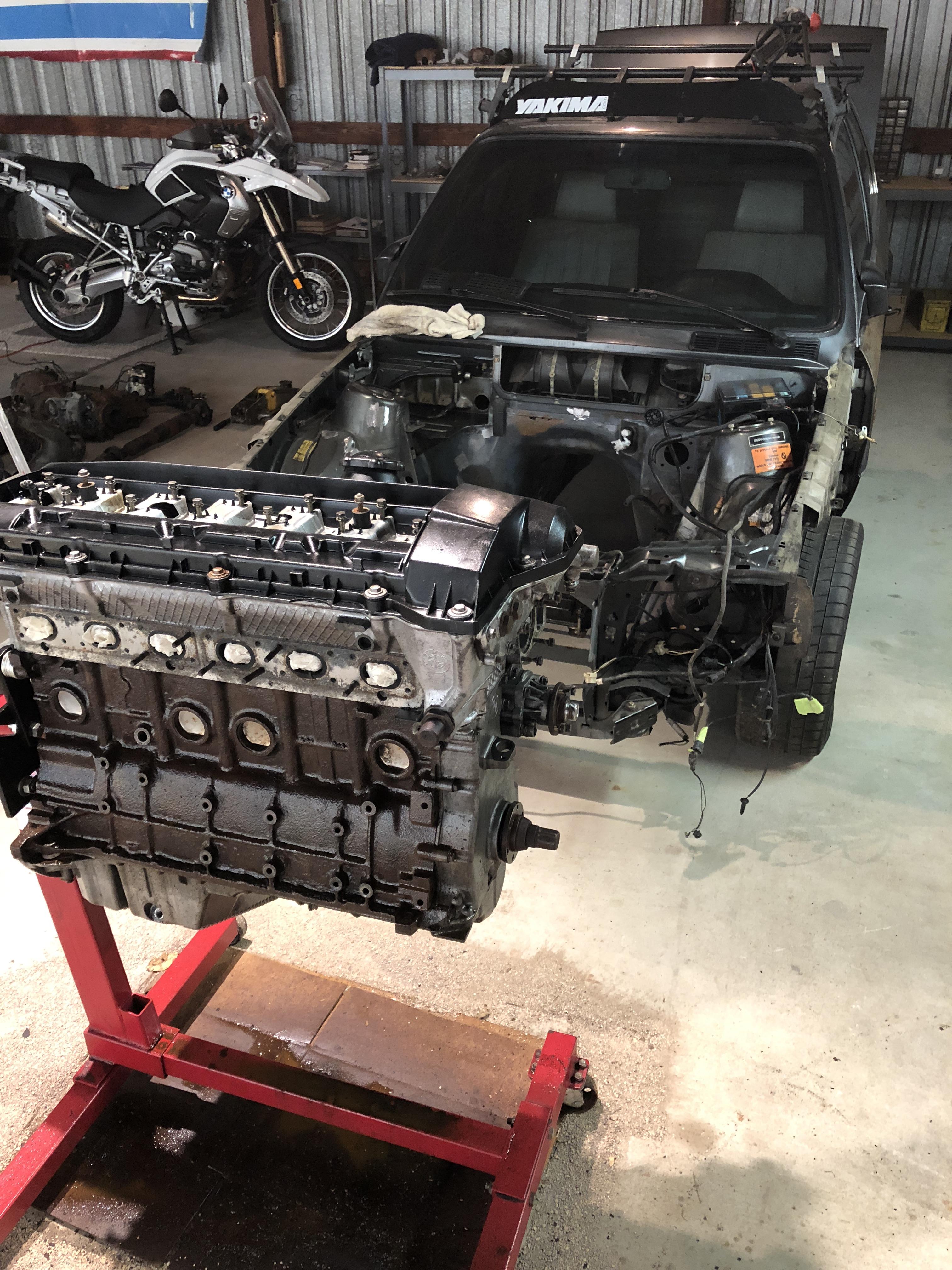

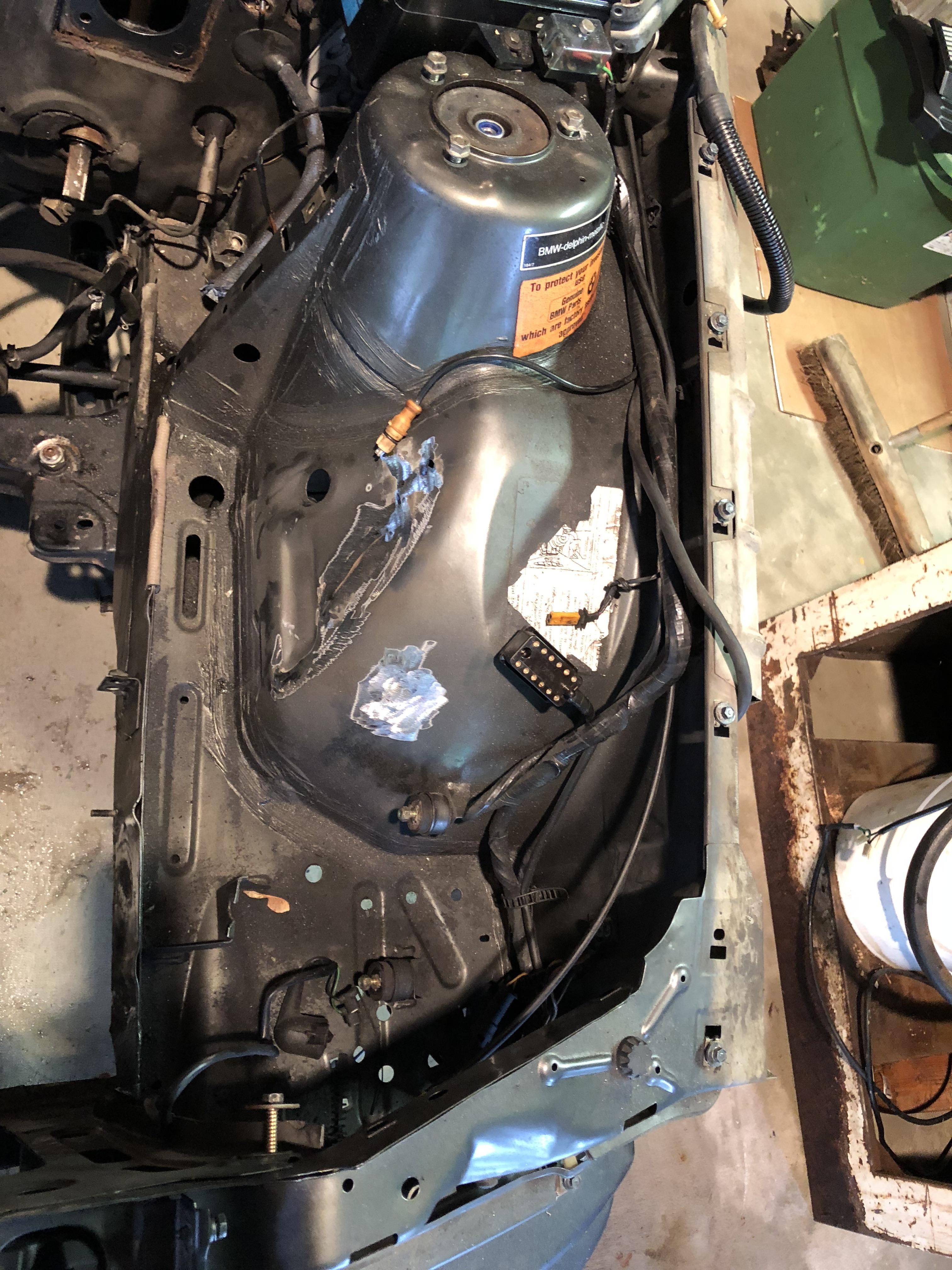

                                        haha yeah. So am I! I didnt make much progress this summer due to work travel but Ill hopefully continue to make progress now. At this point im cleaning up the bay, Im going to tuck as much as I can and clean it up. Probably just paint the bay black and be on my way to engine install.
                                        • AJK430A
                                          AJK430A
                                          AJK430
                                          #34

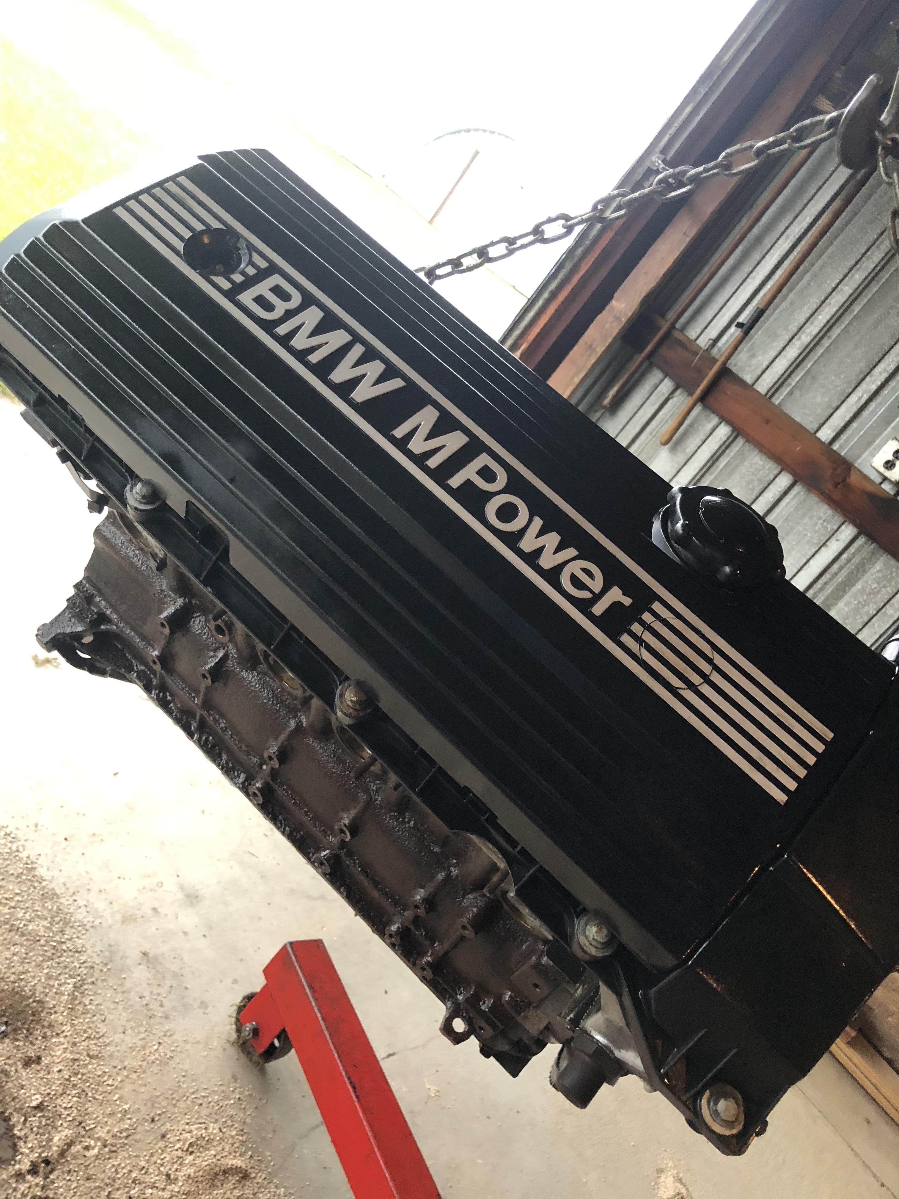

                                          Alot of behind the scenes progress so to speak as far as acquiring information and components for my harness. I've got the harness out of the donor car, ill be working on getting that crossed over to utilize the C101 to mate to the chassis of the 86 e and deleting whatever isn't necessary. Also a ton of time spent cleaning up the engine and bay, deleting brackets for a mild wire tuck and chipping off and wire wheeling 20 years of crusties off the S52 cast block. Also still have to swap the pan and sump, build a dipstick with CCV and safety wire the oil pump gear on.
