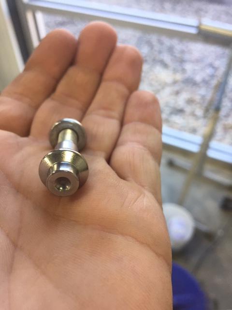

            vinegar removed both the paint and the zinc plating of my style 5 bolts. however, the style 42 bolts are titanium, i believe, so maybe its safe to do that? otherwise, i'd suggest something more specific to paint removal that wont harm the plating.
            pro tip: put the bolts in a hand drill chuck and use the rotation to help with cleaning/polishing each bolt head.

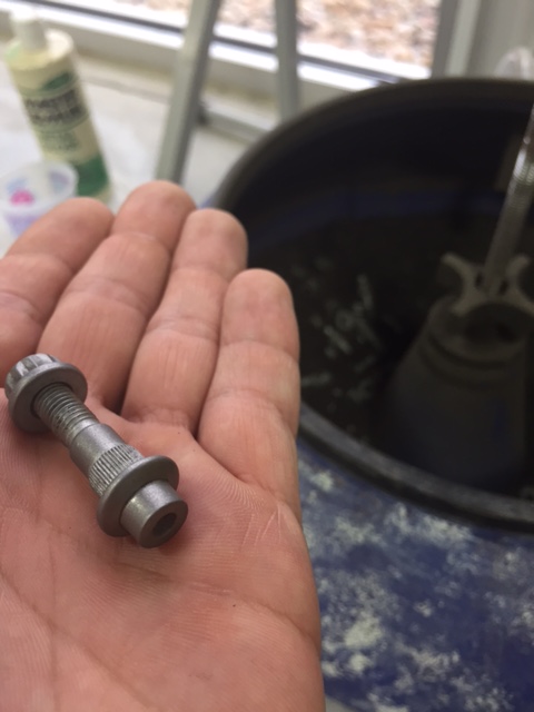

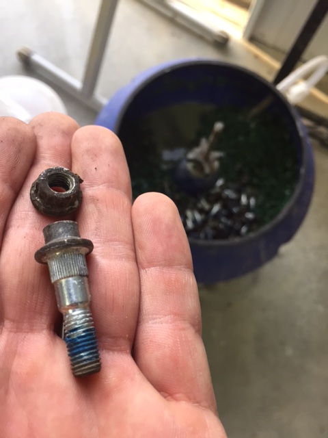

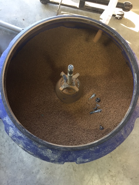

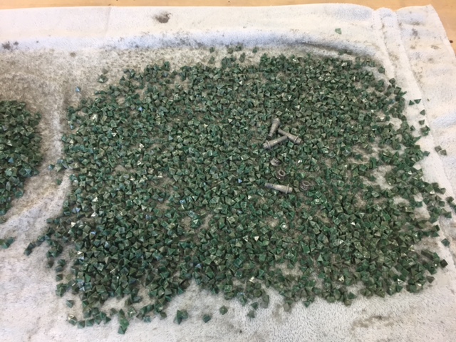

              I wrote an entire thread about refinishing wheels and never posted it...
              Anyways.. they look like someone painted them once before in the past. That is the factory paint/ powdercoating flaking off of the rim faces. The aluminum underneath somehow (rockchip or curbing?) was exposed and started to corrode under the finish. This normally happens from road salt and other caustic materials reacting with each other. The material contamination then expands and pushes the coating off of the wheels causing the flaking. ( Similar to water freezing and expanding)
              I would suggest vinegar or aircraft remover on the bolts depending on how fussy the coating is to remove. I would then tumble clean them( plastic or stone media as this will remove contaminated from the threads too without harming them)  followed up with a tumble polish (wallnut or corn husk with a polishing medium added).
              The following are the stages I described:

                Thanks for the info guys. Kinda what I figured. What size tumbler is that? I need to purchase one.
                    Its not a very large one. Harbor freight sized. LOL.
