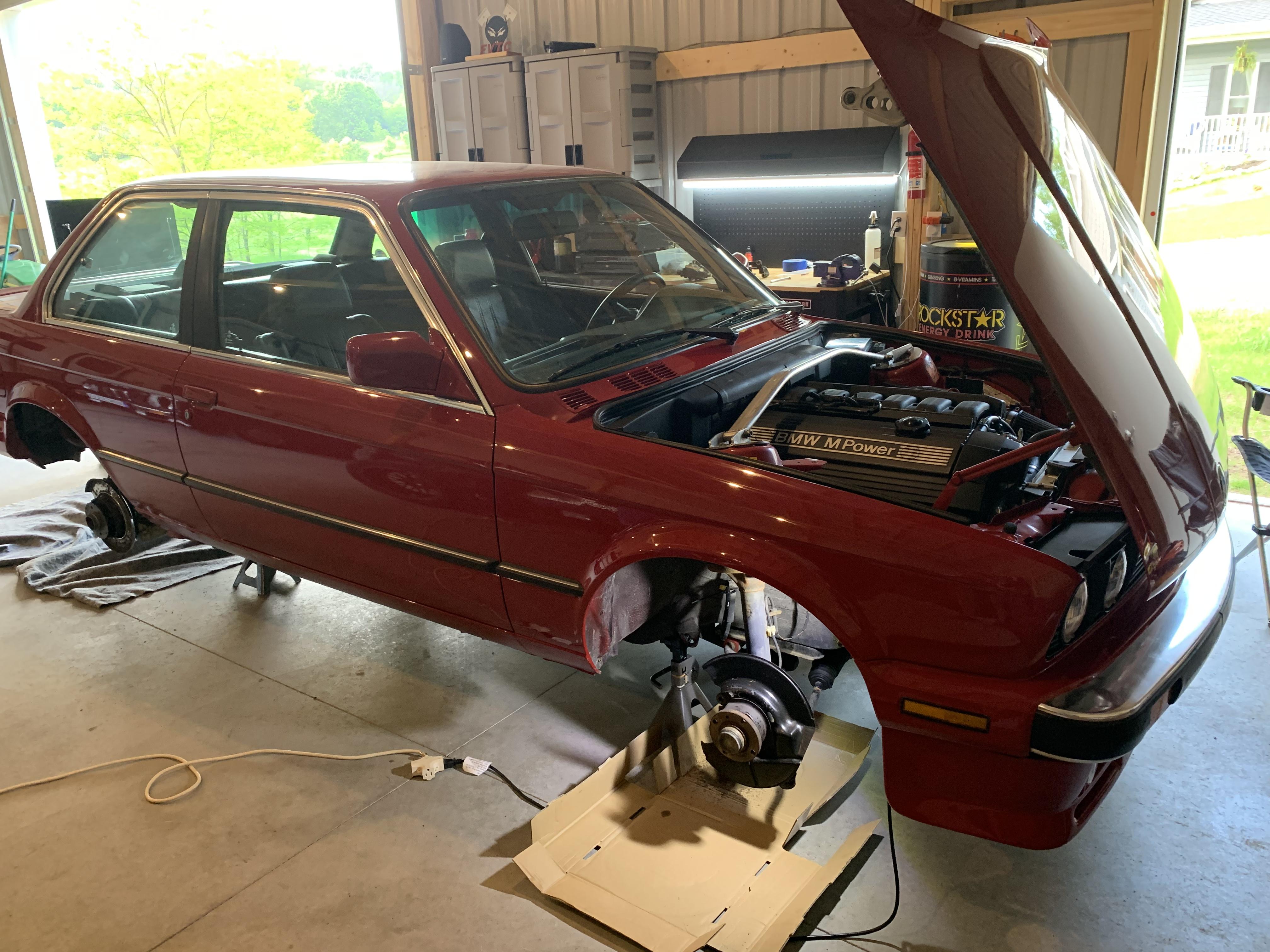

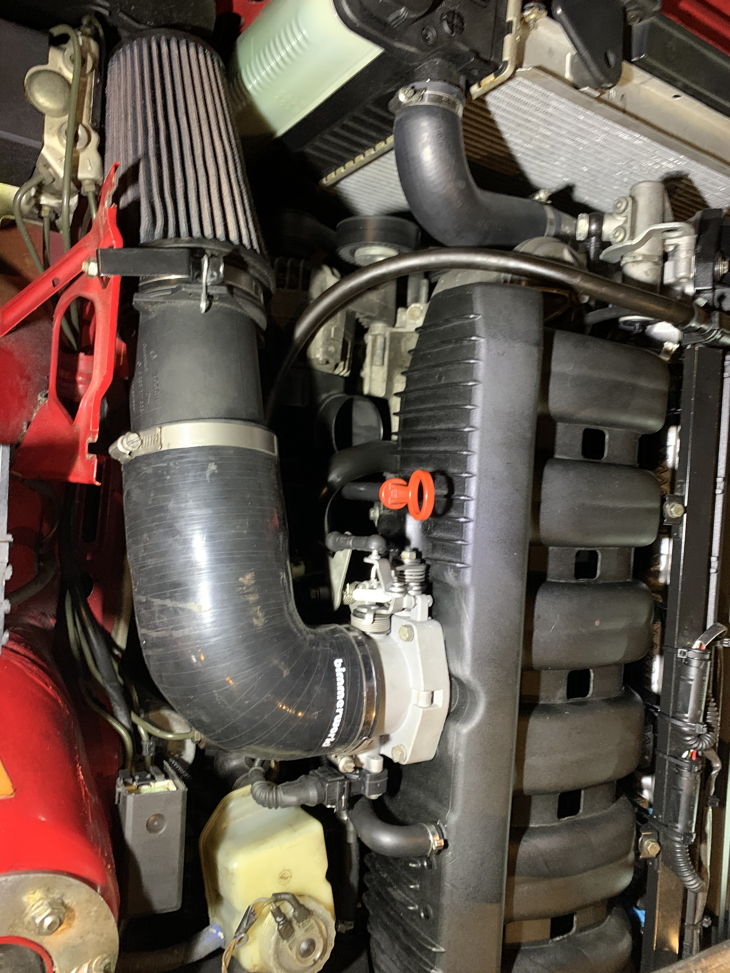

    Progress... 😄
      #31
      Relocating stock booster or going ix/944?
      Staying OBD2? What's your plan for engine to body harness?
      • timmerT
        timmerT
        timmer
        #32
        Using an e21 brake booster, and a custom wiring harness...the guy doing the swap is a wizard at making harnesses.  Keeping full OBD2 functionality.

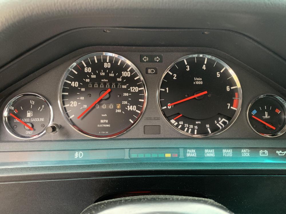

          #33

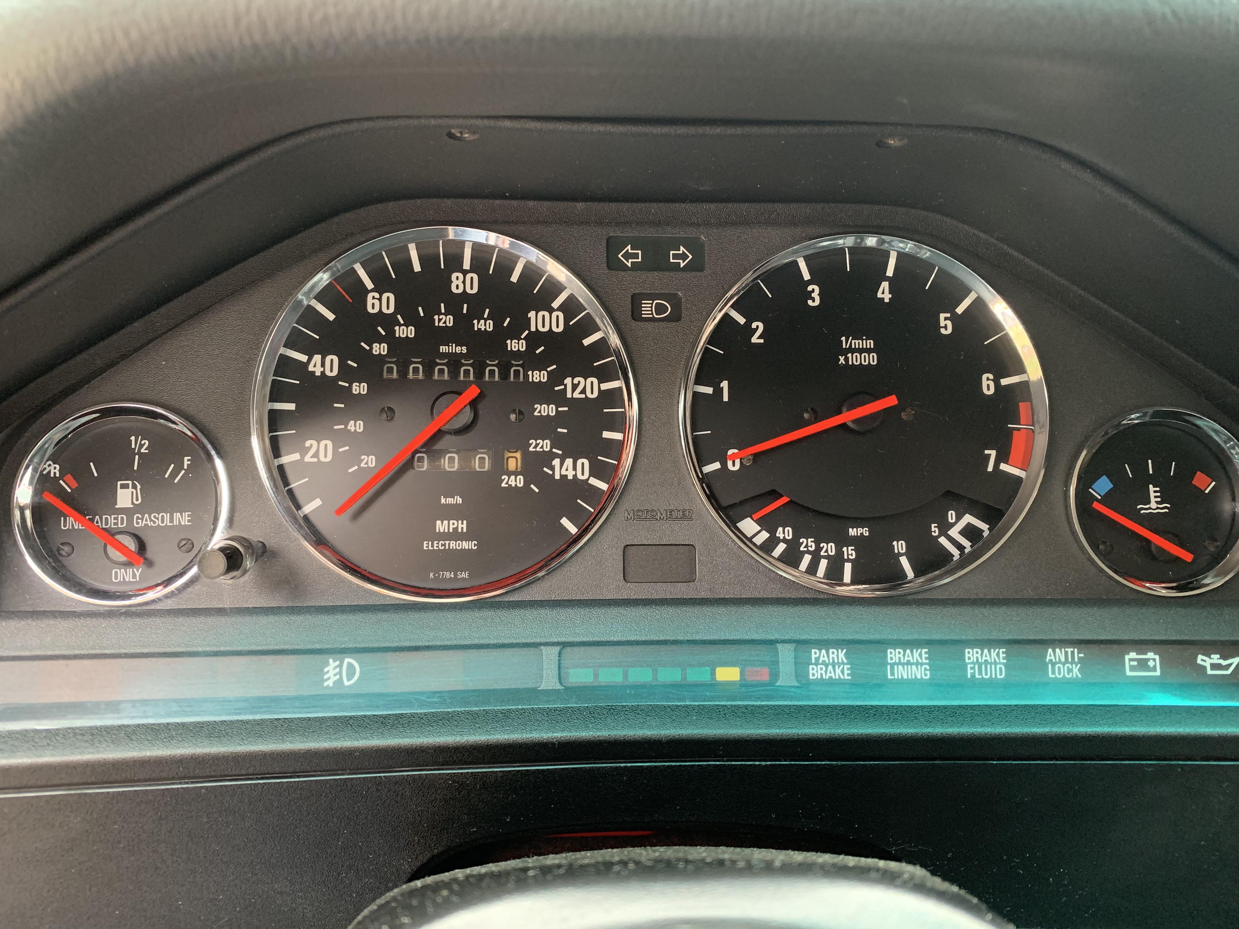

          Z3 steering rack is in, brake booster in, and refreshed the gauge cluster 😁
            #34
            Cluster looks great! What did you use to paint the needles?
            • timmerT
              timmerT
              timmer
              #35
              Fluorescent red needle paint... a couple coats will do!
              https://www.ebay.com/i/190281783139?chn=ps
                #36
                Interesting. My biggest gripe with the E30 clusters is the lack of lighting. LEDs help a ton, but the needles are always hard to see at night. I really want to upgrade to illuminated needles, its just a lot of work!
                Nice job, I cant wait to see more updates!

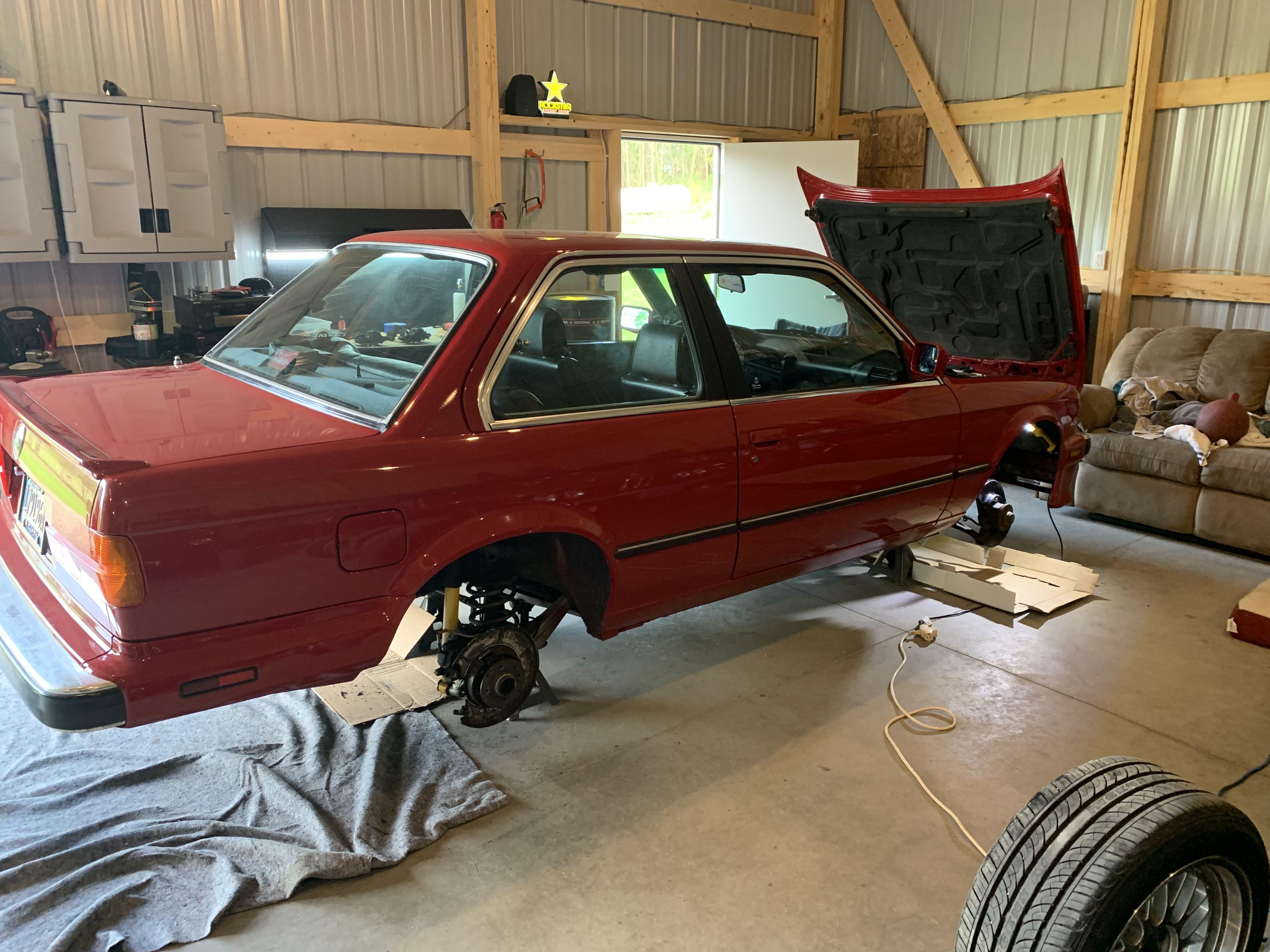

                  #37
                  Getting closer!! 😊
                  • timmerT
                    timmerT
                    timmer

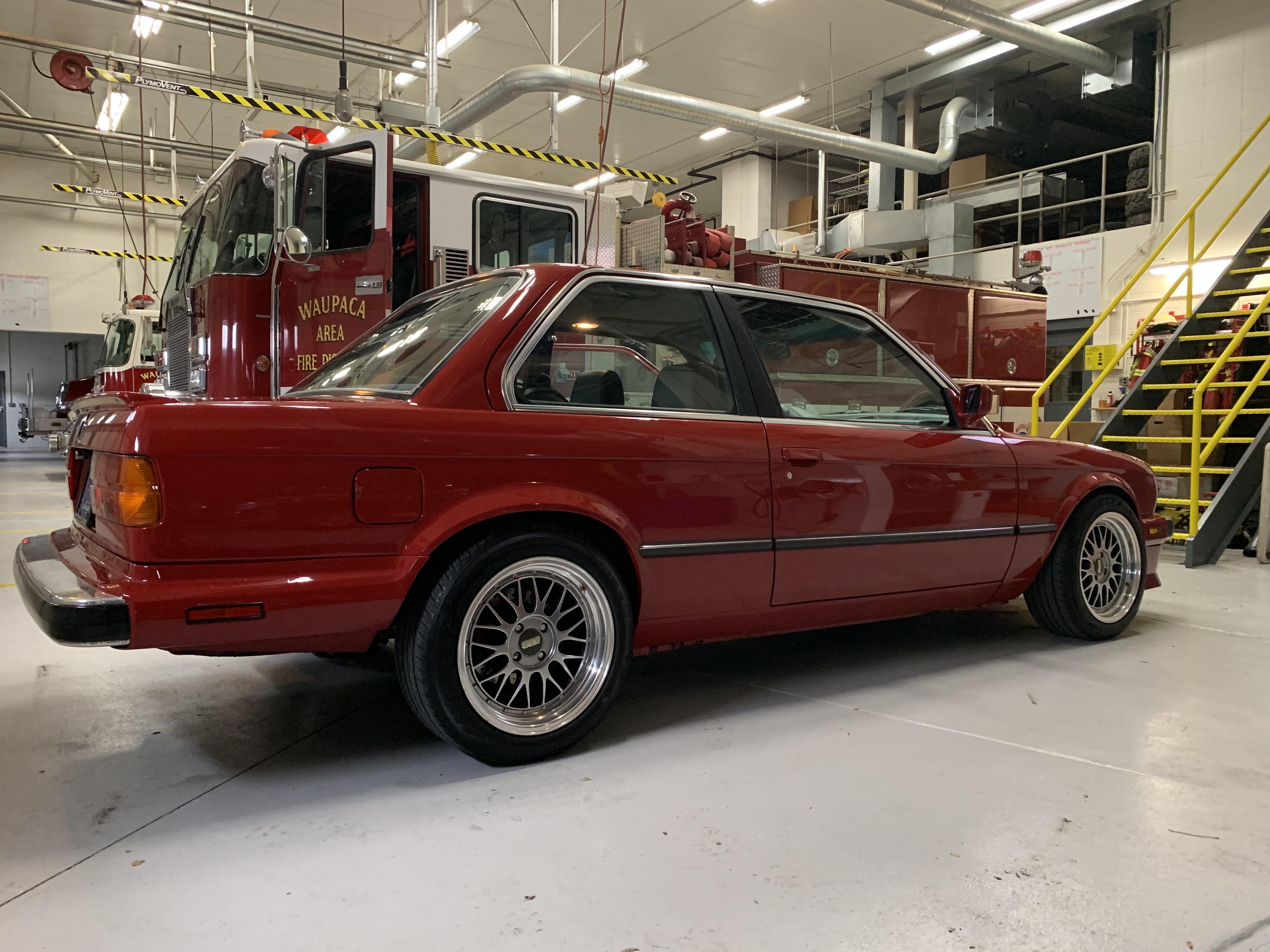

                    #38
                    She’s all buttoned up!  Added uuc short shifter, new subframe bushings, and exhaust is installed... time to get her home!!! Too bad she will be going right into storage... Spring can’t come fast enough!
                      #39
                      Wow, that was fast!
                        #40
                        My build thread in shambles rn...
                        Good work
                          #41
                          Ta da! Nice work!
                            #42
                            Nice & clean! Ready to roll for spring
                              #43
                              Very nice!  Please post your driving impressions once you get around to driving it! Im excited for you man!

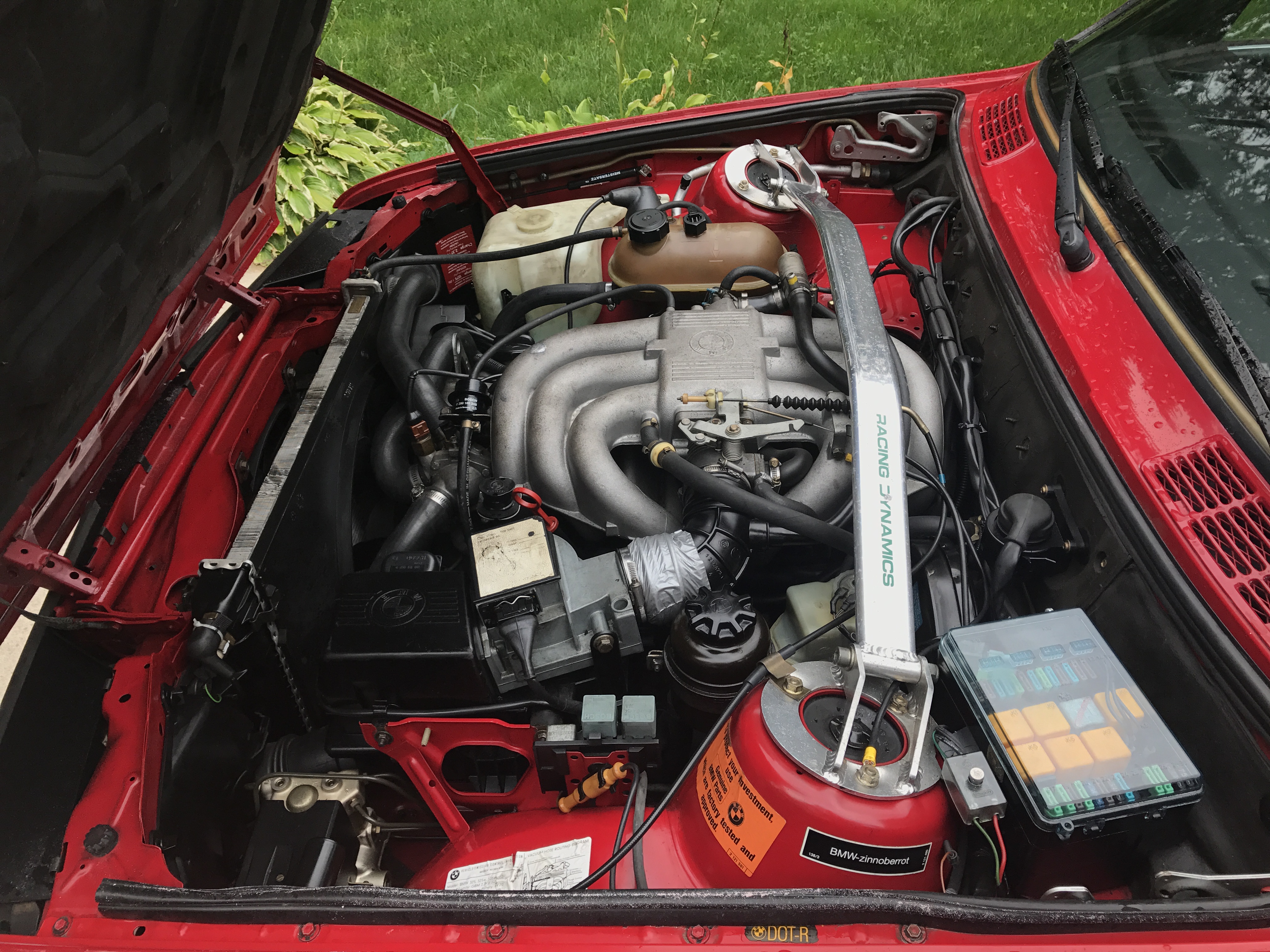

                                #44
                                What is that firewall cover? I love how it hides everything.
                                  #45
                                  M42/S14 engine harness cover

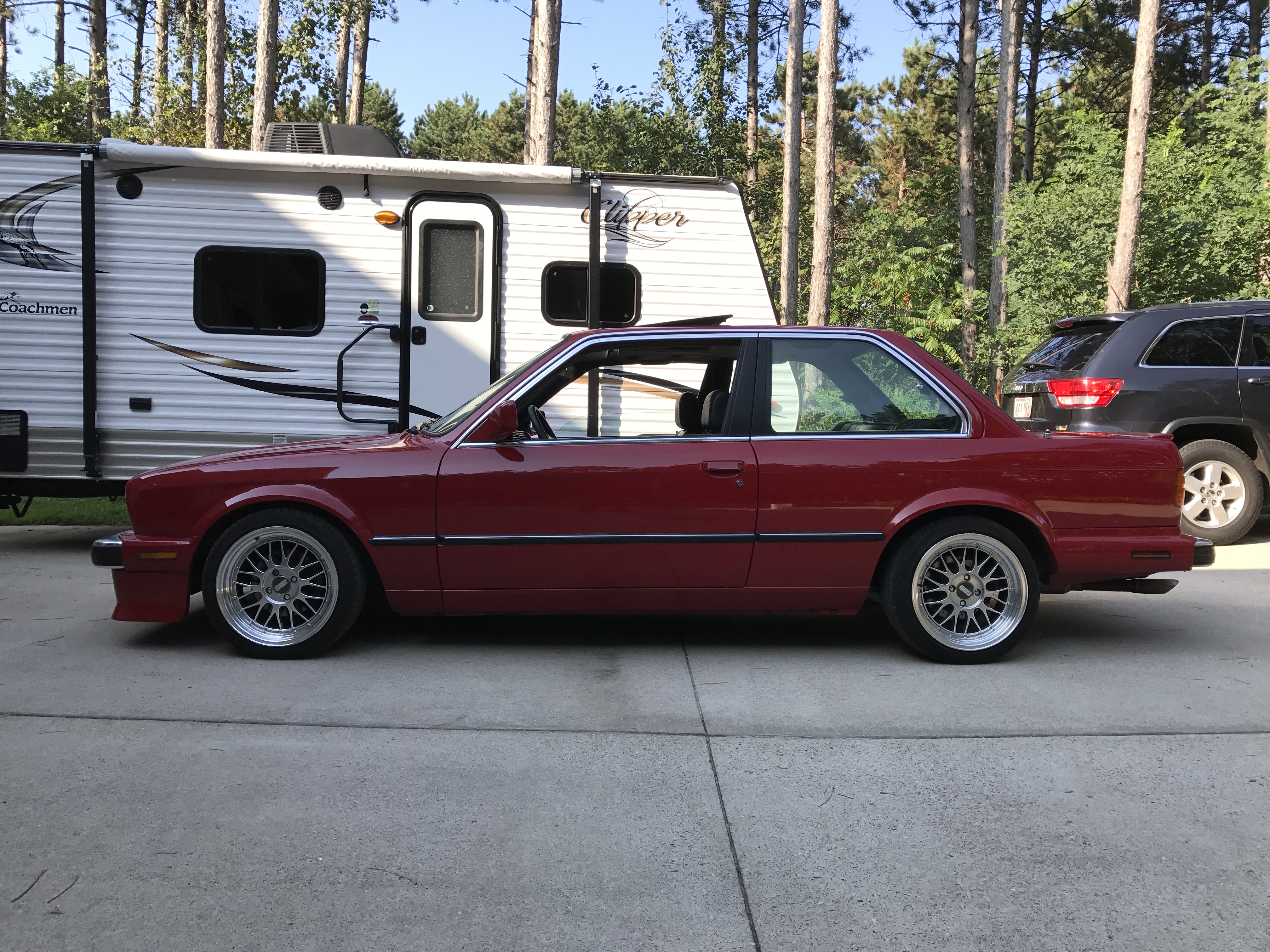

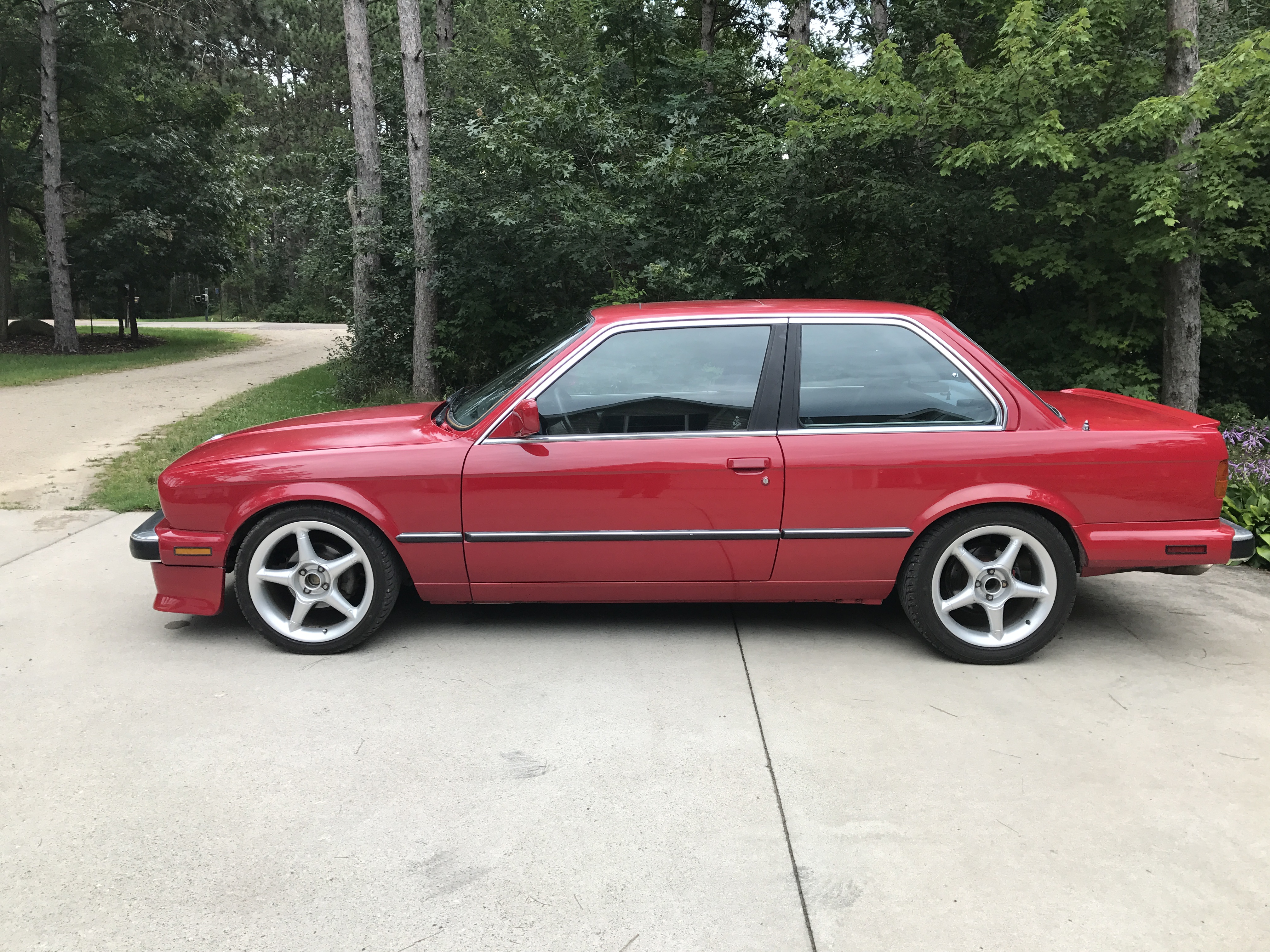

                                        #48
                                        Thanks Snap!!  I had a chance to put a few miles on today, and all I can say is wow!
                                        With the schrick cams, it’s pretty docile around town under 4,000 rpms, and very streetable.
                                        Over 4K it is a beast and is hunting for traction.  I couldn’t be happier!
                                        Too bad I have to put her under wraps soon... can’t wait for the E30 picnic!
                                          #49
                                          I had no idea you would be using it as a fire truck. Glad to hear its running well!
