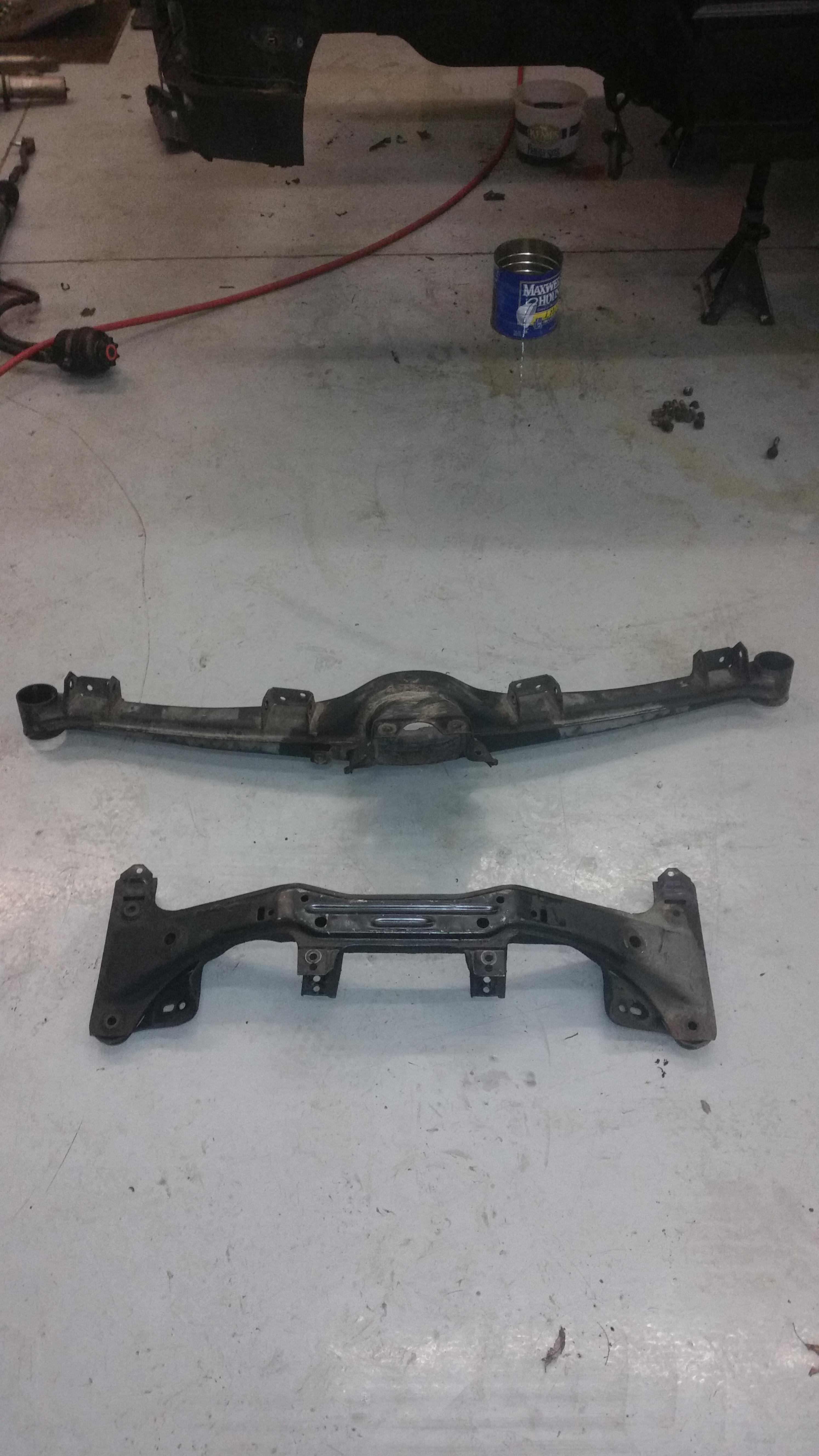

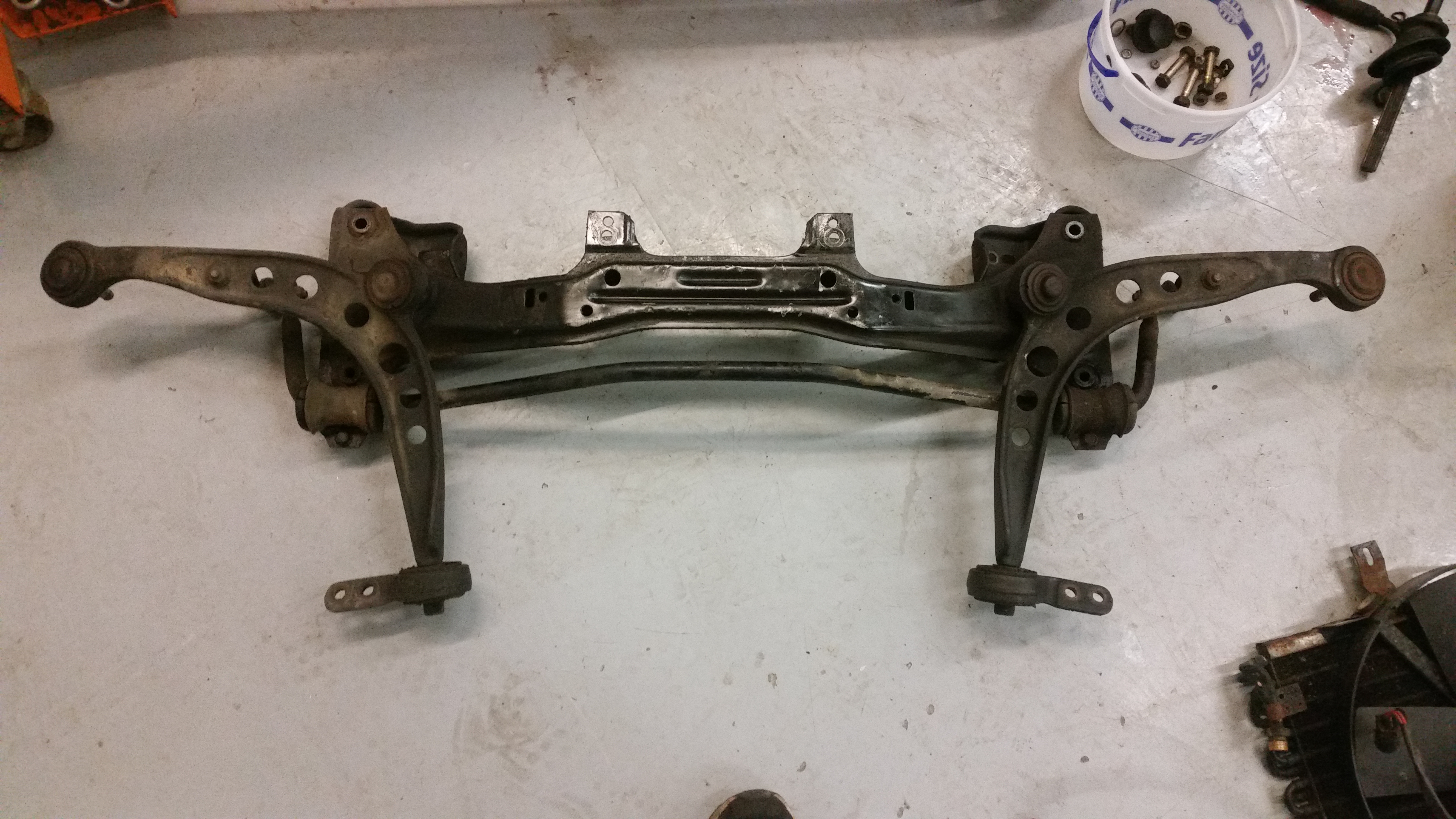

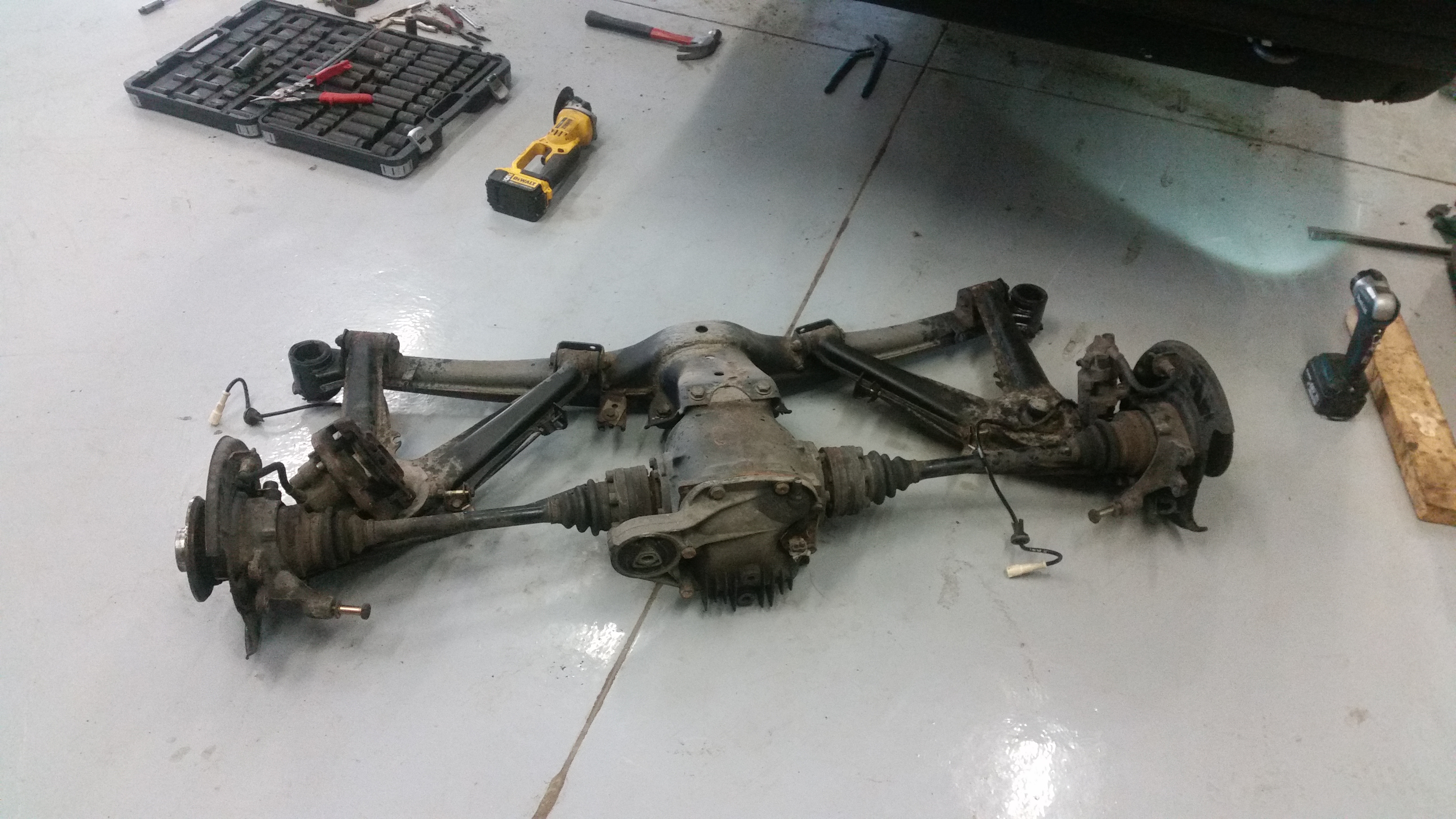

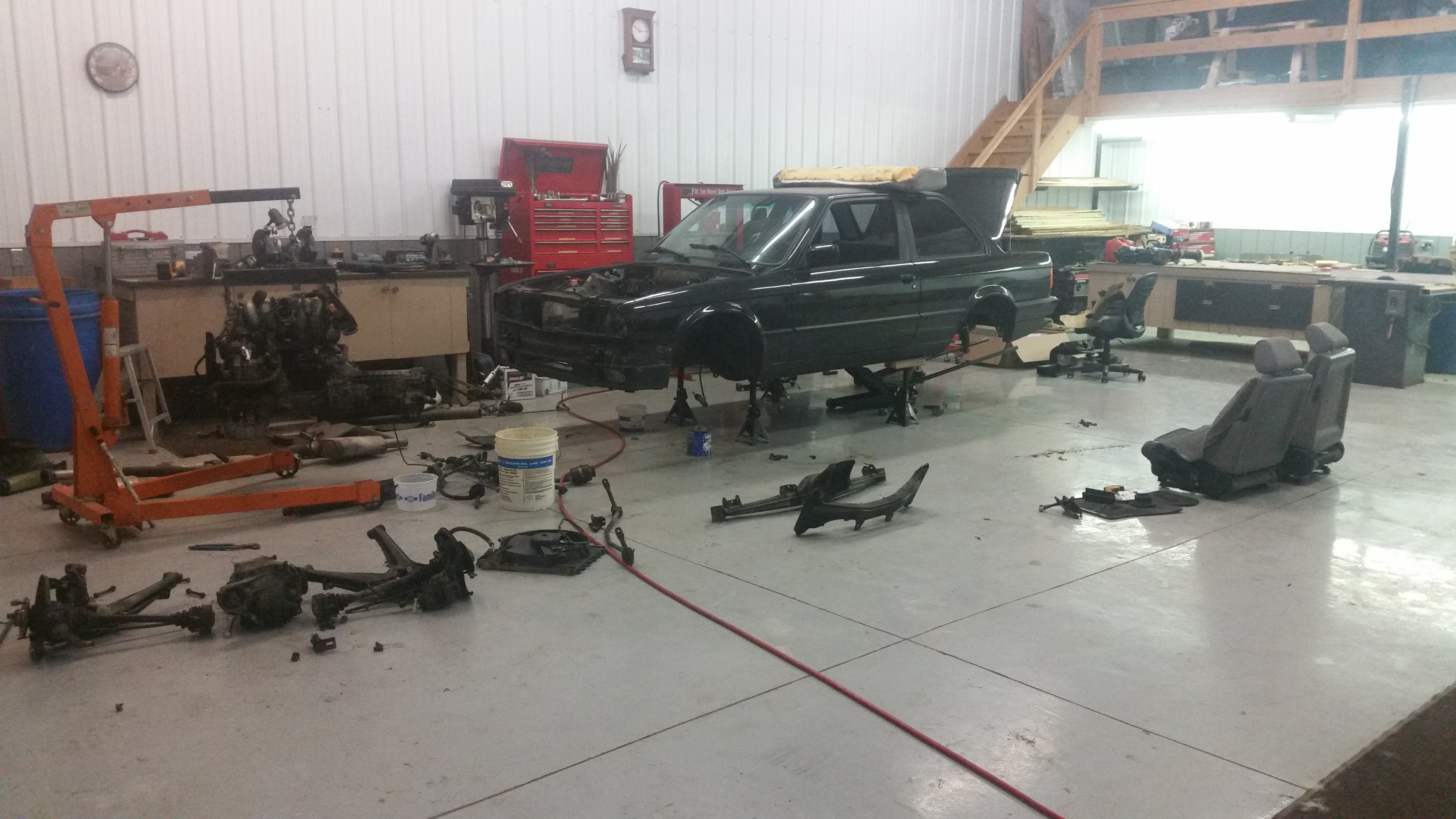

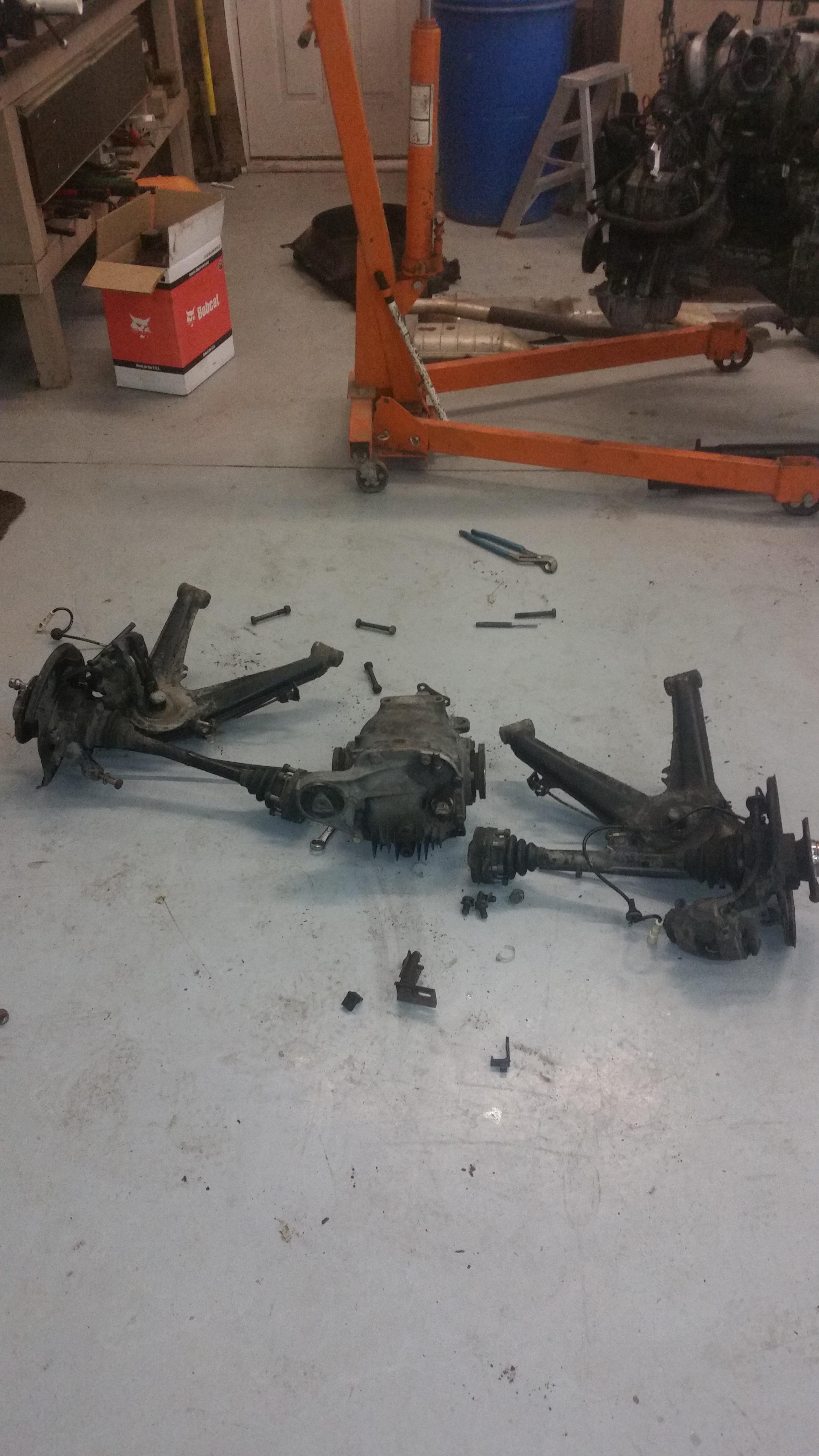

                Got very little done Thursday because, life. Friday though......very productive indeed.
                I think I spent half of Friday just getting the rear end out. Words can not describe how relieved I was when this thing finally broke free from the car.
                20171215221545.jpg\
                Still working on disassembly of the trailing arms.

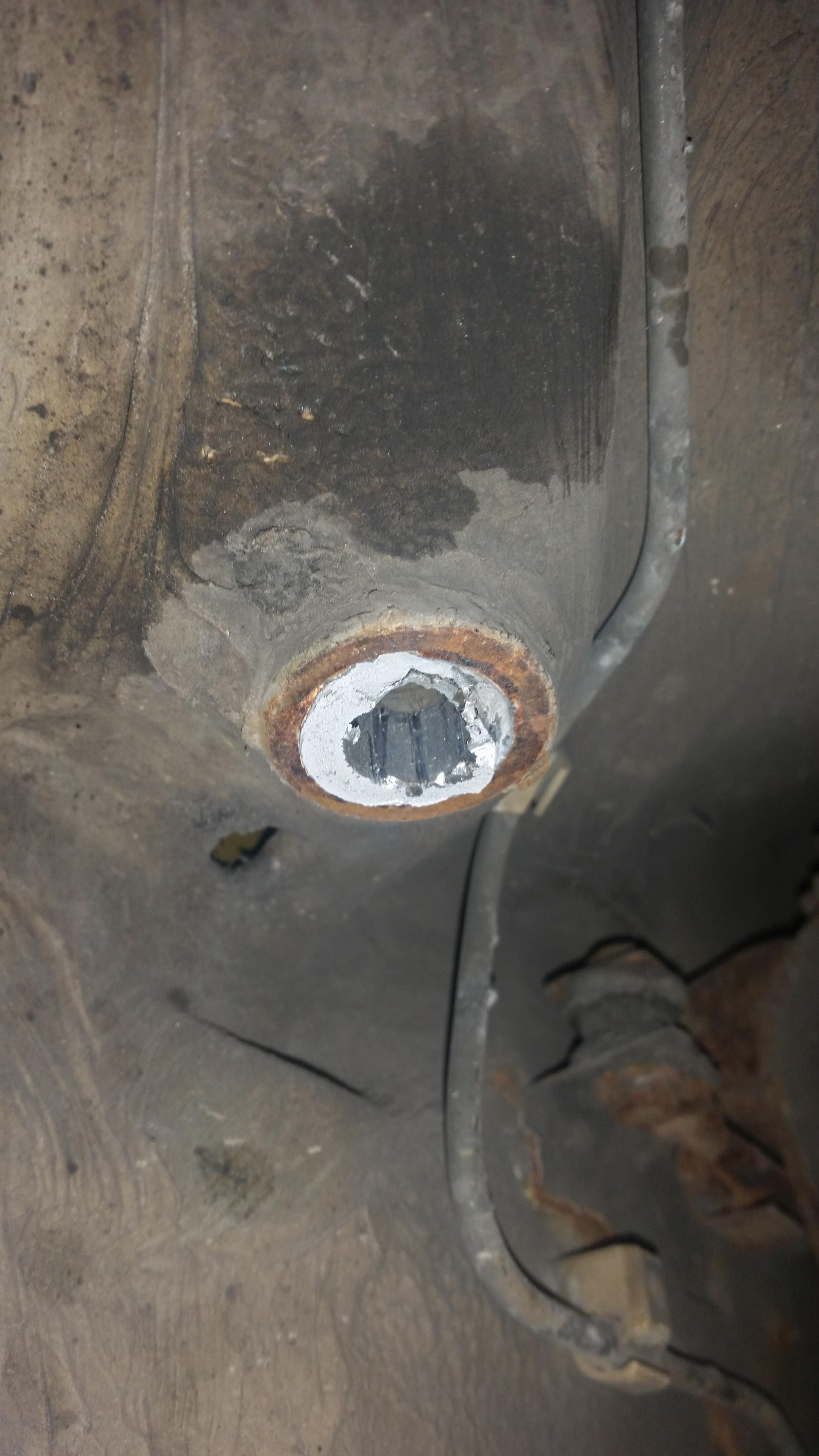

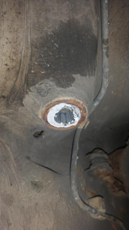

                I should add that when the rear sub frame did finally come free with some gentle shaking, the subframe bushings ended up staying connected to the car instead of coming out. Simple enough...removed the rear seat, pulled out the long studs and knocked the bushings right off. Right side popped out just fine, as for the left. 😠
                snapped off flush with the hole. Still figuring out how I will go about removing this.

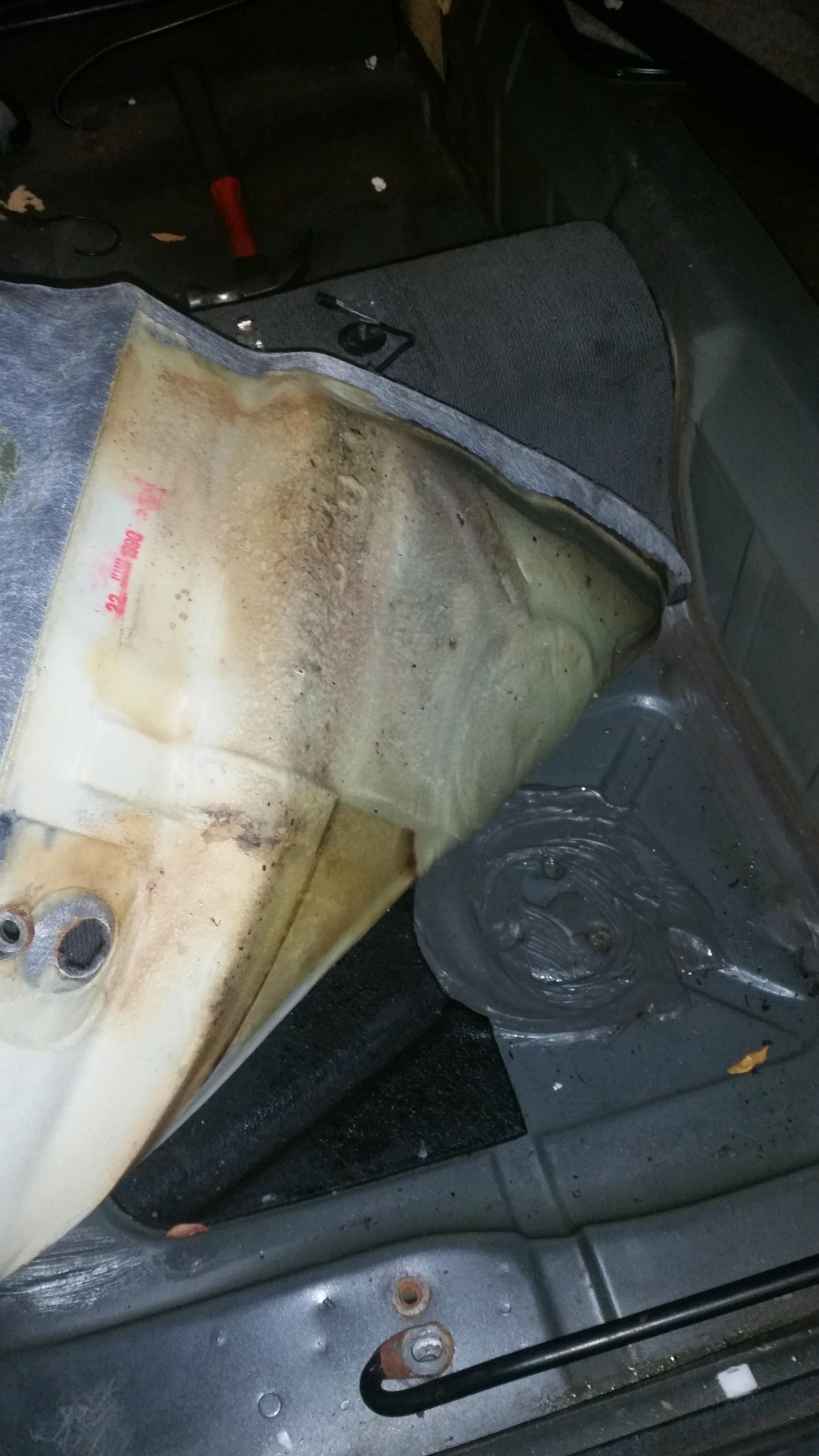

                Transitioning over to the gas tank...

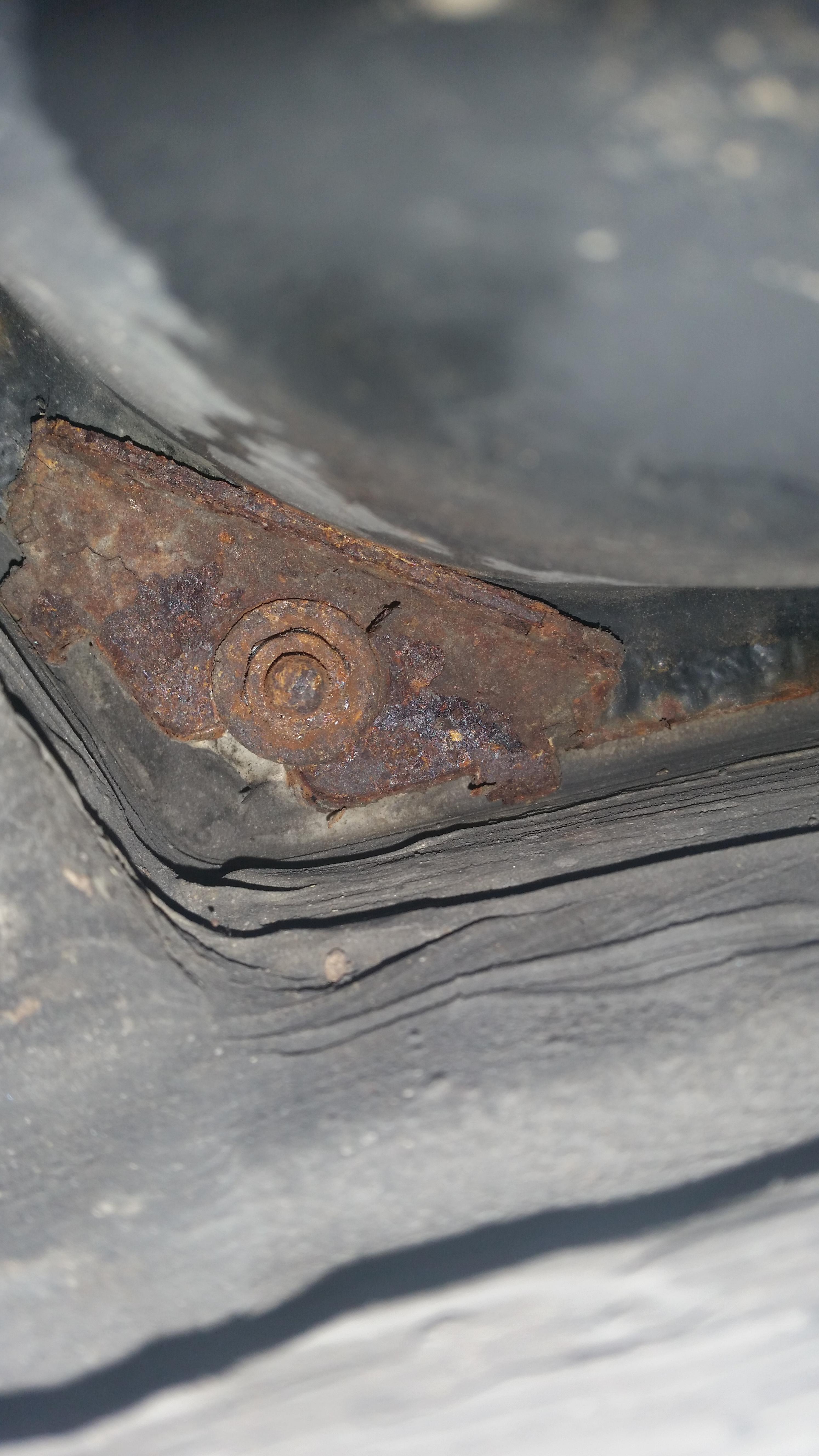

                Out of the 6 bolts, 5 came out fairly well. As for the sixth one...fml
                The nut completely rounded so I can no longer fit a socket on it. As of right now I am still stumped on removing the gas tank until I get this last nut out. Also contemplating on possibly ordering a new aftermarket tank as this one is in rough shape with multiple dents as usual.
                I kind of make a mess when I'm ripping and tarring...

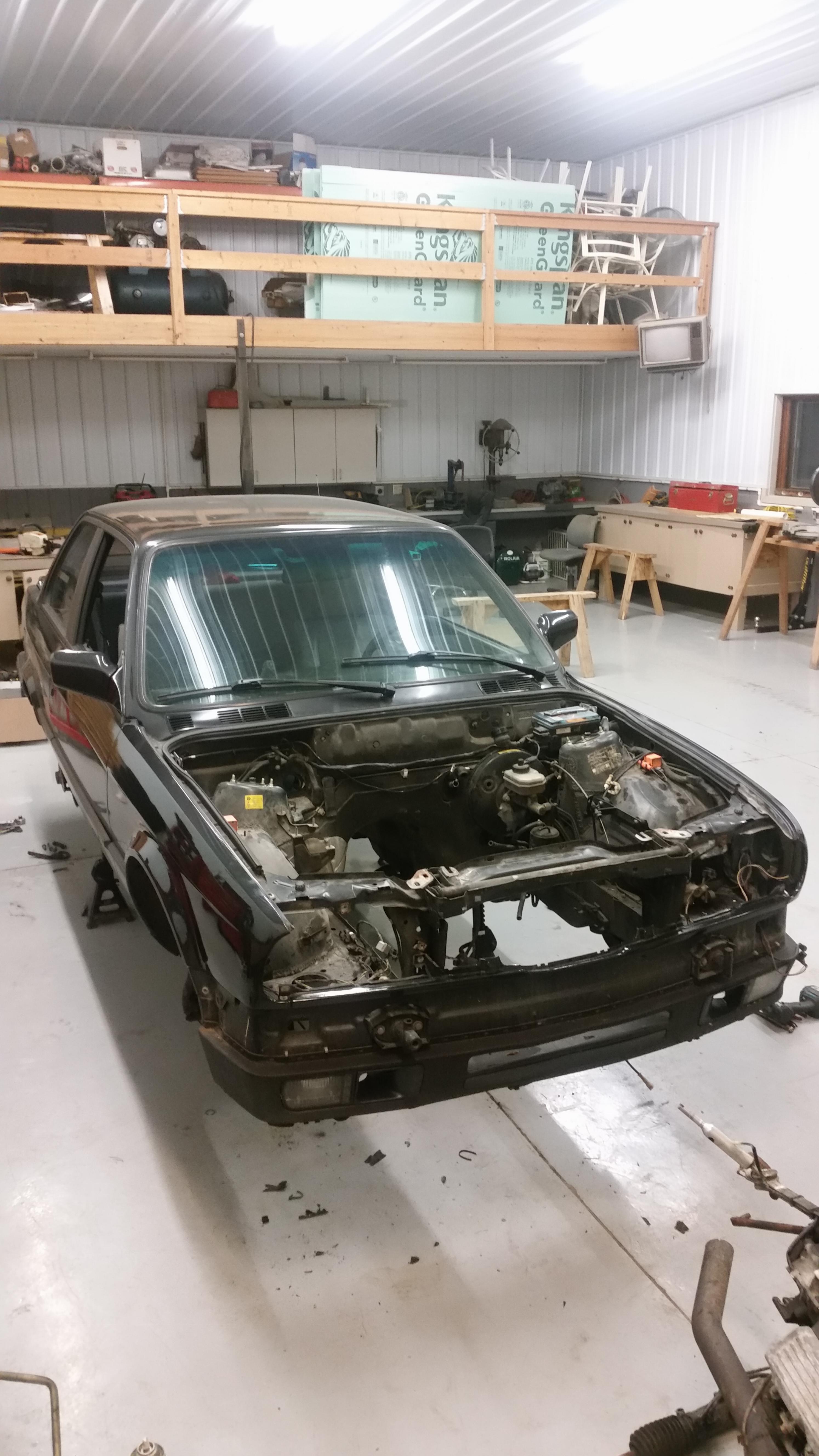

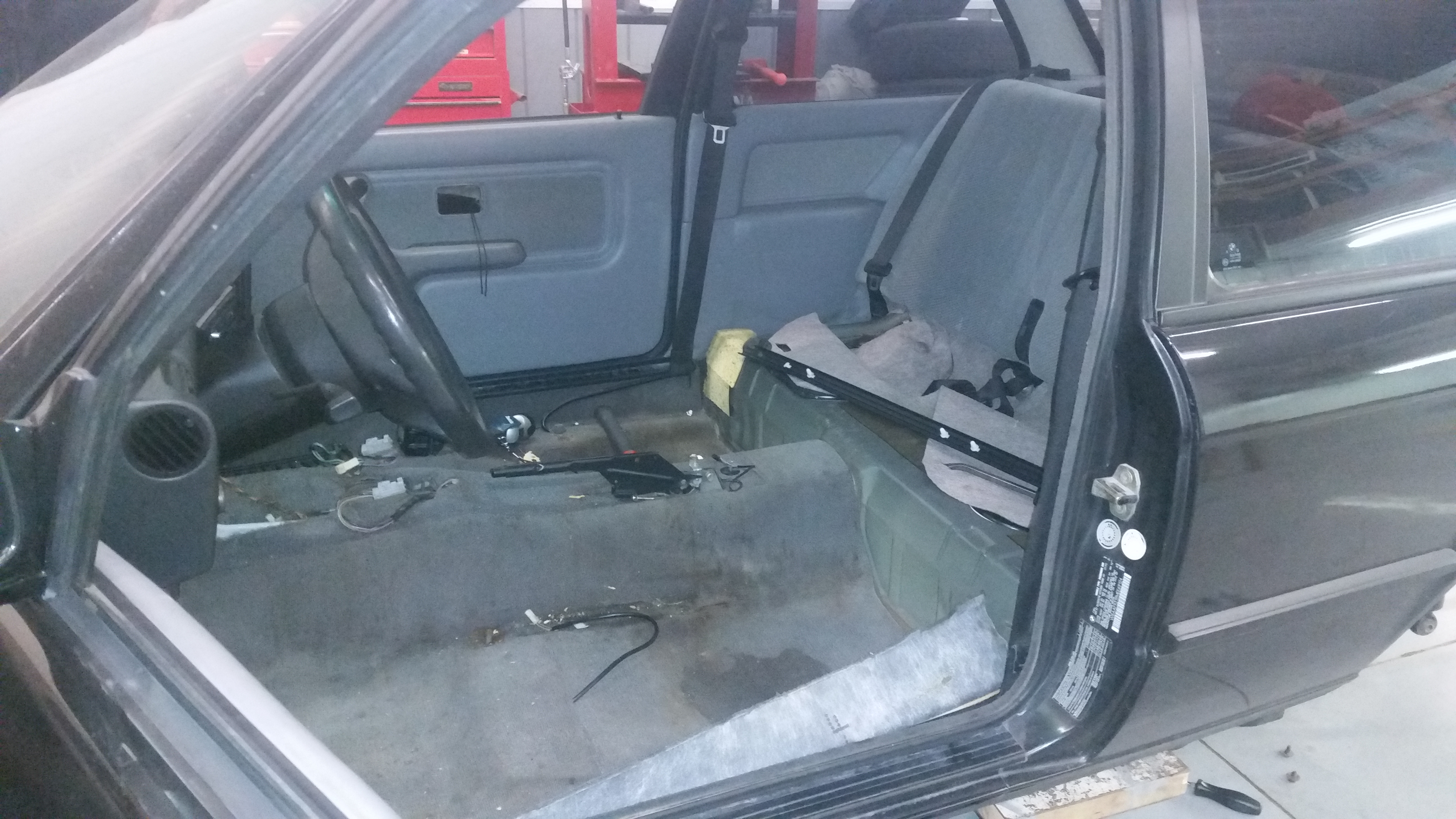

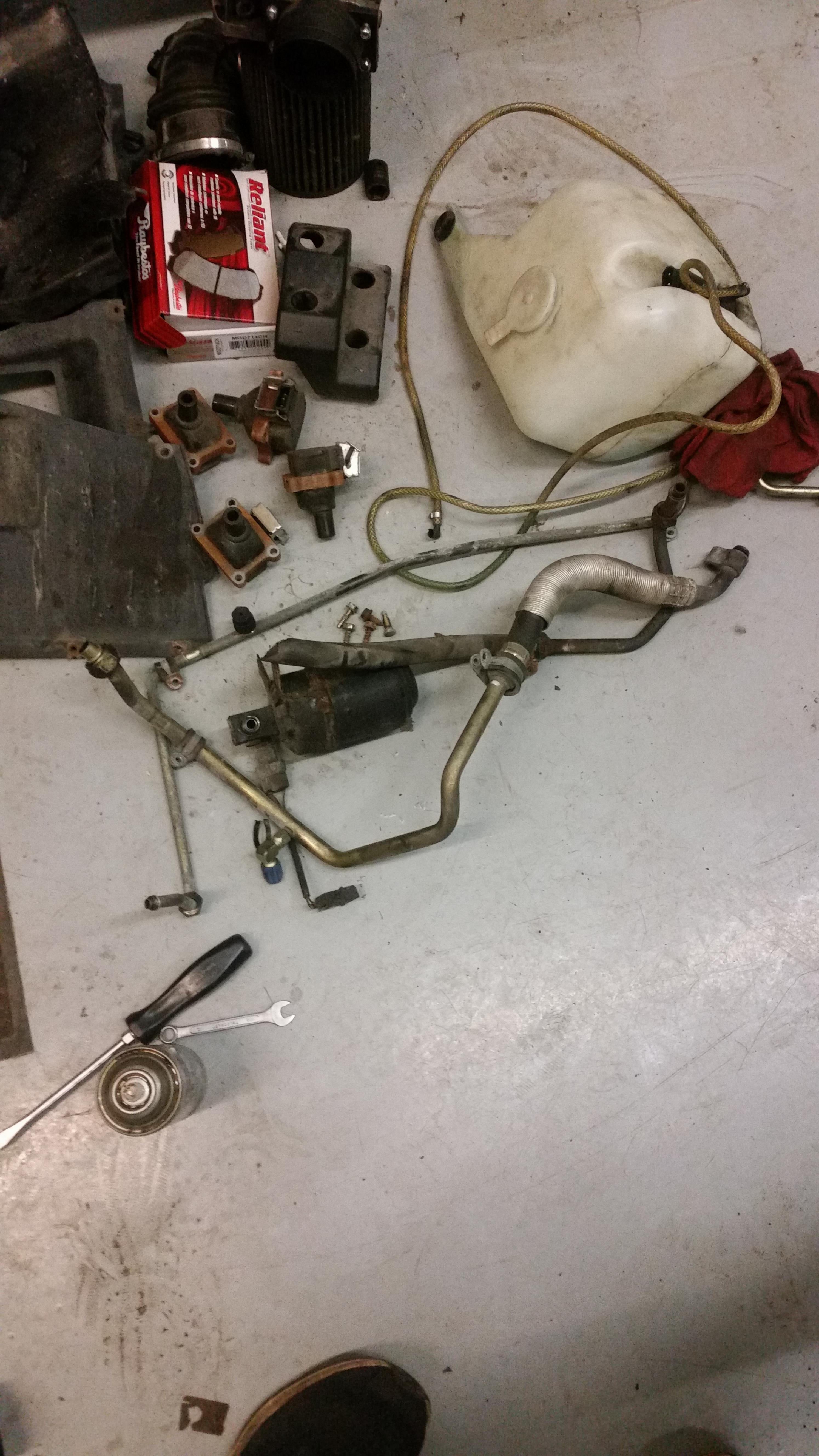

                In between this fuss I was able to remove a few more things from the engine bay including the pretty much the rest of the A/C lines and condenser as well as some interior stuff.
                Carpet is in rough shape. Recommendations for carpet restoration is always welcome.

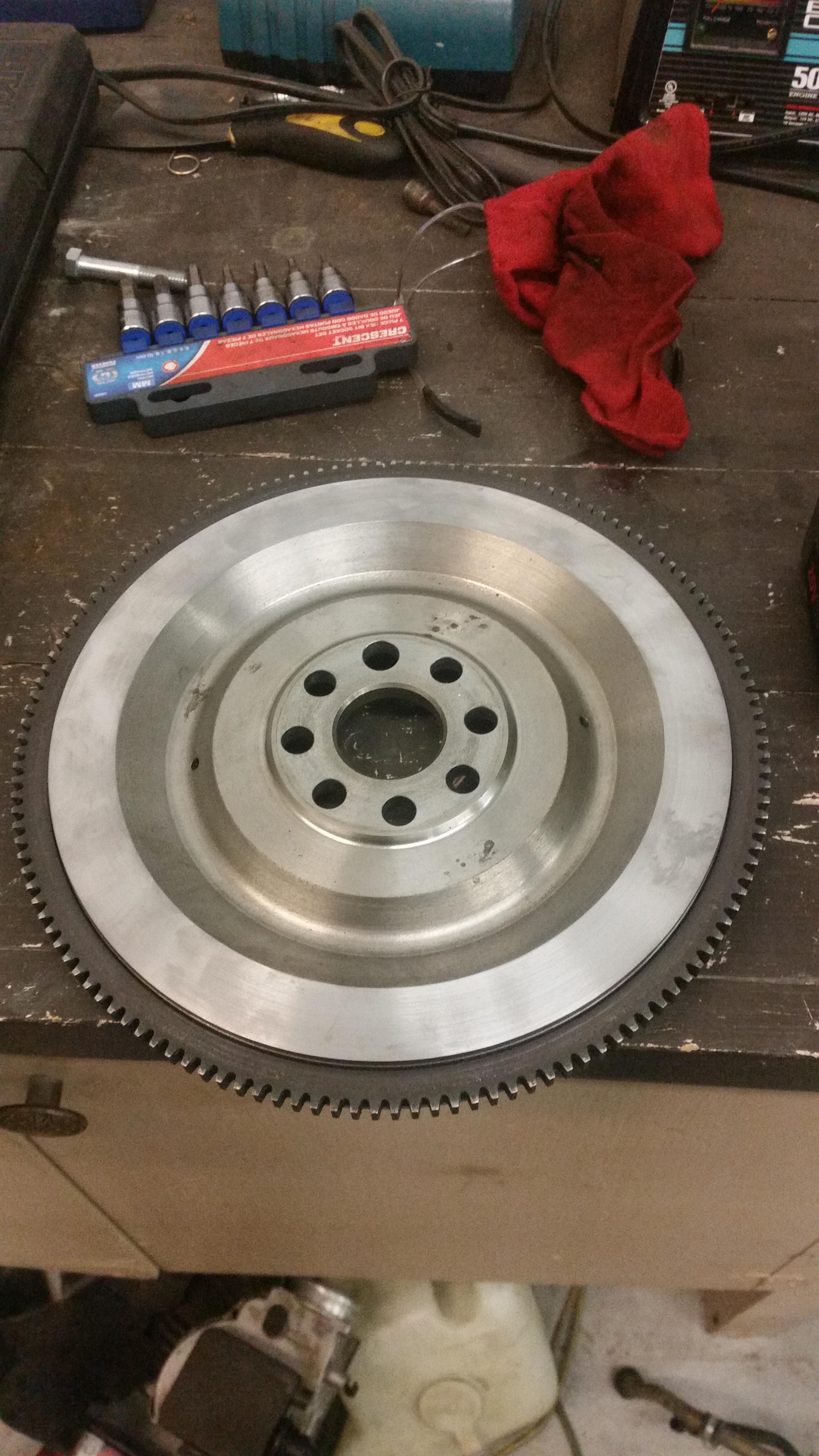

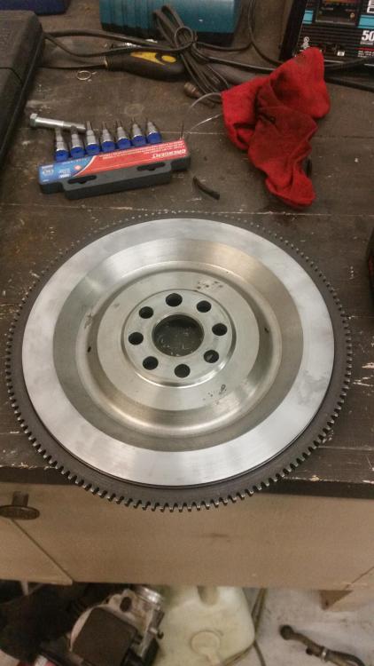

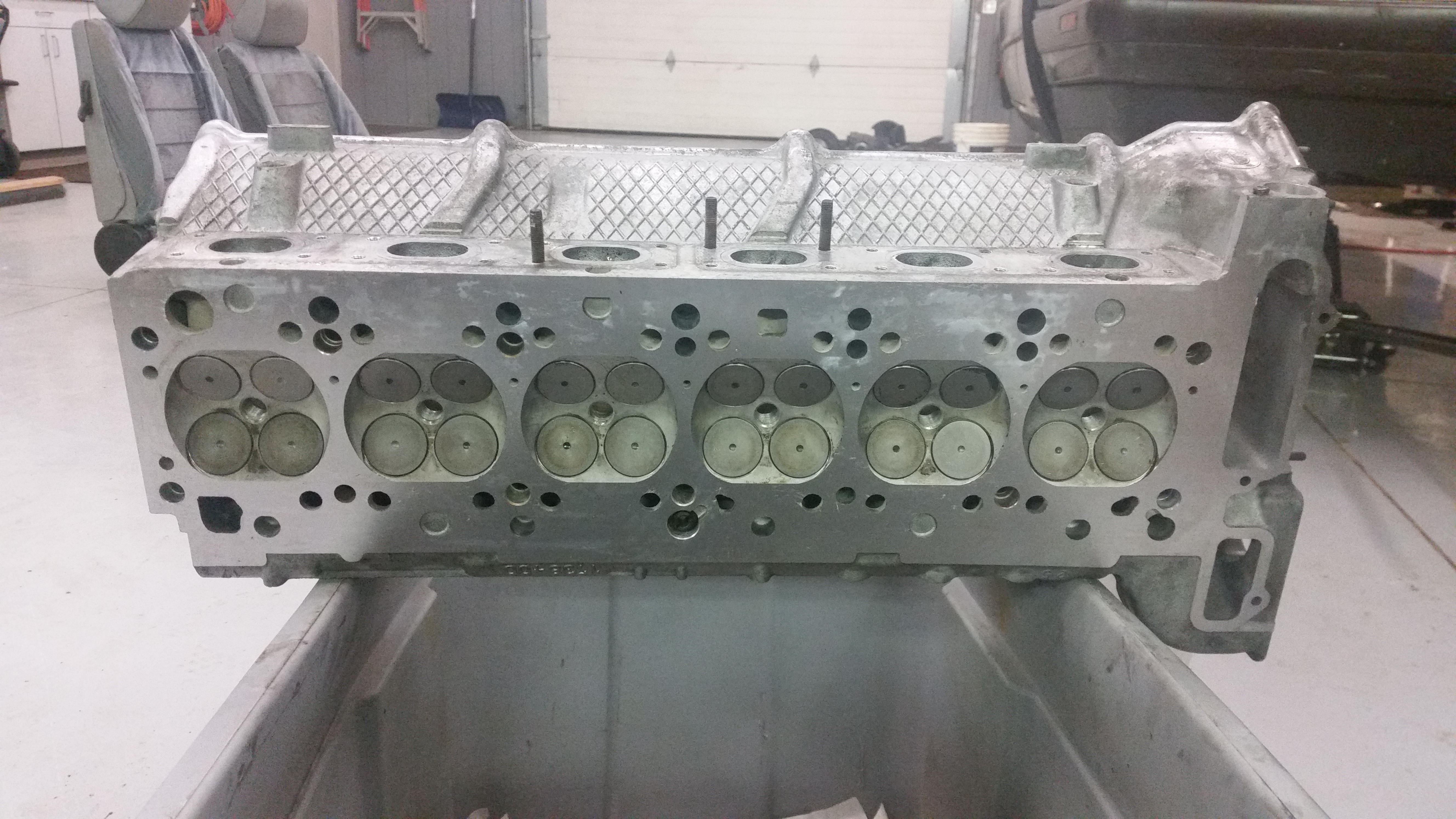

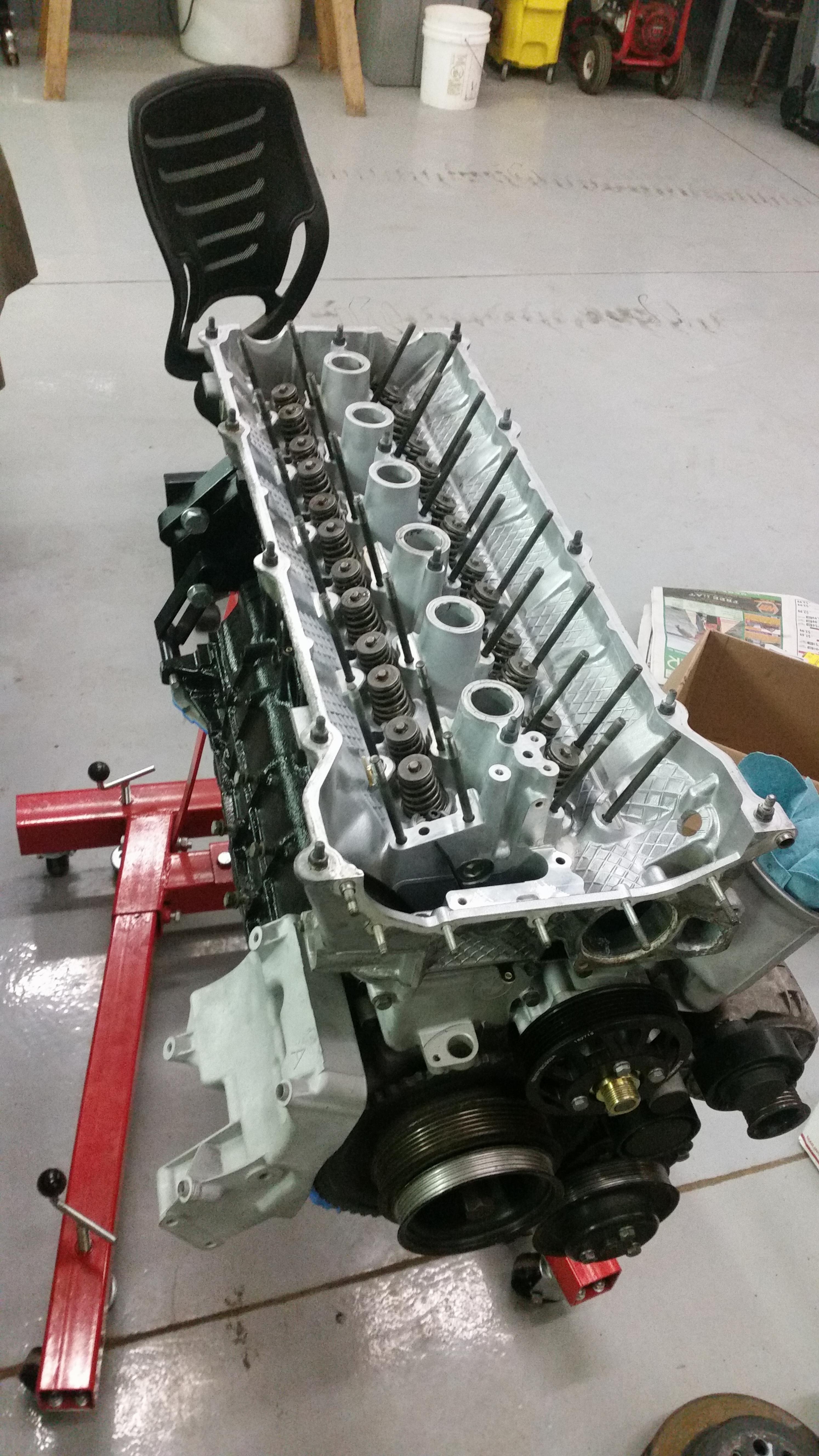

                Got a call from my machinist. Flywheel and cylinder head are done! went and picked them up that night. Very pleased with how both turned out overall.
                Cylinder head received a valve job, decked, and magnafluxed. Sense I will be running a m20 single mass flywheel, I had him remove a 1/8 of an inch on the back side to clear the e34 oil pan.

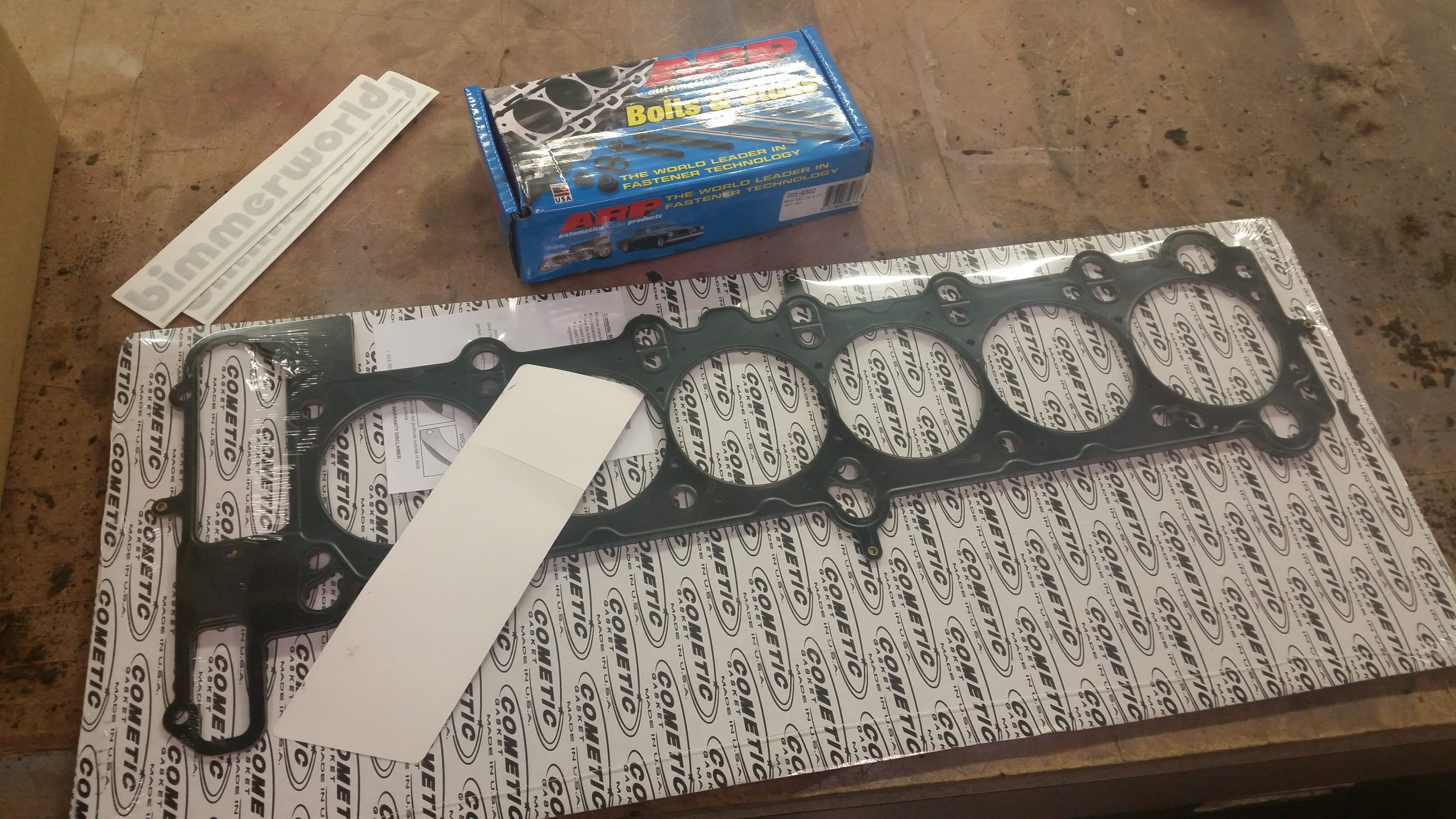

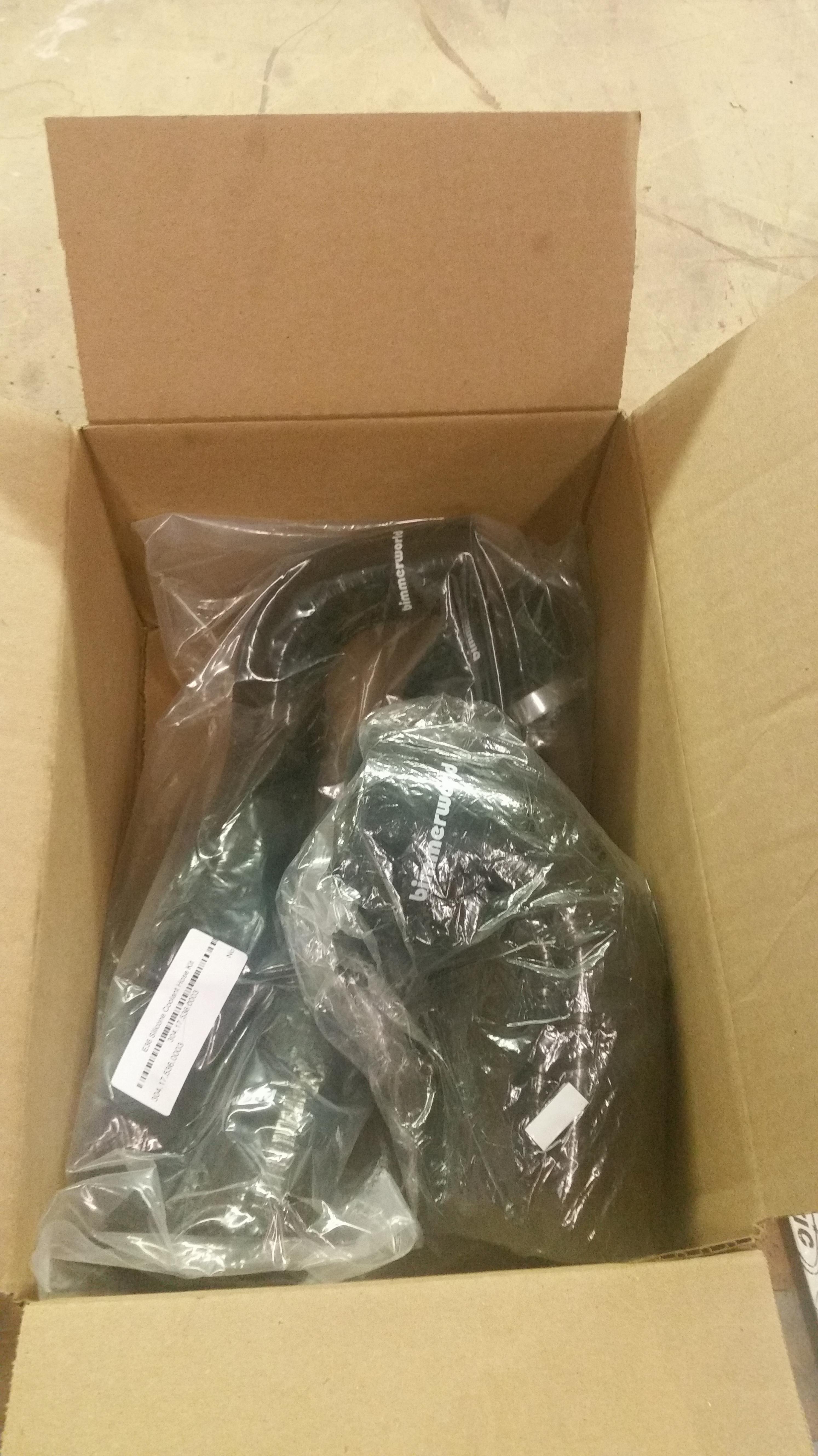

                Head gasket also arrived as well as a few things from bimmerworld...

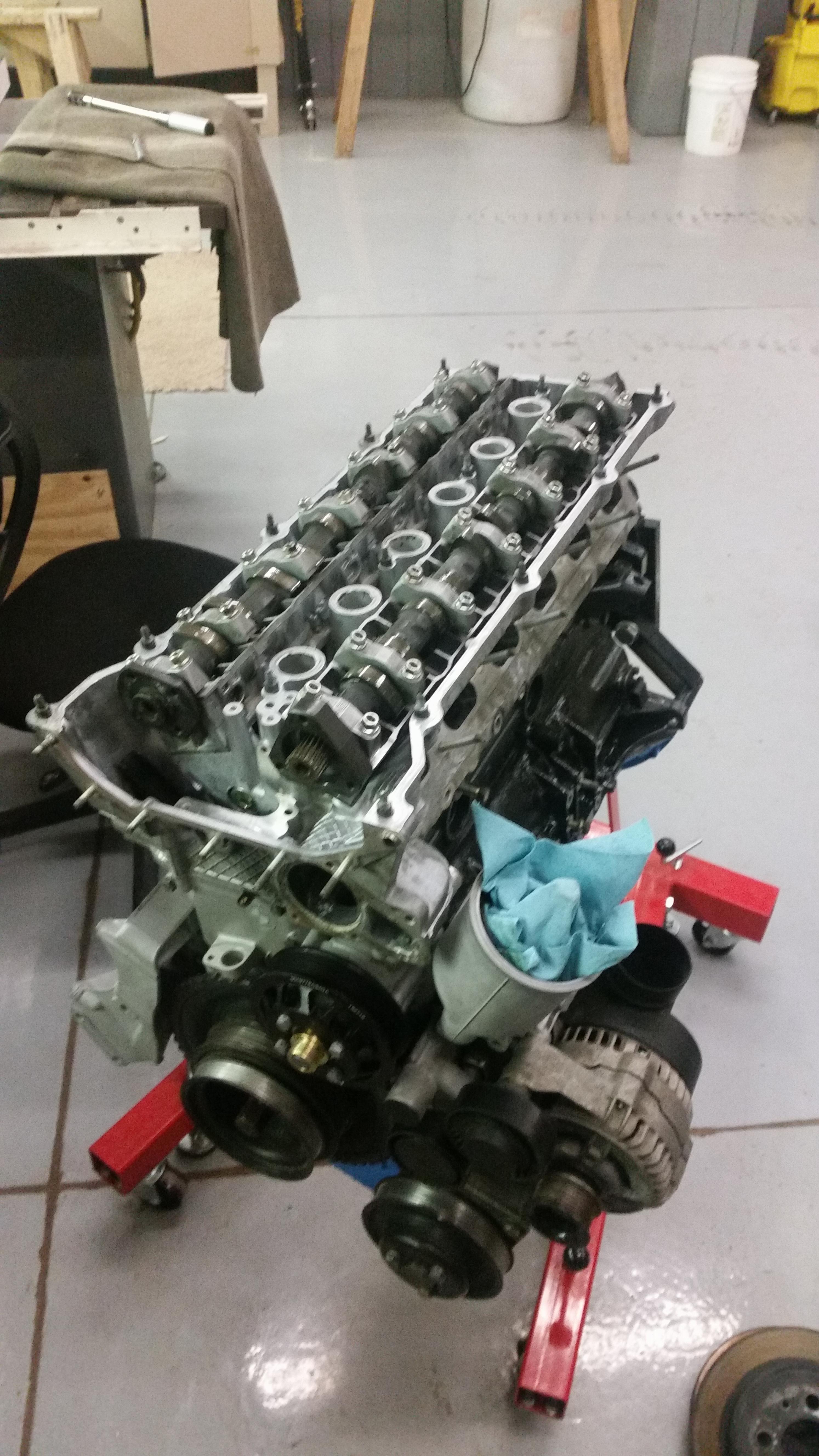

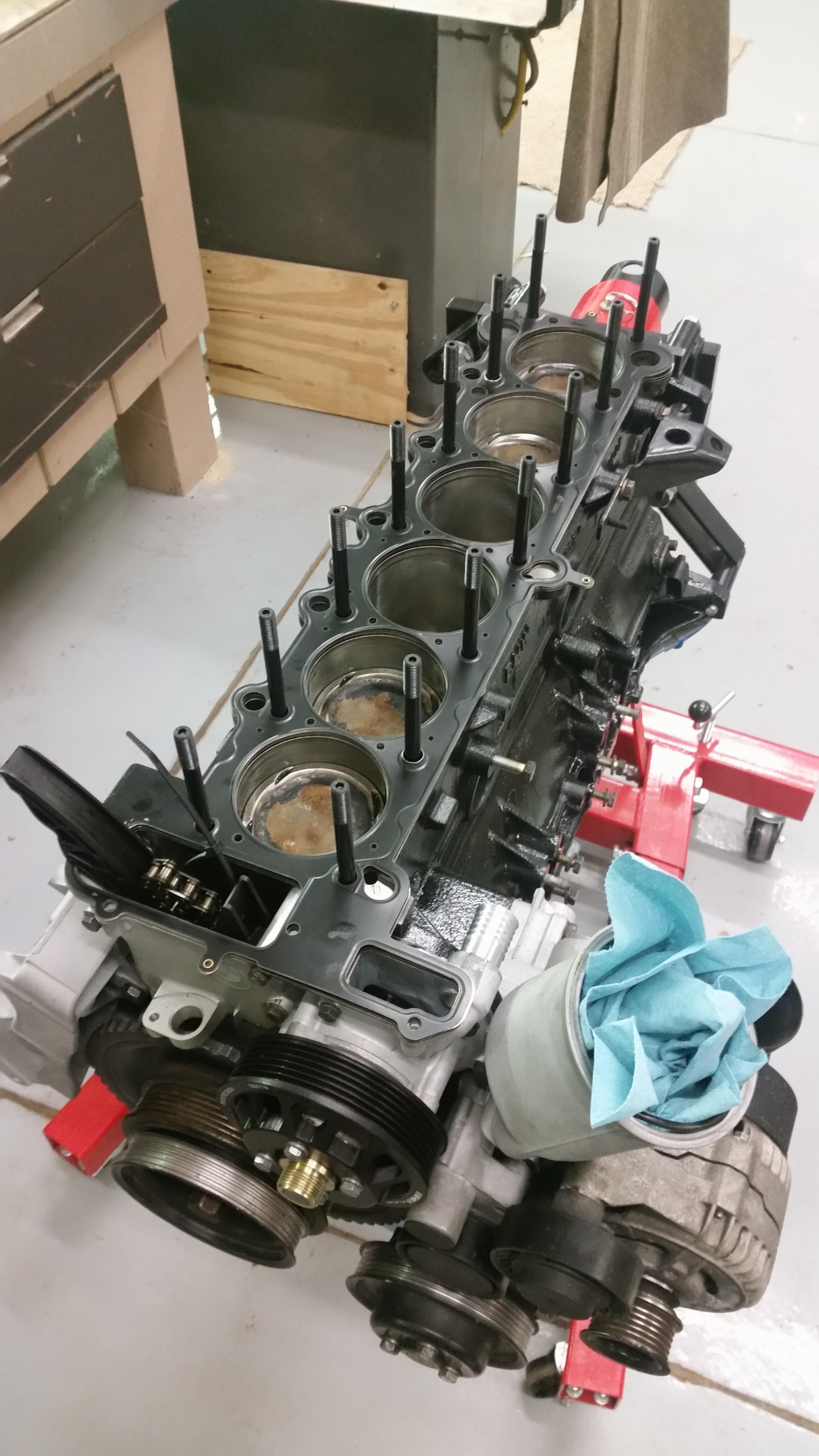

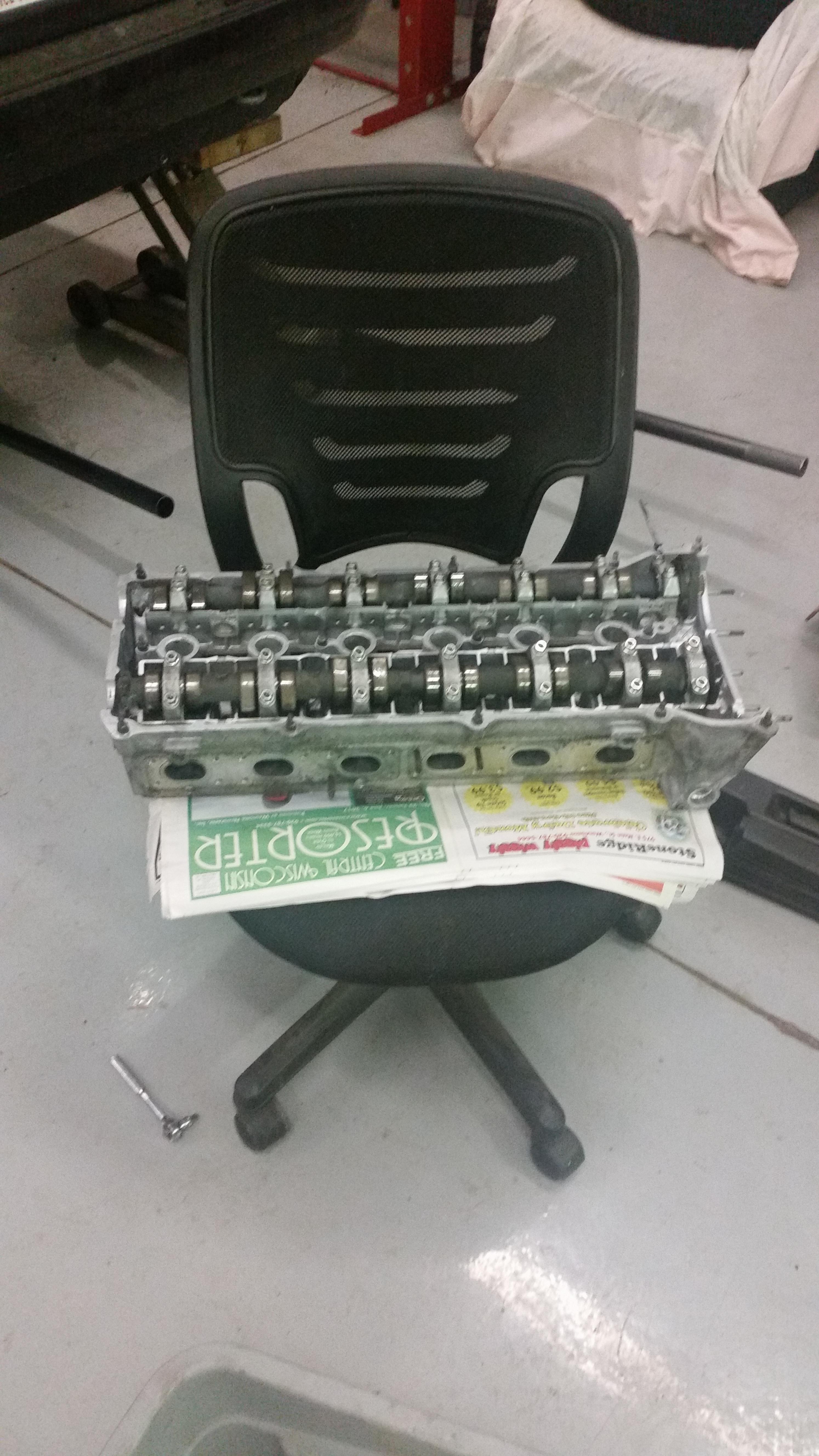

                Saturday I took a break from the car and its problems and started tinkering on the motor some more.
                Still gotta get the cams torqued down so gonna work on that tonight. Hopefully I won't snap any of the threads out of the bearing cap stud holes when torquing them down, but we will see.

                  May your cam bearing cap threads stay intact [emoji1374]
                    #89
                    For the stuck piece of the subframe sleeve you can try threading in a big lag bolt and see if that gives you enough bite and leverage to remove it, unlikely but still worth a try. If that doesn't work it's time for a small hole bit or a large drill bit and just hone out the aluminum. Wear eye protection, the small pieces fly around.
                      #90
                      I had to tap the hole and thread a bolt into mine. Worked well

                        ARP head studs and stock HG thickness? Or did I not see it correctly
                          That is correct.
                            I'll give that a try. Might even put a little heat on it as well.
                              #94
                              Ended cleaning out the subframe bushing leftovers with a Dremel when that happened to me.

                                  For the bushing leftovers I usually took a small drill bit and drilled holes on opposite sides (as close to the edge as possible) and you end up with the leftovers split in two. Easy to hit them with a screwdriver (or chisel) from the edge and spin them which usually results in them dropping right out.

                                  As for the fuel tank nut I have some cool reverse fluted rounded nut removers that work really well for things of that nature. Hell maybe I'll even track down those vanos tools and come visit you and lend a hand.

                                    Late update:
                                    Cams all twerked down. No issues there.😴

                                    Gas tank bolt, I took a 12 mm deep well socket ( the nut is suppose to be a 13) and hammered it on there with an extension. Hooked it up to the impact wrench and the nut came right out! After a little rejoicing I went over to the floor jack and loosened the handle to see if it would break free...No go. Wtf! So I crawl back under there to find that I had missed a bolt and guess what, Fucking rounded!
                                    So I grabbed my 12 mm socket and extension and hammered it on once again, hooked up the impact...😠
                                    As for the sub frame bushing epidemic. I tried the threading and bolt trick. Woohoo! no success here either. Except the fact that I was able to chip off another small little piece of it.

                                          These guys work wonders for rounded bolts. If you dont have a set, you are welcome to borrow mine.
